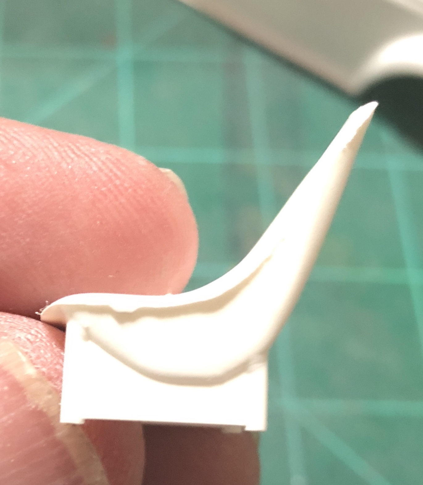

I’ve got the body in rough primer and I am added mount tabs and primed the cage. With the scale 3 inch body lift I’ve added, I will have to also lift the seats up. I’m considering cutting the center web in the seat mount and build some risers/seat mounts.

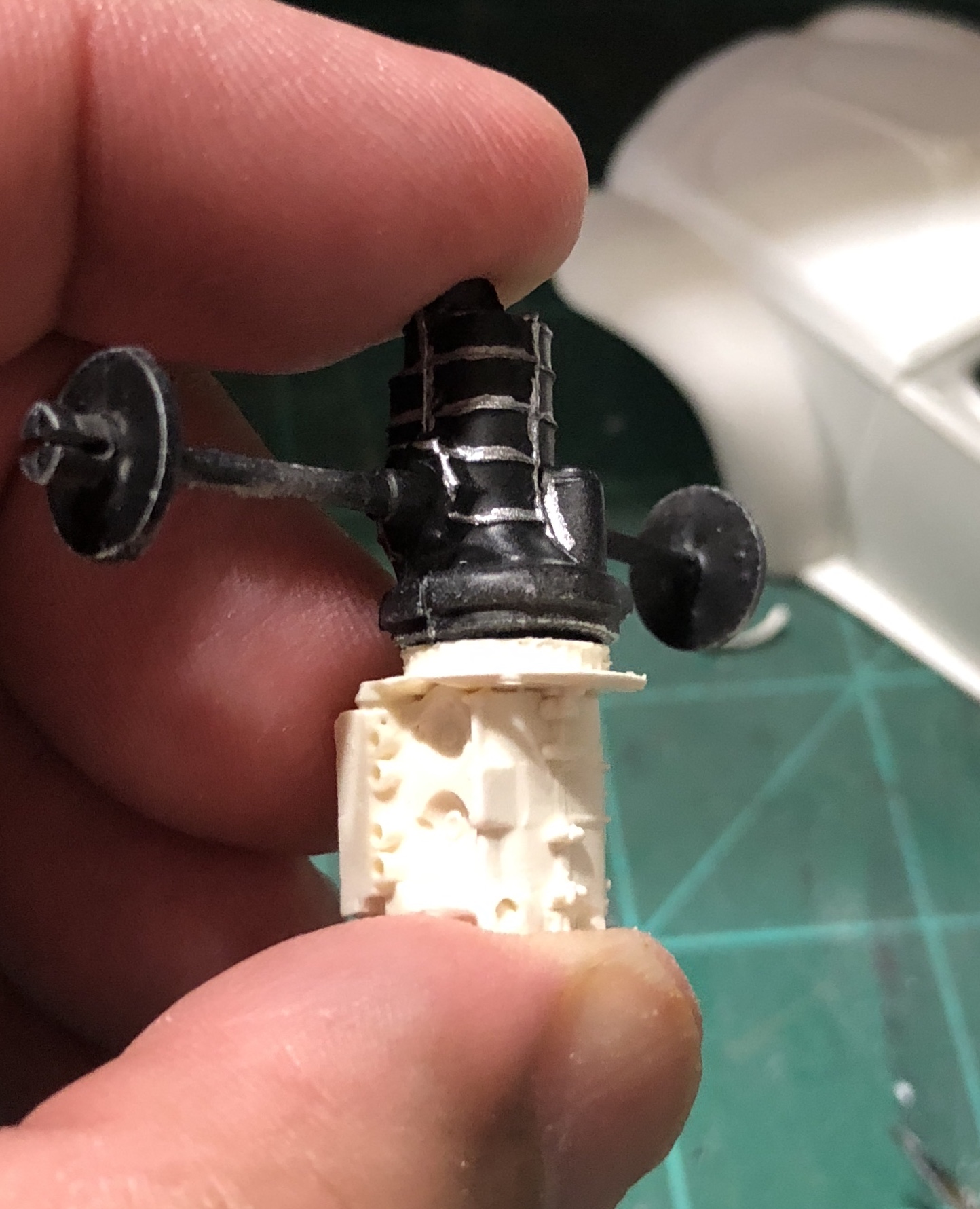

 I purchased this resin cast engine and I am doing some cleanup on the parts.  I like the look of the 36 horse style fan shroud and I usually modify the 1600 Revell fan shrouds to look like 36 horse shrouds anyway . Interestingly it does not have cylinder tin which leaves the cylinders exposed which might look good for a drag car but not practical for a Baja bug. It’s going to have to work. Just like in real life, the issue with trying to fit a 200mm flywheel in an early tranny case, this cast resin flywheel doesn’t fit the stock Revell bell housing.

Since this is an off-road car, I’m going to save the 48’s for my upcoming drag convertible bug and I’m going to run these air cleaner covered webers instead.

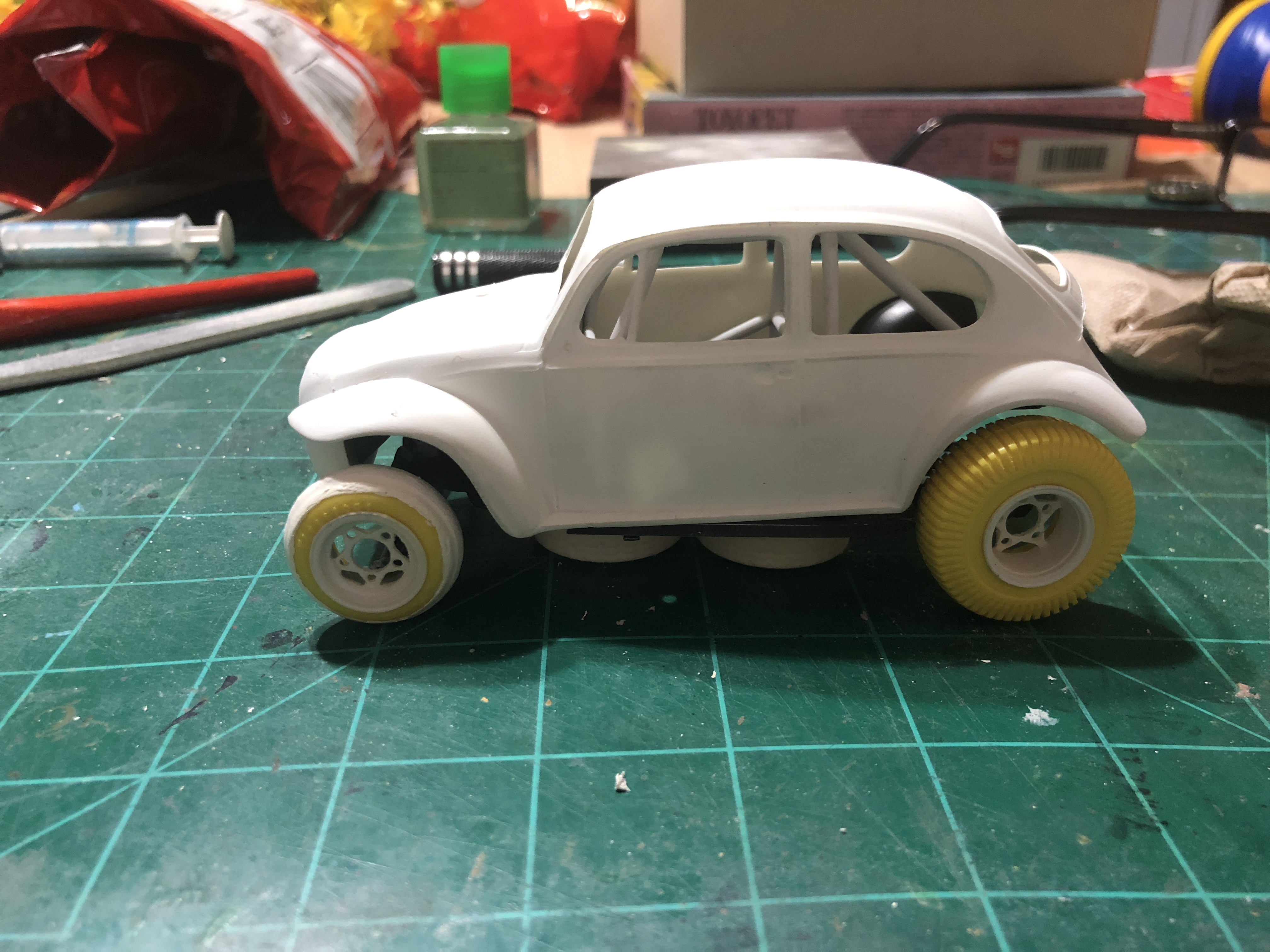

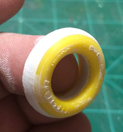

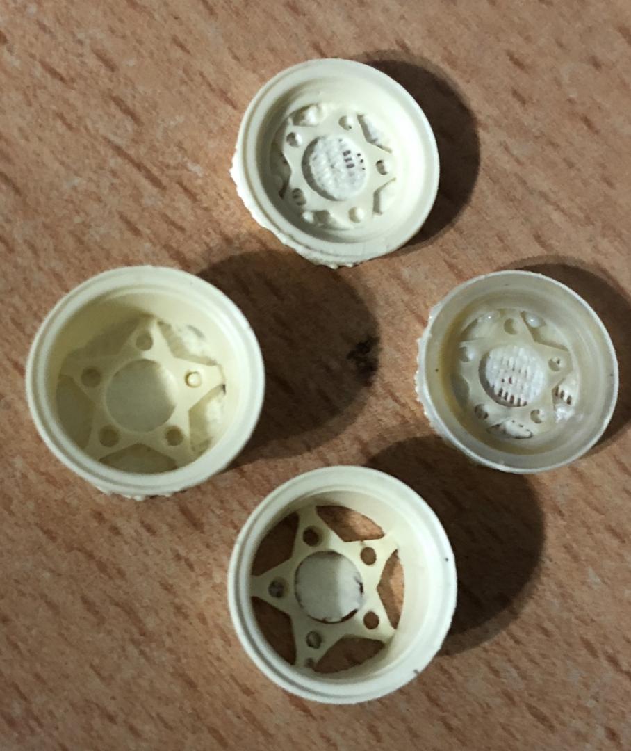

Been in a little bit of a standstill while sourcing the tires that more or less replicate  The original Sand Scorcher. Front tires are from a AMT deora kit With two thick styrene sheets sandwiched between the tire halves and shaped with Tamiya putty to get the correct tire width. While waiting for the putty to cure, I just wanted to see a Mock up of the wheels and tires sitting next to the body. Once I modify the suspension, it should be ready for paint

On 3/2/2019 at 10:12 PM, Evlwevl said:
[...] Interestingly it does not have cylinder tin which leaves the cylinders exposed which might look good for a drag car but not practical for a Baja bug. [...]
Is that because of sand getting thrown around?  What about making a vacuum-formed shroud?
Share this post
Link to post
The cylinder tin provides a sealed cooling path For the air so they direct air around the cylinders and cools them with air provided from the fan. It turns out that I have a parts kit from Tamiya that uses those same cylinder tins for this engine
