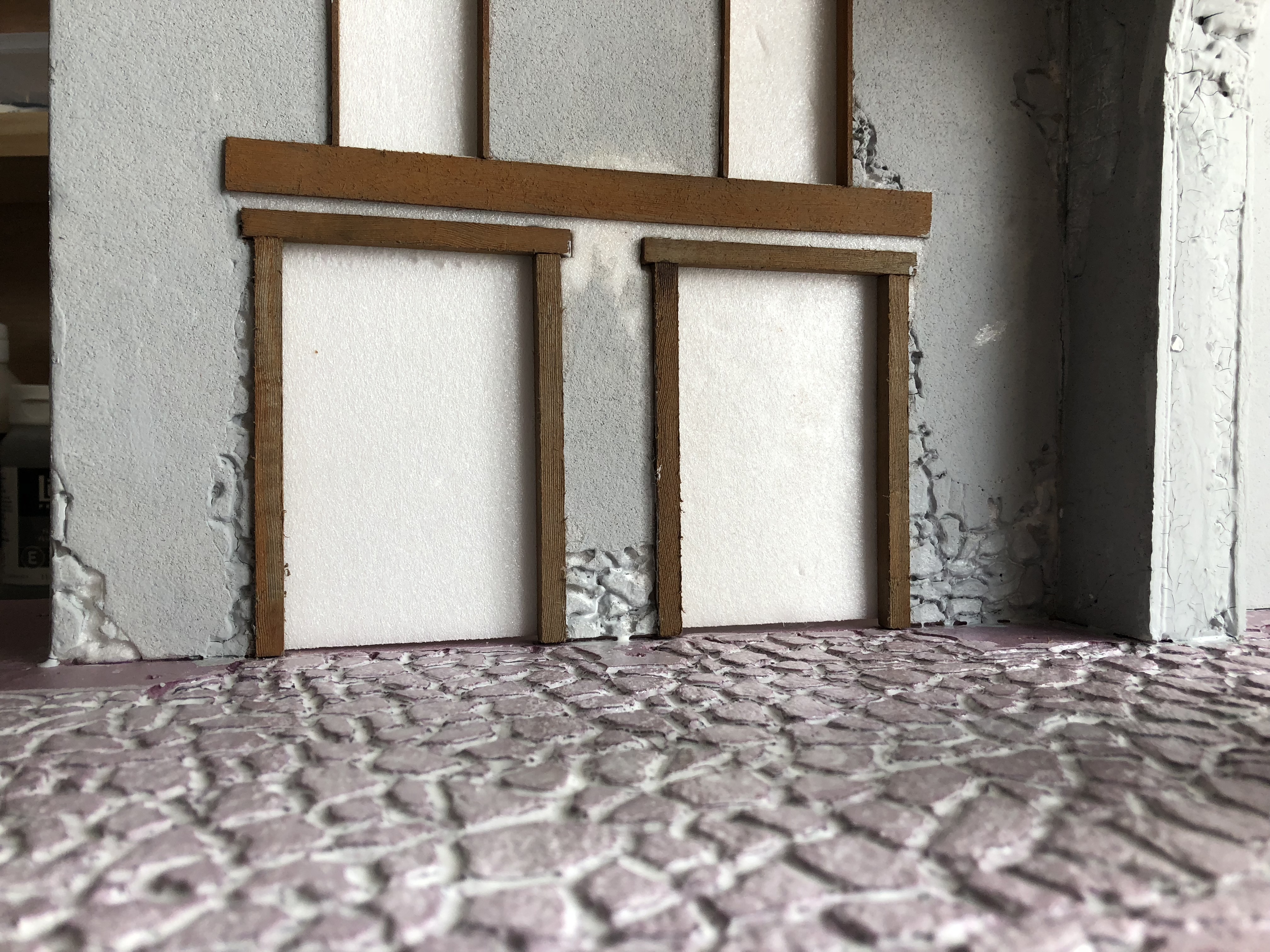

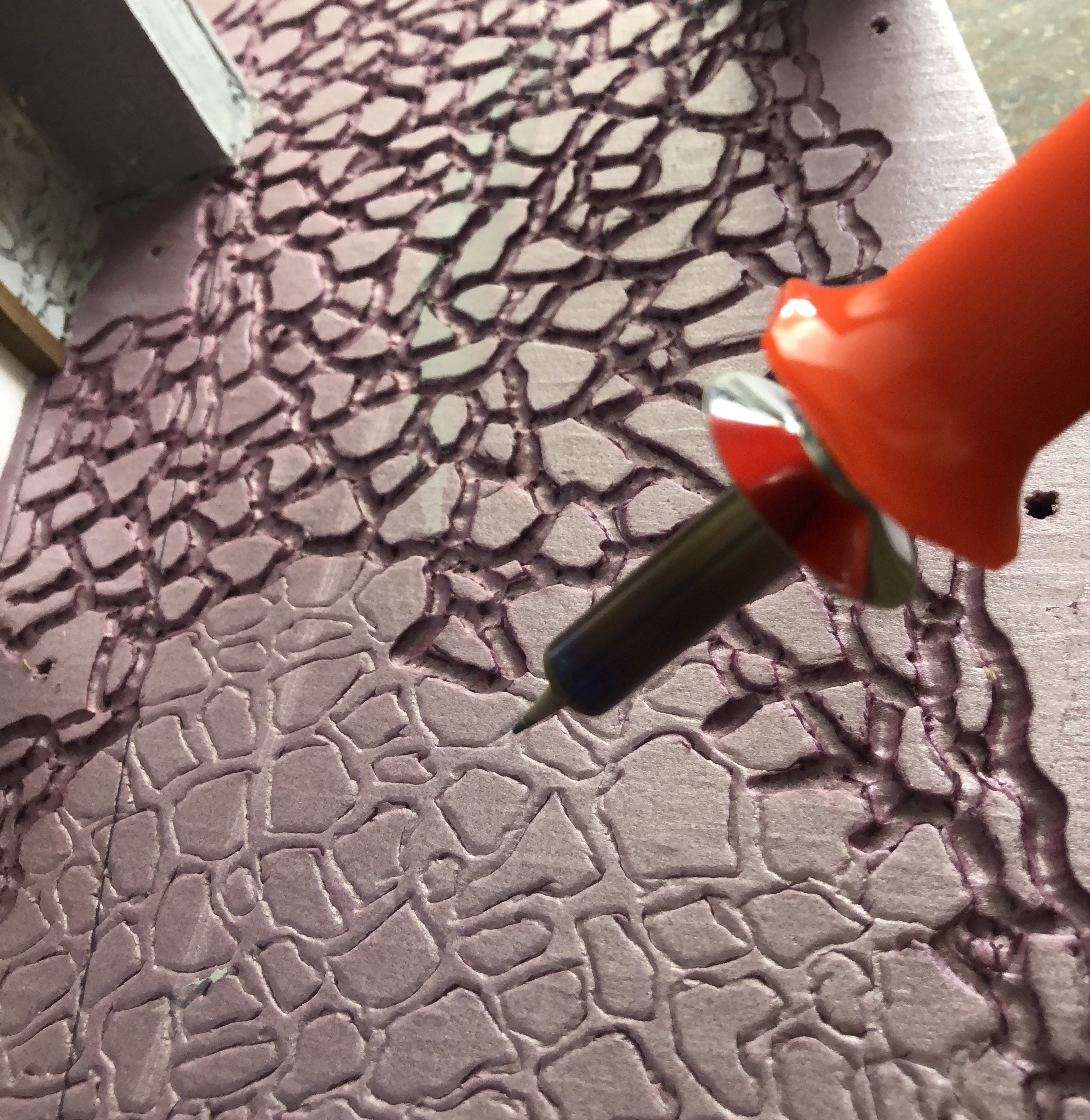

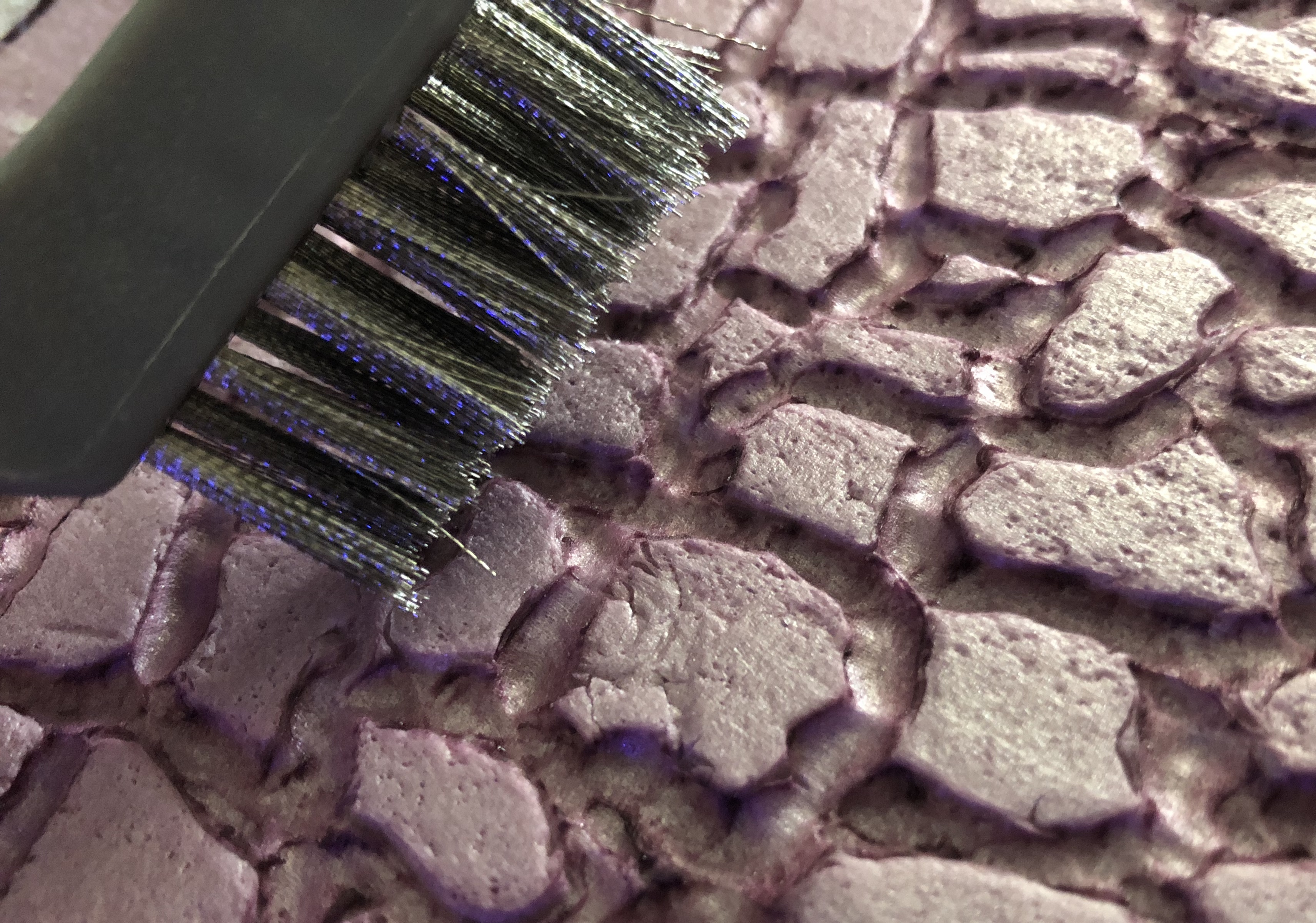

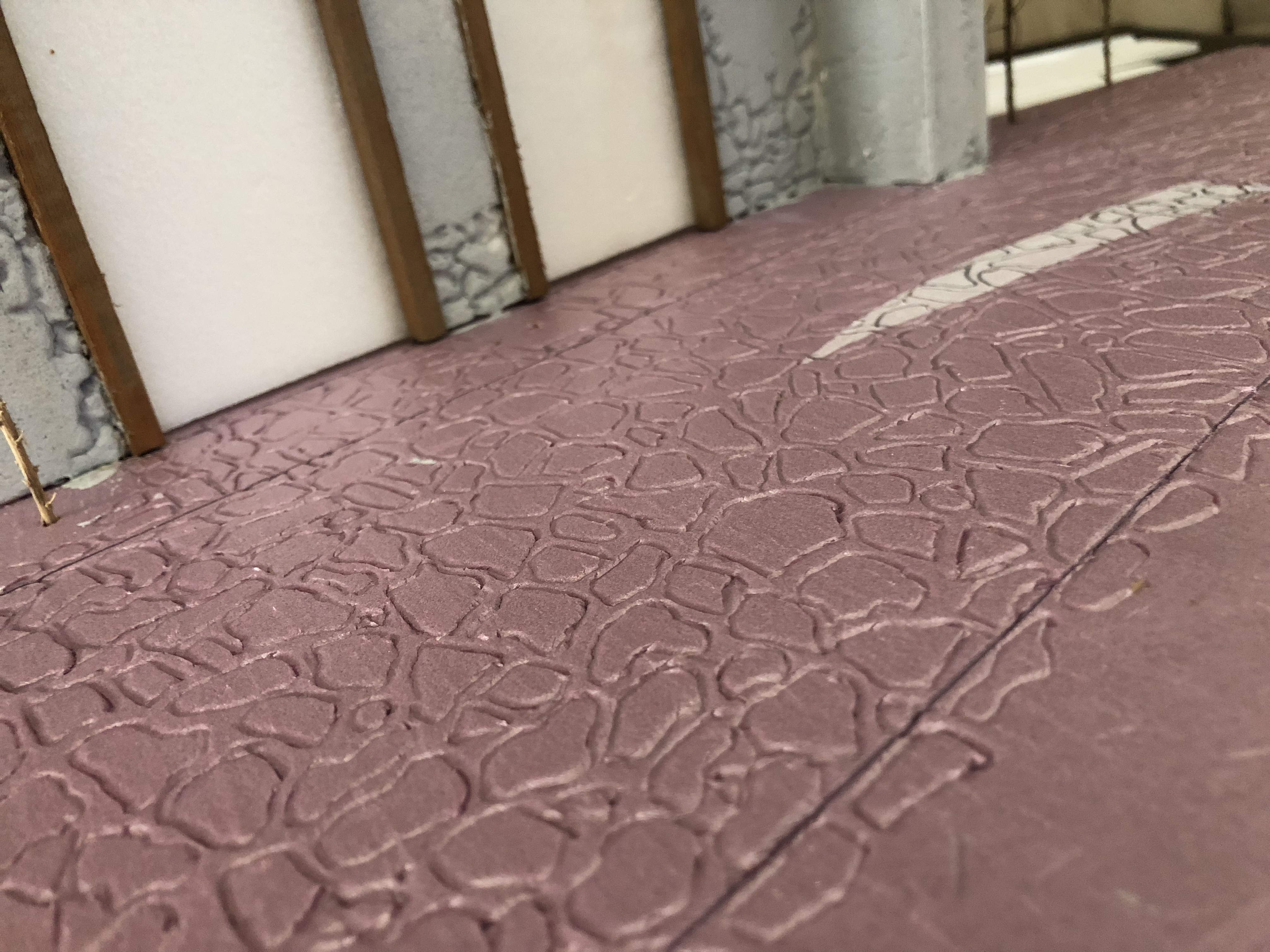

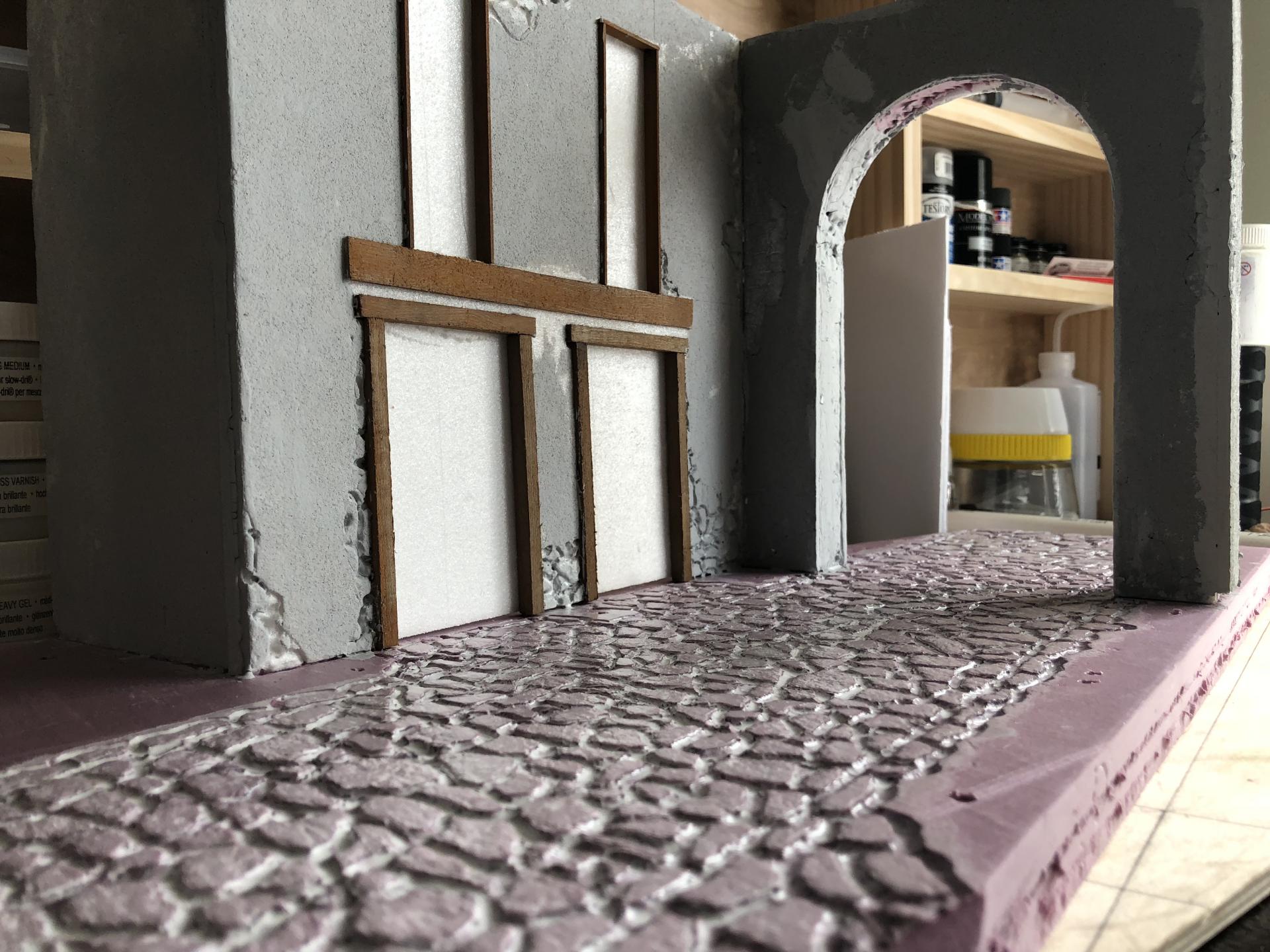

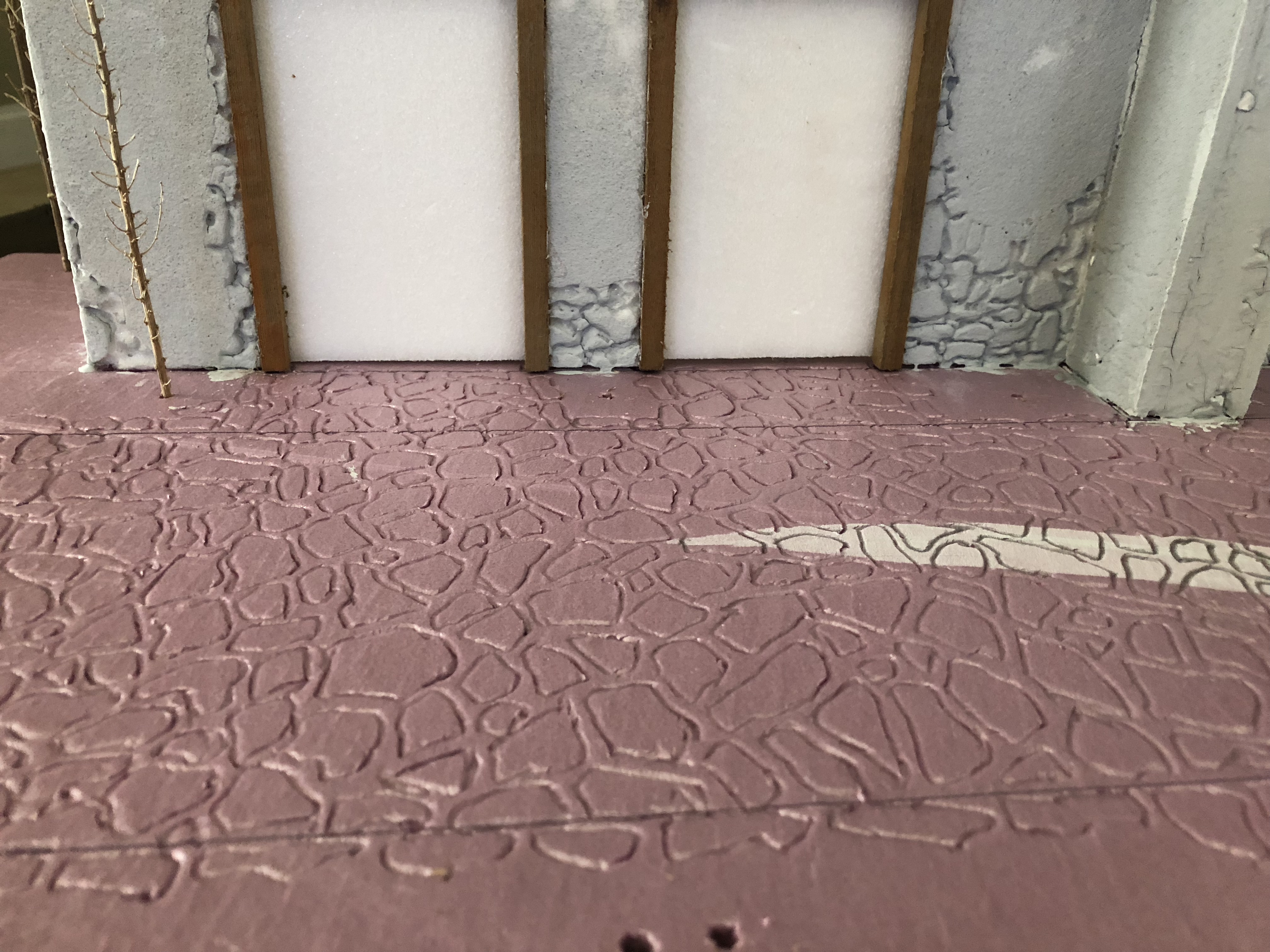

Yes. I drew them with a pencil. Then I went over the lines with a soldering iron. I’m testing this out to see what comes out of: white acrylic gesso with gray acrylic tint to resemble stucco. I will be adding different layers with different shades. Then, I might paint the stucco wand used a chipping and worn out technique to fade the paint. We’ll see what happens then.

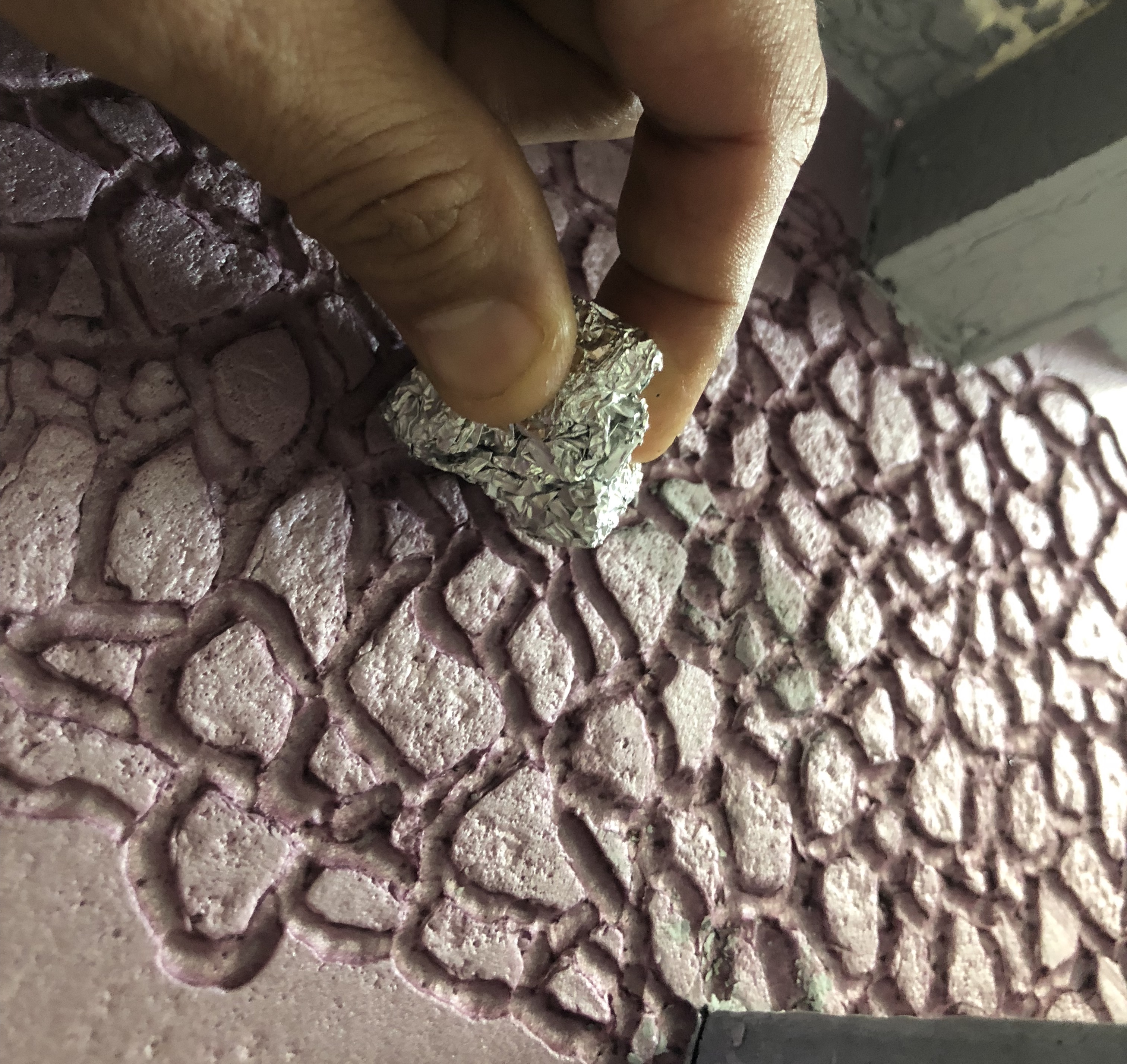

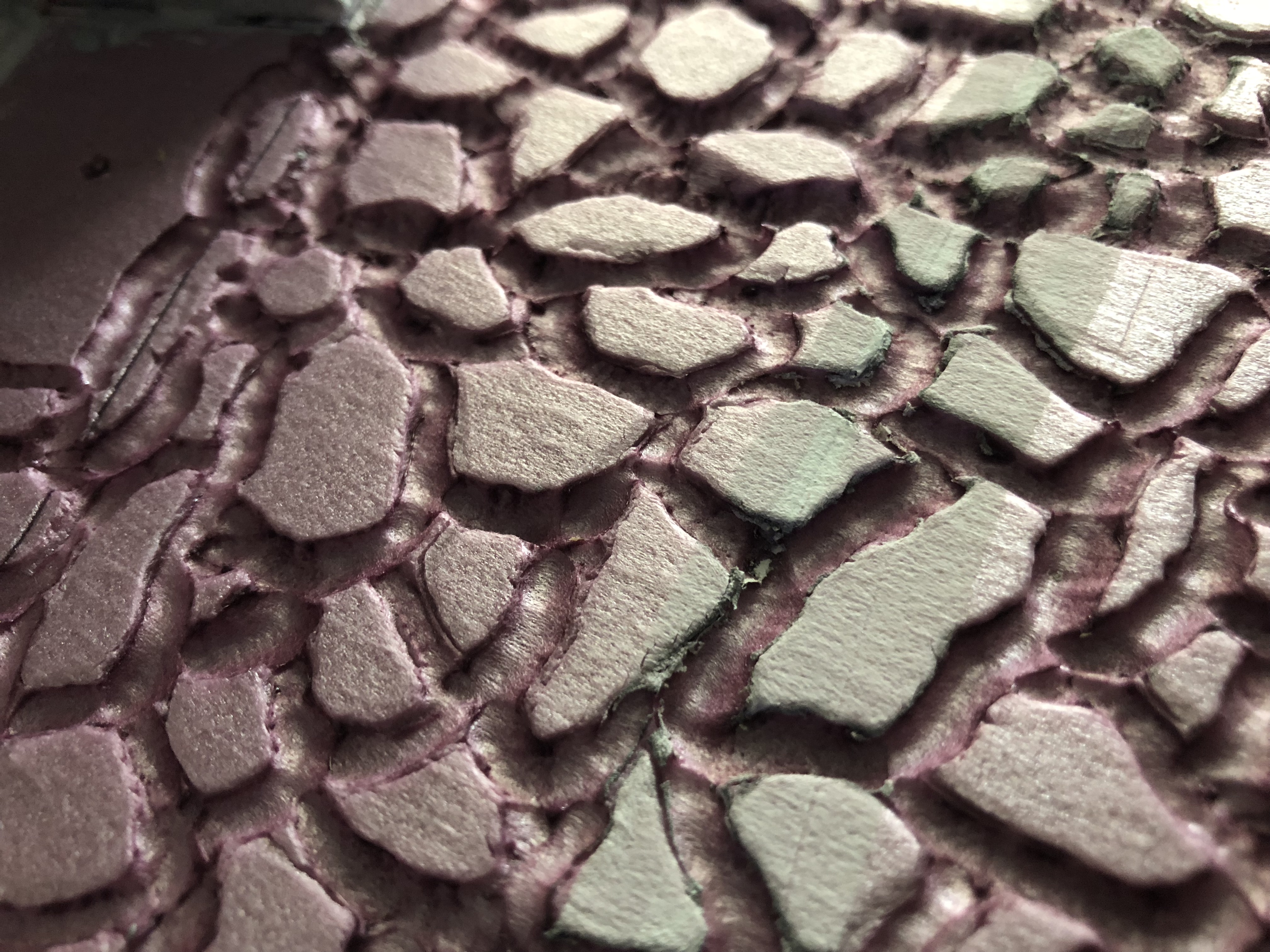

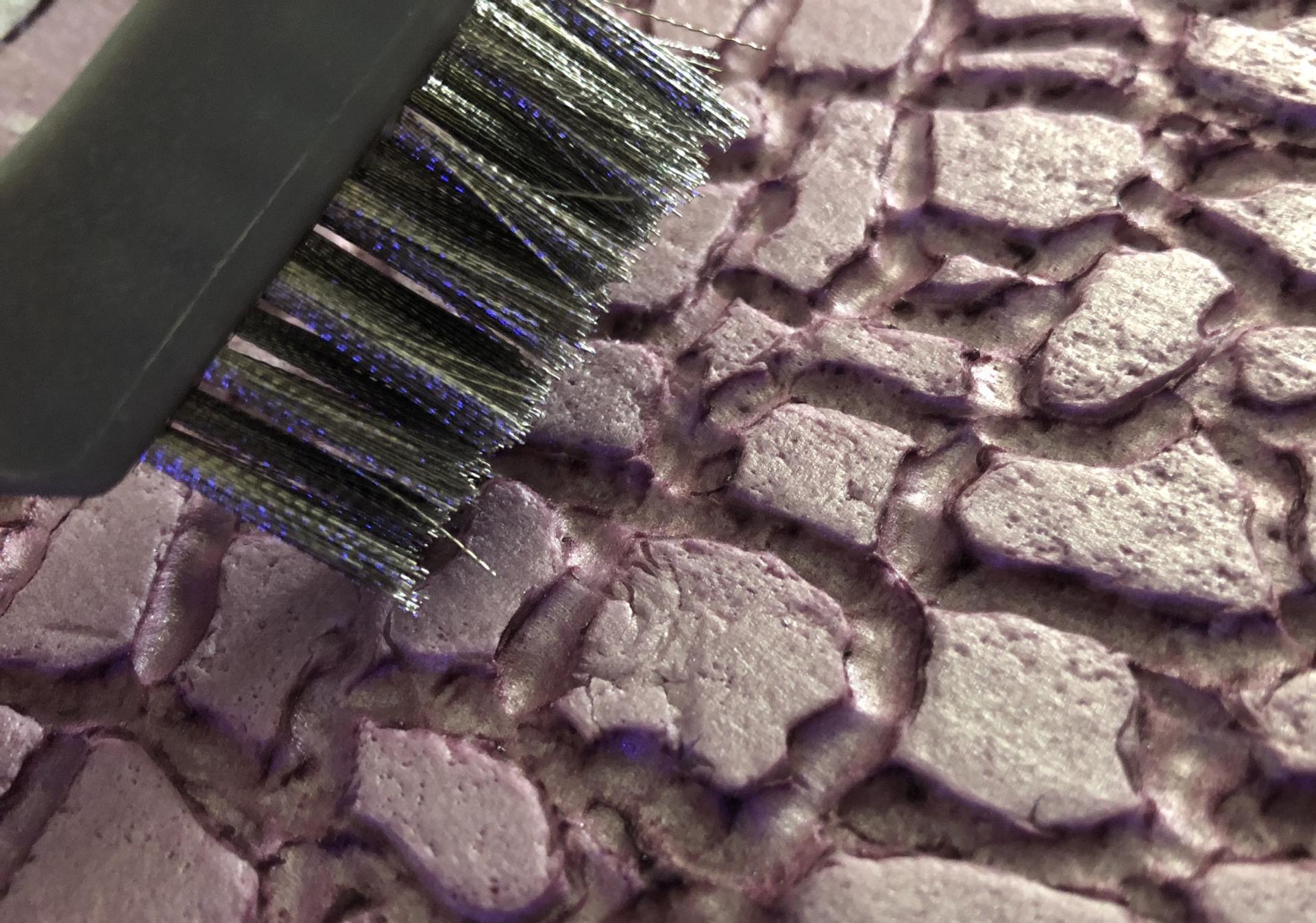

I drew the flagstones on the insulation board with a pencil. Then I traced over the drawing with a hot soldering iron. Then tapped over with steel brush and aluminum foil crushed in a ball.

Thank you. I have seen this application on other stuff, so I figured I would use it this way. I like the results so far. It gives random patterns similar to organic materials such as stones.

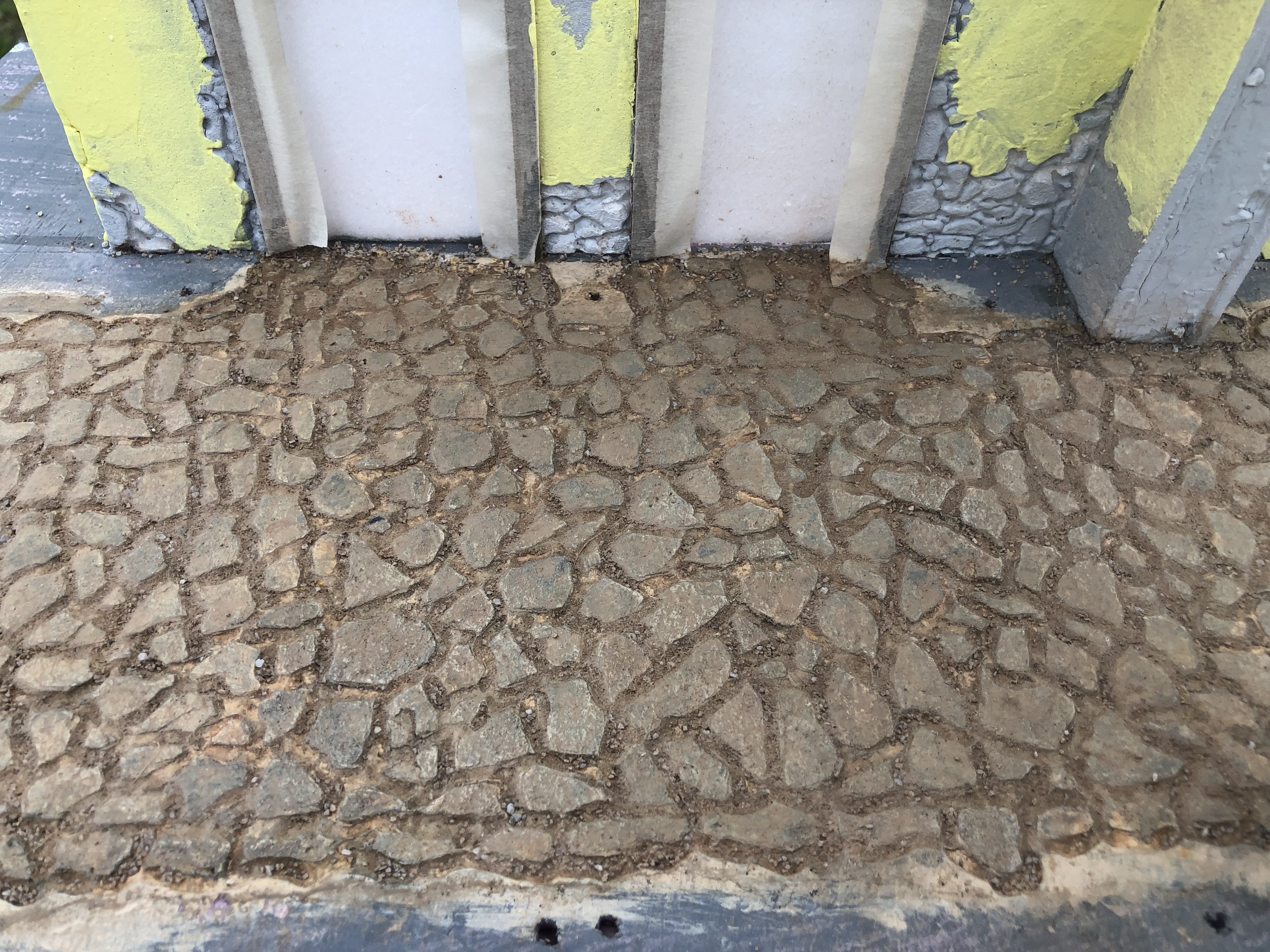

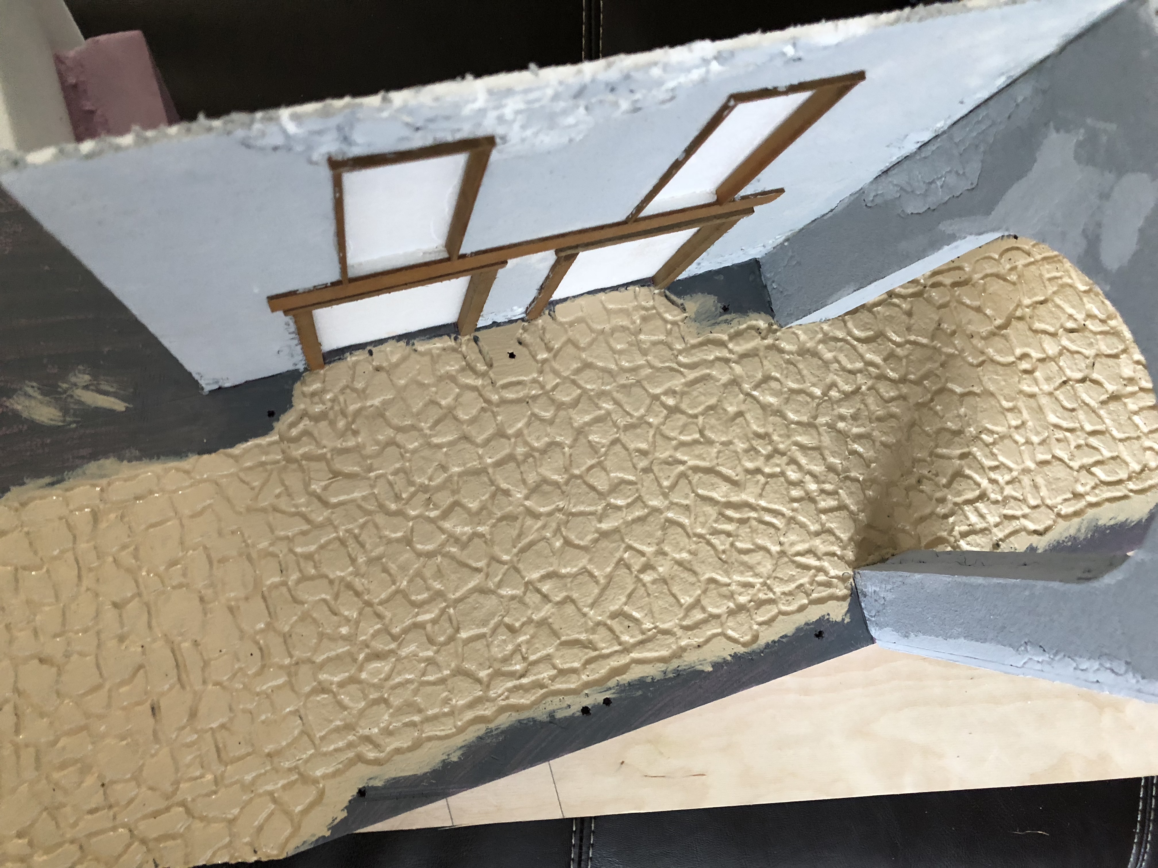

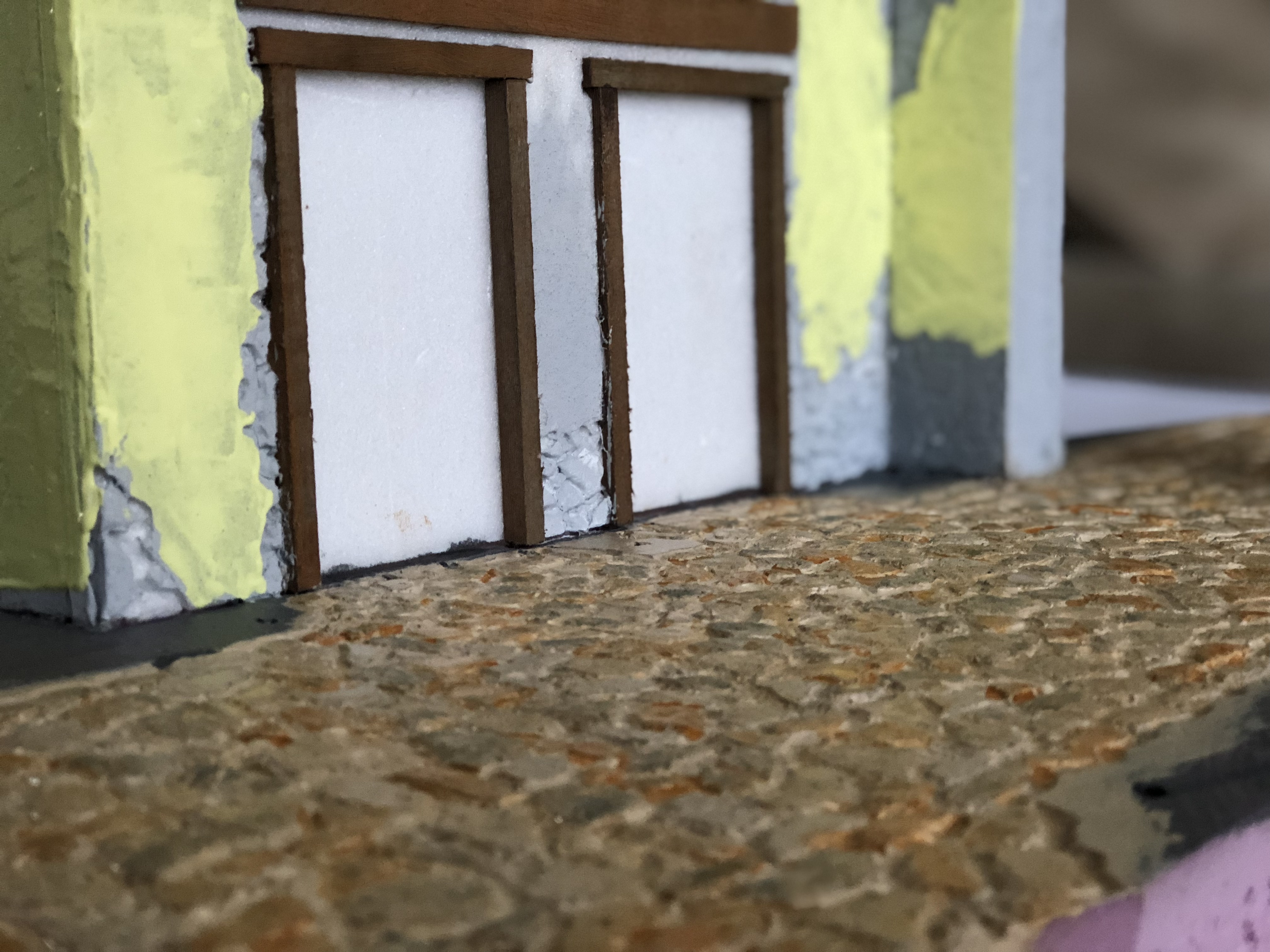

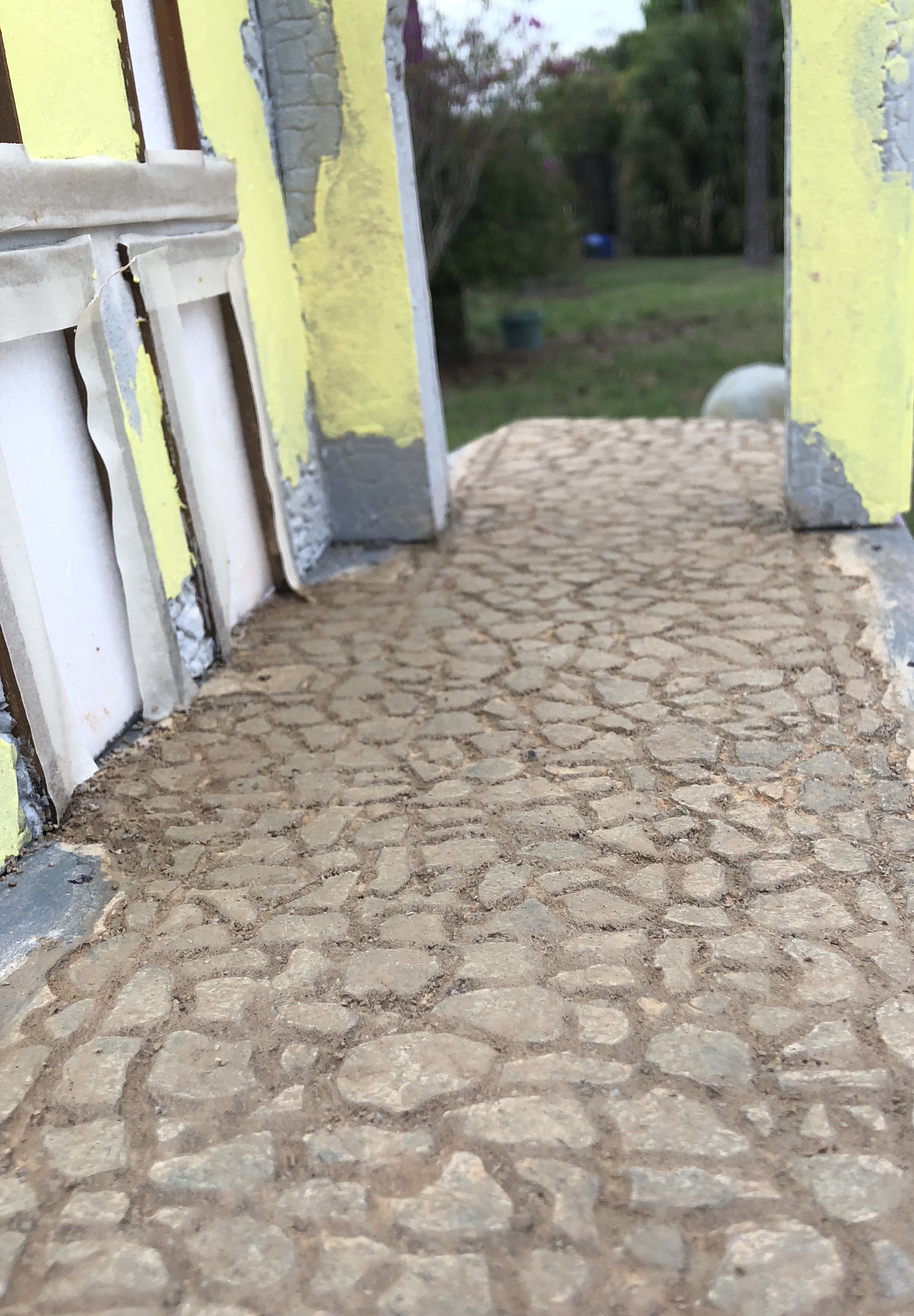

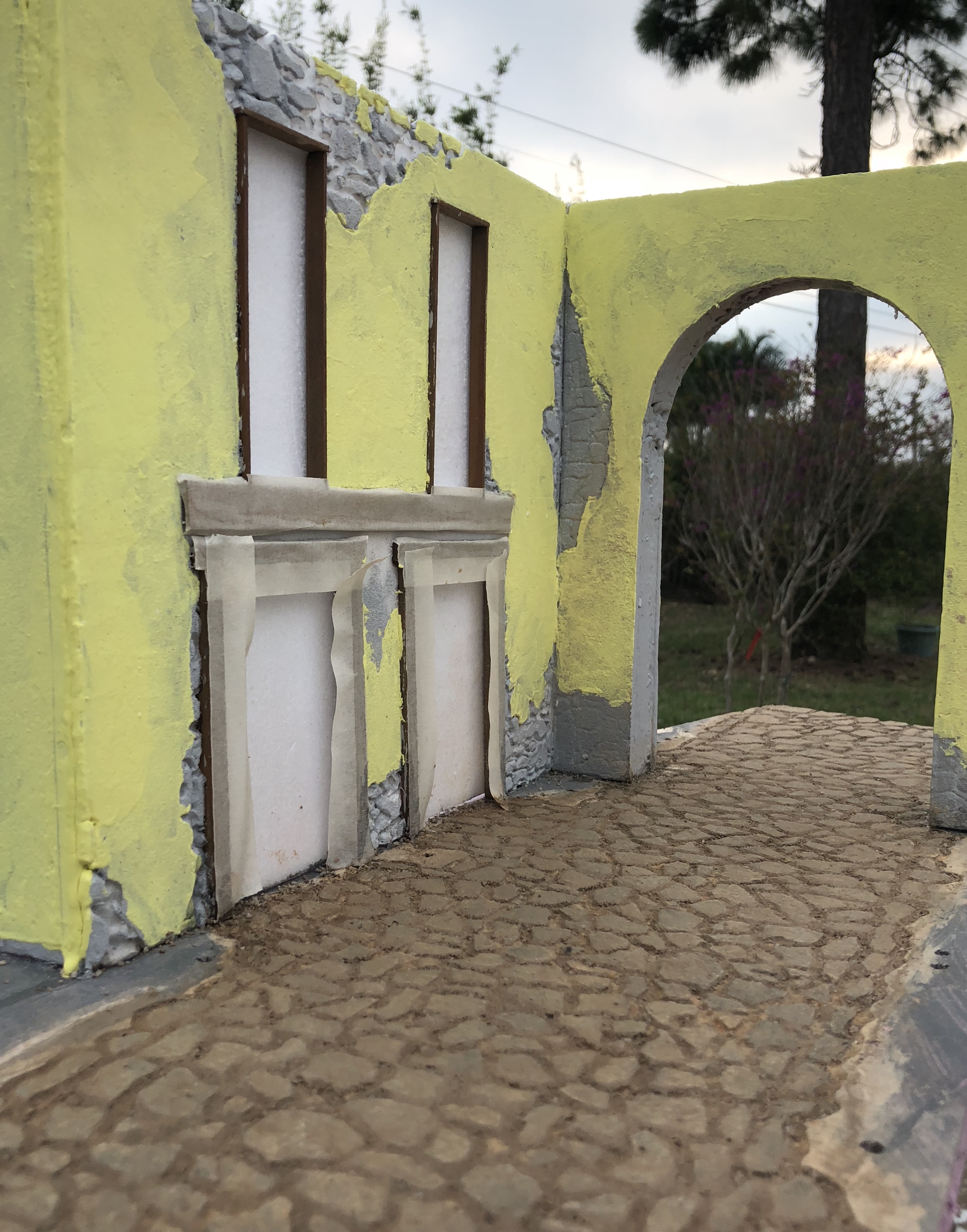

First layers of paint applied to the flagstones and building wall. I painted stones in this order:
1- Dark gray color over all.
2- Tan color as second layer.
3- While second layer was half wet I painted rusty wash color over random stones. Then changed to a darker rusty wash color over random stones. This way the paint blended in different ways.
I will then add more washes and dirt to the joints as well as random spots of grass growing around the stones.
Edited by QbanFam
Share this post
Link to post

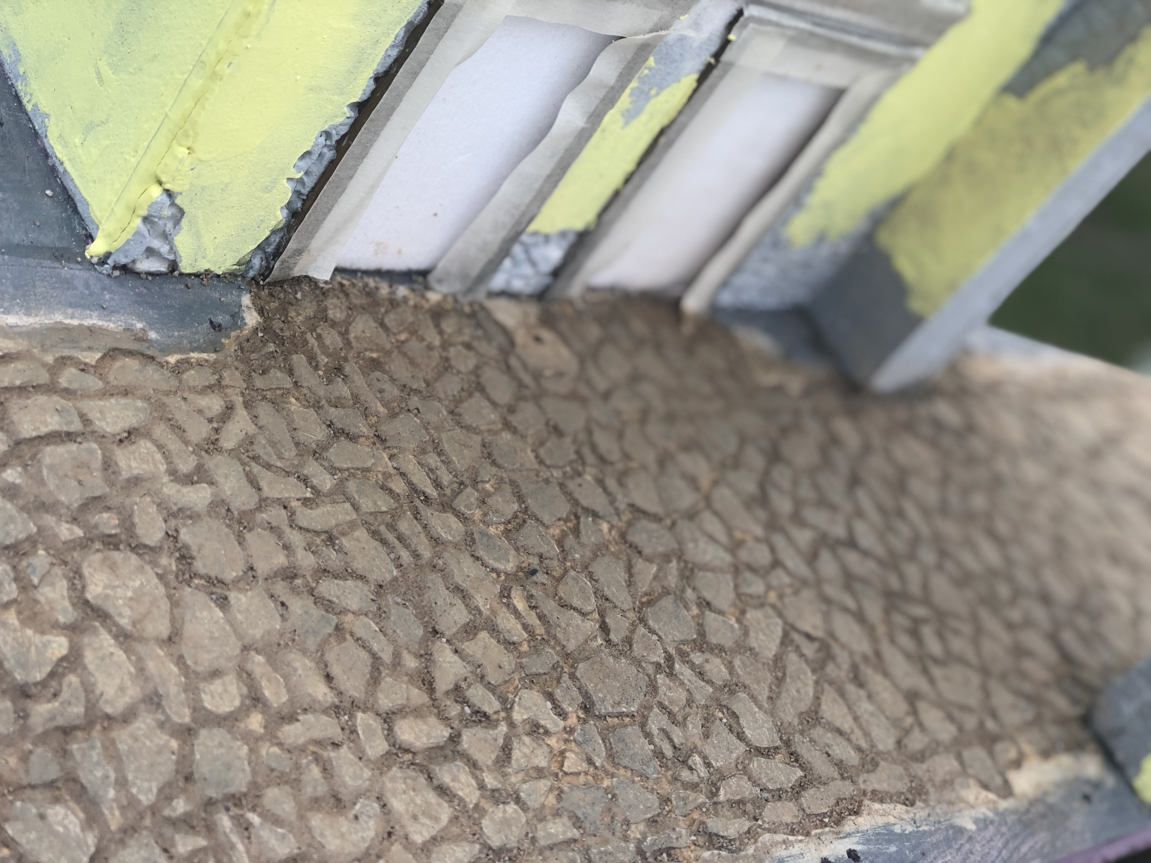

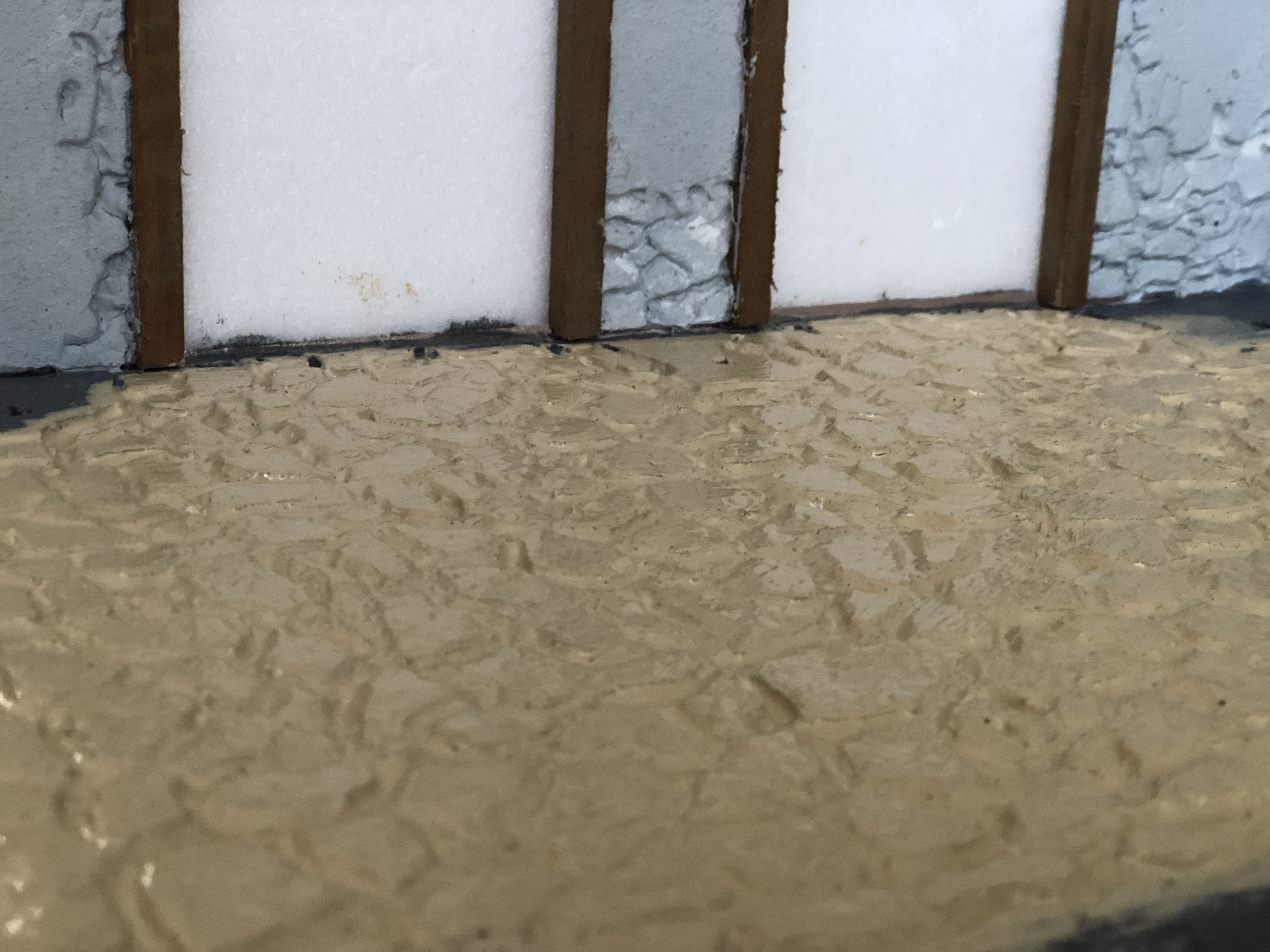

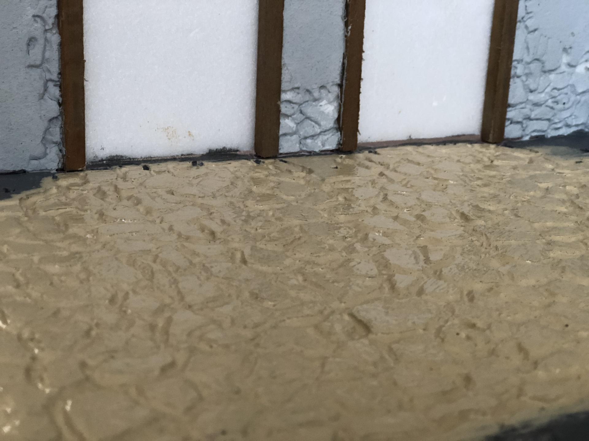

Another layer on the flagstones.
1- Black ink wash.
2- Raw Umber ink wash.
3- Layer of sand color grout, mixed with two grades of gravel, for the spaces.
4- Another black ink wash.
...to be continued.

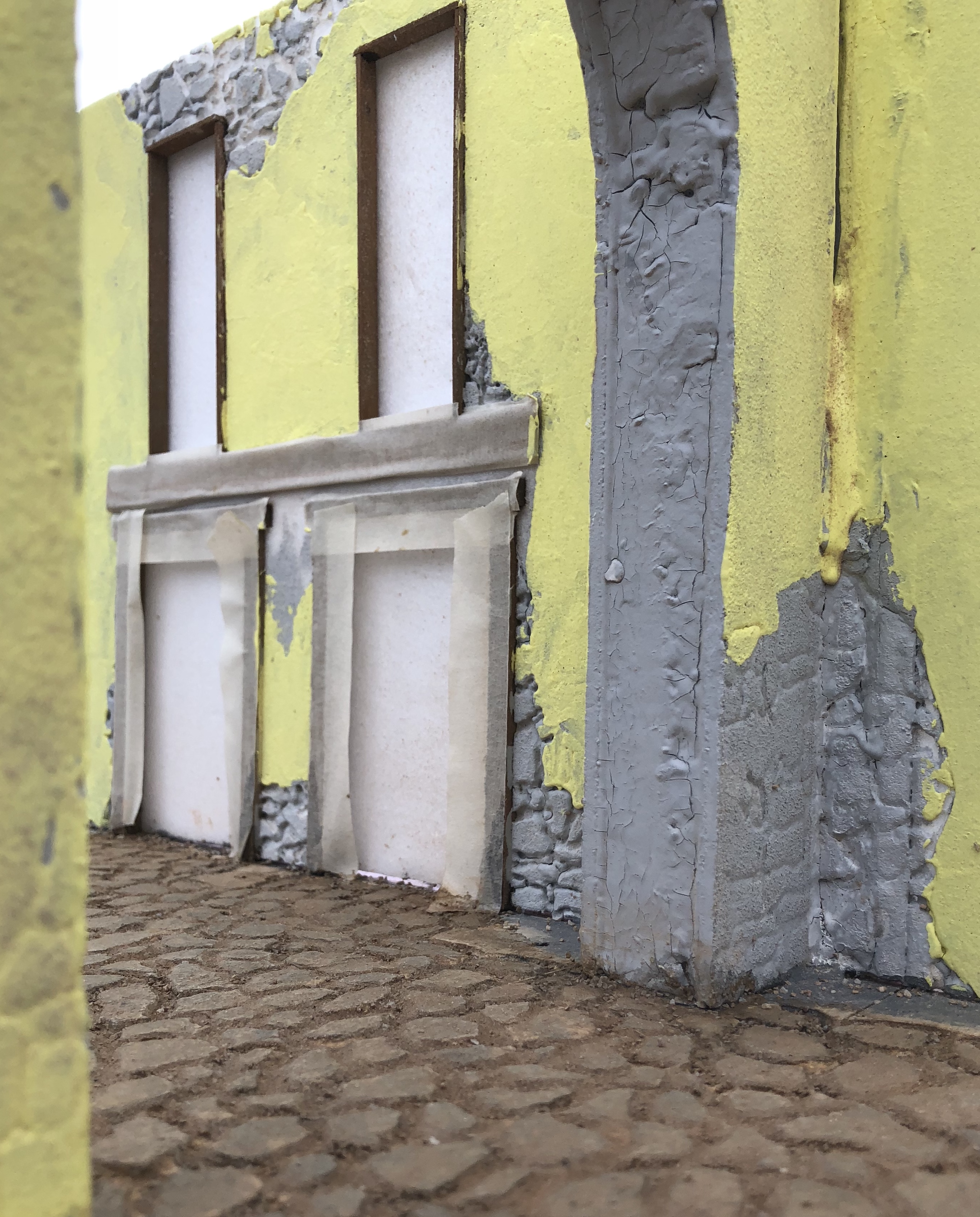

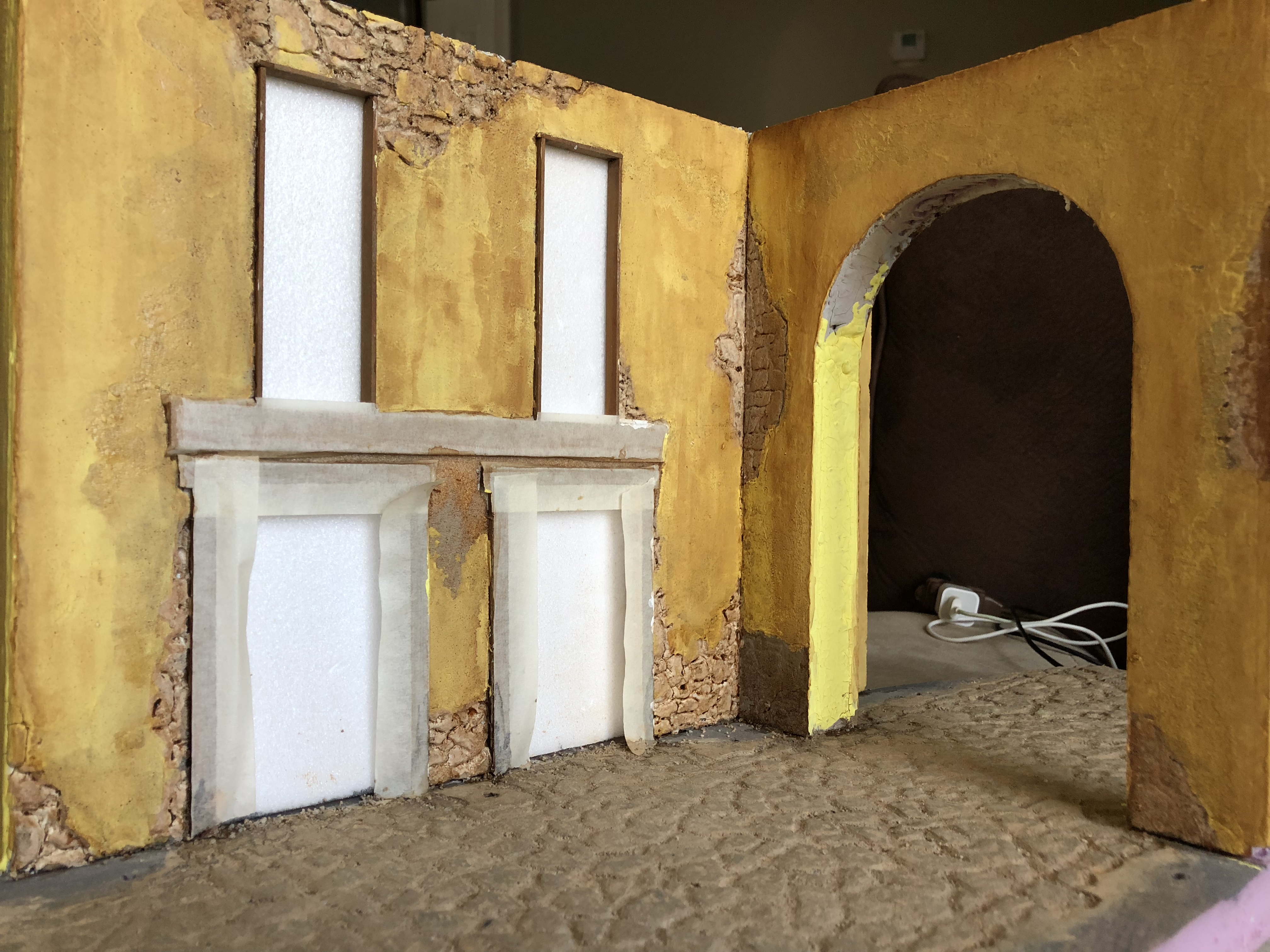

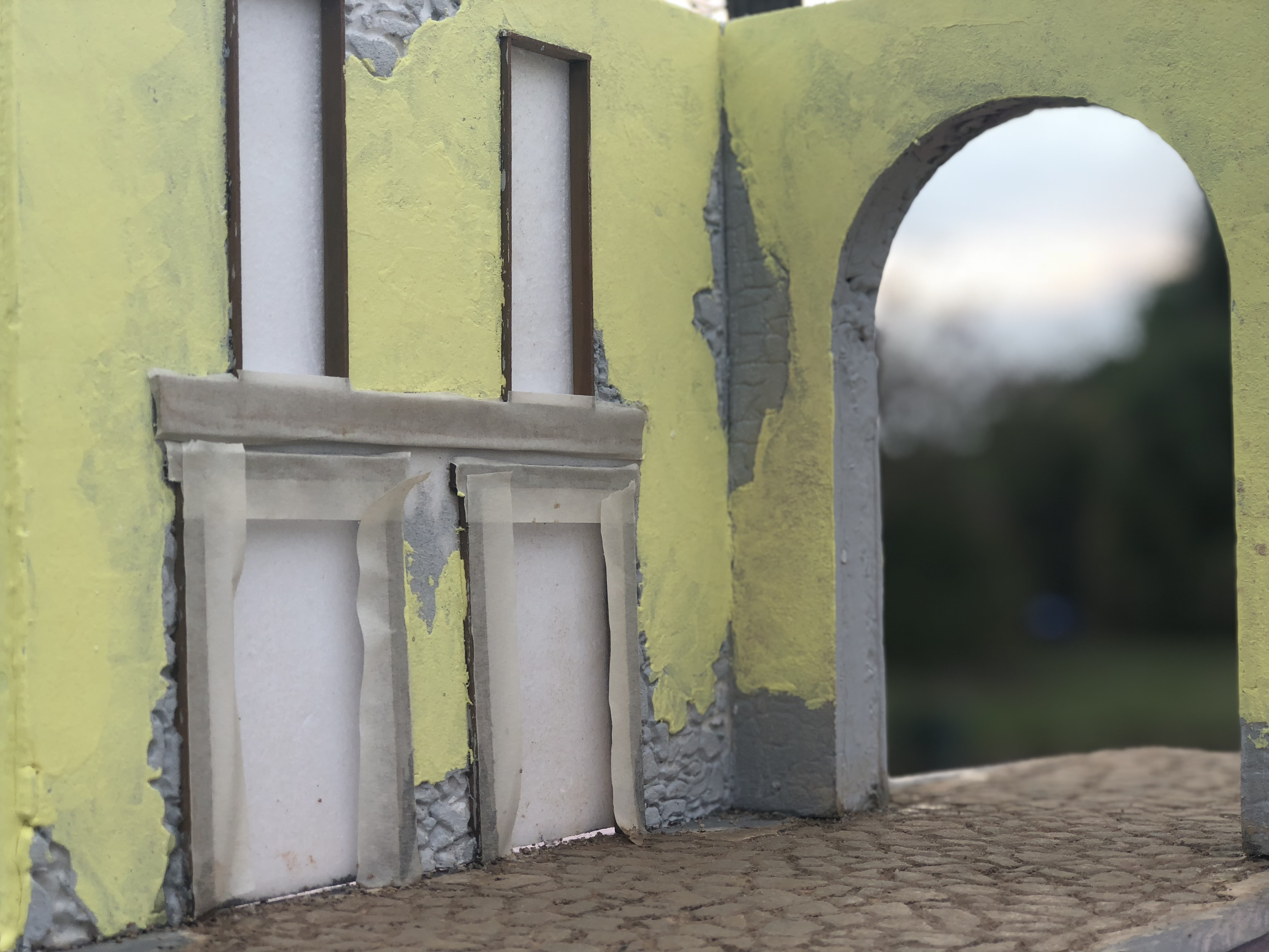

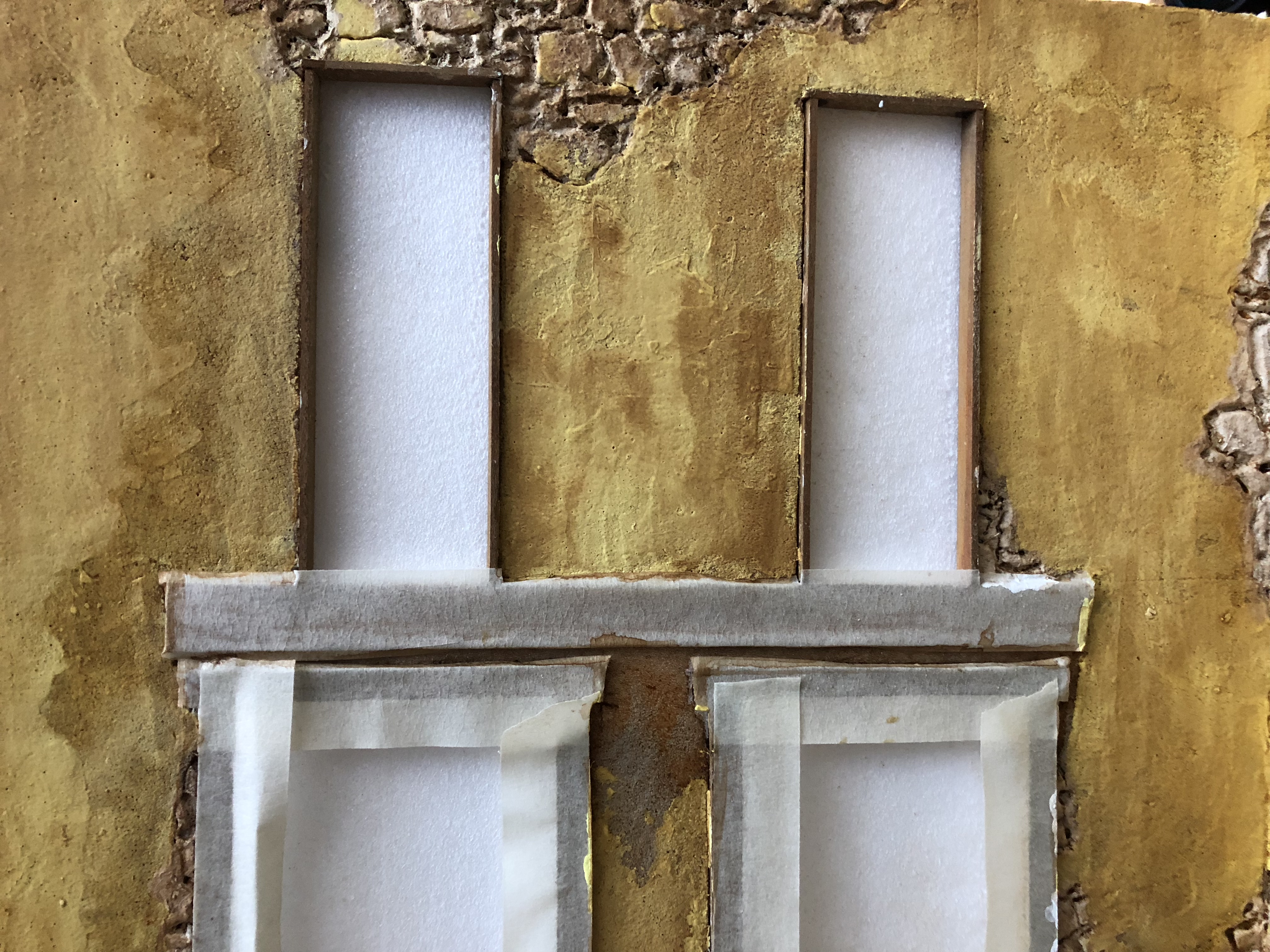

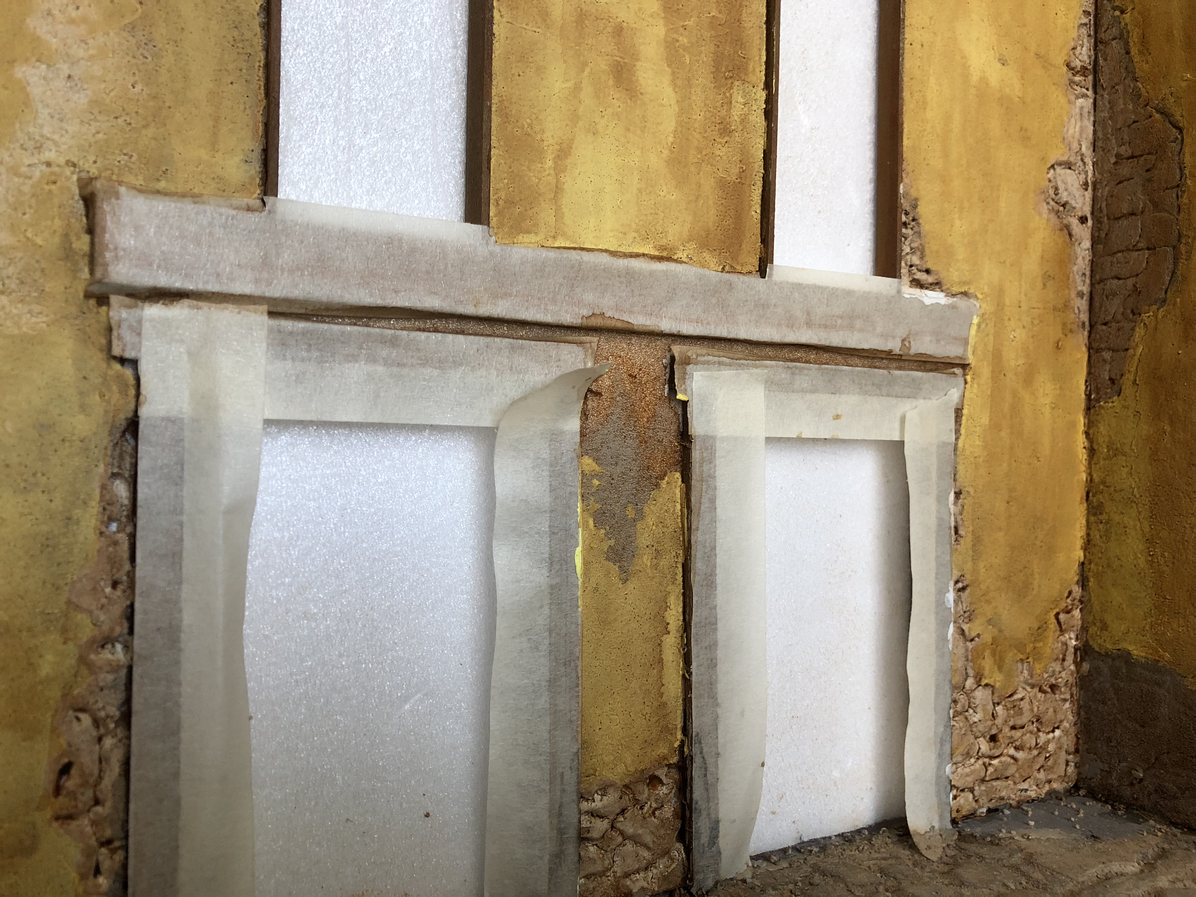

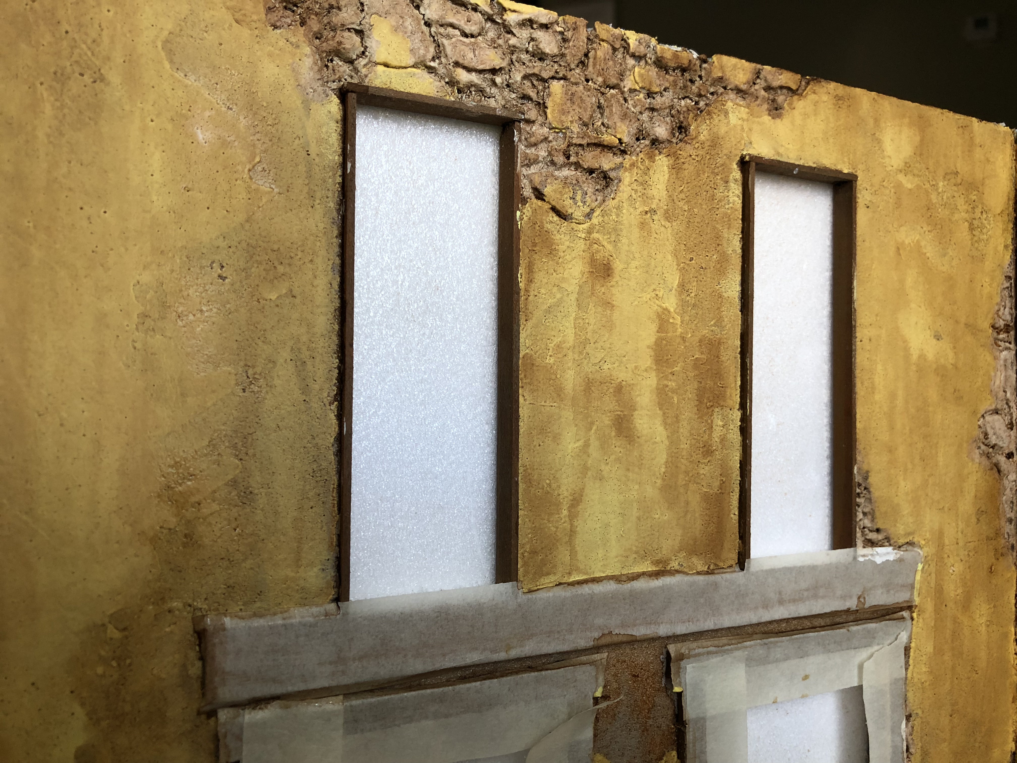

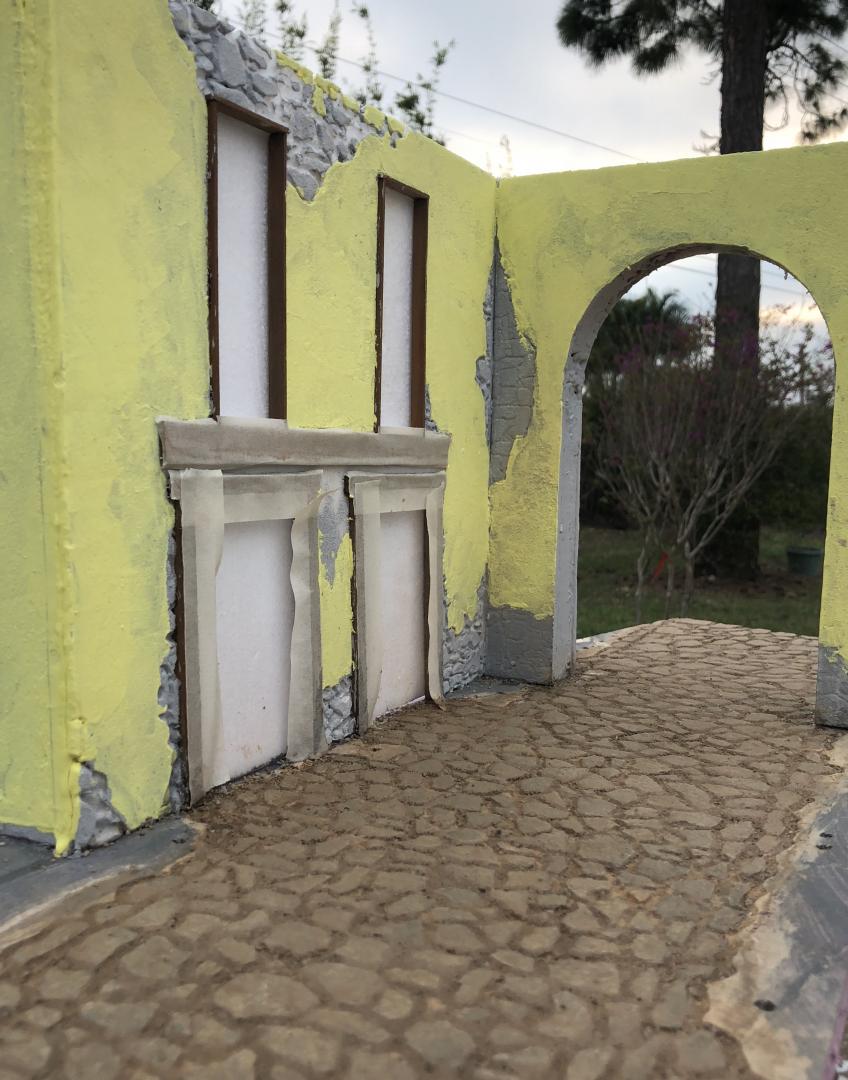

Began working on the building walls. This is what I have done so far:
(Note: the next layers will be applied with a small artist spatula.)
1- Applied one layer of acrylic gesso, mixed with a small amount of black acrylic ink to get a gray color.
2- Once the first layer is dried I mixed more acrylic gesso with yellow acrylic ink and applied over the wall randomly and in different directions. I’m going for the Spanish Stuccy pattern (it might be called differently in other regions of the world).
3- I repeated step two, once the previous layer was dried.
No with a brush:
1- I diluted transparent burnt umber acrylic ink in water and applied a wash.
2- I repeated step one until desire color effect (It took me 4 layers).
to be continued...

I think it is a good idea to use white acrylic gesso as a base for other colours that you decide to add later, because the gesso lays down the textured surface. Also, you are mixing ink or acrylics with the gesso to achieve some interesting shades. Your stone work is highly realistic and these walls have a nice feel about them.

Thank you, David. I still need to apply more layers on the stone and add details to the wall. I might have mentioned this already but I think, to achieve more realistic textures, one has to apply multiple layers. Each layer might represent different things such as: base paint, peeling paint or stucco, grime, mildew, moss, etc. That’s just how it happens in real life and it’s my method of modeling dioramas. Don’t get me wrong, I struggle a lot trying to achieve this. Some day I will be able to do it with my eyes closed. Lol.

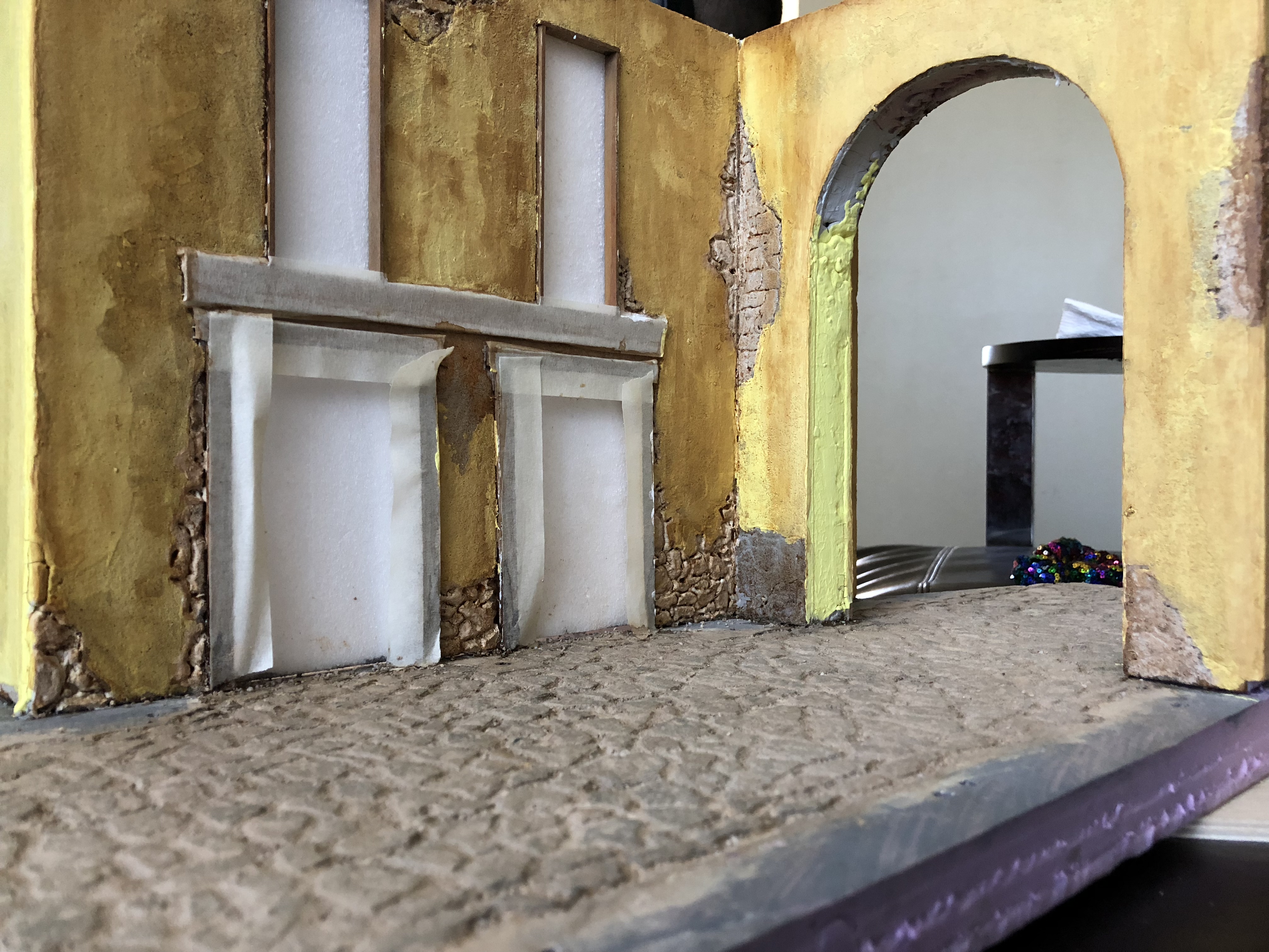

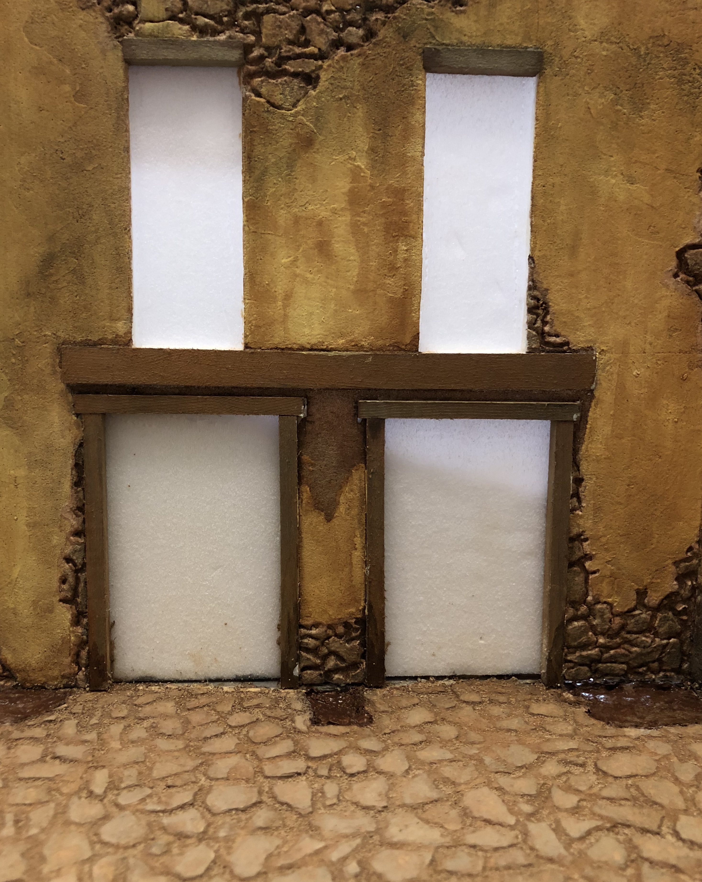

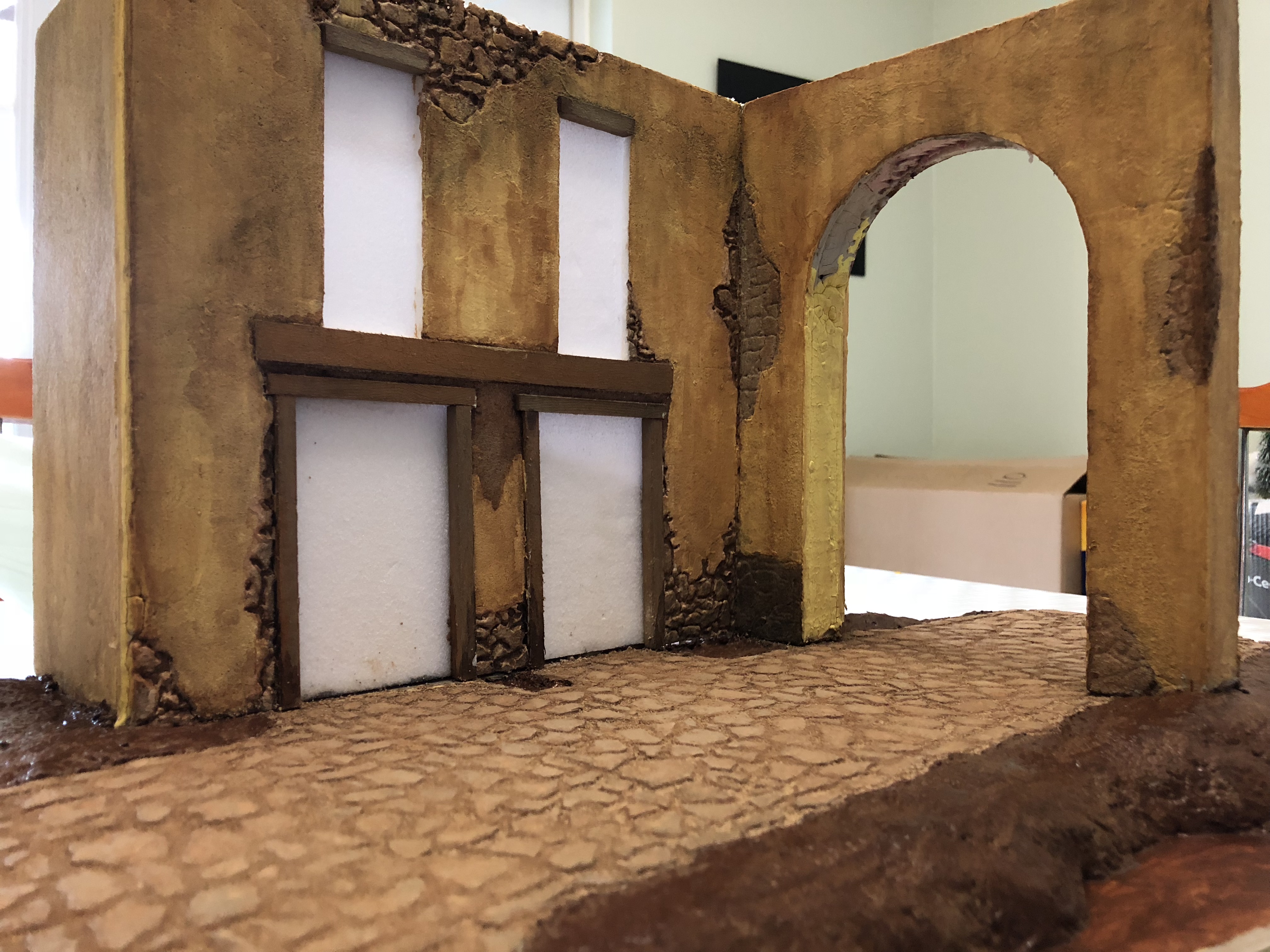

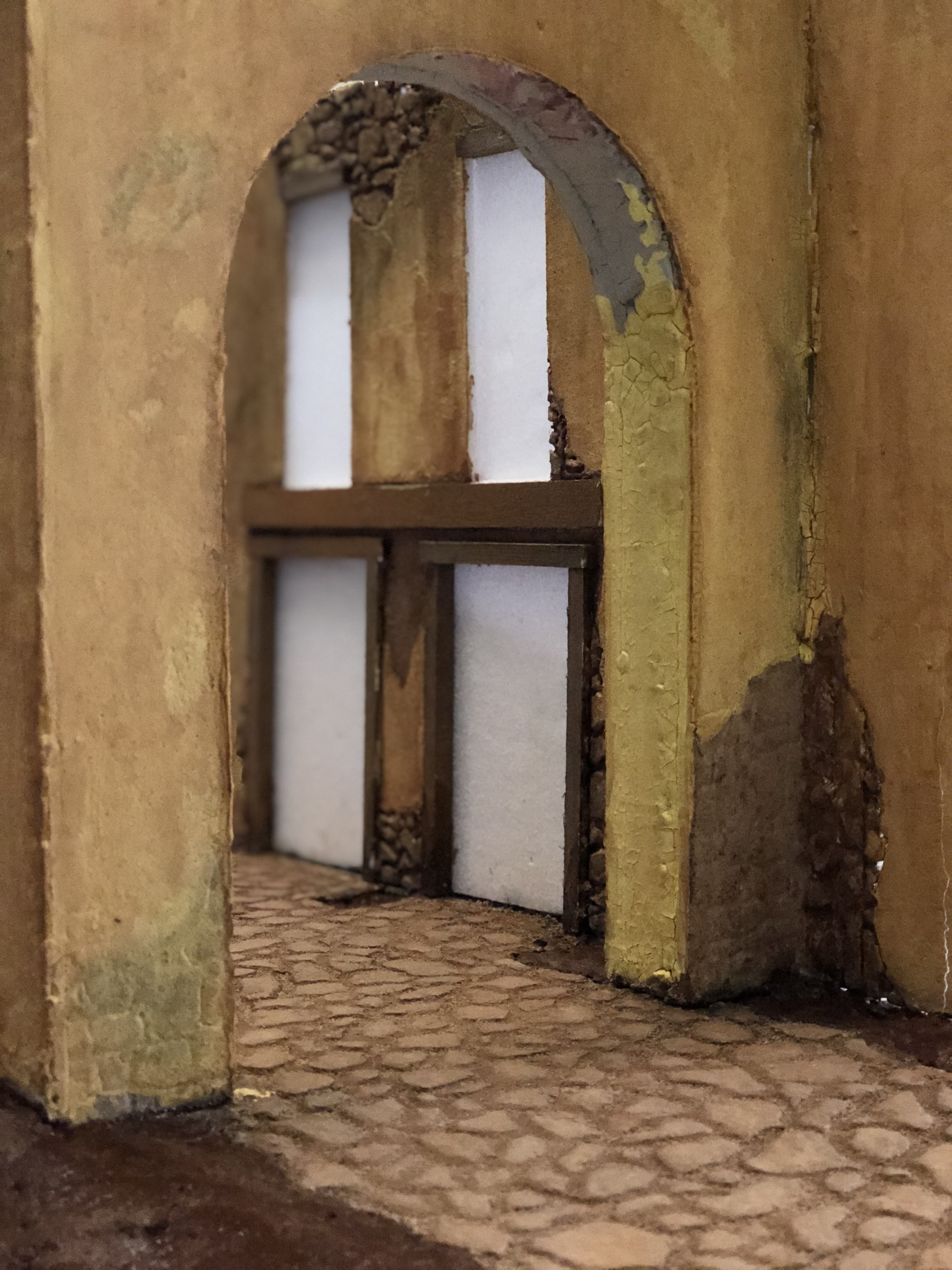

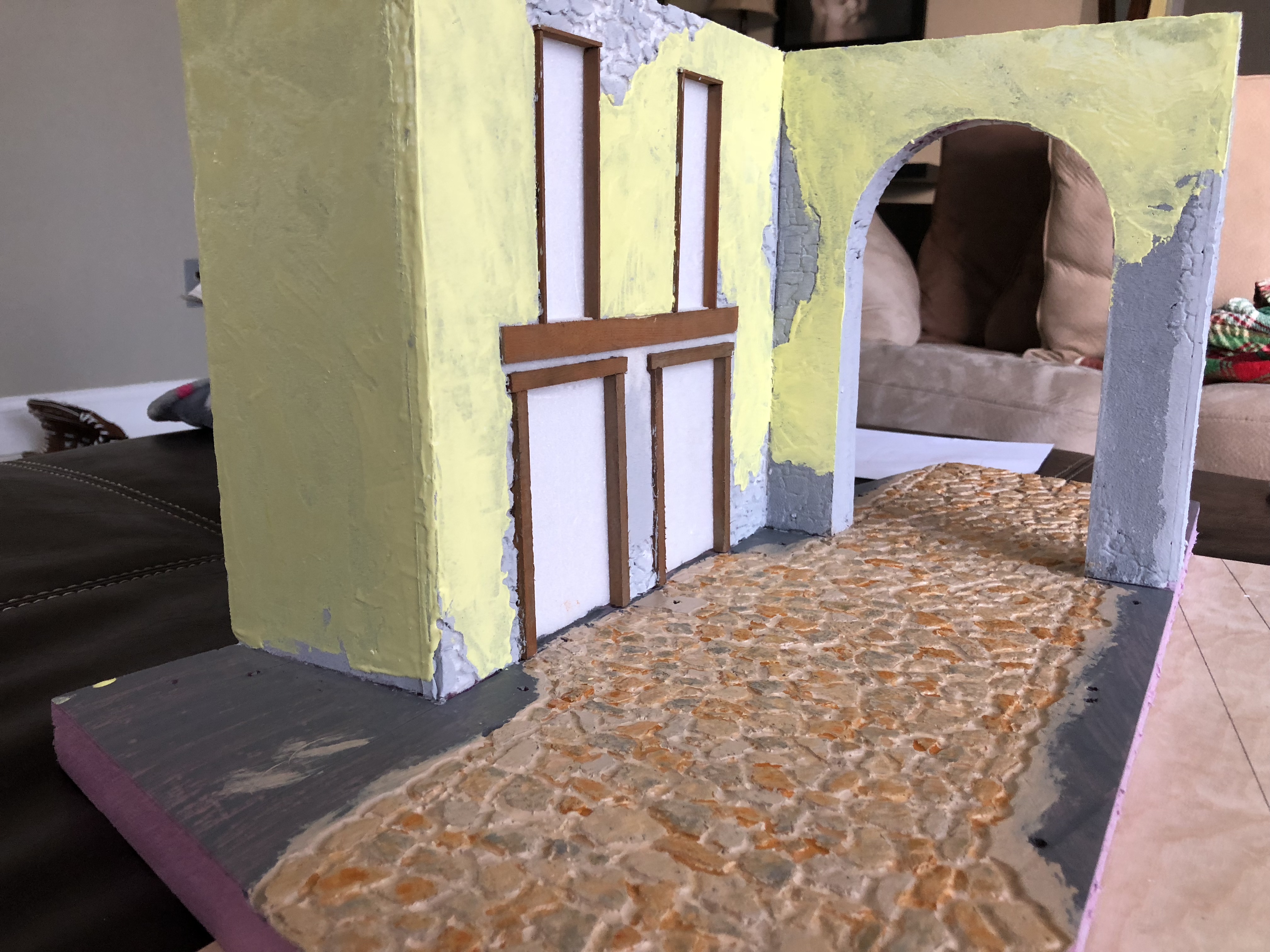

I added somw grime to the walls and added a bigger header to the top openings, which I will convert to windows. I filled up where the ground and grass will go and painted the under cover with burnt umber.
Share this post
Link to post

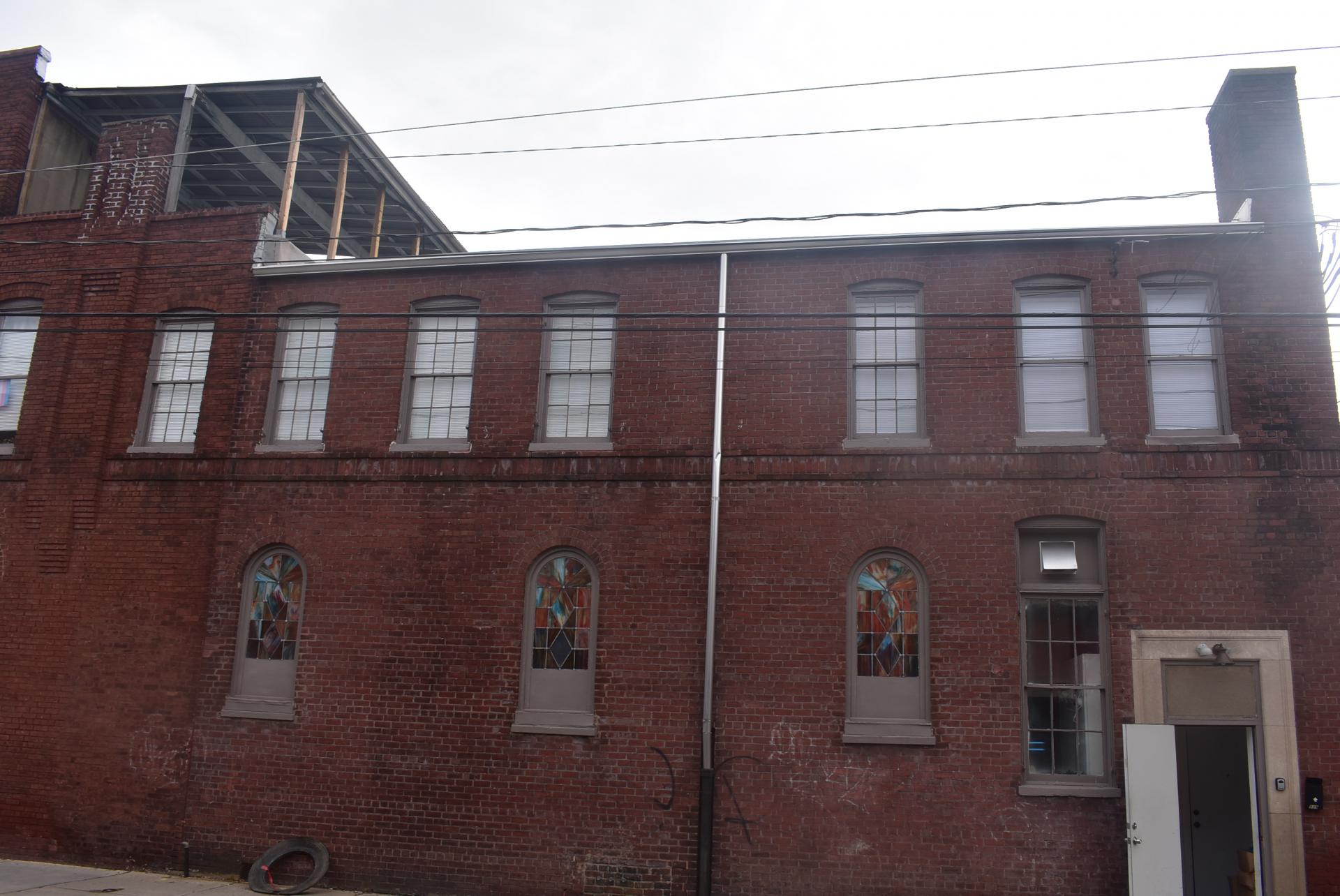

Yordan , it's wayyyyyy too late now , but in the future , when you are doing a "Rounded arch entryway , you MIGHT consider doing similar 30 degree arched window reveals I'f I'm i'm not making sense , look at the arched reveals on the second floor  for a clarification .
Share this post
Link to post
It makes sense. It would have been perfect match to the entrance arch. I have been trying to fix some things on this diorama. I feel like I should start over. For one, I accidentally dropped it and the building fell apart. I had to glue it back together and patch it.

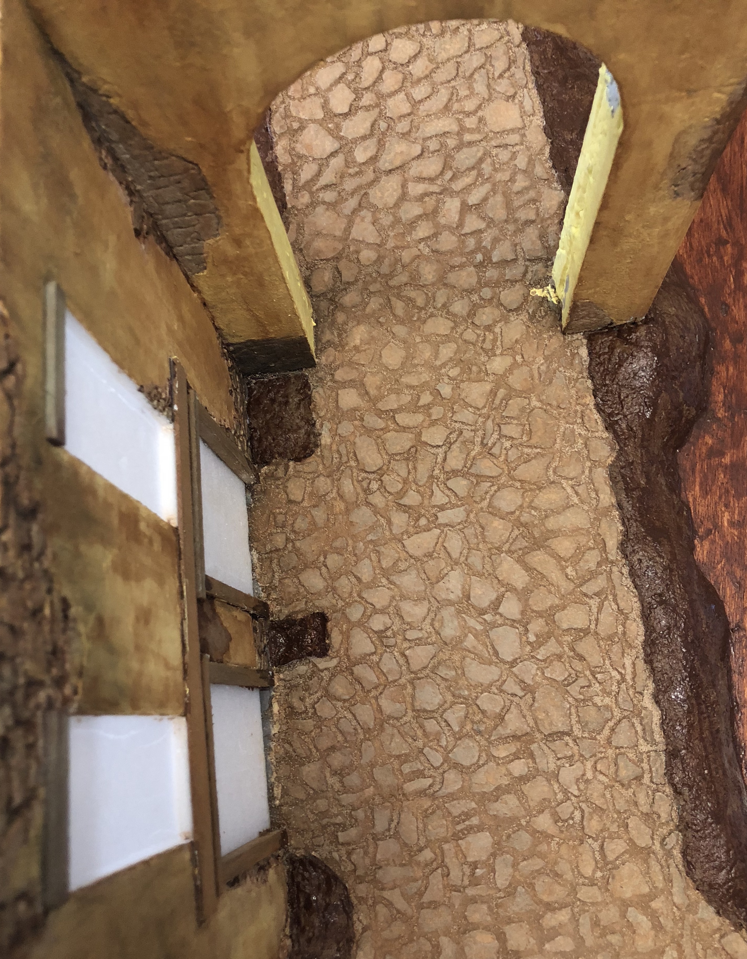

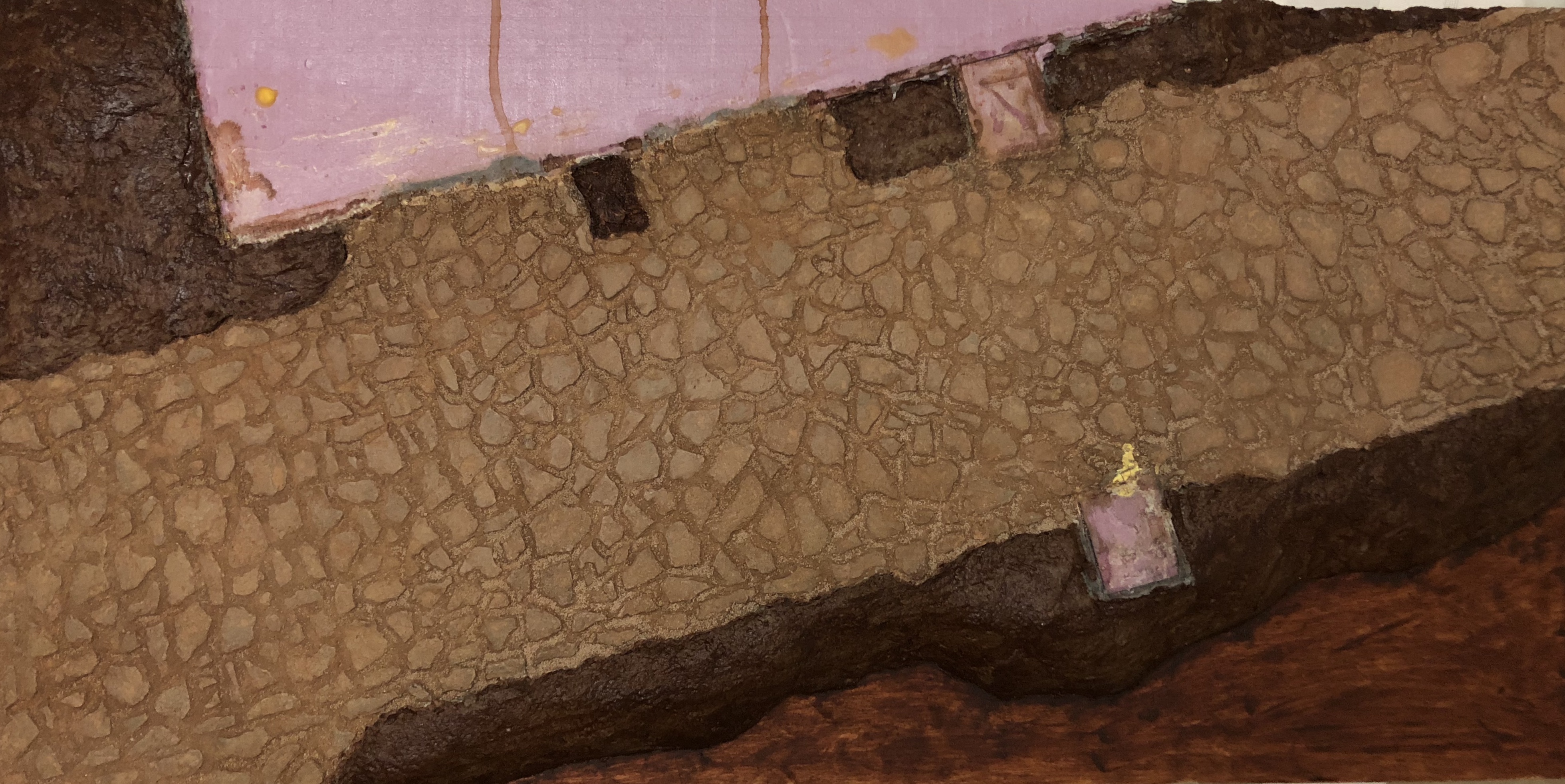

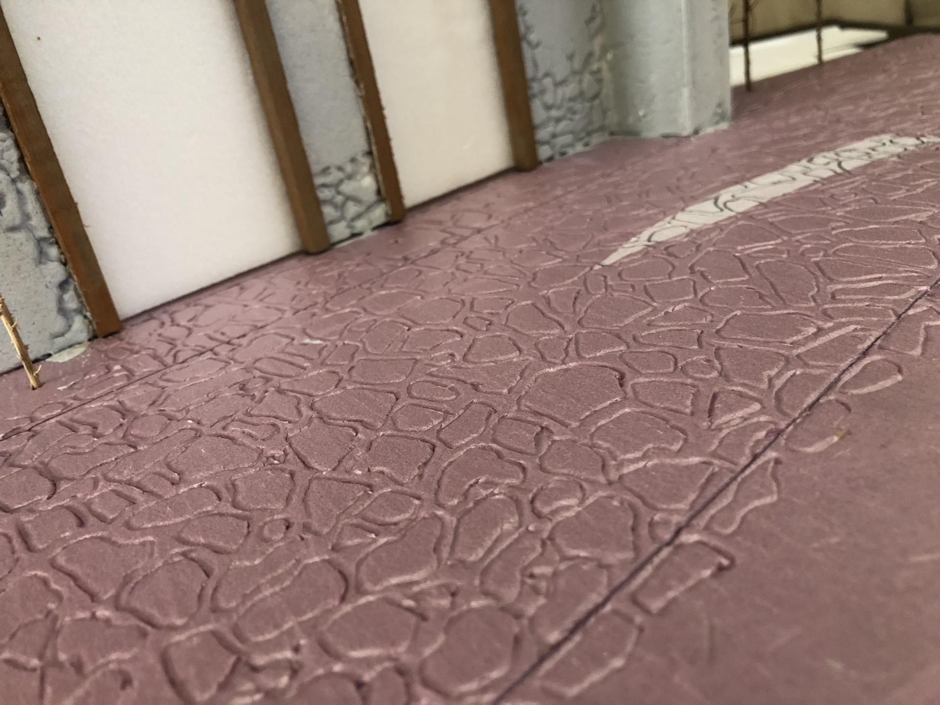

After giving some thought, I have decided to rebuild the building structure. I accidentally dropped it and the walls look crooked, plus other details. I’m taking in consideration some ideas given by members of the forum, which will make the diorama look better. I want to thank everyone for giving me some good points. Here is a picture of just the ground work. I might just work them separately and then attach the building to the base.
