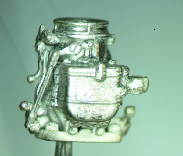

Ran my first plating experiment and got the result I expected.  Got what looks like gray primer completely covering the red resin. It is a matte finish because I hit it with pumice in the air eraser to start with.  Then a dip in wetting solution followed by a dip in tin sensitizer solution for 30 seconds.  Rinsed with distilled water and then into a silver solution for 5 minutes.
The surface I have is conductive so I could electroplate nickel or copper on it, but I just want it to be like a primer with full coverage and no buildup.
Next will be the electroless nickel where I want to get a metallic looking surface that can be buffed, painted or metalized.  The first method only a very thin silver coating that cannot be buffed.
The EN method allows a thicker nickel coating that can be buffed or given a subsequent bright nickel plate.

Just discovered my matte finish responds to burnishing.
Share this post
Link to post
Looks better in person, but getting closer to goal.

   This is really cool stuff!  That carb is a piece art in itself sir!!

The carb is my attempt to 3D print a better representation of the somewhat famous Stromberg 97 than what is currently available.Trying to color detail it without having to become an artist.
Using silvering in place of primer paint has worked out very well and using inks instead of paints is easier for me. I haven't even attempted a model build that needs paint, yet.

Flat32, I'm intrigued by your experiments, I hope you figure it out. That carb looks good, is it 1/25? Who did the printing?
