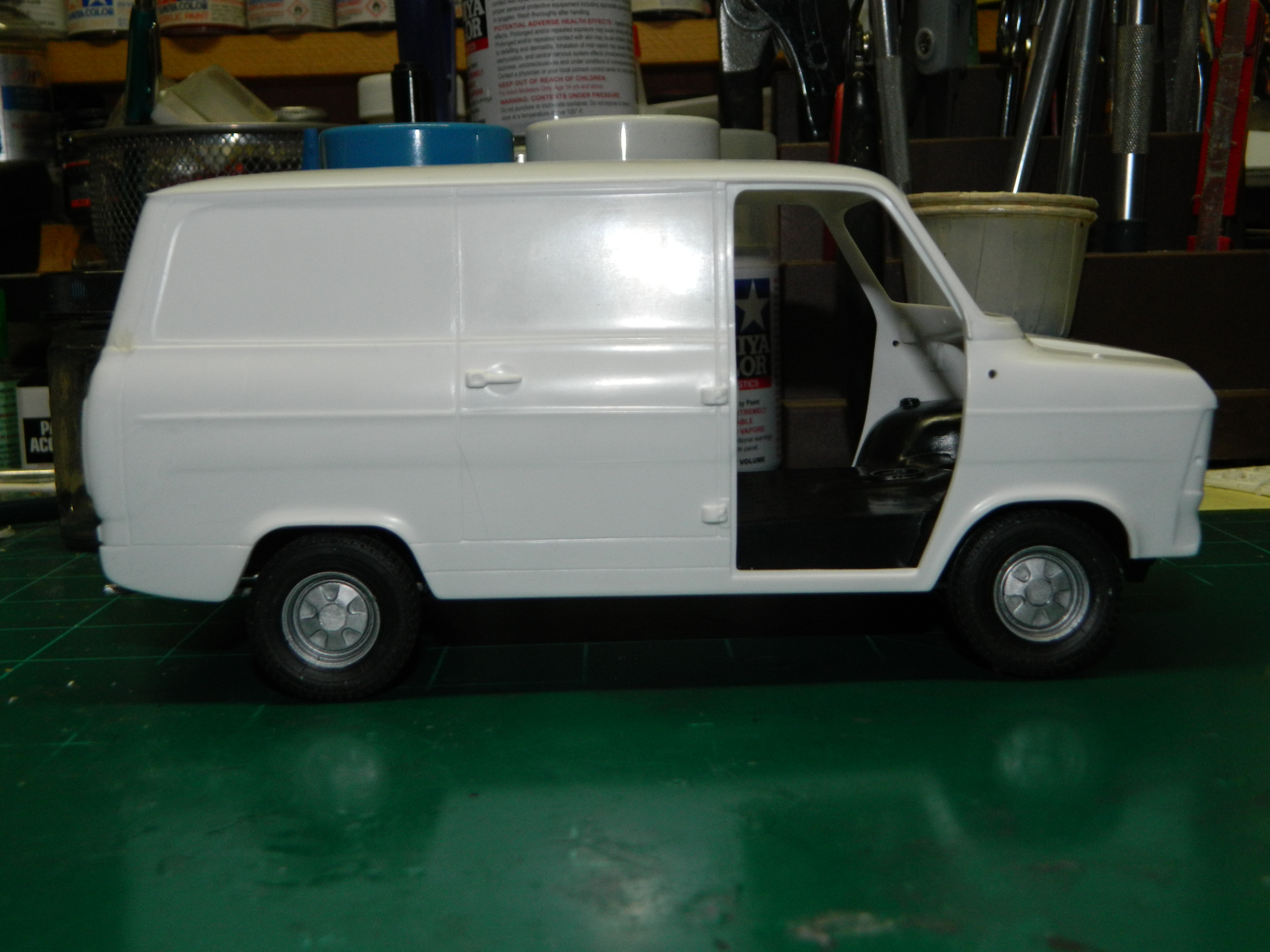

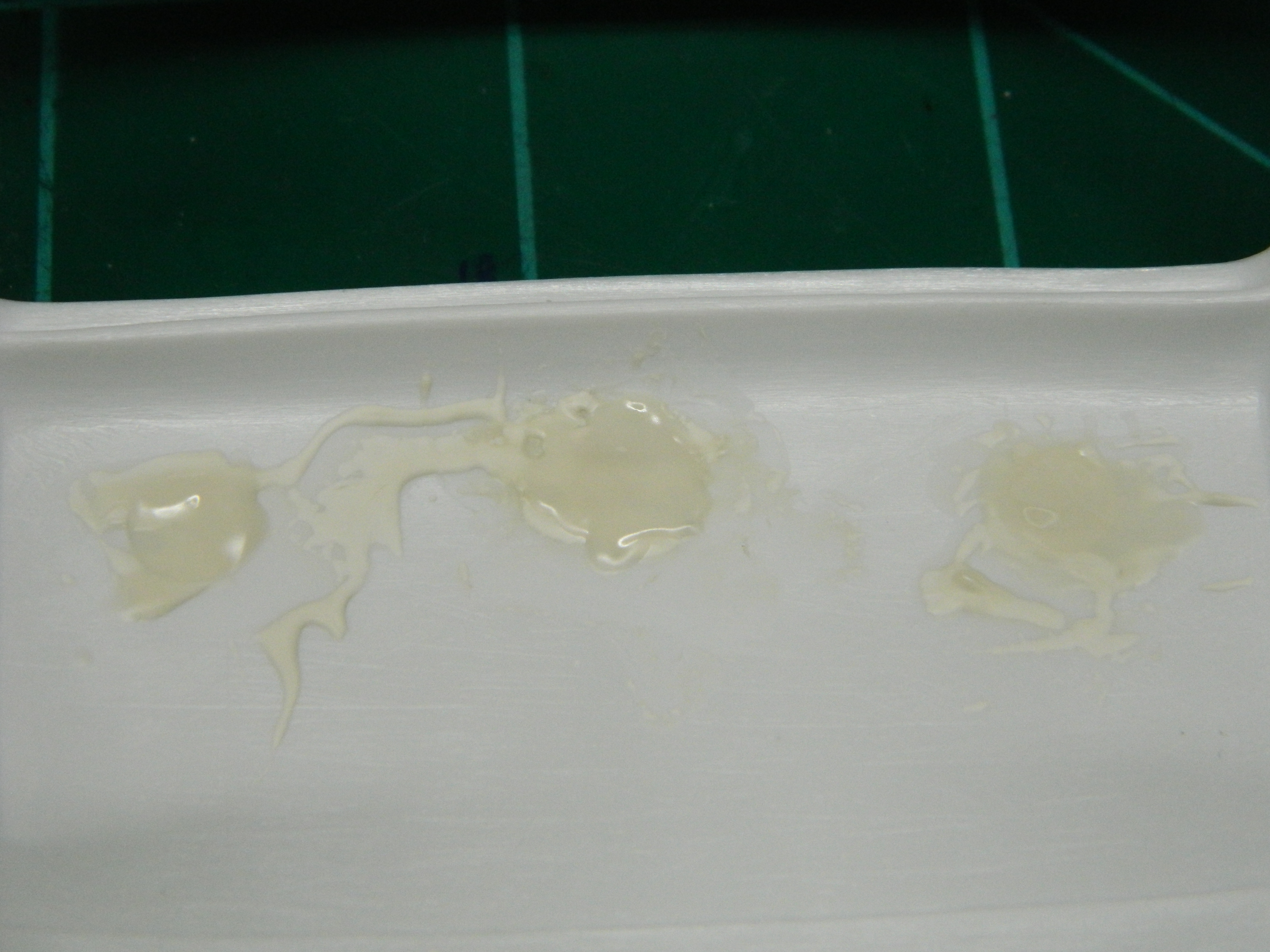

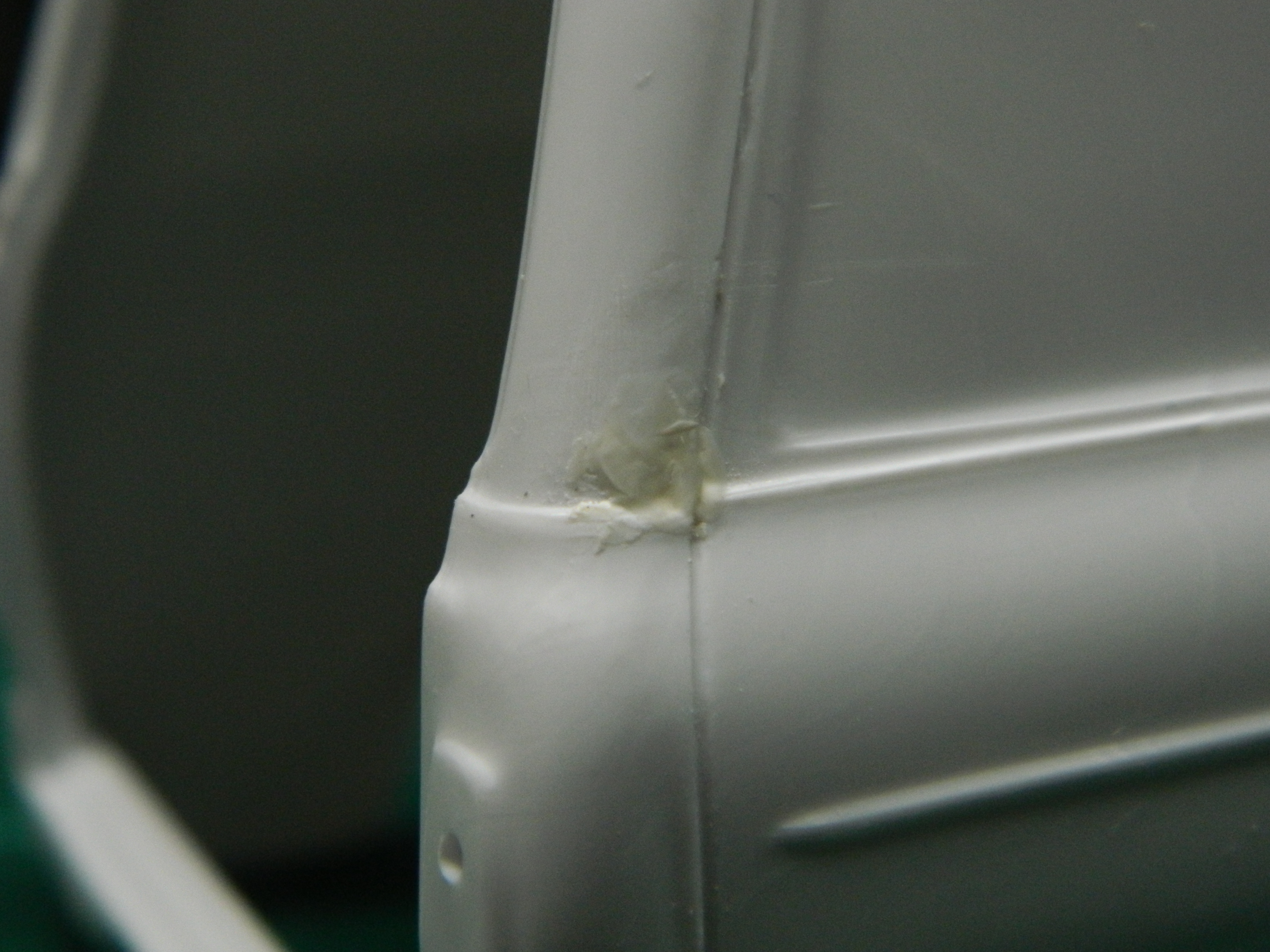

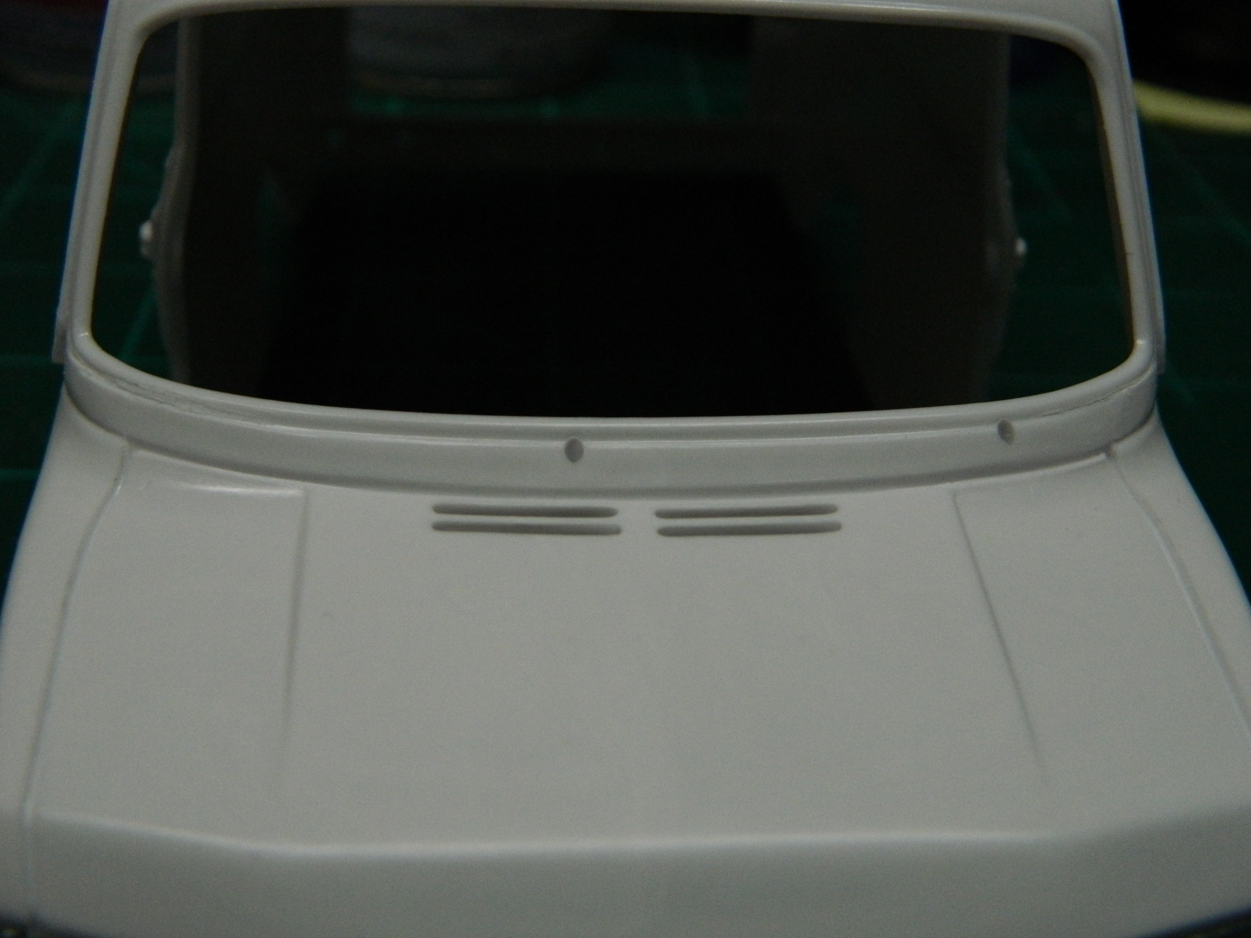

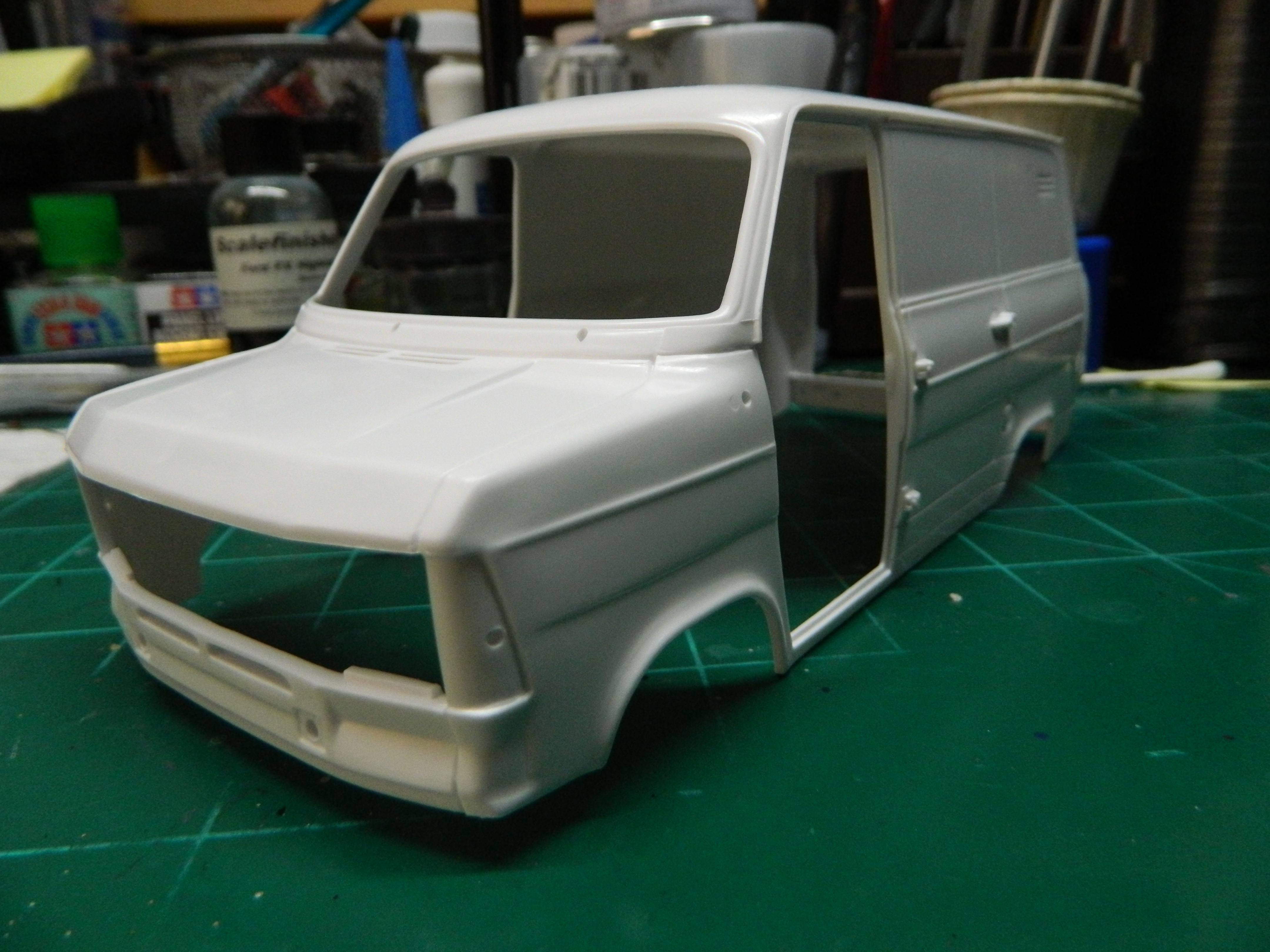

This body is nicely molded, but has a couple of small issues with it.  There is a small sink hole on the right rear of the body.  A couple of small mold lines under the windshield which are now gone.  And, three ejector pin marks near the windshield inside the body.  Once these are taken care of, I'll wash the body and get it into a coat of primer.

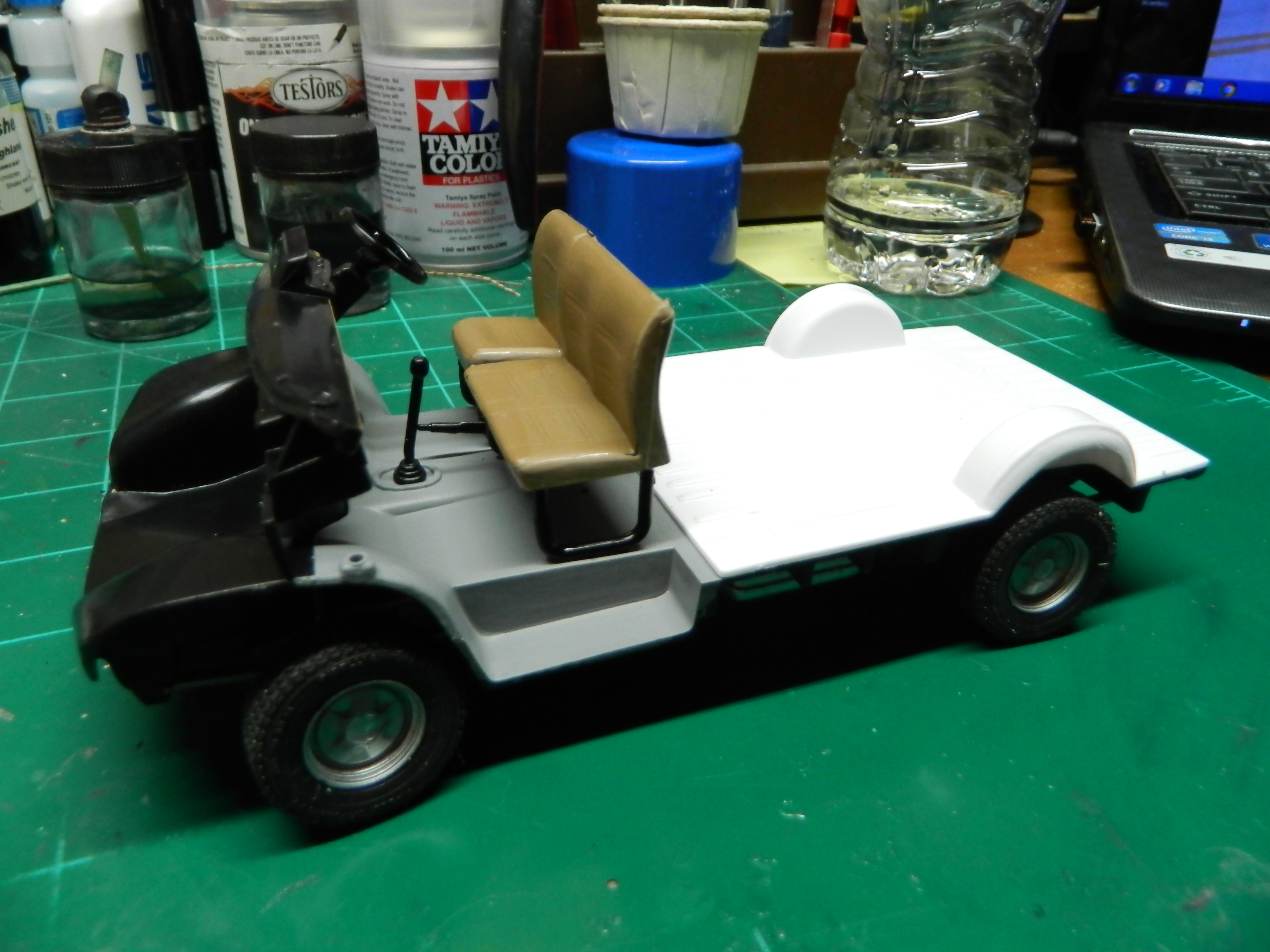

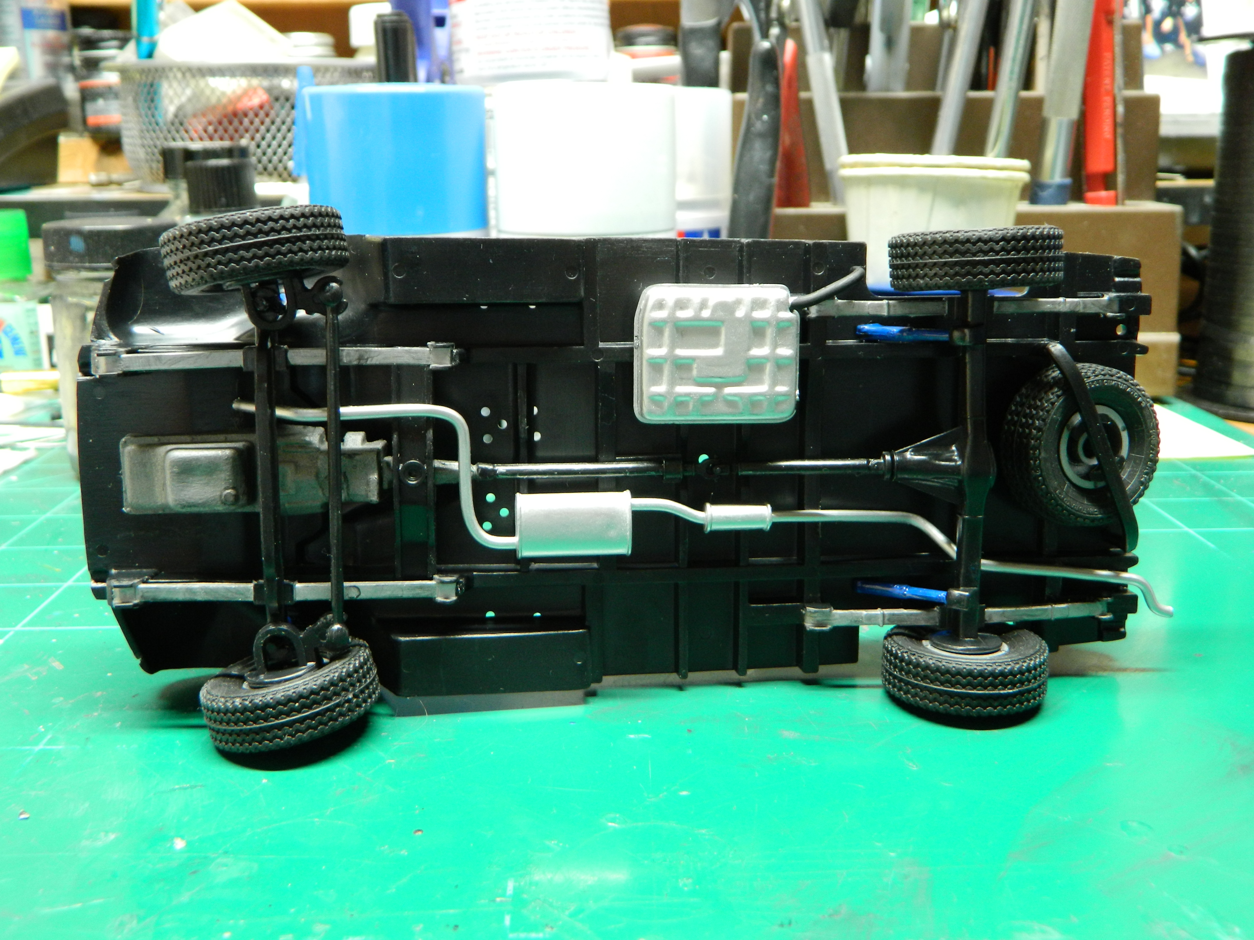

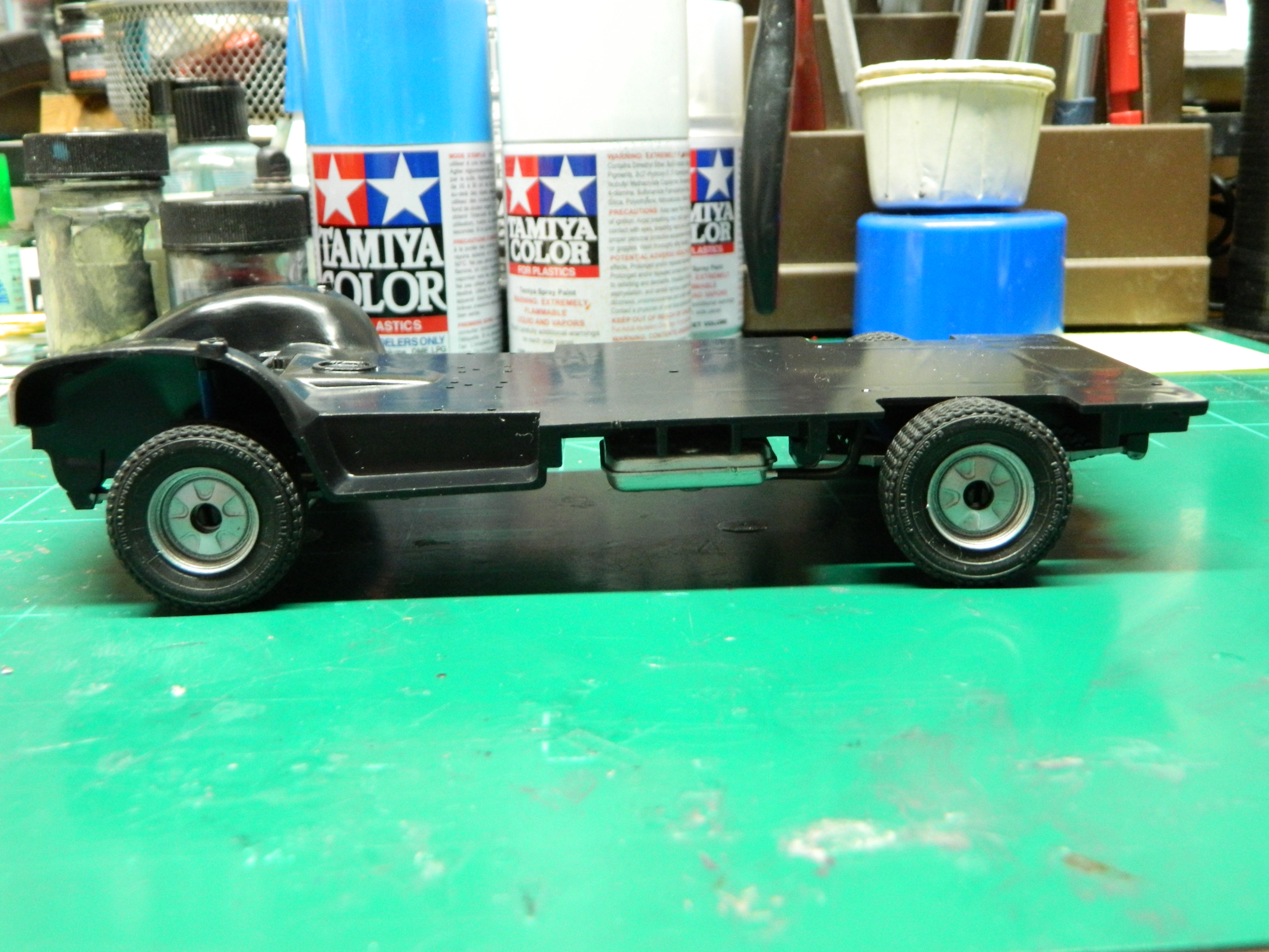

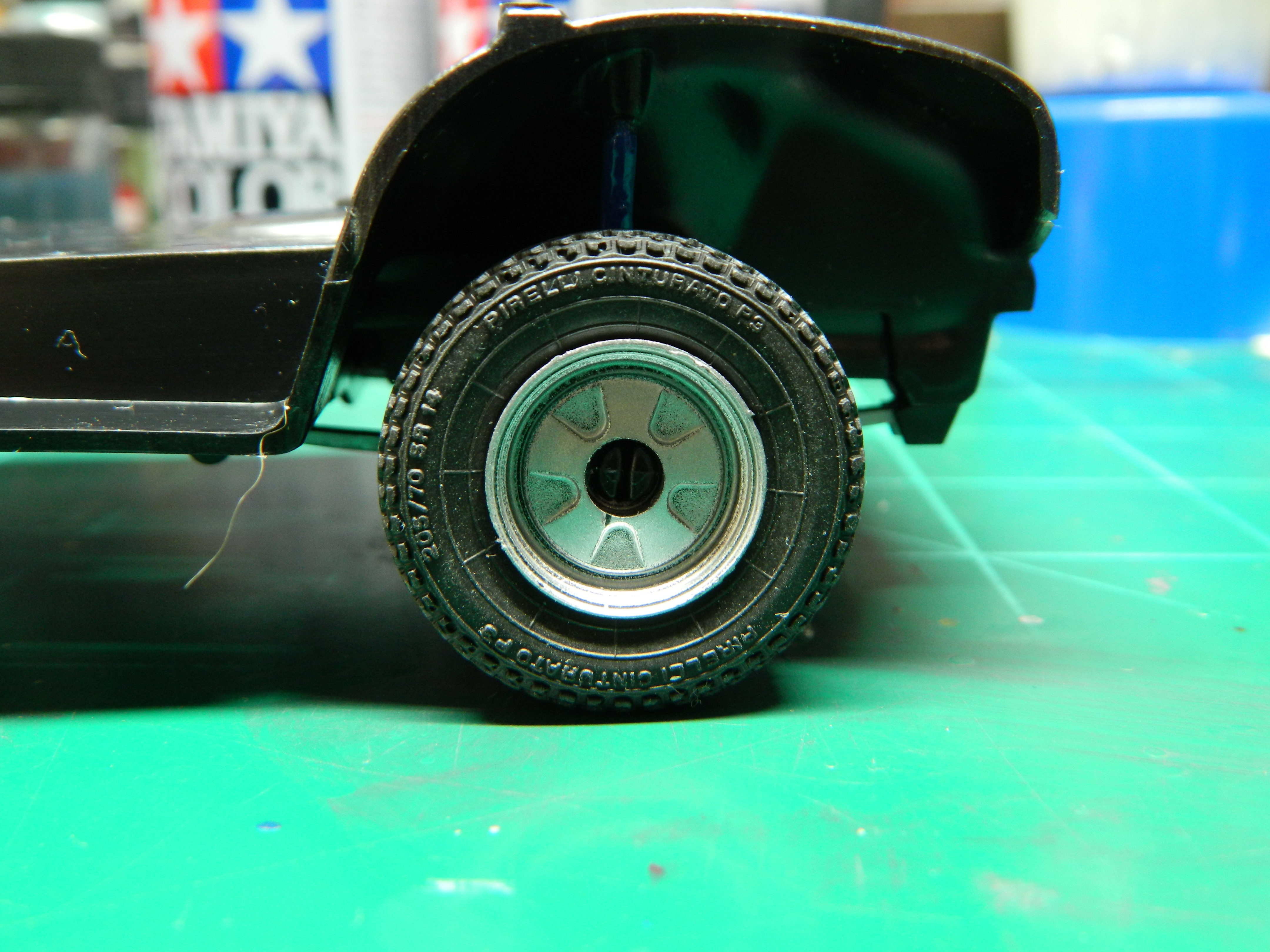

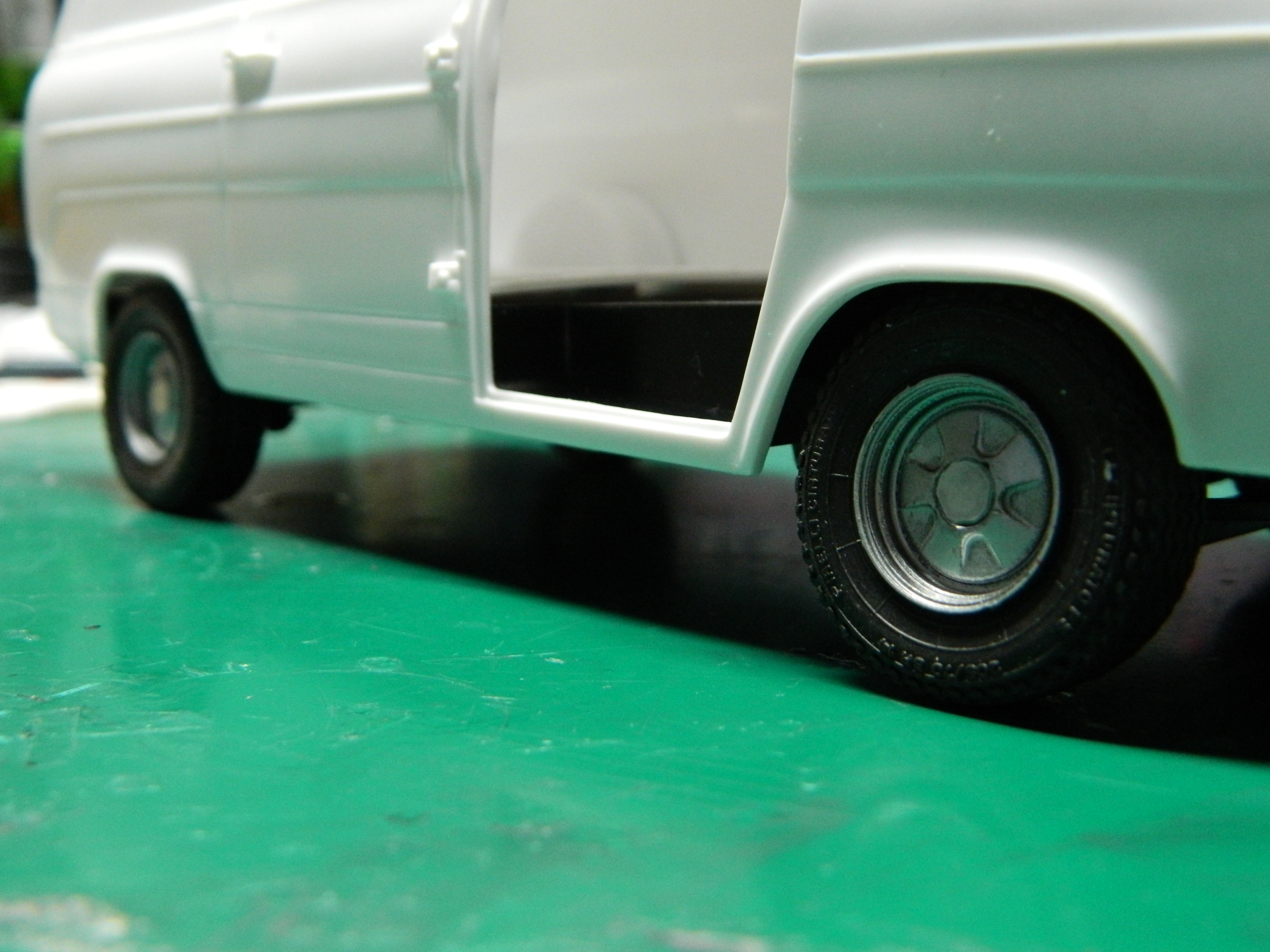

I decided to work on assembling the chassis this afternoon.  Fairly easy to put together and some parts didn't need glue.  I happen to like the wheels better without the wheel covers, so now I have to find something to use as a wheelcap in the center of the wheel.

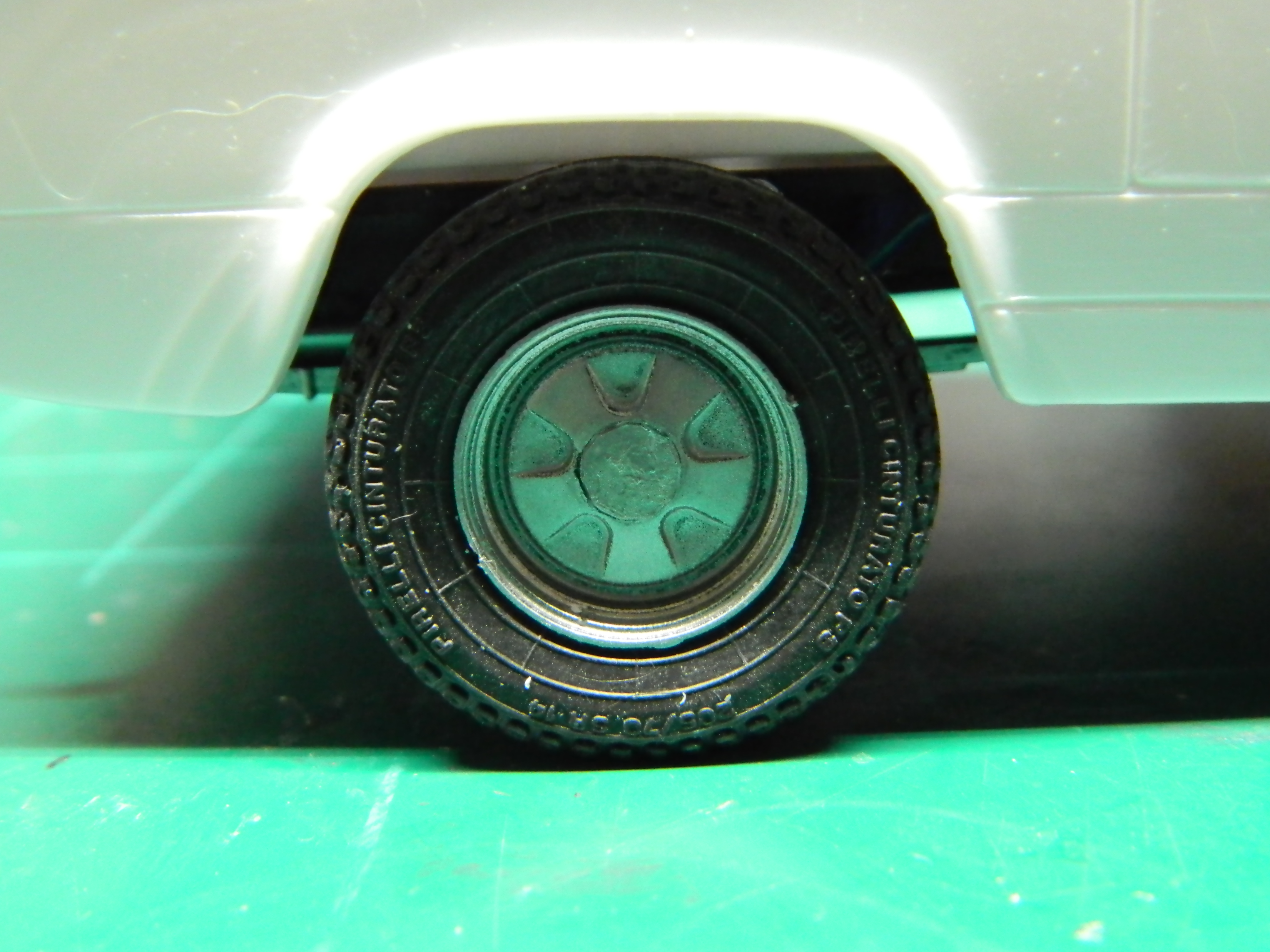

Last night, I sat down with a circle templet, a mechanical pencil and a piece of sheet styrene and drew out four circles at 9/64 inch diameter.  I cut them out with a chisel point knife, glued them to the wheel openings and painted them with Model Master Aluminium Metalizer and a brush.  Easy and done!

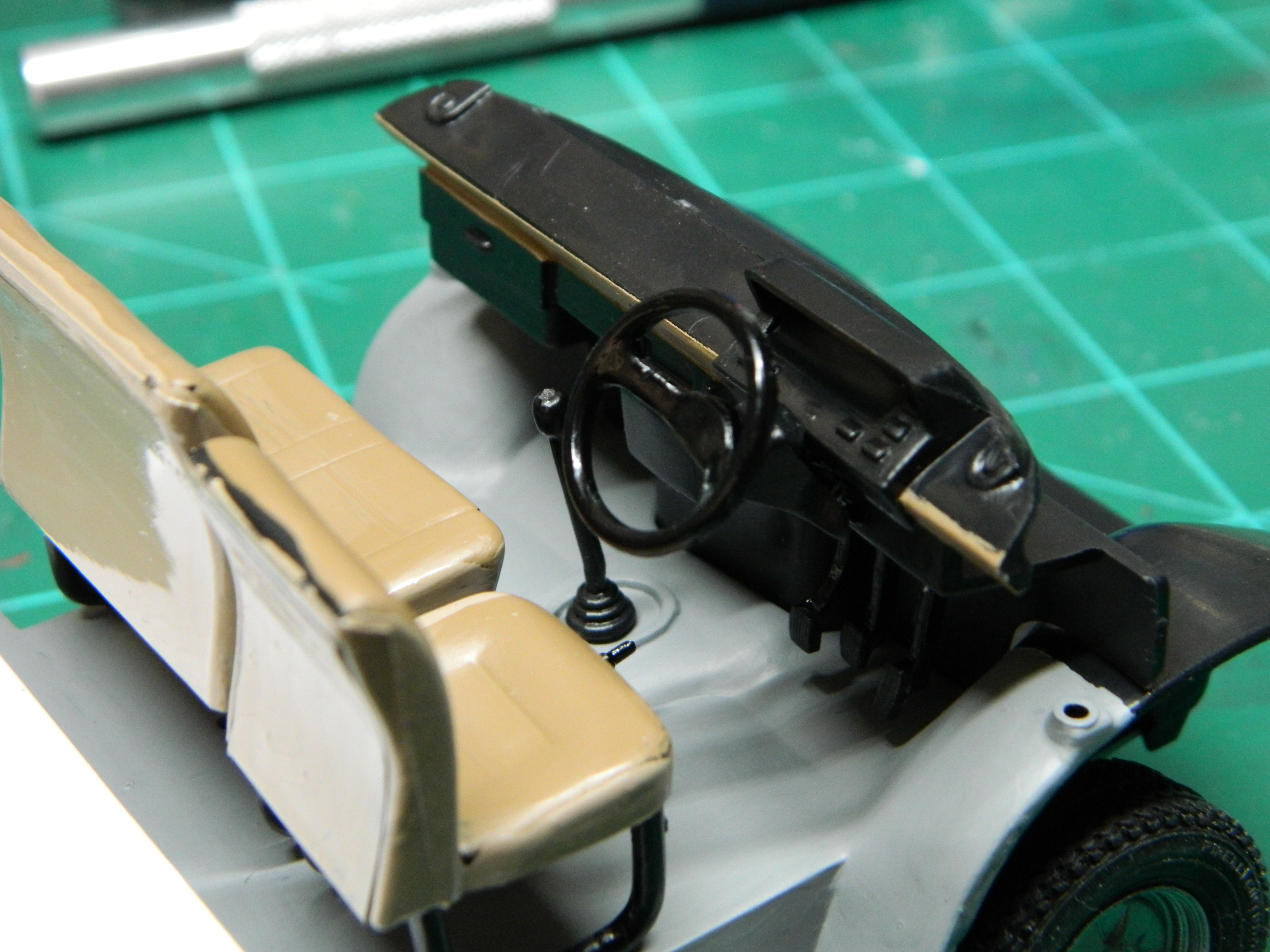

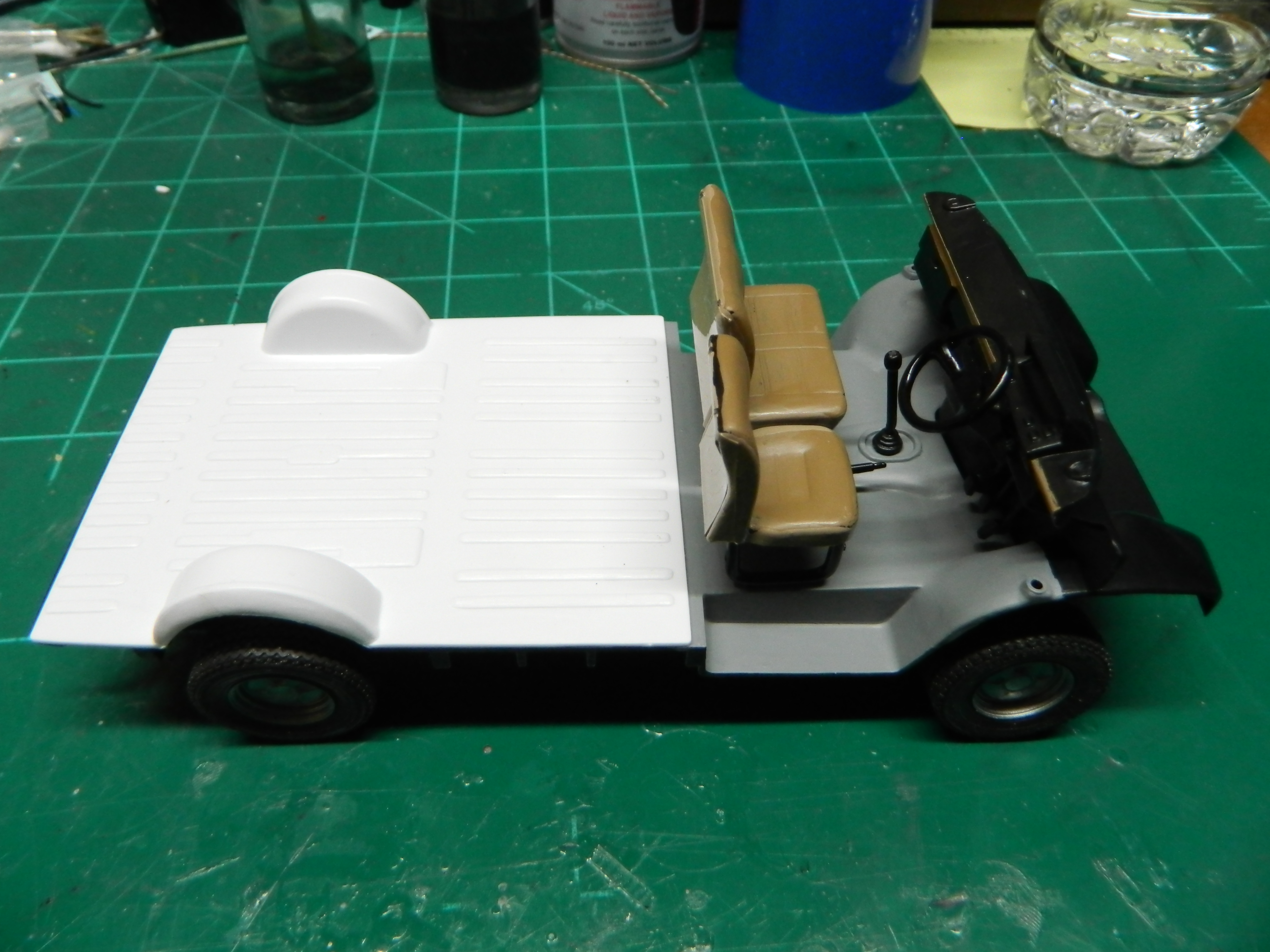

I spent some time on the Transit yesterday at my "Play Date" with some of my fellow Club members.  I got the seats painted and dash decaled and painted and I glued the floor pan onto the chassis.  I need to do some touchups on the seats and on the interior pan.

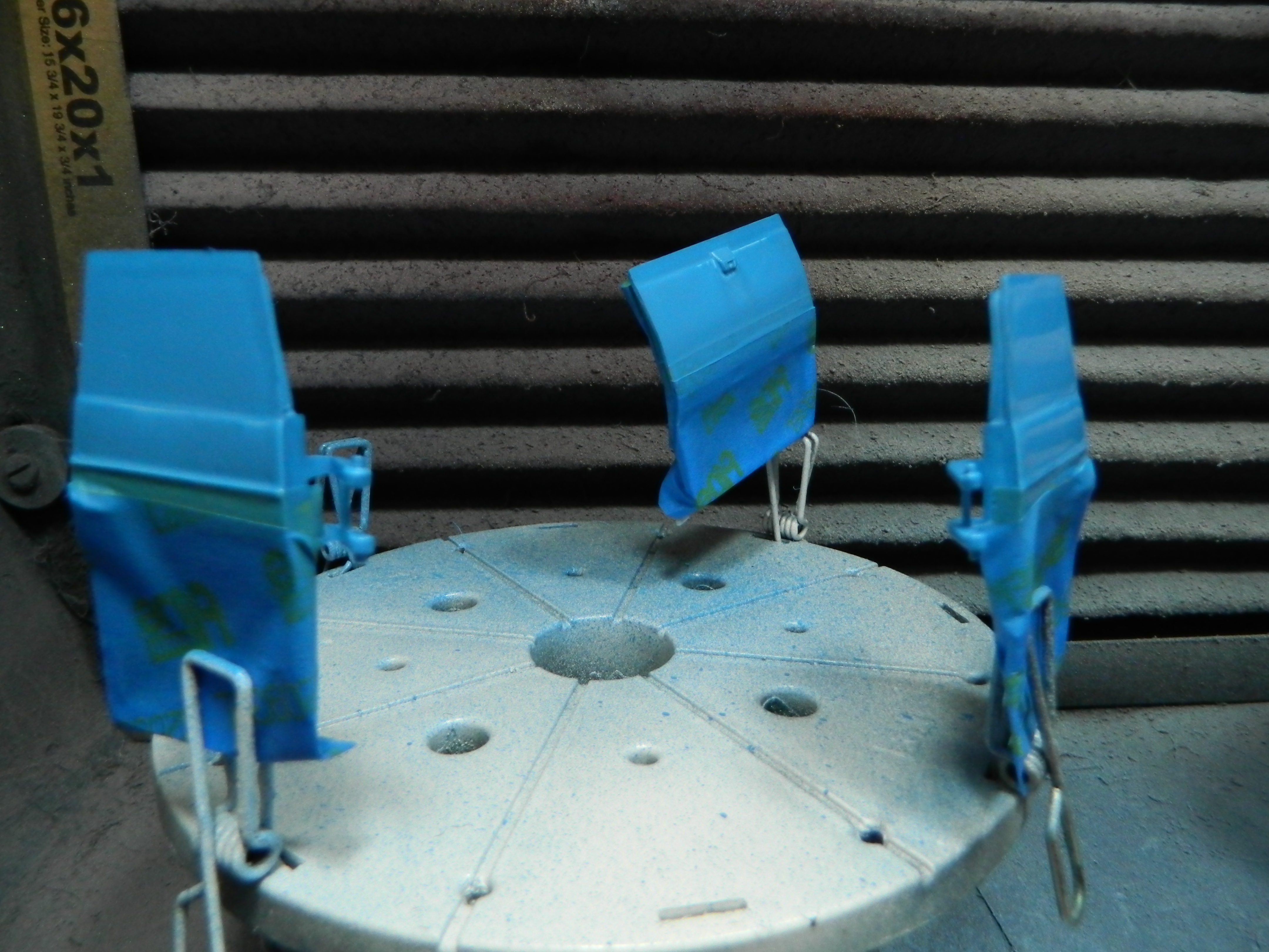

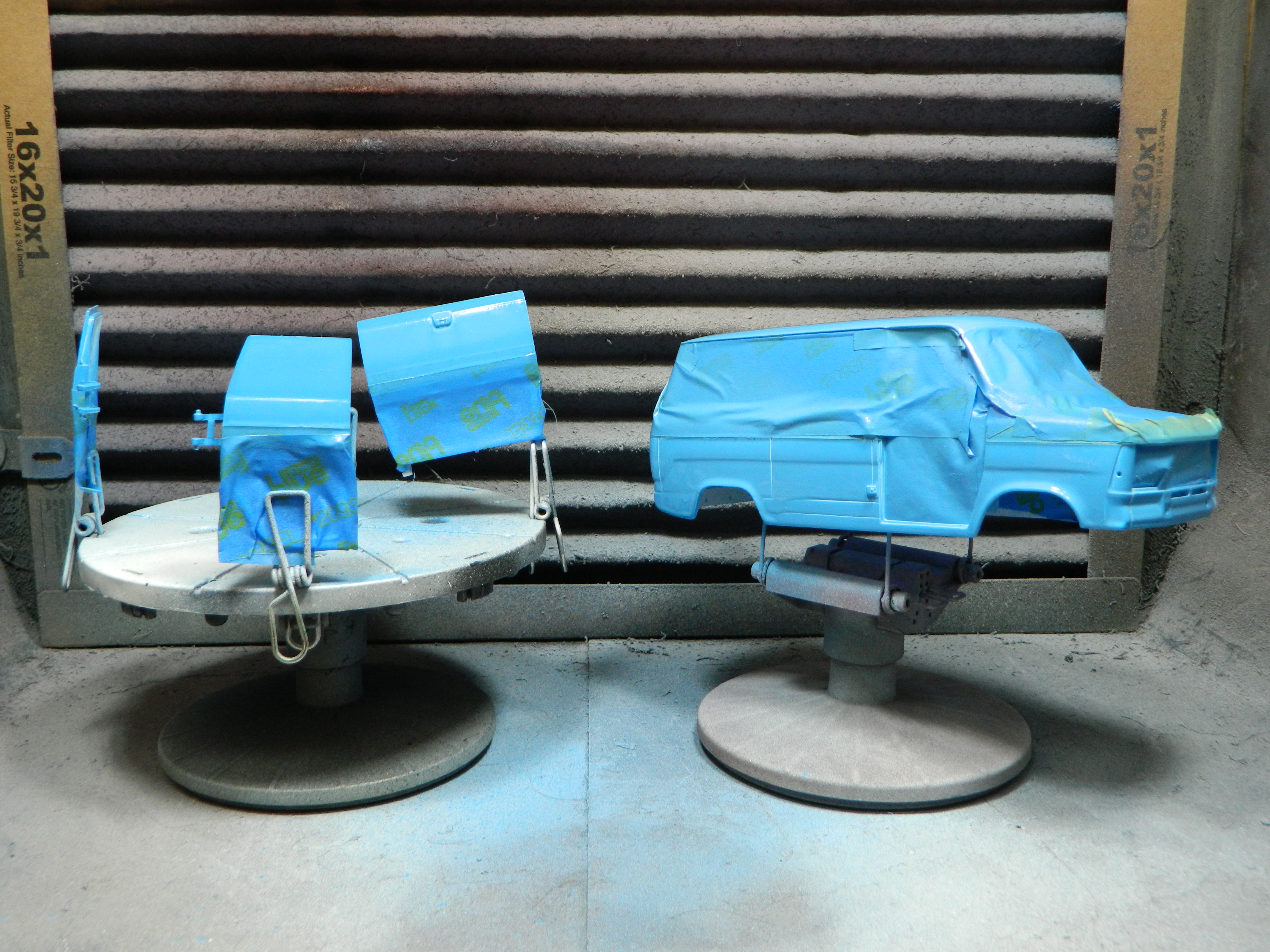

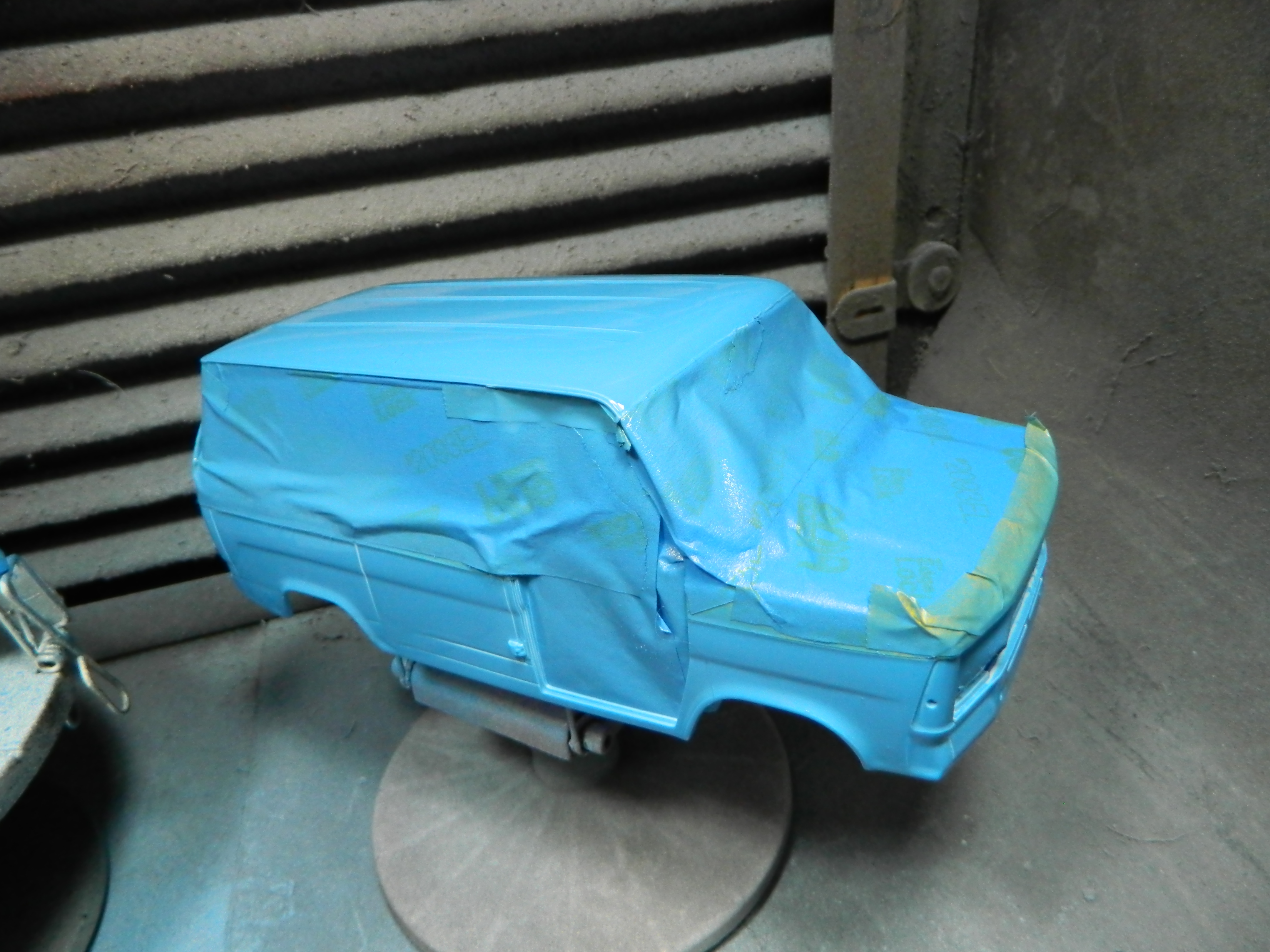

I spent a half hour masking off the body of this Transit.  I hope I did a good job when I pull off the tape after the paint dries.

Thank you Joe!  It took me about 30 minutes to mask everything, so I got the paint booth running to help get rid of the fuzz and dirt flying in the air.

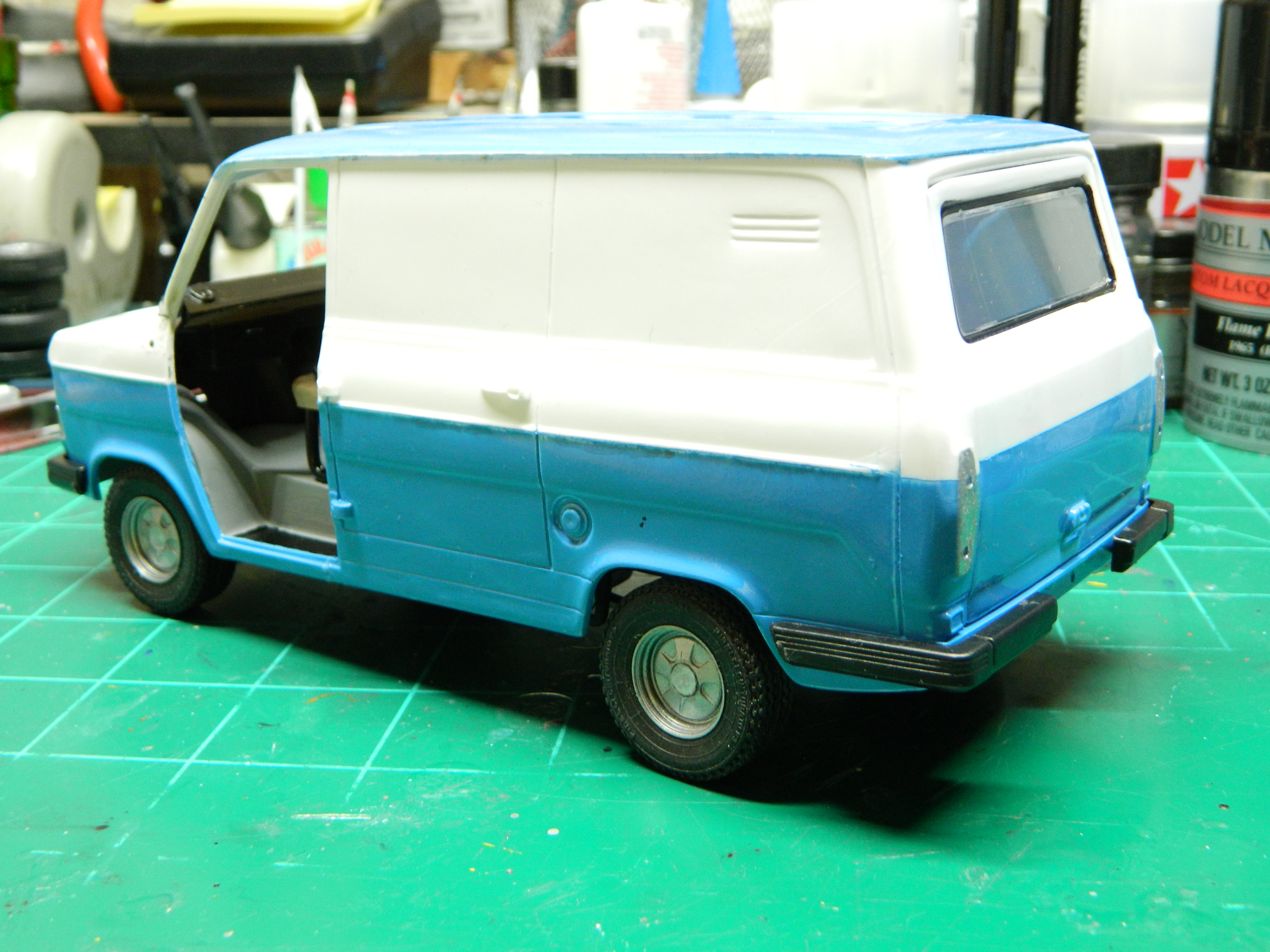

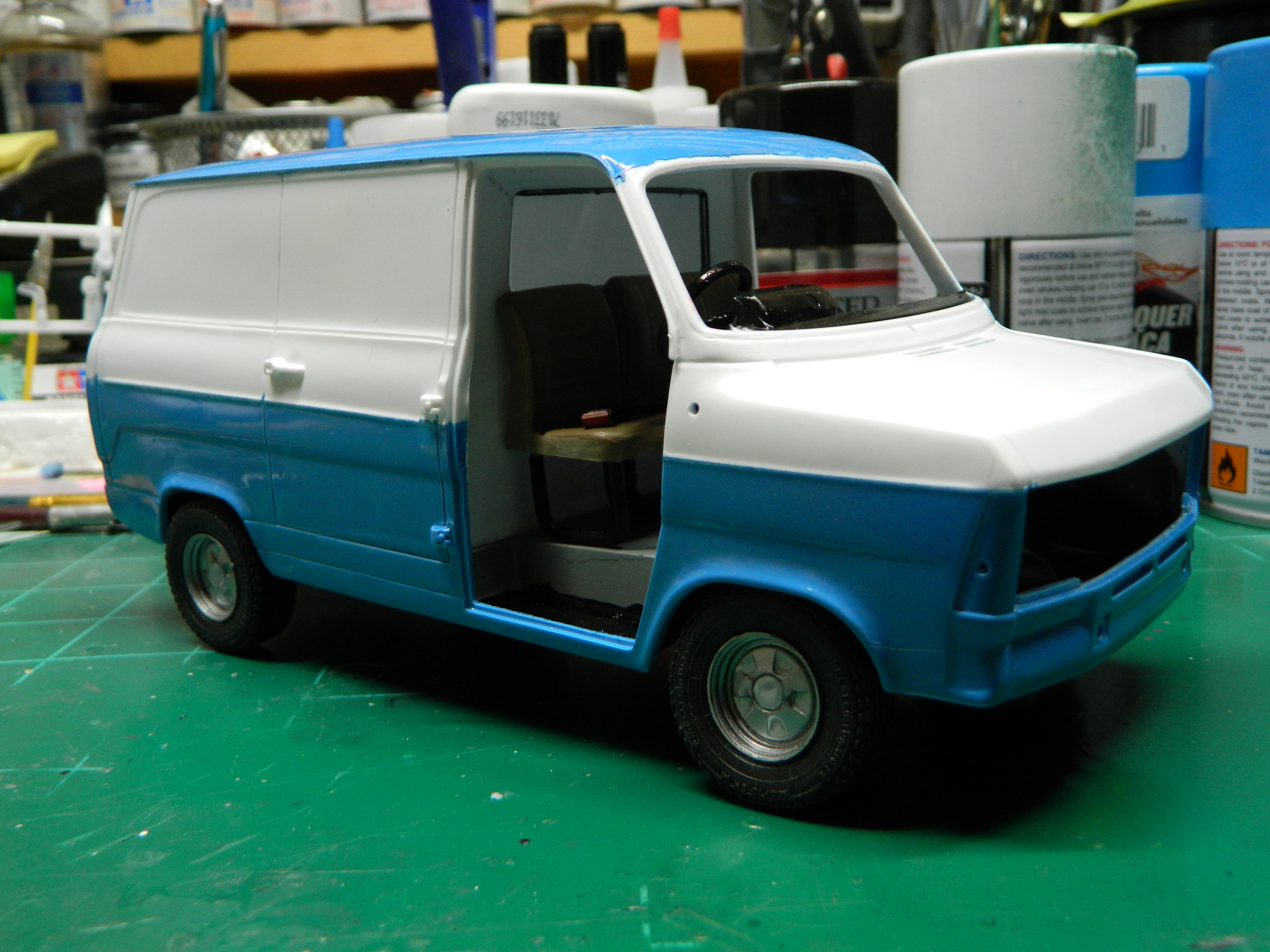

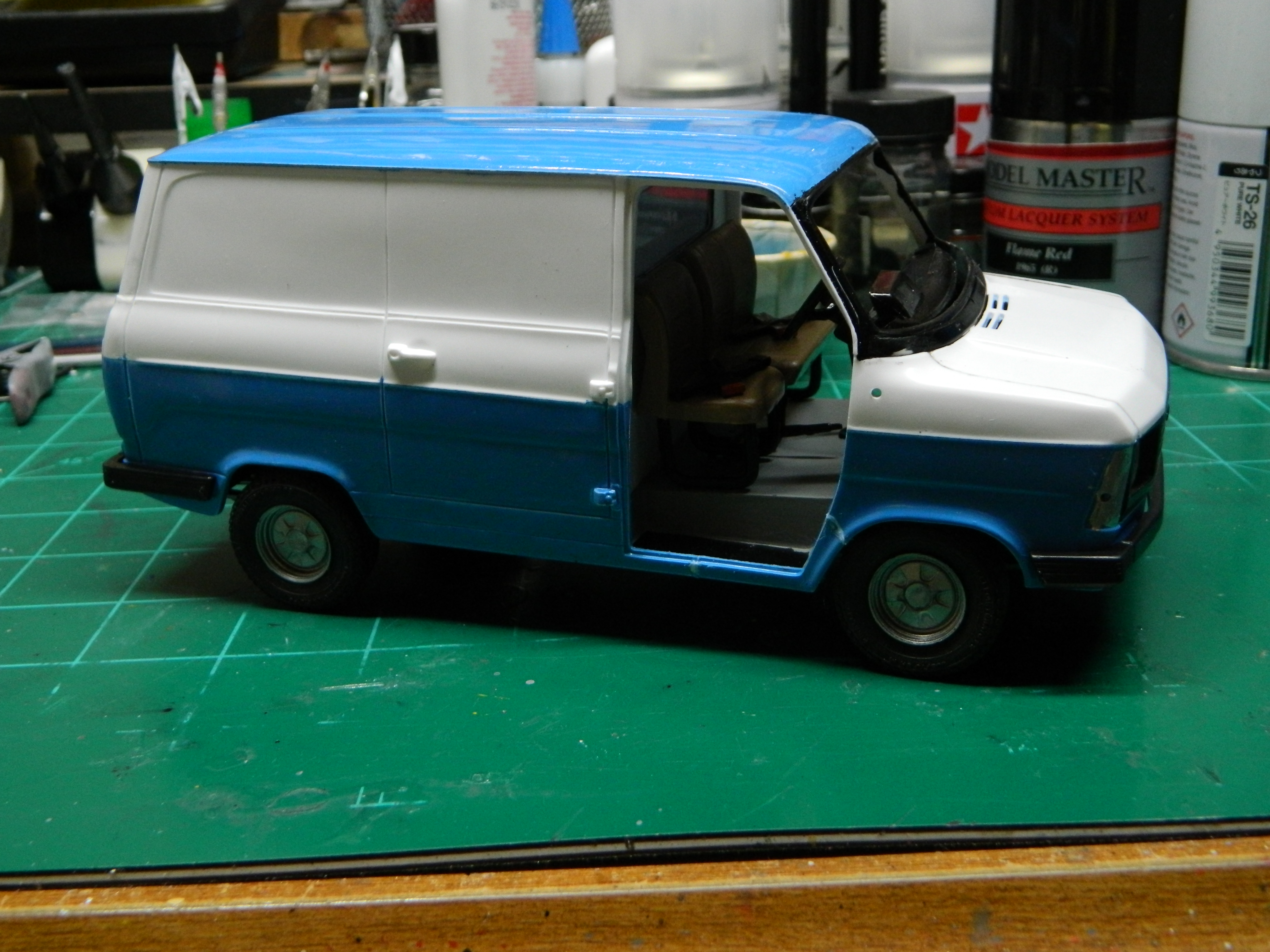

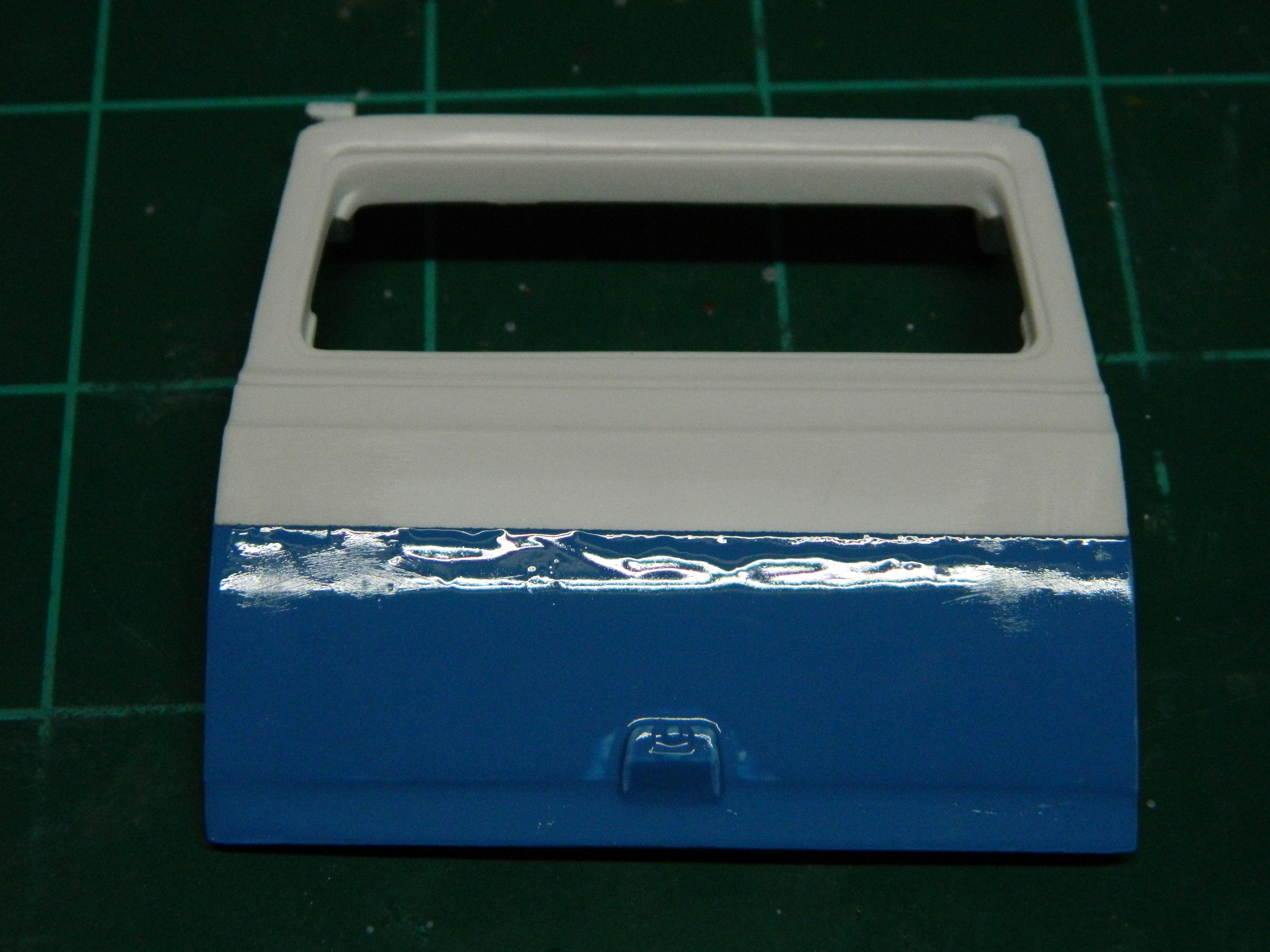

I finally decided to pull the tape off the Transit after another painting session and did a mockup with the chassis.  I still need to add decals and paint some trim.  The side doors came out fairly well.  Some cleanup and installation.  The rear door doesn't like me as I had issues paint it.  Some cleanup and polishing should make it look better.

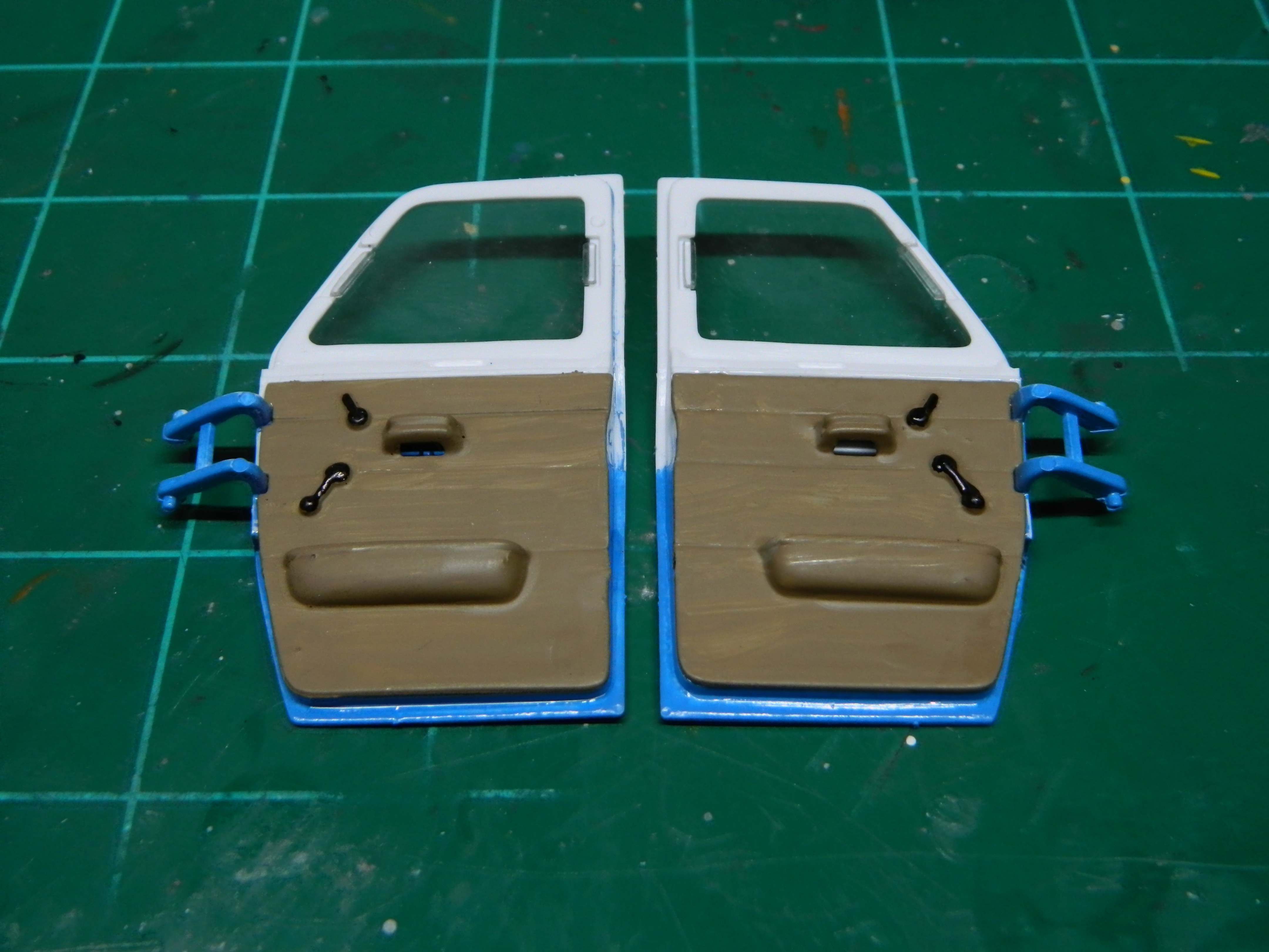

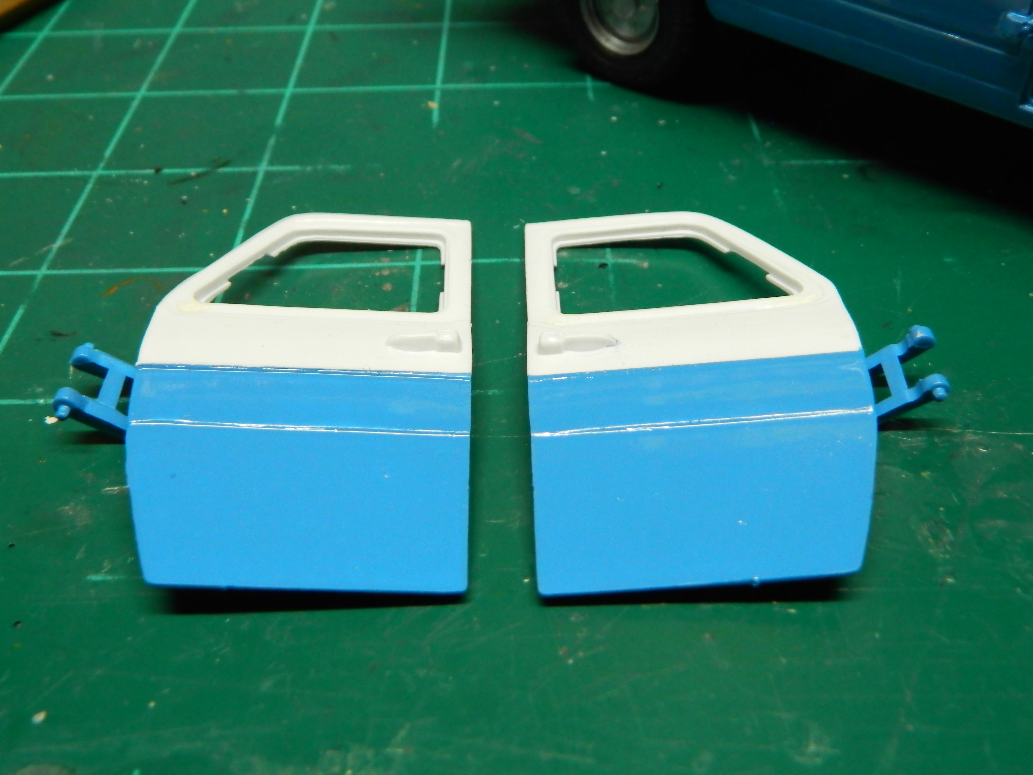

More progress on the Ford Transit this afternoon.  I got the body mounted to the chassis and installed the grille and bumpers.  I need to clean up the windshield trim after I had messed it up earlier.  The front doors are complete and now I have to install them which might be a bit tricky.
