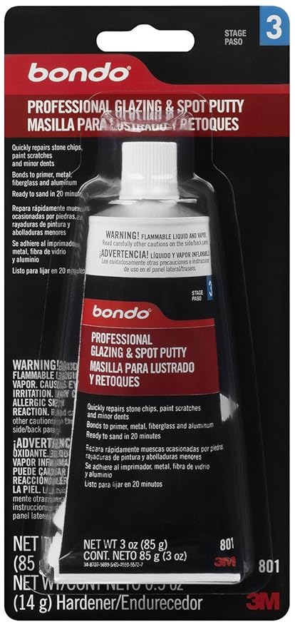

Silly question I suppose, but does anyone make an equivalent to the two-part Bondo in smaller hobby sized quantities?
Yes. It's sold in auto-parts stores in a 3-ounce tube. Comes with the right hardener. It's now my go-to filler for most work, though Joe's recommended epoxy products are very good too. It's easy to mix consistently if you think about what you're doing, and do a little measuring.
Image result for Bondo Professional glazing putty

I second Mr. Engwer:  Bondo Pro is very easy to use; varying the mix ratio just affects hardening time - I haven't had a problem, so anyone can use it.  Be aware, it is softer than styrene, even softer than resin.
