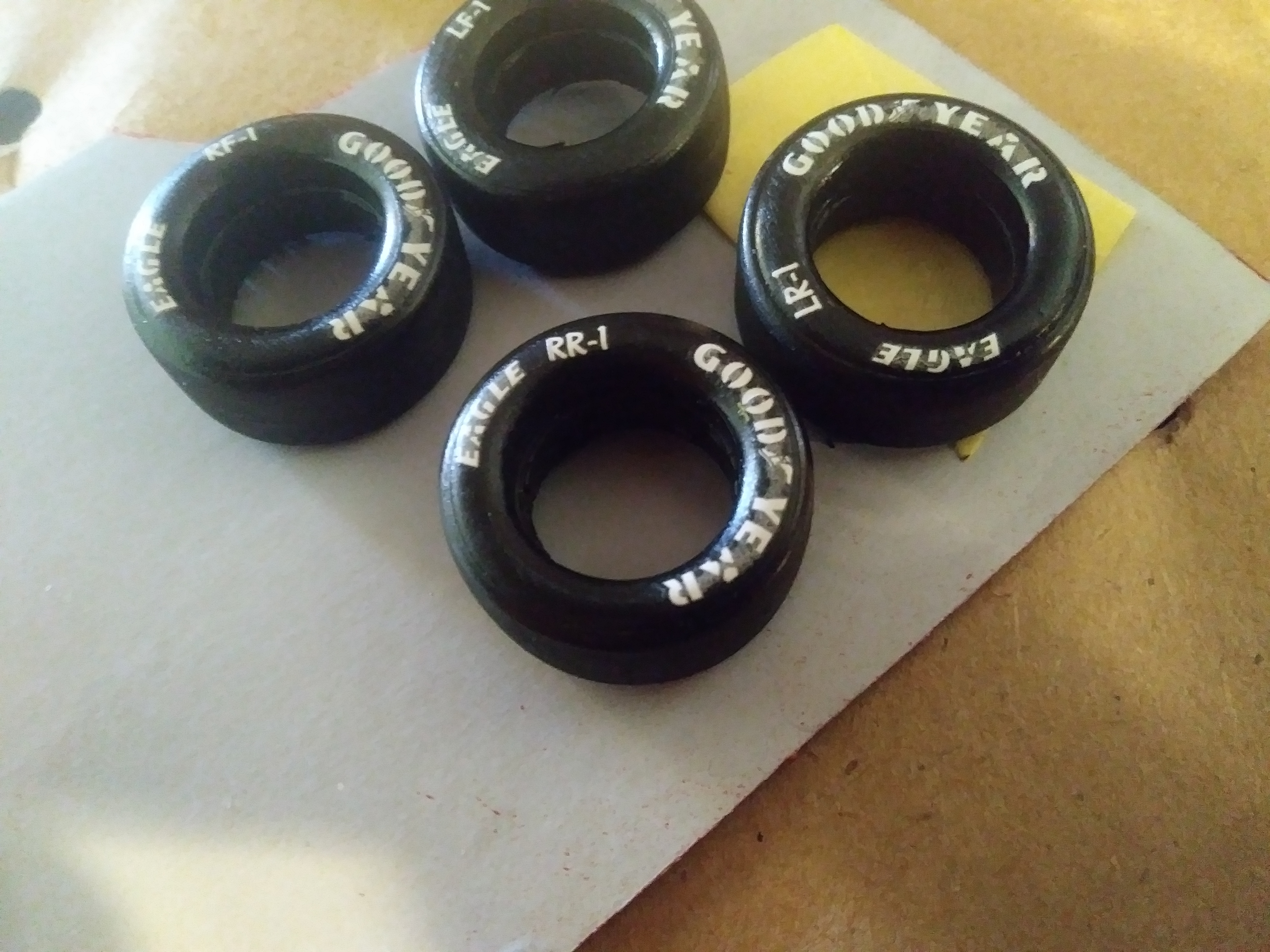

So I dull coted tire letter decals and they silvered from underneath it looks like after a dull coat of clear. Any one got any ideas other than just starting over on these. Cause I'm out of the white letters. ? They were not wet they were fully dried over night .... At a loss here as to why they silvered ?

Could be the dull coat, I have bought 2 cans lately of Testors dull coat that will not dry flat and I ave been using it for 40+ years and have never had that problem. looking at your picture it looks like yours has a shine to it.

Rustoleum matte is what i used and it sure looked like it dried clear.
Okay, but did you shoot a base coat of Gloss Clear on the tires before you applied the decals. If you didn't then the decals would have a hard time settling down on the side wall. This might be why they are silvering. Decals won't adhere to a matted surface.
I've found the same thing. I brush on a bit of Future before applying decals.

Try using a lot of decal setting solution, and you may have to do this several times.  As one of the previous posters said, this may make them look presentable.  I would not use Rustoleum clear.  I have had terrible luck with them on tires.  I use only Testor's gloss coat before I put the decals on and flat coat afterwards.

No advise on saving your lettered tires. I have had this happen to me and I use Testor's acrylic flat clear out of an airbrush. It seems to happen if I apply the clear coat too wet. I think it re-wets the decal and causes the silvering. If I apply very light coats and allow some drying, I do not get the silvering. I had this happen on the same tires, same decals and the ones that silvered had been wet coated more than others that I did at the same time but gave them a few more lighter coats.

Touch up the silvered areas with flat black testors acryl from the bottle between the letters . get some testors dullcote clear and decant it  into a bottle then brush the dull coat over the whole tire with a large soft bristle brush. It works. I do it all the time but not to correct silvering. I make my own tire decals and print them on white ink jet paper. after I install them I have to use the above process to hide the edges of the decal. It works surprisingly well.

I use testors 1260 dullcote spray,  but I decant it, and put it on with a brush. I only use it on tire decals. I don't know what would happen if I sprayed it on. It might make the decal ink run. Maybe since I put  it on with a brush it drys before it can make the ink melt and run.
If you can brush it no problem spraying won’t cause ink to run. I brush my tires with the same stuff. Usually one of the last things I do on a build. That’s why I don’t spray it

I use Vallejo acrylic matte varnish. Put the decals on then top it off with the Vallejo, no issues. I usually do one coat, then another one or two more, after each coat before has dried for a few hours.

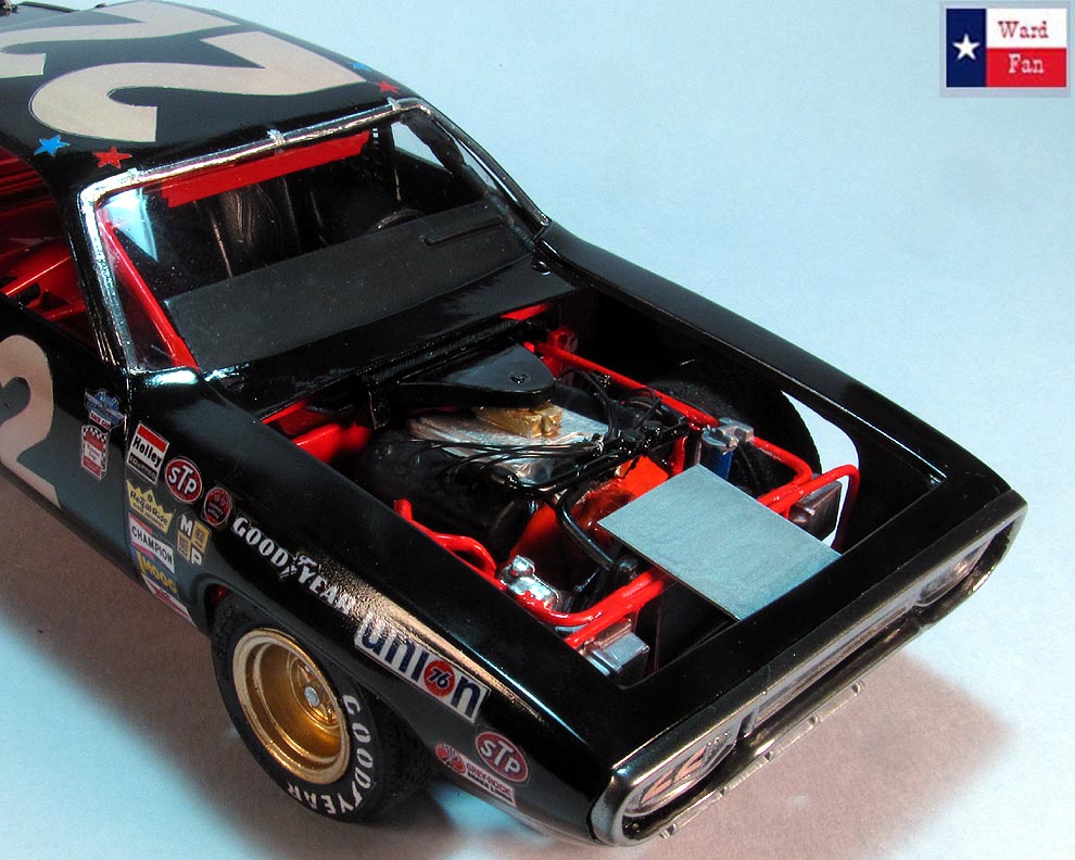

Not NASCAR tires, but Powerslide tire details along with Tamiya kit decals on Tamiya tires. No harsh gases with acrylics.
