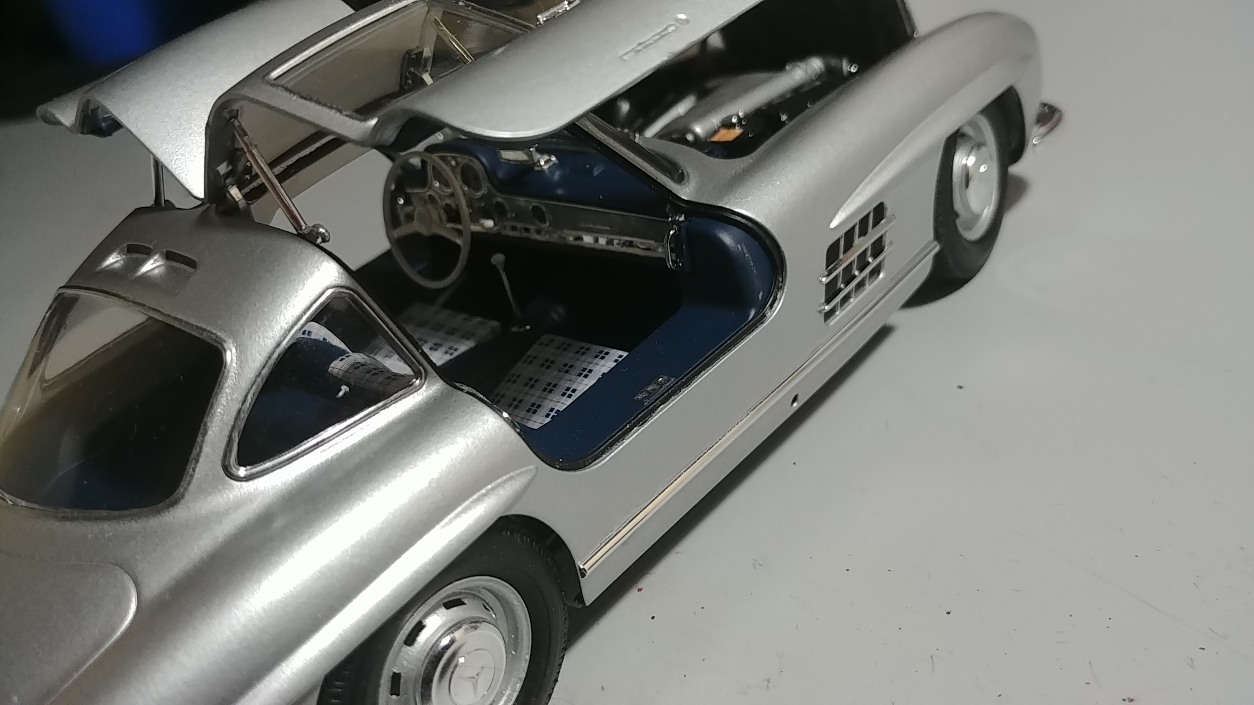

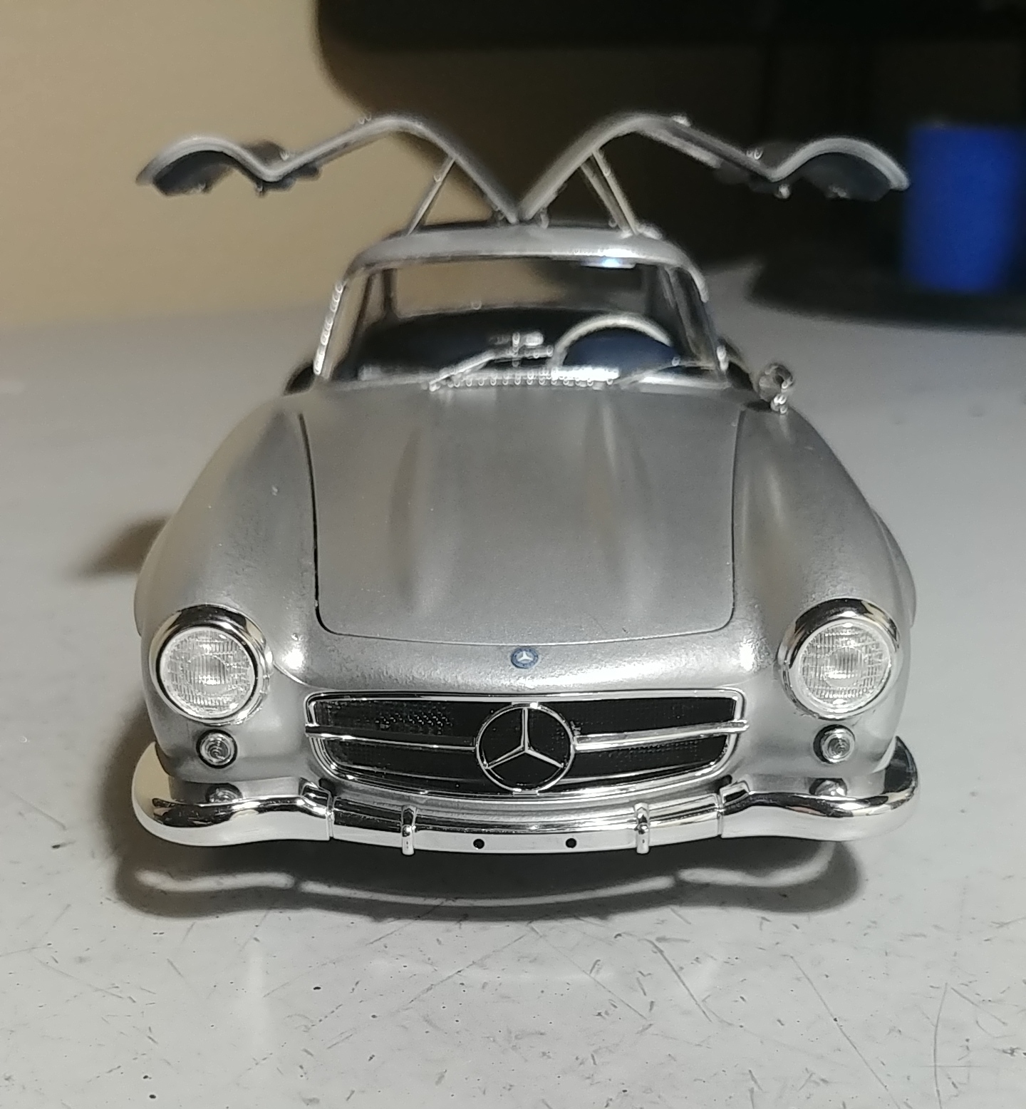

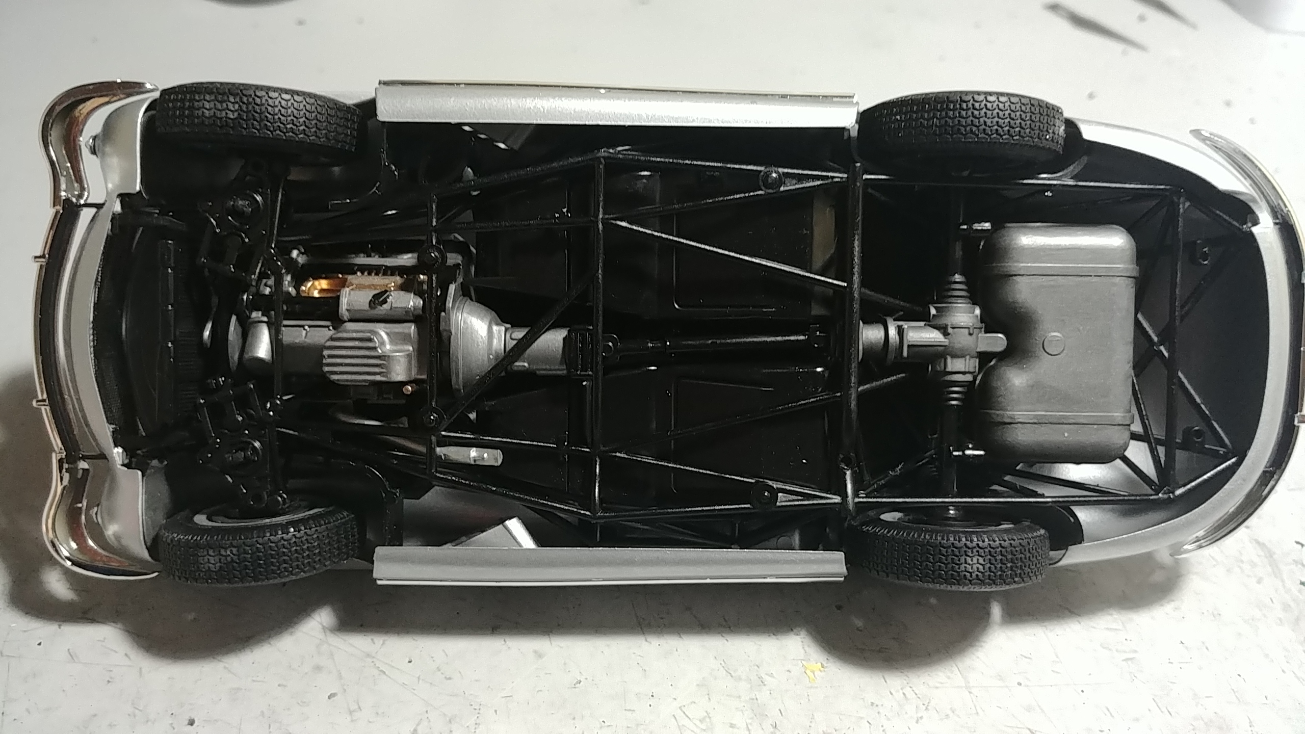

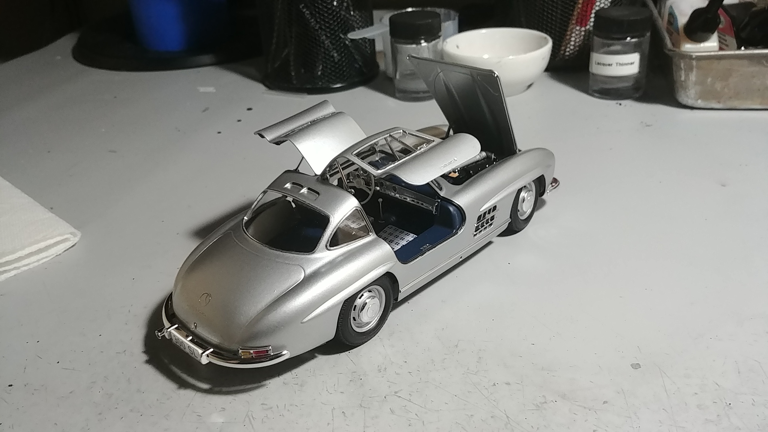

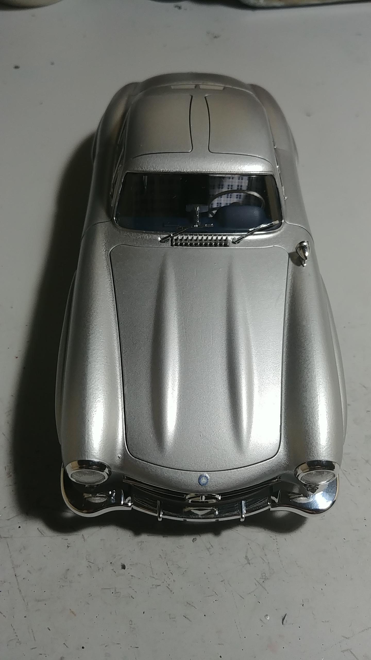

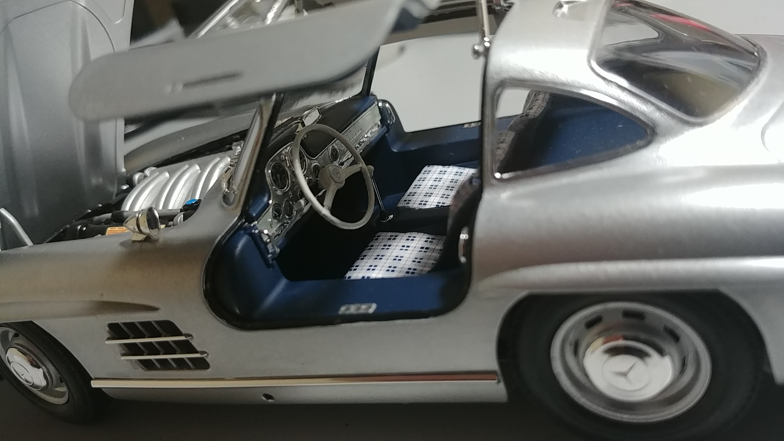

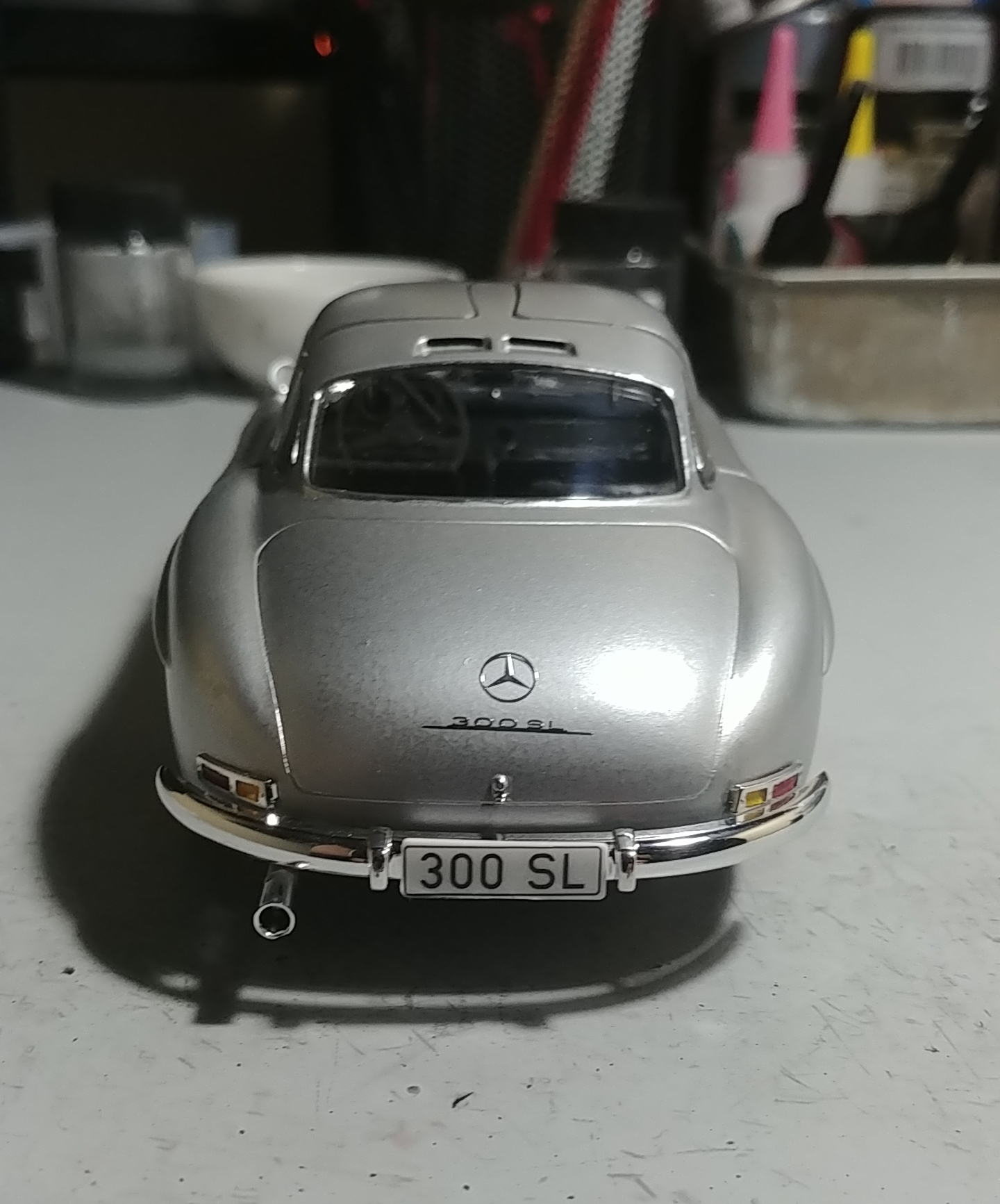

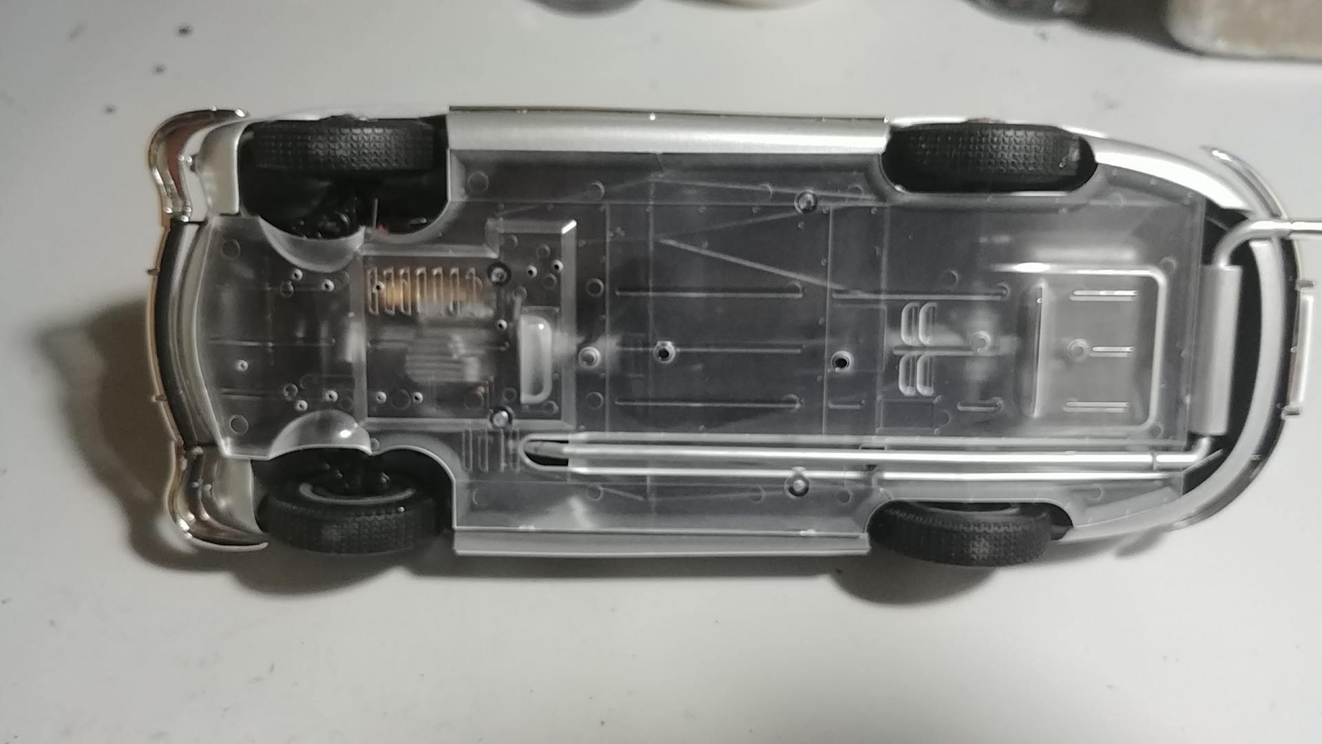

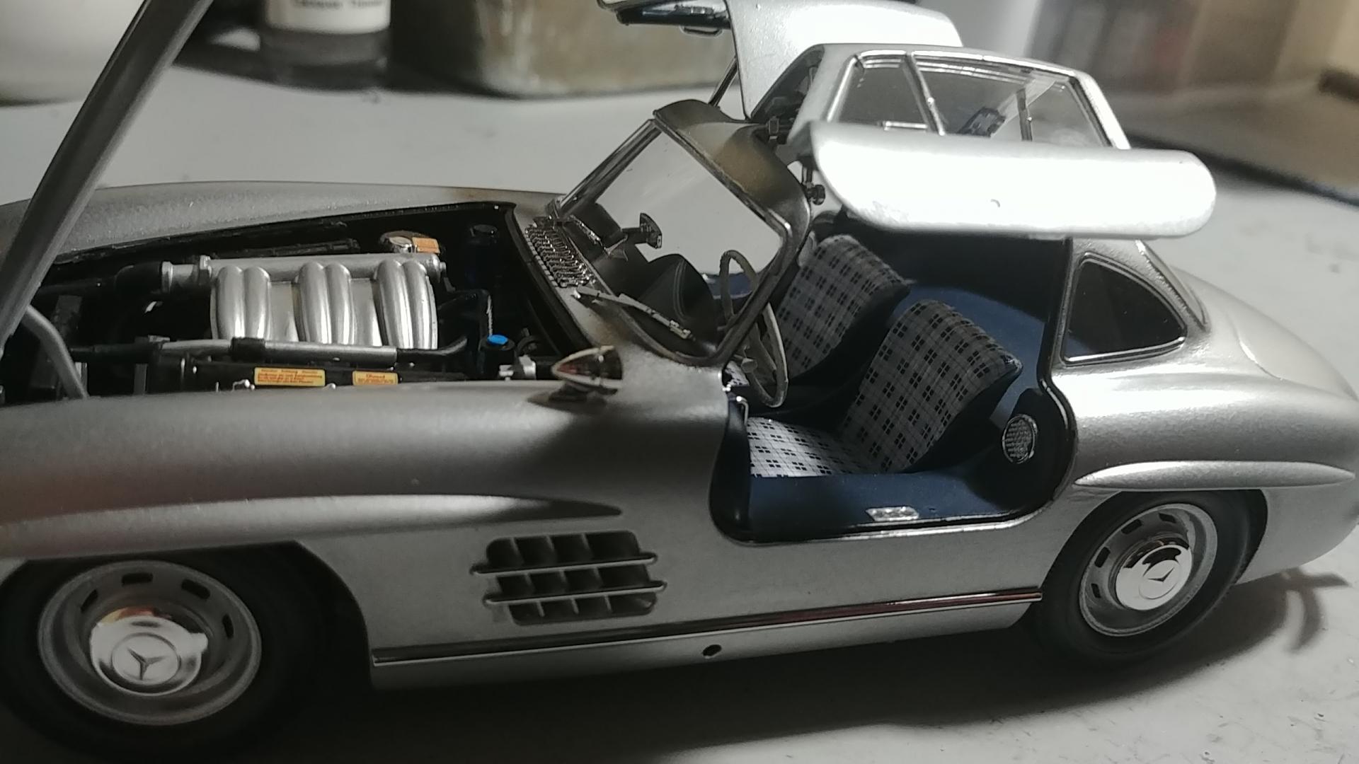

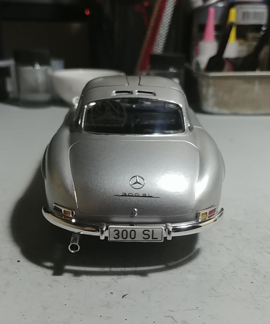

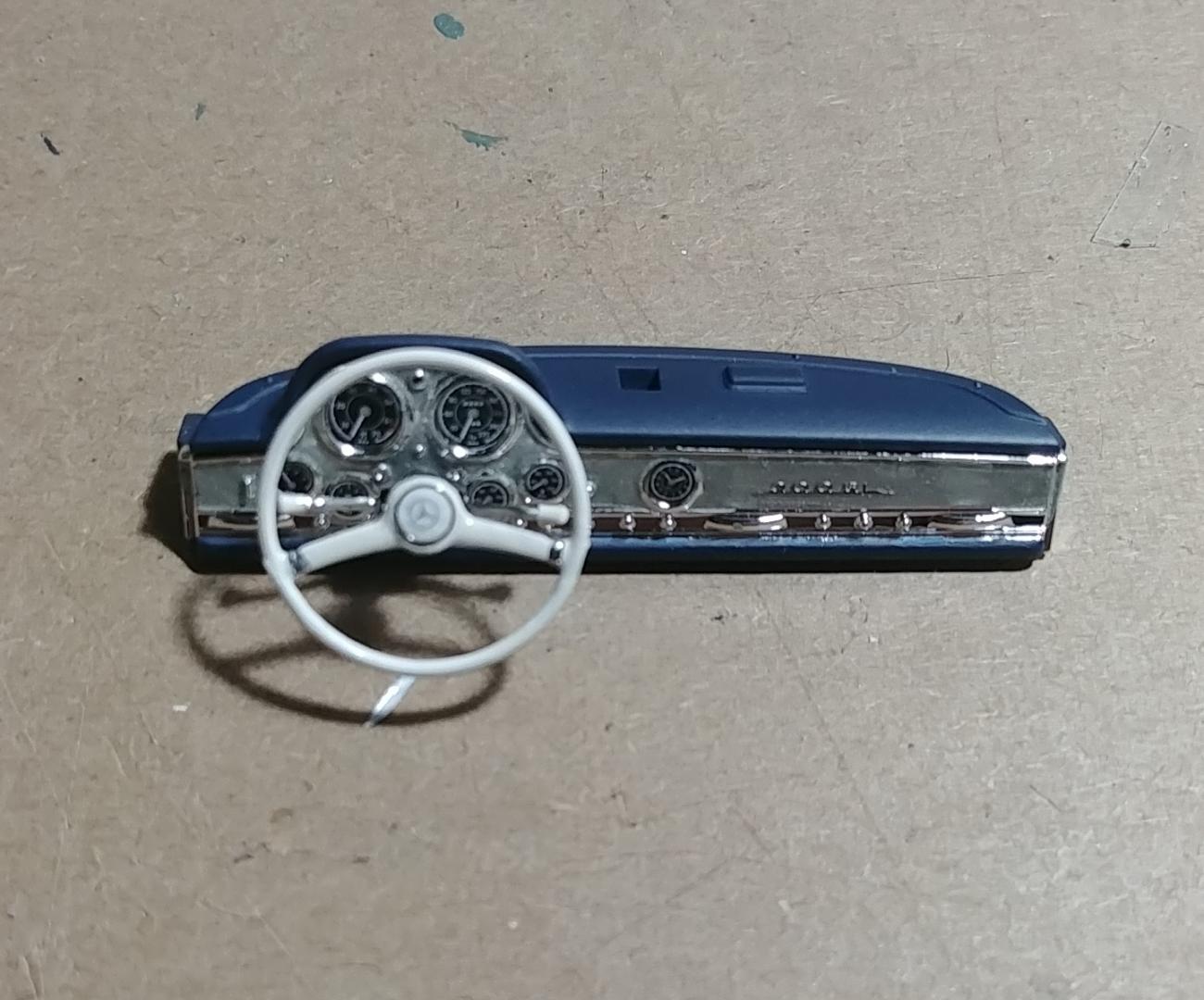

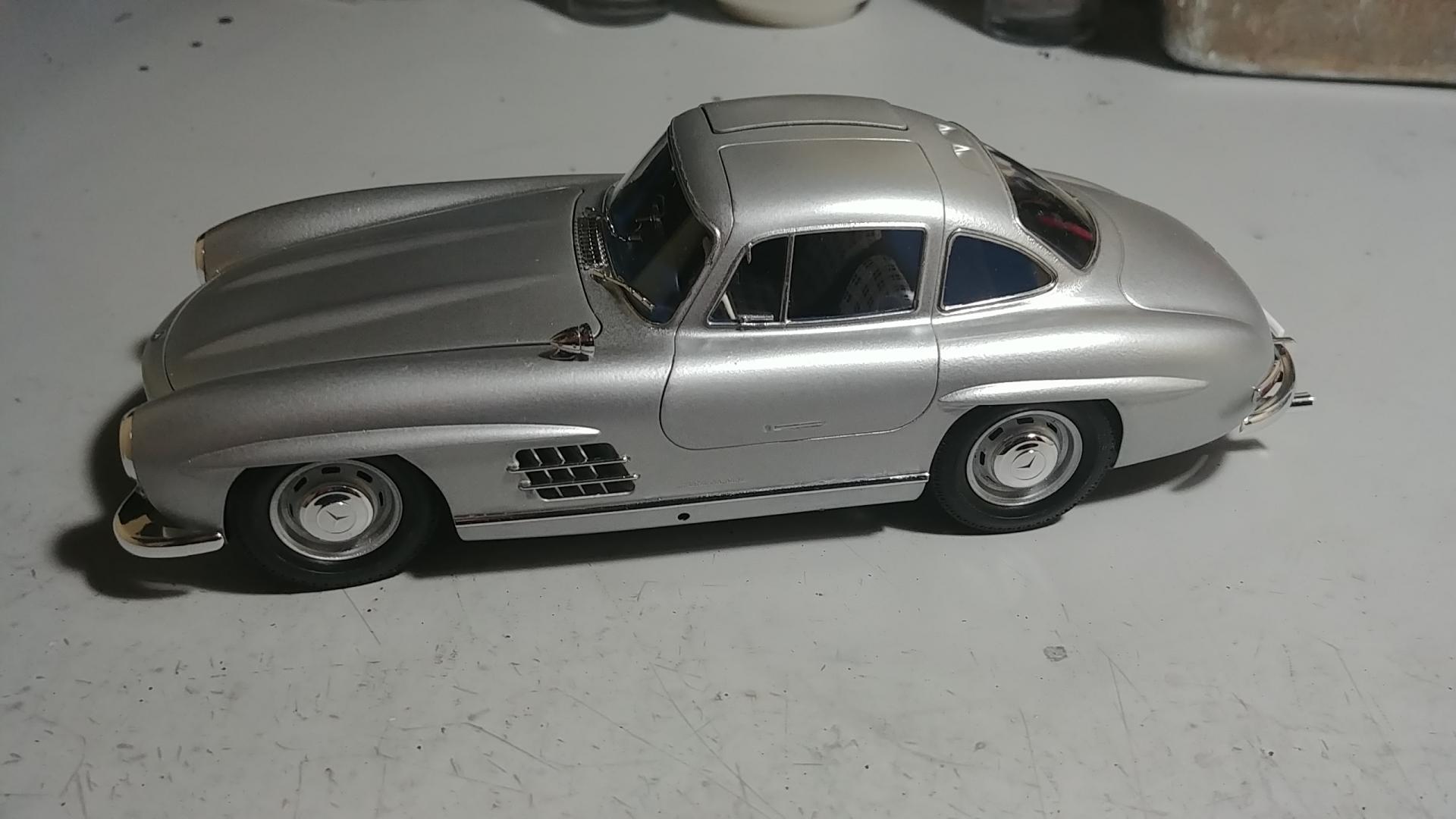

My wife bought this for me for Christmas and I've had a fair amount done for a while, but messed up the paint on the shell.  Therefore, the resulting silver didn't turn out so well.  My own fault though - and after three tries I simply settled for the final product.  However, I'm very happy with the rest of the model. 0303190752.thumb.jpg.f9a0b02f1e9aabf1615e883004bdf255.jpg0322191359.thumb.jpg.ebfdfa15416ad5ede96a1312f496664c.jpg0322191436.thumb.jpg.e524306fb6af0b5b39f62fecac030aa2.jpg0322191442.thumb.jpg.67e5820ee6b938413b826127c39d66f2.jpg0322191451e.thumb.jpg.8ba0adeb7fe3f94b722b32e12fcc0b50.jpg0322191451d.thumb.jpg.c3729d936329d08f6ab3357107bb7418.jpg0322191451c.thumb.jpg.ae6eb11e69717ee9b8dbde666f568ff5.jpg0322191442c.thumb.jpg.e54d6bae6fdb06d0a012549fefc4be54.jpg0322191452.thumb.jpg.6681e34662fca28c4aab56f9b174e94d.jpg0322191452a.thumb.jpg.c94ecfc12a58a793a4a83a4cde179140.jpg0322191441.thumb.jpg.14ae9c3ac52bb3ae4f24902d18f6e88b.jpg

Stunning build! I'd be very, very pleased with the paint finish on the kit's body.  The detail work on this build is spectacular!

I wish my paint jobs turned out half as good as yours, very nice.

Beautiful looking build. The interior really stands out and I like the way you posed the doors open.

Well done.  The dash is impressive.

Looks great. Like the seats.

The most important part, YOU FINISHED IT!  Silver is a PITA, so don't feel bad.  It took me 3 tries on the Mercedes 170V Roadster.  I'm tempted to get one of these kits every time I see one built.  Looks good!

Nice job man. What paint did you use for the silver? I've found that you can get better results with mica and metallic colors by color sanding your second to last coat of paint before clear coating it. You'll get the particles to lay down much smoother.

great looking build! i tend to leave clear chassis like that too - to show off all the detail!
the openings fit well...

Originally I used Testors Model Master - German Silver Metallic out of my airbrush.  Not sure if it was the paint or just me but the color had a very odd greenish hue to it that didn't go well with the blue interior.  I only did one coat.  I had some minor runs and cleaned it up.   At this point, with the enamel base, I looked for other enamels and made the poor decision to go with Testors Silver metallic in a can.  I needed it for a base for another model I'm doing Candy Apple Red, so I figured I'd give it a shot.  I liked the dullness of the finish and color overall, but it kept settling and pooling no matter how hard I tried to lay down smooth coats.  After cleaning it up a couple times, I shot one final coat.  You can see some bubbling in some of the crevices etc.  I finally said enough is enough.

You definitely want to ditch the testors enamel silver. Go for Tamiya Mica Silver or Gloss Aluminum for darker silvers. Vallejo has actually released an aerosol version of their silver. I ordered a can to see how close the scale of flake is. Will let you know how that goes.

Looks good and as others have said silver can be really difficult to lay down but I think you've done well.  I really like the interior, that dash looks great.

I think it still looks KILLER!!!!….love the blue interior too!!!

Looks great.  The interior detail is excellent.

Thanks for all the kind words everyone.  Yes - the interior is probably my favorite part of the build - and the engine compartment second.
