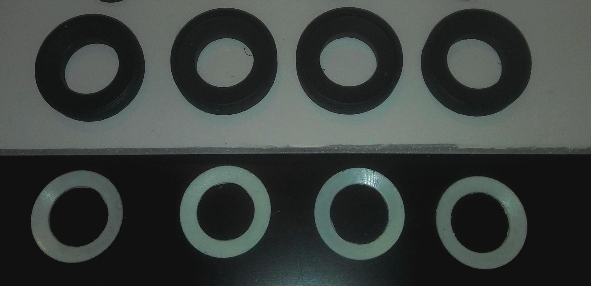

You can cast RTV rubber from a RTV rubber mould if you apply a coat of mould release.  It's how I made white rubber tires for my Pyro Mercer build.

If I don't need it, I don't make it. I need these Firestone wide white wall tires for my 30's projects. 1987749620_whitewall2.png.447984001eb2341bb421fc34684aa9d5.png484205859_widewhitewall.jpg.f62a4c3f70b61b8a0a3c01495f68bfbc.jpg551325317_widewhitewall1.thumb.jpg.a5bcec1aae68a0645a8efd14482eed7a.jpg
