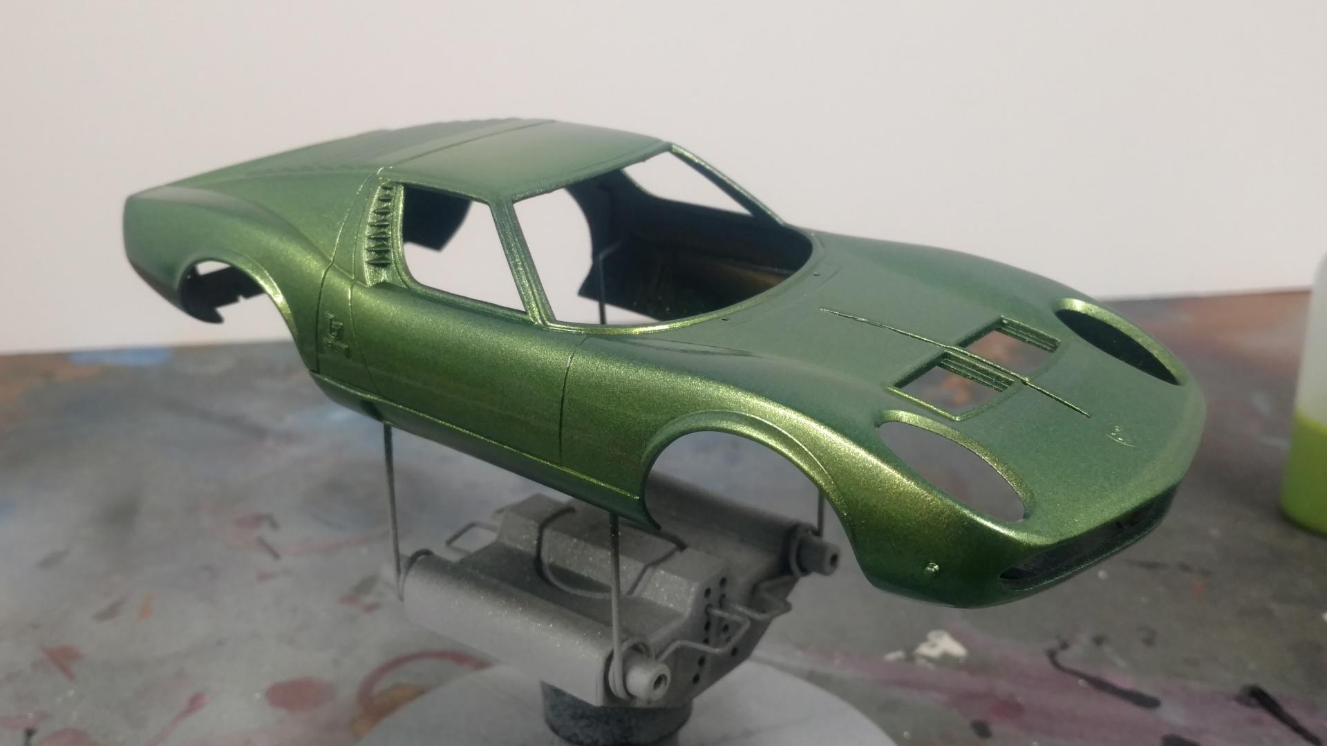

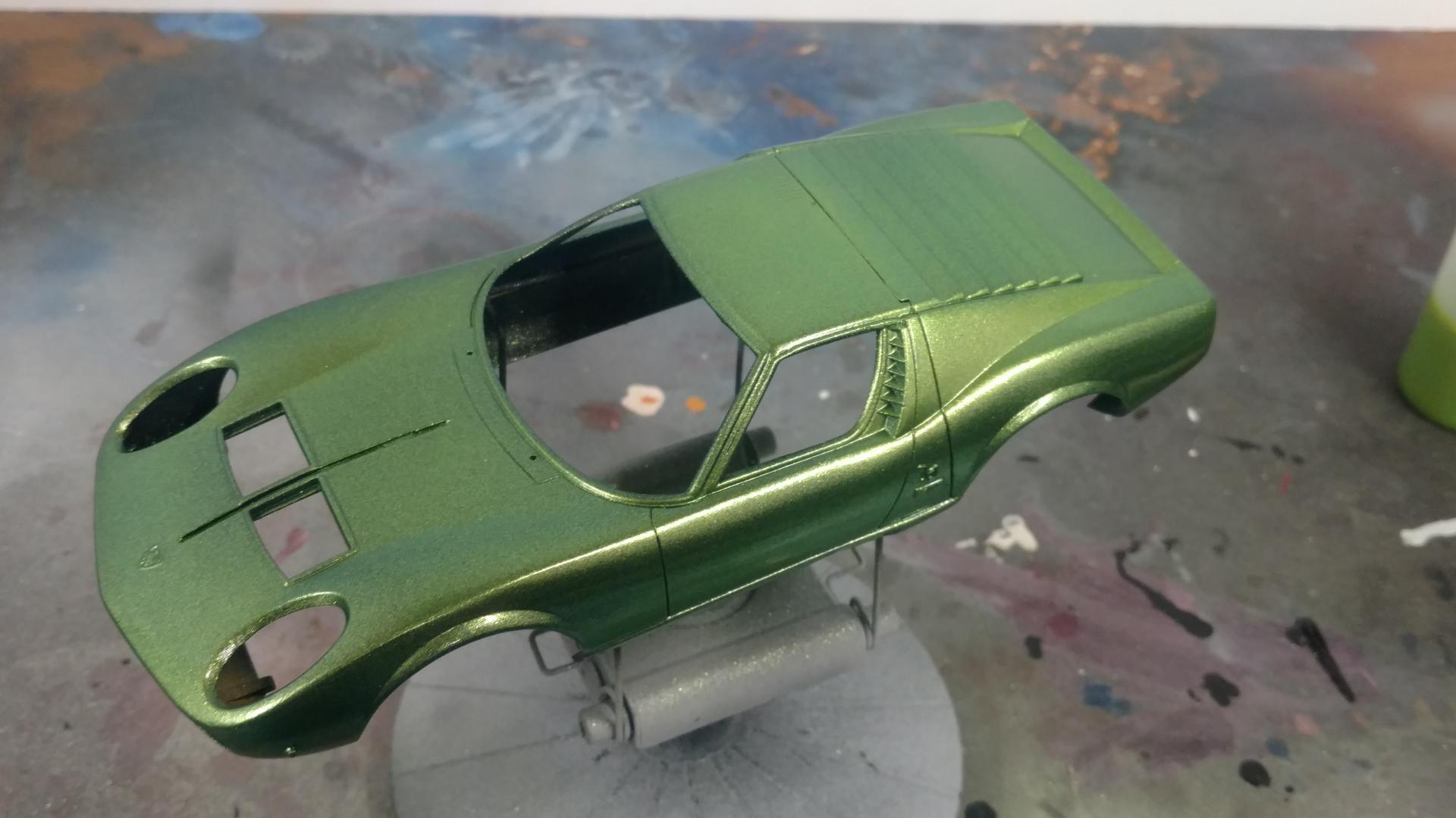

Another test paint job that turned out well!
I liked a color of nail polish I saw at the store while waiting for the wife to gather her H&BA goods.  It was pretty cheap, at $1.50 for 1/2oz jar (or there about).  It was called  Sassy Lassy (green metal flake) by Sinful Colors.
I quickly found out that it was a clear coat with green metal flake and no actual pigment, but pressed on...lol I made a pun...

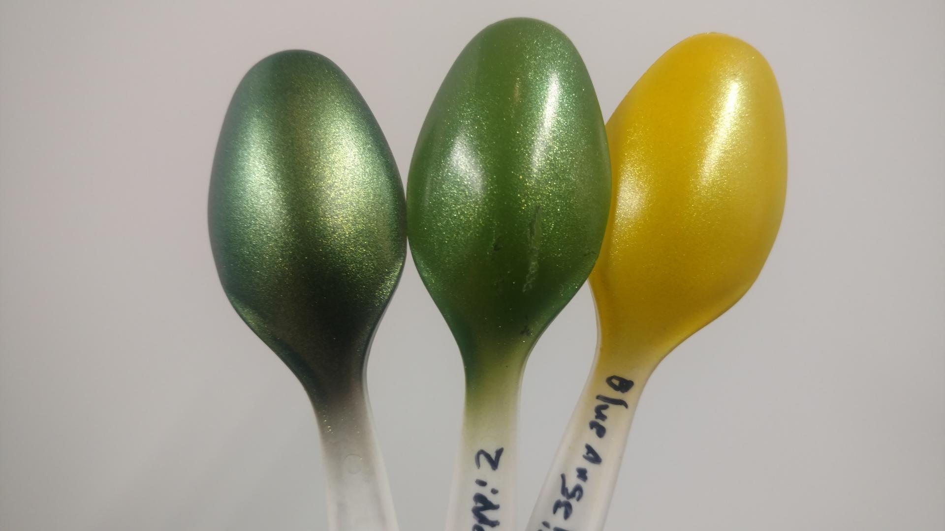

So, green flake over Testors Flat Black, over Model Master Green Zinc Chromate, and over Blue Angel Yellow.
The yellow, was first and OBVIOUSLY not green at all!  The Zinc Chromate was second (the middle spoon), so I tried the flat black and loved it.  So I mixed up the whole bottle about 30% paint to 70% lacquer thinner and shot at a very low pressure... about 15psi through my Paasche VL with #3 needle.  Found a kit that needed this color and tried it out.  This is what I got:

That looks promising- it deserves more photos after a few coats of clear.

VERY interesting indeed! Thanks for posting! B)

That looks great. If someone is looking for an unusual color just visit the Nail Polish isle.

Not the flashiest of colors, but it easily works for some stuff. I like your test subject. Looks like it sprayed well for you. What do you thin it with? and what psi do you usually shoot nail polish at?

An unusual colour but one that looks good on this Lambo.

The paint on the car turned out very nice.

Yes, I agree with Greg here. I would love to see what a couple coats of clear does to the Lambo and the spoons.

Sadly I was polishing the clear and there were some bumps in the base black, which came up through the paint as I was wet sanding and left black speckles everywhere.  I have wet sanded the whole car and will be spraying another coat of the green this evening, since I can't work on the real cars in the driveway.  Pics to come shortly.

I thinned this with a medium "temperature" lacquer thinner from Orilley Auto Parts.  I have used the Kleen Strip brand but it was too hot and would dry before hitting the body causing a very grainy texture.  Also it seems the Orilley stuff seems to mix into the paint as opposed to dissolving the carrier (if that makes sense), as the Kleen Strip brand does.
The pressure is very subjective with nail polish.  Most times you want a very low pressure and build up very thin coats, but with the size and quantity of flake in this paint, I had to crank up the pressure and REALLY open up the needle.  I used a #3 needle in my Paasche VL at about 25-30 PSI to keep it wet and flowing until it was on the car body.
