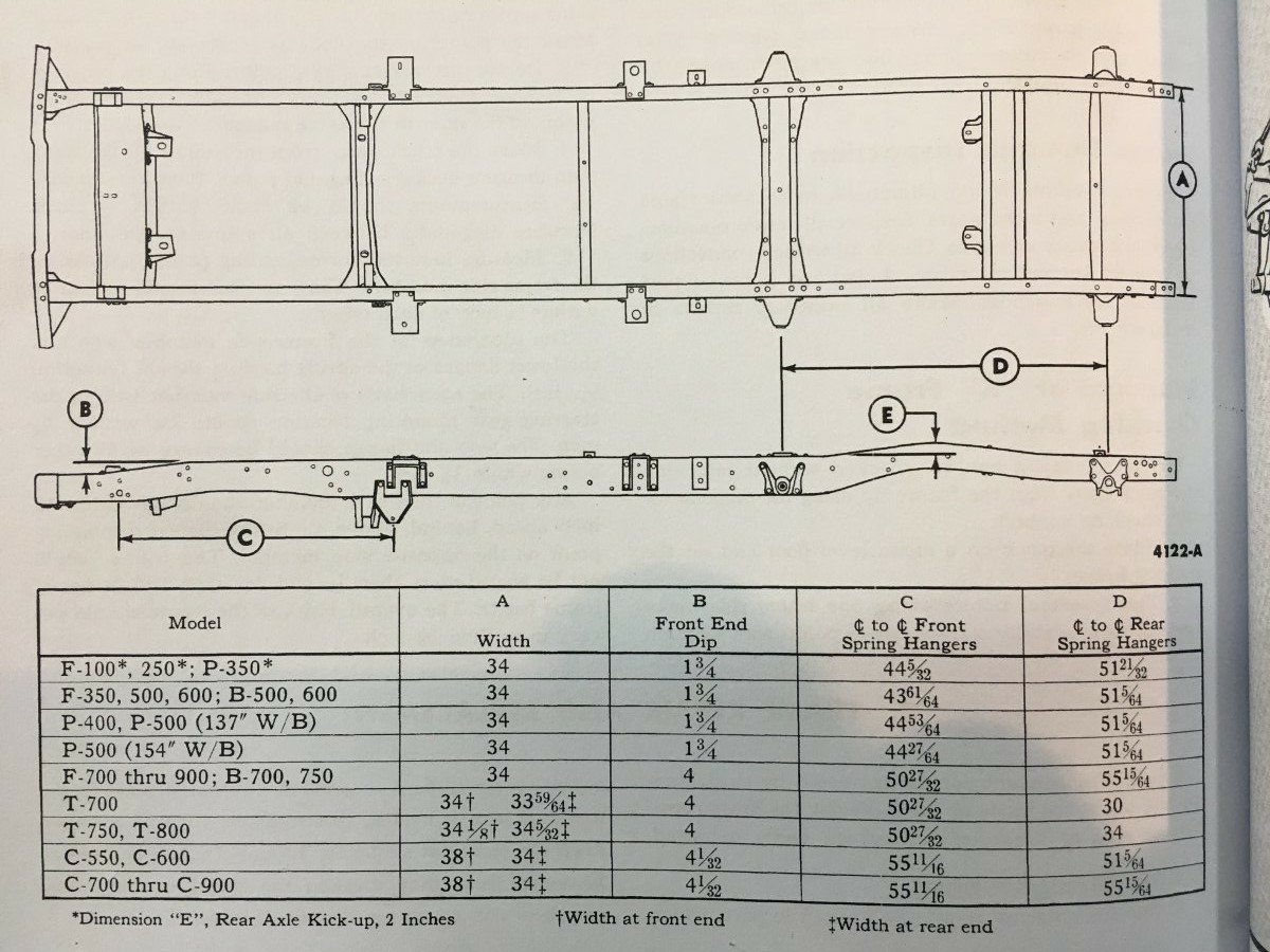

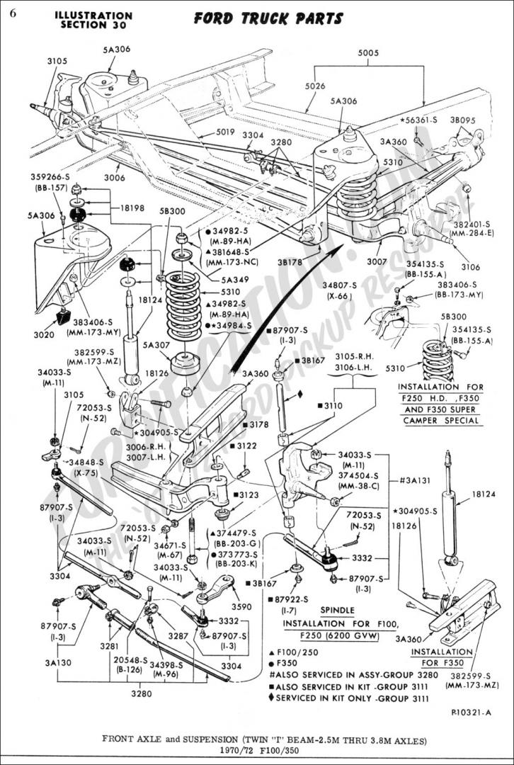

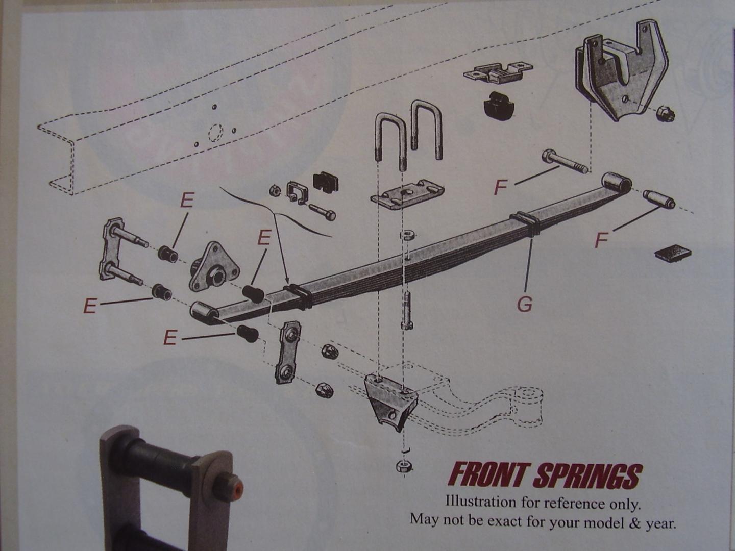

Here's the general front suspension layout for the single I-beam/leaf spring setup that Ford used on the light trucks until '64 (from the Carpenter '57-'66 catalog)
...and here's the general twin I-beam setup used from '65 - '79
...plus a 57-60 frame diagram
The '65/'66 moeb frames are going to be the same ones used in their '69 - '72 F-series.
Edited by mk11
Share this post
Link to post
