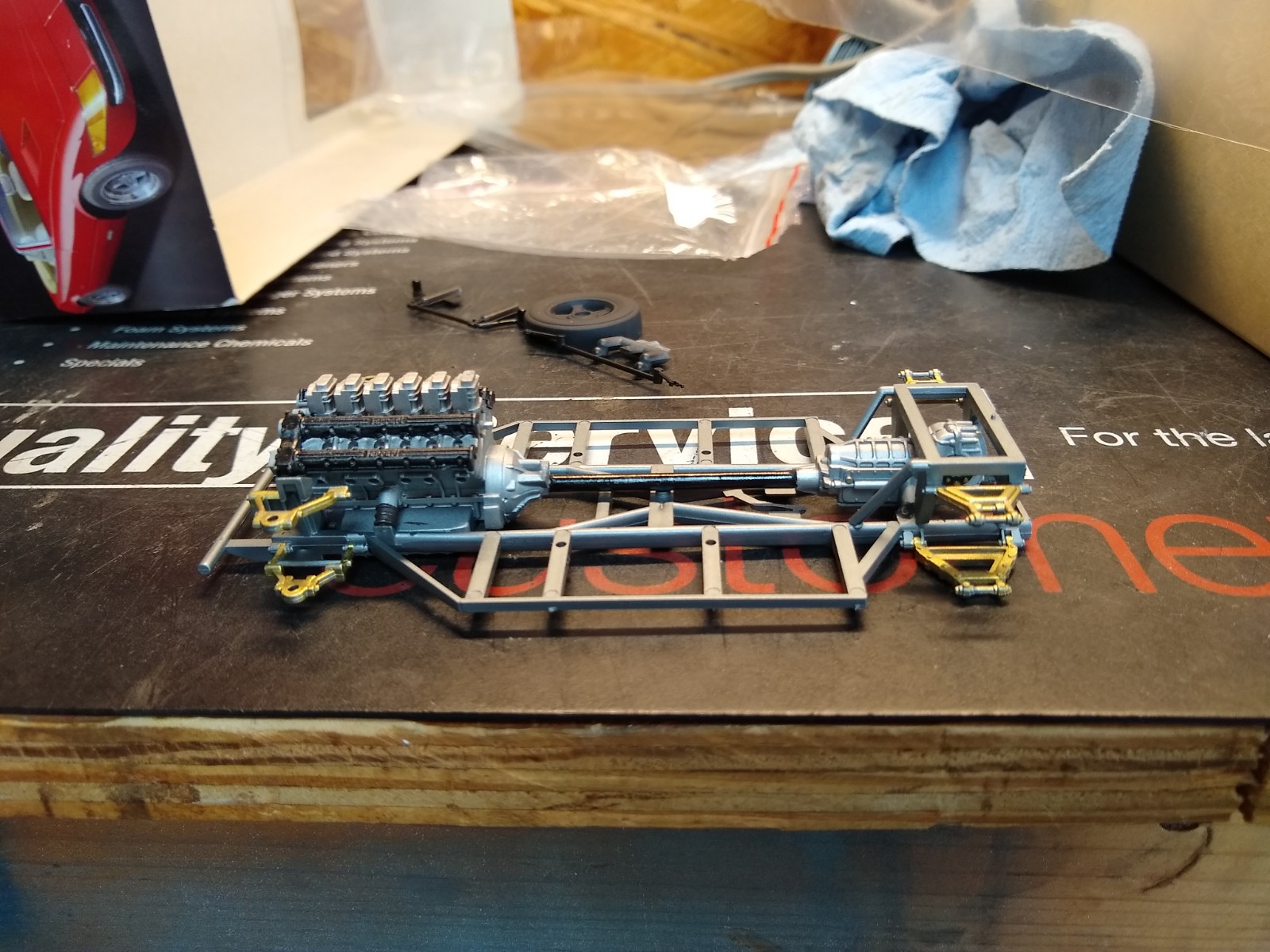

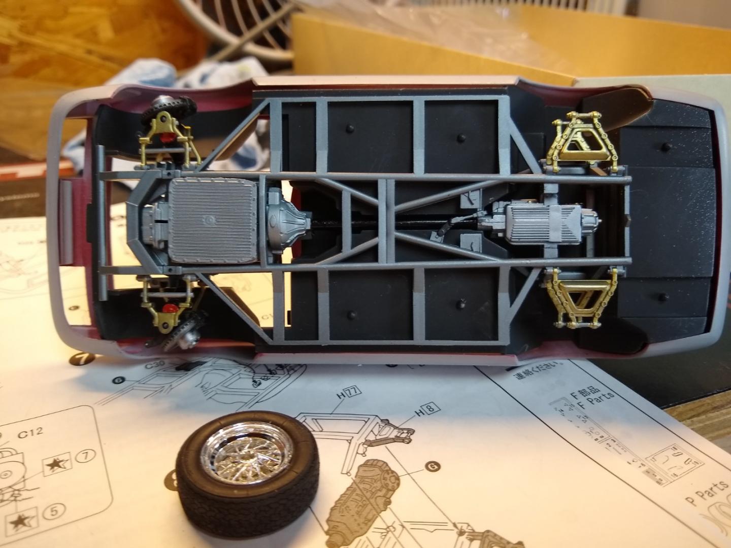

Building this one for a friend.   Such a nice kit I decided to try to make it my best build to date.   Spent a few hours smoothing out the waves and sinkmarks on the body.  Rescribed the lines sharper.  Went ahead and glued up the frame to have strong bonds where the crossmembers are joined.   My buddy collects diecasts mostly, so I have been putting lead sinker weights wherever possible.  The engine block is full.  Some in transaxle, fuell cells, and behind dash.   That will also help it to on all fours later.  I started photos late in process.

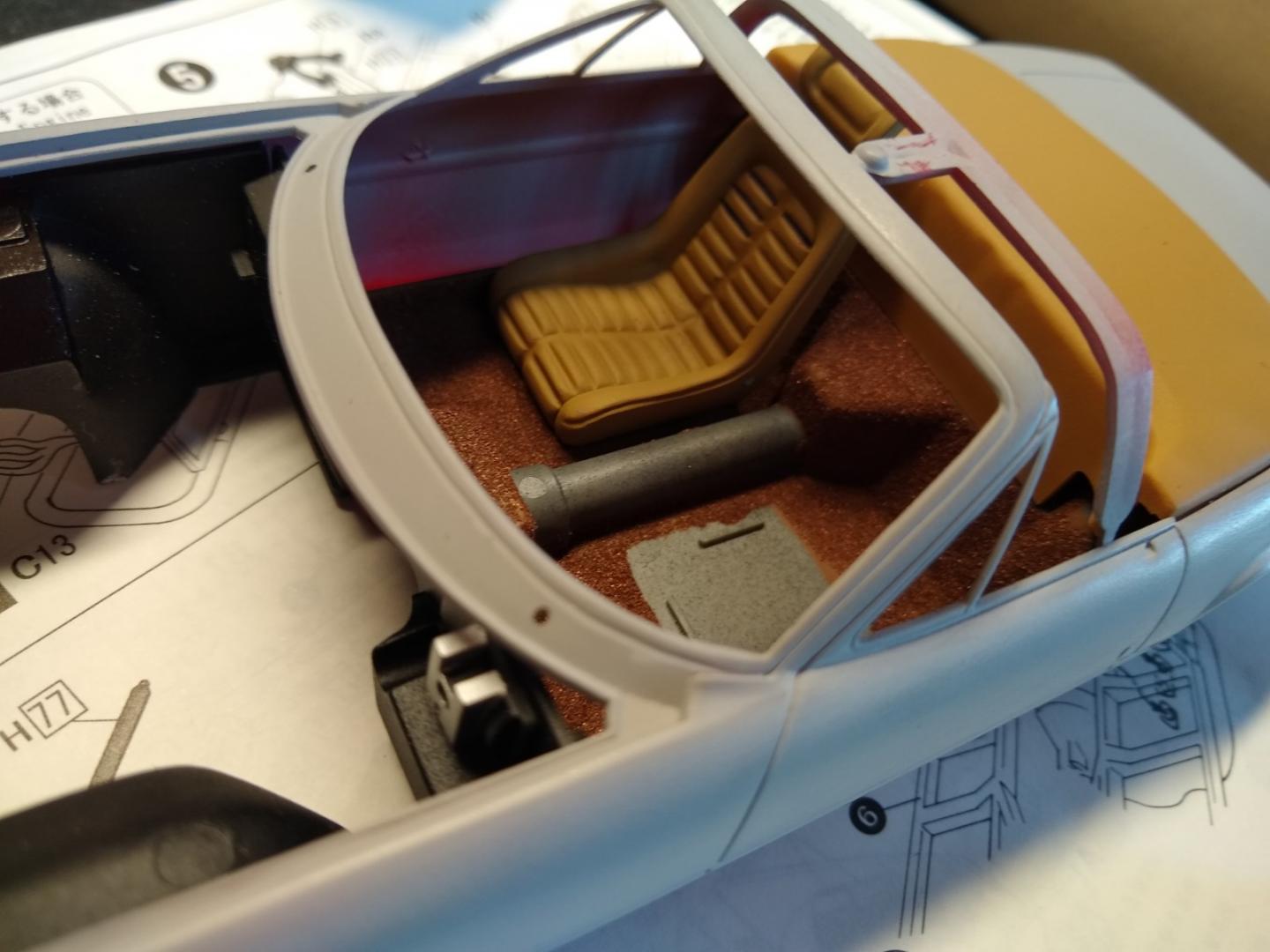

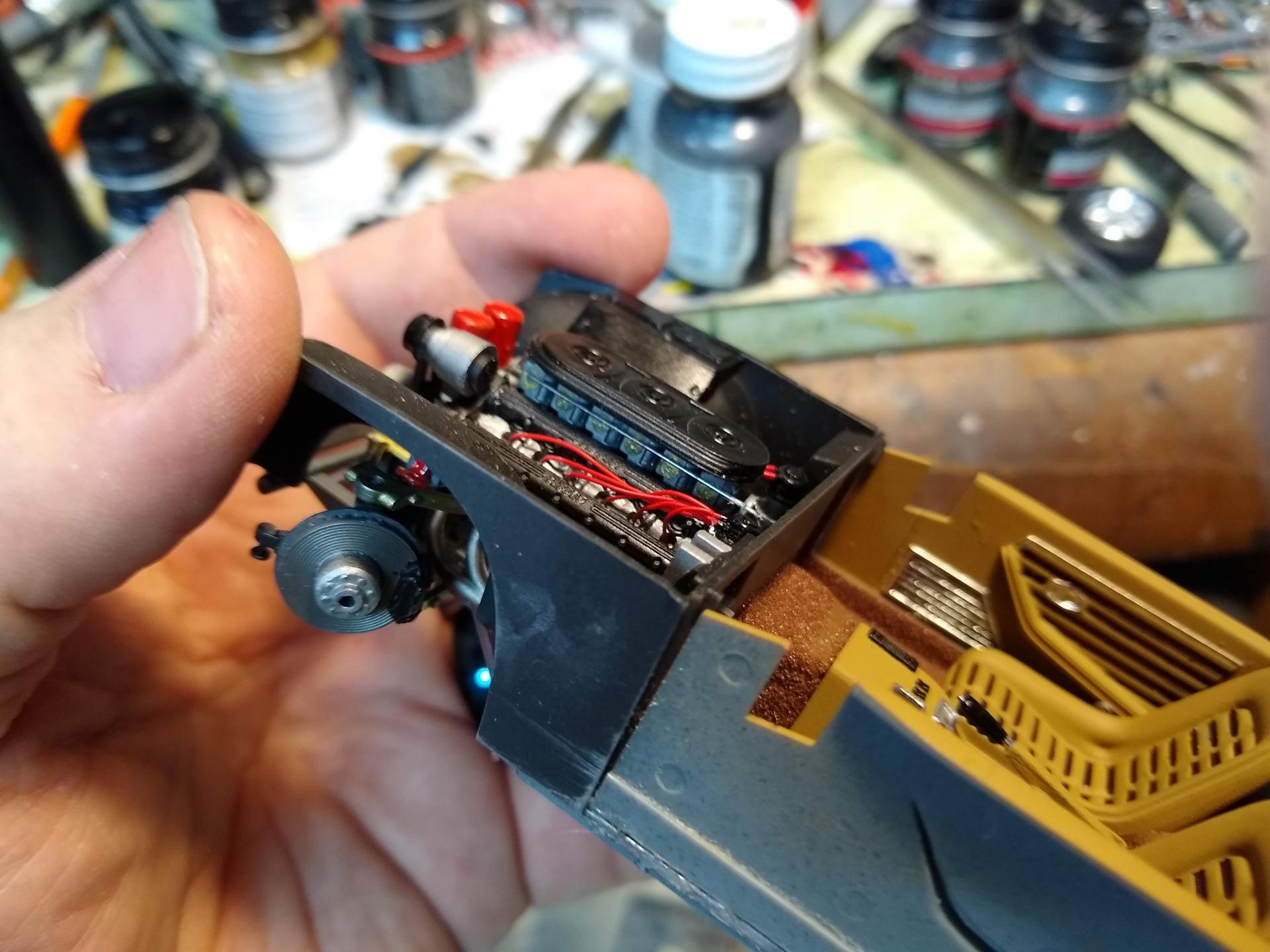

Embossing powder carpet.  Plug wires from a spool of red wire from Radio shack.   Not much else other than paint details and a quickie carb linkage from PE hood pin plate (yep) and a piece of guitar string.  I don;t have patience for more and that was plenty at this point.

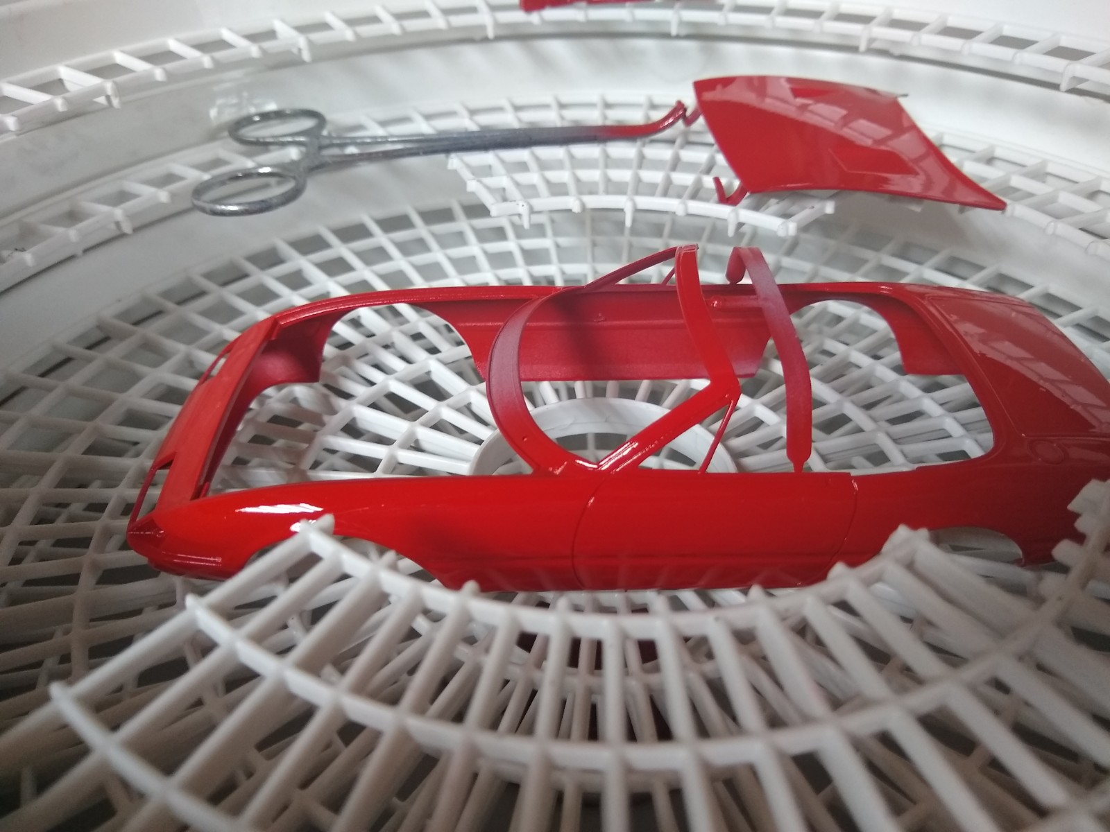

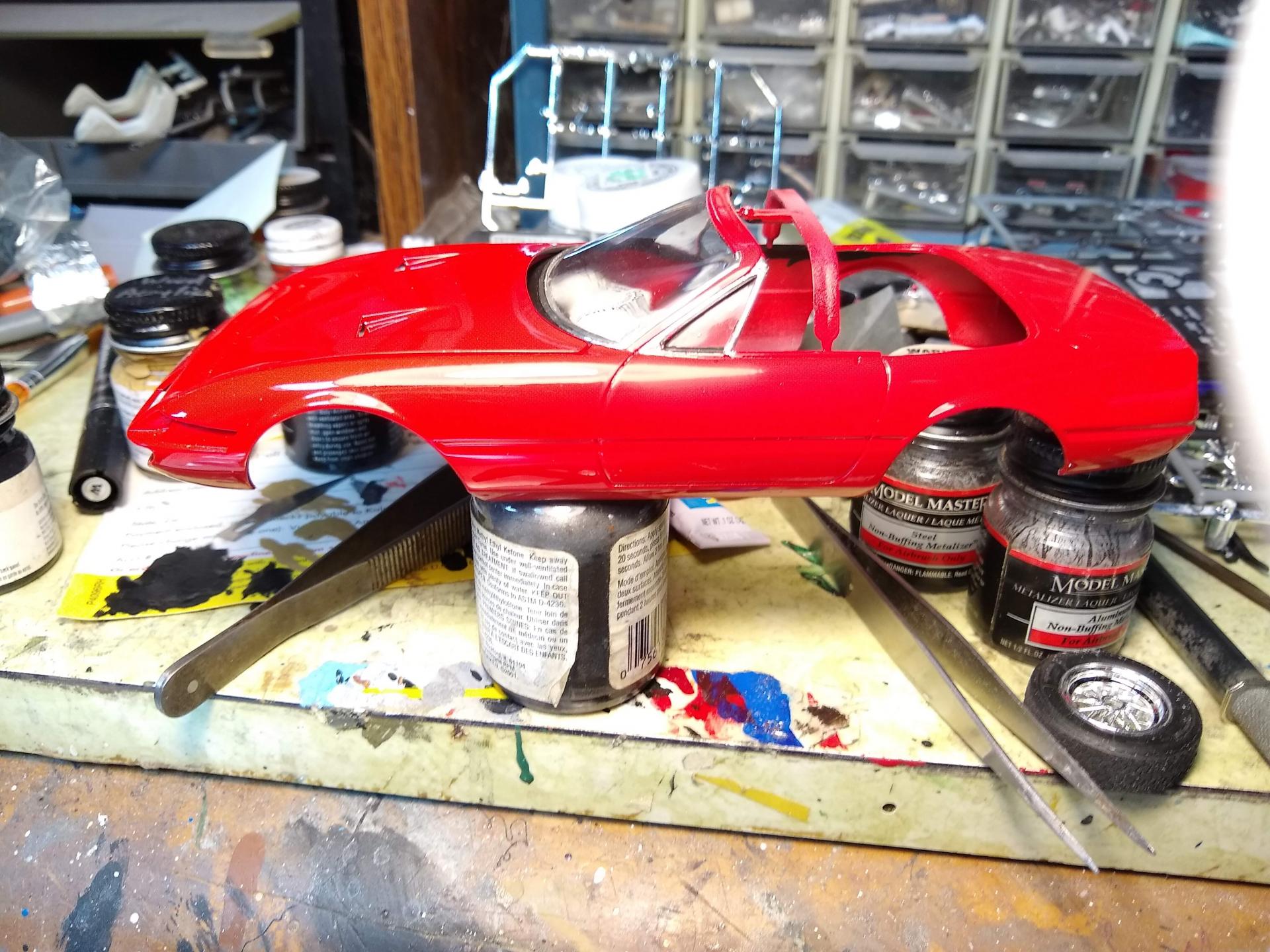

Paint is Rustoleum auto primer under Rustoleum Cherry Red from lowes.  Has some dust, dang it.   That's a shame because the paint laid down like glass.   I did my most extenxsive prep ever on this one and danged if all the experts aren't right.   The better the prep, the better the paint job.   I'll polish carefully, but going to let this one dry THOROUGHLY.   Red has been tough for me in the past.  I did let it dry in dehydrator for several hours yesterday.  IMG_20190406_154216945.thumb.jpg.4e67590a4060586a95d965fb1679727c.jpgIMG_20190407_153613034.thumb.jpg.a847aac0d40f6e3603cb0f1ed427976d.jpgIMG_20190407_153613034.thumb.jpg.a847aac0d40f6e3603cb0f1ed427976d.jpg

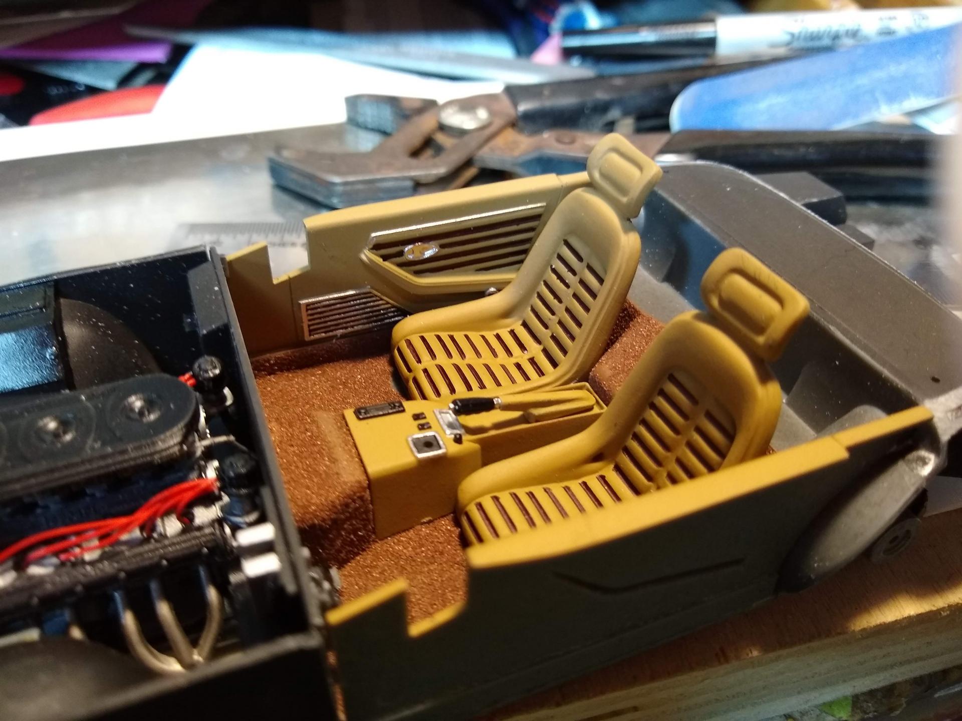

More photos.   Did the lines between the seat pads.   One of the fin point Sharpies worked well.  Saw that tip on another build of same car.  This is the paint before rubbing out.  Haven't started that process yet.  If it weren't for the dusties in it and if it were going to be mine, I probably wouldn't fool with it.   And started the foiling.  I do that differently than most, probably.   You can make out my quickie carb linkage.  Shoulda took a litttle motre effort, but it's done.

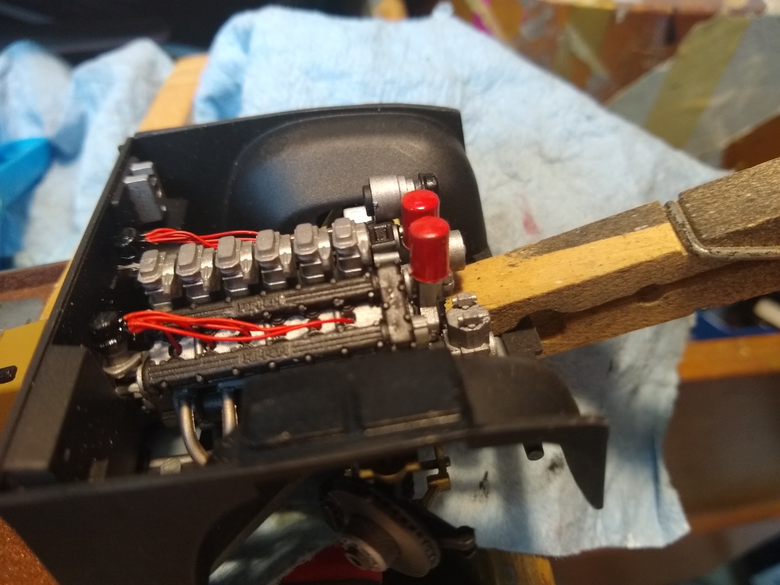

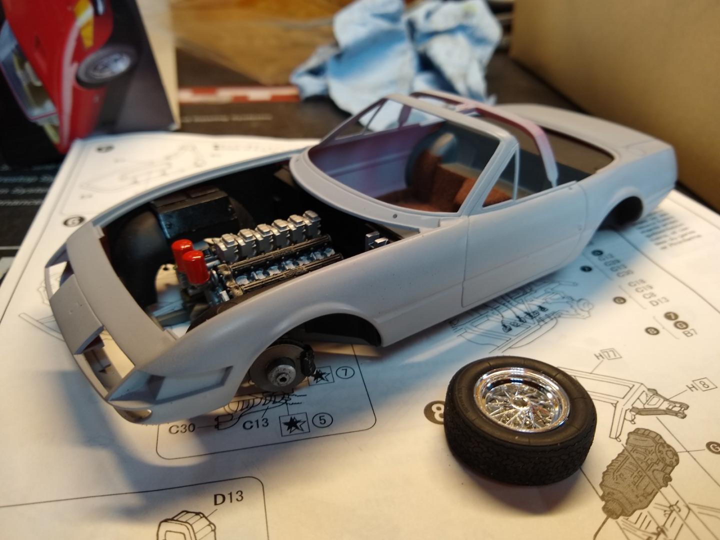

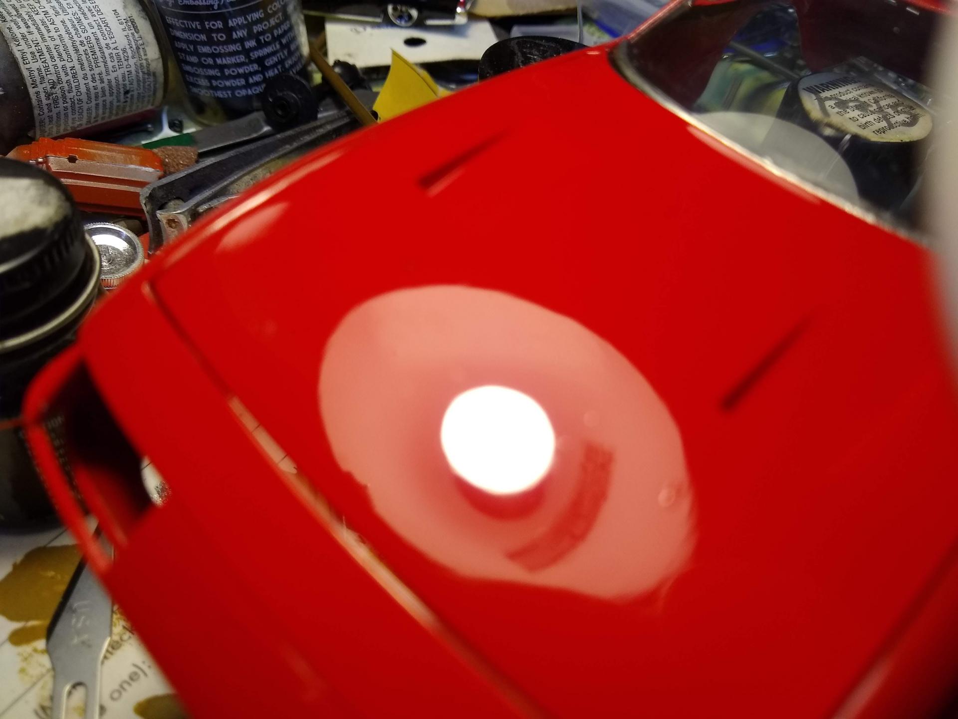

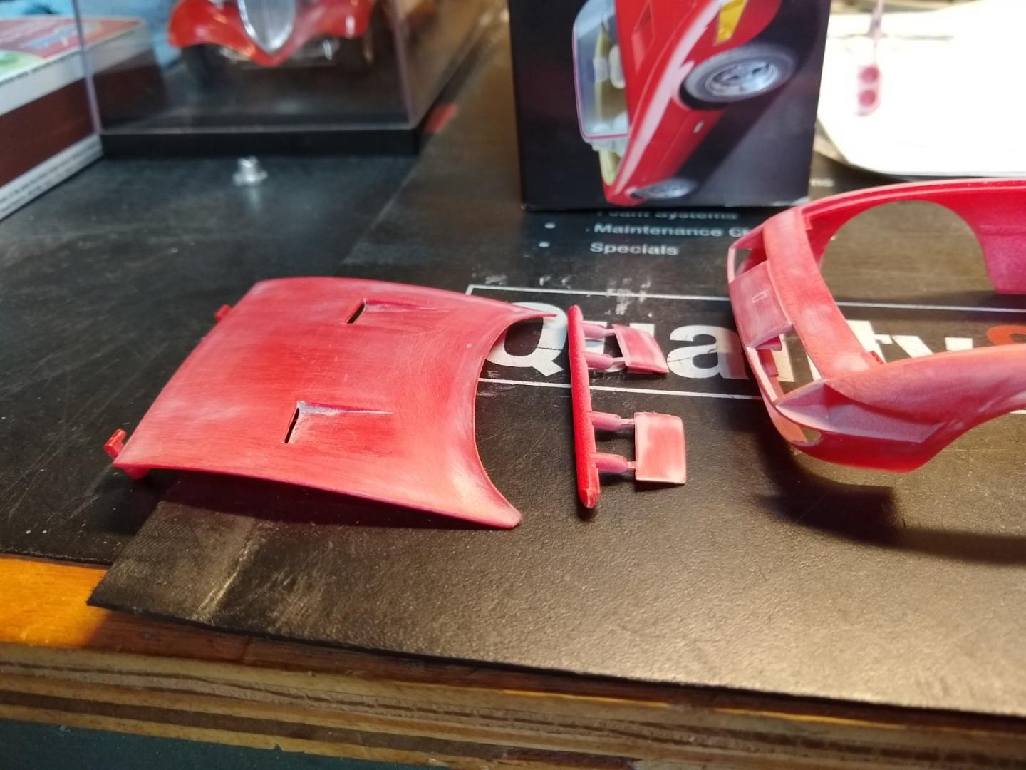

Some updated photos.  I'm still in the body on/off stage, making sure everything is fitting.   The headlights gave me a fit.   I assembled the headlight bar before paint to get a good cement bond.  Well, at time to fit, they weren't quite right, so I attempted to "persuade" the connecting bar a bit and it broke.   So I thought I'd replace it with metal rod only to realize I had no rod of the proper size.  Tried some wound guitar string and realized I couldn't get it to bend like I wanted.  So everything is pinned and glued back together.  It has a lazy eye that I need to see if I can adjust.  But the lights do raise and lower so I don't want to mess with it too much.  The covers fit pretty close to right when closed which is most important, I think.  The hood hinge also glued in place.   Insulation is gray primer, framework is silver sharpie.  Might try to make a prop rod.  Won't be prototypical, but may put on in for display.  I hope the guy I'm building it for doesn't mess with lights and hood too much.  Not the sturdiest assemblies.  If building this kit, tape the headlight covers in their PROPER place FIRST, then build the rest from below.  BUT, once you glue the covers to the light housings, it does not come back out.  Be warned.
When I put the dash decal on, the decals tried to crumble.  So I sprayed some clear lacquer over them.   Went to put the steering wheel emblem on and it still crumbled.  So I carefully brushed some clear enamel over them.   We'll try that again later.  The horn button also didn't have any backing behind the yellow so it wasn't going to work anyway - too translucent.  So I painted a dot on the wheel and will try to make an approximation of the horse on it later.   There is also a decal that looks like the choke control for the console.  Some photos of real car have it and some don't, so if it falls apart, no big deal.  It will probably be next decal I try to see if the decals work better.  Trying to not mess up the body decals till I get them to stay together.  I really need the body decals to stay together.  Wish I has some of that decal film stuff - microscale?  If hte enamel doesn't work, I may try a thin coat of kristal kleer.
The turn signals are a combination of TS yellow and Boyds Orange. Testors TS yellow is just too yellow, but orange sharpie was too orange for the fronts.   Black sharpie around edges to define the gasket that is in photos of real car.   The taillights will likely be orange sharpie.
With the lead weights in it, it feels hefty.  The wheels screw on and I'm getting excited about getting to the point where I can install them.   Of course, I still have to build the other three.  I put that one in place to check clearances and such.   The chassis will have to be placed carefully and correctly to get the wheels right in their openings and already sanded the face of the brake disc hat to get the rears inside just a touch more.
Paint has been polished out but will still need one more good cleaning when it's done being handled so much.  Someone on a FB group said Rustoleum is trash and no good.  I'd have to disagree in this case.  Paint is shiny.  Nice and hard too.
Radiator and engine room details will likely be next.  One tip - when building a kit like this, do your bolt heads BEFORE putting too much detail in.  I waited too late and was hard or unable to get to all of the engine bolt heads.  Also, put a piece of tape behind the tiny parts to keep them from flying into space.  Haven't lost anything yet.  Did break turn signal off cutting from sprue - should have cut them before the big attachments.  Drilled and glued back in place.  Happy to say still haven't lost any parts on this one.  Knock wood.  Thanks for looking.   We'll see where we get to next.

Randy, I built this one many years ago and just a bit of a caution.......before you mount the wheels permanently, you may want to file the hubs down just a bit. I found my wheels to stick too close to the edge, whereas on the actual car they're slightly inboard.

I think I saw your note about the wheels on another thread.  I have already filed the faces of the rears off.   May go a little more when I get to that point.   And will check fronts for sure.  I have had a blast building this one, even though it ultimately lives with someone else when complete.   I'll gladly build more of these for others!  LOL
