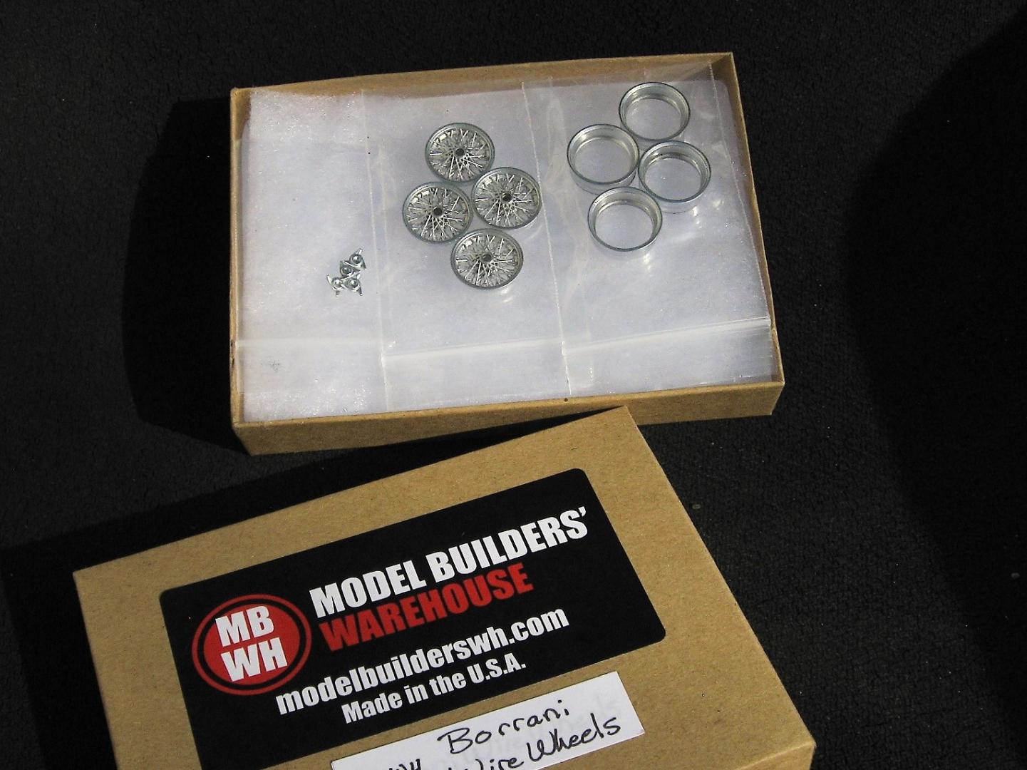

1 hour ago, cooltoys1 said:
... I know it needs better wire wheels, so im after that, any thoughts?
3D printed...I've seen 'em in person, and they're pretty damm fine. They even have the adjustment nuts on the rim-end of the spokes. Not even the best of the hand-laced wheels have that (other than some done by...I believe...Pico Elgin, that have printed rims including nuts, and actual wire spokes).

Bill - I cant wait to get my hands on some of those MBW wire wheels - where did you get them???
It's right on the box in the phpto. :D
Contact Randy Ditton for more information:
(970)-817-4985

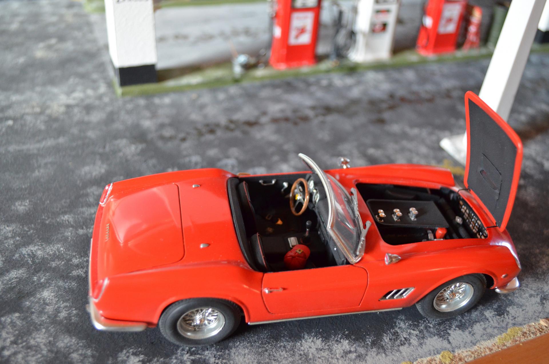

<<  As you can see, I've built it!  I used Replicas & Miniatures of Maryland seats and door panels, the kit seats really suck.  I have a Herb Deeks photo-etch set, didn't like the cast metal rims, but used the tires (kit tires are horrible).  Because it's for a diorama, I didn't detail the engine, but I have the R & M engine kit too.  I corrected the side vents.  I also vacuum-formed headlight covers and detailed with aluminum tape.  Added mirrors from two different kits so had to modify to match.  R & M steering wheel, that has real wood rim.  I did a few other details.  I picked up another kit last year at Desert Scale.  I've bought K A Details p-e and turned aluminum rims for the 250 GTO, think they would look good on this.
While without a doubt the overall fidelity of these wheels is amazing, every time I look at them, there is something off about them.  I think the spokes seem a bit too chunky when compared to photoetched or metal wire wheels.
Share this post
Link to post
Yes, I believe the diameter of the wires may be a little thick. However, there are always trade-offs...almost always, at this point anyway.
Most PE-center wheels have the wires sandwiched between the rim halves, which looks wrong to anyone familiar with real wire wheels.
Likewise, most hand-laced wires that are built on a jig ultimately have the rims assembled around them as a sandwich too.
The only way to get scale-correct individual wires, with the wires oriented correctly relative to the rims (at this time) is to hand-fit individual wire spokes into drilled rims, or into 3D printed rims that have .010" holes made into the rims as they're printed. I believe only Pico has done this type so far. He was certainly one of the first, several years ago.
If you want to get REALLY technical, Ferrari Borranii wheels usually had polished alloy rims and chromed-steel spokes. Replicating the subtle but definitely noticeable difference between the appearance of the two materials is a challenge I'll leave to modelers far more ambitious than I'll likely ever be.
I agree 100%! The correct interleaving of the spokes cannot be done with photoetched spoke discs.  That is something that the 3D printing handles well already. I think give it some time for the technology to improve and the printers will be able to print thinner (properly scaled) spokes.  We're almost there!
