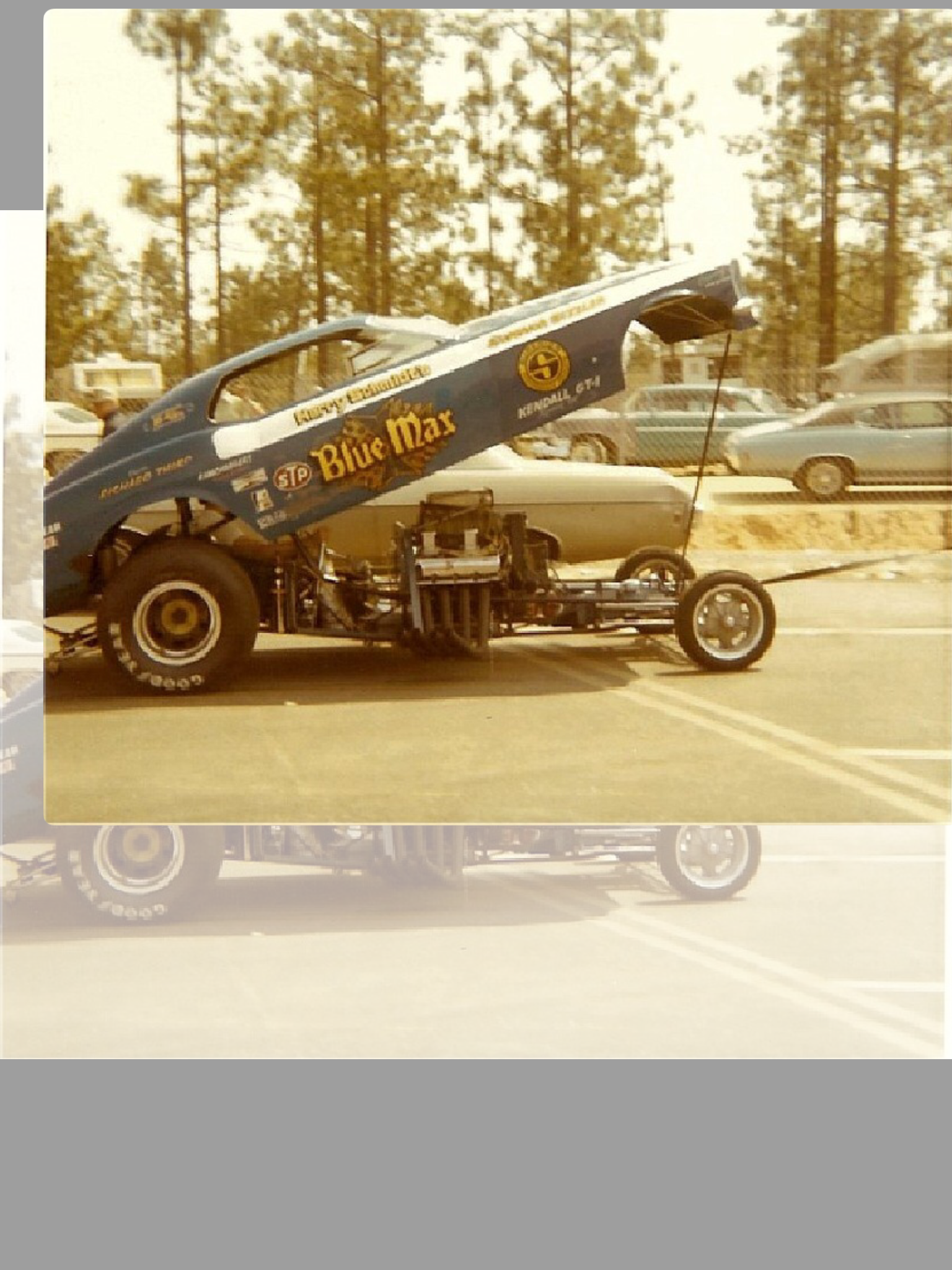

Hi All, I'm putting out a call for some reference help to get more info or pics of a 69 Don Hardy chassis. My next builds I want to do are the first and last Blue Max funny cars . I'm starting the first Blue Max car with the Polar lights kit and the chassis supplied is not what was under the body. The only pic I could find is pretty grainy and I could use some help with more info. The body has some fixing to do, front air dam, cut door panel lines, fill out side vents a little and add a center-line detail on top of the hood. Any help I would be very grateful.

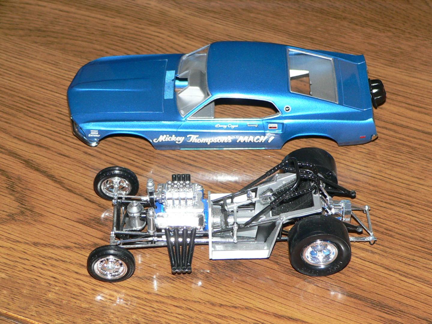

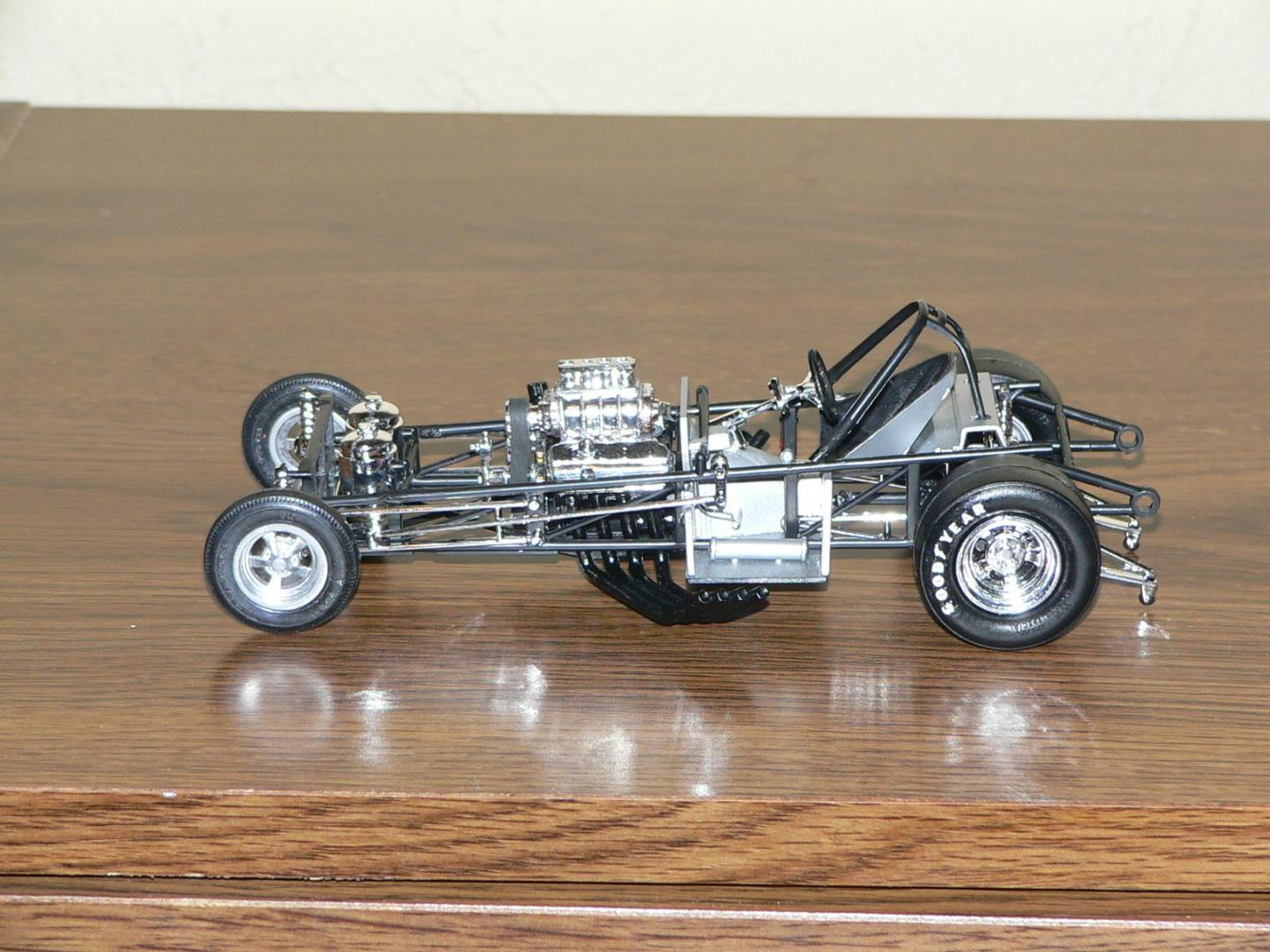

The Johan Mustang FC and Pinto FC had the 1/25th Don Hardy chassis of which you speak (a later version), but they are pricy. The Monogram Cop Out FC is also close and much more available but it is in 1/24th scale.

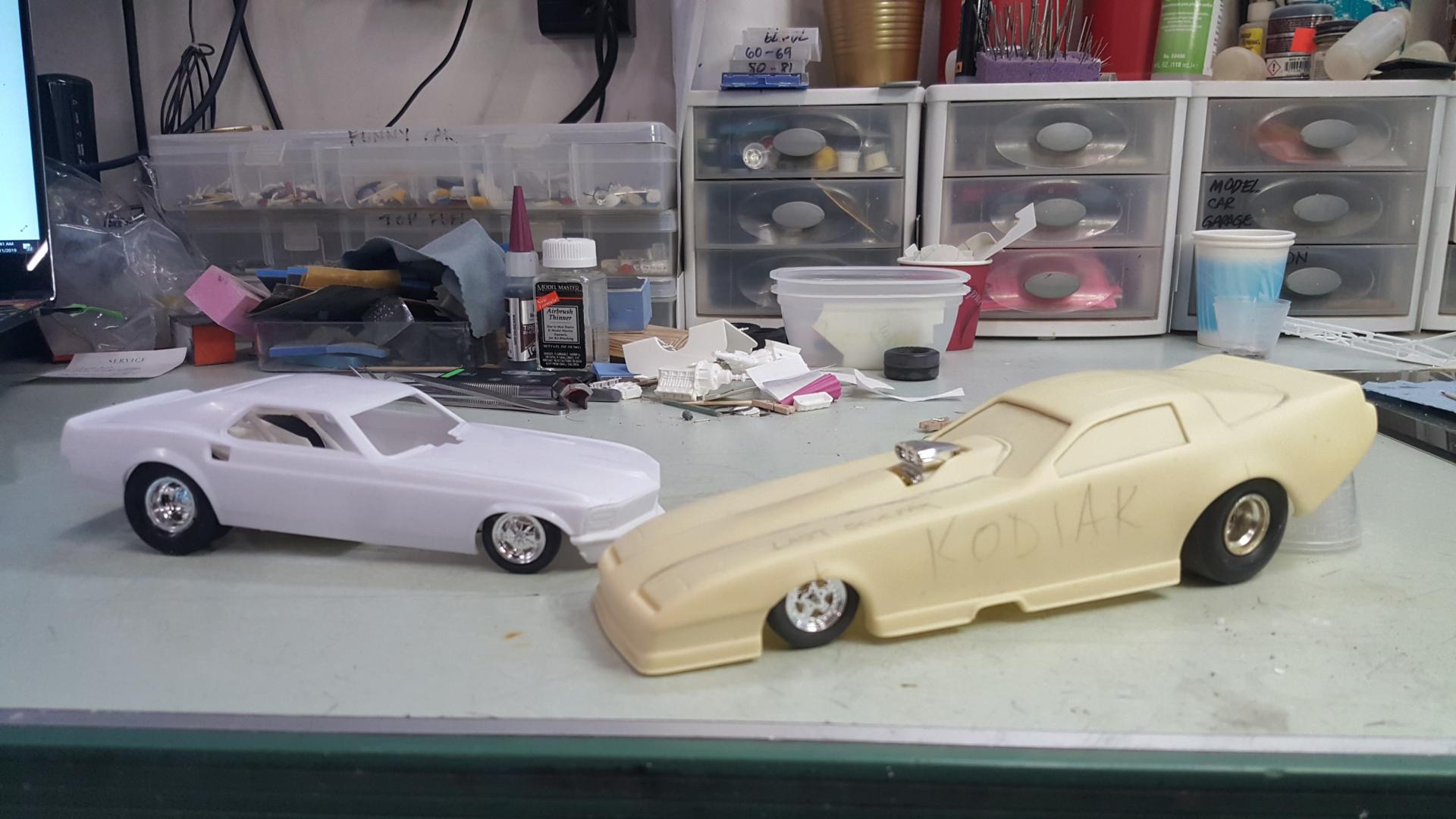

I think the body I have is a rework of the monogram kit, body lines,are all different, same wheelbase. The roof seems a little too low but I'll take a closer look when I get to it,maybe remold it
Link to comment
Yes most likely, the Monogram body is the first version of the Firebird Trans Am body used in the mid 80's, but the racers later modified the Trans Am body with a longer nose and some aero improvements.
Don "Snake" Prudhomme used the first version of that body style from 1982 to 1985 and the later version with the longer nose 1987 to 1989.
