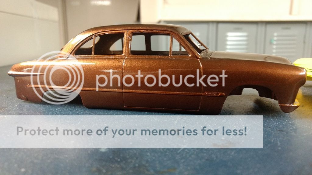

I stretched the roof of a 49 Coupe to make a 50 Sedan using measurements from my cousin's 1:1 50 Sedan. It's not difficult to do. I kept the 50 trunk hinges but haven't messed with the rest because it will be a VERY mild custom.
http://DSCN4524.jpg
http://DSCN4523.jpg
http://IMG_20190322_071522191.jpg
Later-

I have often wondered myself could this be done , especially given the Coupe roof .
Share this post
Link to post
Quite doable if you lengthened the roof in the right place; I remember the Modelhaus (and possibly another caster) made a beautiful conversion body for the '50 Crestliner two-door sedan.
I had a conversion started for the Turnupseed '50 coupe and can at least say everything lined up.

Thank you very much for the kind words. Without, hopefully, getting a swelled head, I am very proud of how it turned out. It helped to be able to get the measurements from the 1:1. Now if I could just get off my lazy butt and finish it.
Later-
