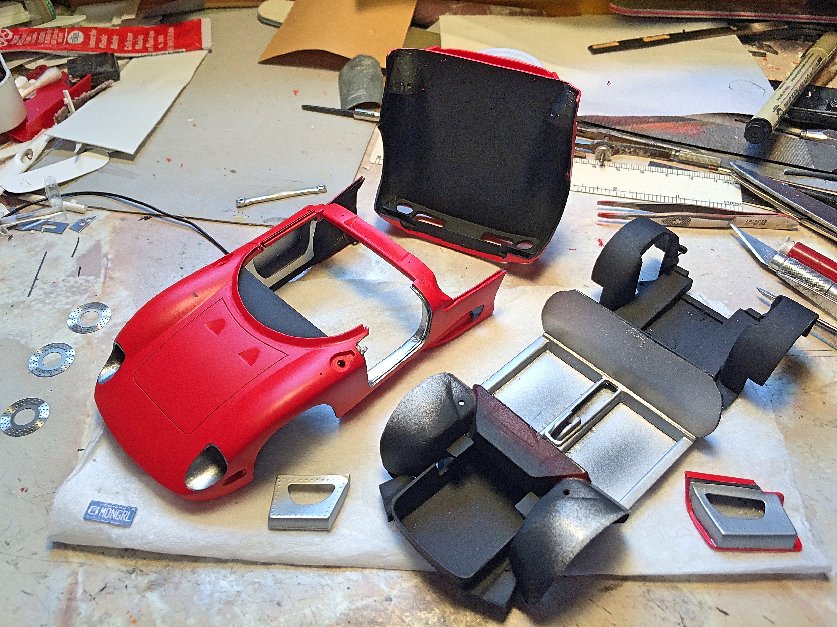

I'm up early this morning, in total obsession possessed mode.  Came up with a name, MONGREL:
Definition of mongrel
1: an individual resulting from the interbreeding of diverse breeds (see BREEDentry 2 sense 1) or strains (see STRAIN entry 1 sense 1)especially : one of unknown ancestry She owns several dogs, one of which is a mongrel.
2: a cross between types of persons or things the cinema is … a mongrel of virtually all the other arts
I Needed a license plate, used the AZ Motor Vehicle Division website to almost order it, nobody happens to have this.  LOL  Modified using the Fotor app.

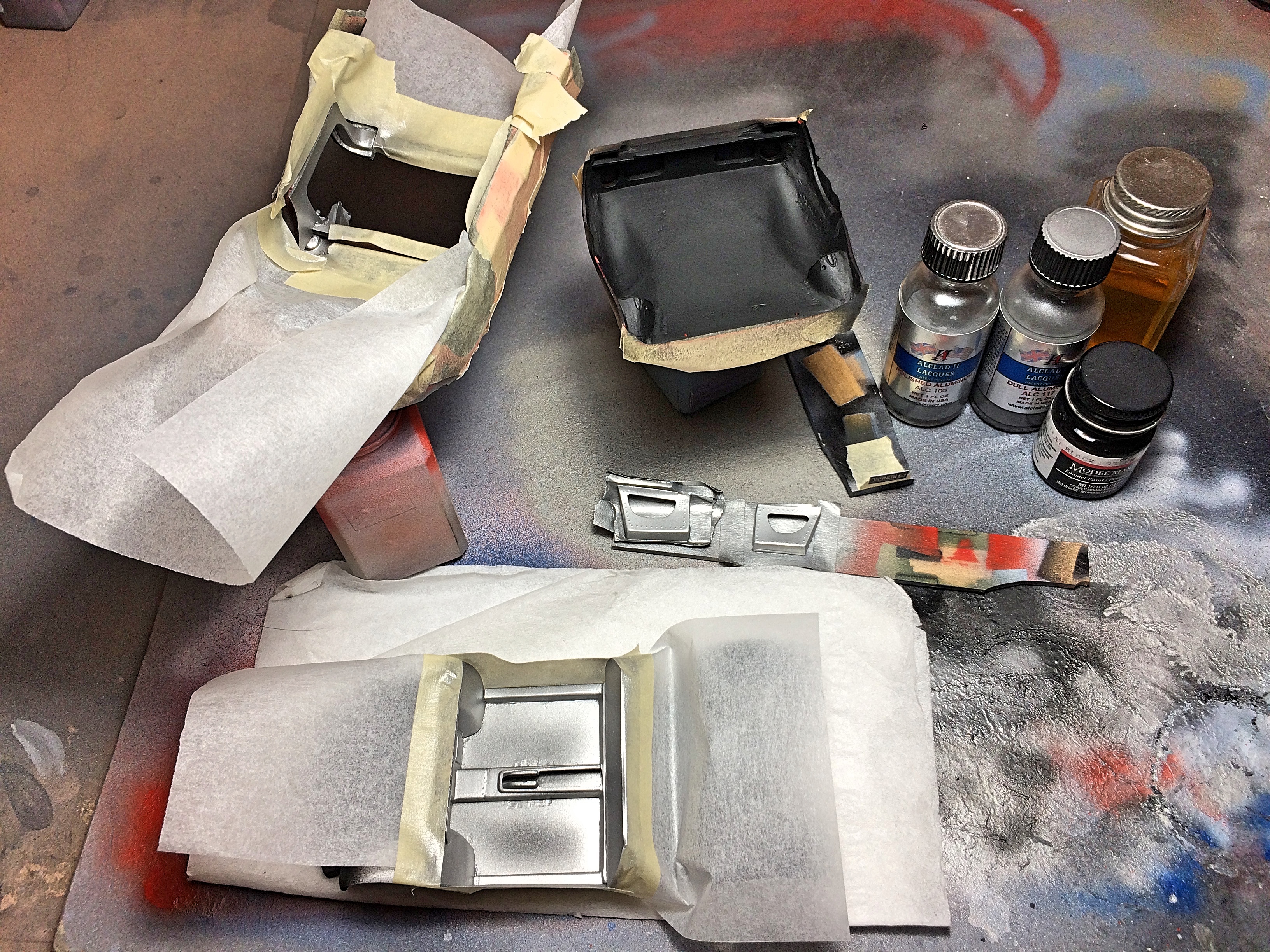

Since I have to eat, posting progress while frozen pizza is baking.  Last paint was doing inside the body flat black, and then the interior aluminum.  Then I could start final assembly!
Lots of masking, I'm lucky no paint peeled off with the masking tape.  I had one tiny gap in the tape that got nailed, and some around the edges.  I used Alclad matt aluminum at first, then changed to polished aluminum because I didn't like it that matt!  Glad the work with the rivets shows up.
Unmasked.

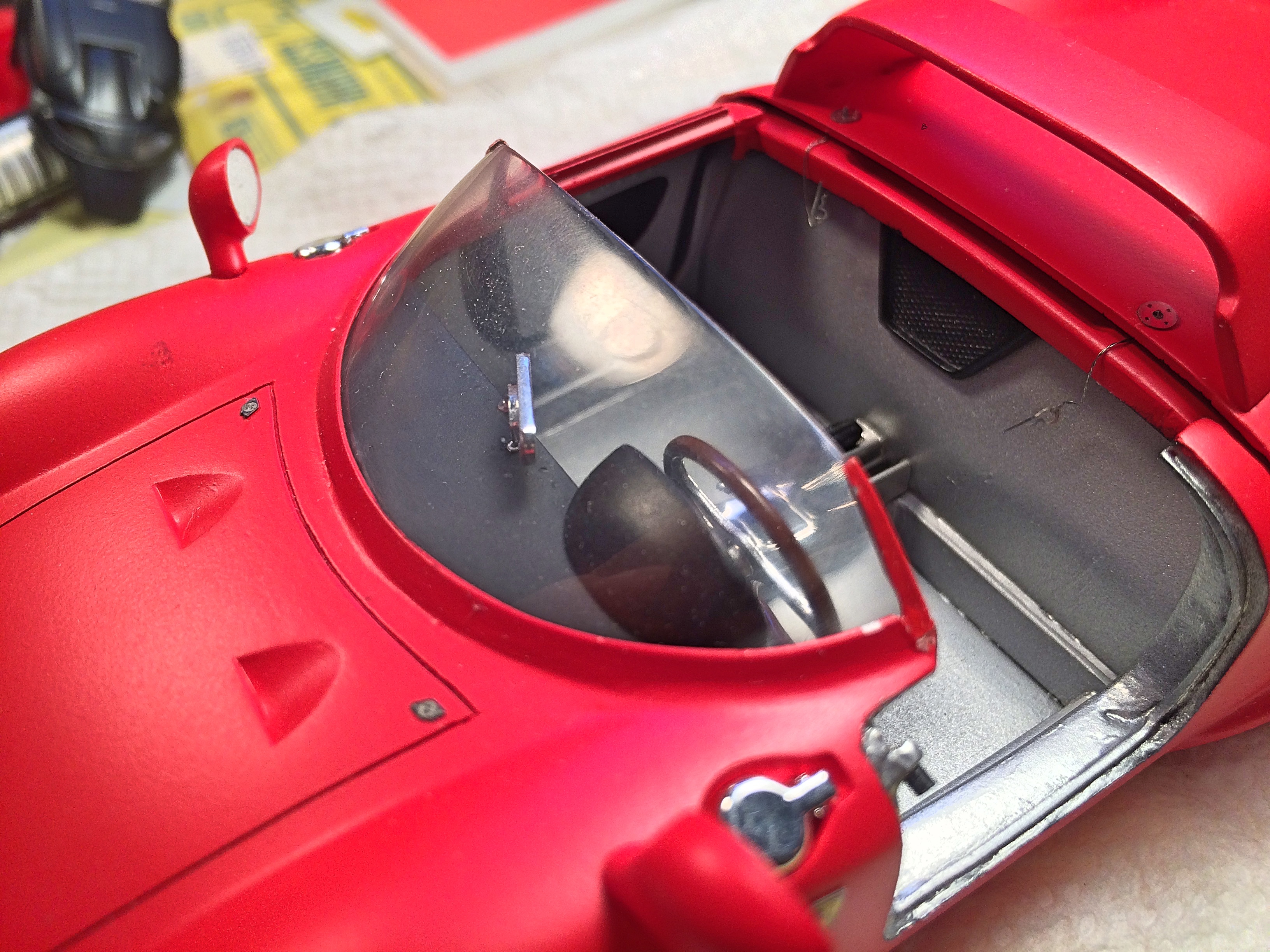

Added Detail Master hood pins, used the traditional hairpin type.  Had to work on the eye so it would go over the hood disk.  Added a Pro Tech nut to each pin to help hold the wire on.  Detail Master tuner pedals, on left-over photo-etch fret, so they move.  (that's like really important :P)

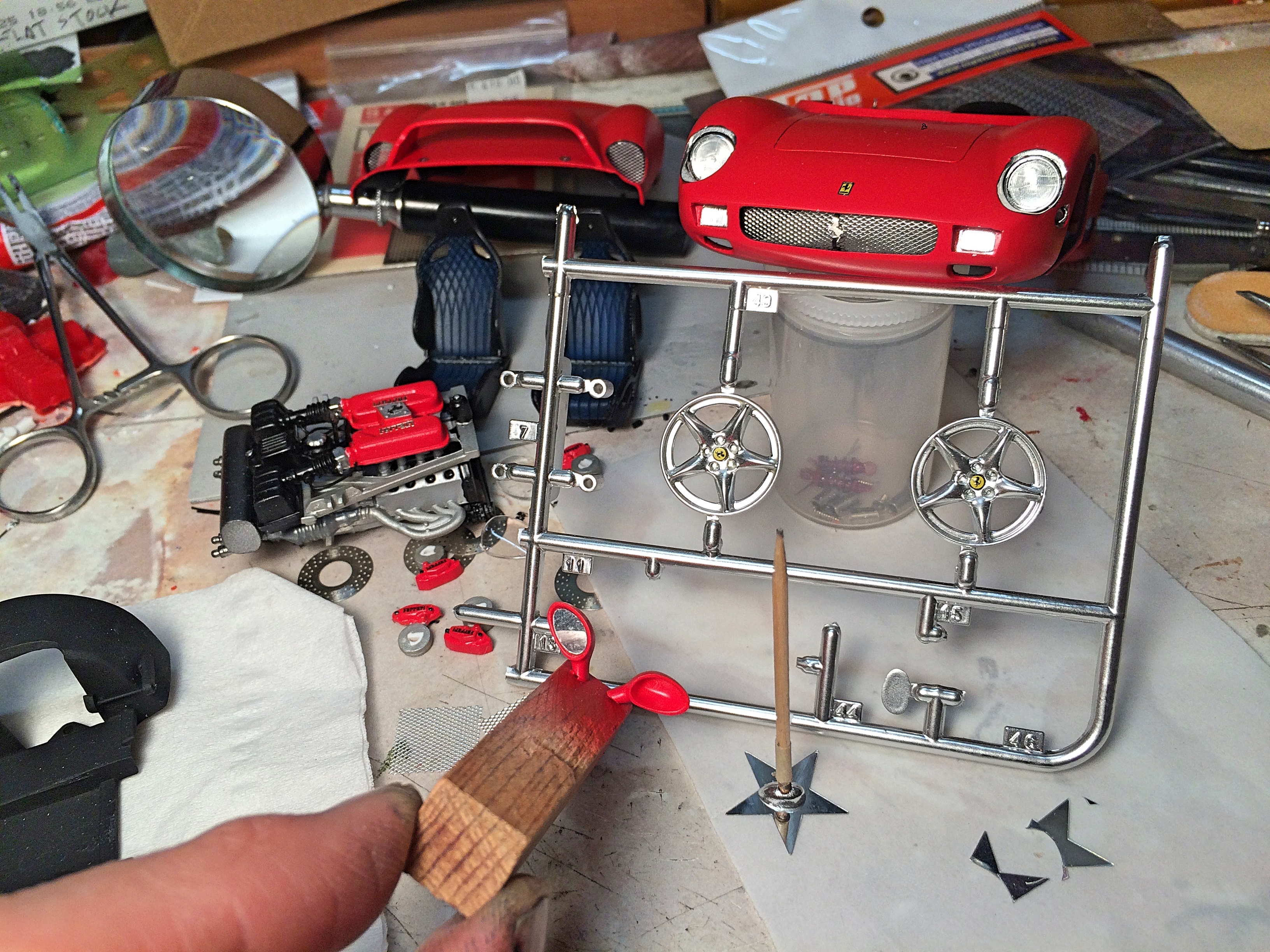

Made the little lights using the clear sprue, the cordless drill, started the shaping by also using the Dremel, then sandpaper and my shorts to polish.
Light lenses are barchetta aftermarket from Japan, looks like Cibie.  The rectangle lights have chrome mylar reflectors.  Glued on with clear Elmers.  The taillights are Farmers Insurance red reflective, over AAA chrome mylar, stuck on baking soda can foil (it was in that mess pile), painted inside with Testors acrylic clear red, but left unpainted in the center where I punched the FI sticker. Cigarette package foil for hood insulation.  Model Factory Hiro carpet.
I hate the kit mirrors, most of the time I detail anyway, but these are bad!  I competed with a little girl to gather up these party favor stars, wish someone would sell sheets of this mirrored plastic.  Used the kit mirror for a pattern, glued in with a couple globs of Water Effects to glue.  Added Replicas & Miniatures of MD aluminum screen in all the openings.  Crazy Modelers chrome emblems, Hobby Design 3D emblems added.

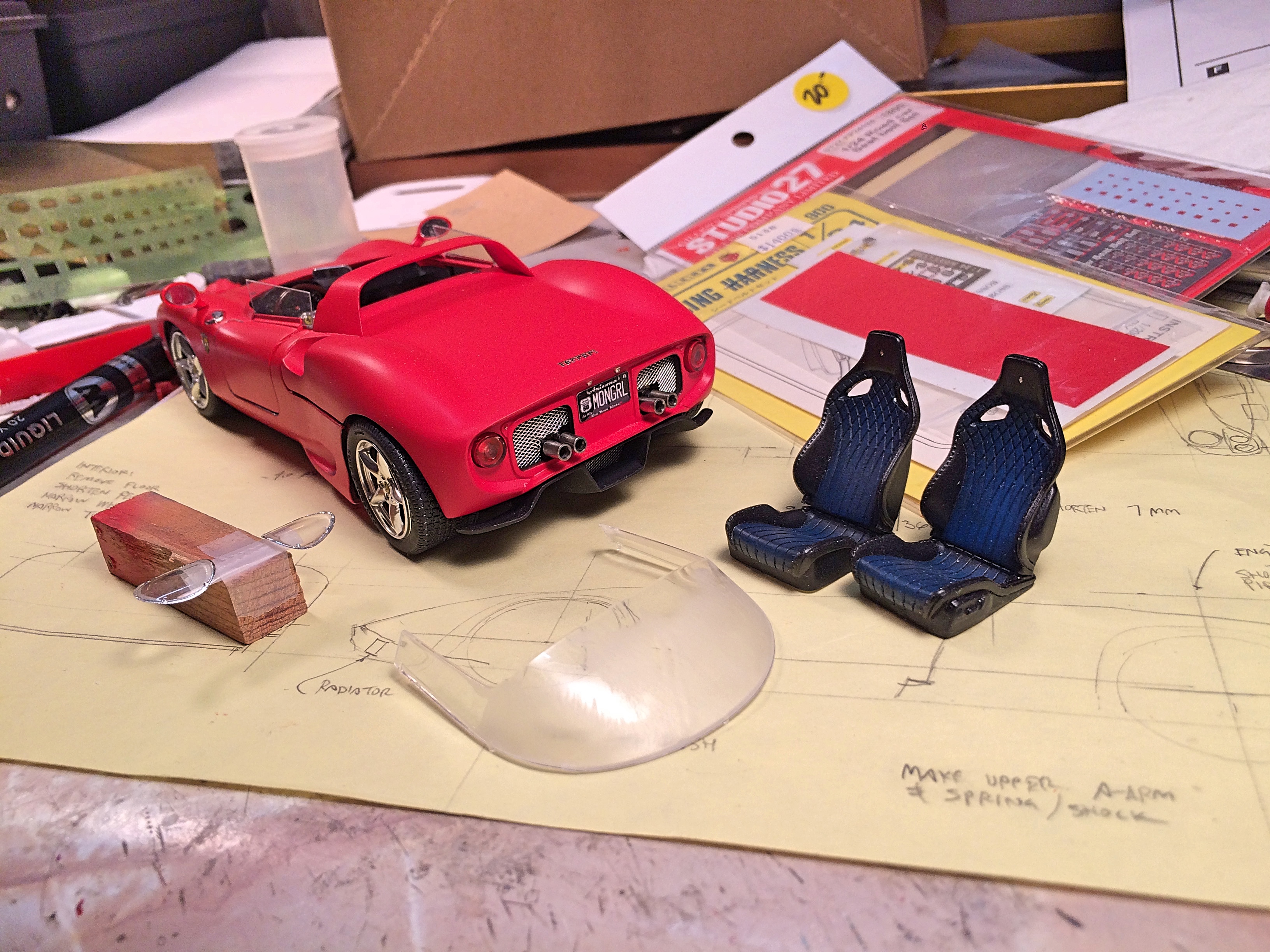

I was concerned about the "glass".  The kit had the wiper molded on, which I hated.  Also had a crappy vac-formed window.   I used the polishing system for doing paint, and made a HUGE improvement.  And the best part, it fit without almost no glue, and the aluminum plate end parts were modified without wrecking them.
Final photo-etch body detail, rivets for the door "glass".

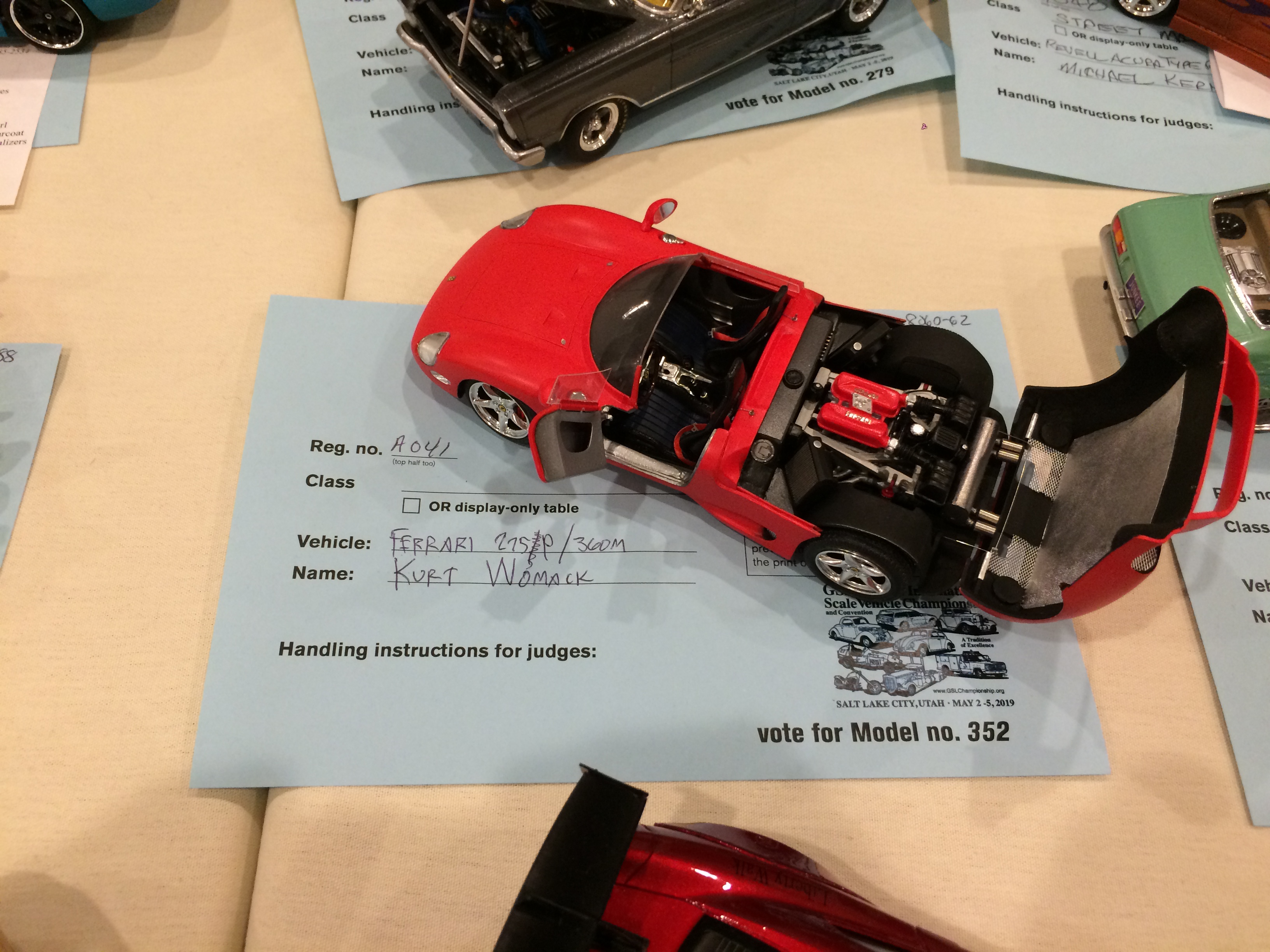

Thanks everyone!  Made it in one piece.  :D   Totally expected this class to be packed, exceptional work by others.
I needed to take a picture, for when I filled out the information to register.  I only had enough time to create a one page document, with 'before' pictures, so had to write on their online website some of the details of construction.
Link to post

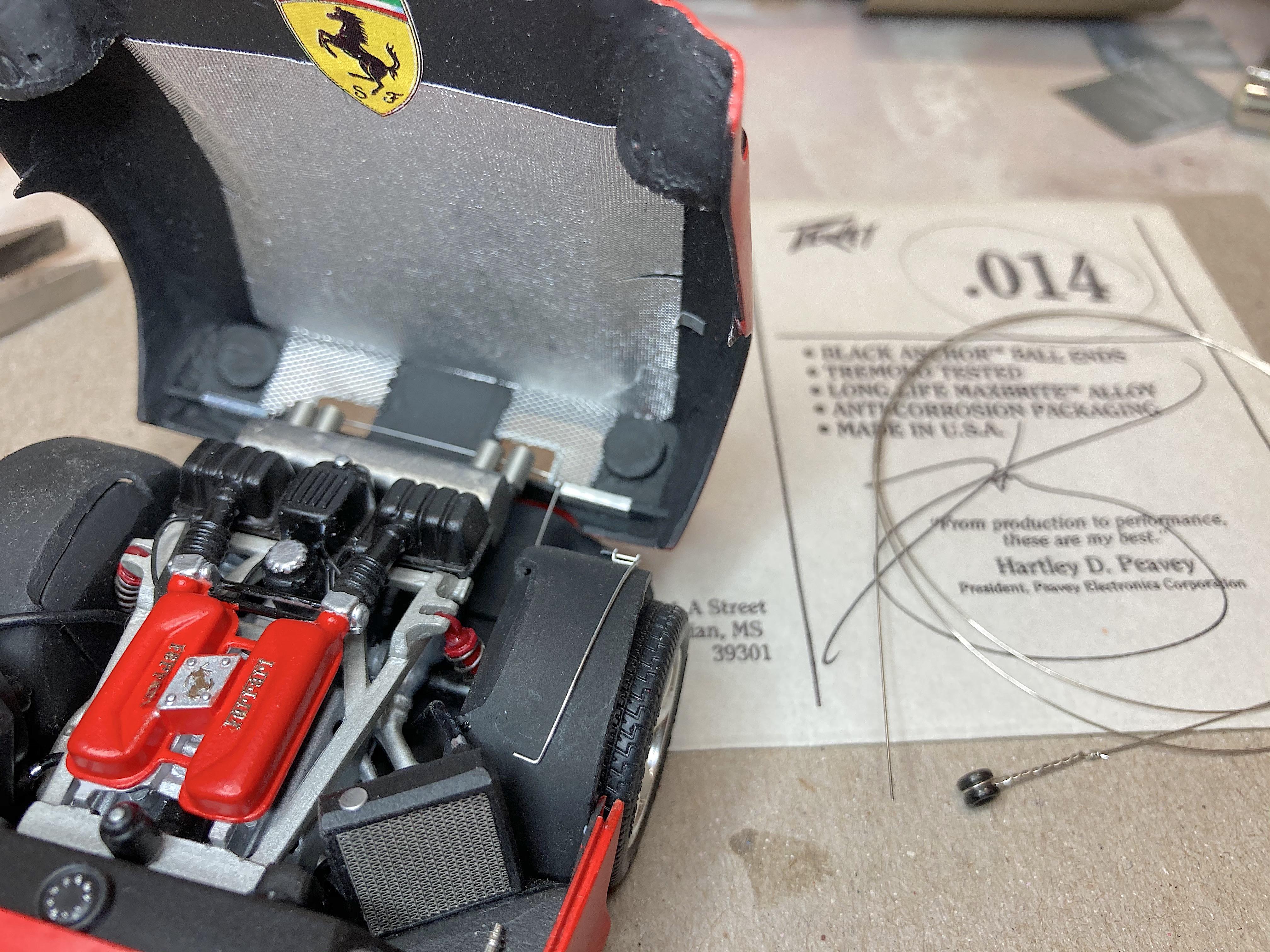

All this time, it was bugging me that the hood was flopping back too far when opened.   So I fixed it tonight!   Bent aluminum plate, bent guitar string, which is held on with wire insulation "nut".
I'm just going to make prop rods for every project from now on!   Unless I make hinges that hold the hood up.
