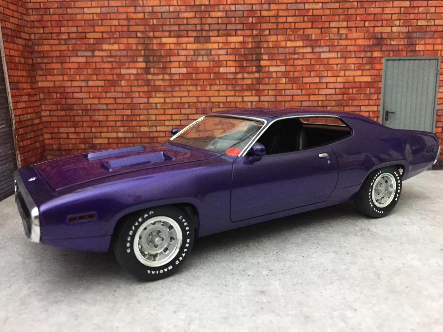

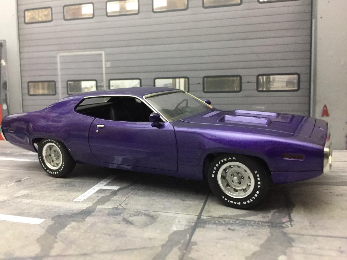

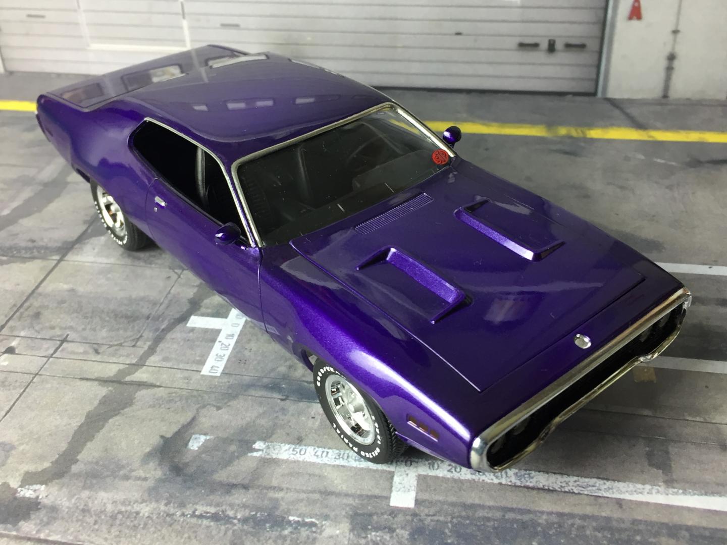

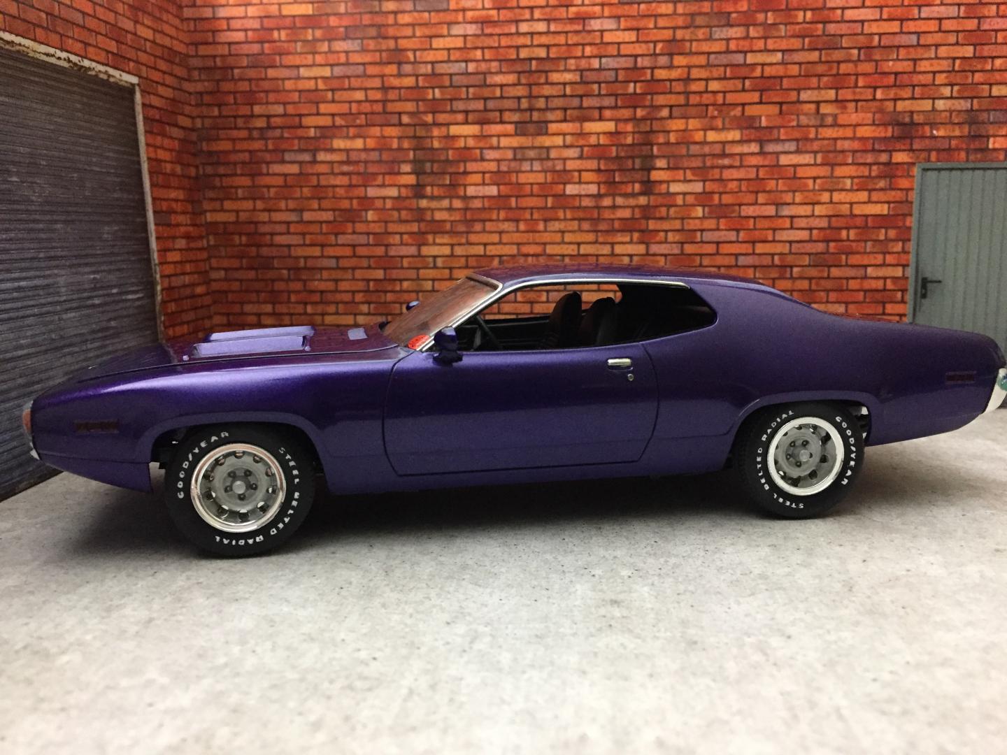

Hi folks,
I did another restoration...
This is the 1/24 scale Monogram kit. Bought it some time ago from a modelling mate and it looked like this:
The hardest part was getting rid of the white stripe decals that had practically "eaten" into the plastic, even after stripping the paint. I may show some WIP photos of that later on.
The paint I used is Testors Plum Crazy to replicate the In Violet Plymouth purple. The first time in decades that I used enamel on a car body and I was quite annoyed by the 72 hours plus dry time so for the next step I used a food dehydrator which helped to save a lot of time and patience. I also did my very first tyre lettering on this kit. By the way, no clear coat on this one, just elbow grease... :rolleyes:

Nice..  I like the color.  Great job on the tire lettering.

Awesome job! The paint looks great. How did you do the tire lettering? It looks perfect.

I like how you rebuilt this kit, and the paint finish and color look perfect.

Well done. Where are the exhaust tips from?

Brilliant!!  Love the color and your elbow grease really paid off.

Great resto! I love the MOPAR badge on the trunk lid. Where did you come about that? Or was it molded onto the kit like that originally?
Thanks Hugh! Yes, I gave this quite a bit of thought and got me some white gel pens as I thought this would be the best bet but even the one with the finest tip didn't work out for me. So I tried it old-school, white paint and brush... And it worked. :rolleyes: I used a 5/0 brush and Tamiya XF-2 flat white. Apart from a steady hand and a strong enough magnifying glass I think the most important thing is to keep the paint thinned to the right degree and clean the brush constantly because the paint will dry on it quickly and won't allow for precise painting.
Thanks, Lee! Those are regular wire end ferrules.
Thanks to you too Chris! That is a decal I've taken from a sheet sold by ScaleProduction. It has a lot more Mopar decals on it, plus some Mustang decals and some other US car stuff: https://www.scaleproduction.de/product_info.php?info=p2157_decals-street-racing-musclecars.html

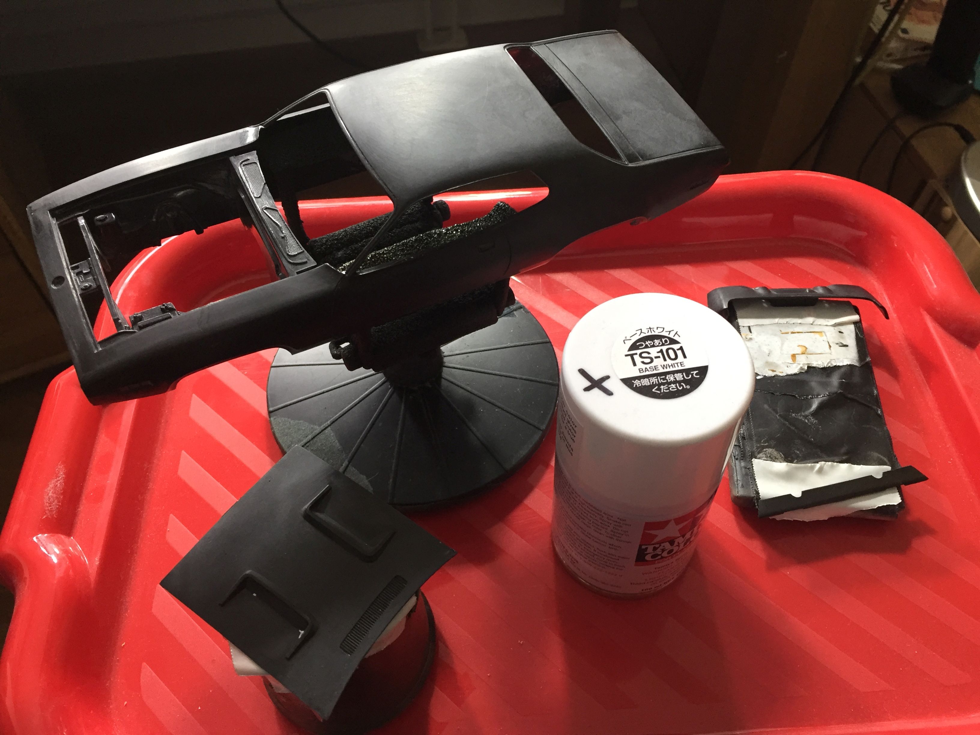

The paint was stripped using my usual chemicals, but the stripes on the roof and on the hood couldn't be removed by that:
They were so resilient that I even used a special scalpel blade:

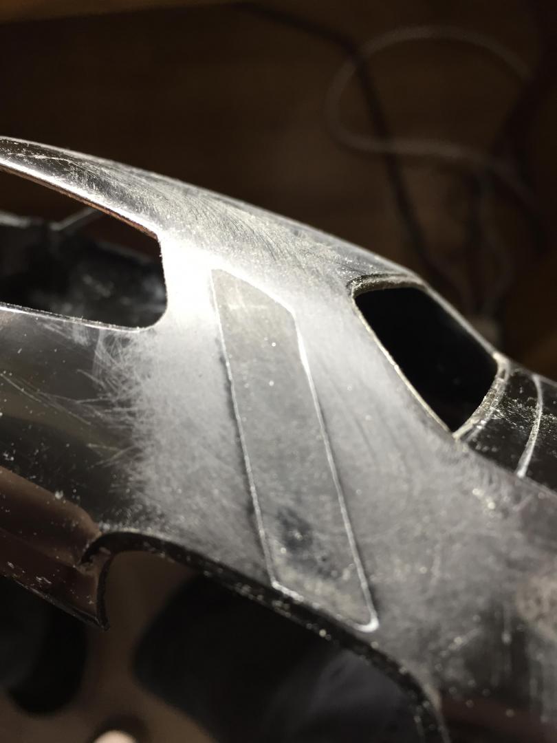

But in the end all that helped was heavy and coarse sanding them down:

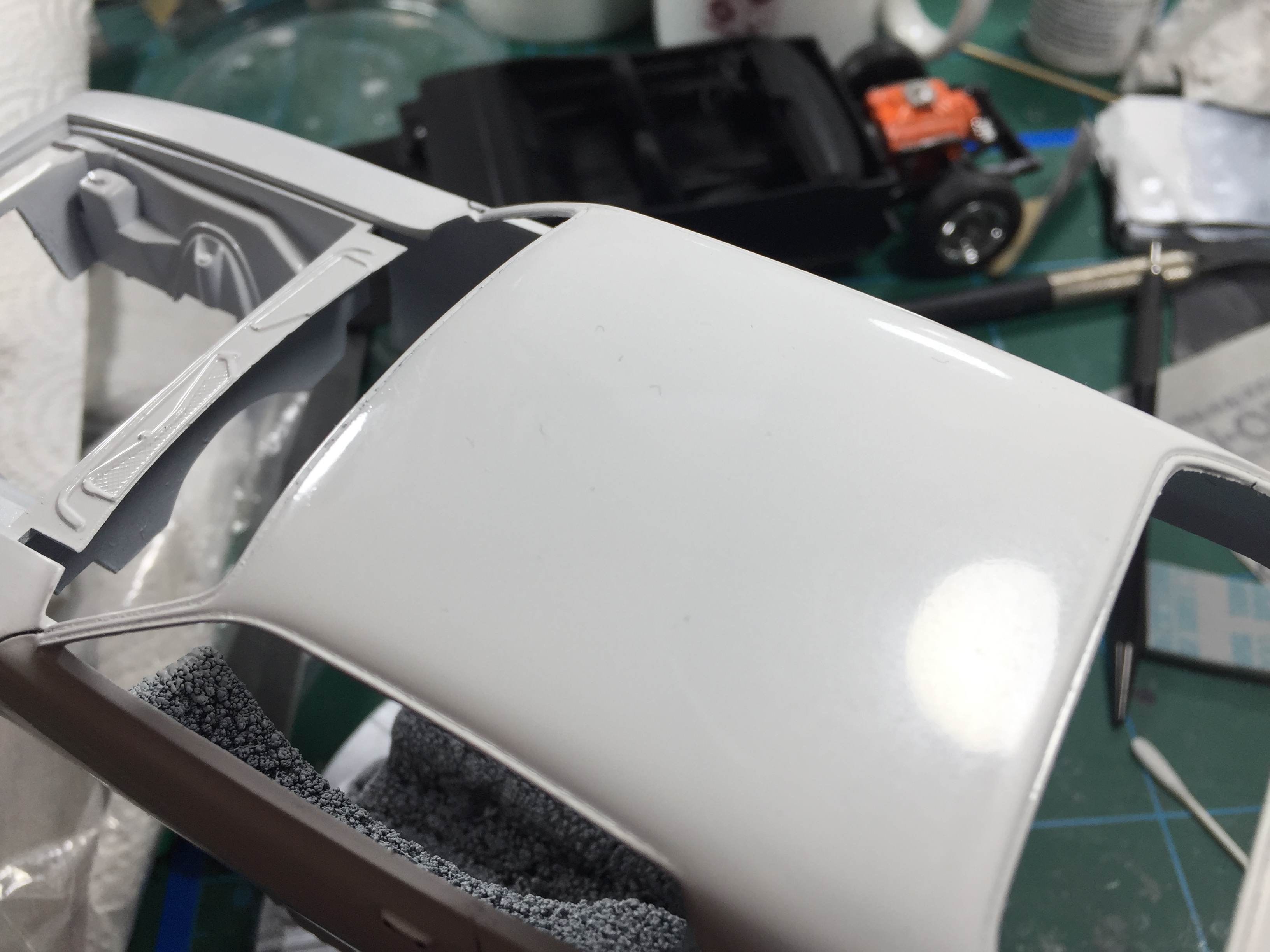

After that the body looked okay and I proceeded with the primer coat:
The primer coat was nice but to my surprise the "ghost stripe" on the roof was still visible:
So again, SANDING, the hard way:
Applying primer in such a way as to have an even coverage on the roof wasn't easy, but it worked out in the end:
