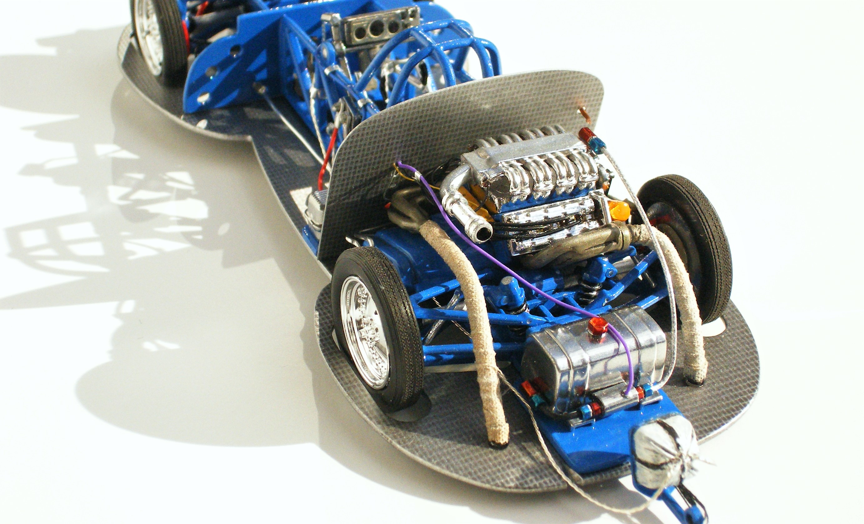

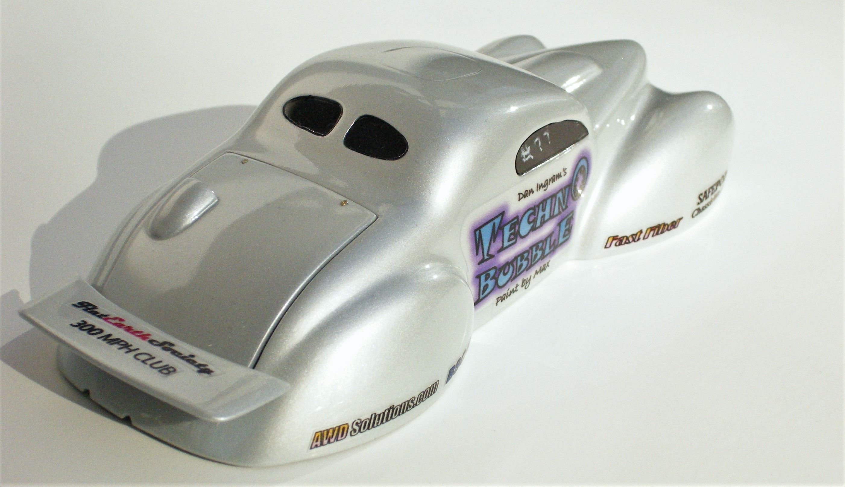

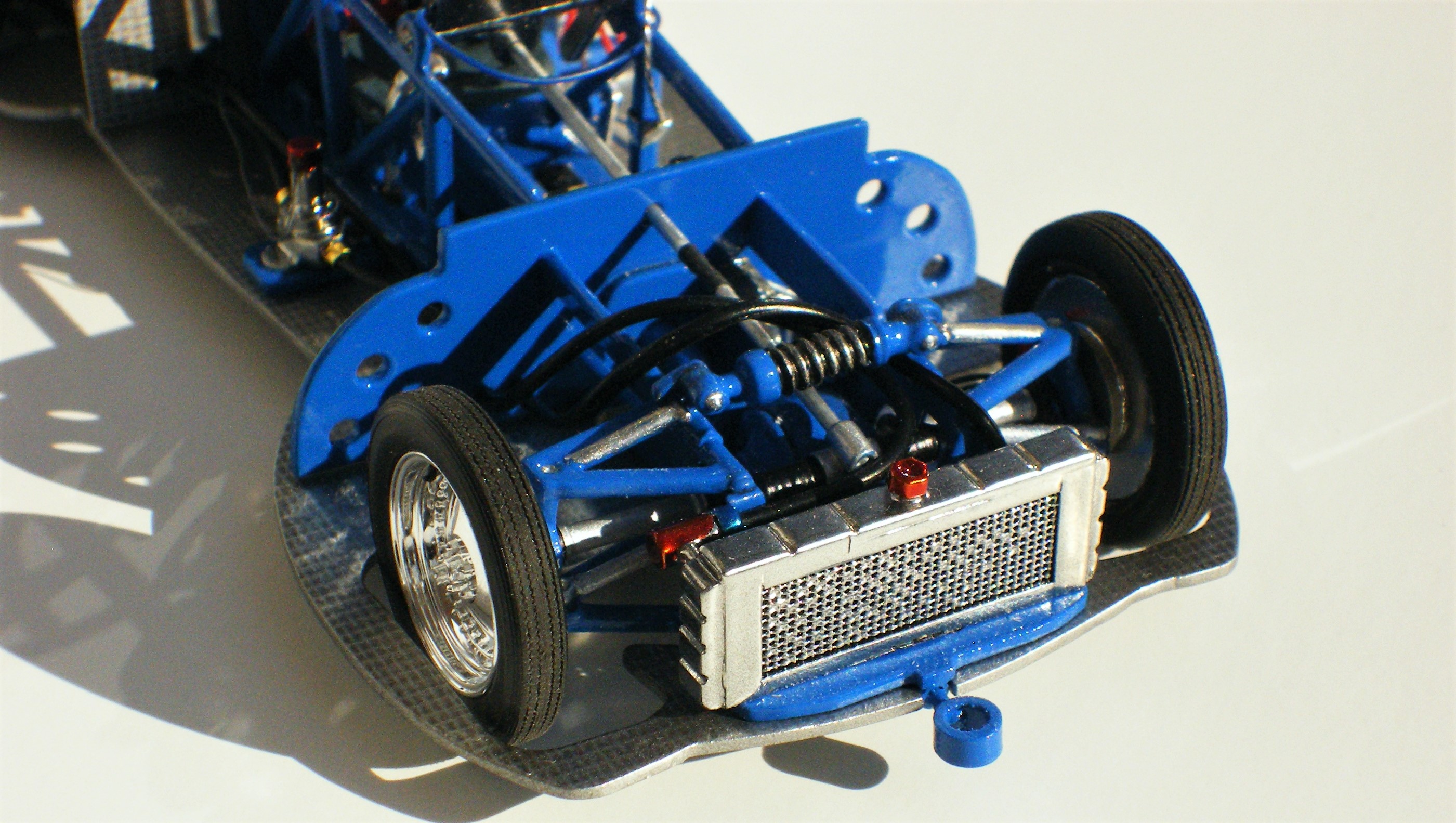

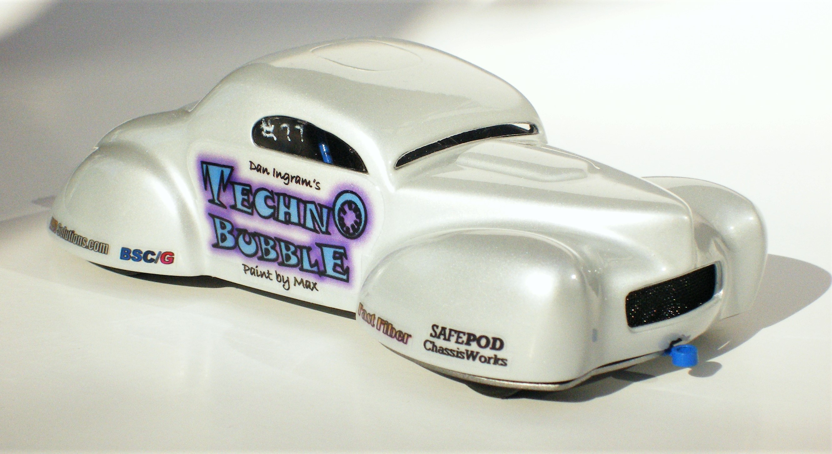

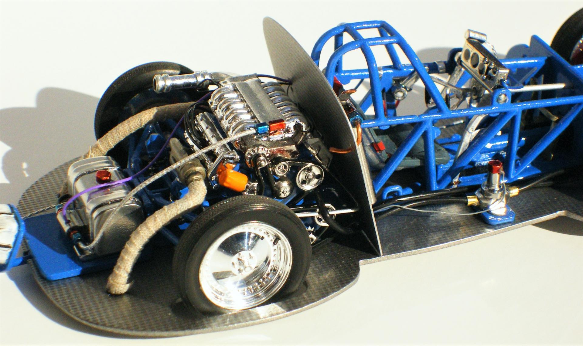

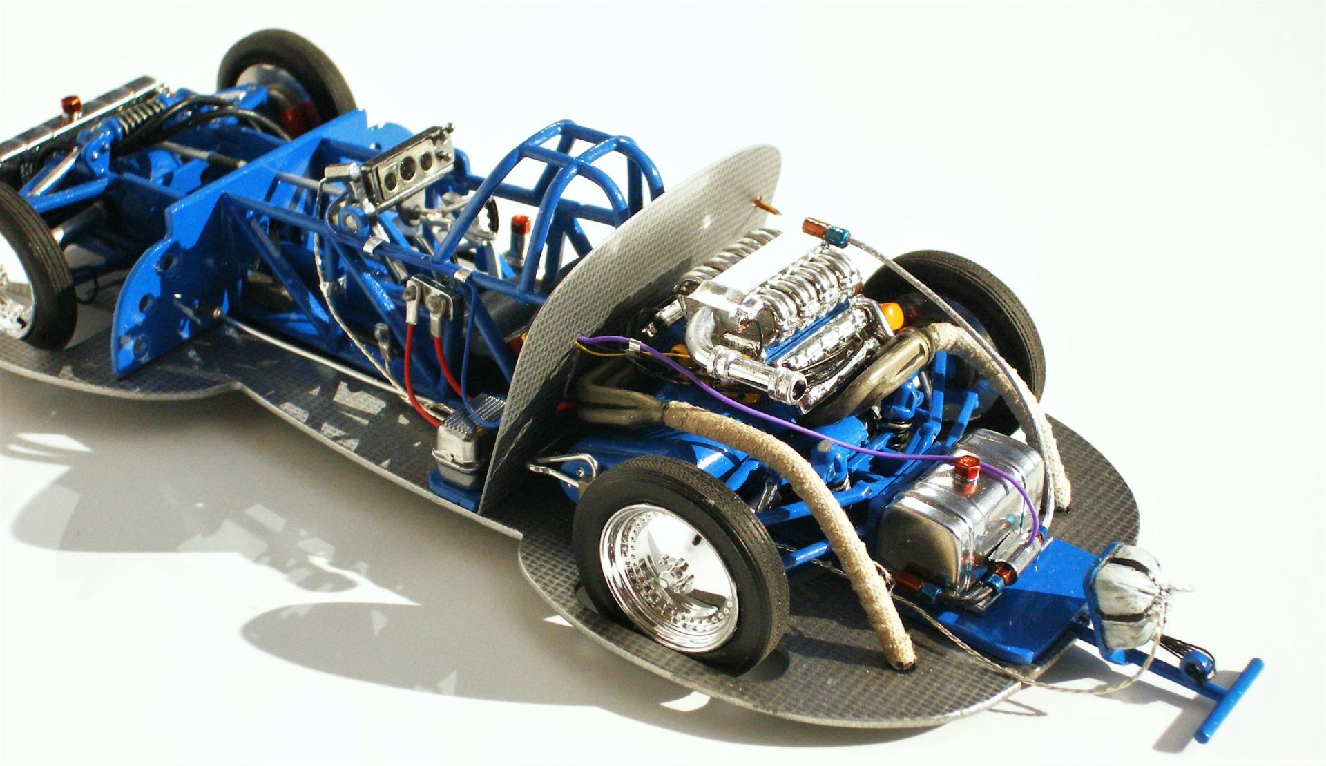

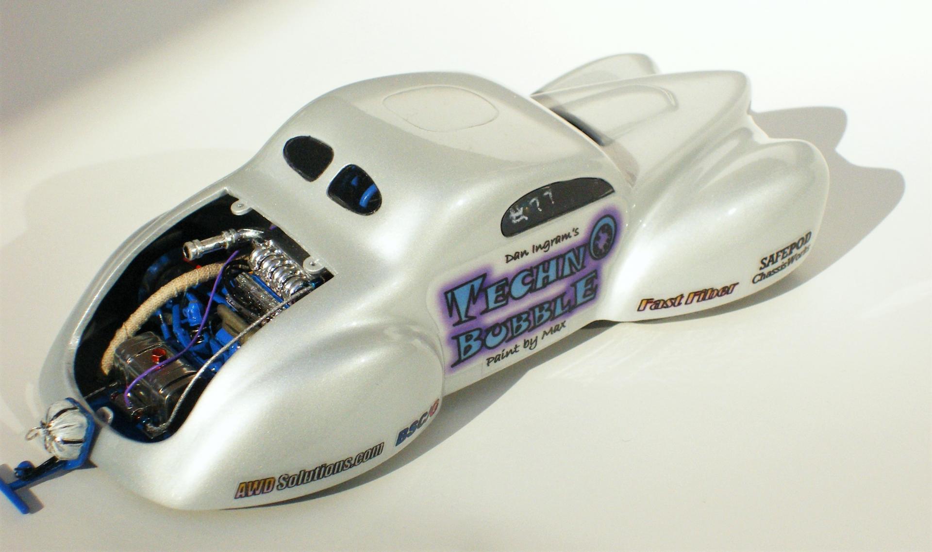

Hi!
A very sliced and diced Revell's 41 Willys coupe body (chopped, sectionned, fenders molded shut, opened trunk etc.), hiding a scratchbuilt AWD custom chassis that integrates modified Corvette Indy front & rear suspensions + rear engine. Parts box skinny tires & disc wheels. All the rest scratchbuilt, with painted carbon fiber finish on belly pan/floorpan & bulkhead panel. Testor's White lightning pear over grey primer. Home-made decals.
Another member of the Flat Earth Society!
Long live the Salt!
CT

I've been really enjoying all your posts. This is by far, my favorite. I really like the mono shock front end.

Now that's stretching ones imagination Claude.  GREAT concept and nicely executed.  cheers,tim

Now wouldn't that be fun to drive ............ very nice work super clean well done !

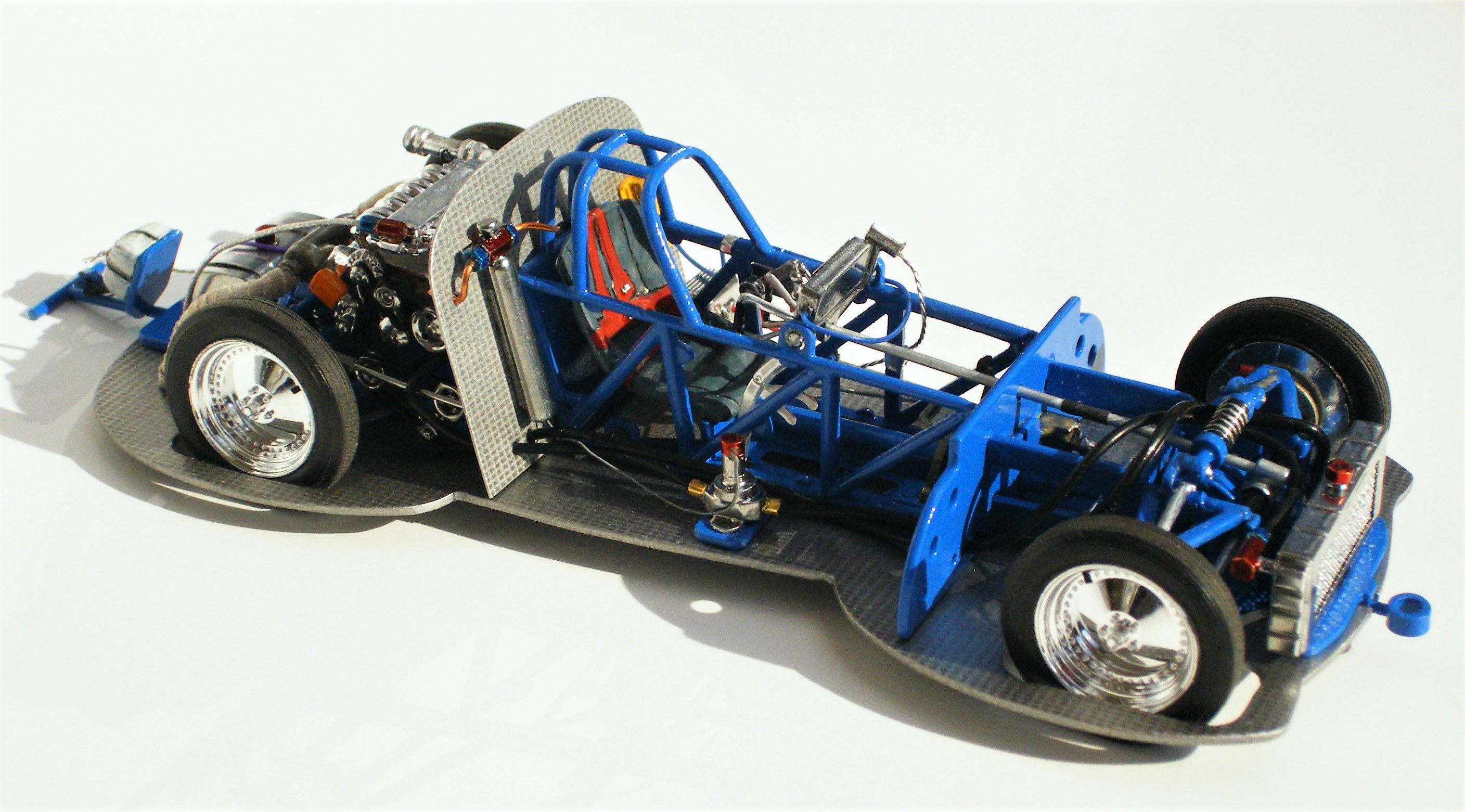

Probably the slipperiest Willys ever built. Lotsa trick stuff going on there, too. :D
What did you use for a gearbox in the sidewinder configuration?
Edited by Ace-Garageguy
Share this post
Link to post
Hi Bill!
Actually, I used the rwd powertrain from the Corvette Indy, which was low on details. I added many components, plus a custom driveshaft that goes to the front differential, which is a Winters-type unit out of the Mickey Thompson quad-engine car. Said driveshaft passes under the driver's seat and the front bulkhead panel, to join the fixed quick-change third member. The IFS was converted from twin to single transverse mono-shock, for packaging issues.

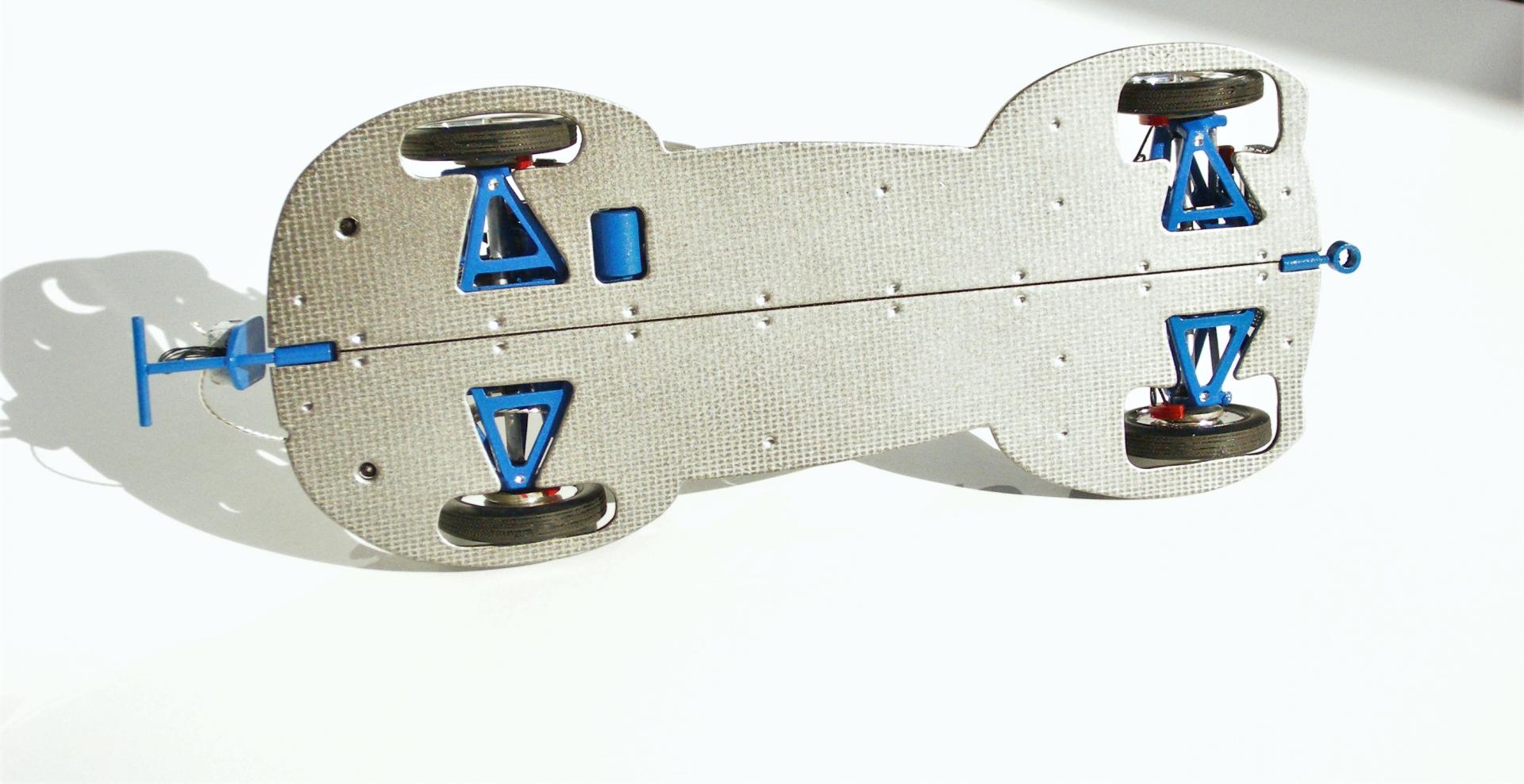

What is the blue Roller Looking thing sticking out from the bottom, near the engine? Speedometer fixture?
Share this post
Link to post
Hi!
Thanks for the comments. To Alexi's point, that blue "cannister" sticking trough the belly pan is a part of the Corvette Indy transaxle unit. I figured it is (and wired it) as the starter... but I can't swear to it. I could have "shaved it", but for the sake of realism, I left it on.
Might create wind drag, however. What do you think?
CT
Share this post
Link to post
Thanks, for the answer Claude.  I don't think it is enough to worry about.
Share this post
Link to post
