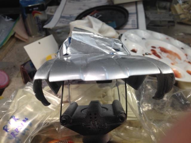

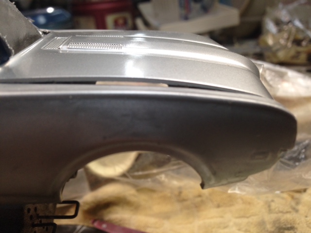

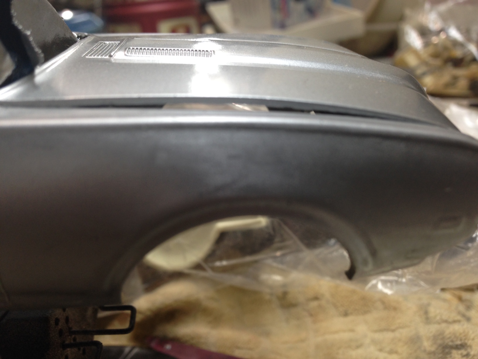

Have vintage Jo-Han kit but it has a slightly warped hood. Looking for any suggestions on how to fit it.

Twisted, or ?

Twisted....

The first thing is, that you probably should have addressed it before paint. -_-
It's hard to tell, but it looks like it has a fairly mild twist, but a pretty pronounced bow.
You could try putting it in a tub of hot water, putting enough weight on top to press it flat, and then let it cool like that.
I haven't had a lot of luck fixing warped parts myself.
I usually just try to "massage" them out with a little careful bending if they're mild, but something this pronounced will probably require some sort of heat solution.

First thing is to find the fender location,..before fitting the hood,... then come back and, under hot water, over twist, slowly, the hood and cold water stay the twist,...
Steve
Steve:
This is a builder I`m attempting to rebuild; it was painted when I acquired it. :D
I assure you I would not have wasted paint nor my time to apply several color coats to it then attempt to straighten the hood on the back end!<_<

4 hours ago, 69NovaYenko said:
Steve:
Got ya Greg.
I assumed, when I saw that the body was attached to a paint rack in the photo, that it had just been painted.
