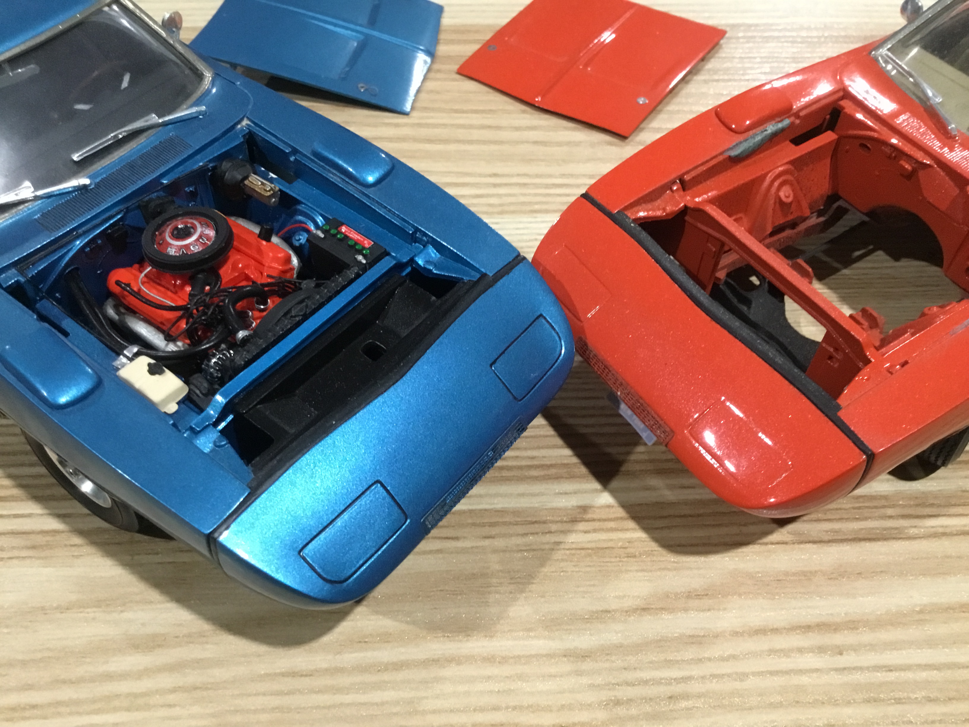

74654391-CEB4-42A9-BE58-A59CBC4BF4C9.thumb.jpeg.c391f1540b906509fc52c532b06b6cda.jpeg I noticed the first time I built this kit that the seal around the nose should be flush if not recessed a little bit. It also should extend into the engine bay slightly. To do this I simply scribed along the seal on the nosecone itself to create a new edge of the steel nosecone. Then I sanded down the seal. I also added some plastic to the seal to enter into the engine bay. I hope this helps.
