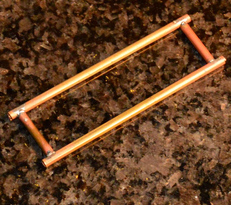

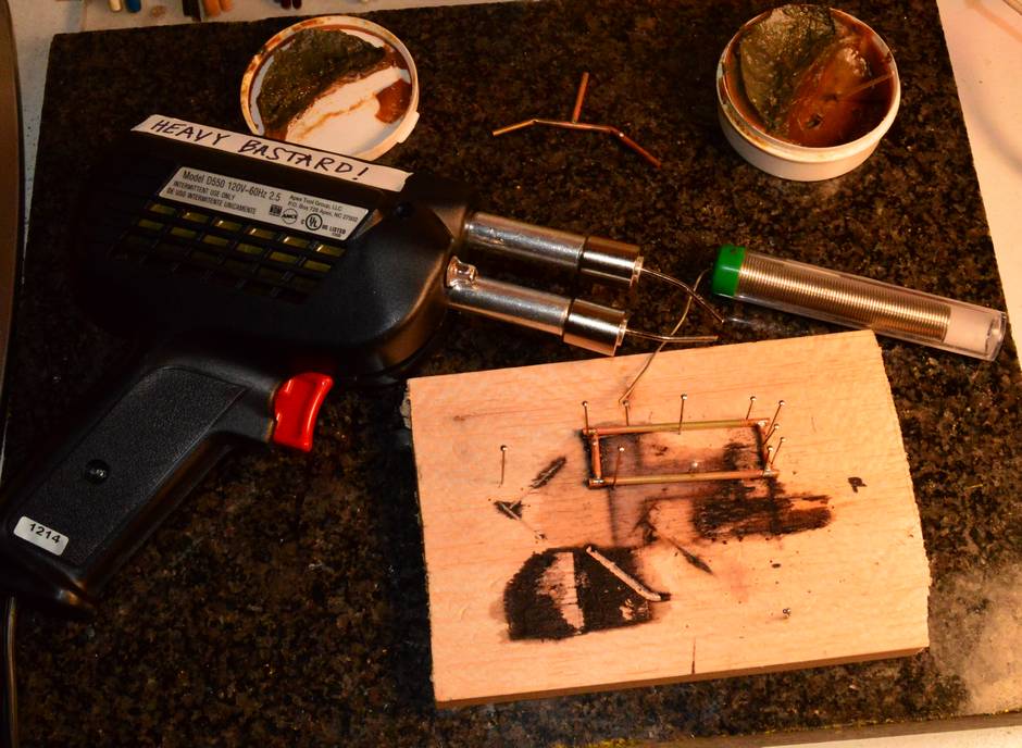

Straightliner59 Posted May 24 I think this qualifies as a tip, at this point. It's well worth sharing. I had inquired about resistance soldering on another thread, as I was looking to put together a system for a little less than an American Beauty setup. That mission is mostly accomplished--I'm still collecting pieces to build the probe handpiece, but, I am up and running with tweezers. I digress. In replies to that thread, someone mentioned simply using a standard soldering gun, and cutting the wire tip, to create two "leads", thus creating the resistance/heating. Until it was mentioned, I'd never considered that. Once it was, clearly, it's the same process as created by the commercial units. It also costs much less, and takes up less space. I received a 200/250W Weller gun in the mail today, that I purchased for less than $40. I quickly made the modification, and gave it a shot. It works beautifully! Heats quickly, and provides the ability to maintain contact with the parts, and kill the power, to let the joint set, before moving anything. I like that! I think a 100W unit will work fine for tubing, etc., that anyone who builds1/24-1/25 scale chassis would use. Below are the results. Quote Share this post Link to post Share on other sites
Pete J. Posted May 24 (edited) Glad to see your system worked! If I may make a suggestion. I see you are trying to burn your house down. Try Googling "honeycomb ceramic soldering board". They are not expensive and are a great alternative to a wood or asbestos boards. They come in a number of sizes. I use mine with a piece of foam underneath to stick the pins in. With the honeycomb pattern, it is easy to get things square and you have enough overlap that you can always find a way to secure the pieces. You also don't get wood smoke in your eyes. Hope this helps. Edited May 25 by Pete J. Quote Share this post Link to post Share on other sites
Straightliner59 Posted May 25 I want to acquire something to solder on, and the ceramic has been recommended before. I will look to pick one up, soon. I have been using balsa to solder on, since the mid-'80s, and, so far, have avoided fire! Obviously, that doesn't mean it's the safest practice! I run the exhaust fan to evacuate smoke/fumes. All that said, thanks for the reminder, Pete. I will move one of the ceramic boards to near the top of my "to get" list. Quote Share this post Link to post Share on other sites
Dave Ambrose Posted May 25 You could probably use a scrap of Hardie board, or Hardie siding. I found a broken piece of siding at my local Home Depot, and they just gave it to me Won't be as handy as that honeycomb board, but it's certainly good in the flammability department. Quote Share this post Link to post Share on other sites
Straightliner59 Posted May 25 2 minutes ago, Dave Ambrose said: You could probably use a scrap of Hardie board, or Hardie siding. I found a broken piece of siding at my local Home Depot, and they just gave it to me Won't be as handy as that honeycomb board, but it's certainly good in the flammability department. That's not a bad idea, at all! Quote Share this post Link to post Share on other sites
