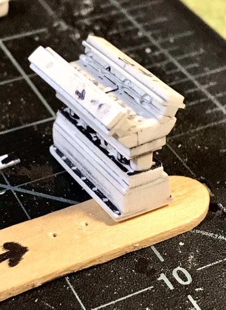

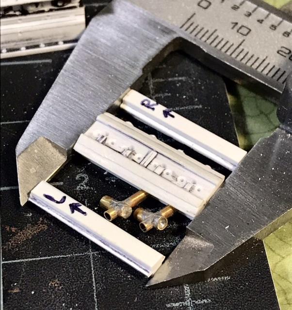

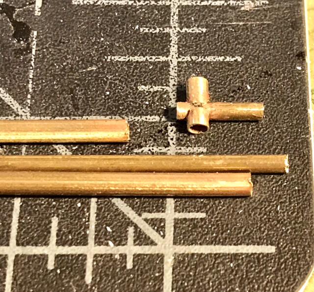

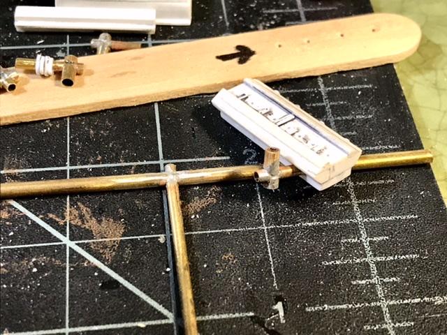

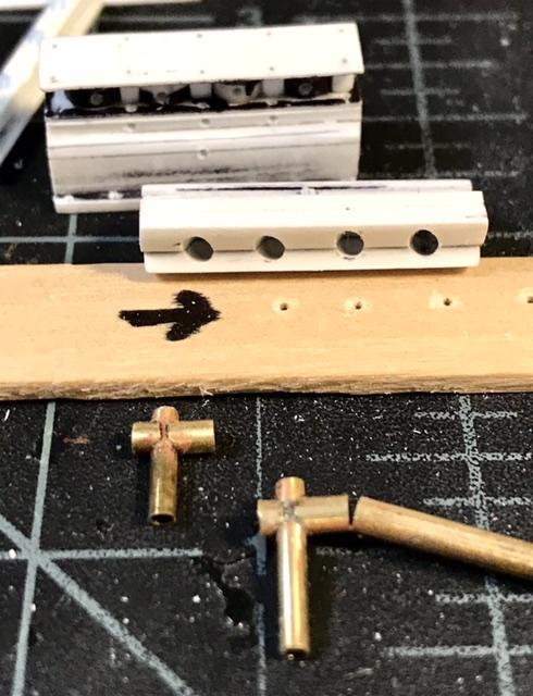

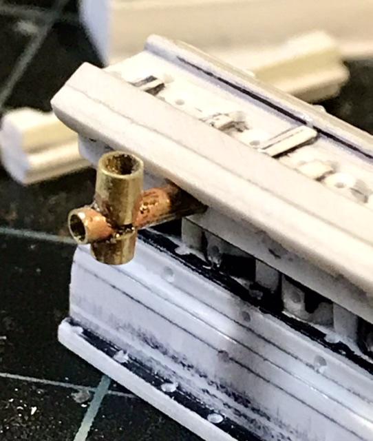

absmiami Posted April 4, 2021 Author Share Posted April 4, 2021 The other side of the cyl head gets angled holes for the carbs... the Amal carb bodies are soldered up from 1/16 thin tube and some .078 tubing scrounged from the back of one of my STUFF drawers ... Next is some work on the cam housings ... Quote Link to comment Share on other sites More sharing options...
absmiami Posted April 4, 2021 Author Share Posted April 4, 2021 The carbs will get some aluminum caps and horns. ... time to clean up the Sherline workbench ... maybe I’ll post a photo before the cleanup. Just for laughs ... the cyl head has plug holes drilled at angles - this was a duel plug / cylinder engine - the distributor sits in front of the engine - below the fuel pump and above the water pump ... Quote Link to comment Share on other sites More sharing options...

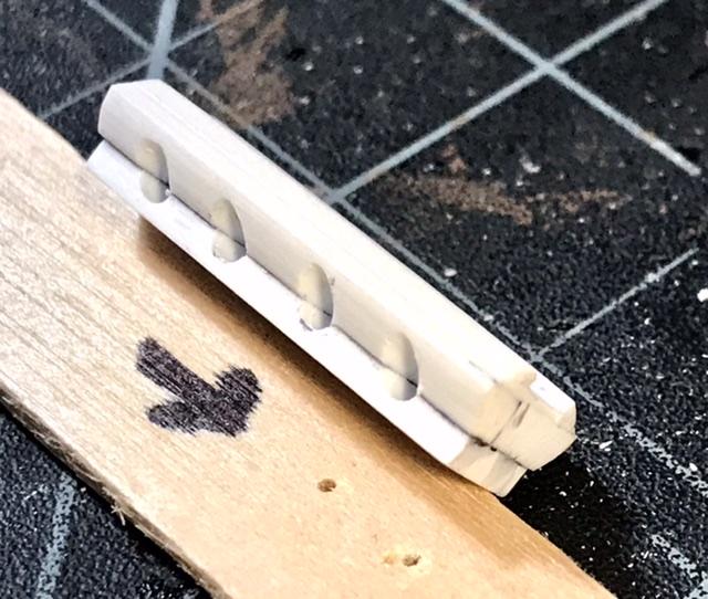

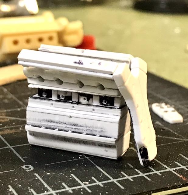

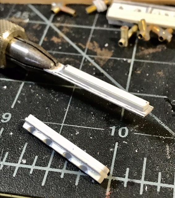

absmiami Posted April 5, 2021 Author Share Posted April 5, 2021 The camshaft housings were made from three strips of Evergreen liquid glued together to get the profile / Shape correct ... then added some .025 plastic pegs so I’ll get a solid attachment to the cyl head once the parts are painted ... Quote Link to comment Share on other sites More sharing options...

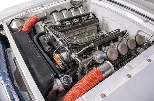

absmiami Posted April 5, 2021 Author Share Posted April 5, 2021 Pleasant surprise in today’s mail ... Veloce’s Ford Small Block source book has a reprint of the 30 page Ford Motor Company publication on the 65 Ford Indy DOHC engine - page for page - very nice - I had pined about getting a copy of this pamphlet on this thread last year - it hasn’t been re-produced in some years - but Author Des Hammill found my cure ... book also has some good info on the hi performance engines used by Shelby ... so maybe I should complete that DOHC Indy engine ?? ??? ya think ? Quote Link to comment Share on other sites More sharing options...

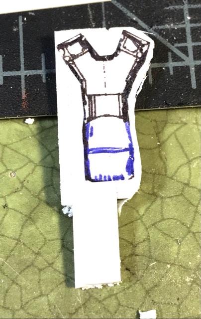

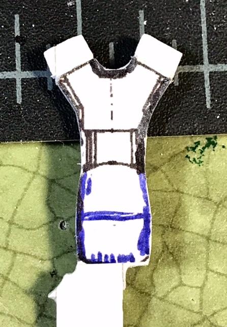

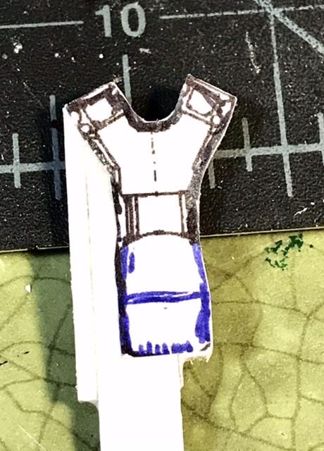

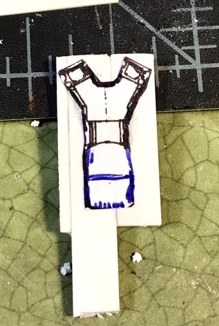

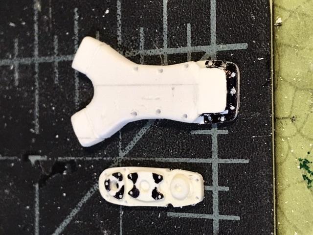

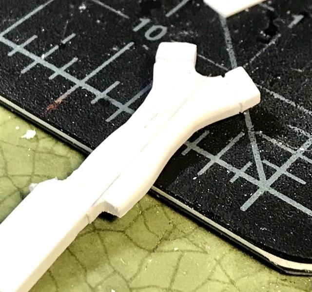

absmiami Posted April 8, 2021 Author Share Posted April 8, 2021 Hope is eternal - the combustion engine is ... not .... the gear casing at the front of the engine is a one piece casting with an accessory drive bolted on its top half ... the drawing was traced from the Roger Taylor Vanwall 3 view profile drawings - they are really good - and they are at Least 50 years old - then ground and filed the profile on some .080 thick Evergreen - made the accessory drive from some .030 strip - and added Details and bolt holes ... Quote Link to comment Share on other sites More sharing options...

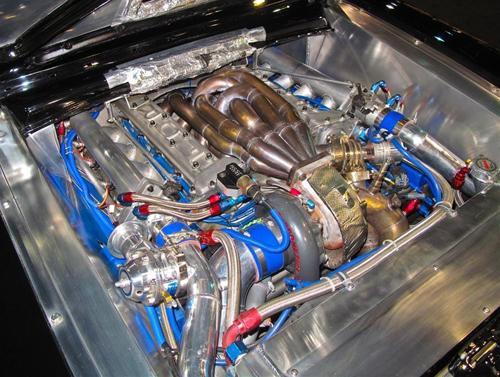

Big John Posted April 10, 2021 Share Posted April 10, 2021 I like the work in white styrene and the brass carbs. Looking good! So, if "Hope is eternal - the combustion engine is ... not ....? You'll be wanting to build one of these next? Quote Link to comment Share on other sites More sharing options...
absmiami Posted April 11, 2021 Author Share Posted April 11, 2021 Why do I think that you have posted pix of a Tesla motor and transaxle ??? Am I warm ? Quote Link to comment Share on other sites More sharing options...
Big John Posted April 11, 2021 Share Posted April 11, 2021 Yes, this was at the Peterson museum in LA. the future of engines? But you will need to put playing cards on the wheels to get the 'Real sound of power" affect. Quote Link to comment Share on other sites More sharing options...

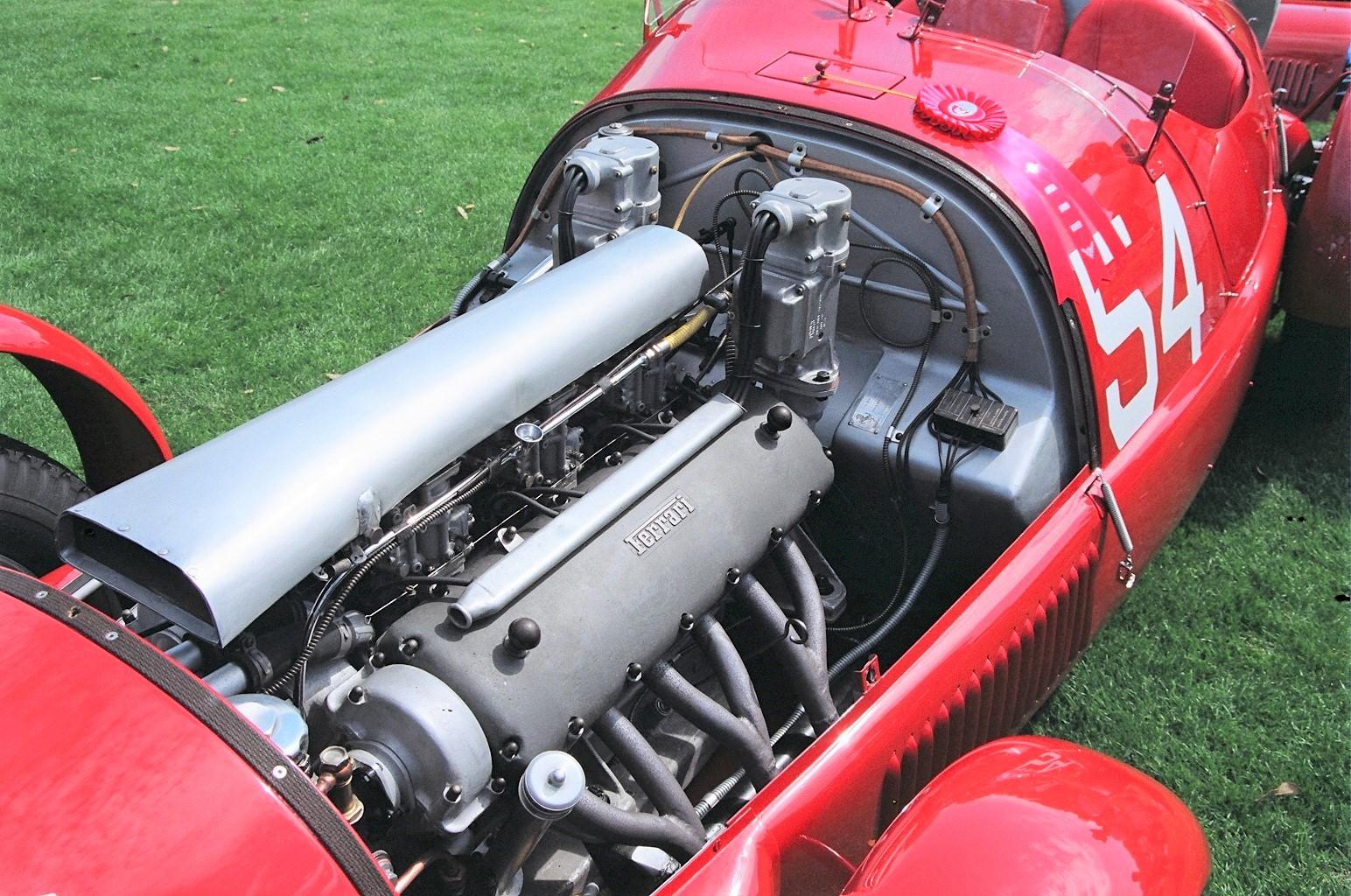

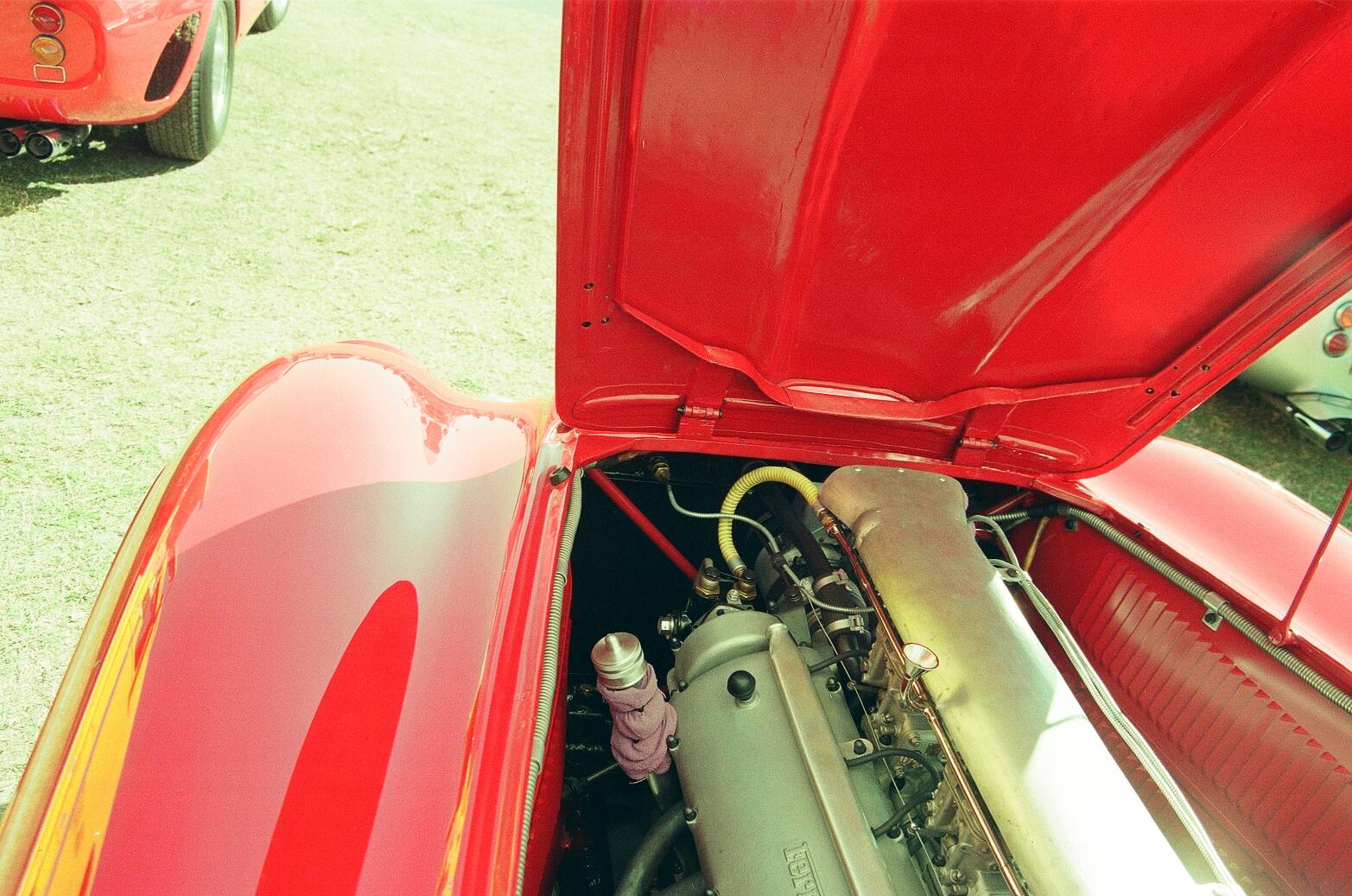

absmiami Posted October 13, 2021 Author Share Posted October 13, 2021 2 cars but same engine ... this is an early Columbo V12 the photo in the sports car eng bay is from the Spa winning Ferrari Barchetta that I am building in the Other Racing WIP section - an Umi kit that I am building as a tribute to the late Mike Quarterman - he produced this kit in 1993 ... the other photo is of the Collier family owned 166 that is displayed at the Rev's Museum in Naples this photo was taken at an Amelia event a few years ago ... It is one of the first Ferraris - and was built about a year before the Barchetta. Quote Link to comment Share on other sites More sharing options...

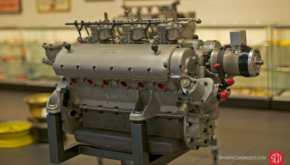

absmiami Posted October 13, 2021 Author Share Posted October 13, 2021 this is a shot of the engine published by Sports Car Digest - with - or without - there permission - but with a plug - great site ... this is the display engine in the Jon Shirley Collection - that family is the lucky owners of the Spa Winning Barchetta that I will build from the Umi kit ... the kit includes a fairly detailed engine bay, but ... Quote Link to comment Share on other sites More sharing options...
