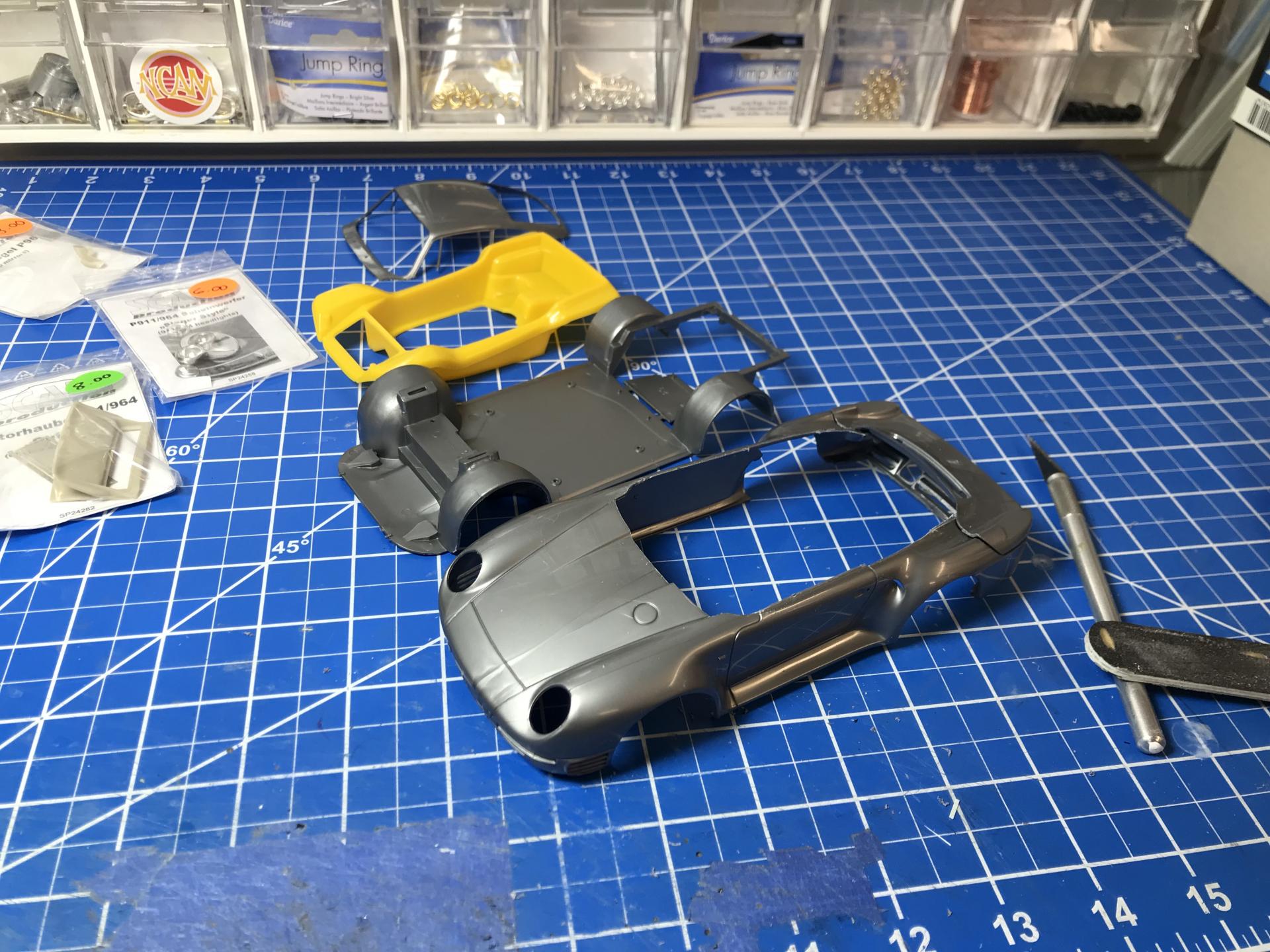

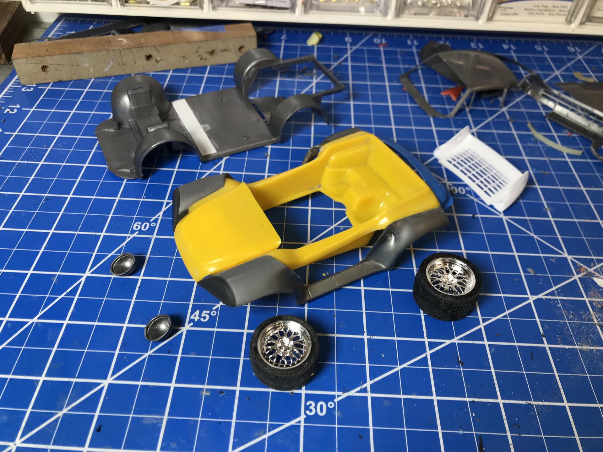

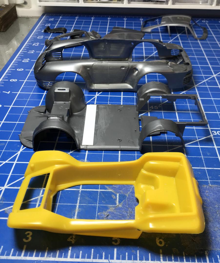

First up was removing the roof and about a half inch from the 959 chassis and body... Since the 959 is awd, and im building a "dune buggy" seems like a good idea to try and keep that feature.
IMG_1336.thumb.JPG.87e508821d4a0550b2509933bd108d2b.JPGIMG_1345.thumb.JPG.b3bf41666b5a479b1bb6a04674e93c27.JPG

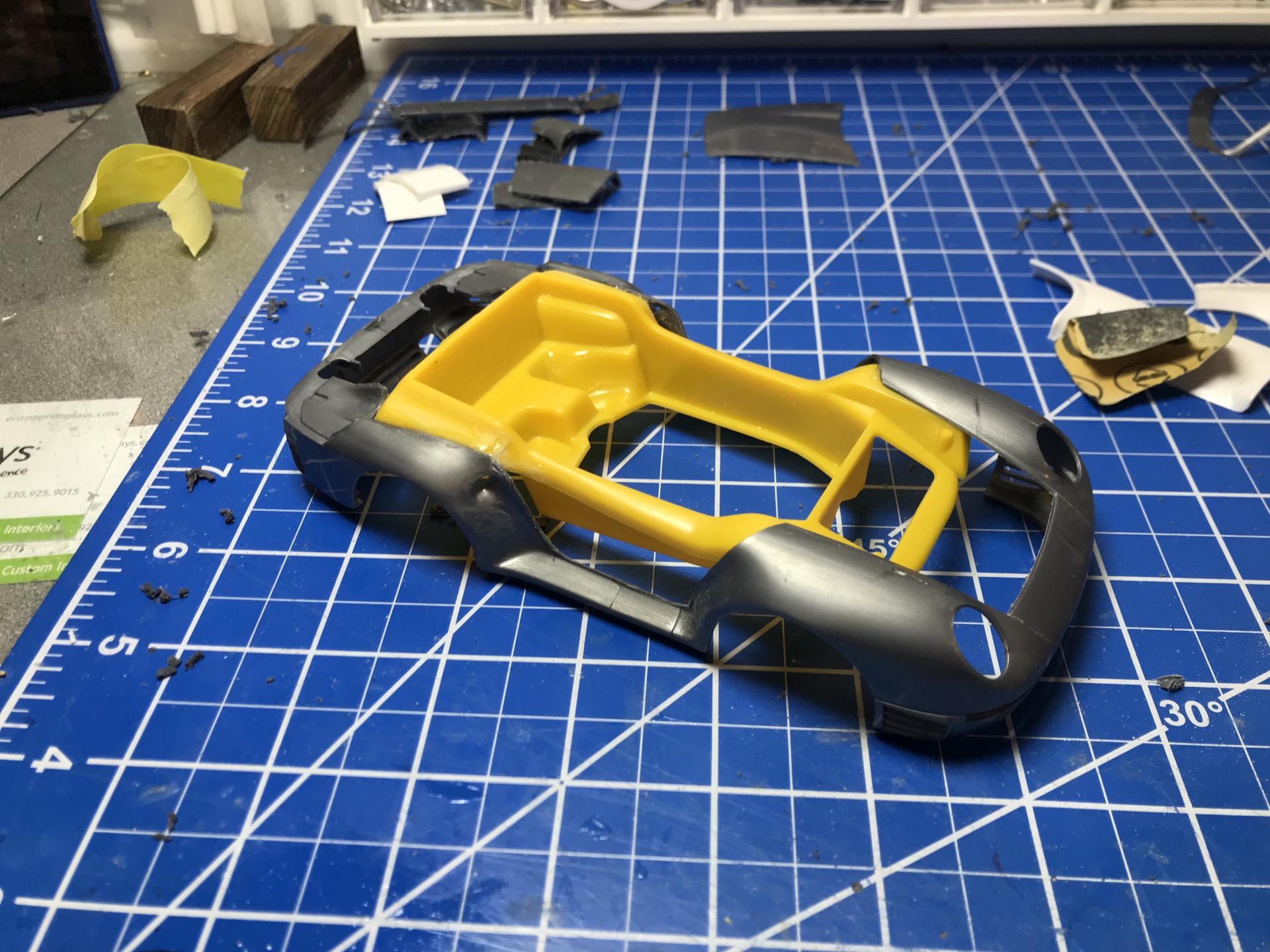

Then it was time to "sink" the manx body into those nice wide flares.
IMG_1347.thumb.JPG.a81ad45278fa2e3010045b4f32d31103.JPGIMG_1355.thumb.JPG.c749c9d5d3fd8c4a42835ec9873a5d93.JPG
Then to clip the front and rear off.... getting it back to normal Manx length. Picked up the rear end from a Heller 934 rsr with a bad body, and a tamiya 911 GT2 donated its wing... still to be installed.

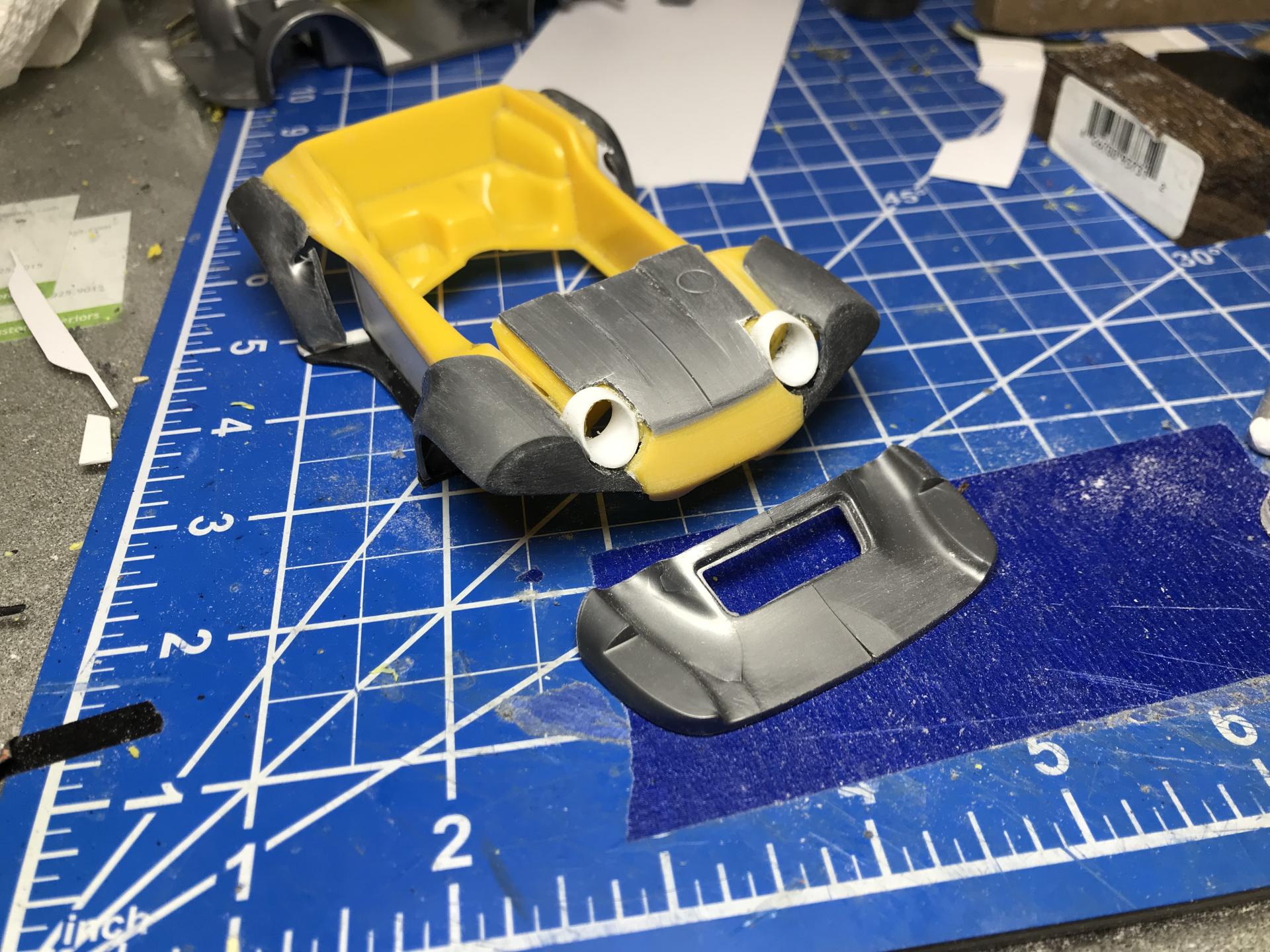

Then I sunk some round tubes into the fenders to make provisions to mount the Scale Production projector headlights.

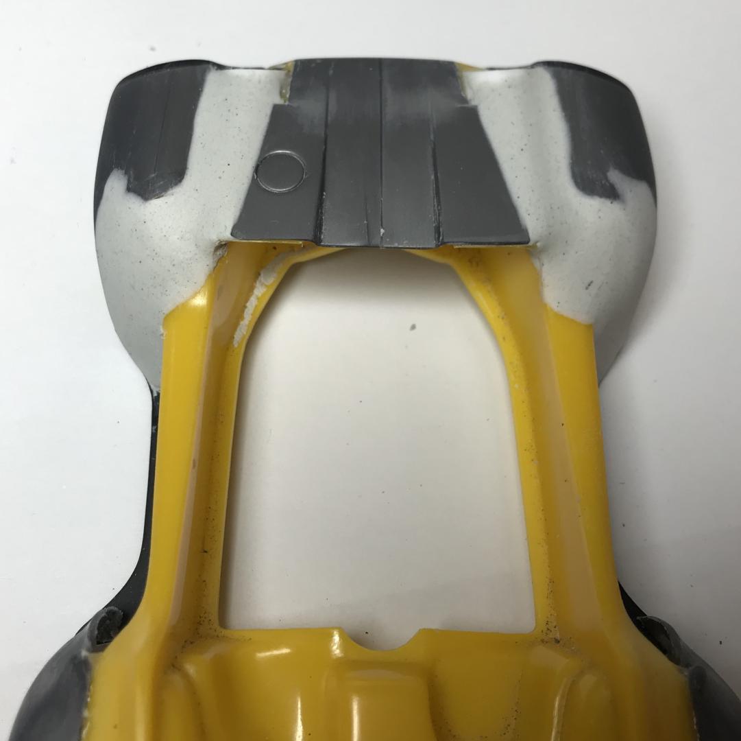

Trimmed off those bulky side skirts to make the nice hourglass shape more prominent, new skits made from .060 styrene

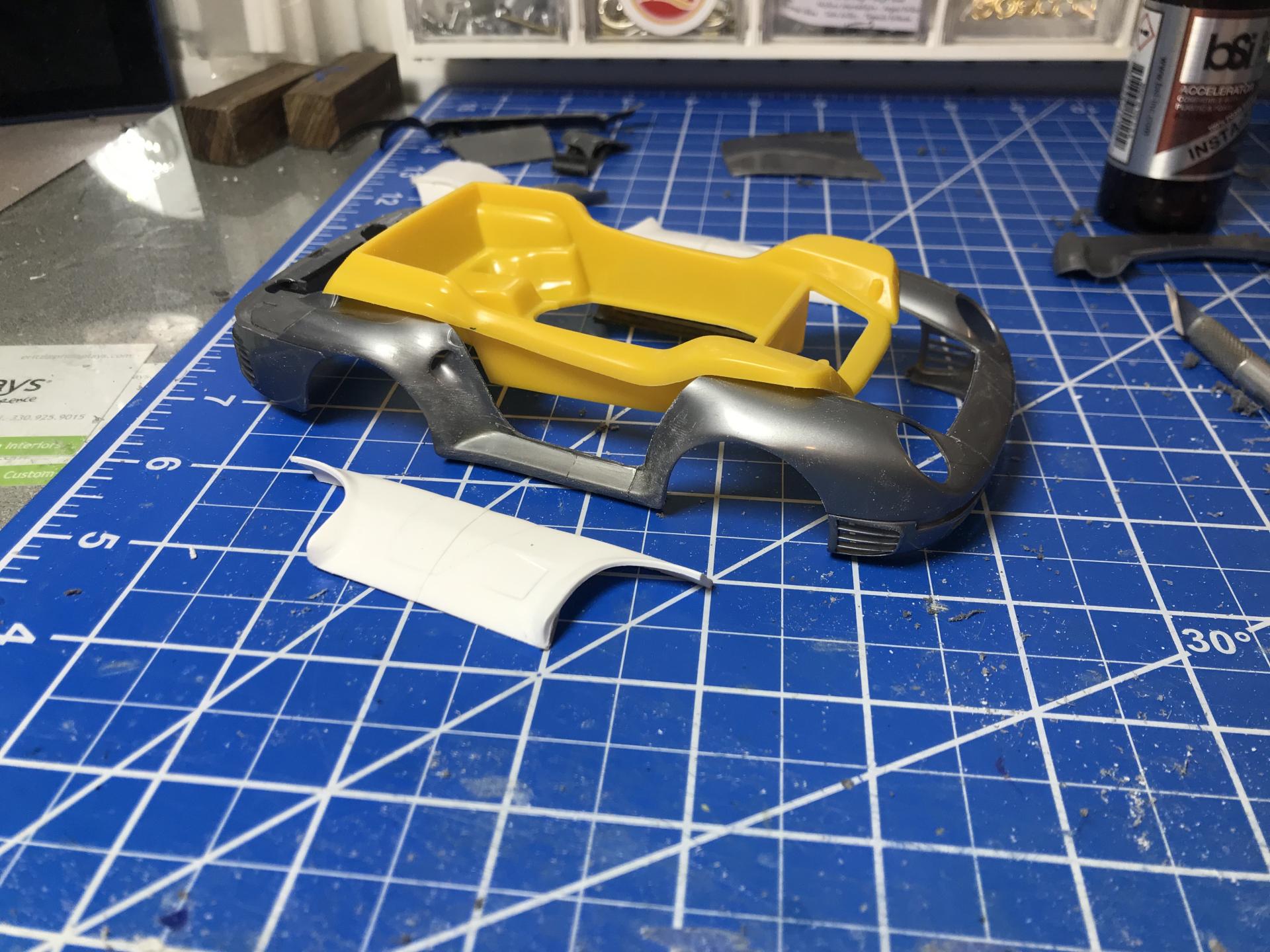

and finally last nights update... Narrowed the 959 hood to make a new lower front valence... with a little trimming this should fit nicely.

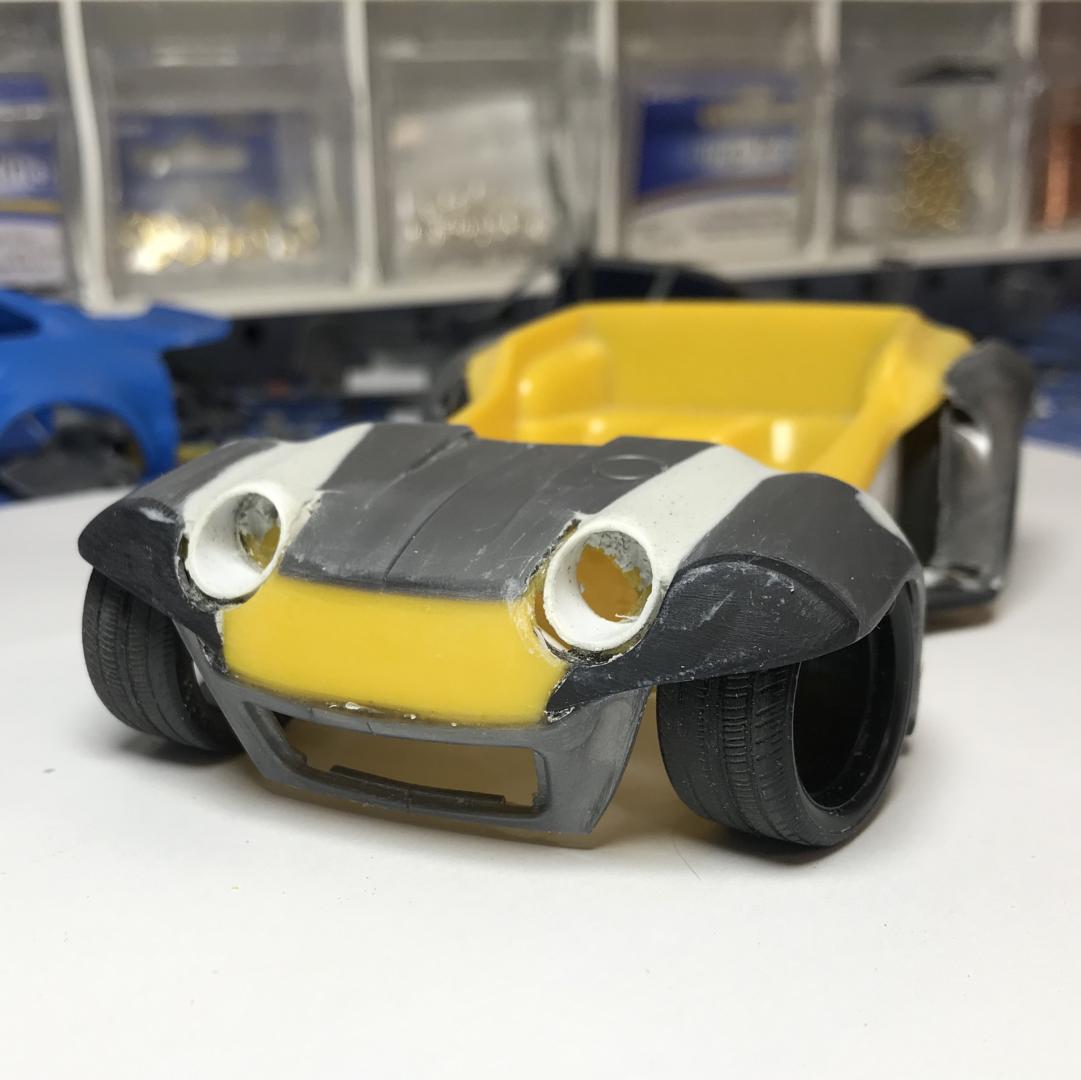

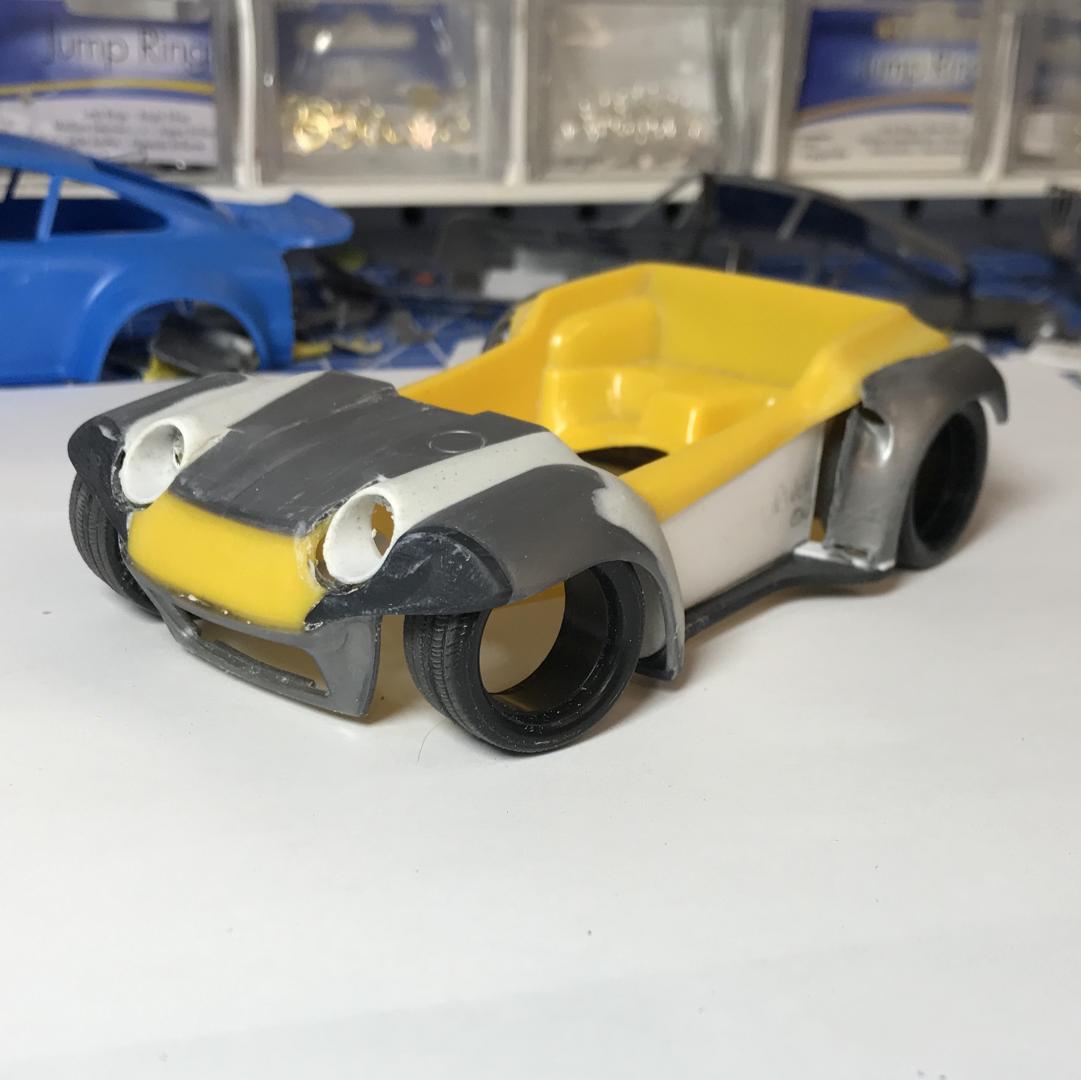

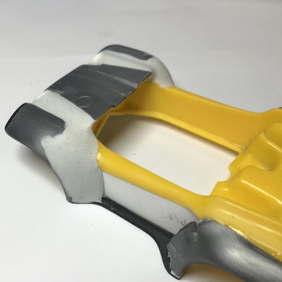

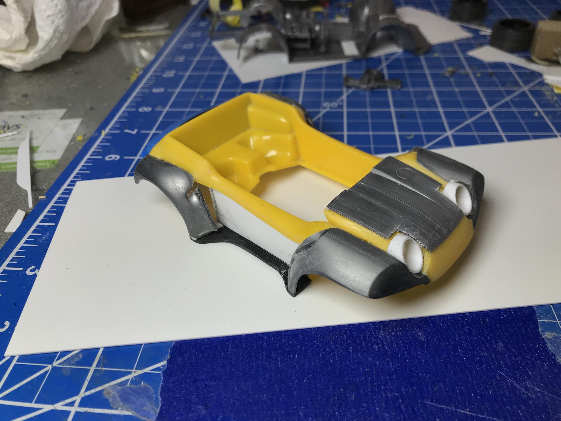

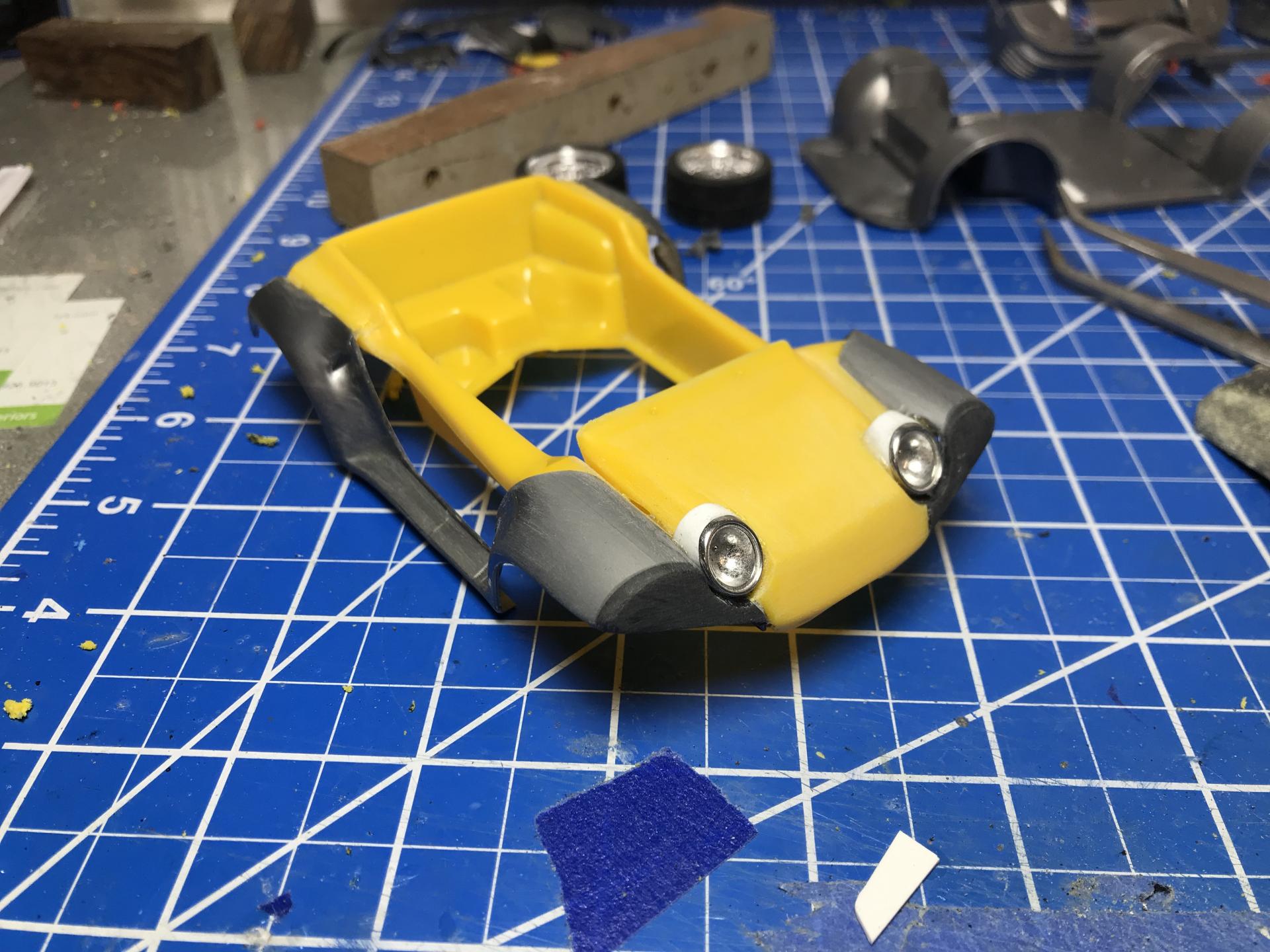

Thank you for your interest and comments! It is starting to shape up a little more.
The reversed 959 "hood" worked great for the lower front valence, its a little smiley at the moment, but that can be toned down as it continues to evolve.

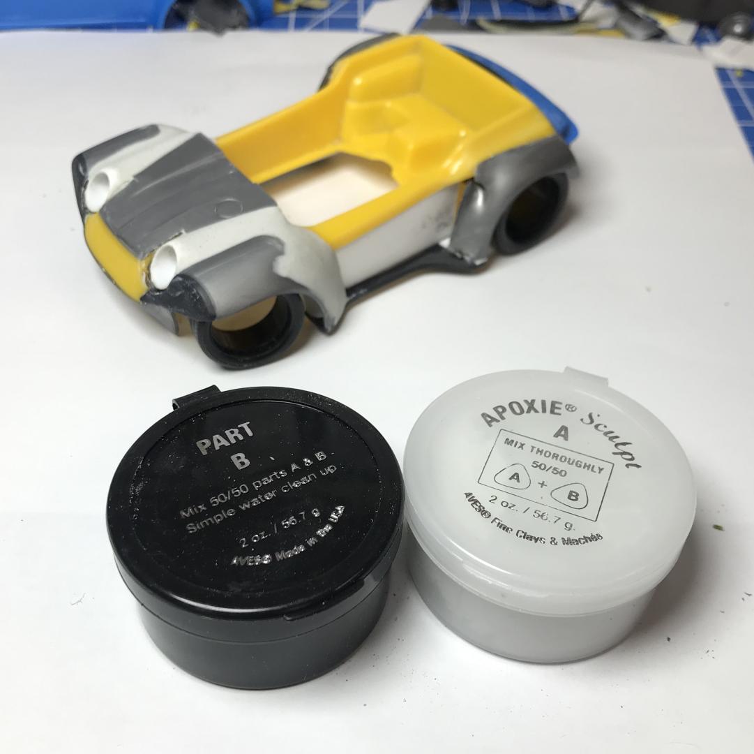

I always like to try and use something new on every build... and this time I wanted to try this Ames Apoxy Sclupt. https://www.avesstudio.com/shop/apoxie-sculpt/
Since, I had some big gaps to fill on this guy, it just made sense.  Last night i was able to work the front fenders and headlight pods, and this morning it was cured rock hard... tonight i will try sanding it to even it out.
So far I'm pretty impressed with the product.  It smooths out really well with a wet finger, and is less messy and stable than my usual bondo solution.
IMG_E1533.thumb.JPG.2dc26ec771705a61096dbdb164ab8d2a.JPGIMG_E1534.thumb.JPG.0de96d87cbc330f78ef7369808e26811.JPGIMG_E1535.thumb.JPG.4f4467a29e86160b52d582ec70c8585a.JPGIMG_E1536.thumb.JPG.71bfba4b6e9aa8f61a4bbc416138b1d0.JPGIMG_E1531.thumb.JPG.3a239b6f09cd0f84529567f2839b9887.JPG

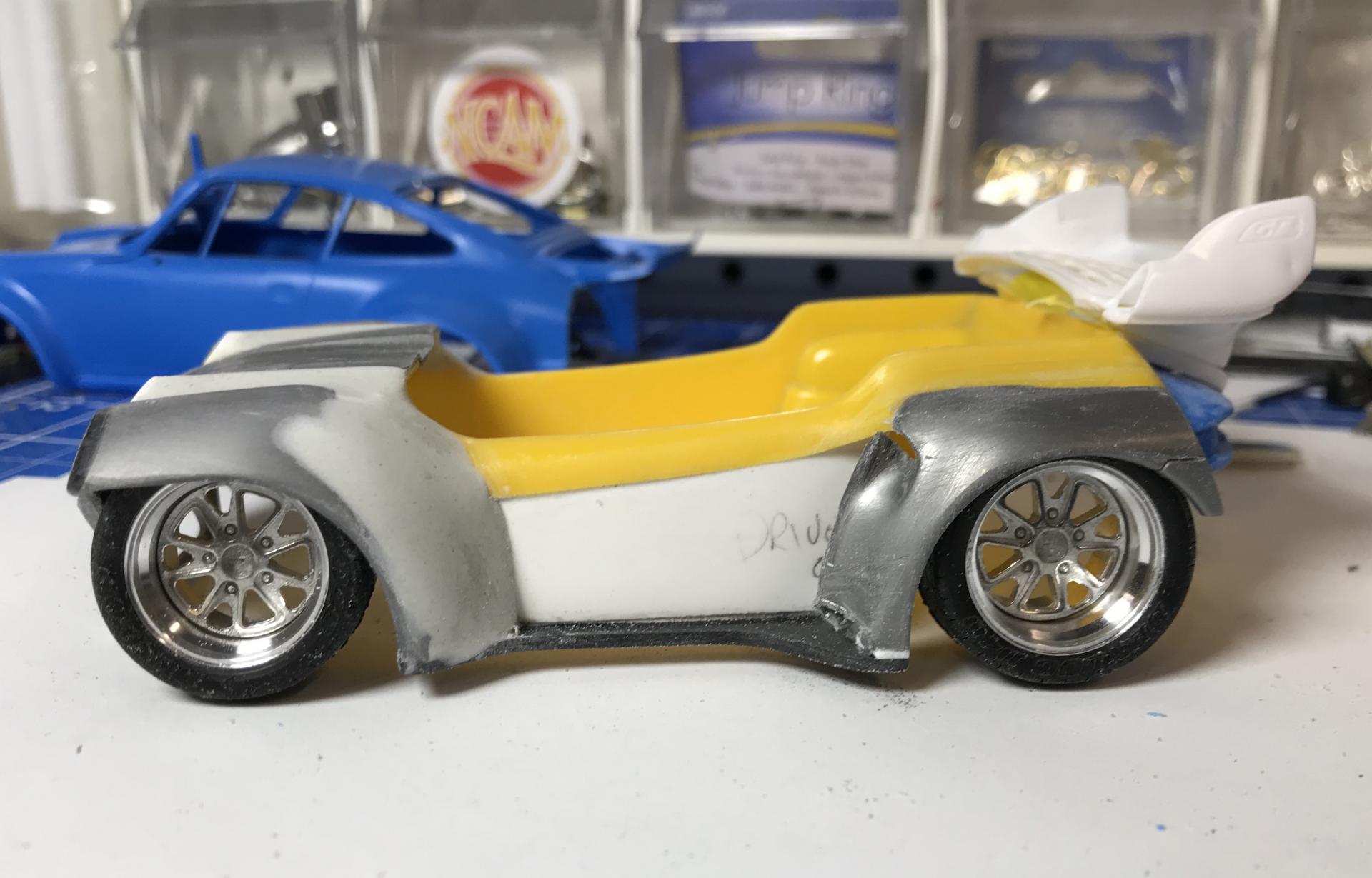

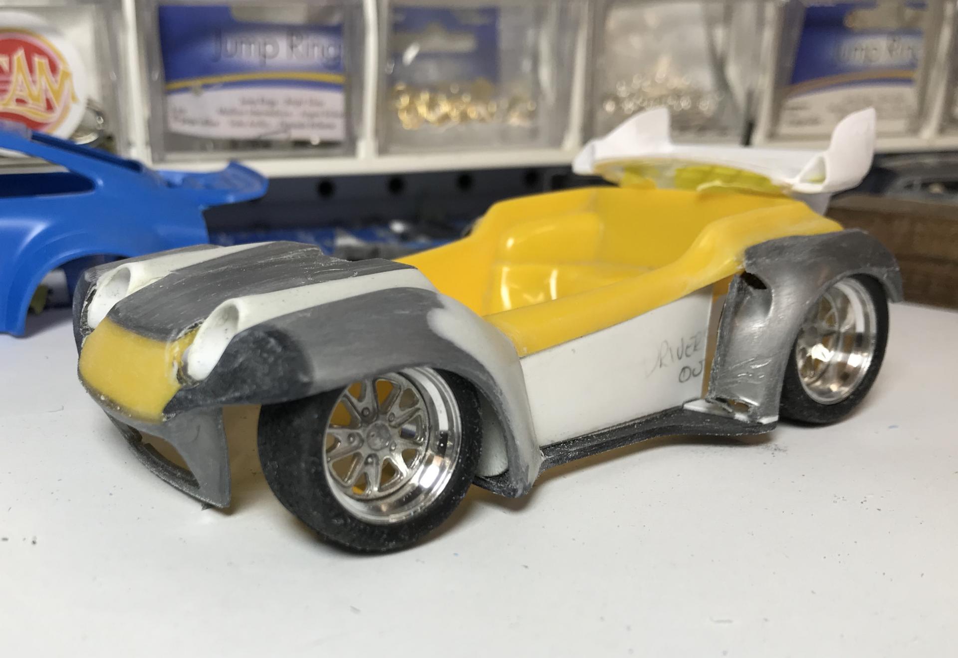

Thank you guys!
I haven't had much time to work on this, but I did start to get the wing fitted...still away to go on that.
I ordered some of the 17" fifteen52 outlaw wheels from scale production... they are fantastic... I also got their stretched wall toyo tires, but they are a bit low profile for this project, I want the tires to have a little more meat to the sidewall.  I went back to the tamiya 959 tires, and its starting to look pretty serious.
IMG_E1895.thumb.JPG.35604e7c0f250650682728aa833448d0.JPGIMG_E1896.thumb.JPG.cf7e02ced85d00244b5f19c0c3768390.JPG
