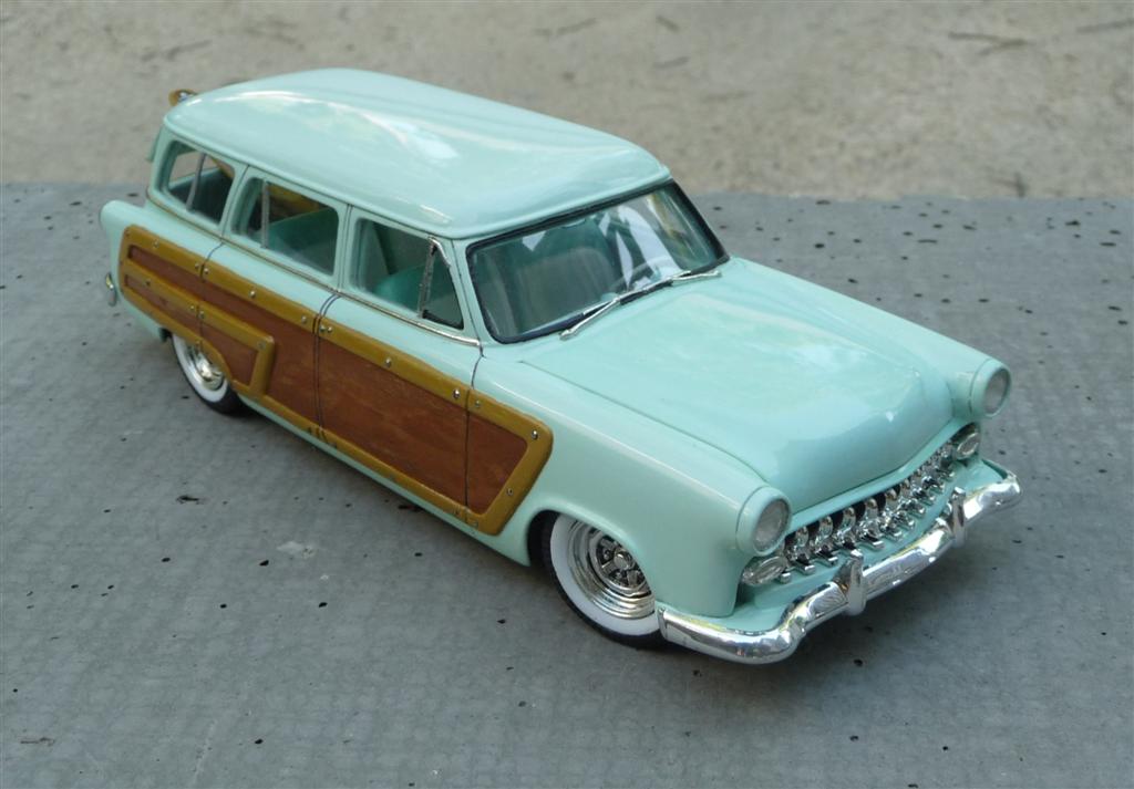

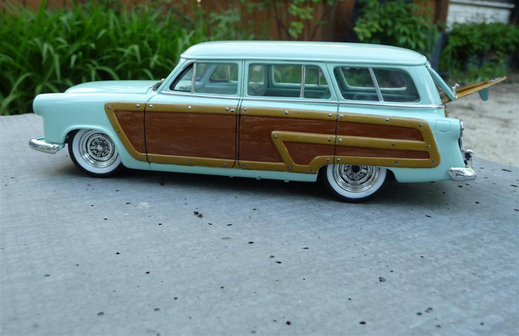

Mr. Metallic Posted May 31, 2019 Share Posted May 31, 2019 Jimmy Flinstone has been around for 20+ years, and his quality has increased quite a bit over that time. Since the beginning, his bodies were priced well below his contemporaries, so there are a lot of them floating out there. His prices are lower because he deals in volume. And prior to about 7-8 years ago, the quality was representative of bodies that were designed to be produced very quickly. Most casting were quite thick, and required work to be able to be used with kit donor chassis and interiors. More recently though his bodies have been much better with regards to thickness and window/hood openings. One thing I have noticed in this time though it a very stubborn release agent that can be present and must be thoroughly dealt with before painting. So, his bodies are best purchased in person so you can evaluate exactly what you're getting. Here's an Edsel wagon i built from one of his bodies. This body was almost a drop on, quality wise. Quote Link to comment Share on other sites More sharing options...
