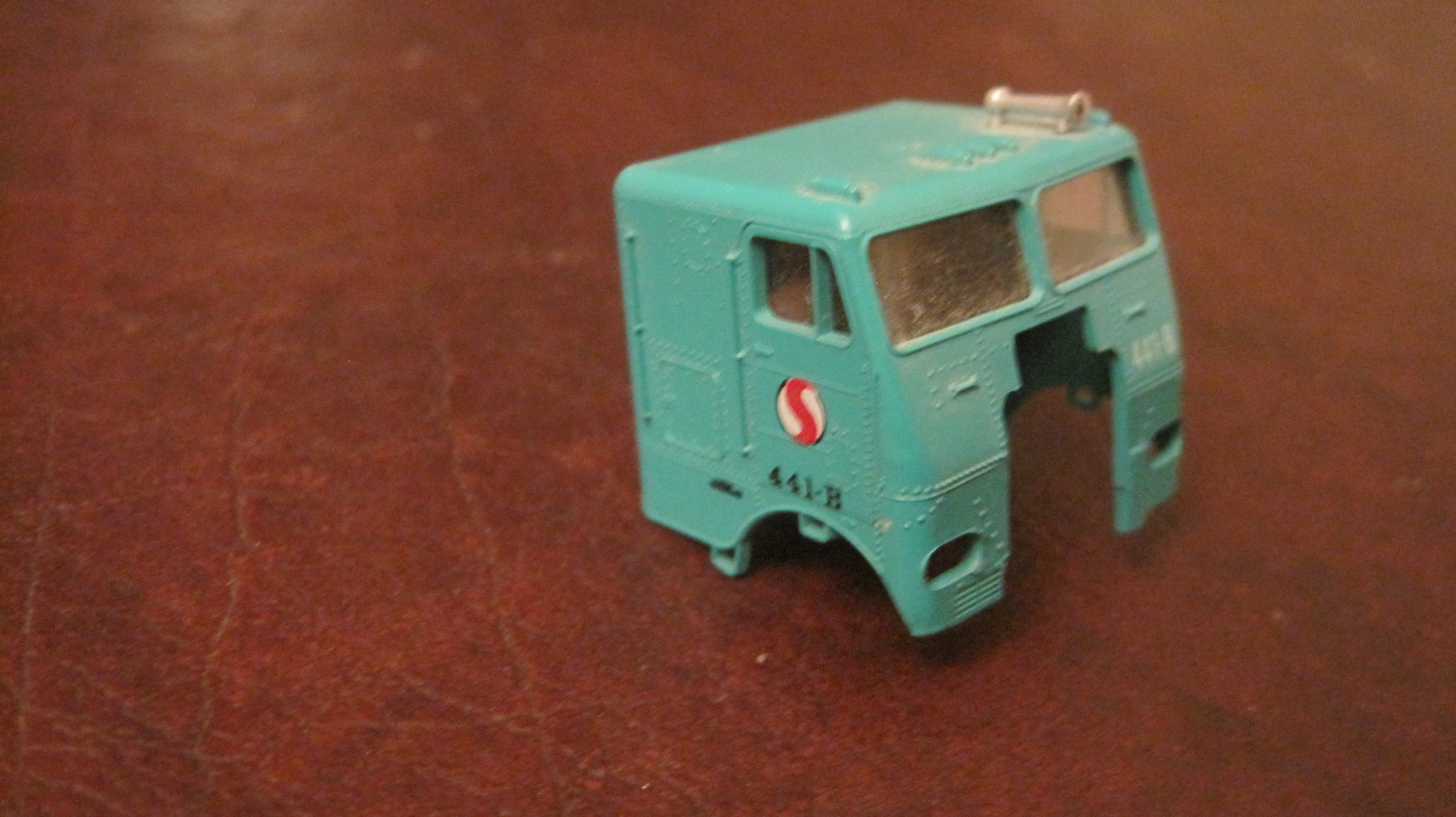

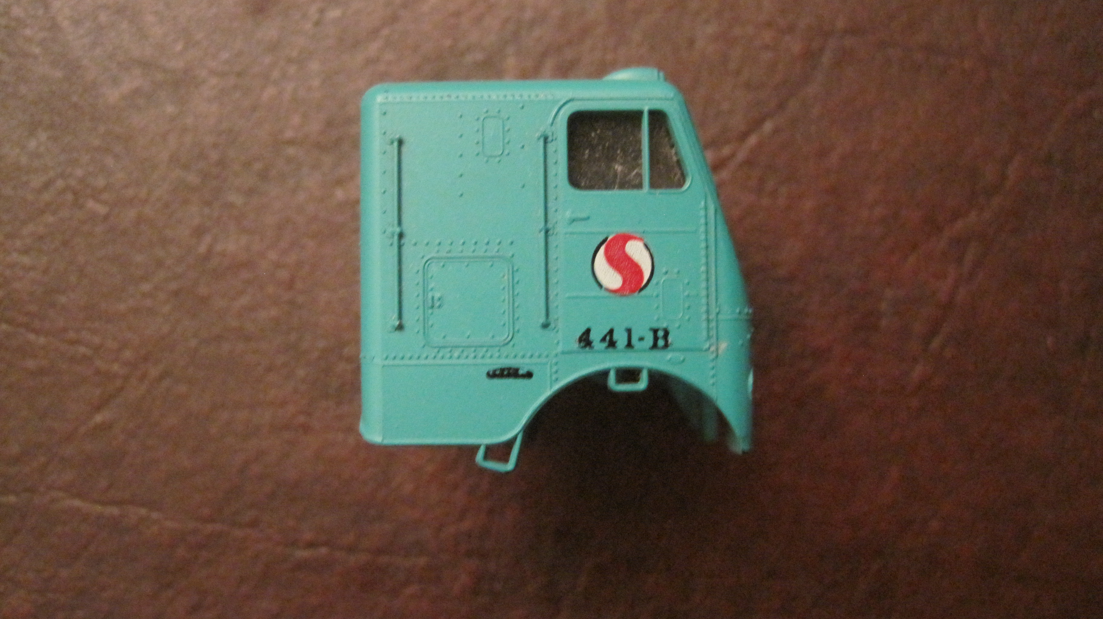

Too much attention for me. Are there any 1/25  resin casters  interested in doing a correct late 60's WF?  1/87 guys had it for years.
