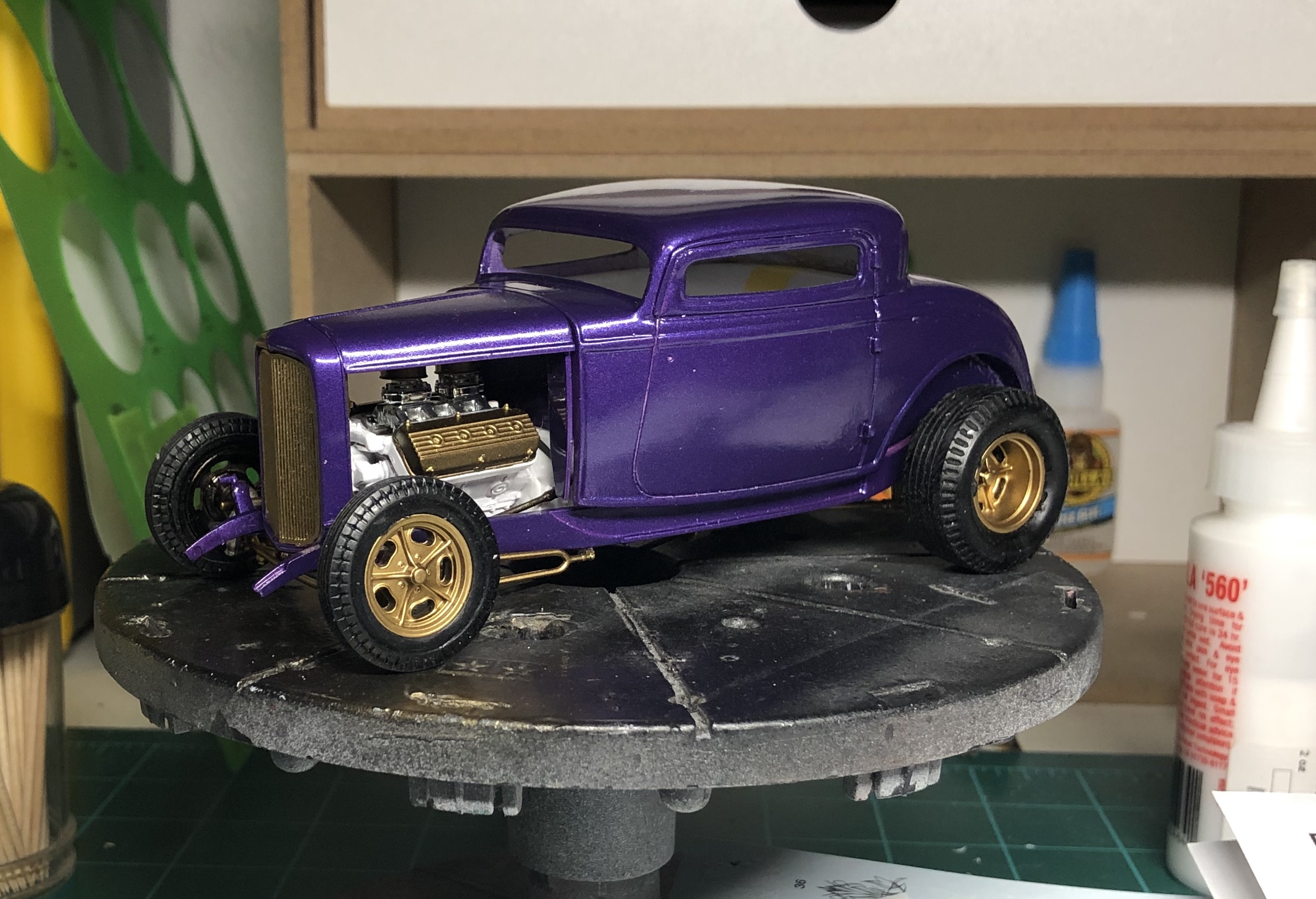

I got a set from Greg and sprayed them with AlClad pale gold for a ‘33 I’m working on. I also have a set of tires he did, but there was a problem with the mold and he has to make a new one.
