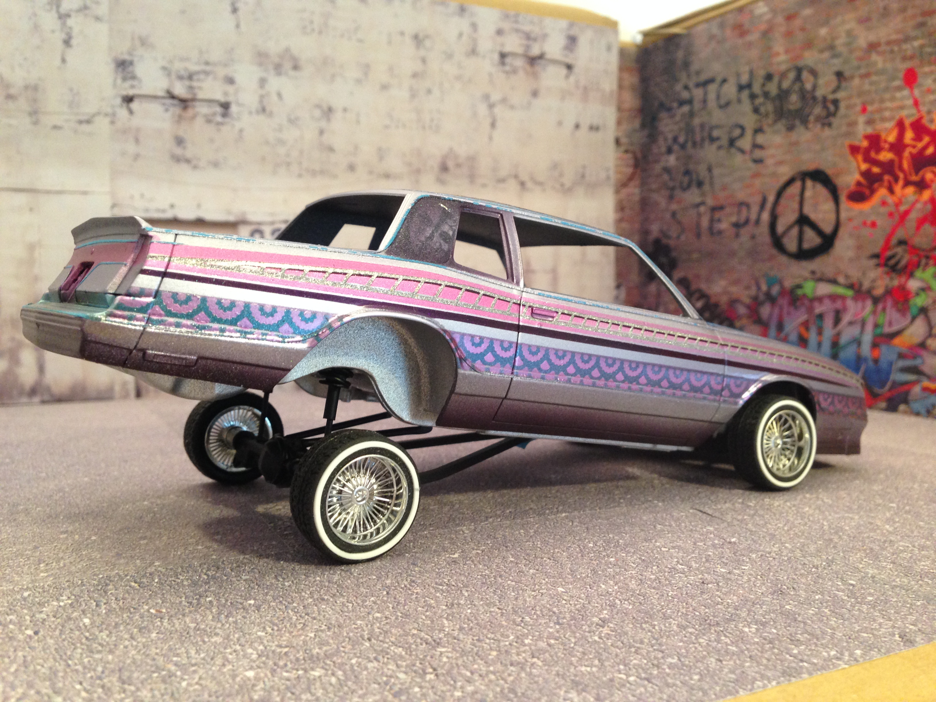

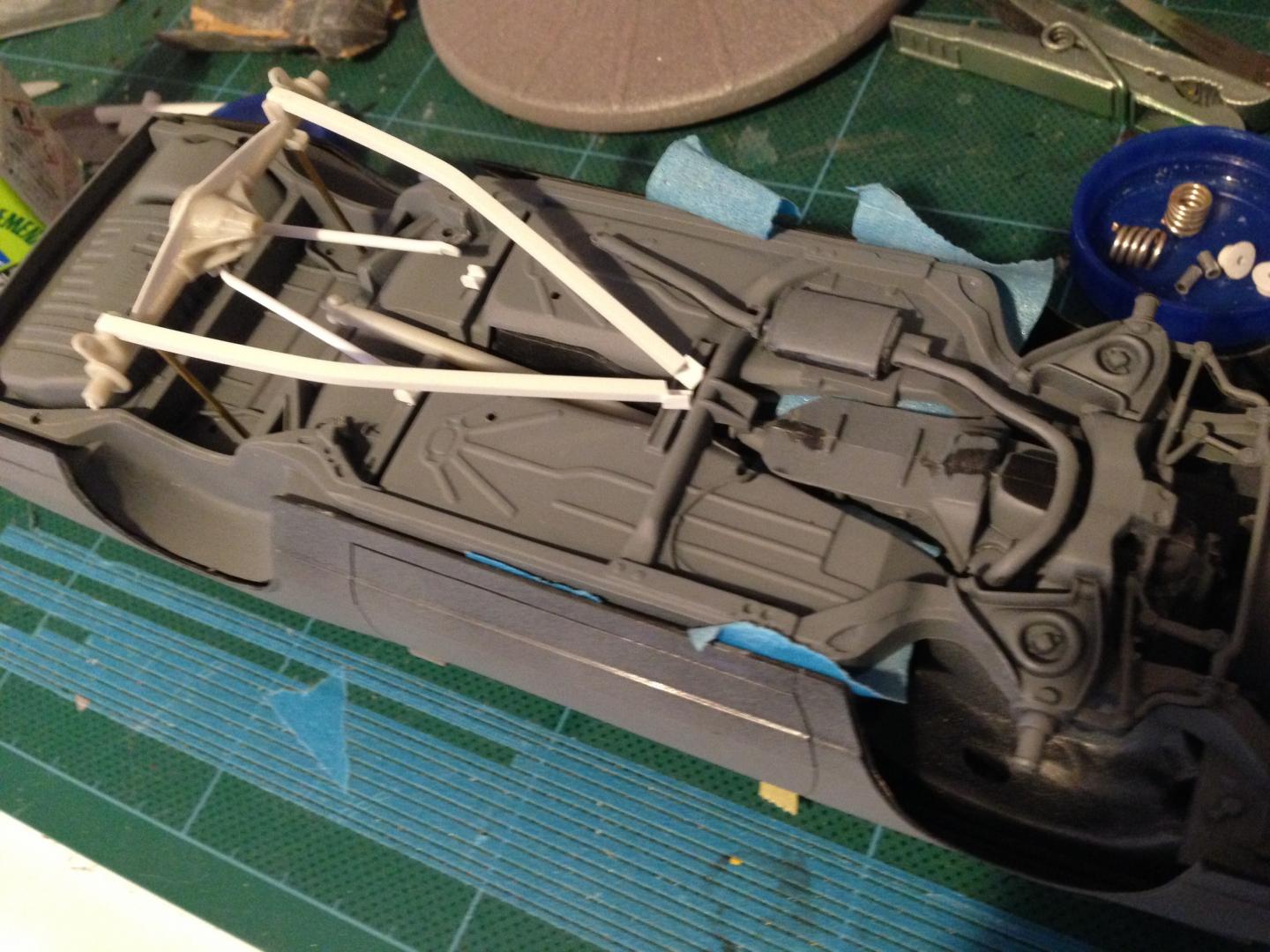

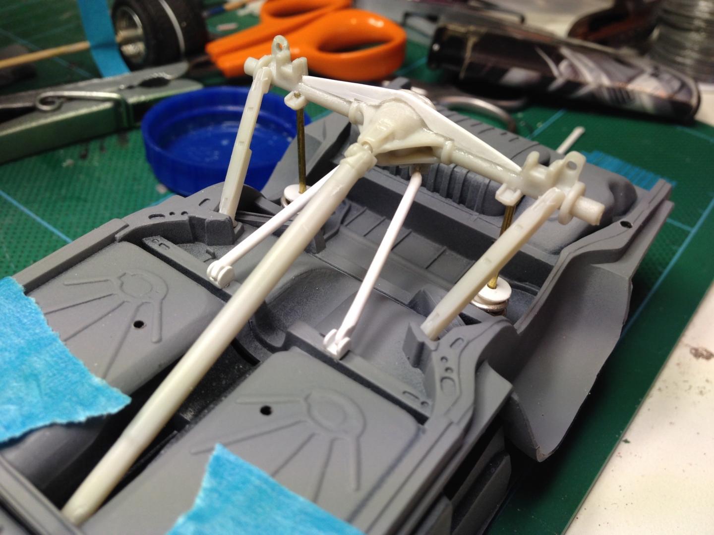

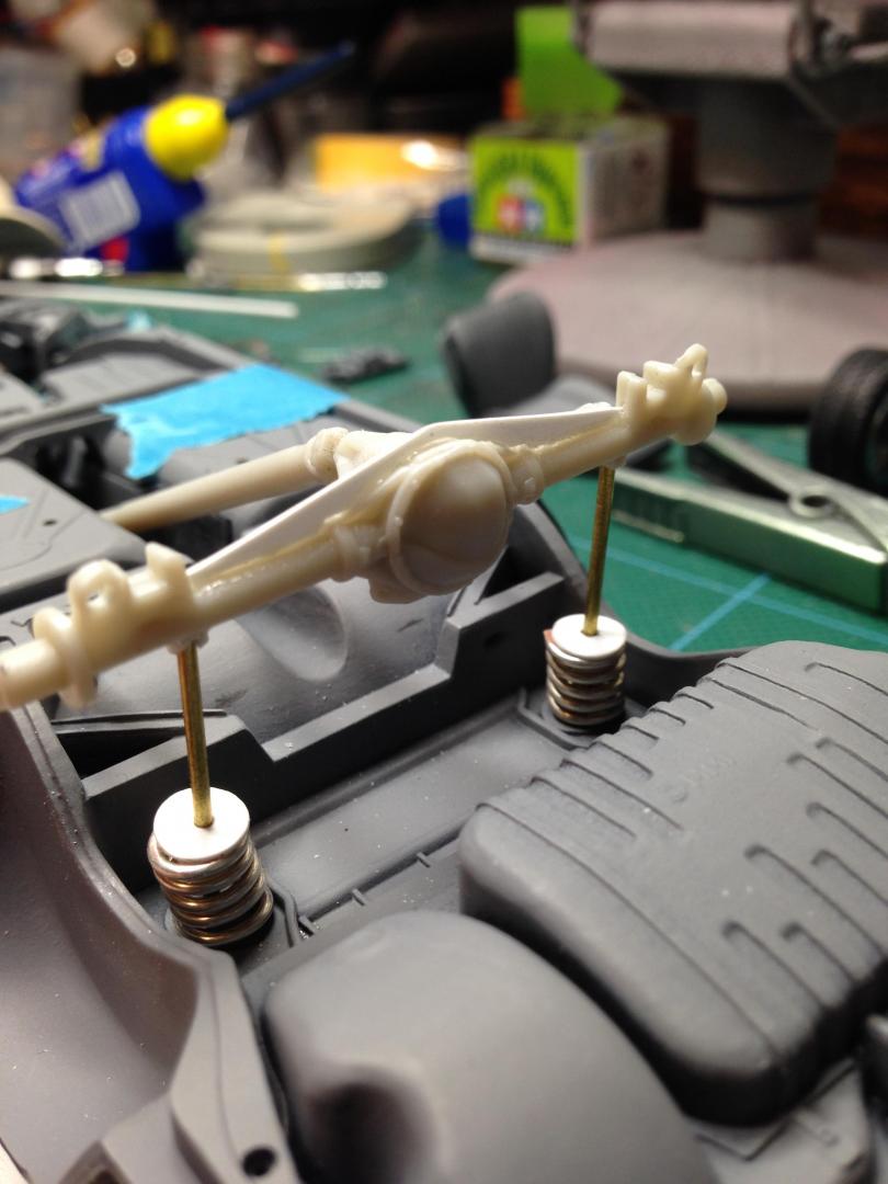

I had to use a better rear axle than the one in the kit, which was hollow on the top and looks rubbish. I added a reinforcement plate.
 I had to play about with the control arm positions and create a 4-link set-up. Longer arms prevent the wheelbase from changing too much. Even though I'll fix this in an extended position, I made sure everything lined up in the lowered position, too.
Share this post
Link to post
I made some springs and caps with telescopic inners from brass rod and aluminium tube.
everything will be chromed

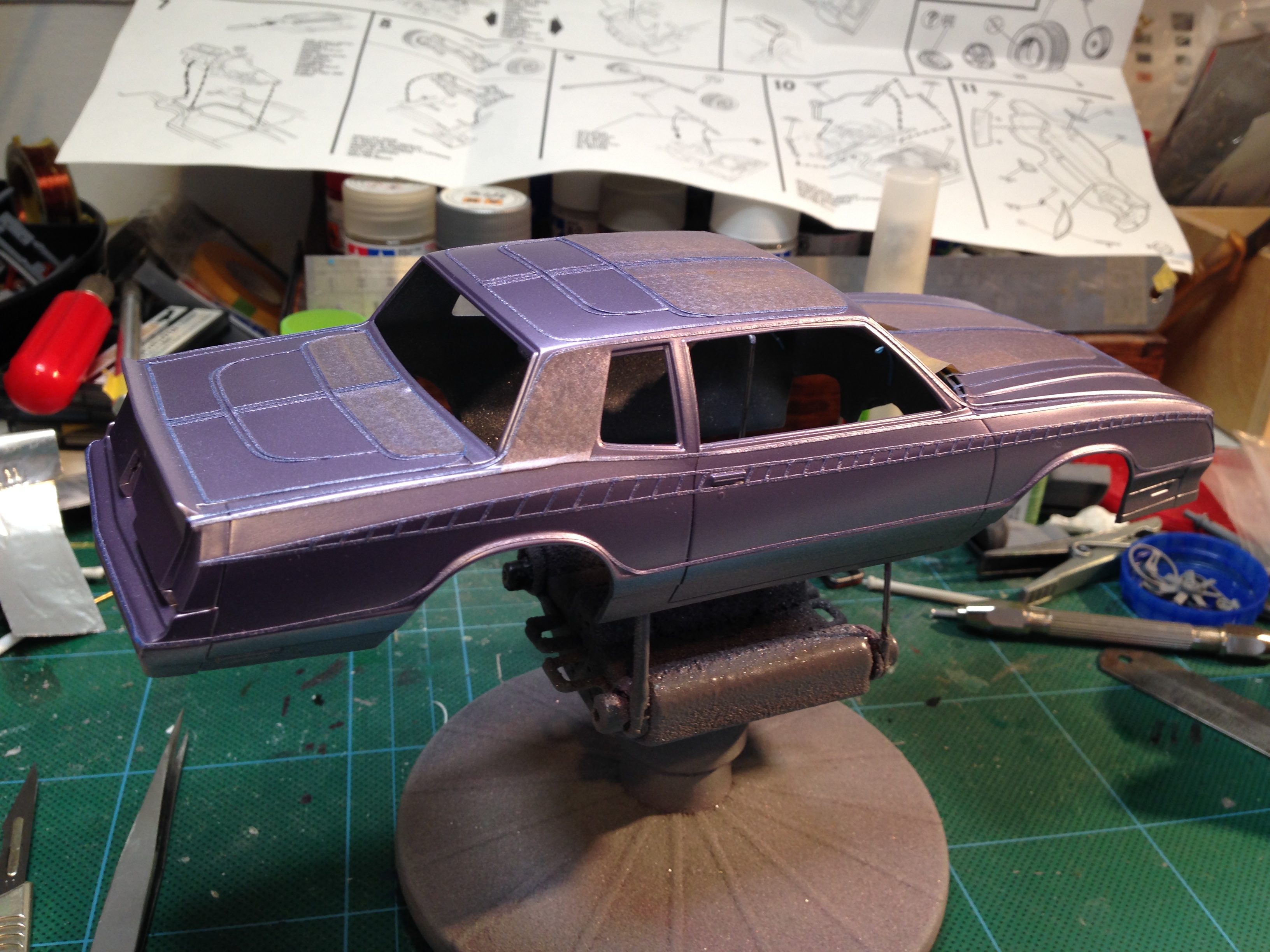

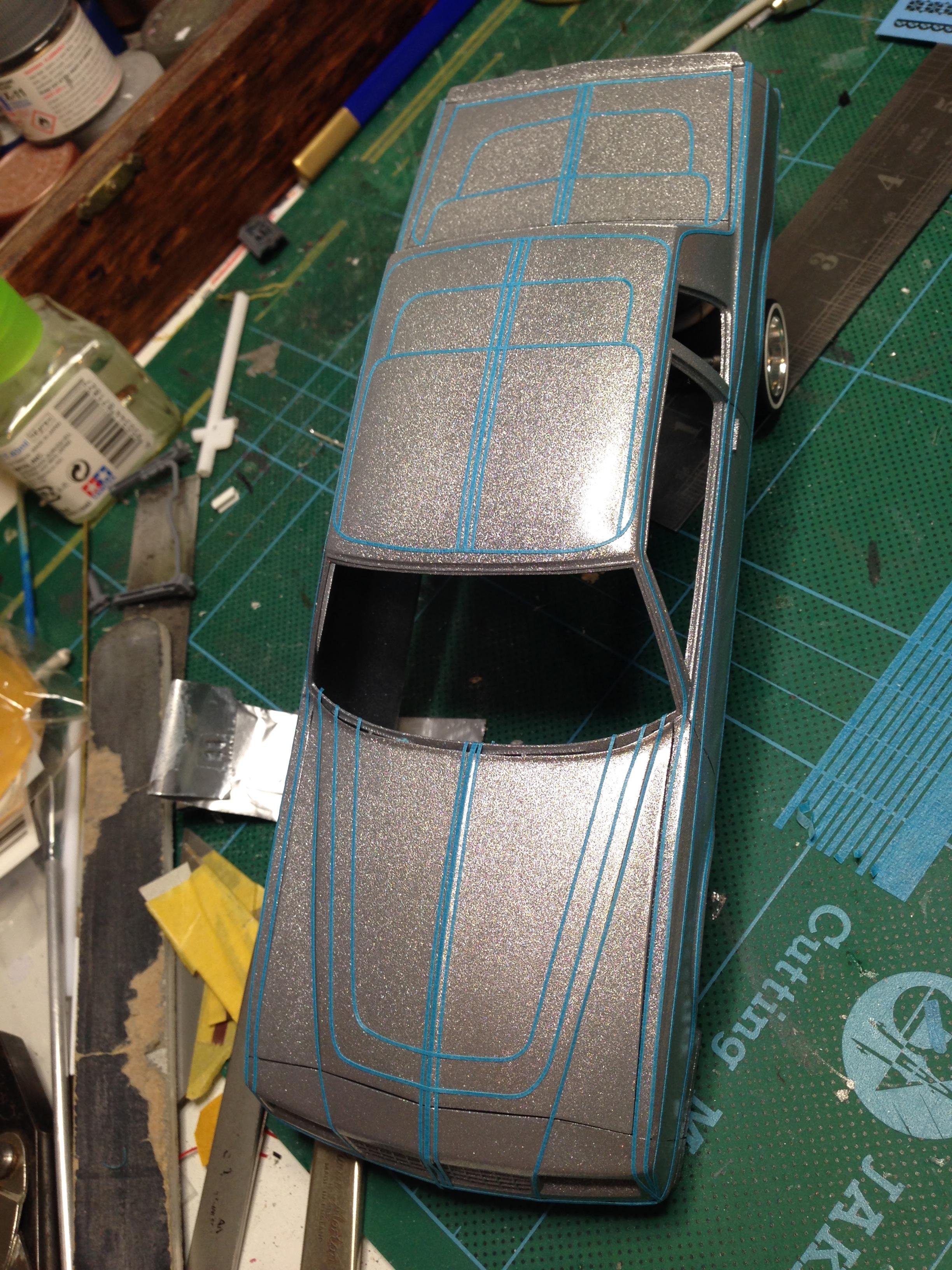

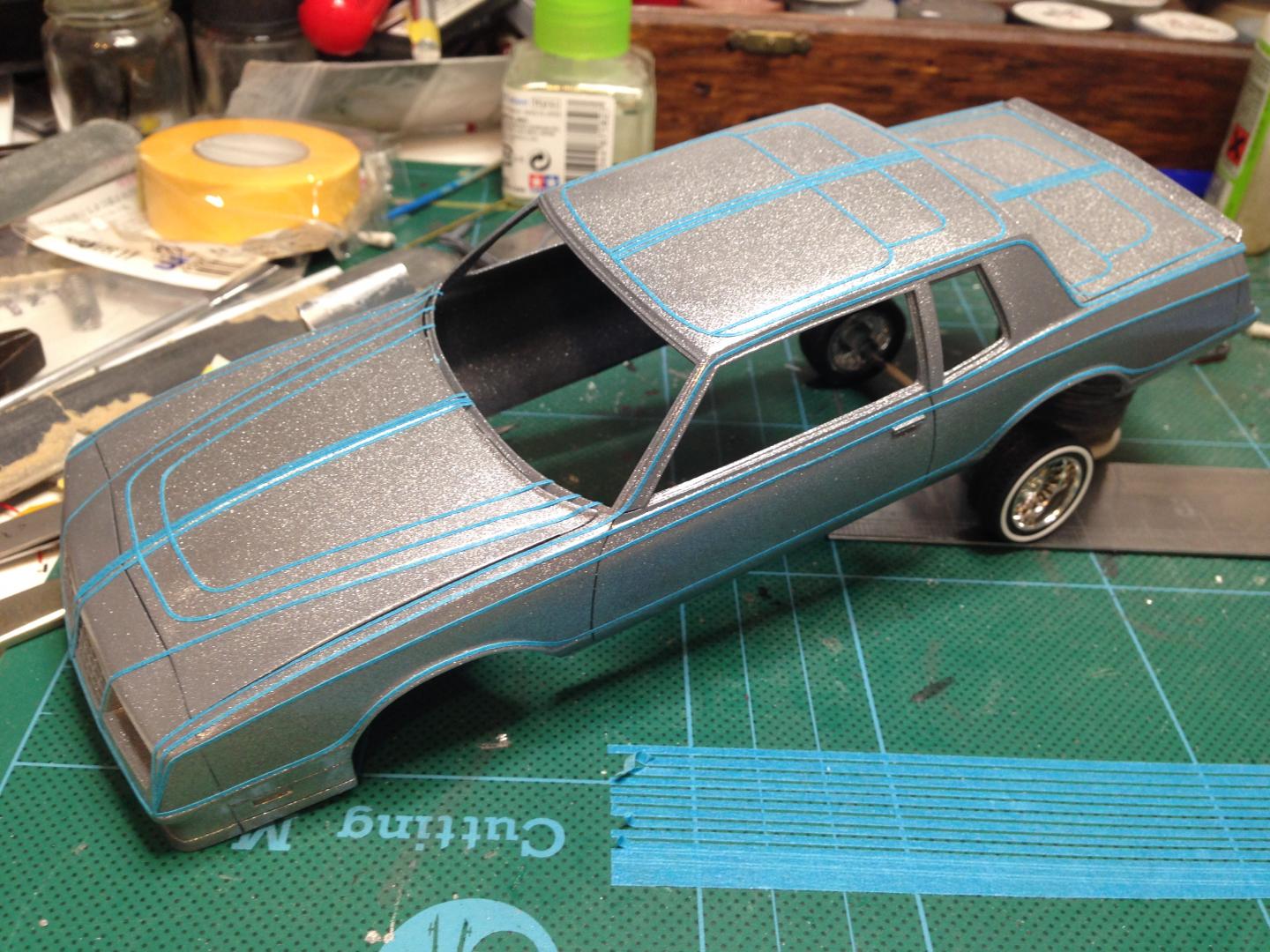

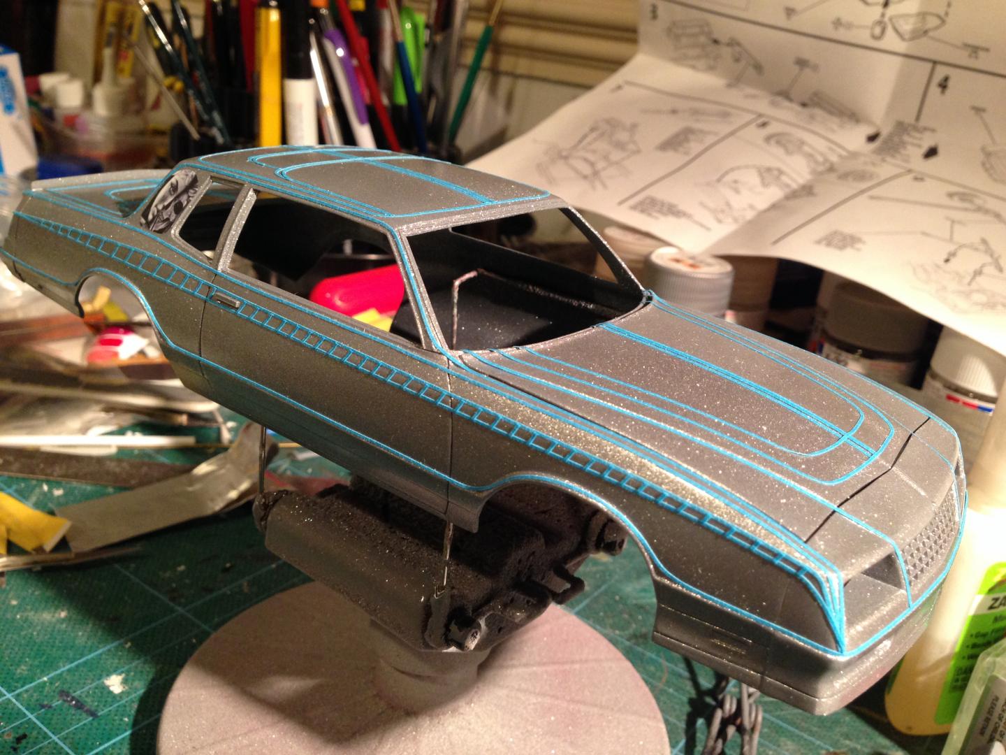

Now to cut some fine line tape and get creative with the paint!
Share this post
Link to post

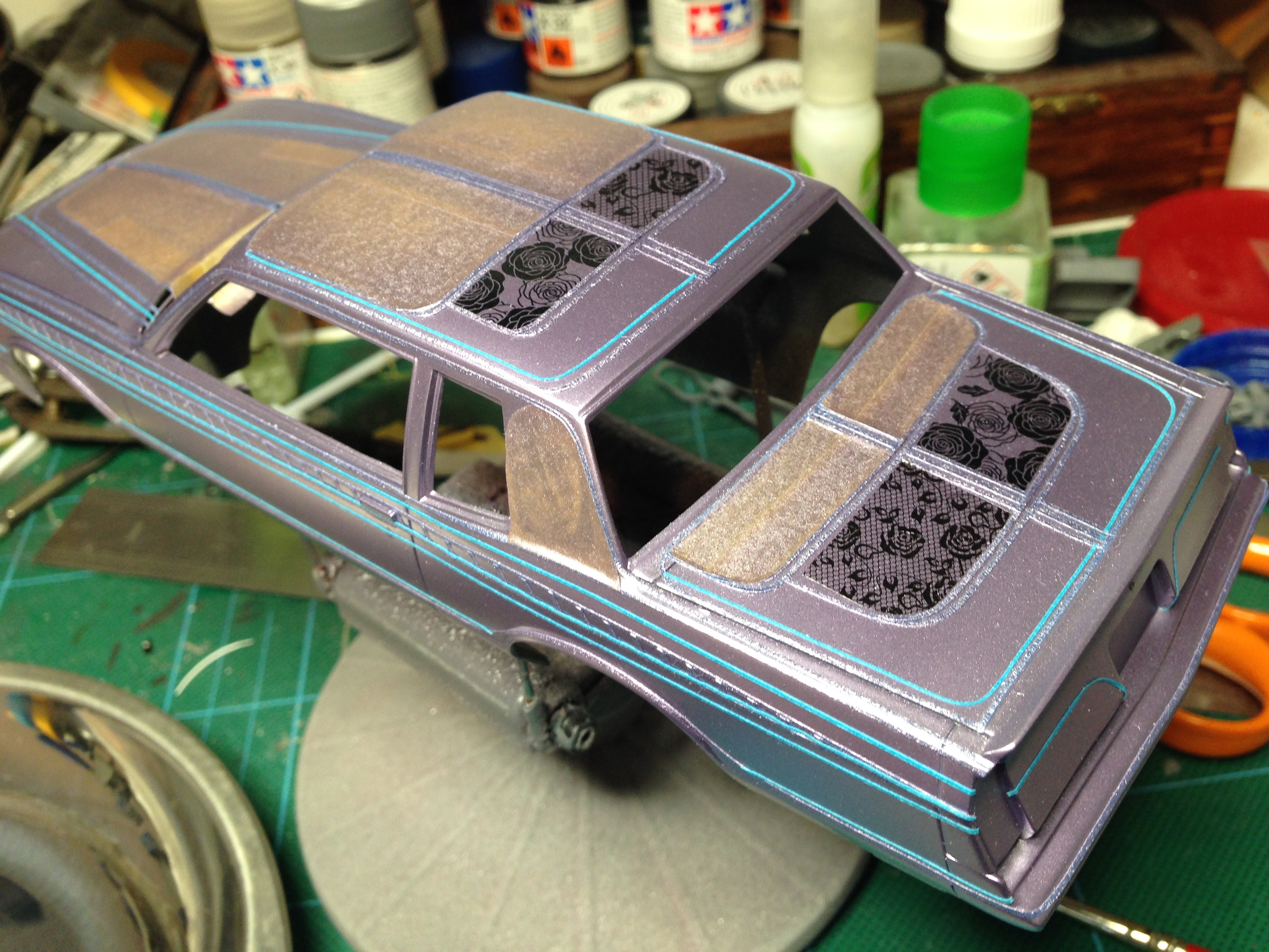

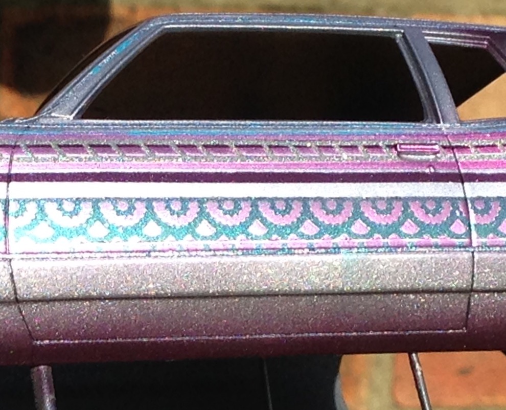

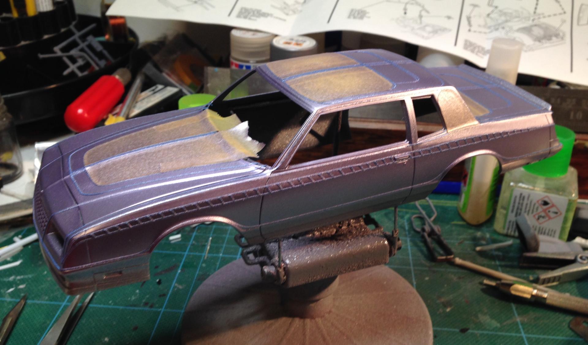

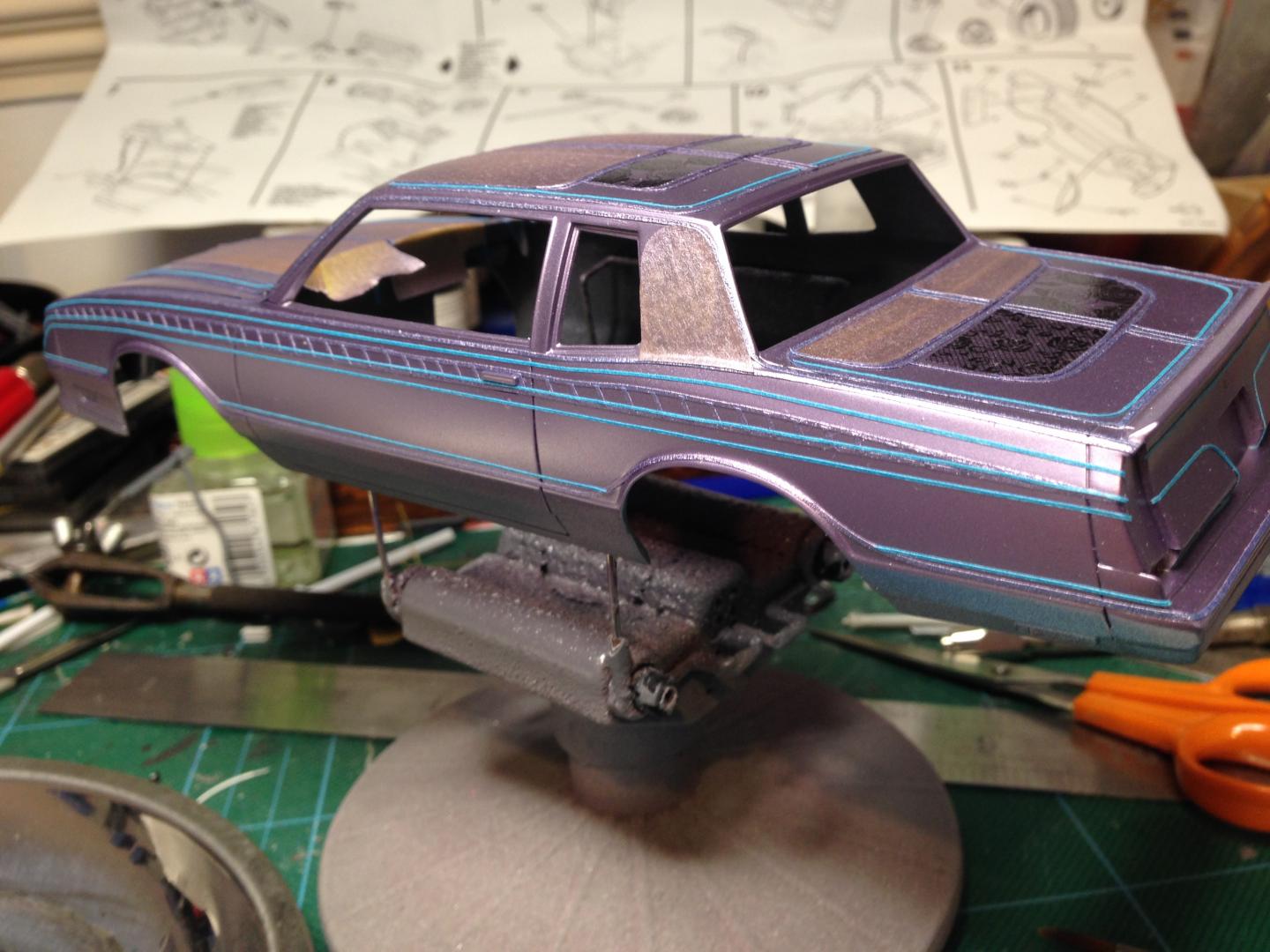

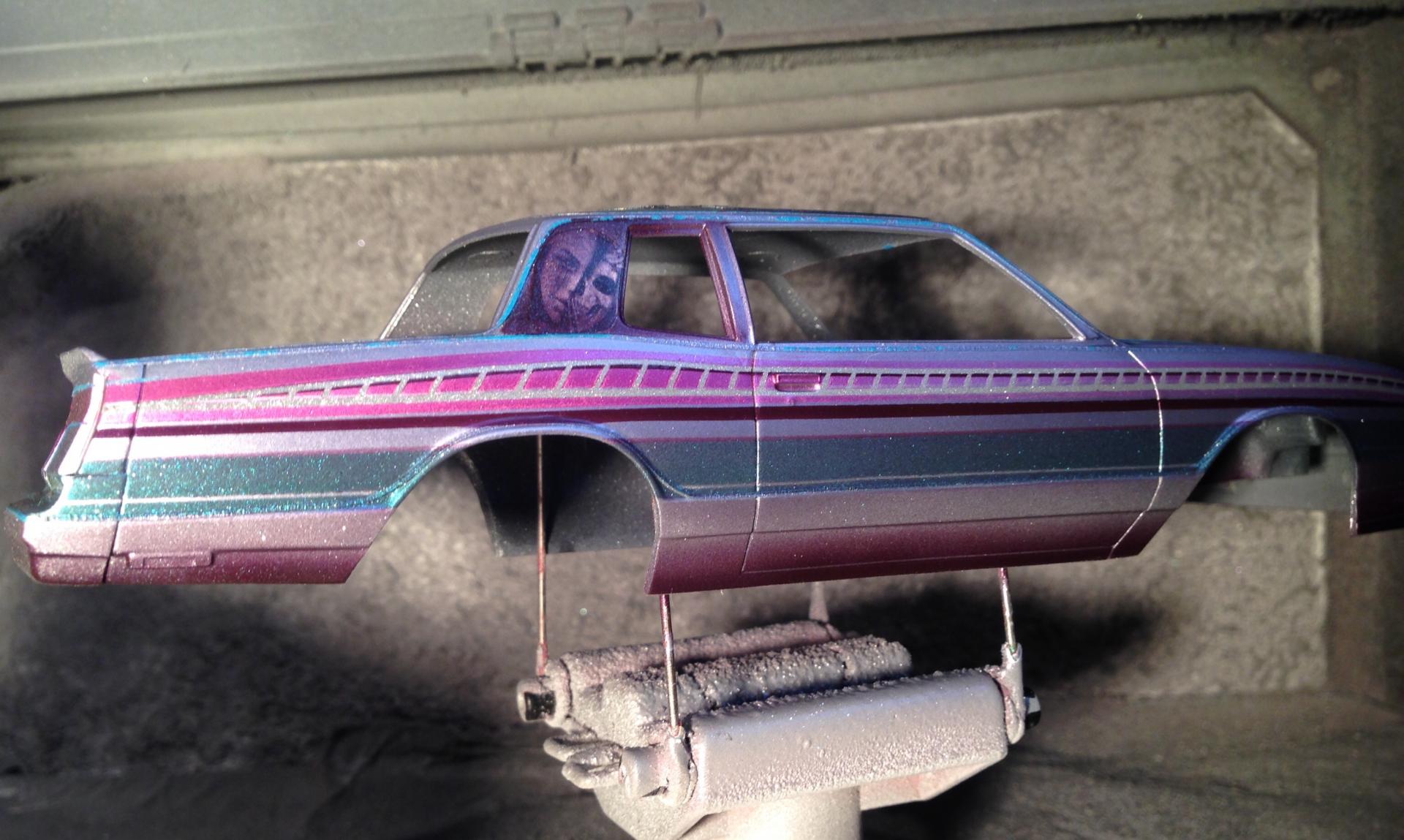

Got the first colour on. Really cheap 'chrome' purple nail polish.
Came out lovely for £2 a bottle

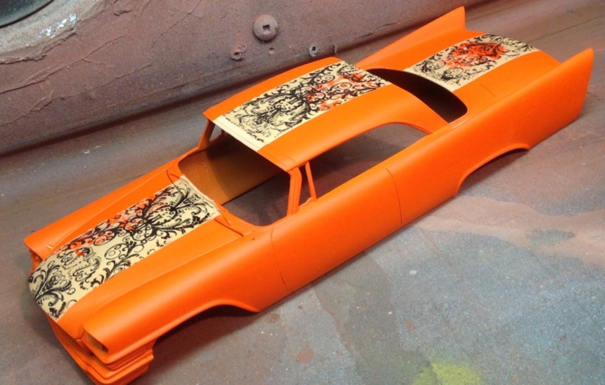

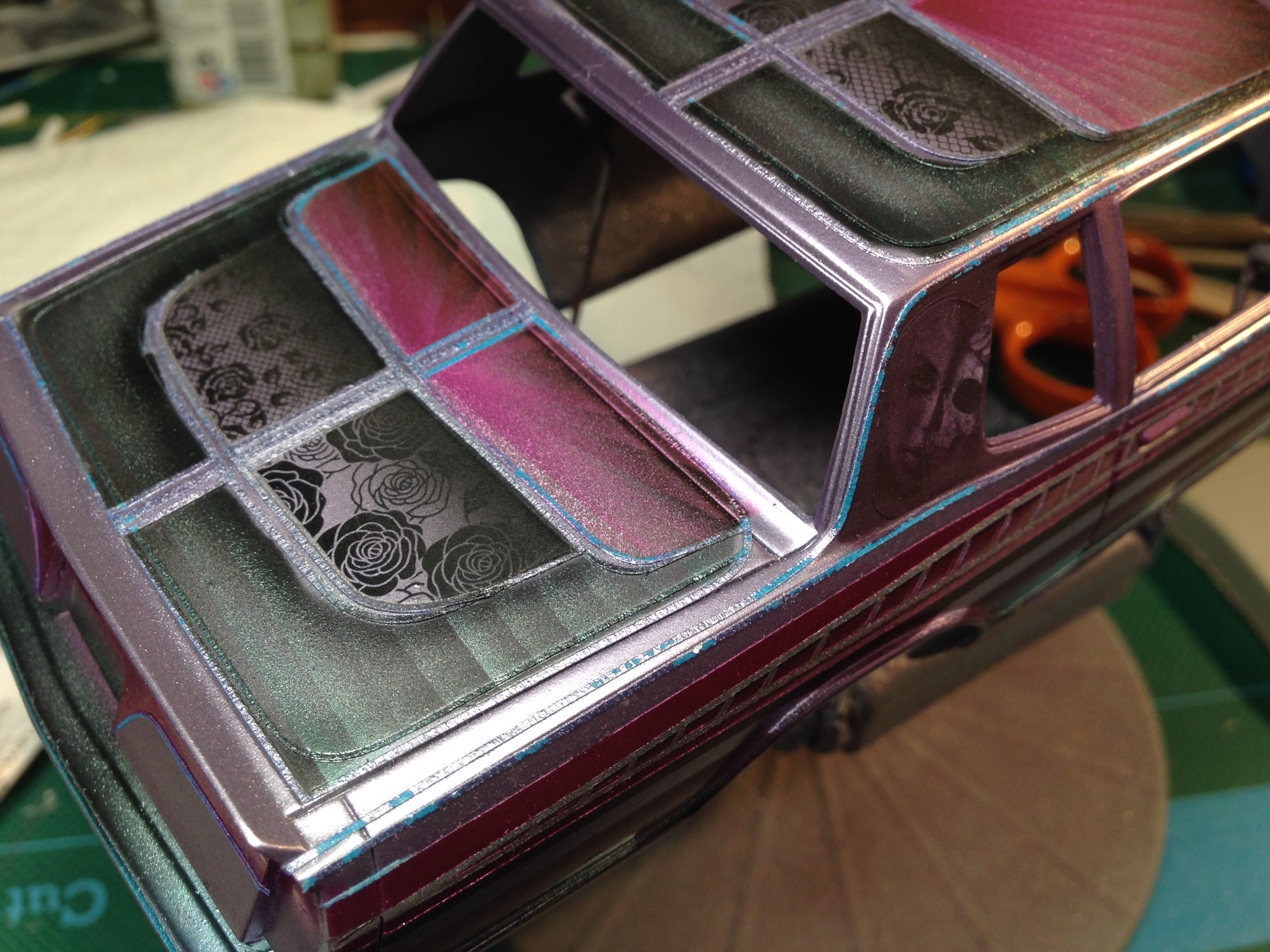

then added some lace nail art decals to a few panels
Share this post
Link to post

2 hours ago, Superbird McMonte said:
 Very impressive! Once you apply the nail art, is it sealed somehow before you cover it with tape?
Thanks!

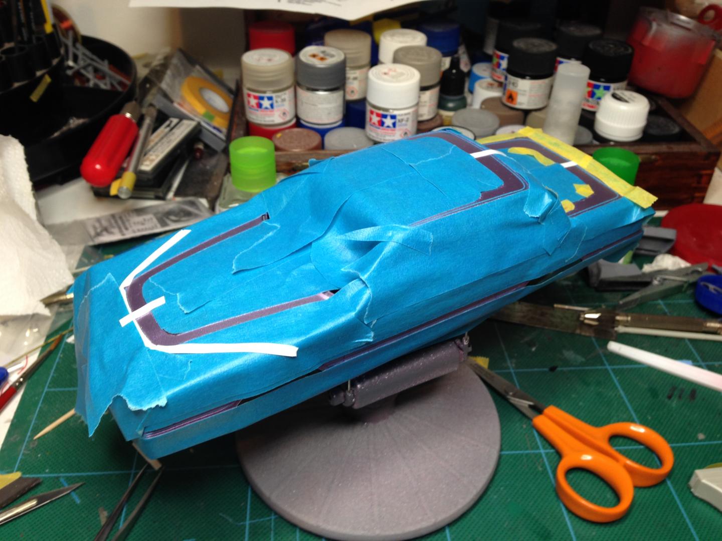

yeah, you've gotta seal it. Either clear or candy, depending on how the pattern is going.
Although, subsequent tape layers are reduced in tackiness, by laying the tape on my inner forearm, before applying it to the model. This helps prevent lifting of the tape underneath when I remove top layers.

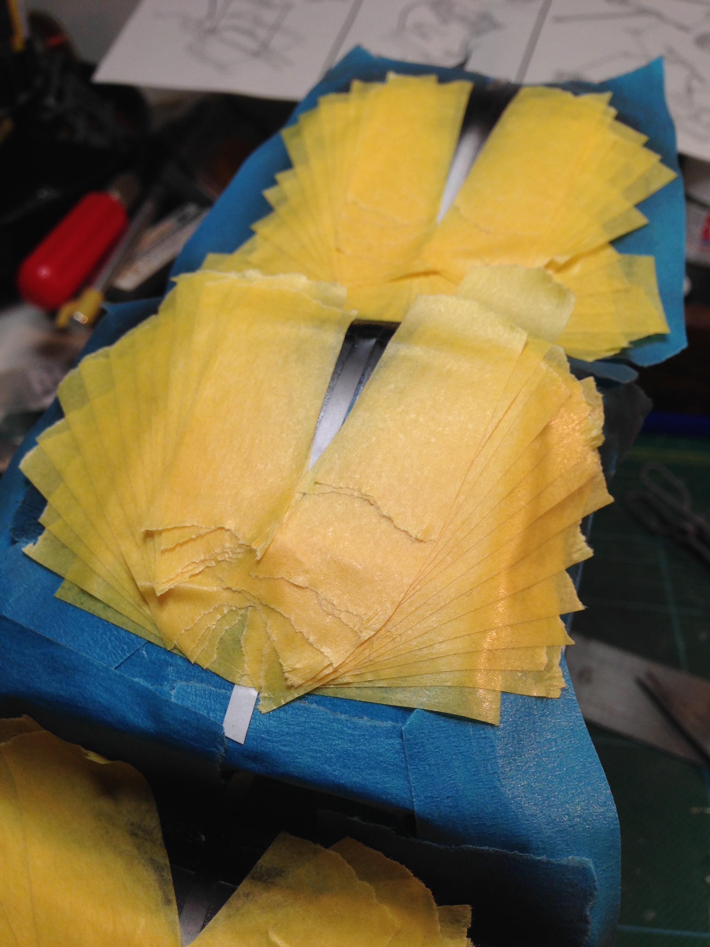

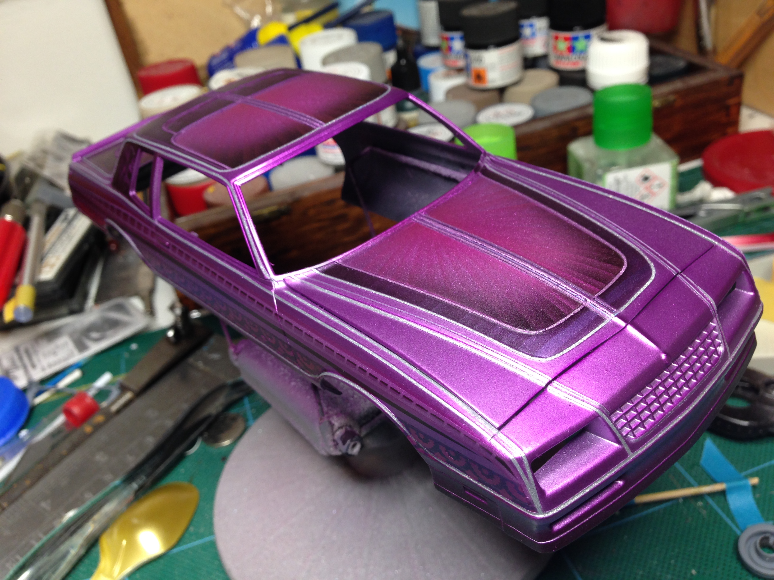

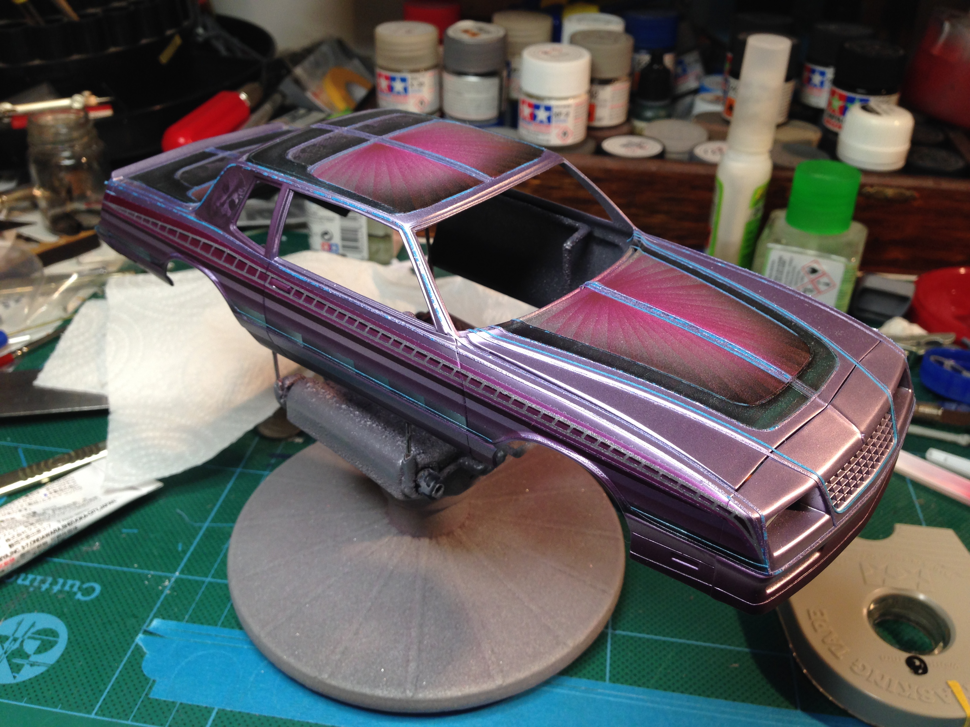

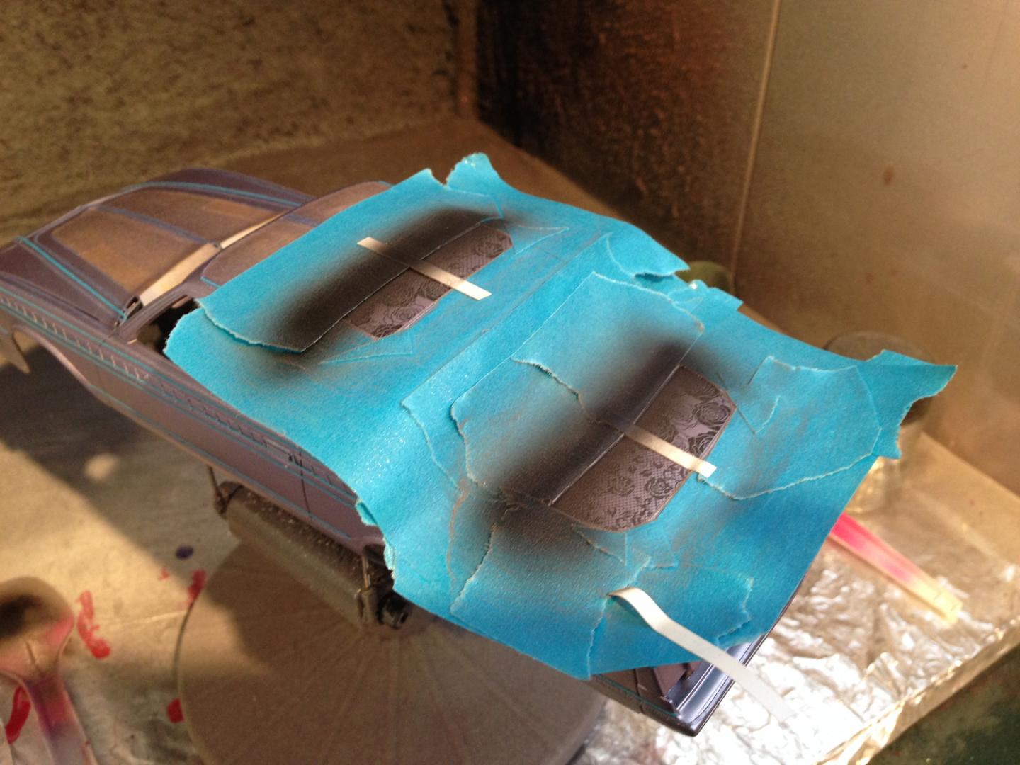

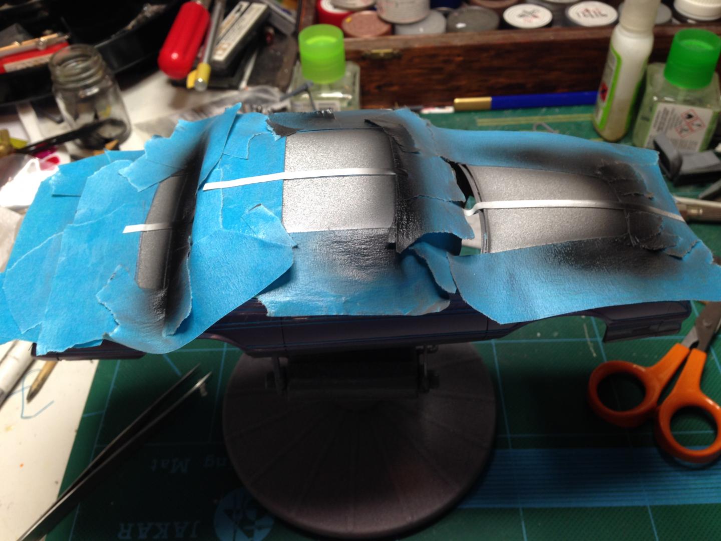

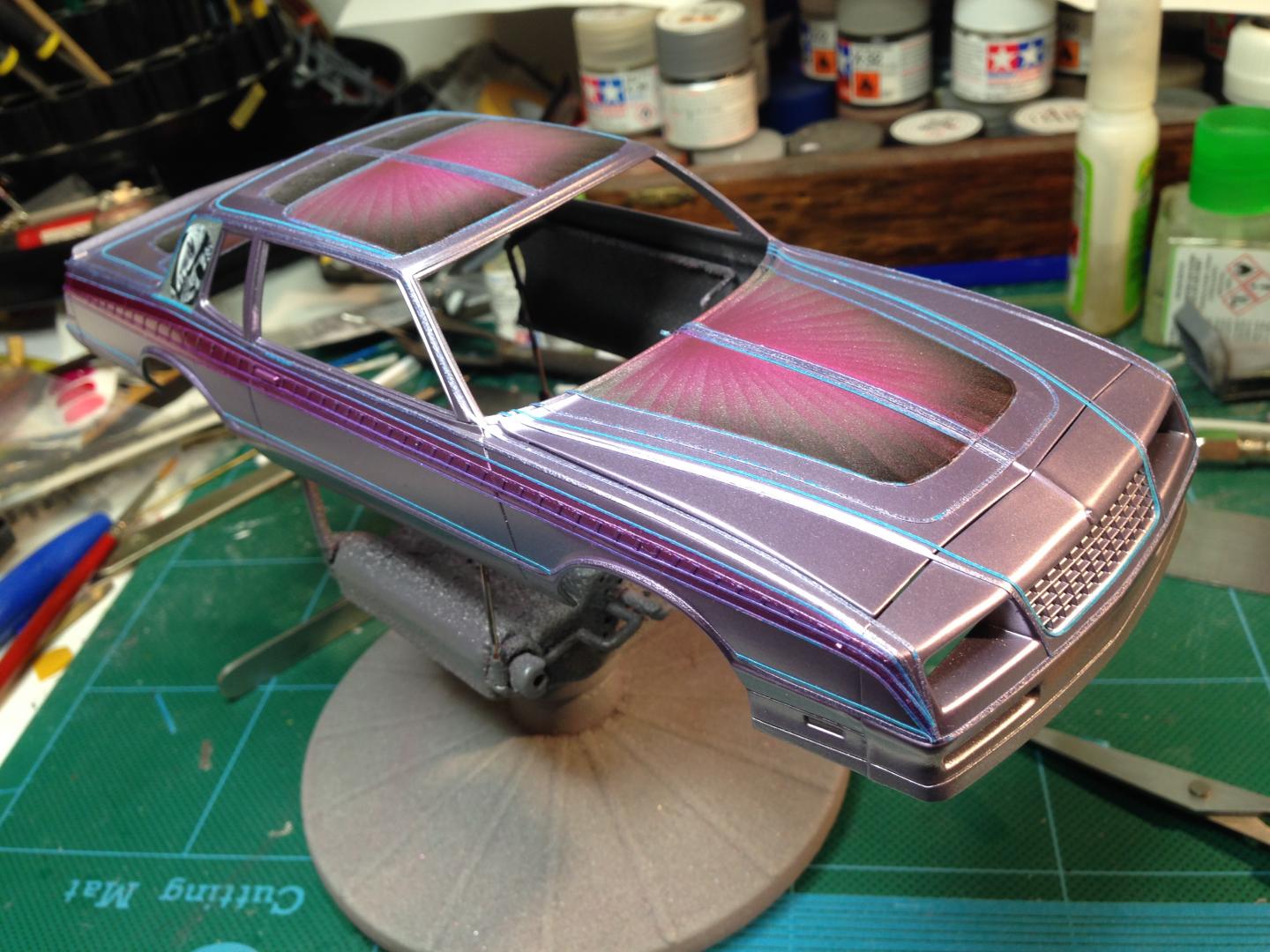

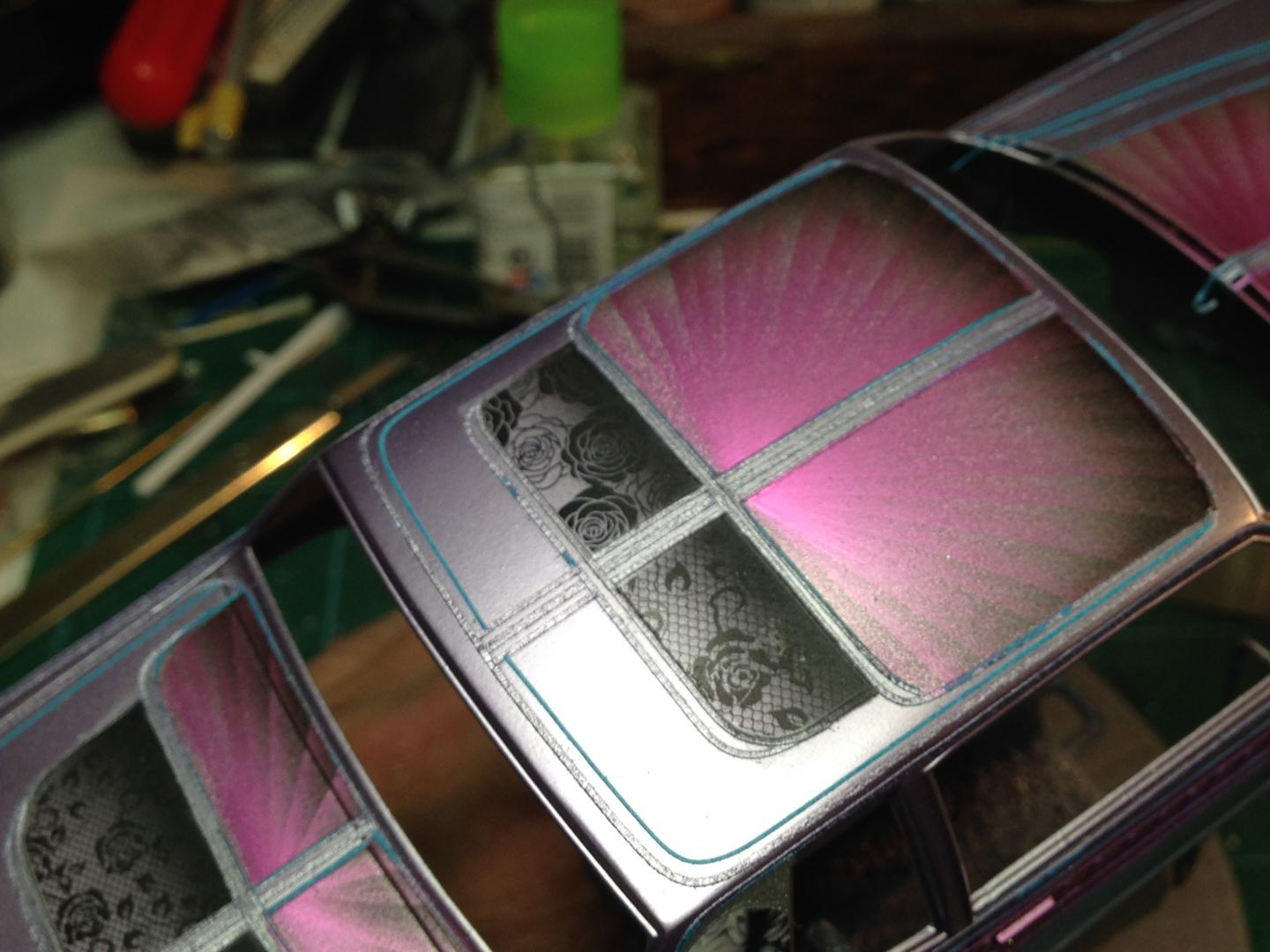

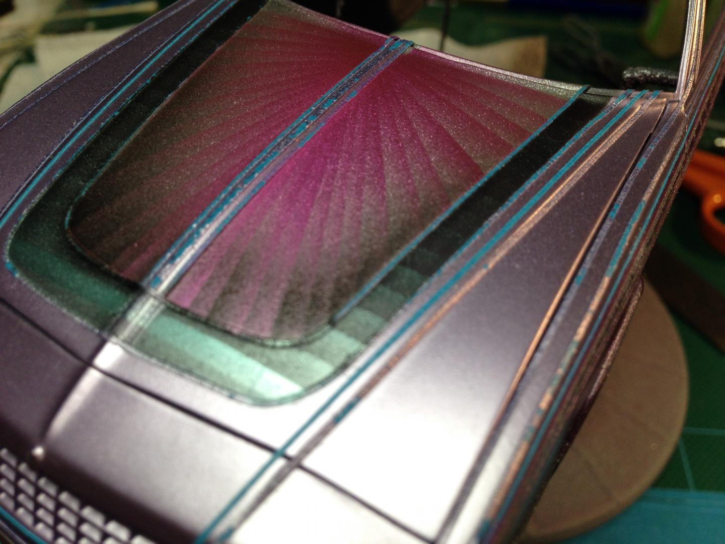

I got a bit more done today. Got through a fair amount of tape, too.
first, added shadow with a bit of black
Edited by geetee66
Share this post
Link to post

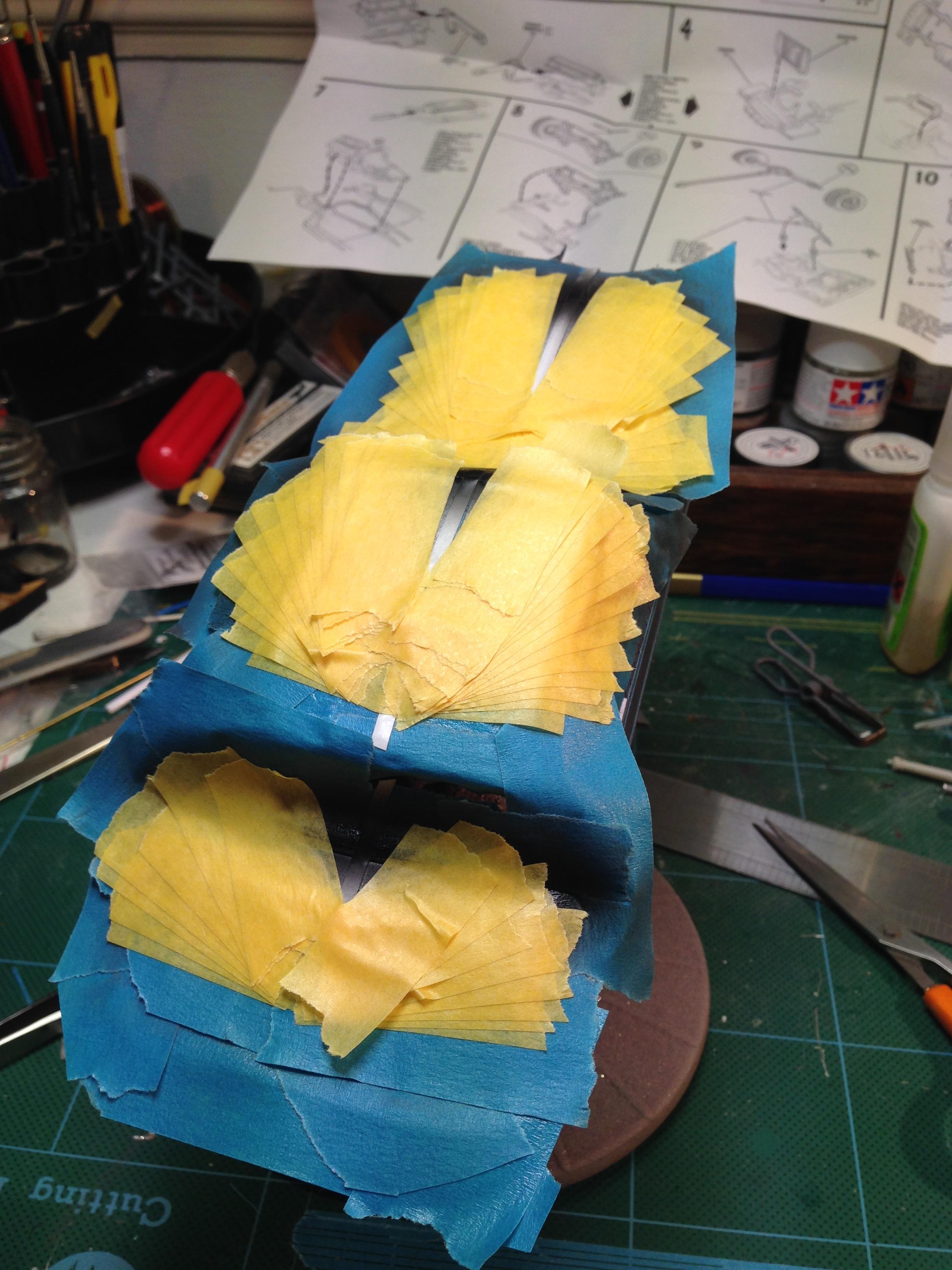

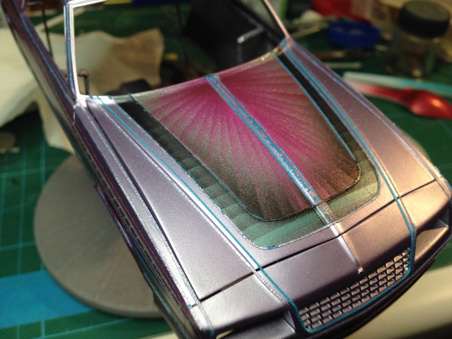

Then laid down tape in a sunray pattern, before shooting some chrome pink over the tape edges..
Share this post
Link to post
WOW, brilliant work!. I am really looking forward to seeing this done, I dig this stuff. . Wheather you like or hate these paint jobs they command  respect.

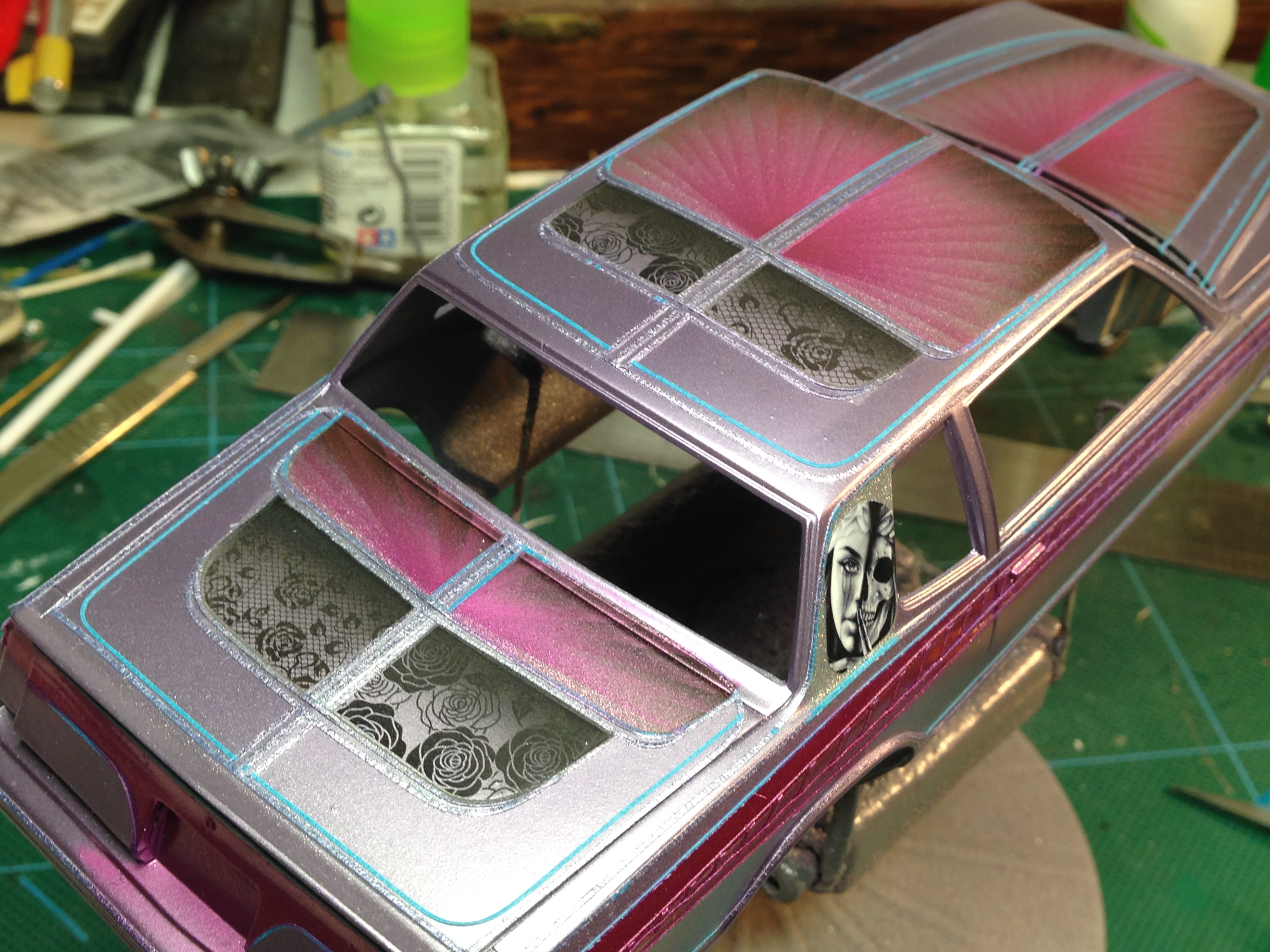

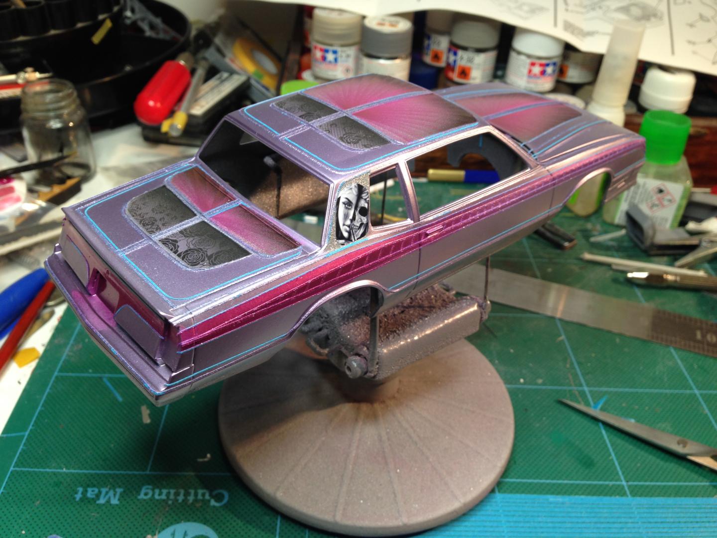

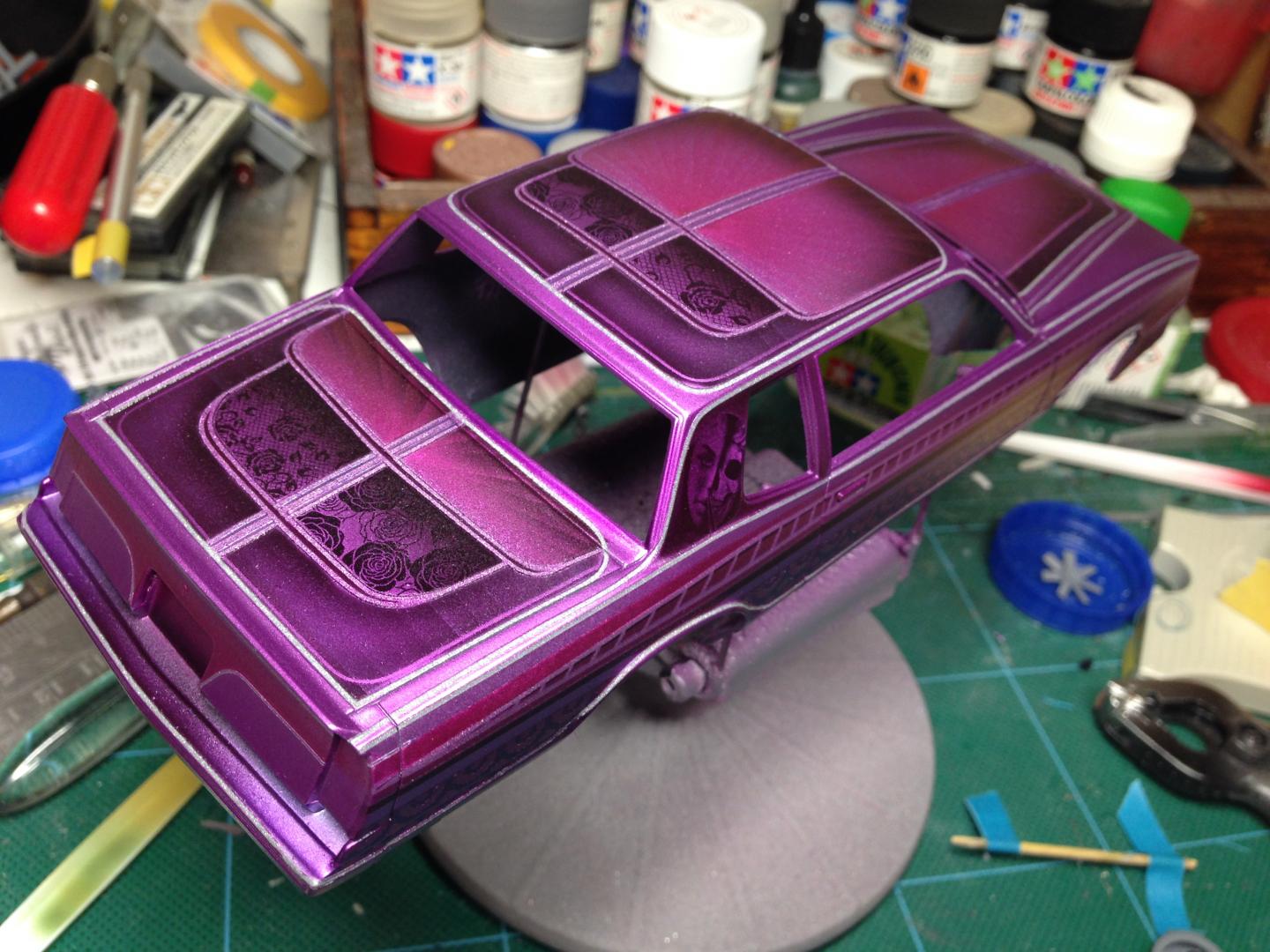

I didn't like the blue fades on the sides, so I covered them with some blue/purple.
that looked too plain, so I masked it with some self adhesive foil border pattern for card making. Some chrome pink was shot over this.
Just waiting for some purple candy to arrive in the mail and I can finish it off.
Share this post
Link to post

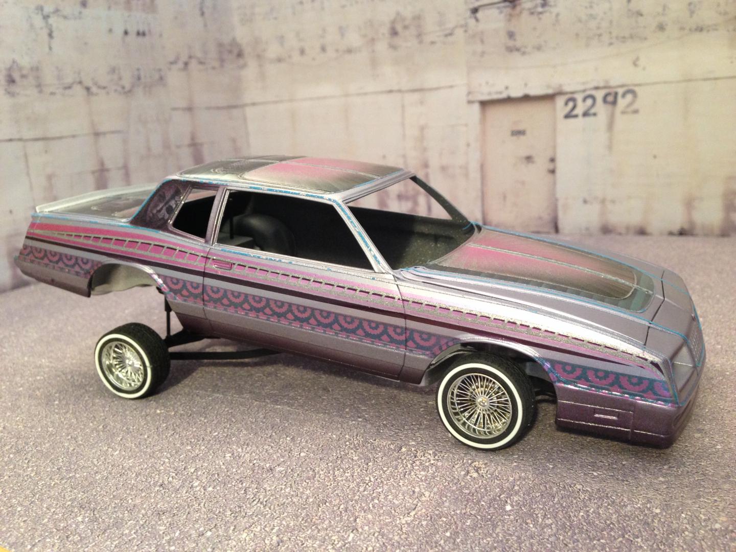

Got the wheels drilled out to fit the axles and couldn't resist a mock-up.. 🙂
Share this post
Link to post

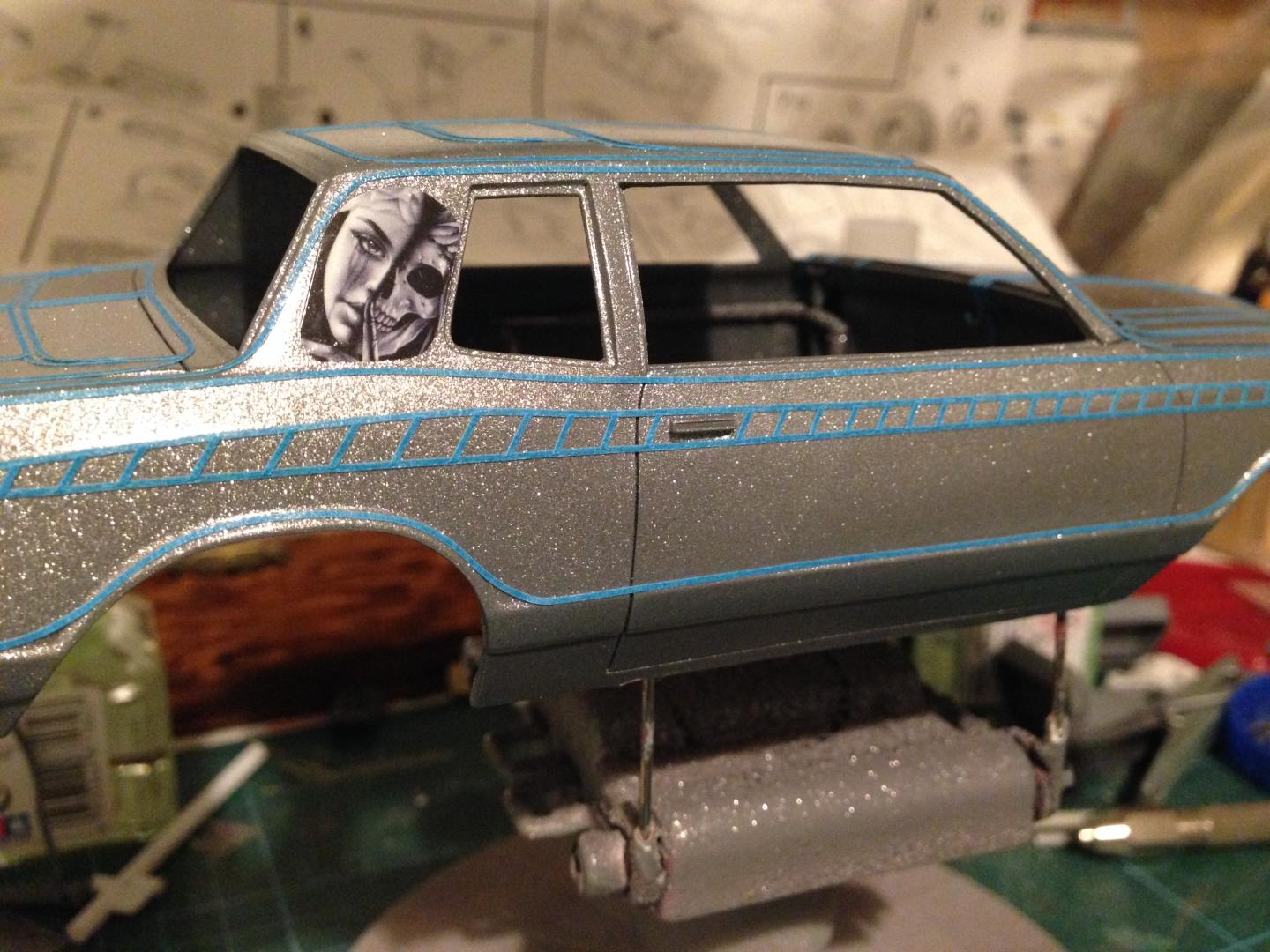

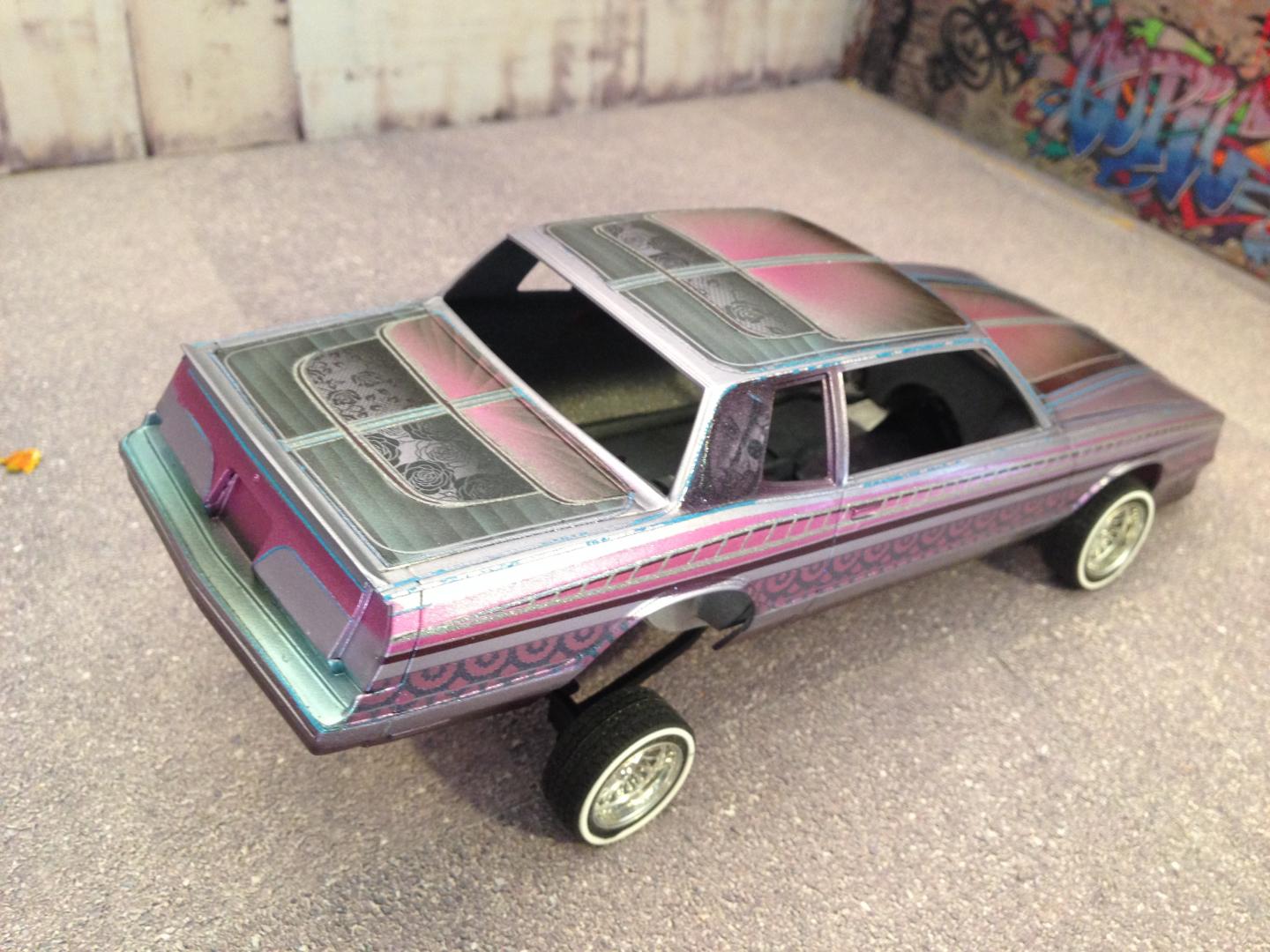

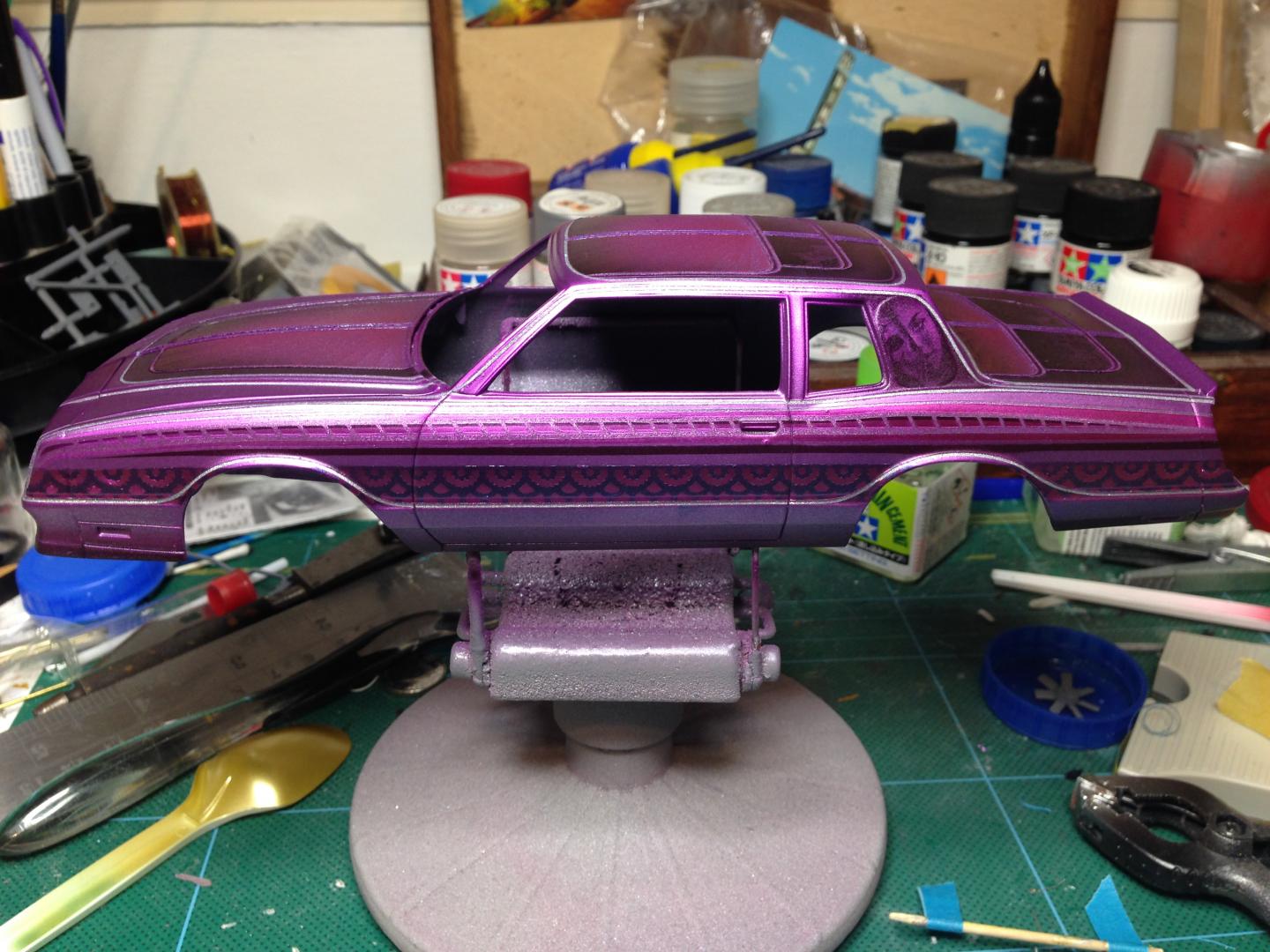

I liked the variation in colour on the different panels, but it was always my intention to use purple candy. The design feels a bit more cohesive now. I think it looks classy, too. I hope you agree. He candy is a bit matt, so I reckon the patterns will stand out more after clearcoat.
i left some fine line tape on before the candy, to make it pop a bit more
Share this post
Link to post
Very nice work Geoff! I think you are right. The candy pulled it all together in a nice package. I am doing a bit more research on how to do some of this with the plans to try my hand at it again. Thanks for the step- by- step. Any advice on how you get the curves of the tape, like on your hood, even on each side? I seem to get one side to look like I want and then can't get the other side to match without a lot of hassle.
Later-
