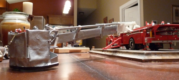

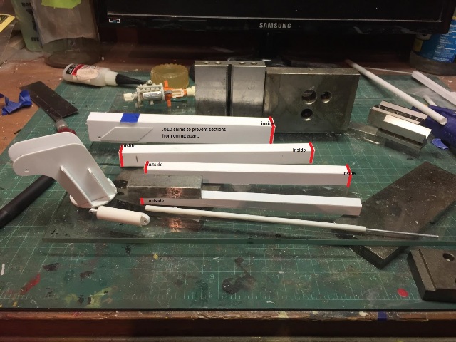

Great job on the vehicle, If I was building the boom and extensions I would use .010 shims pieces inside the boom and the extensions to prevent the extension from coming apart and giving a guide when being extended. I did this when I did an Mack Arialscope  boom years ago.2v2ECZWVJxwhifW.jpg

That's a great idea! Thanks! But the way I am making my boom, just like the prototype with the extension cylinders, the rods can only extend so far, just like the original. The extension cylinder for the first section mounts inside the main boom beneath the first section. The two cylinders for the second and third sections mount inside the second and third section, exactly like the real deal. So when the boom is extended, it won't be able to come apart. It will be all painted and then assembled, and will work just like the real deal.  Nice looking build you got there!
Edited by redneckrigger
