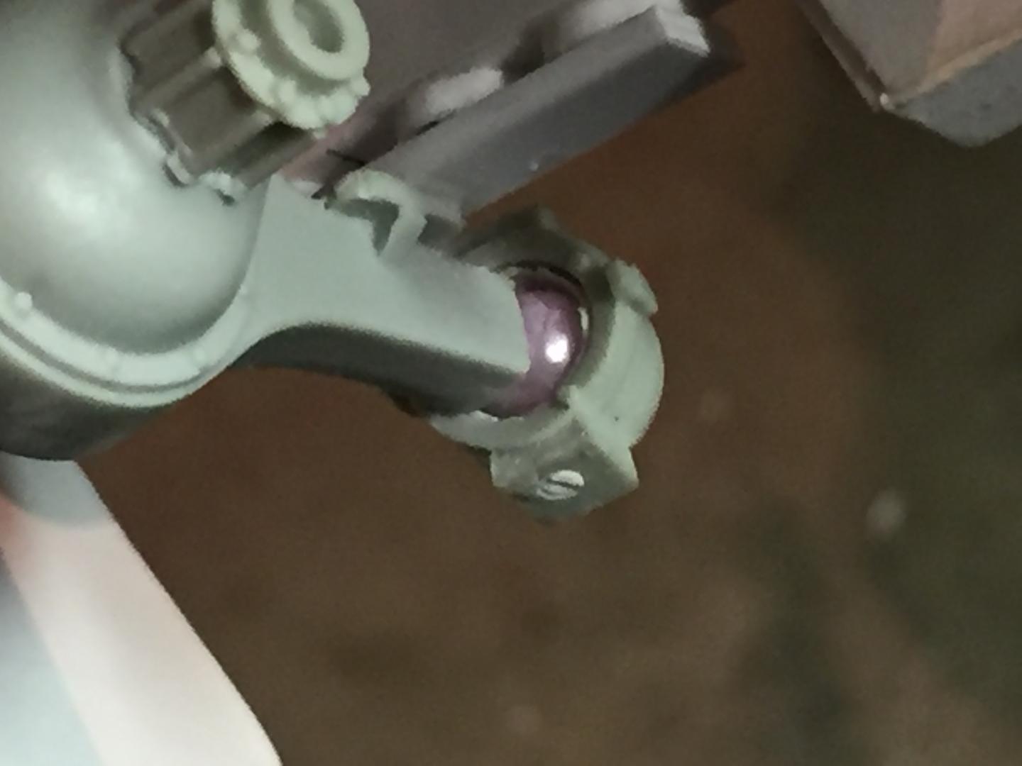

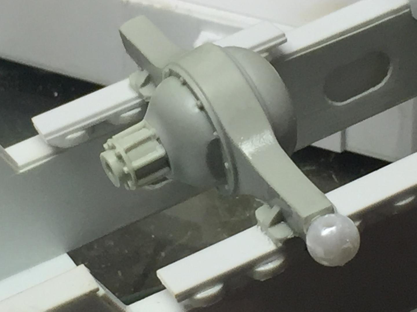

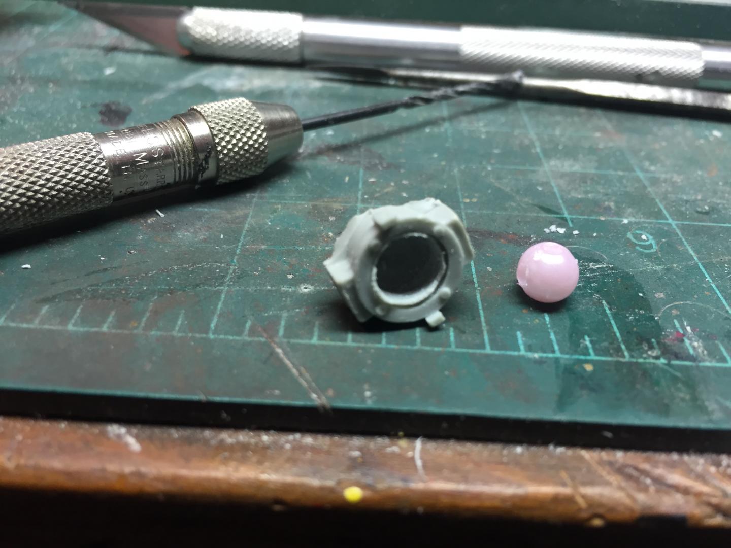

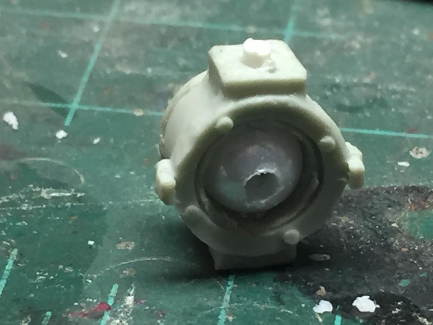

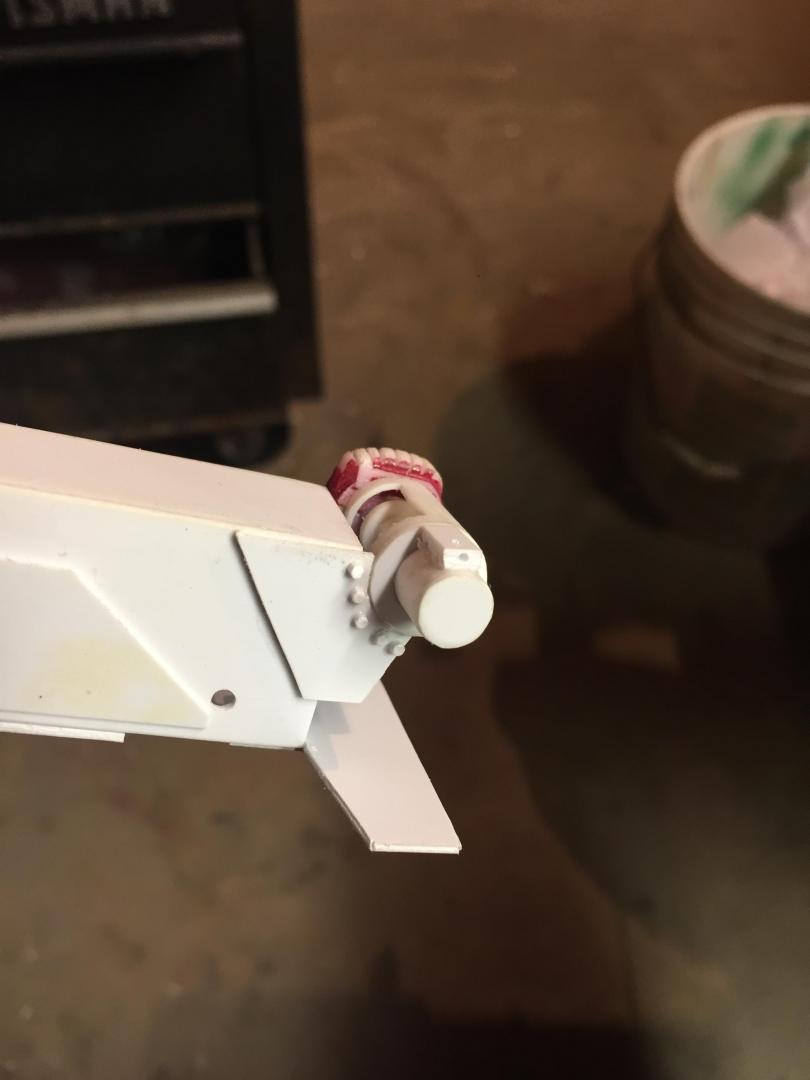

I drilled the cast in knuckles out with a regular drill bit, deep enough to accept a new ball.  I then found a package of plastic craft beads at Walmart. These already have a hole drilled through them. I simply drilled another hole at 90 degrees to the existing hole, but only until it intersected the original hole, not all the way through. Then it was simply a matter of orienting the ball in the knuckle with the original hole vertical with the pivot point of the knuckle and drilling a hole in the top and bottom of the knuckle to line up with the hole in the ball.  I then glued the ball to the metal rod in the end of the axle housing using the hole I drilled part way through.  Then I installed the knuckle and pressed a styrene rod into the top down through the ball and through the bottom of the knuckle.  Made a pretty good and extremely easily done working approximation of the real deal!

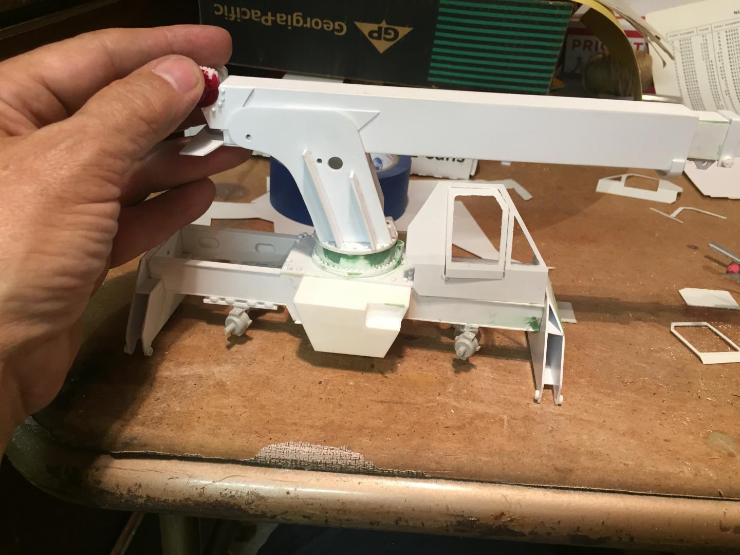

Just started the counterweight.  Since it is a very heavy casting, I started by laminating several pieces of .080 styrene together which will then all be glued together and then shaped as needed.  Also put the winch together which will have a mount made for it to mount inside the counterweight against the back of the main boom.  Seems like it's never going to end, but, for as much fun this kind of build is, that would not be a bad thing!

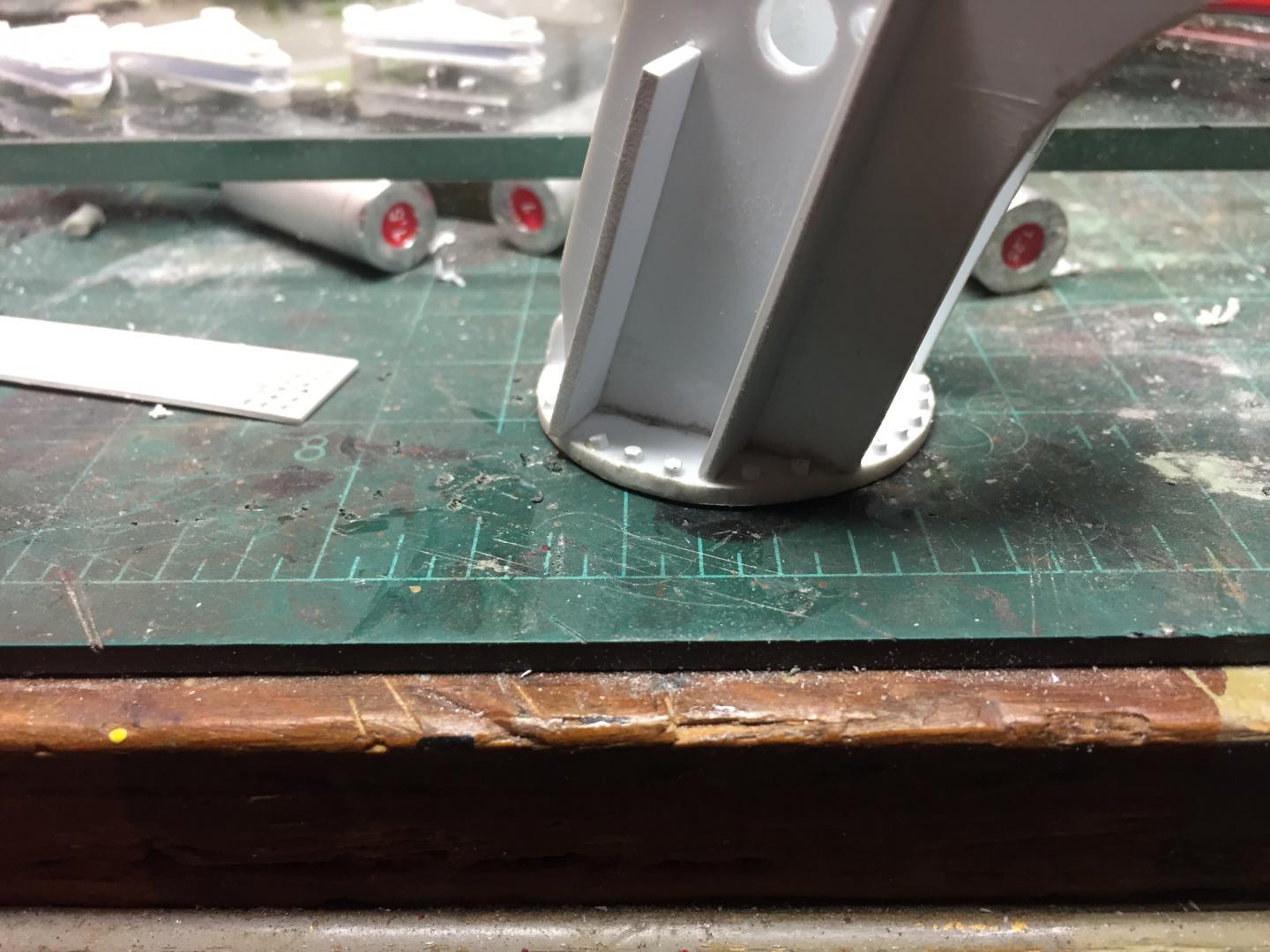

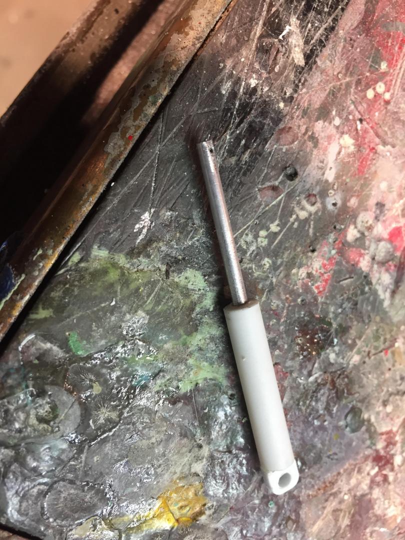

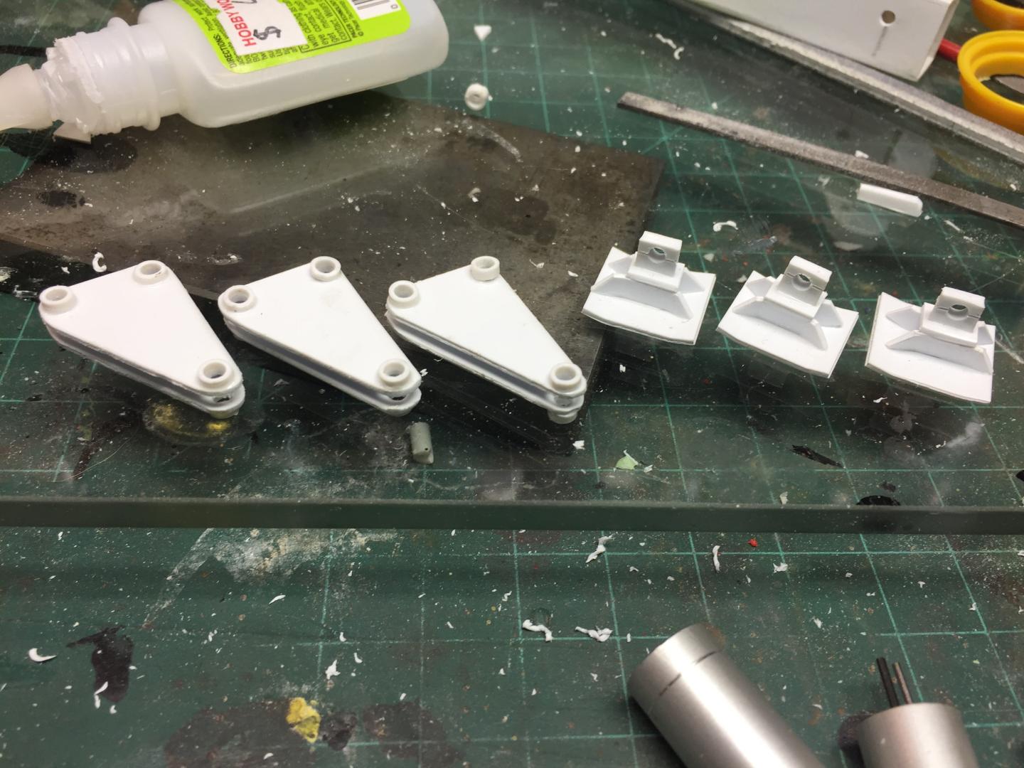

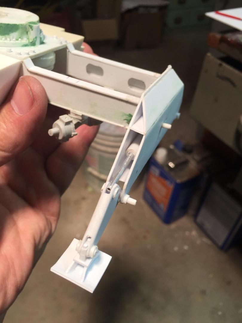

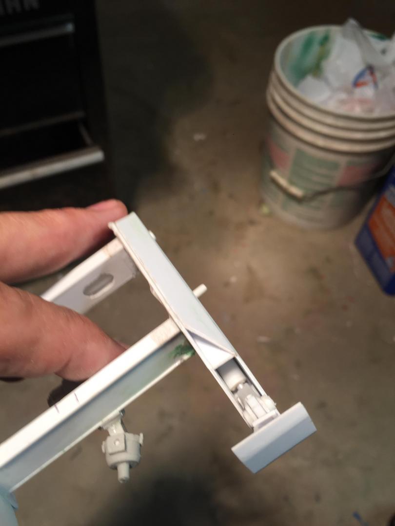

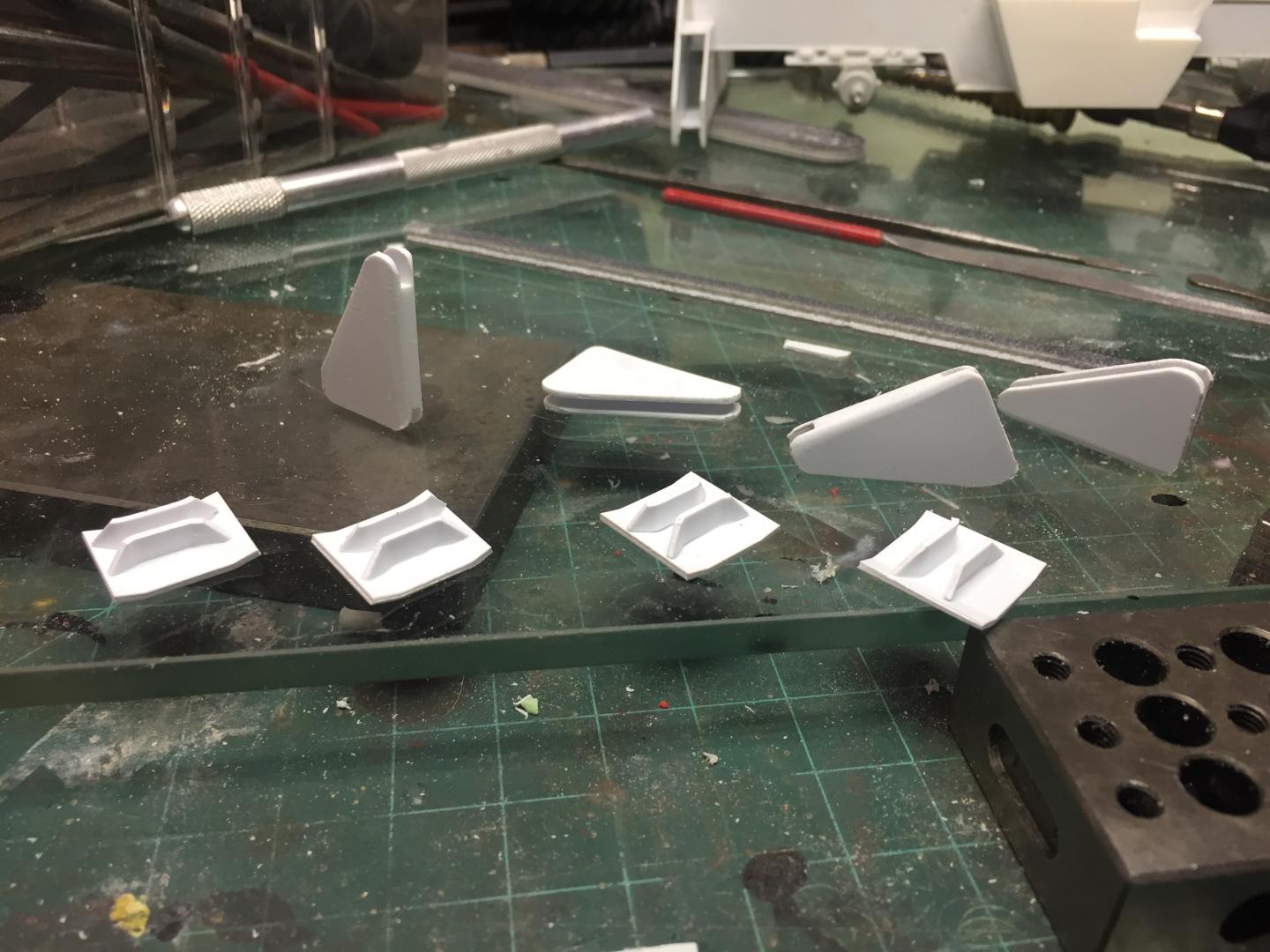

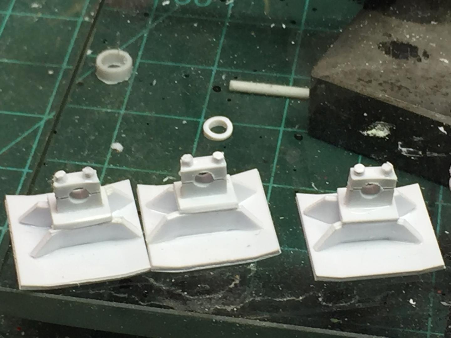

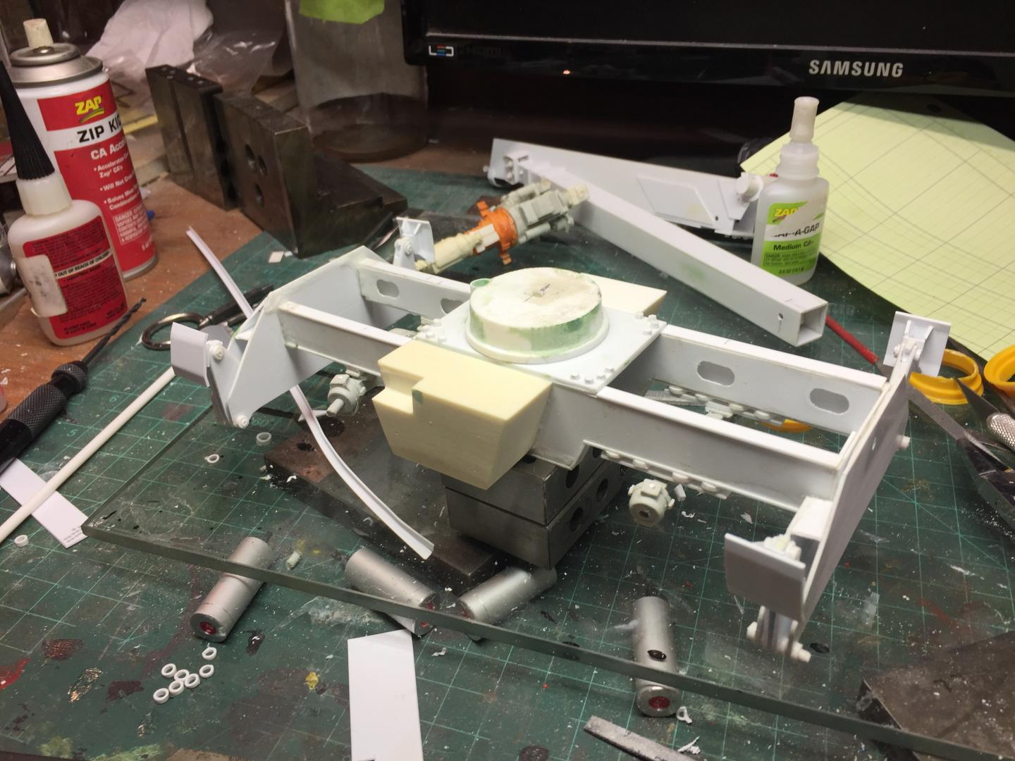

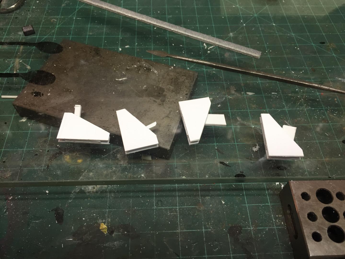

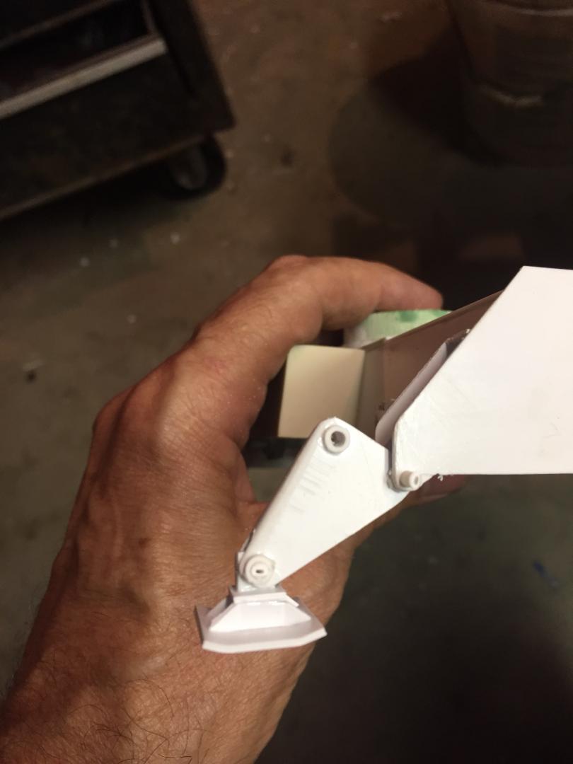

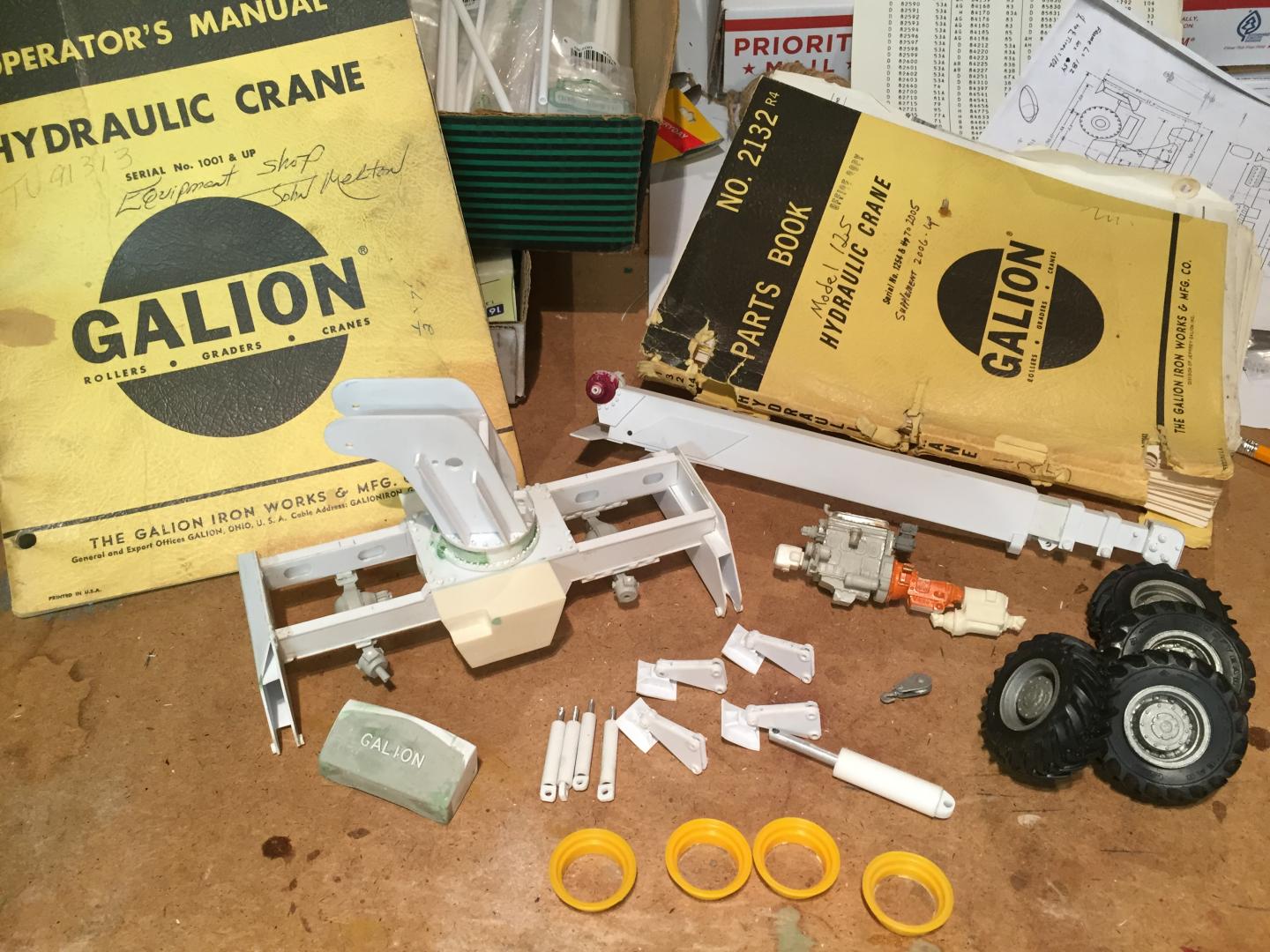

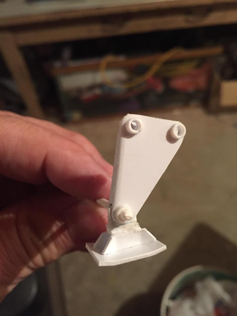

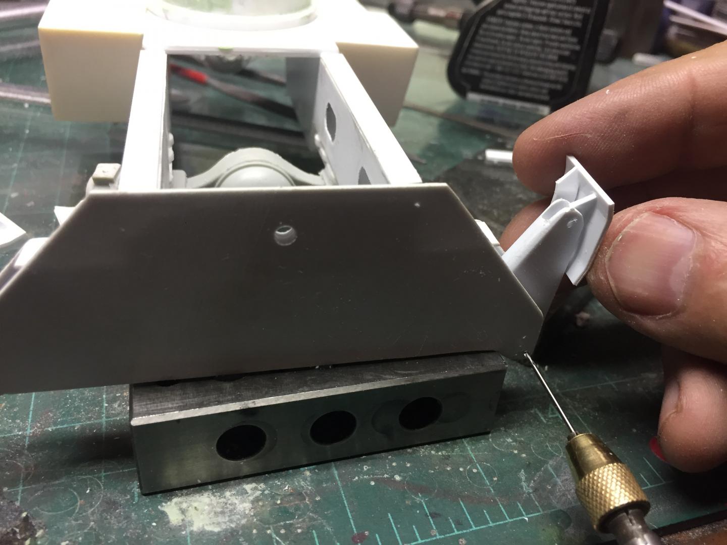

Worked on the outriggers tonight. Got all four of them made up with the pivot bushings and made the pads as well with the pivot bearings and caps and bolts holding them together. Did a mockup of one of them to see how it works. Just need to make the cylinders now.  Also installed the winch and the bolts holding it in place. Put the bolts on the turntable support and the boom support too. Also installed the bolts that attach the counterweight. The counterweight won't be installed until after all of the piping is done. The painting on this build will be done in many subassemblies and then assembled because of the complexity. Really is an adventure! Starting to look like something!

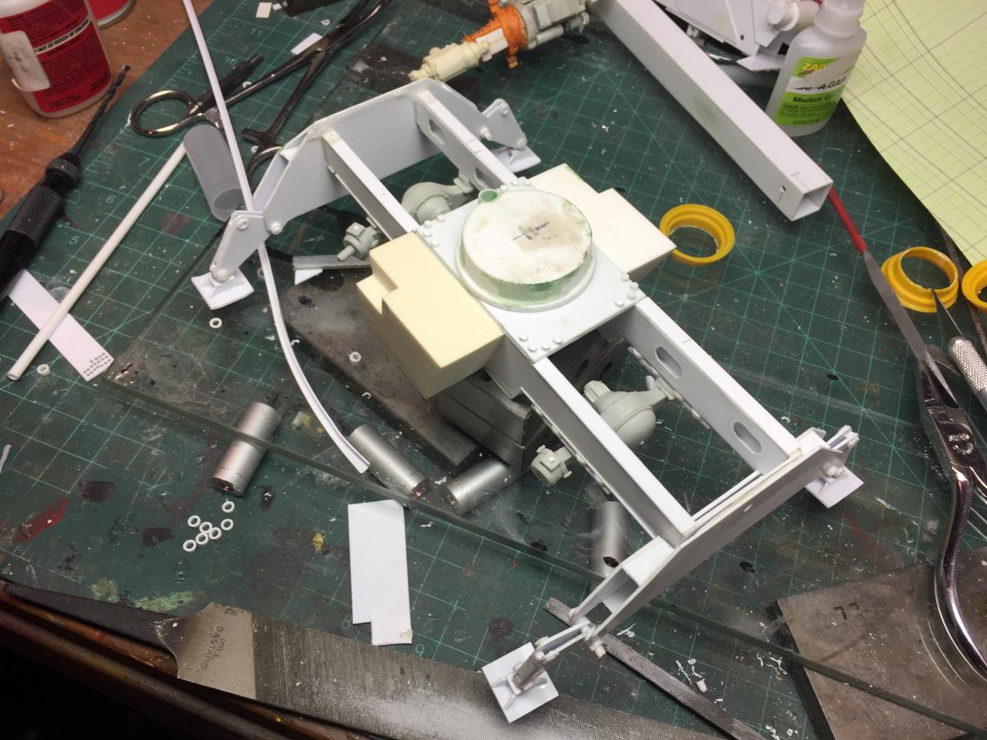

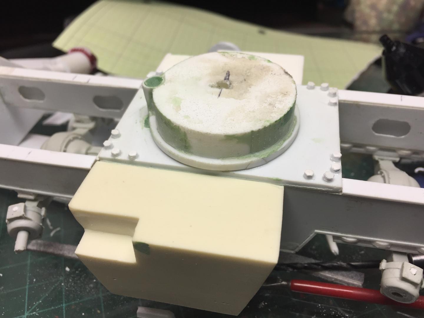

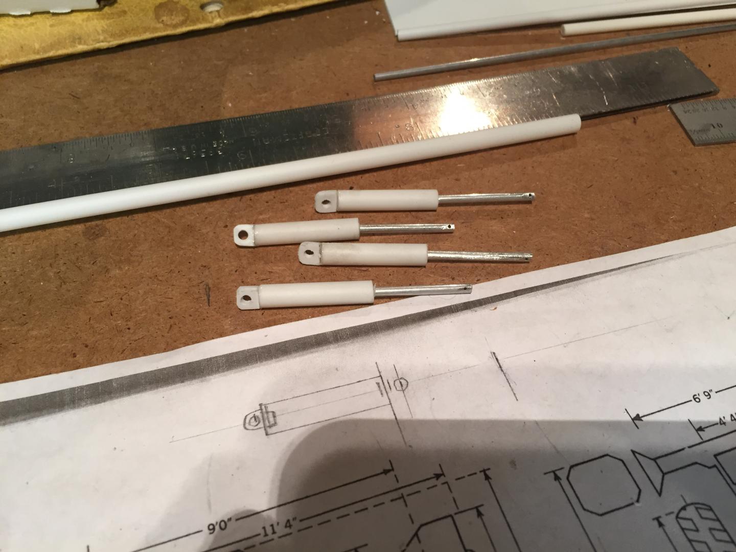

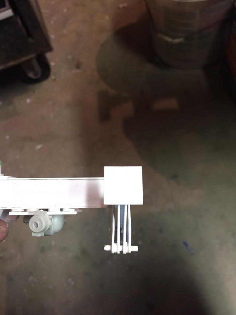

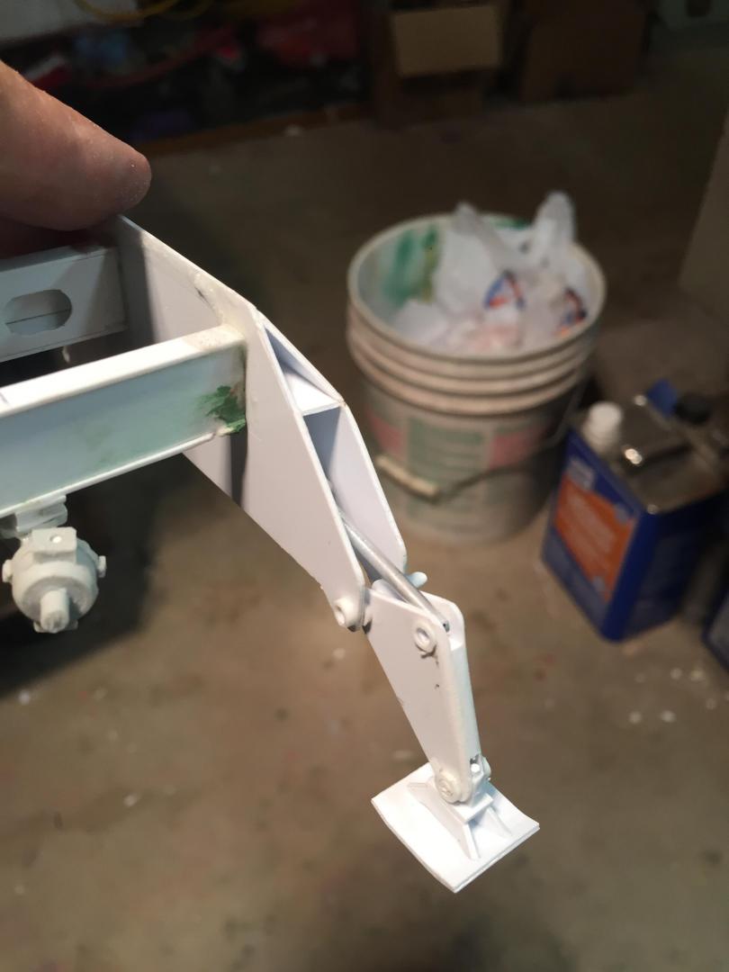

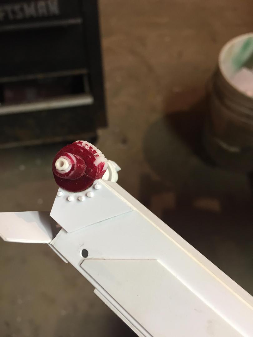

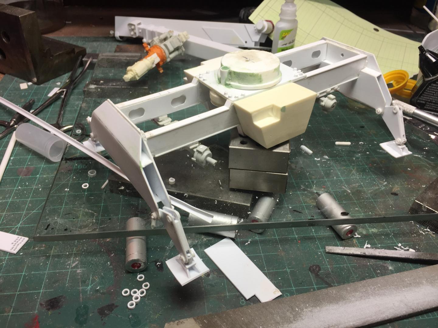

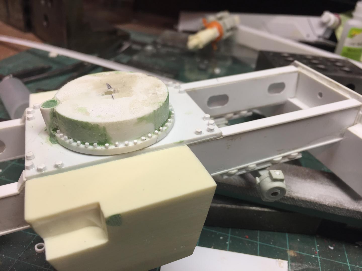

Made up the outrigger cylinders today and installed all of the 43 bolts that hold the turntable to the deck. Here is a shot of all of the subassemblies so far.  Next big things to do are the engine enclosure, steering cylinders and operators station and cab.

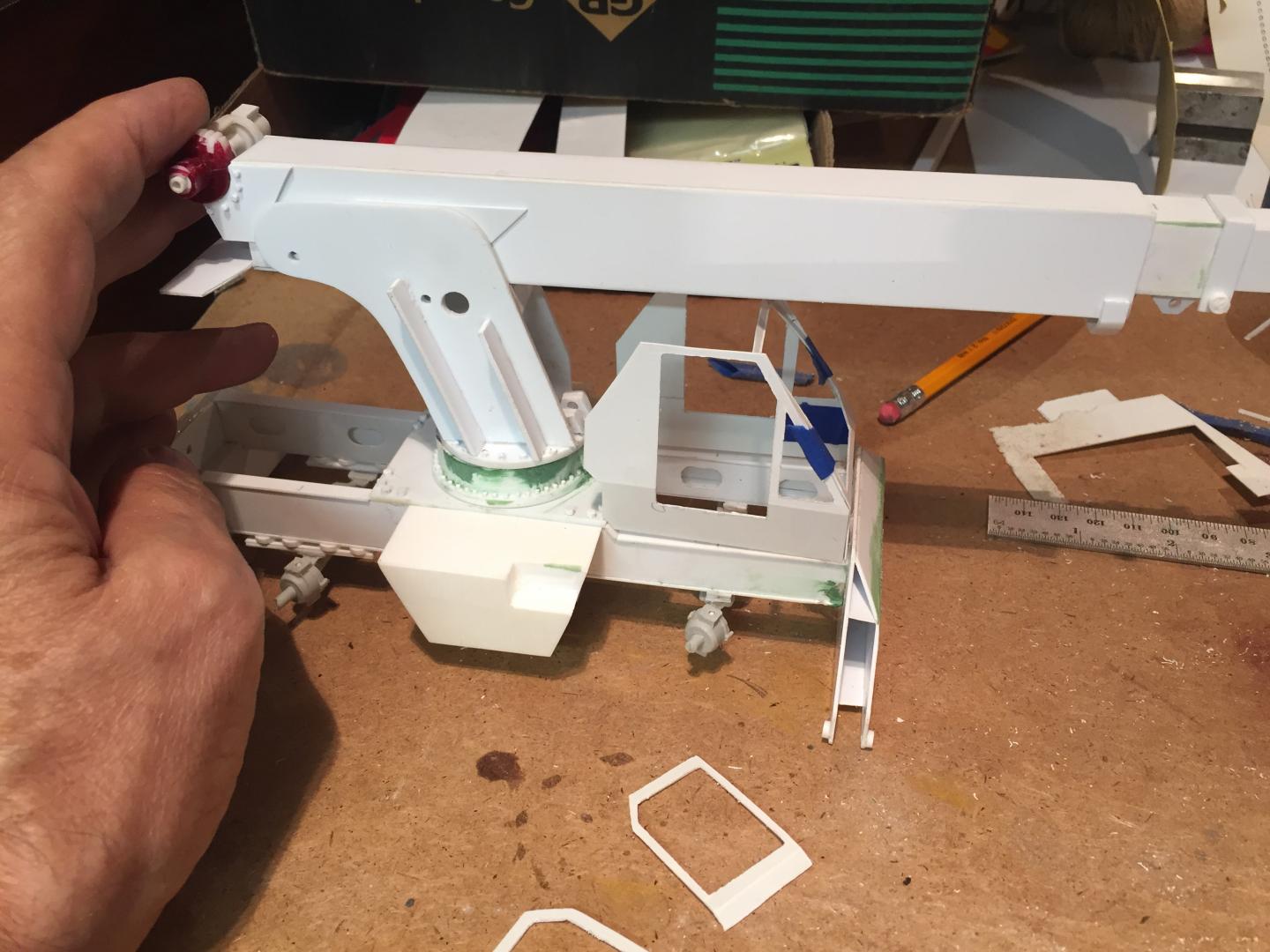

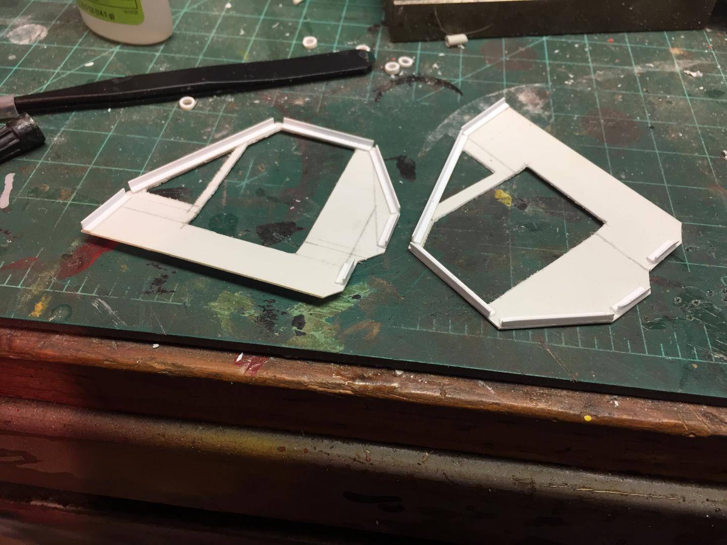

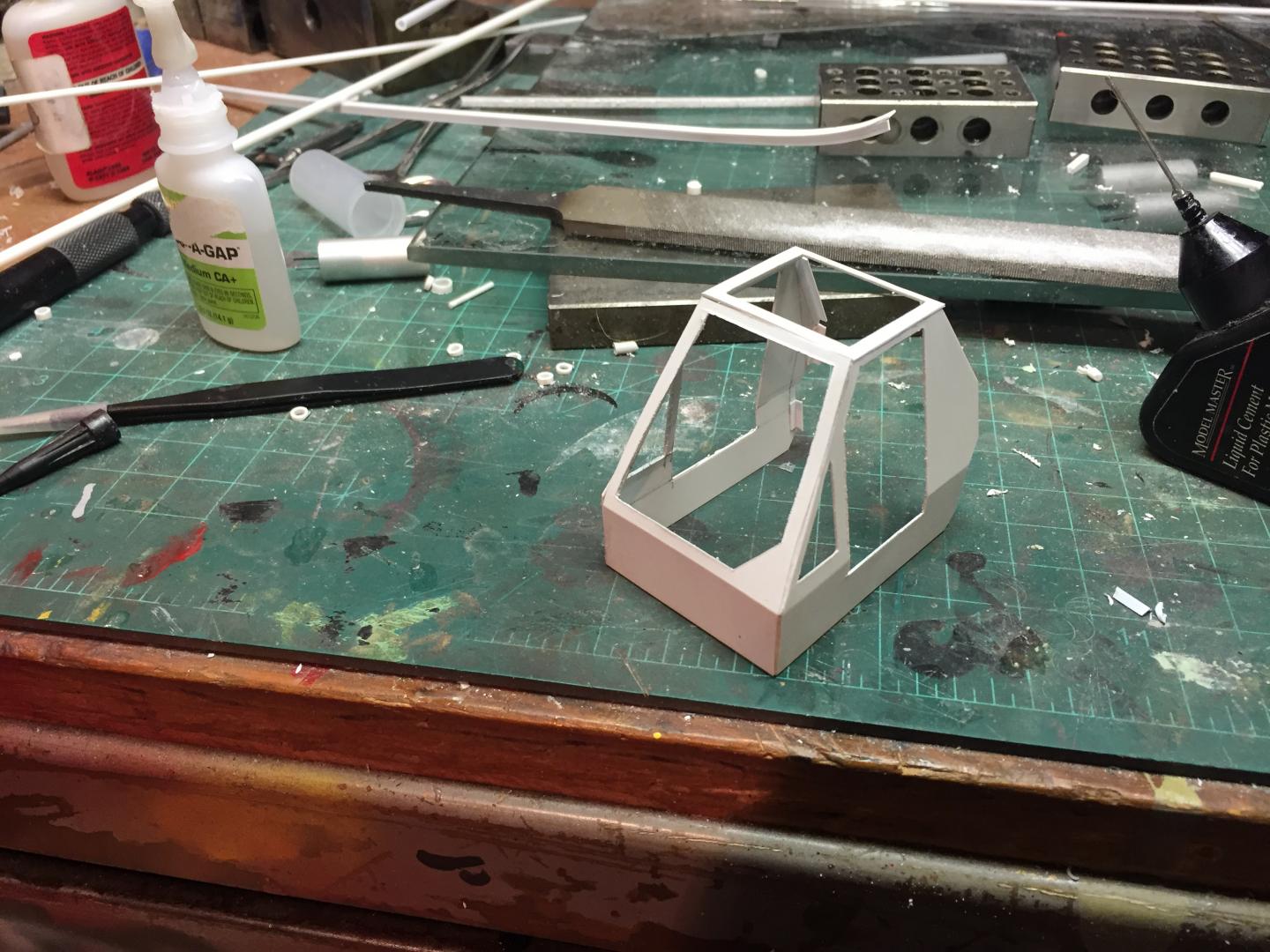

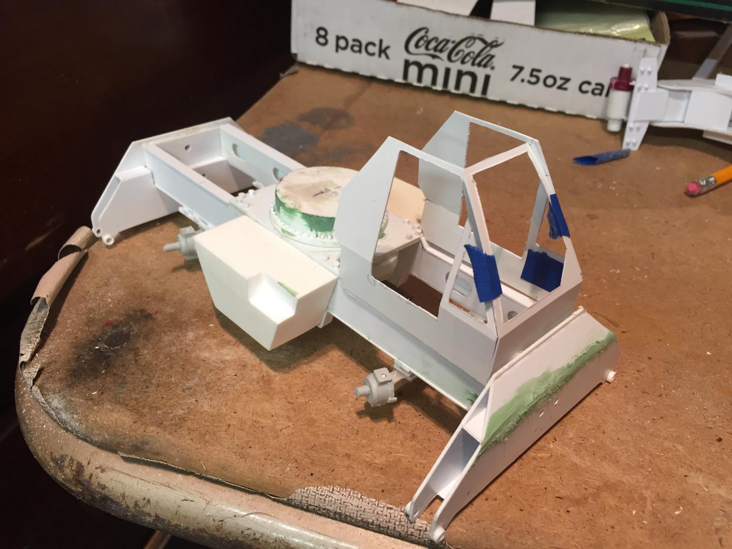

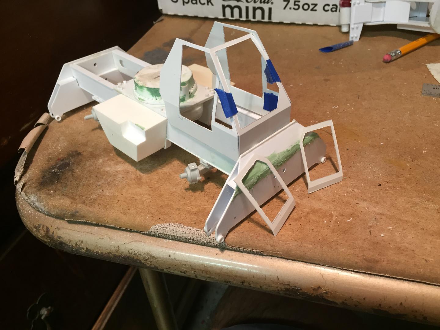

Operators cab basic structure, still needs back wall.....started this build on 16 June.....have put in an average of about eight to ten hours per week.  Cylinders and cab took about two hours today. Tons of fun!

Now that I have the cab roughed in, I am racking my brain to figure out a way to make the window glass rubber moldings. The windows do not have sharp corners, but have a radius to them. I have tried various things so far to get a half round molding to go around the opening with a radius at the corners, but nothing has looked right so far.............................

What about using actual rubber? Bike tube or the like?
Fantastic work so far!
Share this post
Link to post
I thought about that but haven't figured out how to get it in the half round shape.  Might try to make a mold in clay for each window using a piece of wire half way into the clay and pour resin in it with a wire reinforcement in it.  Lots of ideas, lots of time!

You might try jewelry wire as some of the wire are flat . I've experimented when doing fire truck windows
greg
I will give that a try. Thanks!
Share this post
Link to post
I've used styrene half rounds for trim that had probably the same needed radius on corners. I would use liquid plastic glue and do in short sections about a half inch or so. I just lay the strip down and touch with small glue brush. For the radius I'd put son glue on and it bends easily around the radius and sticks. It may be tough controlling the edge you need with half the half round sticking out from the edge. Might need a bit oversize round but it is industrial.
here's a few pics of how much the rounds bend with a little glue softening ..
These taillight shrouds were made with half rounds the same way, bending around the taillight lenses
Share this post
Link to post
Fantastic idea Mike! Never thought of softening it with the glue.....gonna give that a try! That is the problem I was having.....trying to make a radius.  Now THAT'S why I love this forum! Thanks!
Edited by redneckrigger
Share this post
Link to post
Outstanding work  !! I really like following builds like these , shows how simple items laying around can be turned into assembled parts.
Great tip on the half rounds too, I've always struggled with getting them to curve without kinking
