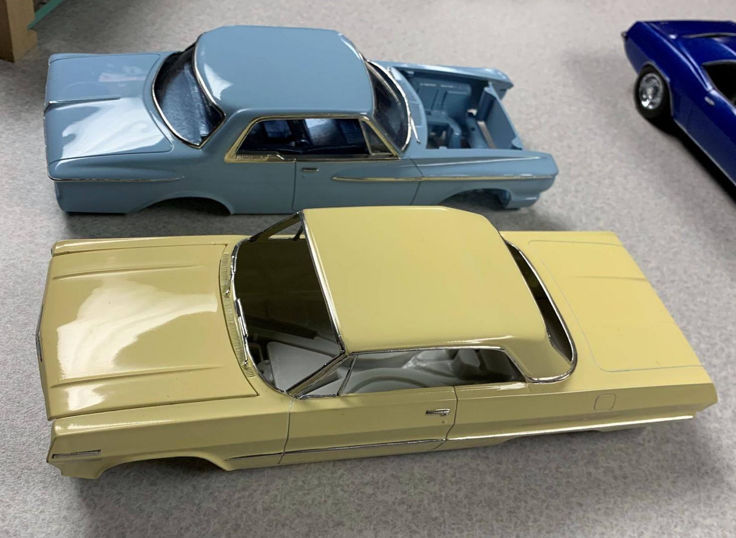

I've never darkened my door/trunk lines..Real vehicles don't have black lines..I just dust paint a few coats then final coat..I do use a pick and define them then sand down what the pick loosened..Never done lines..
1962 Plymouth and 1963 Chev at model meeting April 28,2019,Check out the shine.jpg
