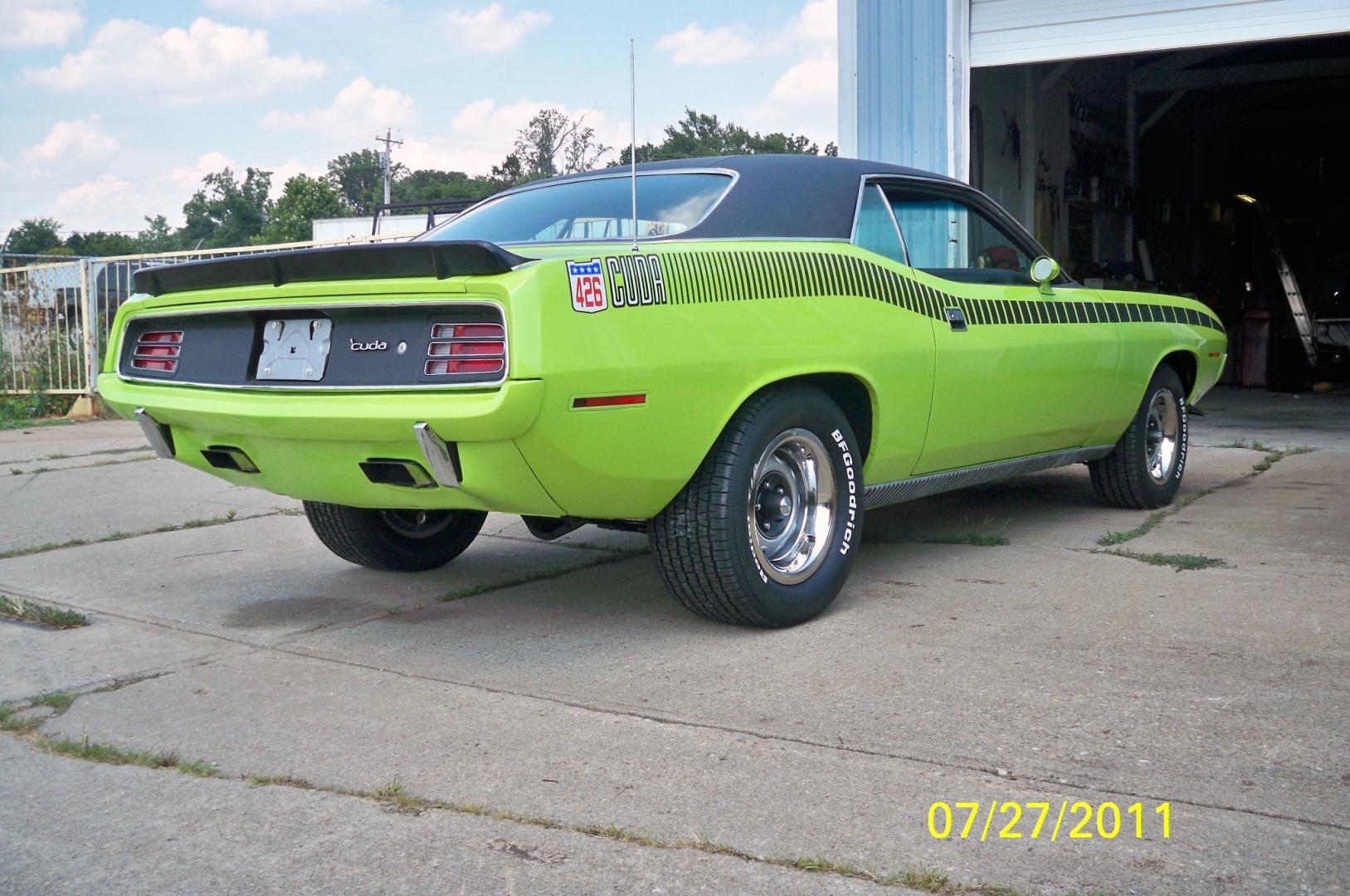

On 6/27/2019 at 8:16 PM, gtx6970 said:
they are.
the coating is made to make the bumper appear to fit closer to the body. The coating also wraps around the ends and fit real snug to the body on the sides
this is a car I built for a client / friend of mine a few years back.
notice it does NOT say AAR on the rear decal.
The man has owned it since late 70s early 80s time frame.
And yes, its an original Plum Crazy purple  AAR ,
But he decided from the beginning of the resto to build what HE wanted and purists be damned,,,,,And btw,,,, this particular  car has a Dana in it. LOL
On 6/30/2019 at 11:34 AM, Classicgas said:
I don't think that's a AAR. The badge says 426. The AAR had a 340 6 barrell. The rest of the stripe is AAR but I doubt the car is. Even the exhaust is wrong.
Classicgas, Re-read the post. He states that it was an original Plum Crazy AAR. The guy who restored it, wanted it done his way. IE: 426, Different exhaust, custom decals and such.
Share this post
I can assure you its very much an original BS23JOB . AAR, 340 six barrel auto. Plum Crazy Purple, no vinyl top.
He has owned this car for ages and will die with this car. I personally restored this car about 8 years ago,,,, and Before the restoration even began and he  decided to build the car HIS way.
Powered by a Tim Banning / FHO (at For hemis only ) built 484 cu in iron block, aluminum head street Hemi. John Cope built 727 auto. Strange Dana 3.54 . Full 2.5" TTI exhaust. AND we added Vintage air A/C system to keep the occupants nice and comfortable. . This is probably one of the best running/driving street HEMI I've ever been in
Edited by gtx6970

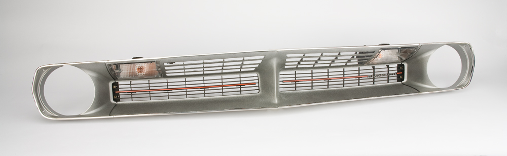

On 7/2/2019 at 6:44 AM, drodg said:
Thanks for the update on the kit and showing all of the parts.  One item when building if you notice that the AAR Cudas have a  chrome or stainless outline to the grill which is not really on the regular Cudas.  It is set back on the inside of the grill.   I am not sure how I might do that.   Anyhow thanks for the write up.   You can see it on the two brown colored Cudas above
Actually all 1970 ( and 71 ) Barracuda and Cudas  have the stainless trim on the outer perimeter of the grill.
 All other 1970 Barracuda / Cuds the grill is argent silver
Exact same colors apply to the lower grill insert in the lower valance
Edited by gtx6970
Share this post
Link to post
AAR grill
all other 1970 Barracuda/Cuda
Edited by gtx6970
