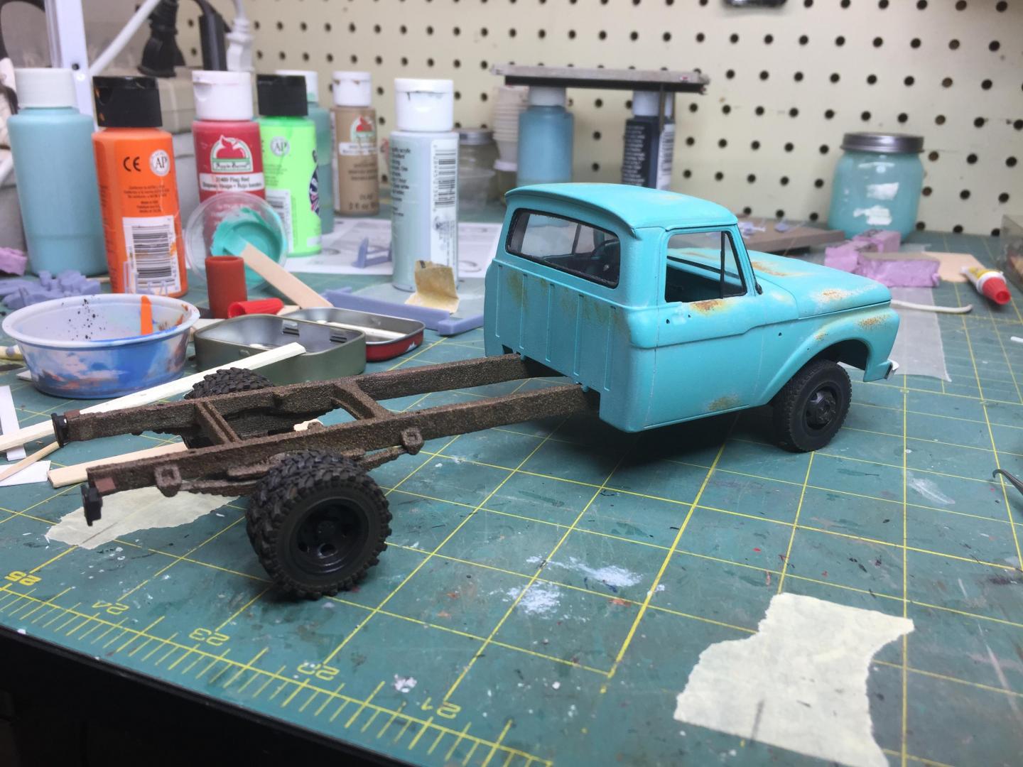

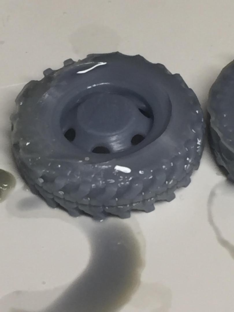

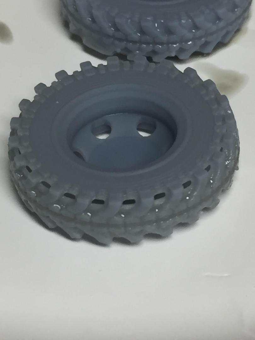

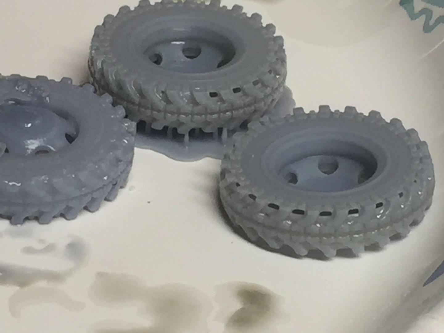

bill lanfear Posted July 18, 2019 Author Share Posted July 18, 2019 10 hours ago, ROY FERGUSON said: What tires are you using with your rims ? Hi Roy, I used some tires I got off the web and put them with my wheels but unfortunately, I can't offer them as they have issues and I can't get them to print consistently without problems. For my build, it took 4 attempts to get success, plus the tires are not my creations so I won't be selling them for that reason also. Here are pics of the latest attempt a few days ago. As you can see, they are full of holes and fill up with resin, then leak for days and days. I may try to make some myself eventually but right now I have many other things to work on first. thanks, Bill Quote Link to comment Share on other sites More sharing options...

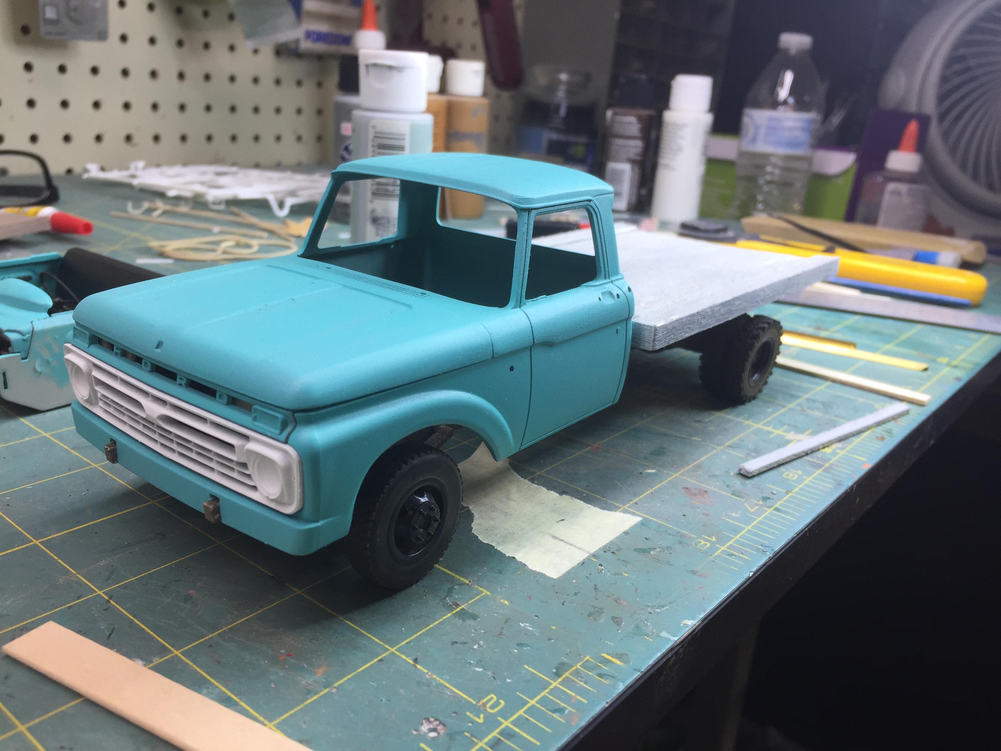

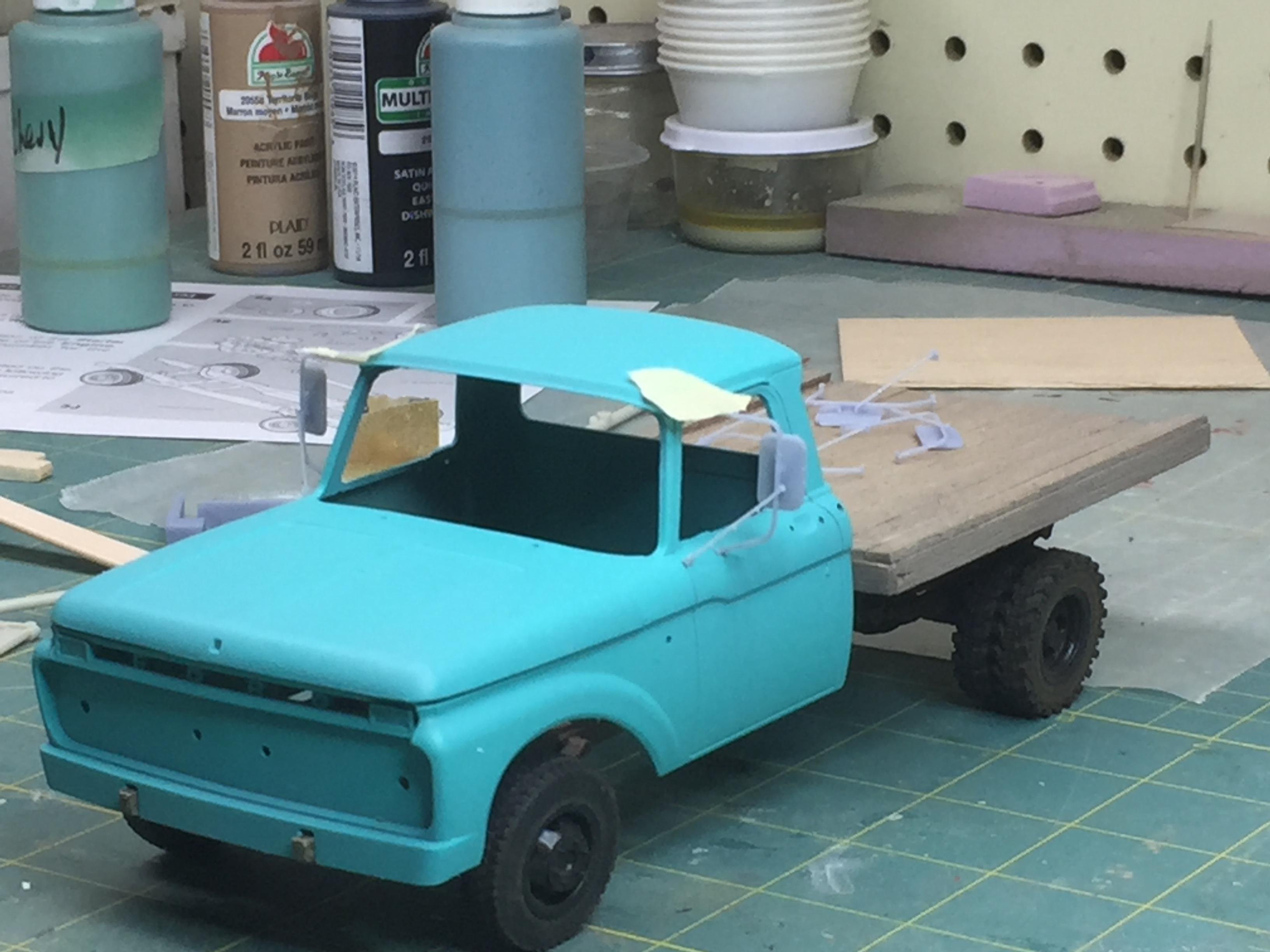

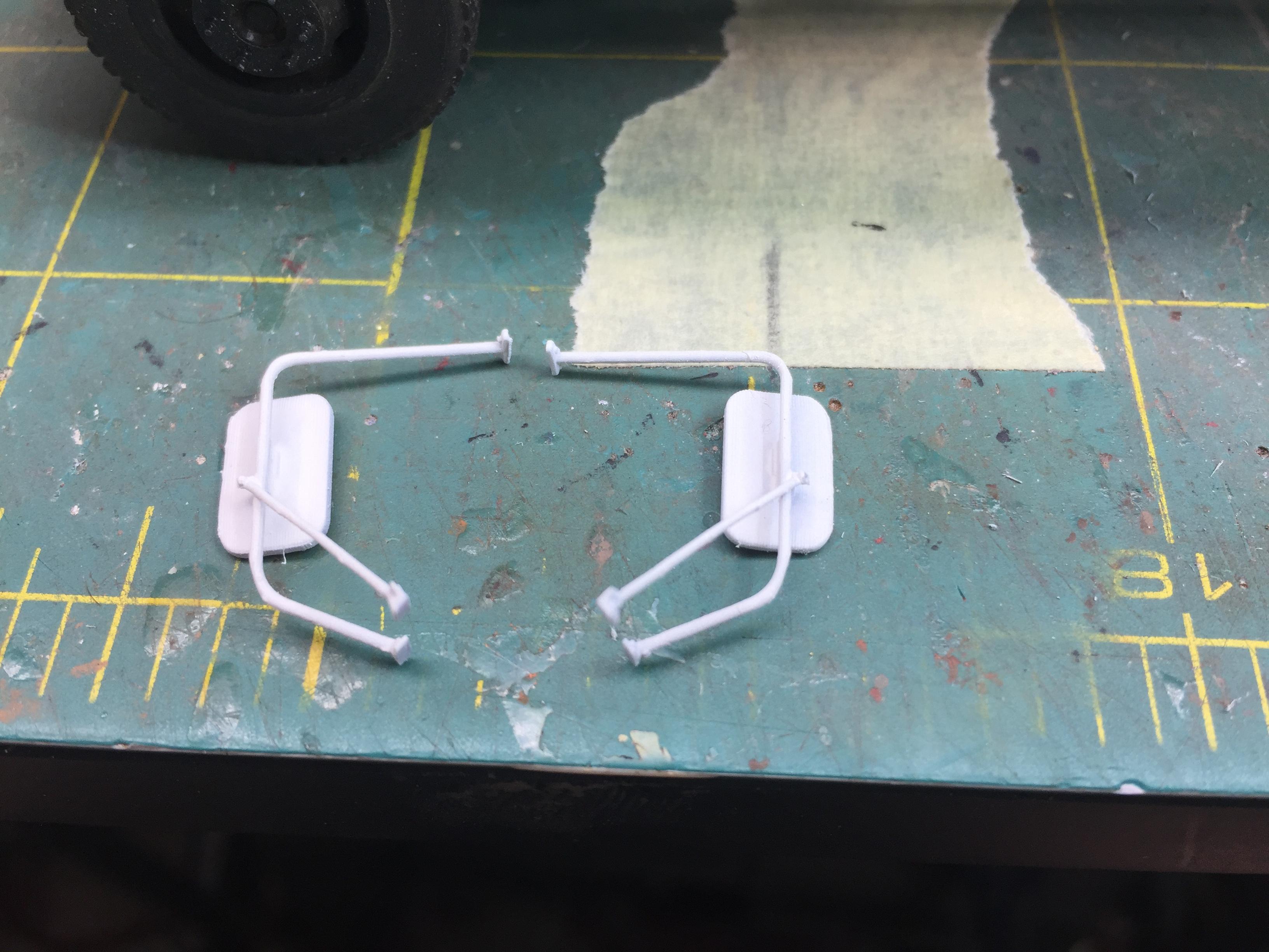

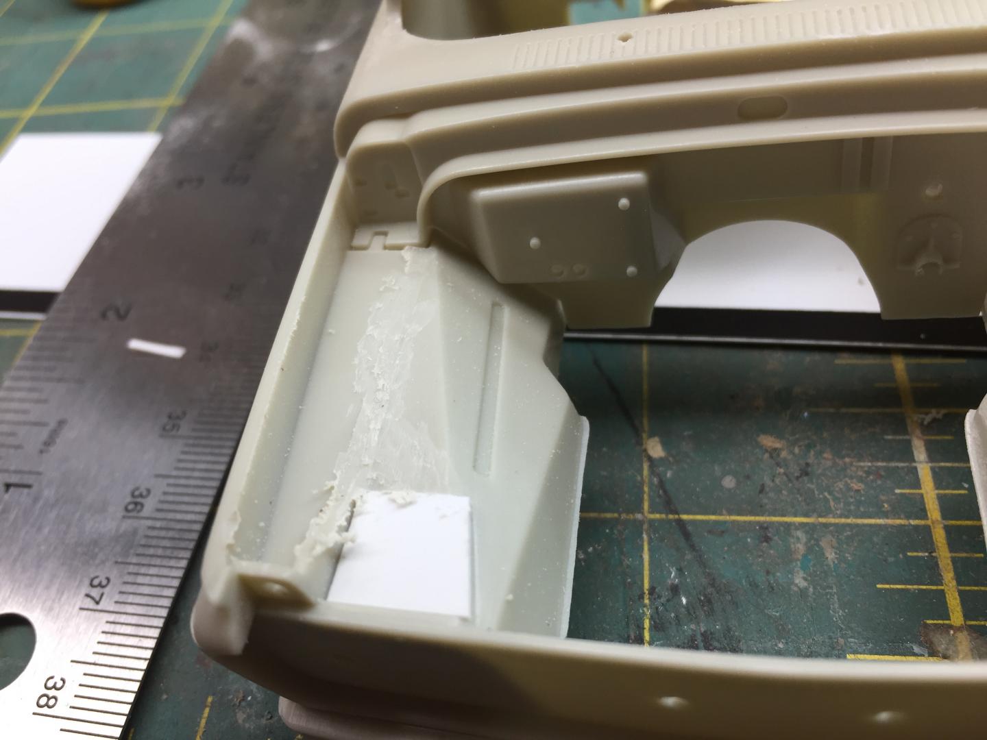

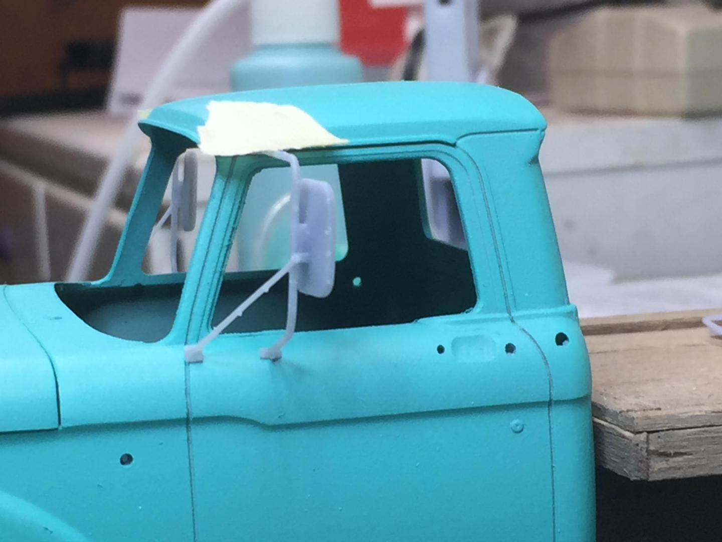

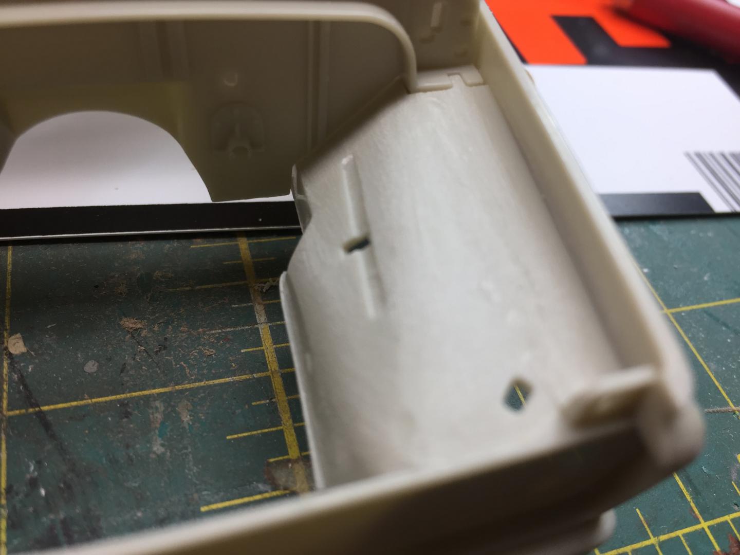

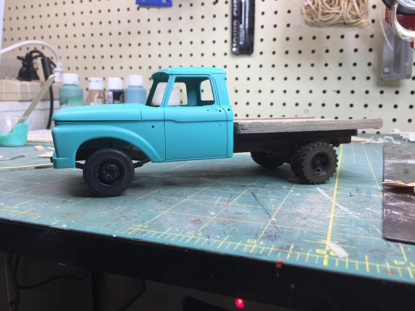

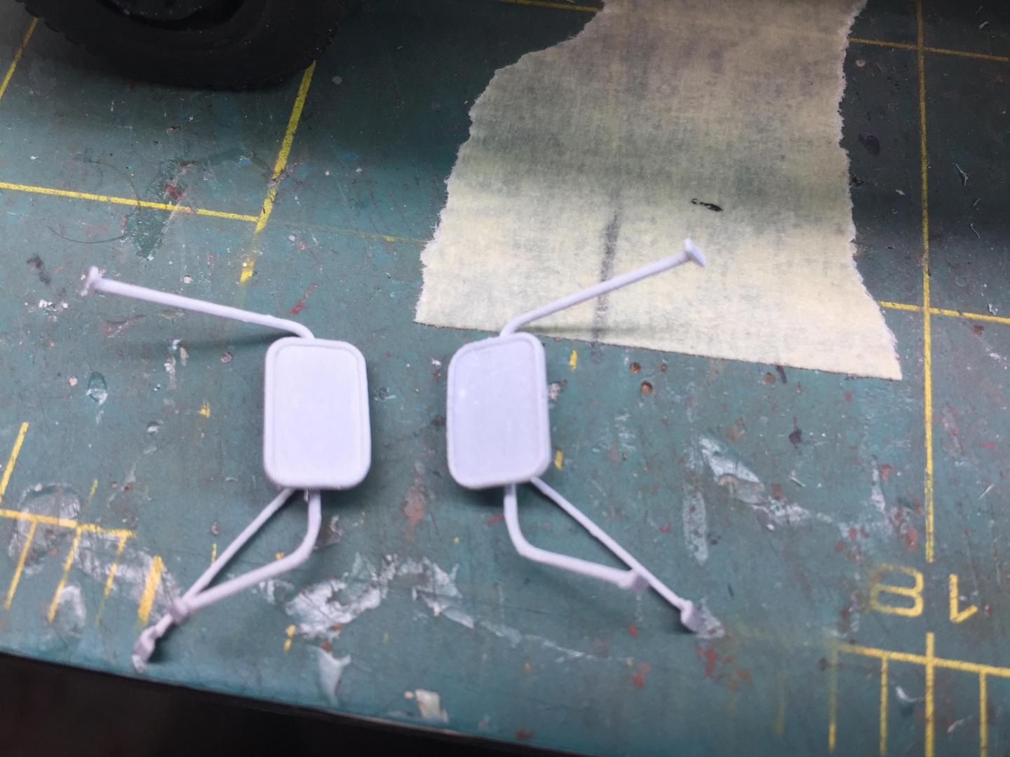

bill lanfear Posted August 13, 2019 Author Share Posted August 13, 2019 I have a small update for this build. I sanded down the sharp edges and supports from the inner fenders to give it the round effect like the real ones. I filled in the battery tray as the F350's had the battery under the passenger floor. I don't know why but Moebius has an issue with getting the proper lip on the dash for these 4th generation and their 5th generation trucks, so I added a strip of plastic to enhance it a bit. I got the base coat of paint on and made a few items for the interior. I made some mirrors that are more appropriate for this truck. I have a question for anyone that is familiar with these trucks. What was the extended wheelbase for the F350's? I know the stake bed trucks were 132" but the truck I drove back in the late 70's had a longer wheelbase and I think the bed was 10 or 12 ft in length. My research does not mention anything beyond the 132" wheelbase except for a crew cab of 152". Any help would be appreciated! Thanks for looking and comments are welcome. Quote Link to comment Share on other sites More sharing options...
wrenchr Posted August 13, 2019 Share Posted August 13, 2019 Those mirrors are very cool. I'm not 100% sure but I think the heavy duty trucks had dual hood latches. I'm not sure what level truck they came on. My 1:1 65's hood even has the revisions on the inside for them. I have seen them in person as well. Quote Link to comment Share on other sites More sharing options...

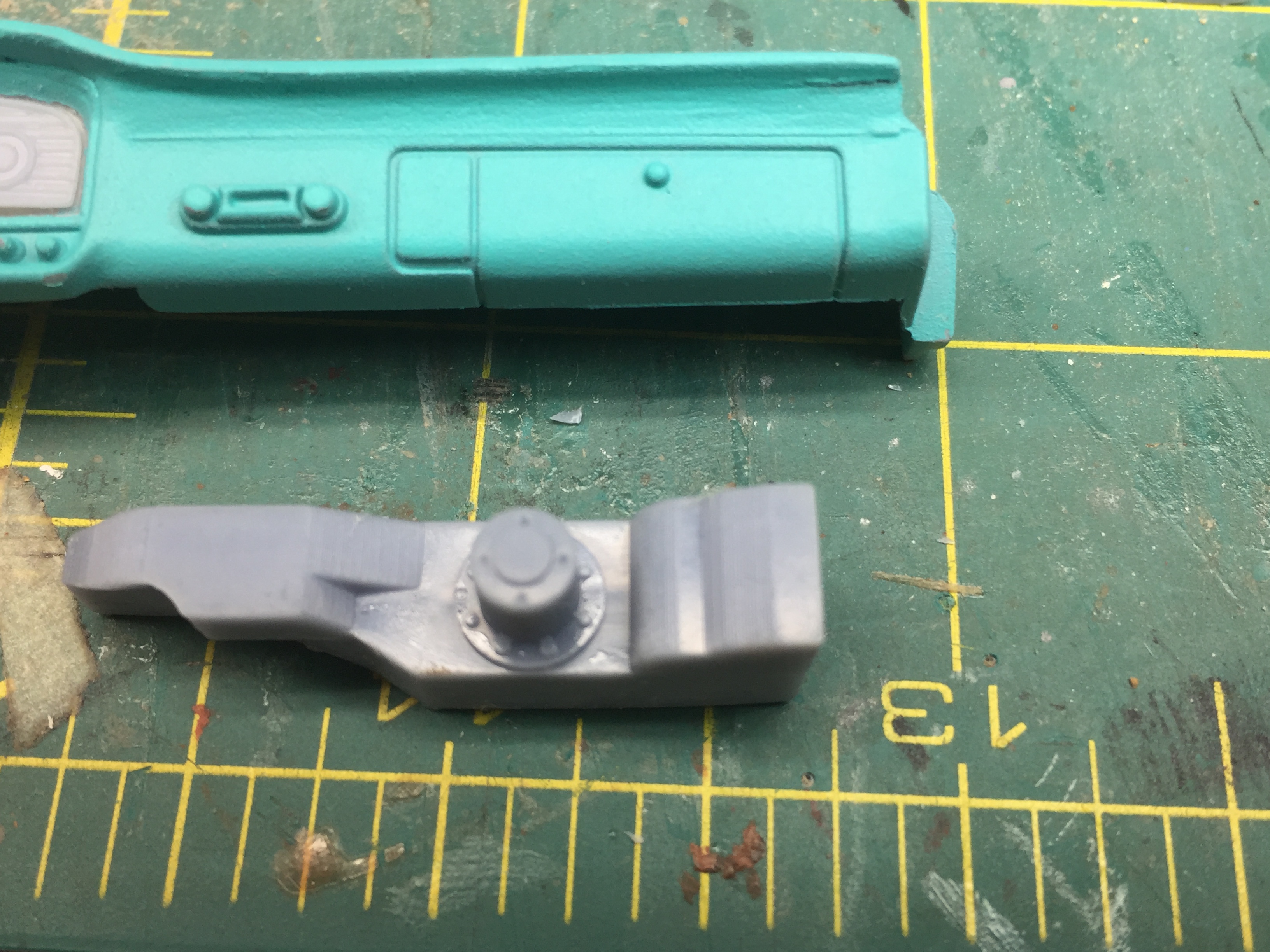

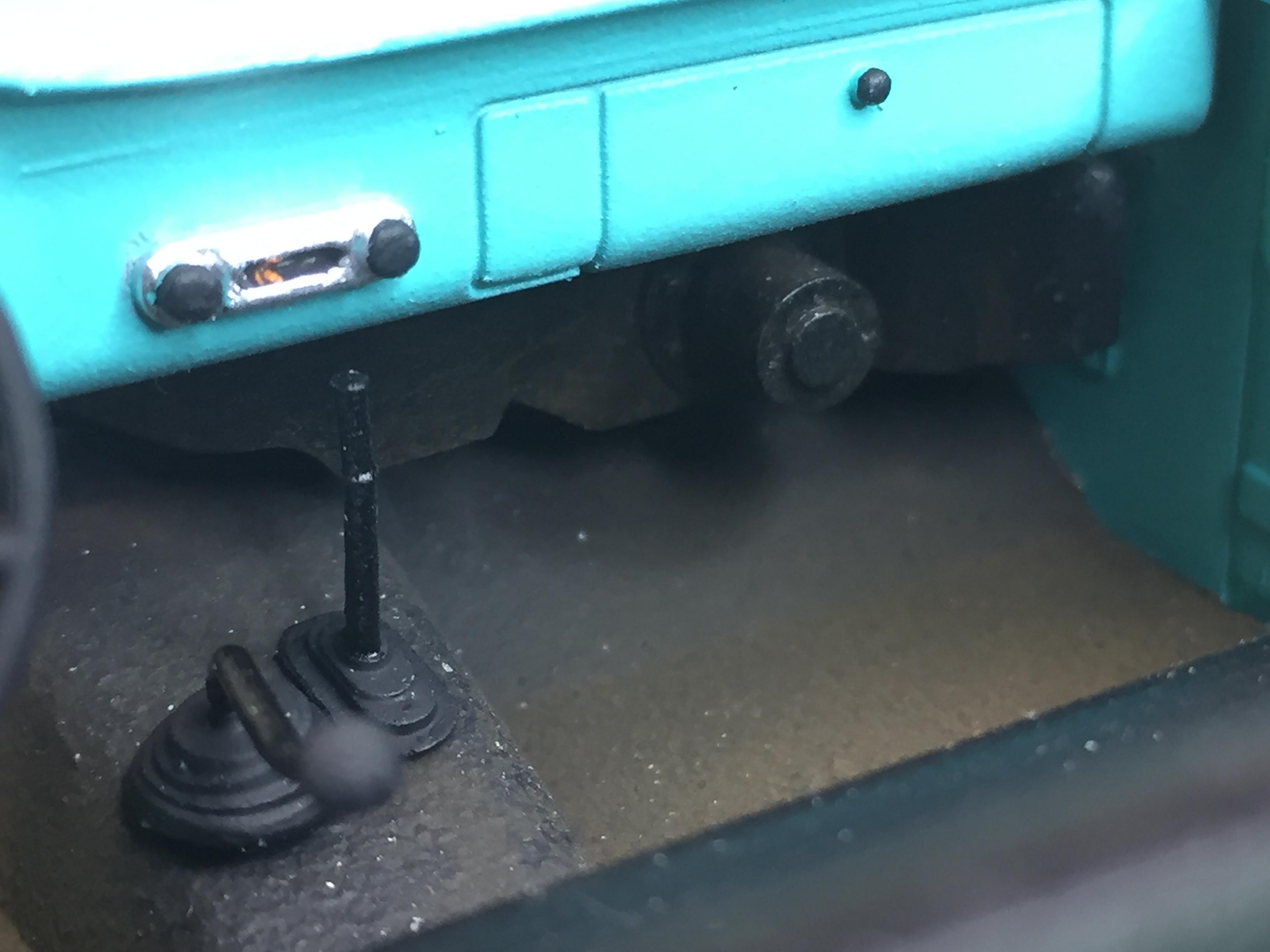

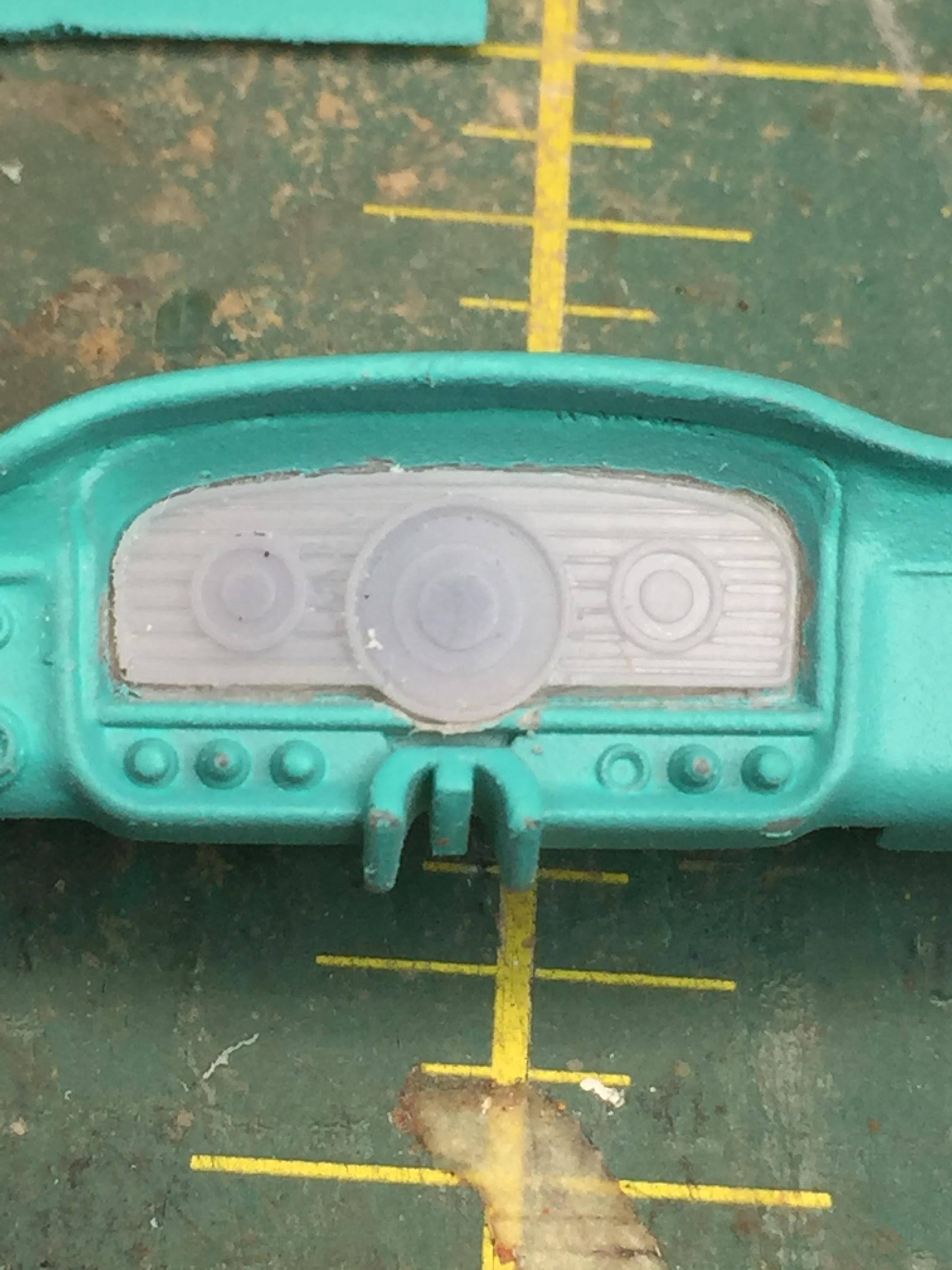

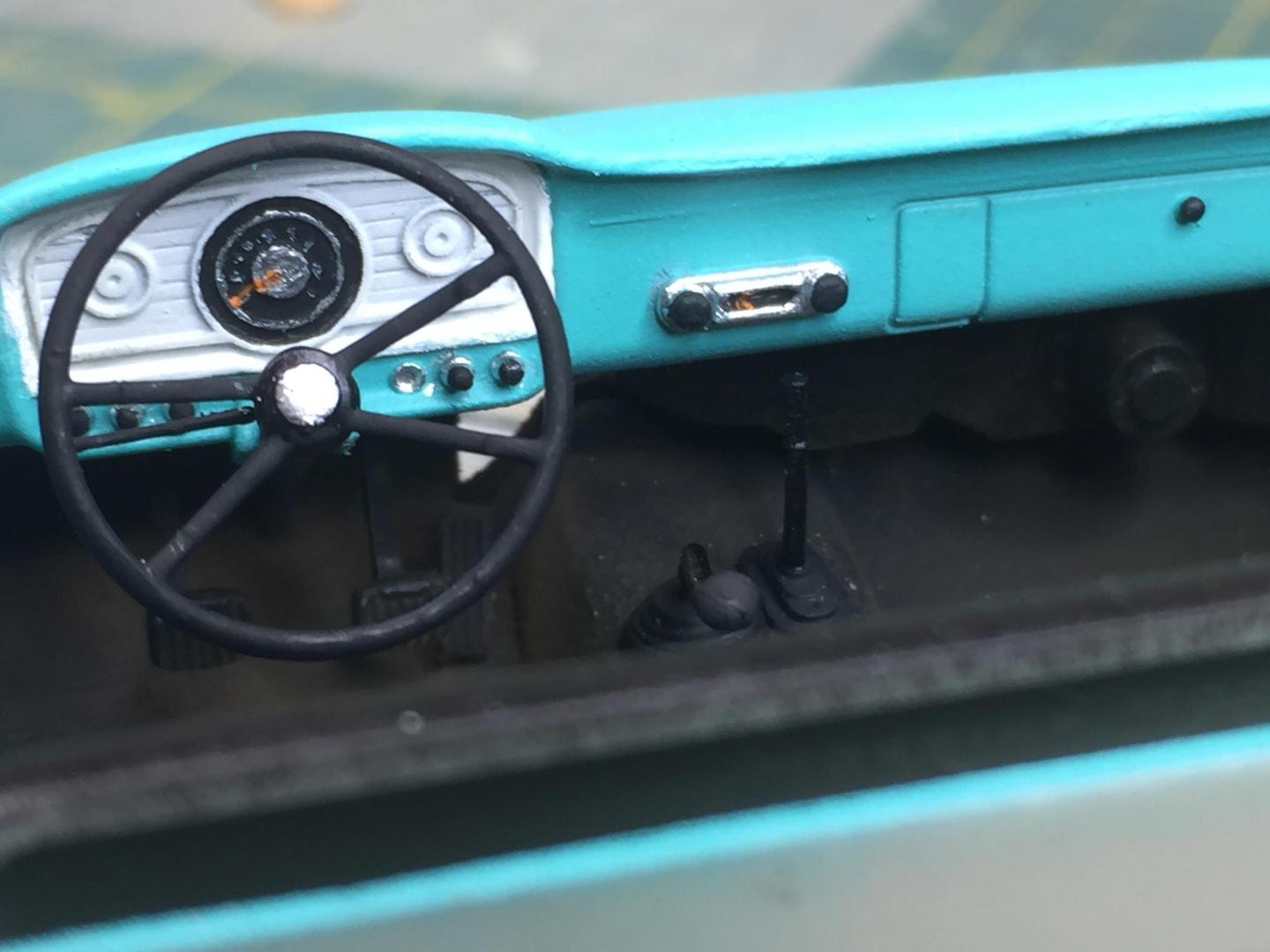

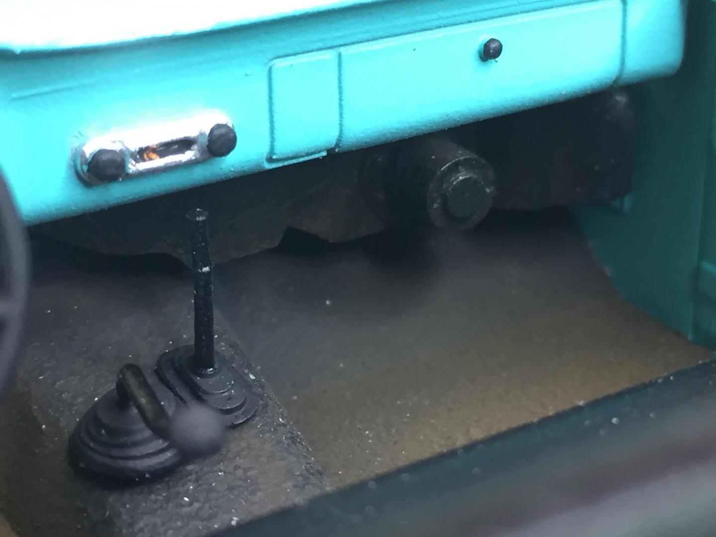

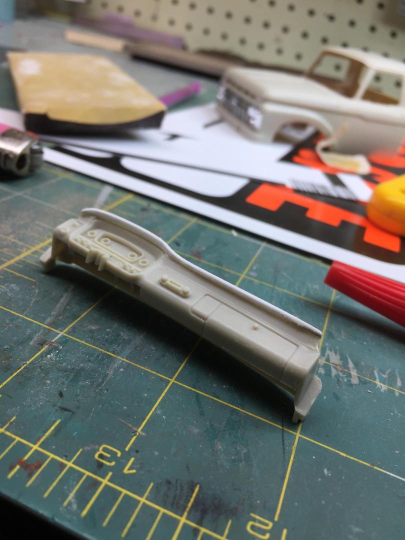

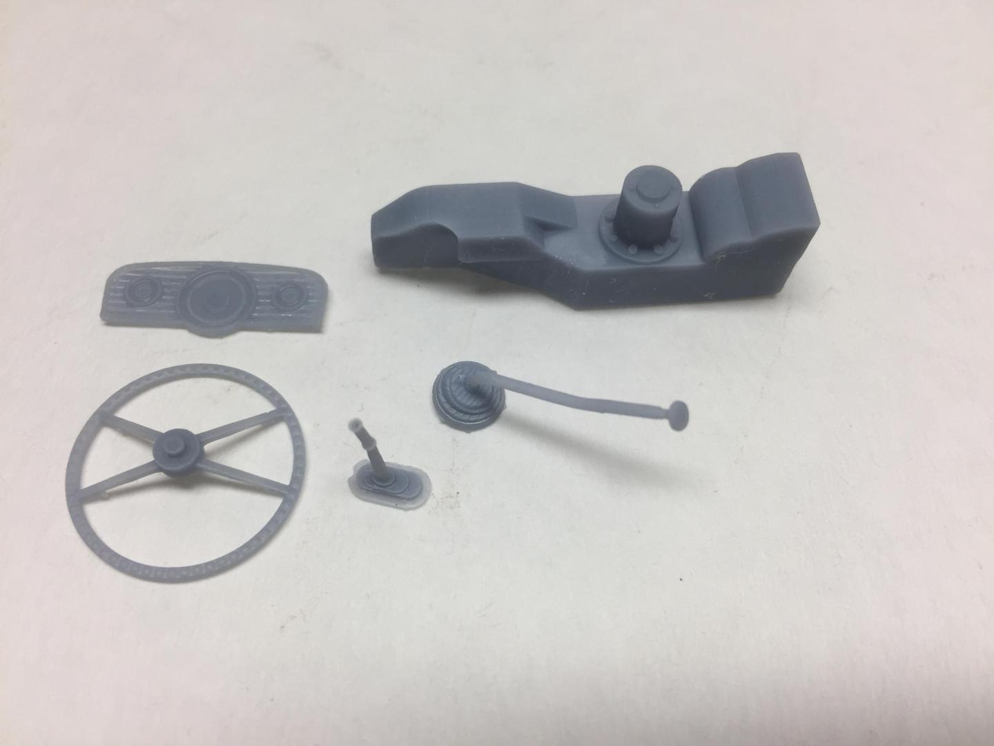

bill lanfear Posted August 17, 2019 Author Share Posted August 17, 2019 Got the interior put together. The heater box is hard to see but fills the void nicely. The F350 interior parts will be available at Rookie Resin this Saturday as a bundle. I cleaned up the mirrors and painted them. The mirrors will also be available. The truck I drove had a longer wheelbase, so I lengthened the frame again and made a new bed. Quote Link to comment Share on other sites More sharing options...

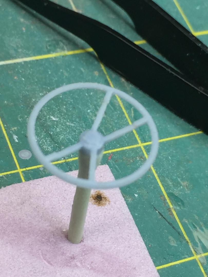

leafsprings Posted August 17, 2019 Share Posted August 17, 2019 (edited) Great new interior items Bill! All '61-'66 F 350's used the 4 spoke steering wheel and some 4x4 models also. Most 2wd pickups had the 3 spoke wheel. Most larger than the F 350 had the large version of the 3 spoke wheel.. 132" wheelbase was the only factory length listed , any longer wheelbase was a special order or custom job by a shop. The '64 grill was never done by AMT and I doubt Moebius will ever tackle it, because they would have to modify the frames, engines and inner front fenders from the '65 and '66 kits to build a '64 . Just added a photo of an F 350 to the 61-66 truck reference section of this forum. Edited August 17, 2019 by leafsprings Quote Link to comment Share on other sites More sharing options...

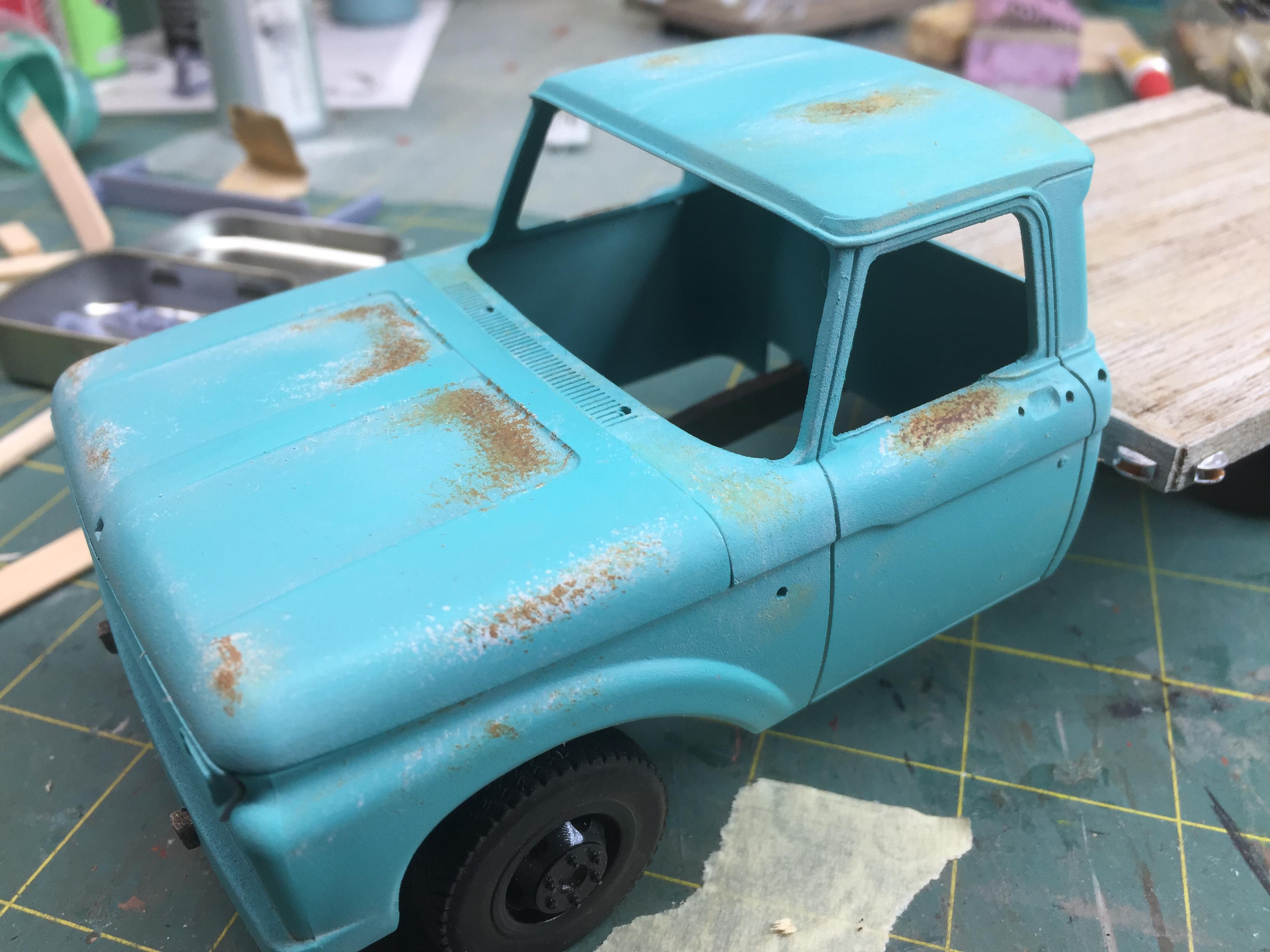

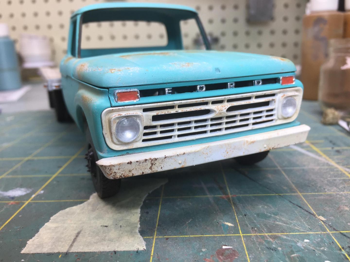

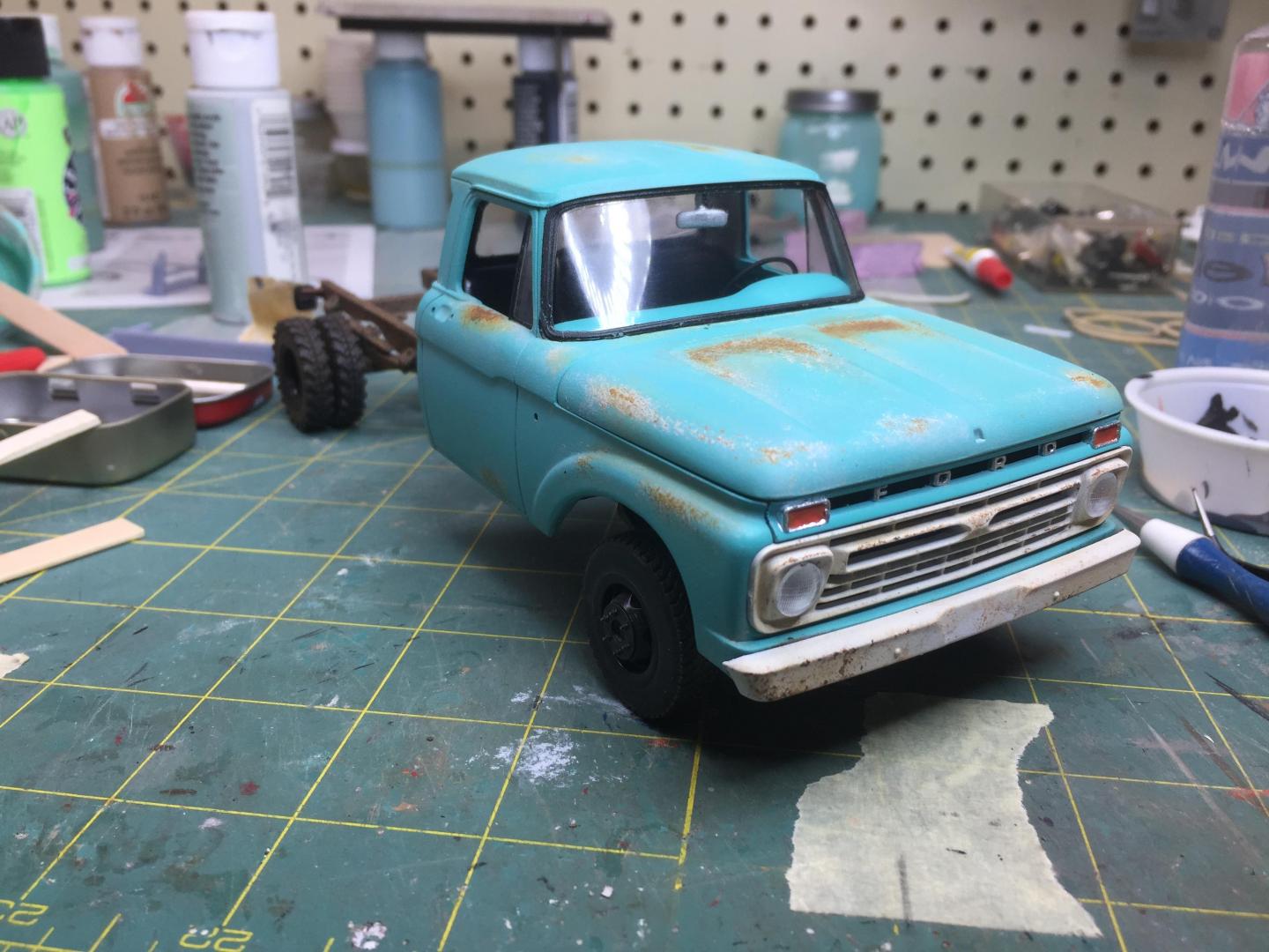

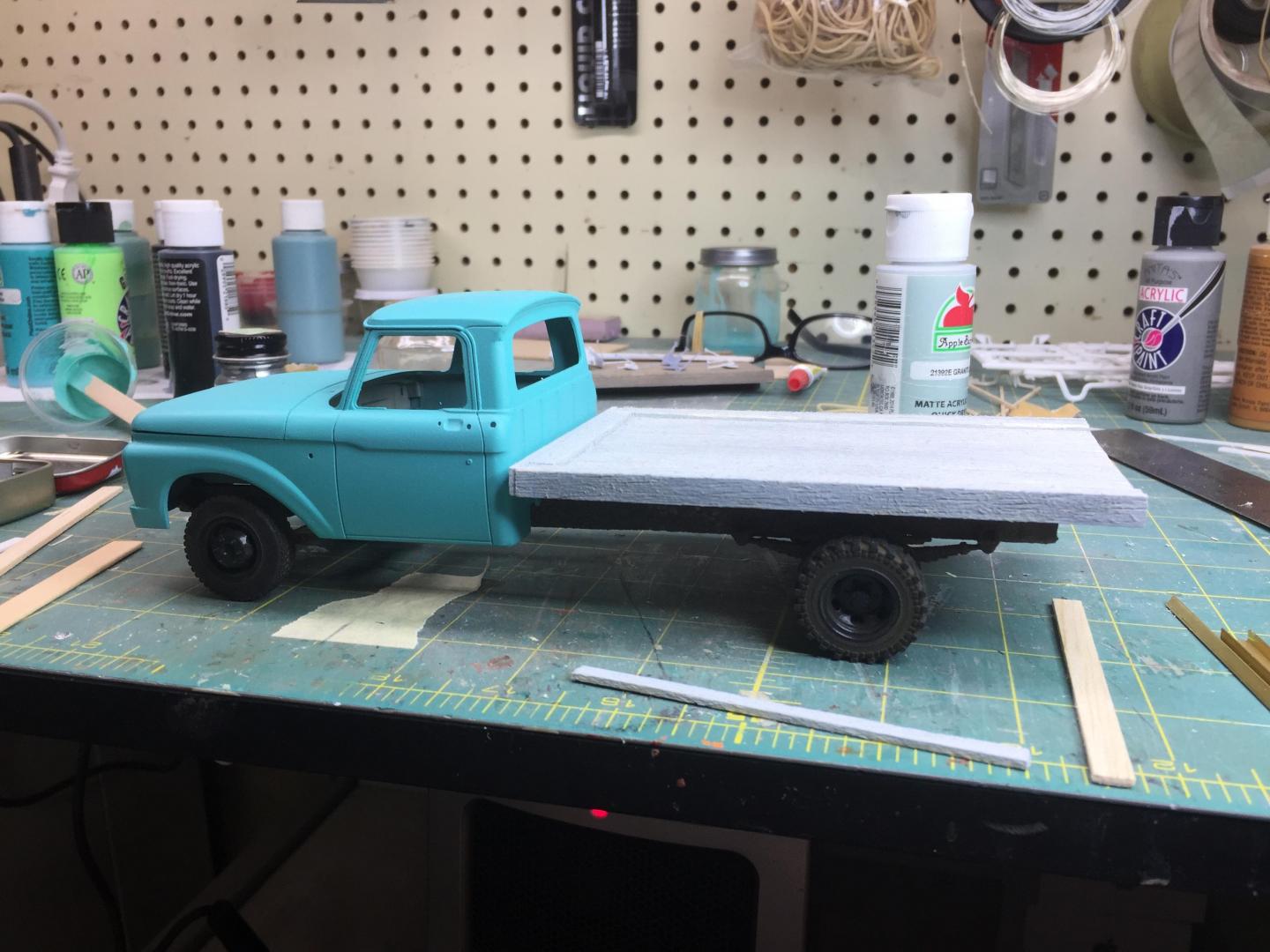

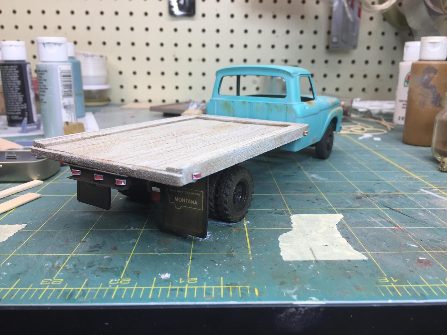

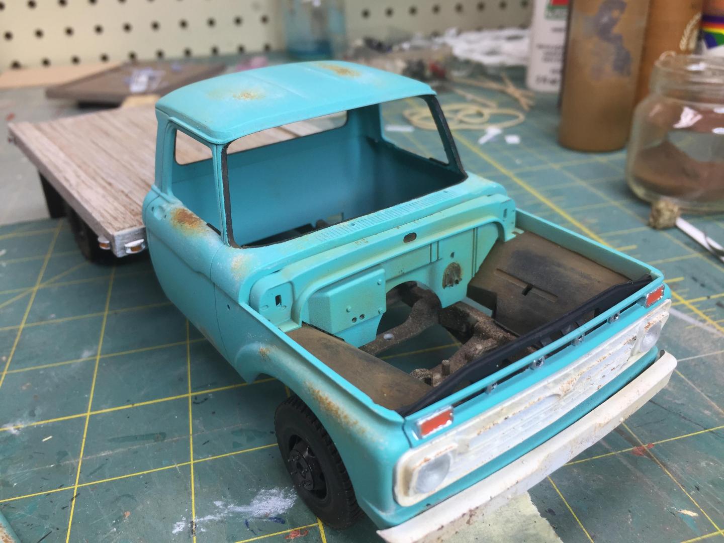

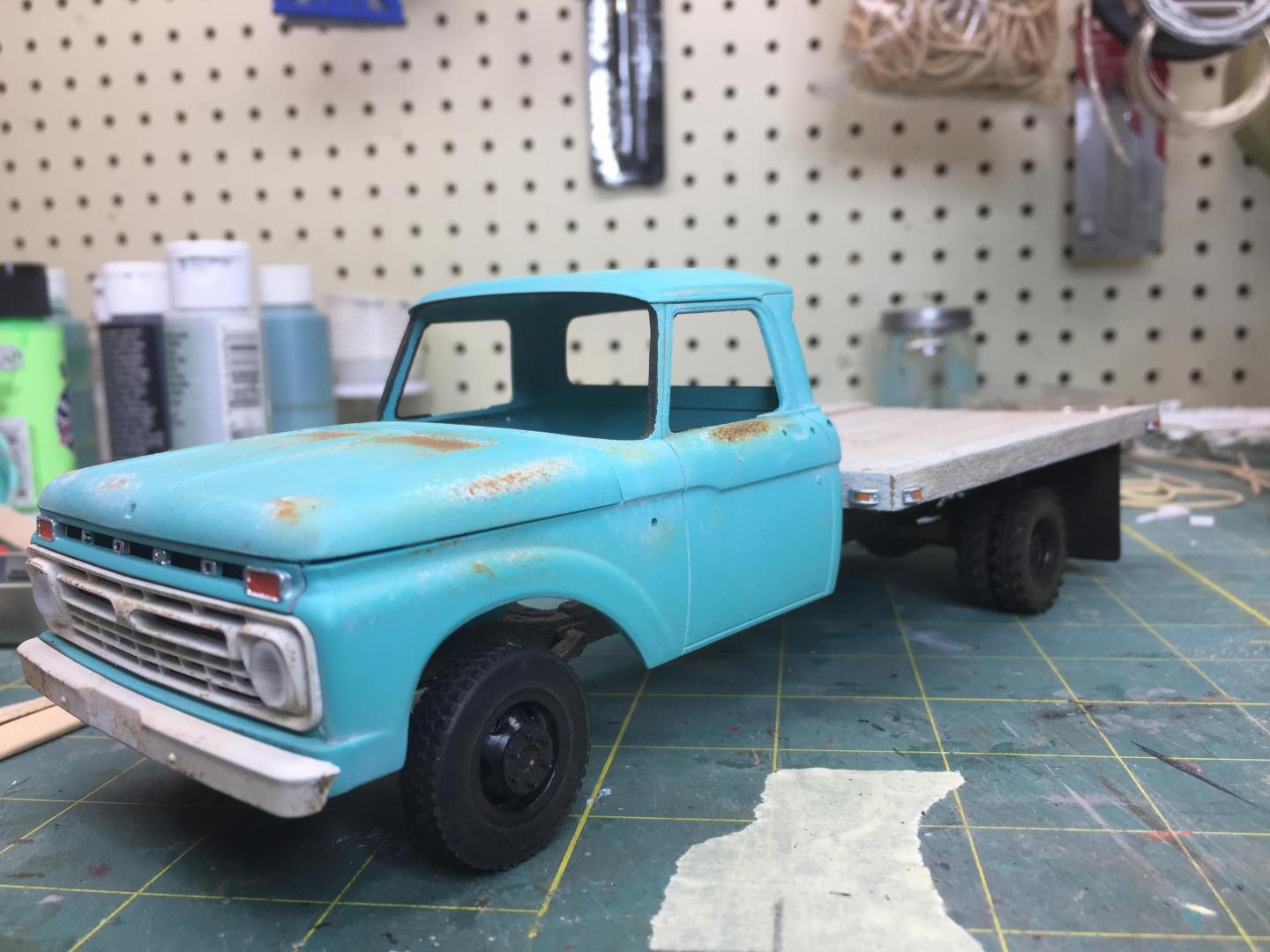

bill lanfear Posted September 1, 2019 Author Share Posted September 1, 2019 Thank you Mike, Roger, and Tom! I have another small update. I started weathering the body, grill, engine bay, and bumper. Painted the window trim, "FORD" letters, and the turn signals above the grill. The bed was also weathered and I put some marker lights on the sides of the bed. I made some mud flaps and used tail lights from a Monogram Ford kit and made brackets for them from angle styrene. Thanks for checking it out! Comments welcome! Quote Link to comment Share on other sites More sharing options...

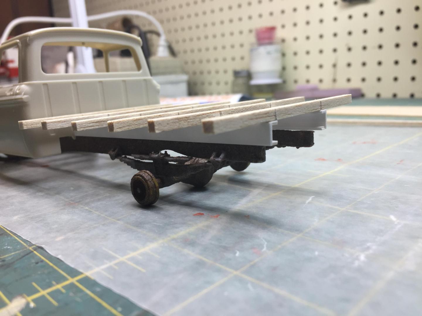

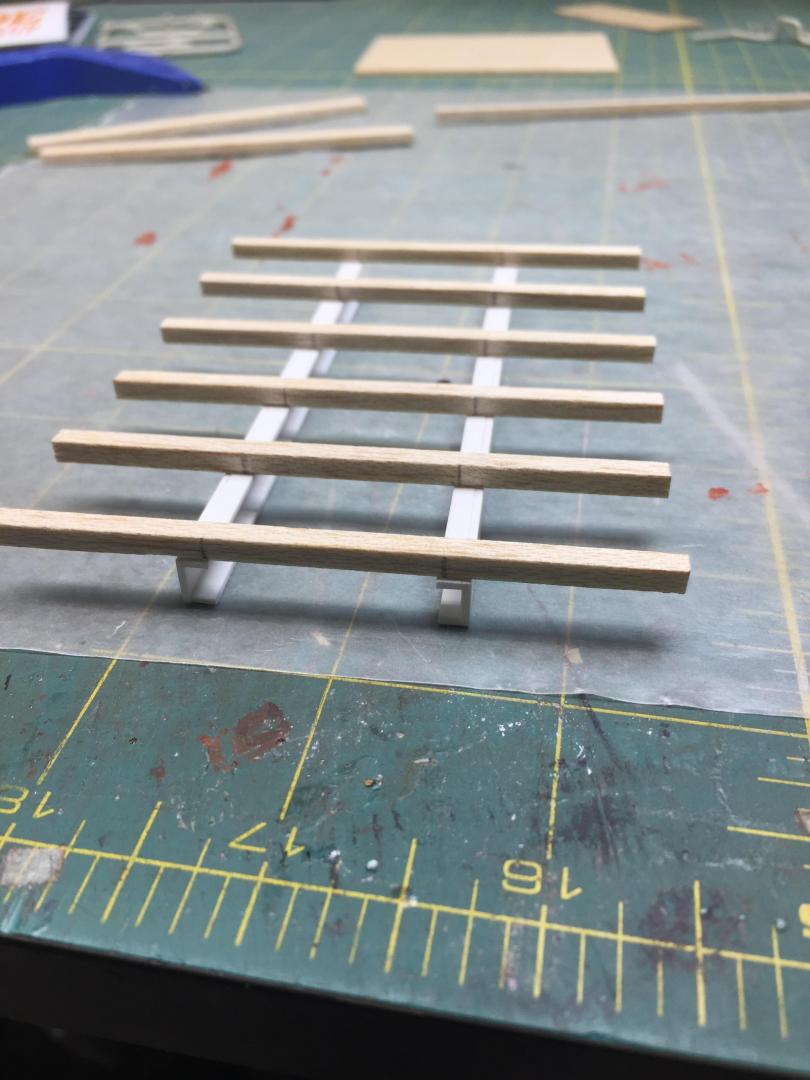

DaveP Posted September 1, 2019 Share Posted September 1, 2019 Great model. How have you mounted the tray onto the chassis? Got any photos of how you did it? Quote Link to comment Share on other sites More sharing options...
bill lanfear Posted September 1, 2019 Author Share Posted September 1, 2019 4 hours ago, DaveP said: Great model. How have you mounted the tray onto the chassis? Got any photos of how you did it? Thanks David! I assume you are referring to the flat bed. I made c channels from styrene or you can buy them from companies like plastruct. It then just sits on the flat frame. Another way to do this could be using wood beams in place of the c channels. Quote Link to comment Share on other sites More sharing options...

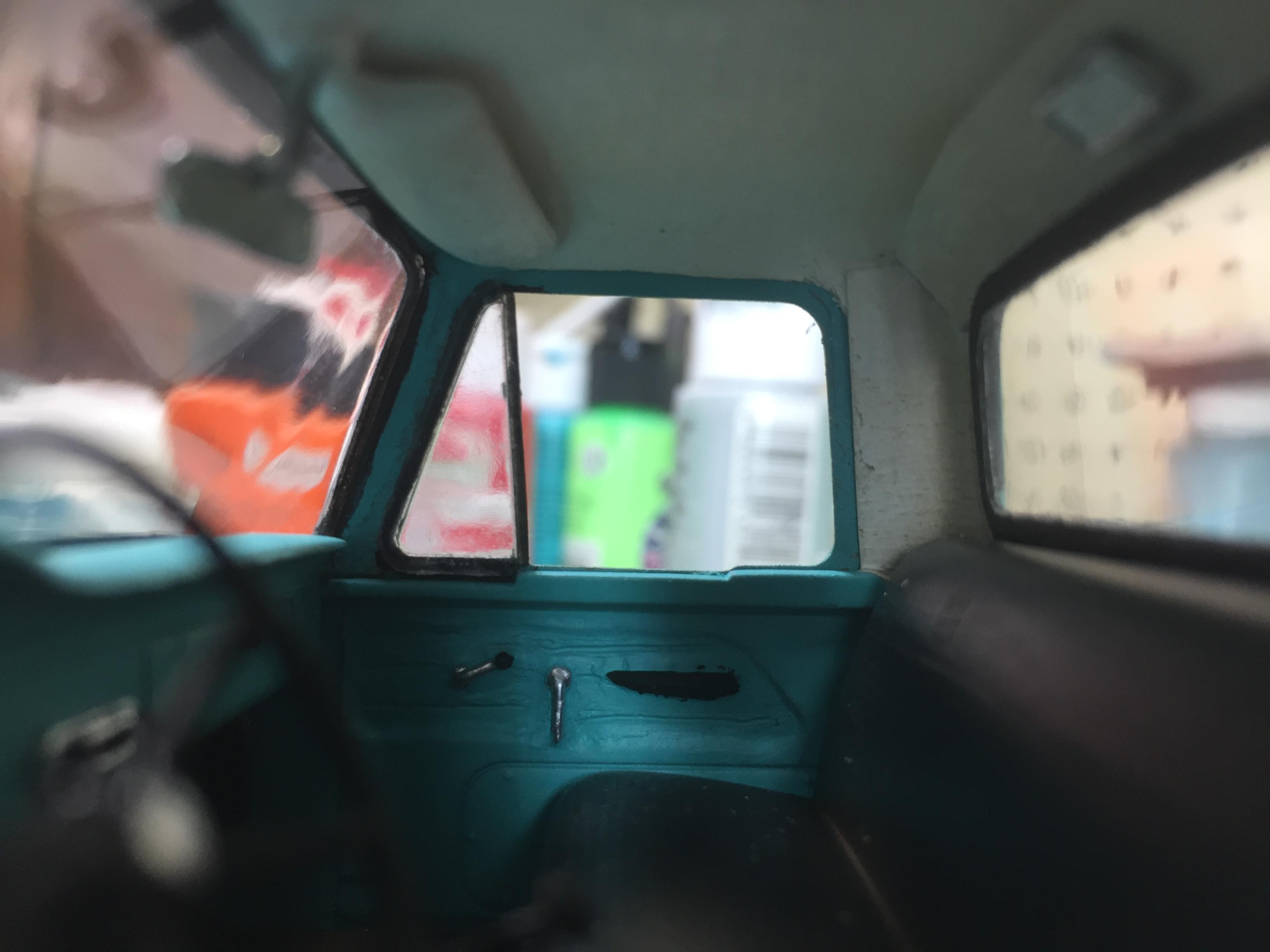

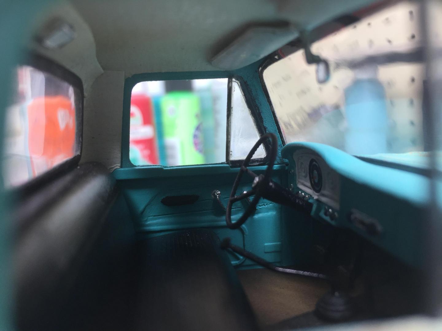

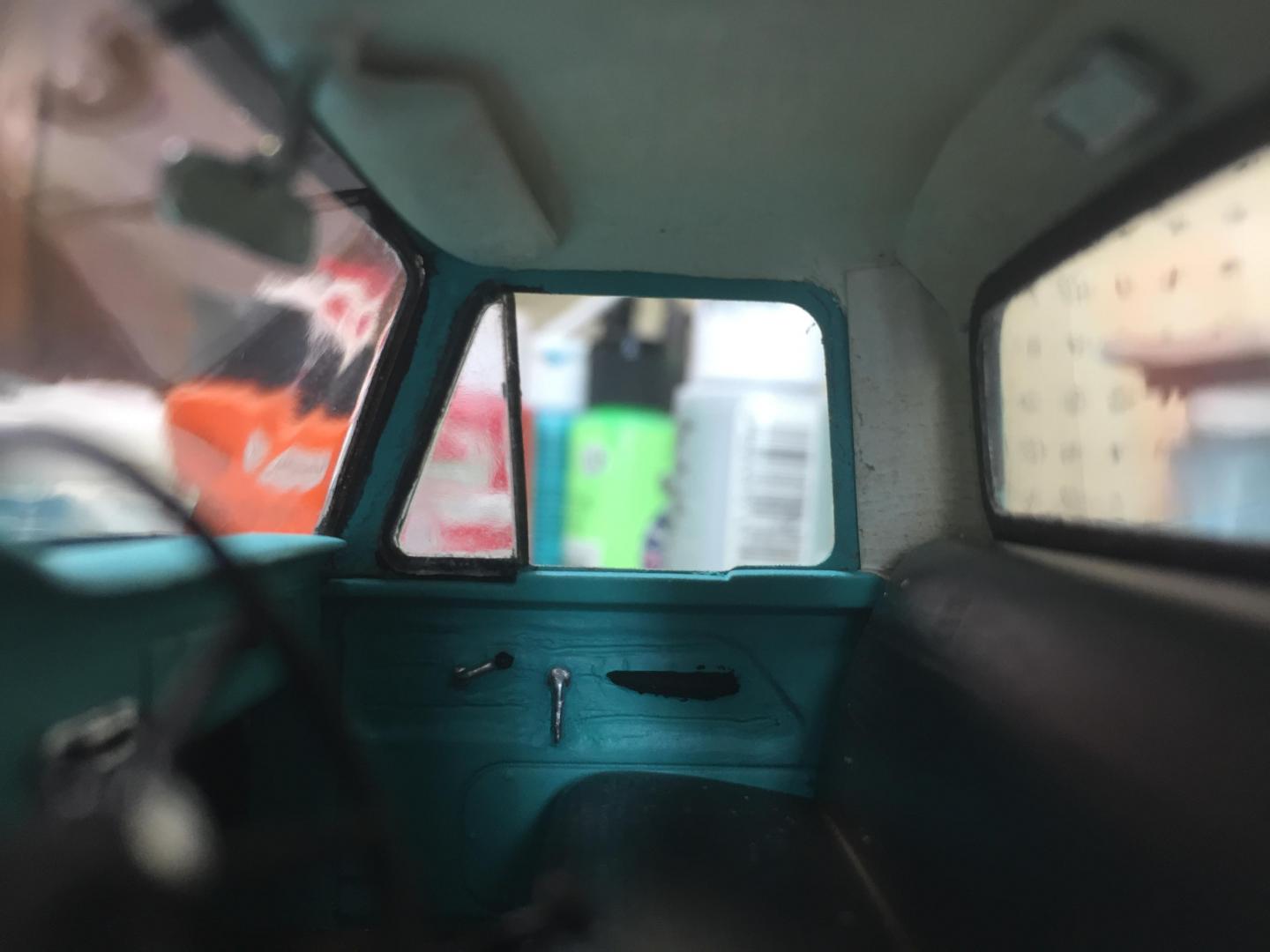

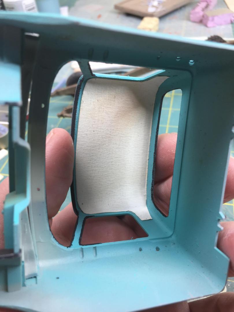

bill lanfear Posted September 9, 2019 Author Share Posted September 9, 2019 Small update, worked on the interior and glass. I wanted to add a headliner for this build and after researching a bit, I came up with this plan. I took some card stock from an I phone box and wrapped it in masking tape, then painted the pieces white. I then glued the pieces in place and made a dome light from something I had in the parts box. For the glass, I taped the side with a lip and carefully cut out the area for the surround molding, removed the tape and applied it to the other side, then cut a new one for the side with the lip again. This allowed me to spray the rubber surround and get a fairly clean edge. For those not familiar with this kit, the windshield goes in from the front (outside) a whole lot easier than doing it from inside!!! Anyways, not much else to report. Thanks for your comments and thanks for watching!! Quote Link to comment Share on other sites More sharing options...
