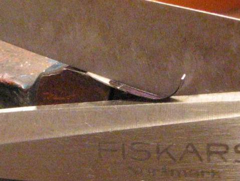

The wheels look great! I discovered that, if I keep the surface of the sheet of aluminum that I am using to make the part I'm cutting flat against the cutting surface of the scissors (I use regular old Fiskar's), that it cuts, virtually distortion-free. I'm so convinced of its effectiveness, that I bought a pair of left-handed scissors, too. I figure they're basically my shears/snips, so I might as well set myself up to be able to cut on either side of a line, without distortion.
Share this post
Link to post
Hi Dan,  thanks for the info.  I don't quite understand what you mean about "flat against the cutting surface".  Can you post a pic of how you mean to hold the sheet/scissors?
Mick..
Mick..
Here is one I took for an article I was doing on working with sheet metal to make dragster bodies. The other is a photo of the result. Note that the motor plate is still flat, while the "falloff" is curled.

OK, I think I see what you mean now.  I think though, the "falloff" would be to the other side of the scissors, away from the cut.  I see too about the "flat side".
This is interesting, also about the scissors for lefties. As soon as my bench is free of laced wheels and jigs, I'll look into this further.
Dan, thanks for posting.

Love it, Mike! It just looks badass! You're welcome, RE: the cutting of sheet. I've been doing it that way for at least a decade, now, and, in most cases, it works, flawlessly.
