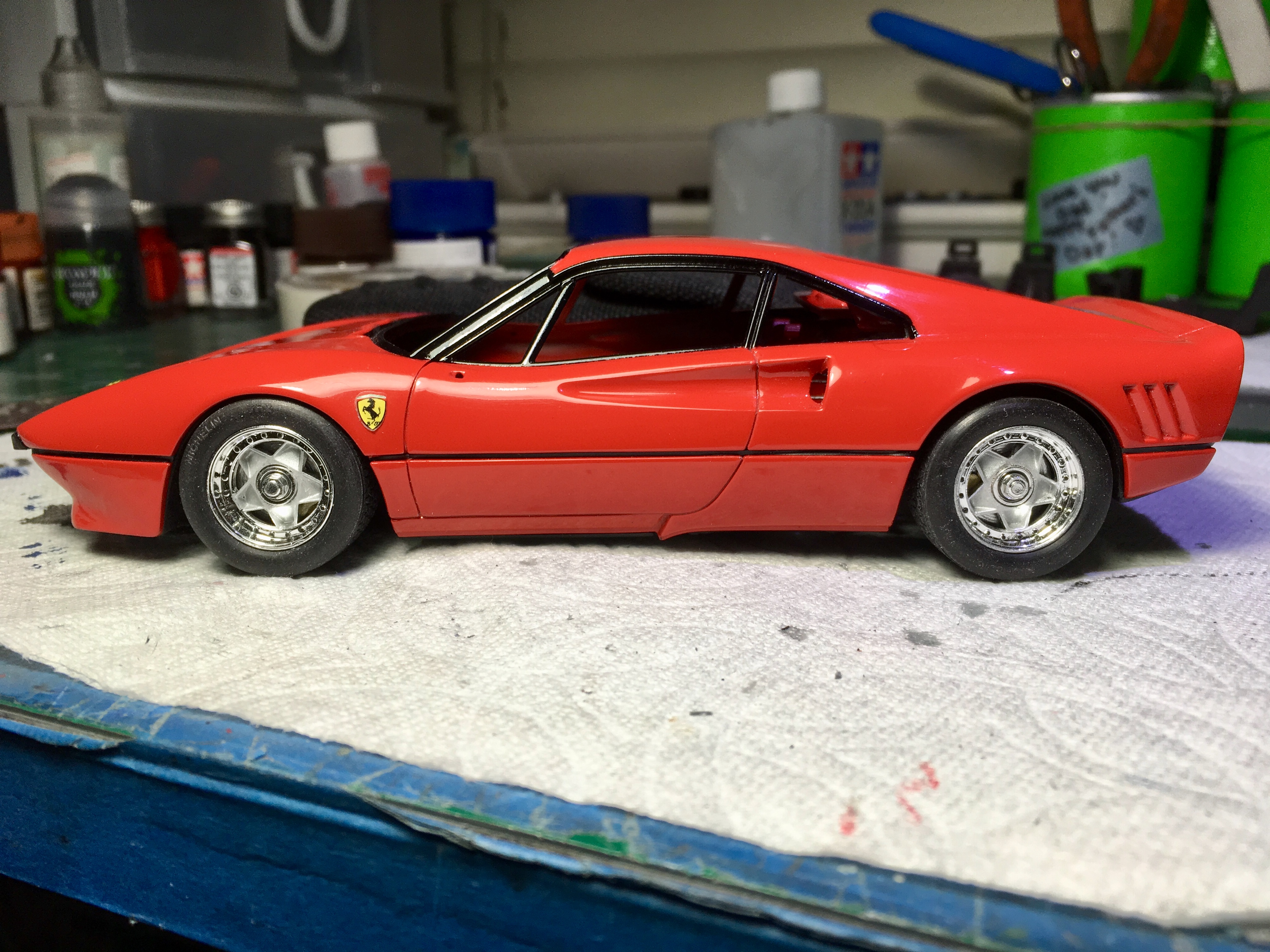

Thank you  Iam Superdan and Dogfish. The model is not nice. The plastic is kind of brittle , a lot of sinkmarks, the stock stance is terrible. But if you go into it knowing this, fix all the problems the kit is ok. The dimensions seem to be good. I thought this would be a breeze but again I was wrong. Thank you guys very much for the great comments.

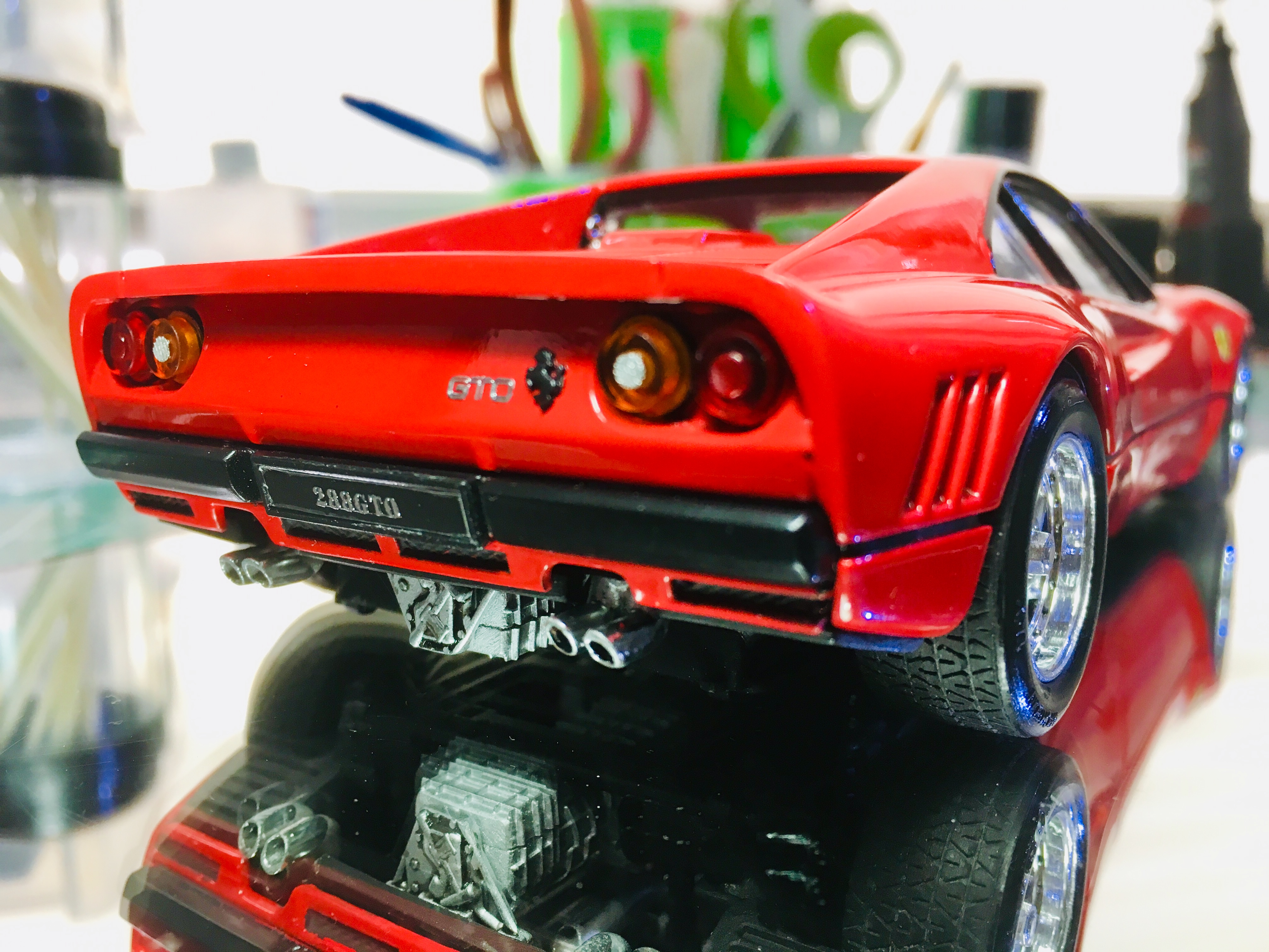

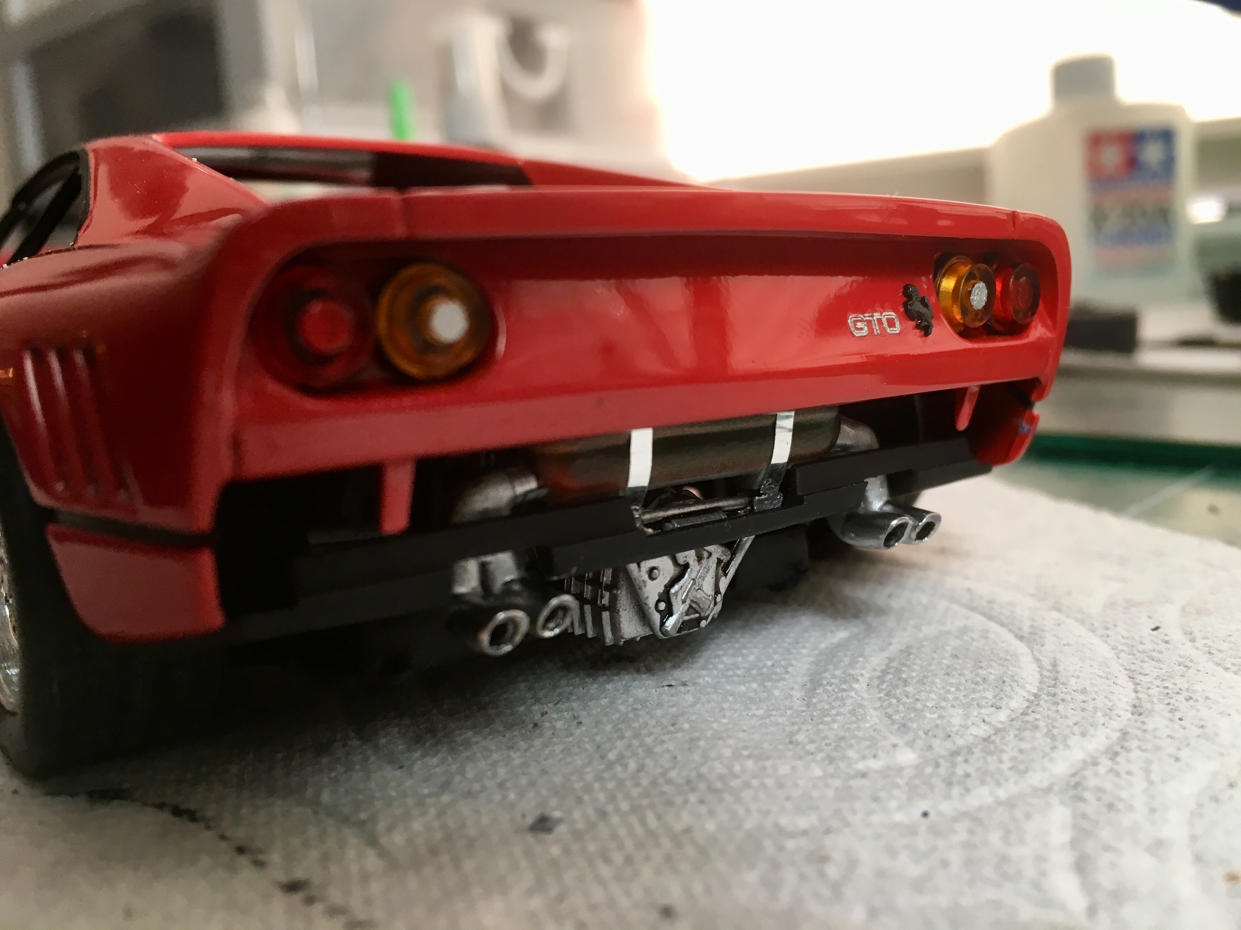

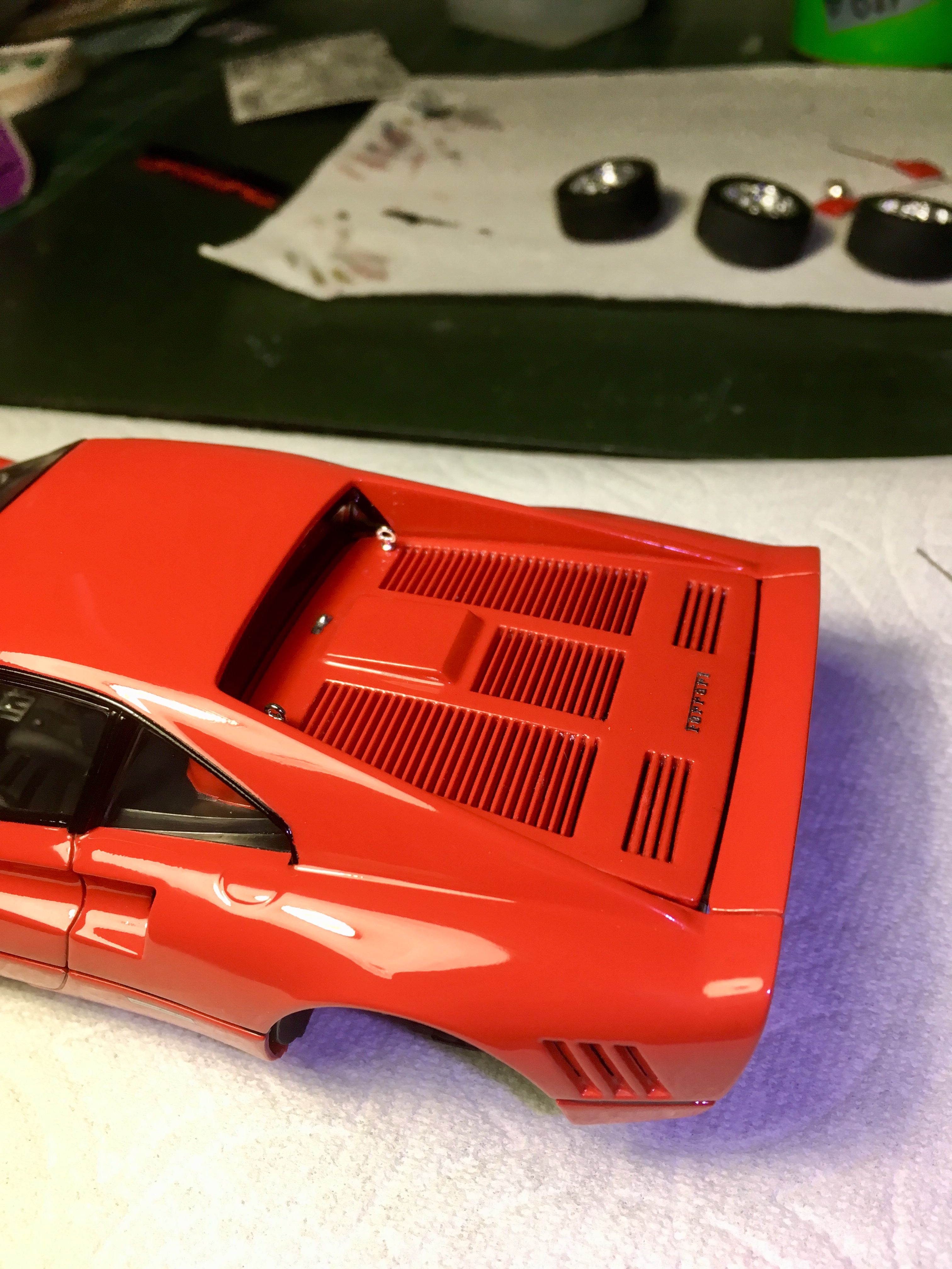

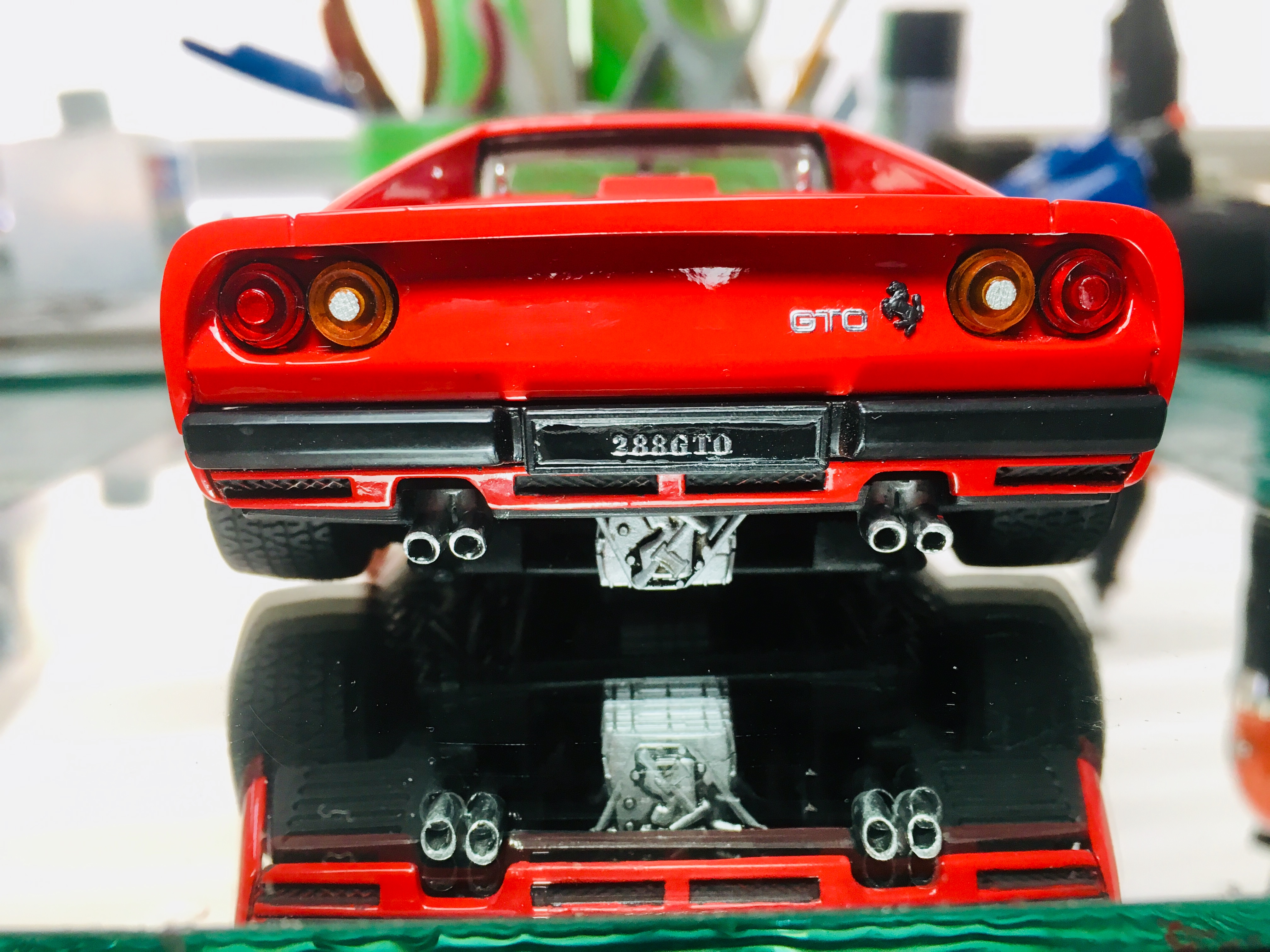

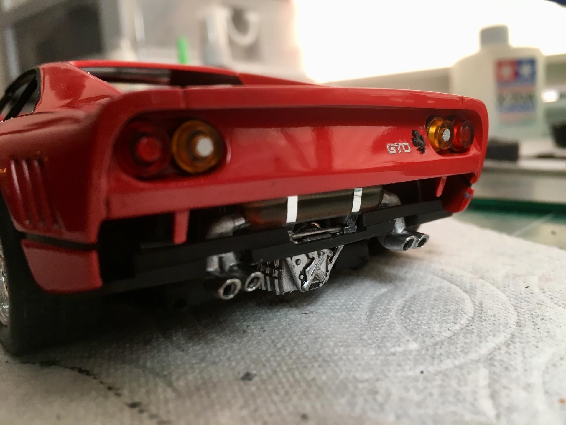

Rear shot before rear bumper goes on

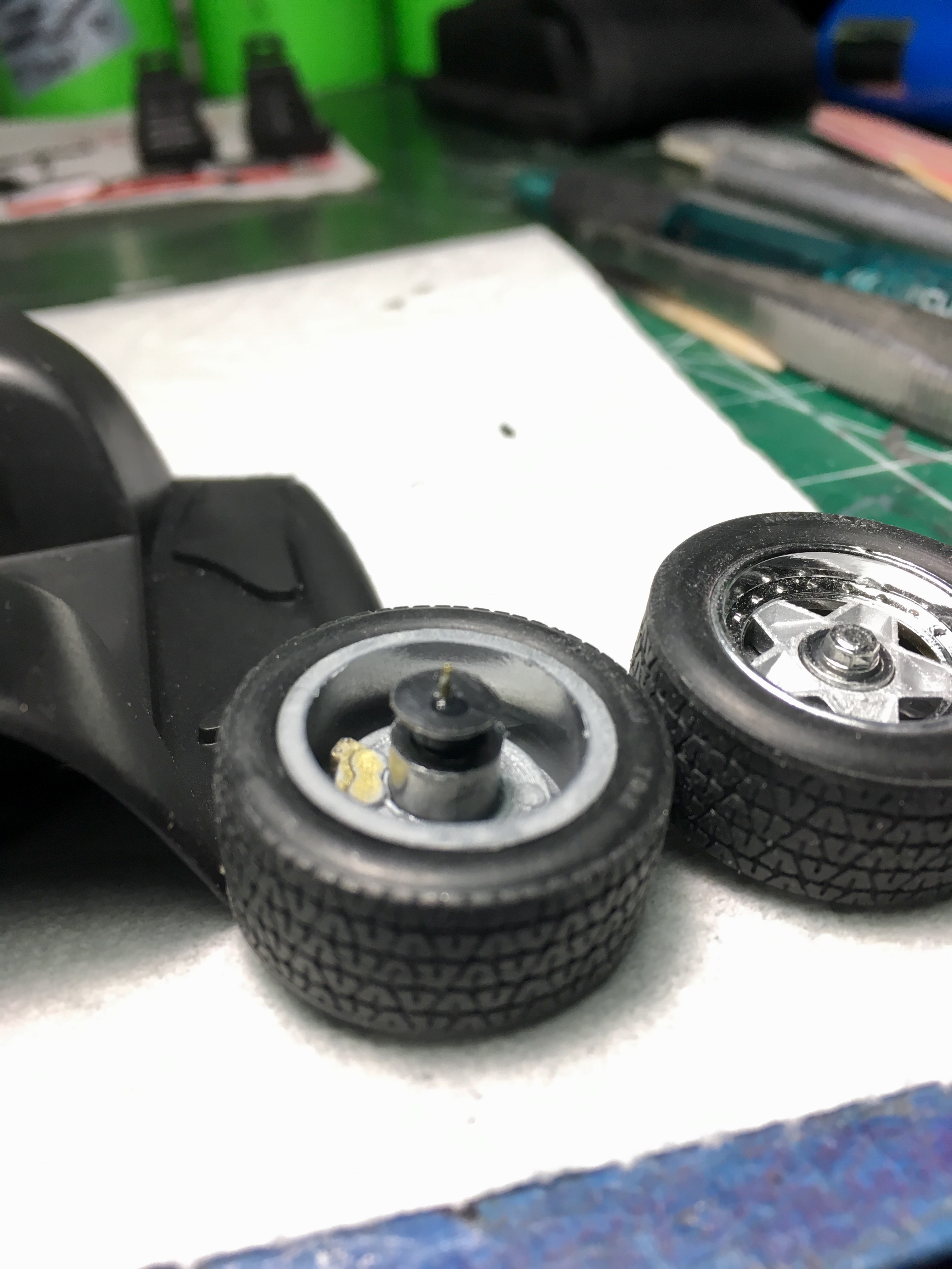

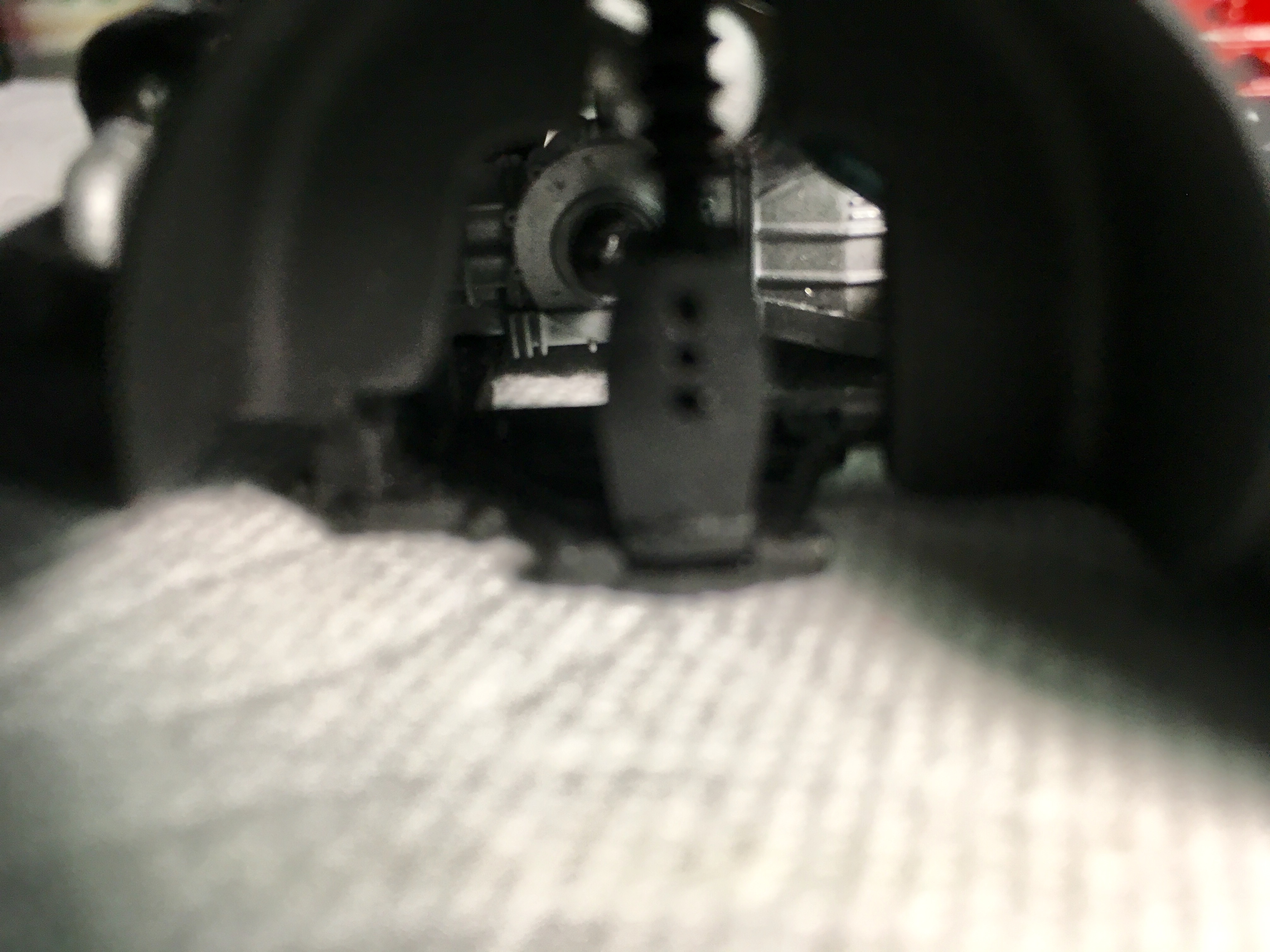

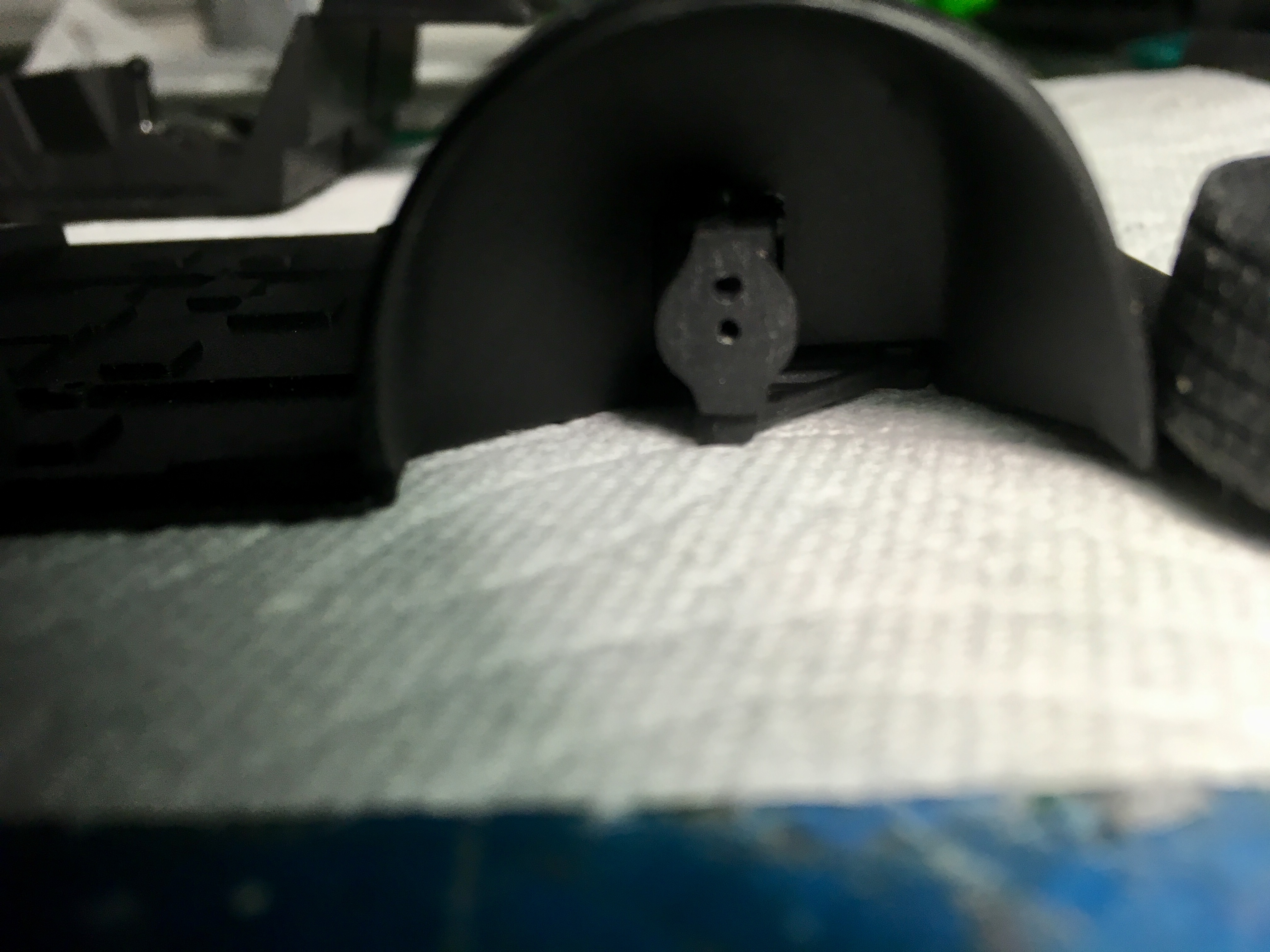

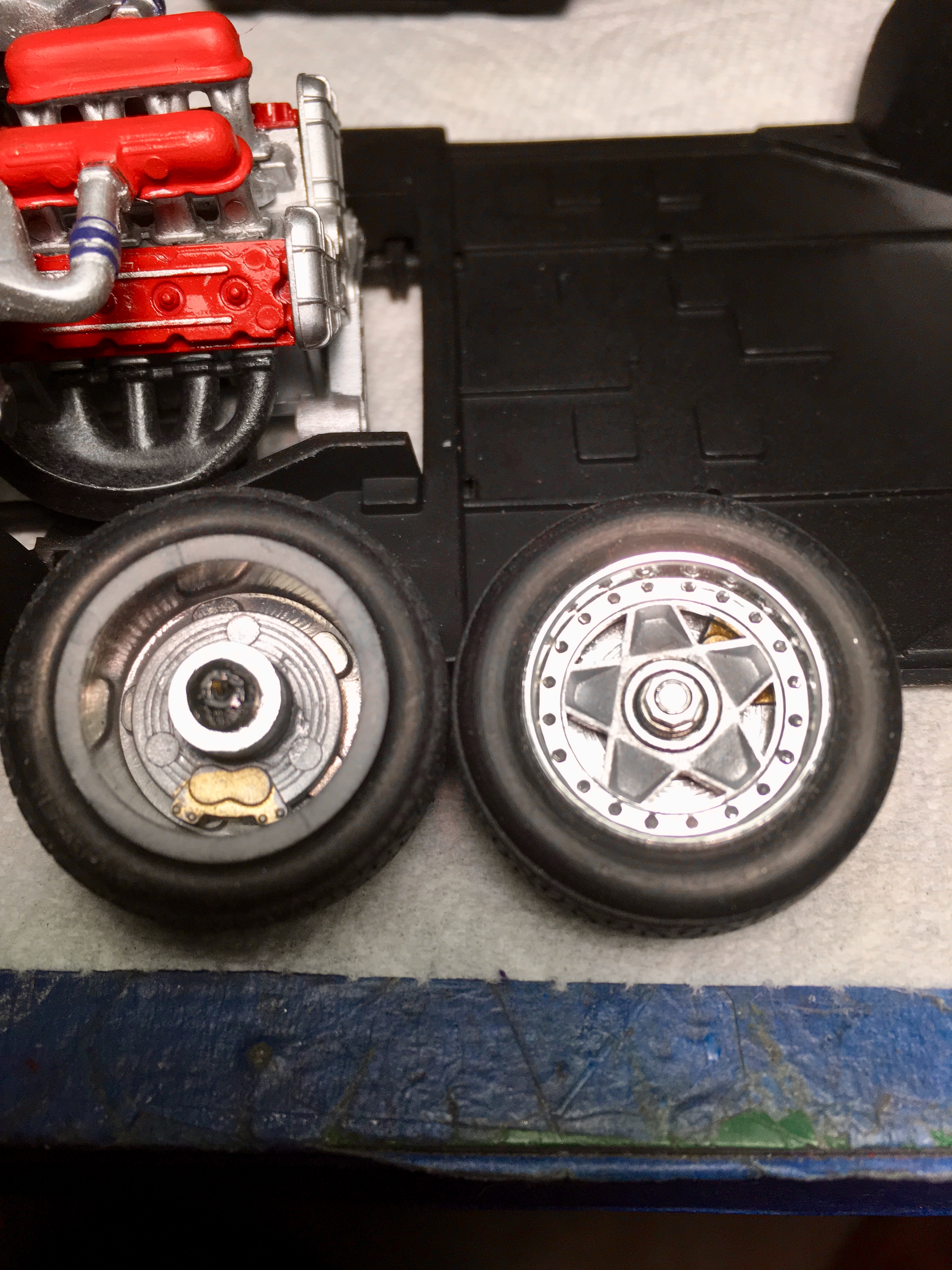

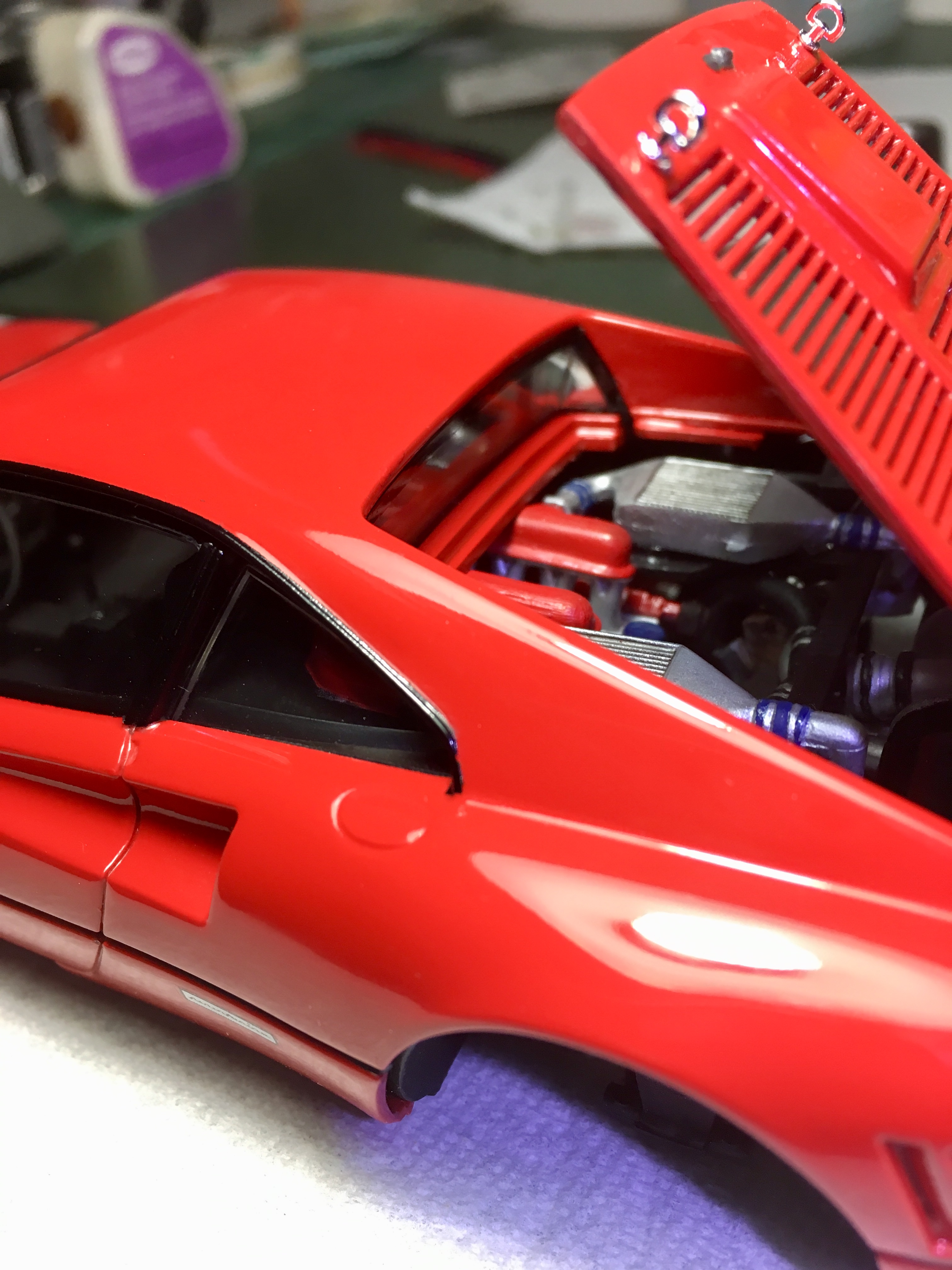

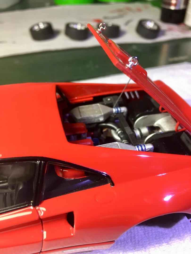

Thank you funky chiken . These next pics is what I did to get the ride height correct. And what I did to get the wheel and tire to set inside the wheelhouse correctly. Other wise the car would set too high and the tires would stick out. I drilled the disc brakes to fit inside the wheel. If you do it by the testors instructions the tires will stick out of the body. I cut off the spindle shafts and put them on the wheel. Drilled a small hole to put a piece of round brass stock. I drilled the front spindle with two hole locations and the rear with three hole locations. Gives me options on ride height. I will then epoxy the rear wheels , then the next day do the same to the front. I just dry fit the tire /wheel for the photos. Hope this helps with this car.

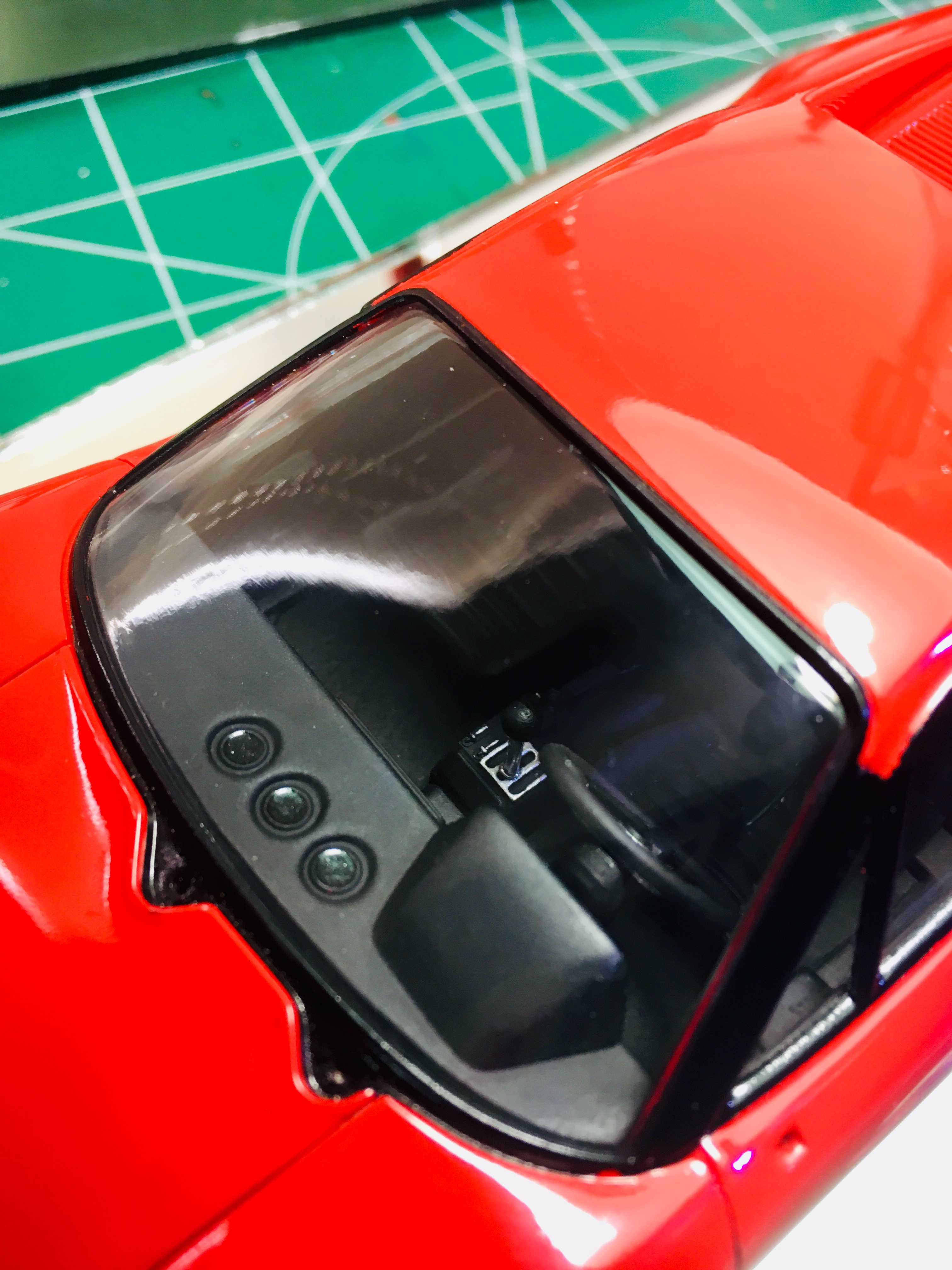

Thank you DannTier, thank you Peter, thank you Modbldr for your comments. Putting the glass in now . It’s very brittle. Hope the chassis goes into the body. The rear glass has to fit a channel so this may be nerve racking. Hoping for the best
Share this post
Link to post

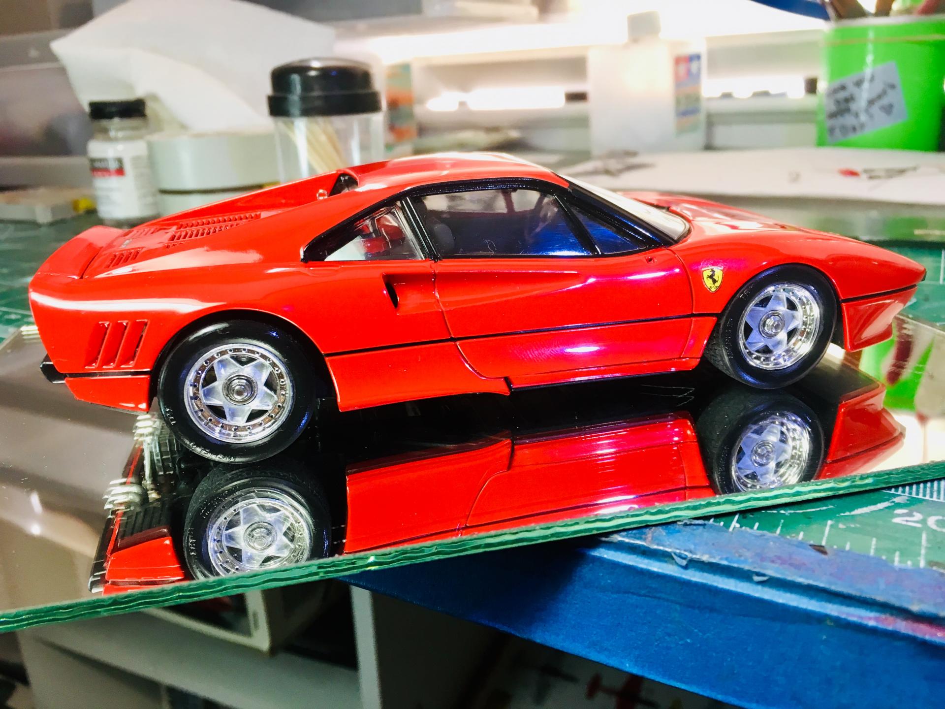

Put the chassis and interior into the body. I was impressed as the body went on without any problems. Rear glass mounted into the channel with ease for some reason. I thought I might have to fight it but did not. Tomorrow the wheels to the car.

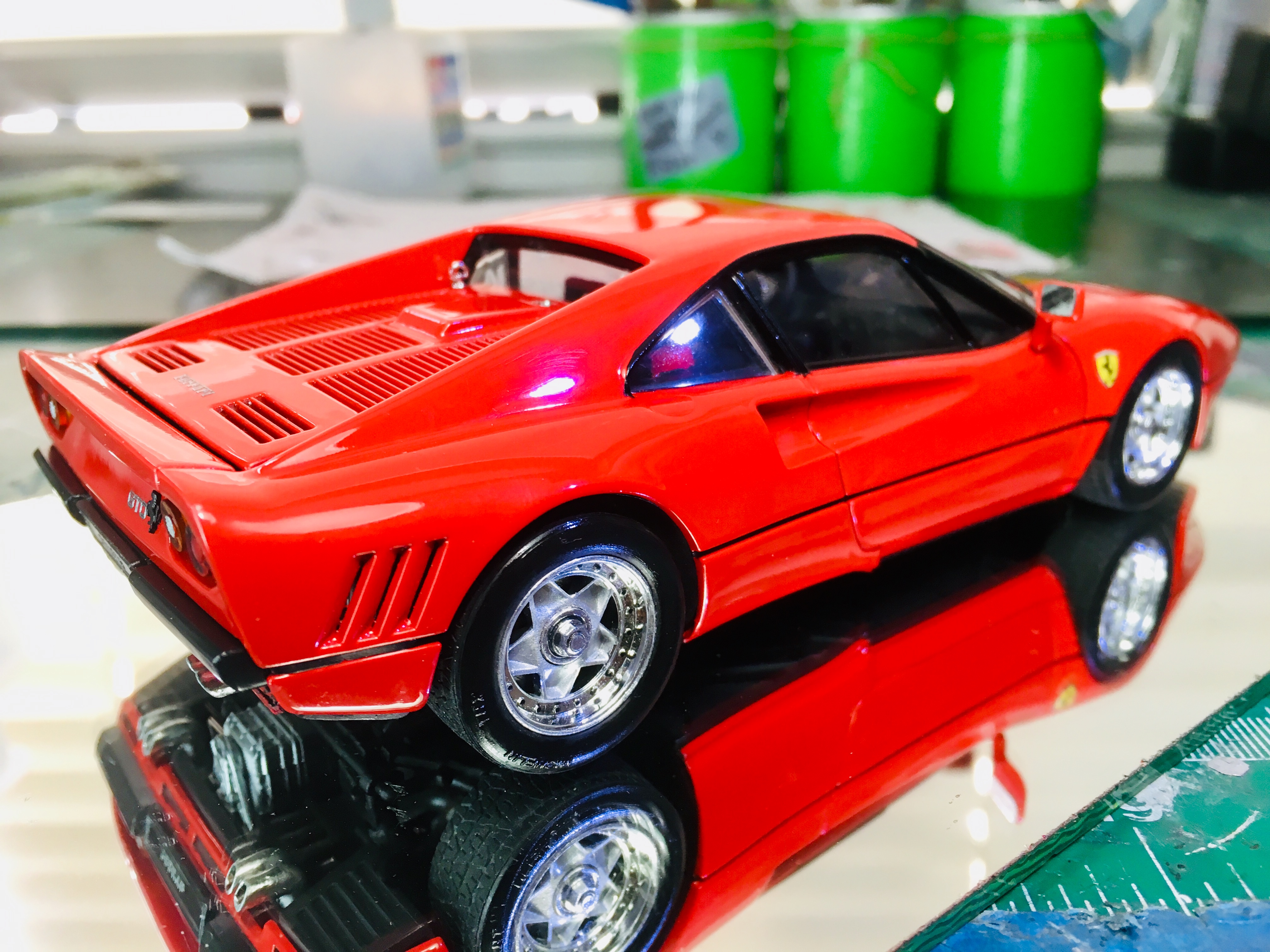

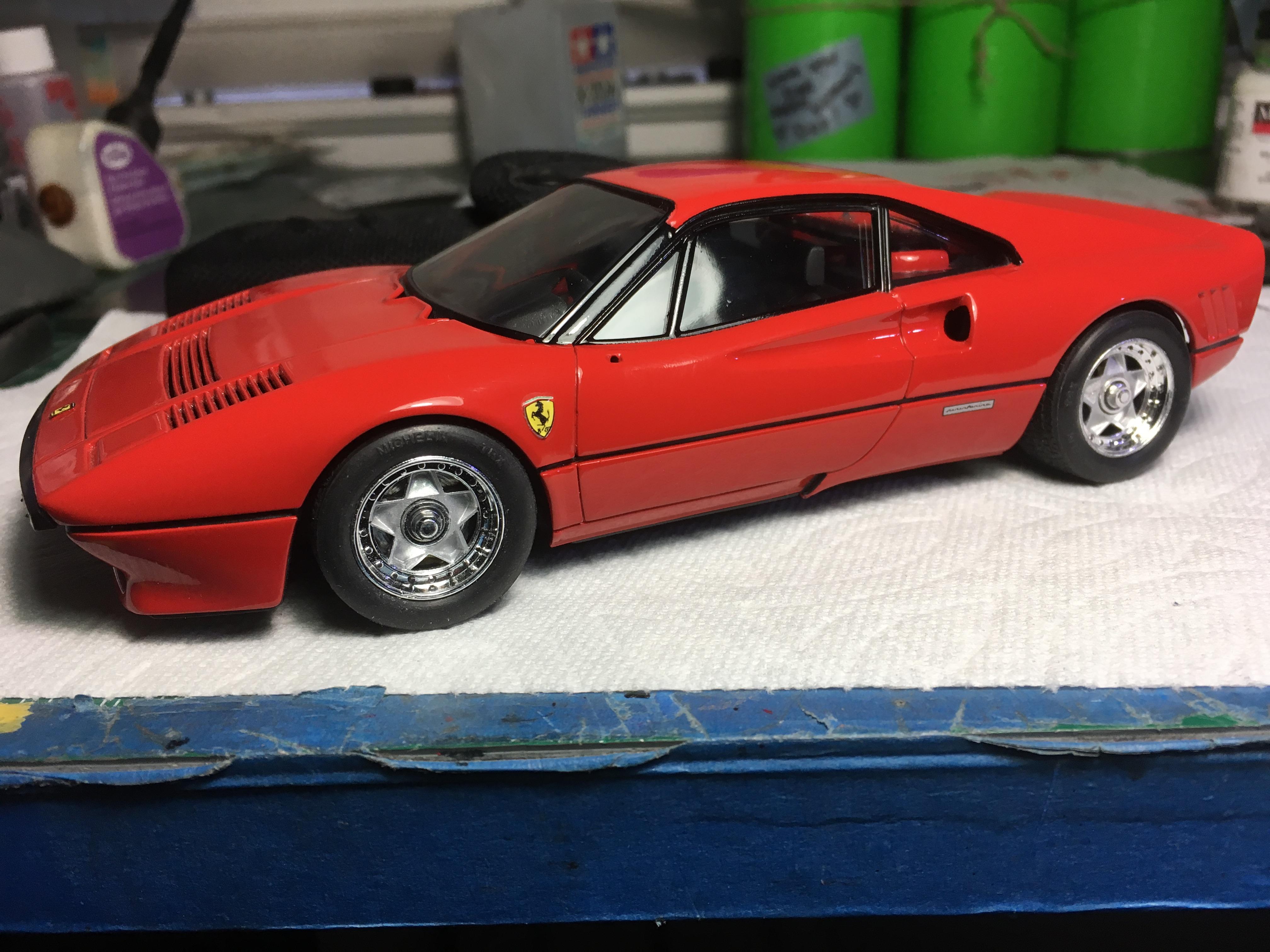

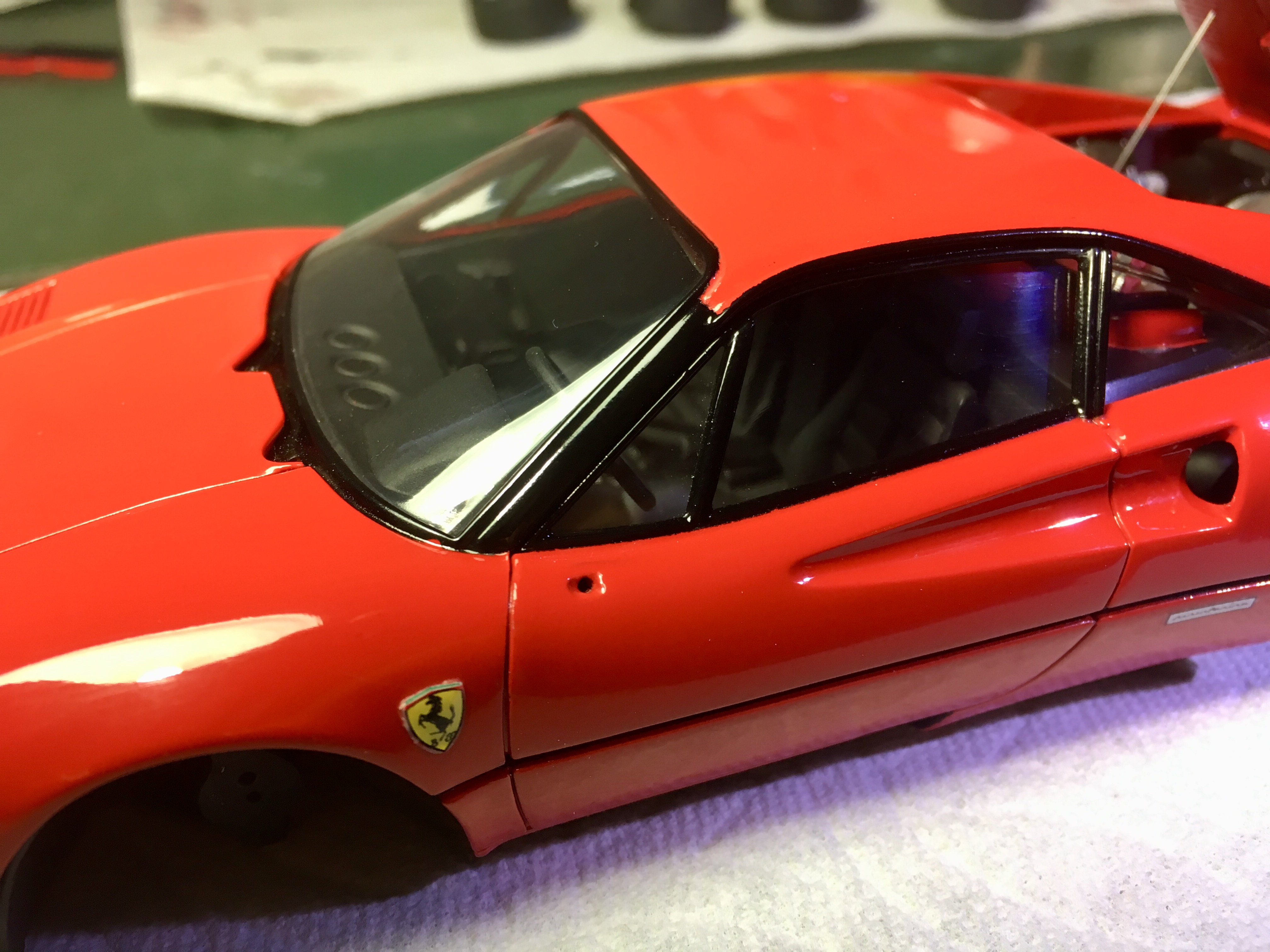

Well just about finished. Mirrors and wipers next. So fat I’m happy with the results. 88FBD7D3-9723-44EE-8A3F-E023BDEA8EF7.thumb.jpeg.62bcd8790cf809e28084a70f9eba8a9d.jpeg
Share this post
Link to post

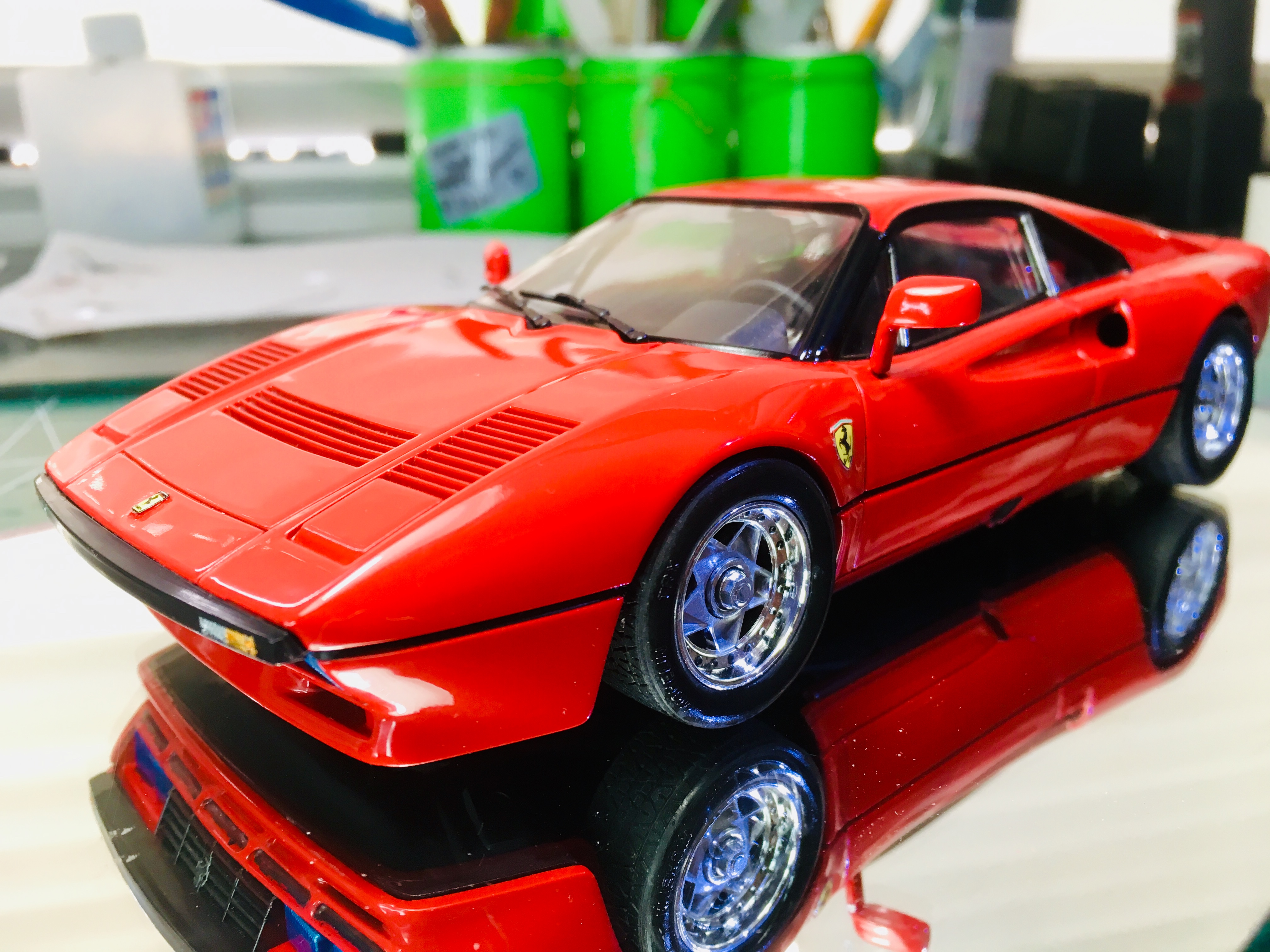

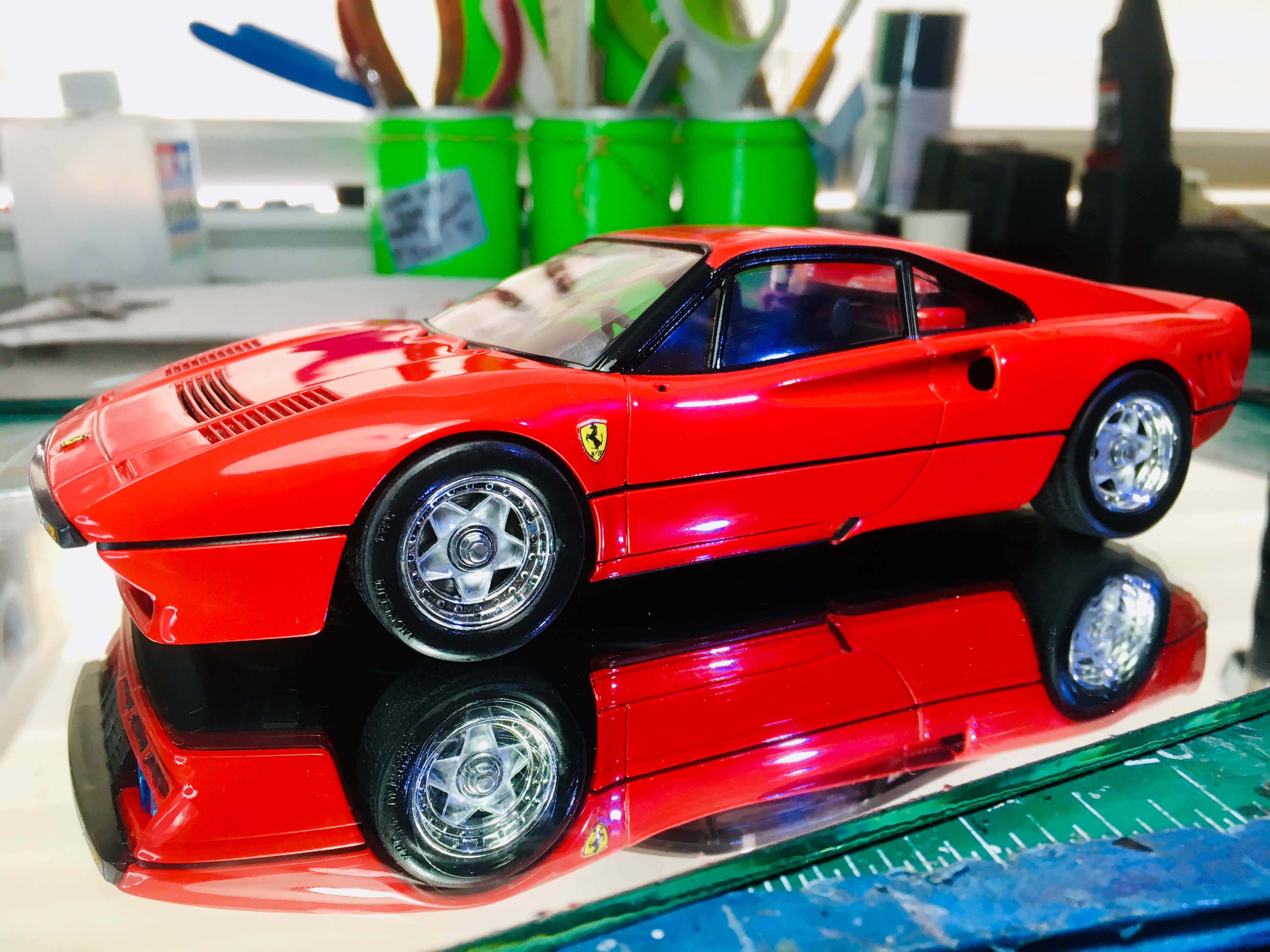

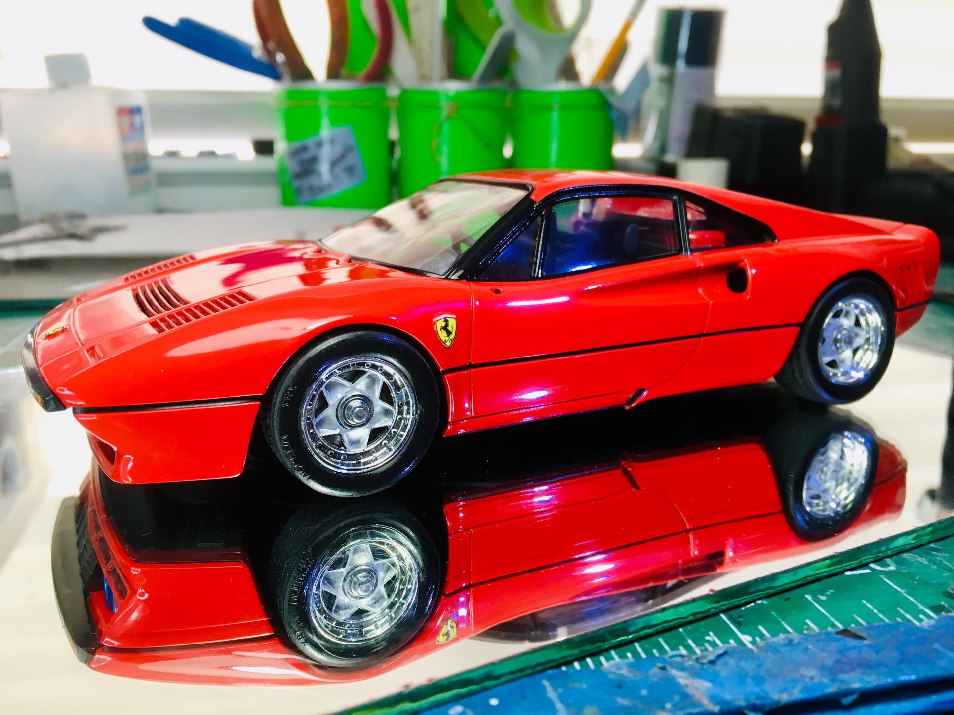

FINISHED!!! Tough kit. I’m happy with the results.
