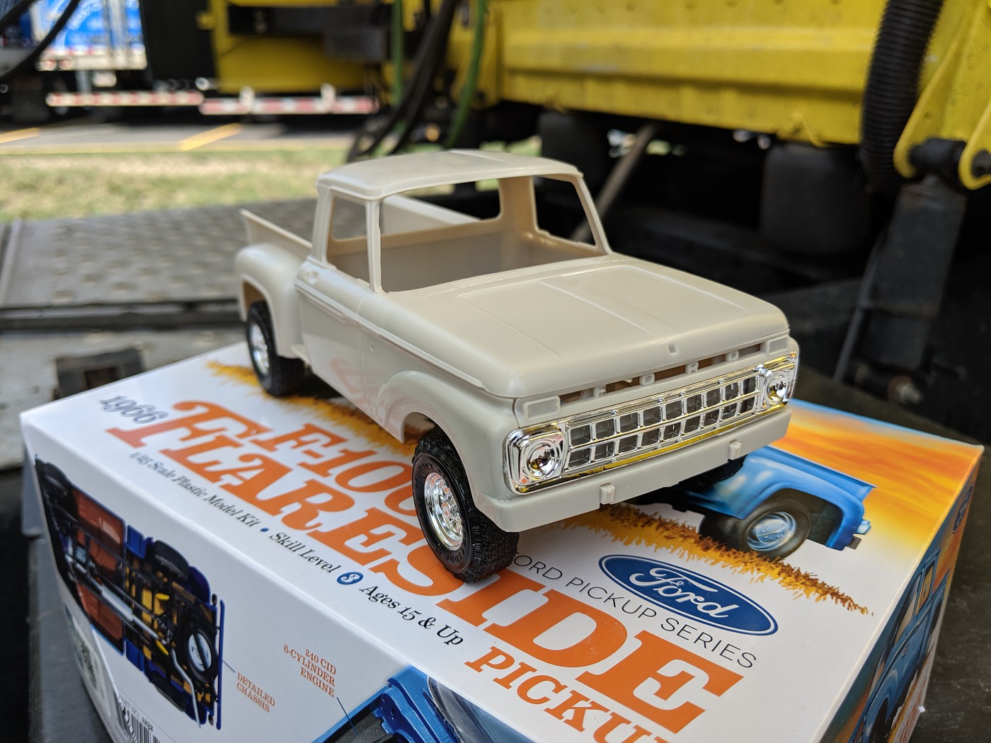

What would be a good way to convert this kit to 4wd? Saw another thread discussing it and it sounds like the 70 F100 would be a good start, but the wheels would be incorrect and there are no aftermarket options. Is there something that I could piece together from various kits?

I believe you must be referring to the '66 F 100 4x4. Yes, the 70 F 100 4x4 would be and excellent choice. The Flareside box would be the only box available at this time.  The '66 is practically the same truck as a '67-'72,  but with different sheet metal. However, the '65 F 100 4x4  has practically nothing in common with the 70 F 100 4x4 and little in common with the '66 F 100 4x4. '66 top photo, '65 bottom photo.

I was referring to the 65, but I could just make a utility bed for the 66 instead of buying 3 kits. I wanted to make a 4WD utility truck. Thanks for your help! Maybe I can cobble something together.

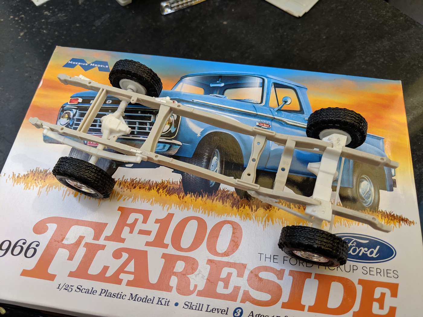

I took this photo when i got the utility bed. It is the fireball kit and a 67-72. The 65/66 cab can fit with the fireball frame as well, I just didn't get a photo. Hope this is helpful.

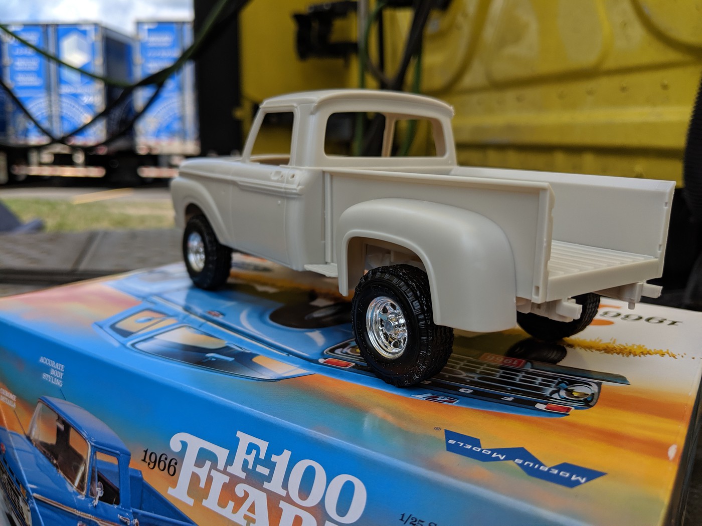

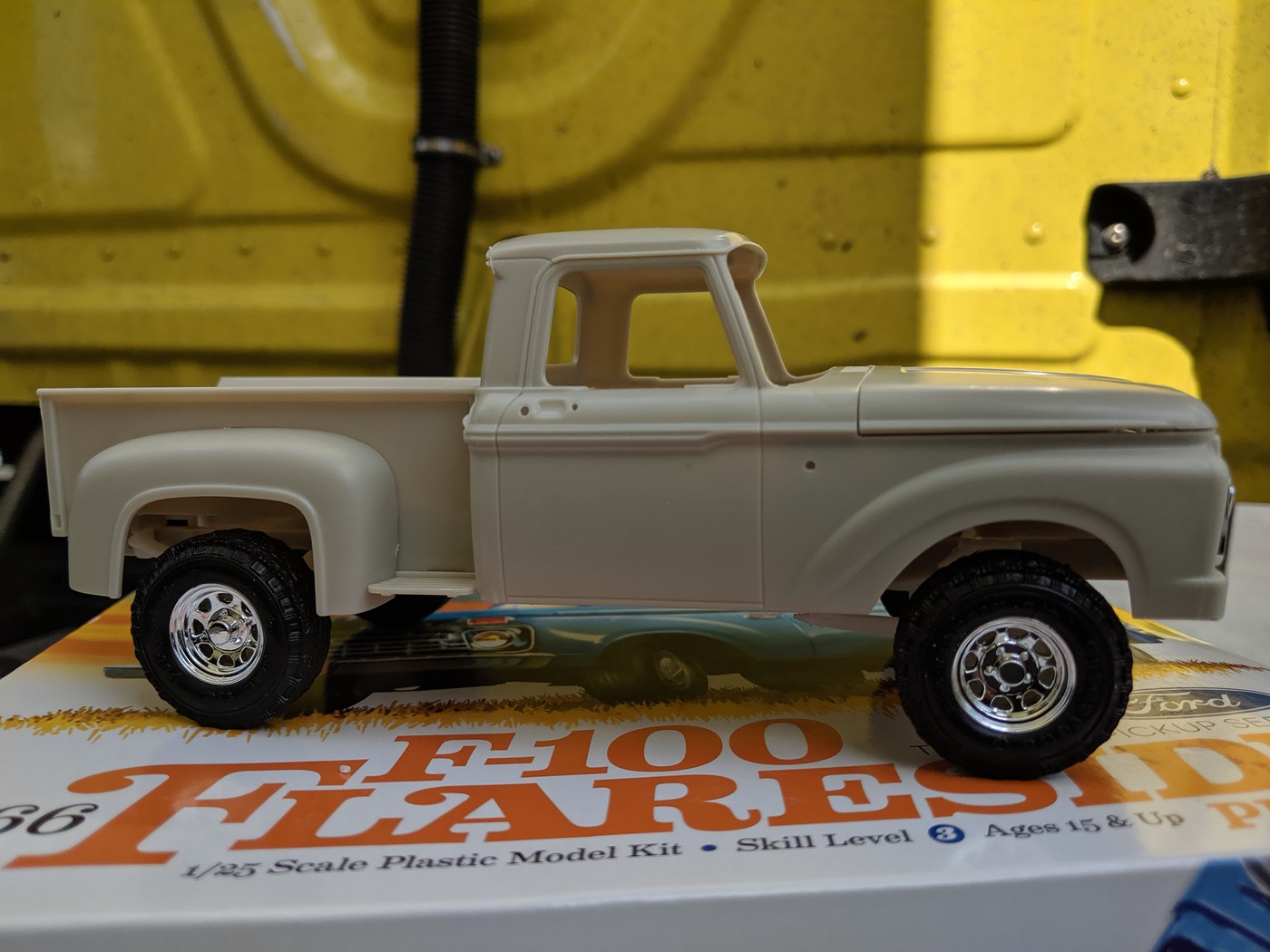

I have also, however, converted the flareside kit to 4x4 with the AMT '79 Ford 4x4 parts and everything fits great.
Worth noting is the following modifications are needed: the front crossmember needs to be thinned down to slot into place and the relief in the frame for the leaf springs needs to be filled as the 4x4 rear springs mount a little farther forward. The AMT wheel backs slot perfectly into the Moebius wheels and those wheels fit perfectly in the AMT tires!
