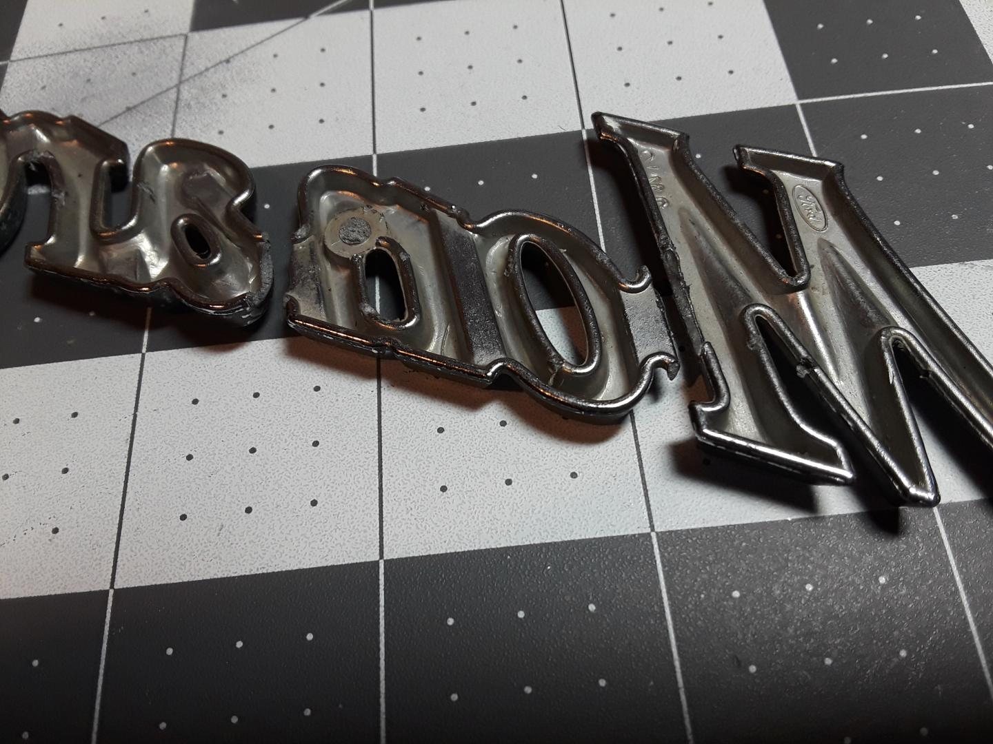

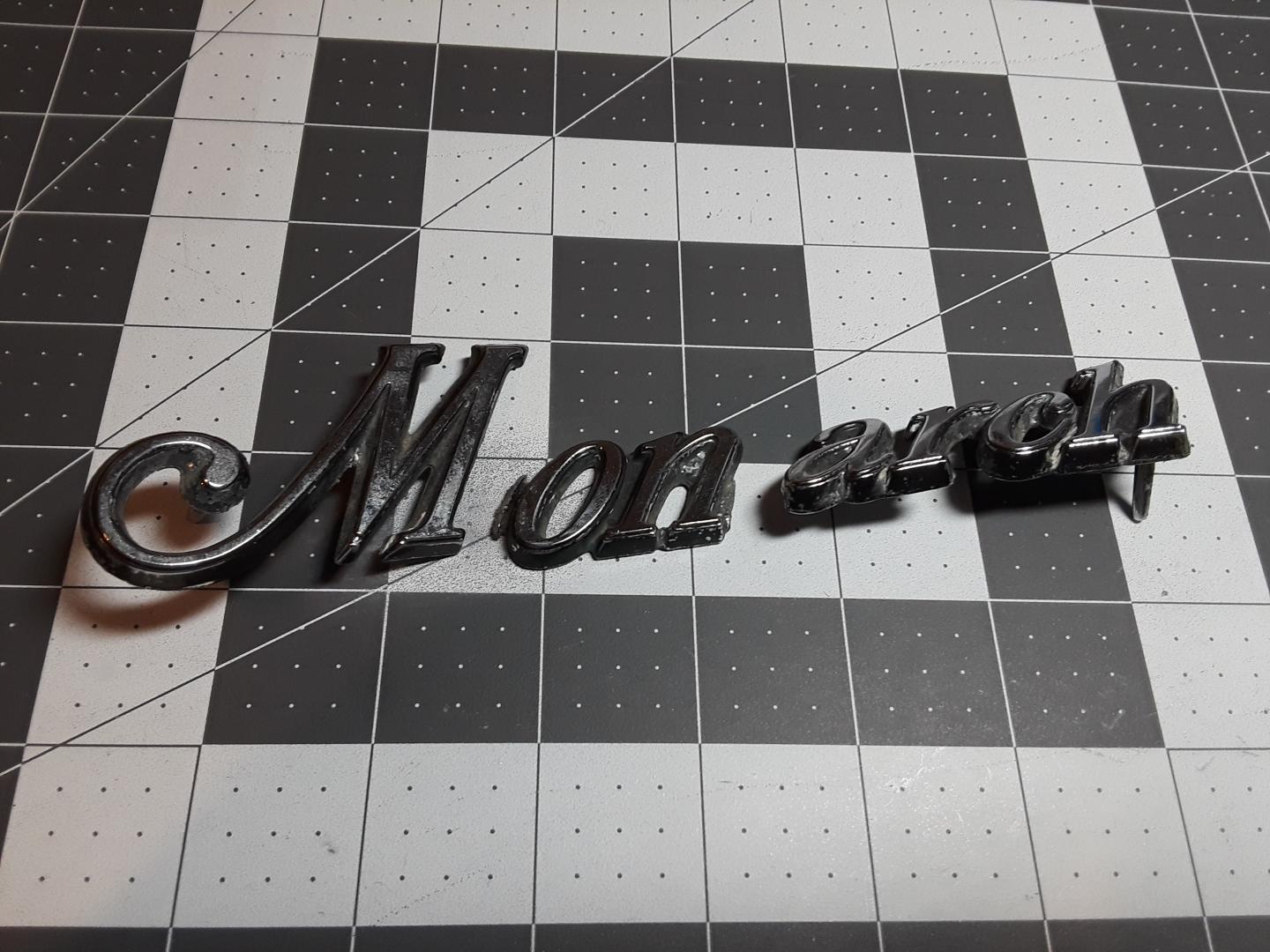

Hotrod 97 Posted July 9, 2019 Share Posted July 9, 2019 If this is in the wrong section, I apologize. I wasn't quite sure where to put it. This badge is from my Uncle's Mercury Monarch. I'd like to keep it for sentimental reasons. How would I go about gluing it back together? JB weld? Something different? Thanks in advance! Quote Link to comment Share on other sites More sharing options...
Motor City Posted July 9, 2019 Share Posted July 9, 2019 (edited) I would place it on a piece of wax paper right side up on a thick piece of sheet Styrofoam. It looks like it's die cast, so JB Weld might be the best way to repair it. Just make sure that is listed on the JB Weld tube. Apply with a rounded toothpick (much sturdier than a flat toothpick). Be careful not to slop too much adhesive on the pieces or it will be more difficult to remove it from where you don't want it. If you can, try practicing on something else first. When you are satisfied with the repair, since it looks like one or more studs is missing, you might consider mounting it on a piece of wood painted the color of your uncle's car. Good luck! By the way, I had a crimped sheet metal fitting securing the antenna to the bottom side of my El Camino's fender. I couldn't believe something so crappy was used. I wasn't sure how to fix it, so I used JB Weld and it is fine today. It has never vibrated loose. Edited July 10, 2019 by Motor City addendum Quote Link to comment Share on other sites More sharing options...
SfanGoch Posted July 10, 2019 Share Posted July 10, 2019 Following Jim's directions to secure the parts, Lab Metal would work to repair it. I find it better than JB Weld. Quote Link to comment Share on other sites More sharing options...
my80malibu Posted July 10, 2019 Share Posted July 10, 2019 (edited) I think I would use some 30 minute clear epoxy to carefully stick it together. Then add some wire in the back section, and fill that in with Epoxy to have it solid. My Cousin owned a Mercury Monarch in about 1978, it was the same Body as the Granada. his had Manual shift 4 speed OD from the Factory, Very Odd. Edited July 10, 2019 by my80malibu Quote Link to comment Share on other sites More sharing options...
Hotrod 97 Posted July 10, 2019 Author Share Posted July 10, 2019 Thank you all for the replies! I think I’ll go with JB weld since it’s the only thing mentioned that I have right now. 48 minutes ago, my80malibu said: My Cousin owned a Mercury Monarch in about 1978, it was the same Body as the Granada. his had Manual shift 4 speed OD from the Factory, Very Odd. That is a rather unique sounding setup. Quote Link to comment Share on other sites More sharing options...

gtx6970 Posted July 11, 2019 Share Posted July 11, 2019 I would use JB weld or maybe a good 2 part epoxy. But no matter what I used I would completely fill the backside to give it strength Quote Link to comment Share on other sites More sharing options...
Jantrix Posted July 12, 2019 Share Posted July 12, 2019 14 hours ago, gtx6970 said: I would use JB weld or maybe a good 2 part epoxy. But no matter what I used I would completely fill the backside to give it strength Yep. What he said. Quote Link to comment Share on other sites More sharing options...
