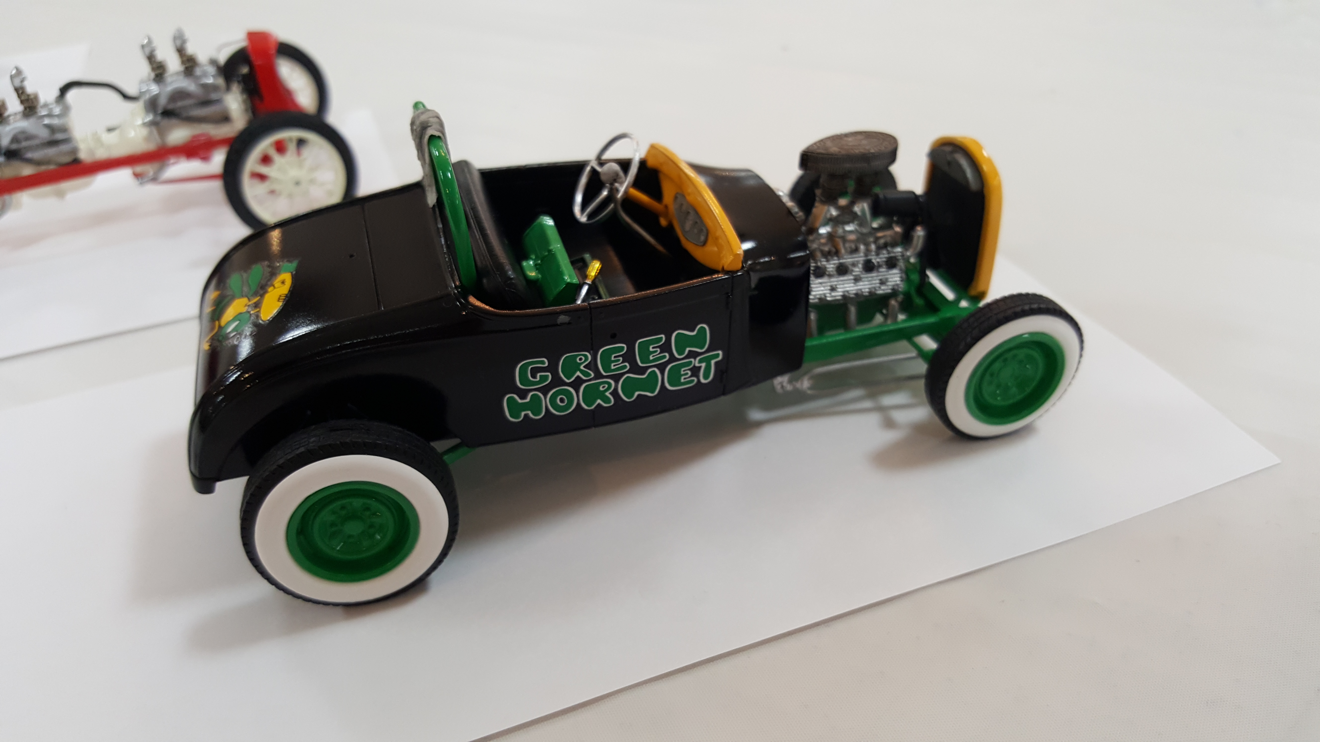

the AMT '29 Roadster is a great kit for post war Lakesters and TROG style racers...heres my latest version...Z'ed and channeled with a '48 flathead topped with resin Eddie Meyer speed parts from Replicas and Miniatures of Maryland.
Edited by styromaniac

Man that looks like a good kit, better than the box art, may have to look for that in my travels.  Have fun with it.

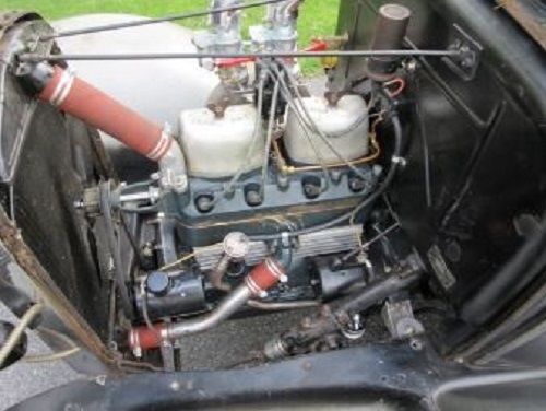

I see all of them fine. I love what your doing with this build. I would toss the old stock distributor & get a newer style, it would sit a little lower and be used on an engine with all those speed parts. Keep going I can't wait to see more.
1930-model-a-ford-coupe-riley-overhead-valve-banger-4-cylinder-engine-good-title-9.jpg

That engine photo is an excellent choice for a vintage power plant for your project with lots of visible details and colors to be used for the various parts as well. your parts choices up to this point are excellent and period appropriate. Thanks for sharing.I'll be watching.
This pic is GREAT!  Thanks for posting Mark!  What a great reference pic!
Advice on the distributor much appreciated (I'm learning a lot about these old Model As, but I definitely need pointers like this), so I scratched up a replacement for the kit part - still need to spend a few minutes making a coil but is roughly how it'll look:

Got the engine painted, having ground off that lower hose that runs to the rad and scratchbuilt another.  I made some rubber hose end-pieces and used the smallest diameter solder I could find to make some hose clamps (see Mchook's pic of a 1:1 above to see roughly what I was aiming for...)
