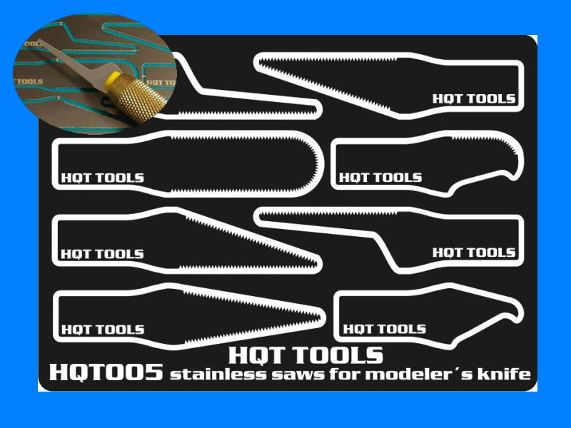

If the front and rear glass is connected by runners, you can use flexible stainless scribers and/or saws to remove the whole thing at once. Using the scriber or saw blades, score underneath the runners parallel to the roof. You should be able to cut through far enough to stick a flat chisel blade under the runners and pop the glass off. If the glass is glued to the front/rear frames, use the pointed scriber blade and gently score between the glass and frames, maintaining the blade in as much a parallel angle relative to the glass ass possible. The PE blades are extremely thin and flexible; so, don't worry about breaking them. After a few passes, the glass can be popped out with little or no damage to the window trim.

I have been looking for a curved-edge razor saw like this for YEARS. I just ordered three sets of these. Will let you know how they work. If they do what I want, they will be My New Favorite Modeling Tool.

I already know how they work. I've been using these for years.  :) The saws and scriber blades are going to be your favorite tools. Using the saw blades to remove delicate parts from the sprue is much better than using sprue cutters.

The curved-edge saw seems like such an obvious idea I'm surprised that there haven't been MANY of them on the market for years. I tried to make one some time back by grinding teeth on the edge of a scalpel-type blade with a Dremel cutoff wheel. It kinda sorta worked.

Rich, the saw blade and scriber tips' kerf is only .30 mm. That is a super thin cut/scribe line. If anyone is interested in the saws/scribers, you can get them from UMM-USA. John Vojtech is a great guy to do business with; and he carries a lot of useful tools and supplies.

On the positive side, the saw blade did exactly what I needed to do. I needed something to slip between the windshield and the cowl and separate the two. Both were too fragile to risk any more prying than I'd already tried, and an Xacto blade just wasn't gettin' it done. The thin saw blade solved the problem in about 20 minutes!
