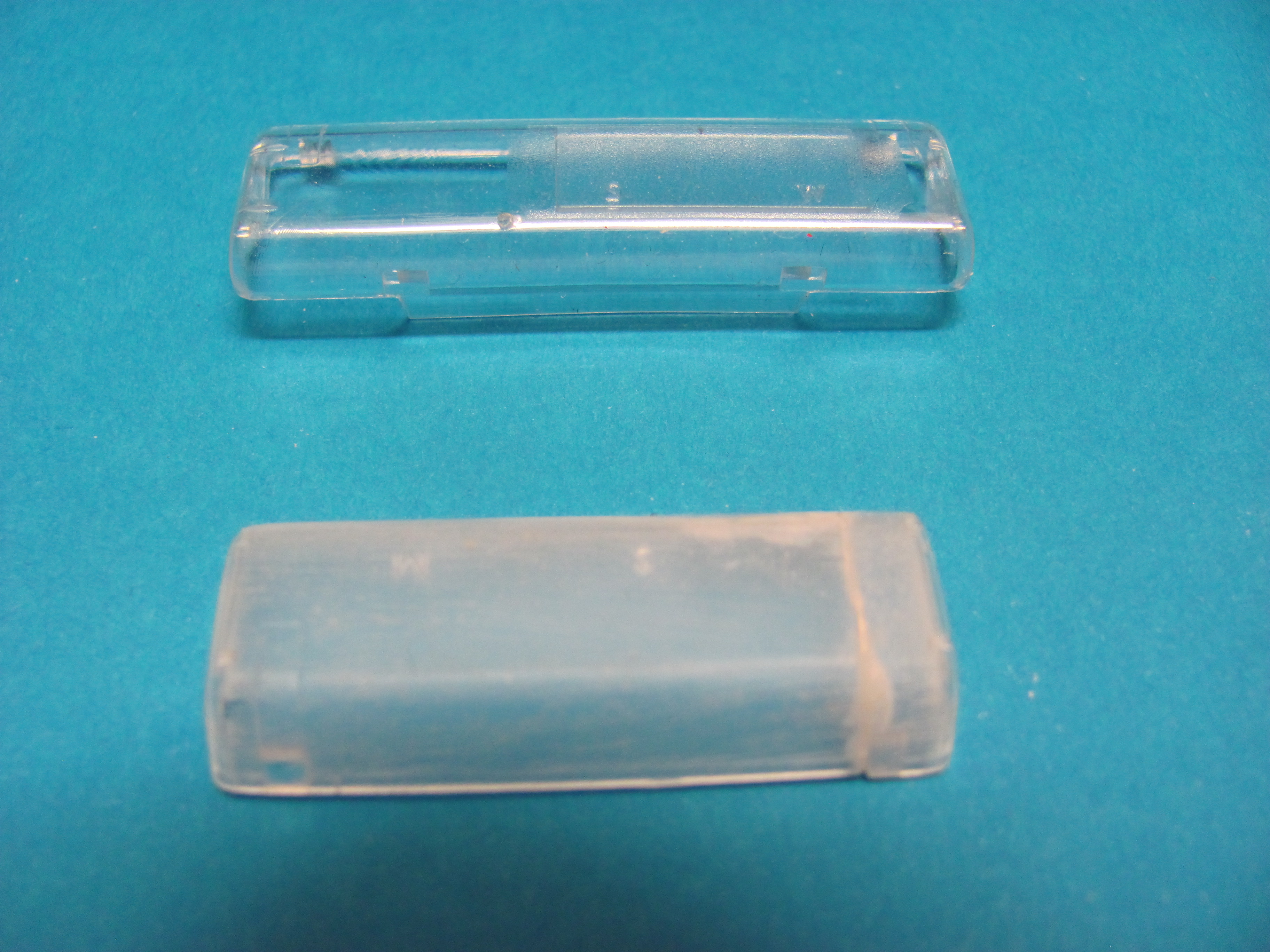

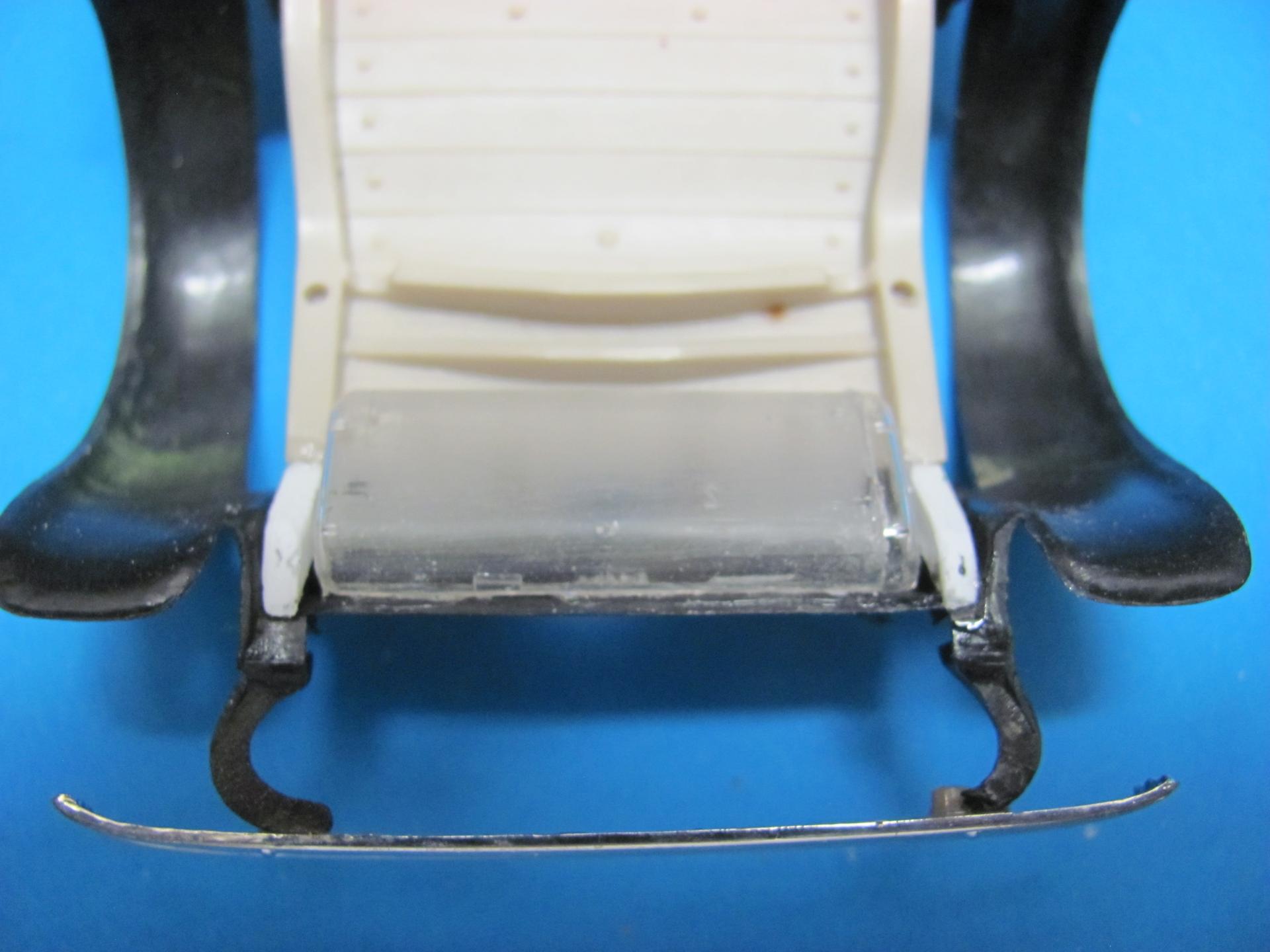

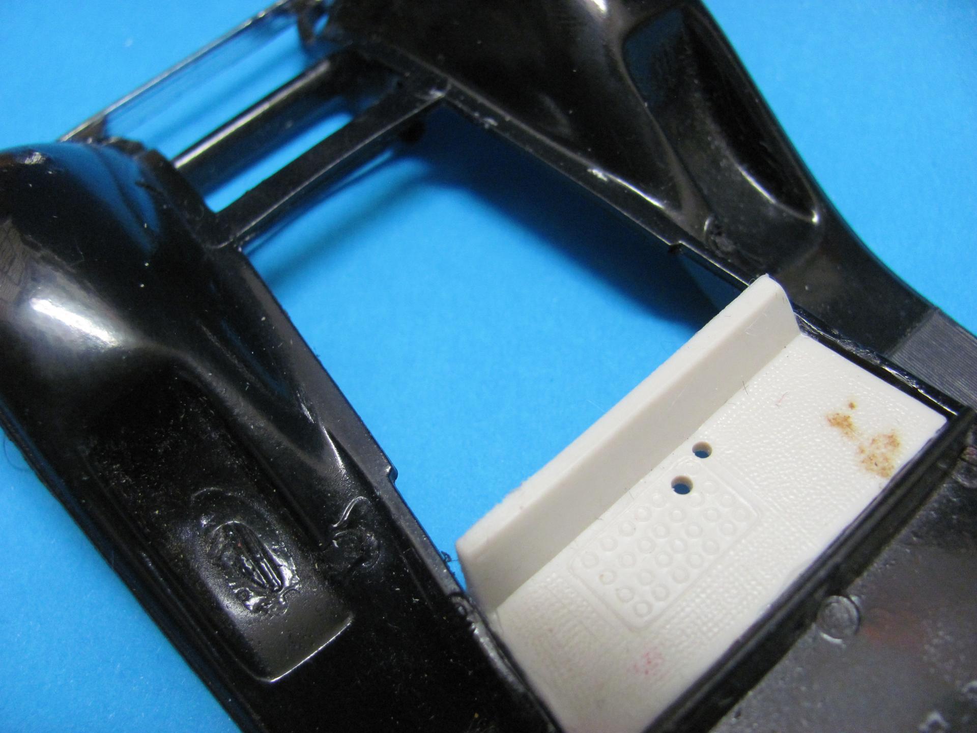

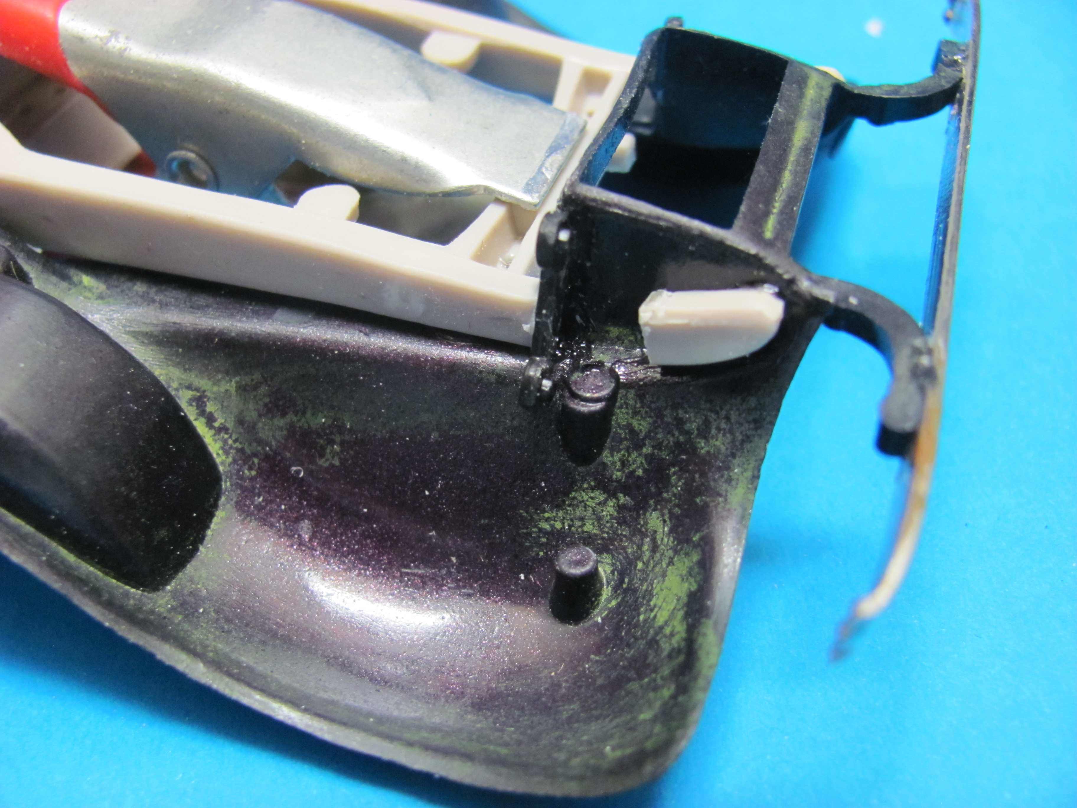

As you can see, the fender unit wasn't in mint condition but I managed to clean it up fairly well. As you probably know, the first series of AMT Deuces had no fuel tank at all and the second series ( Vicky and Phaeton) had something that looked like bean bag furniture!  Anyhow, many years ago I was shaving one morning when I realised that my Wilkinson Sword disposable razors had a cover that looked remarkably similar to a Deuce fuel tank so after buying another bag of them on my next shopping trip I was assured of never running out!

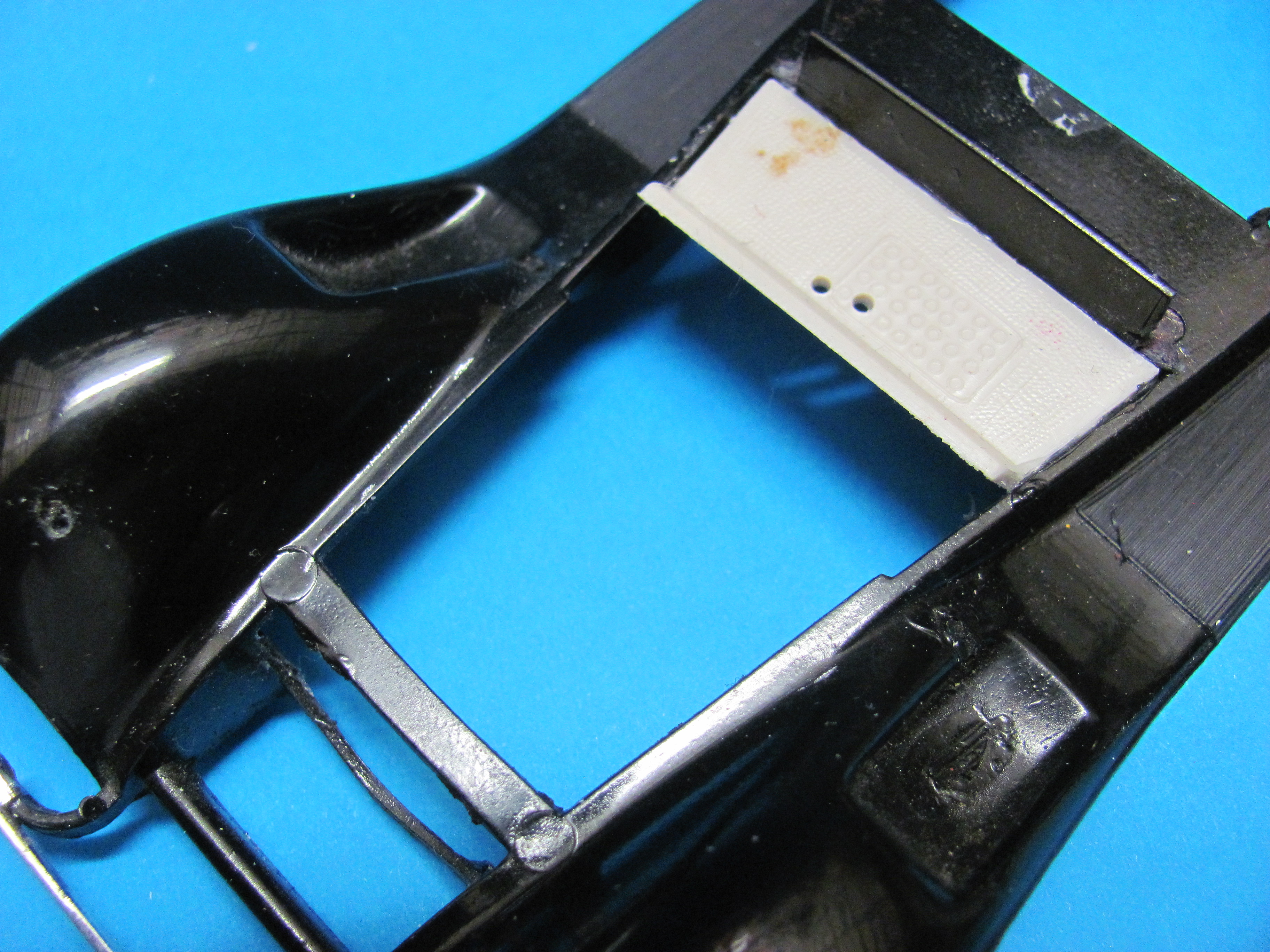

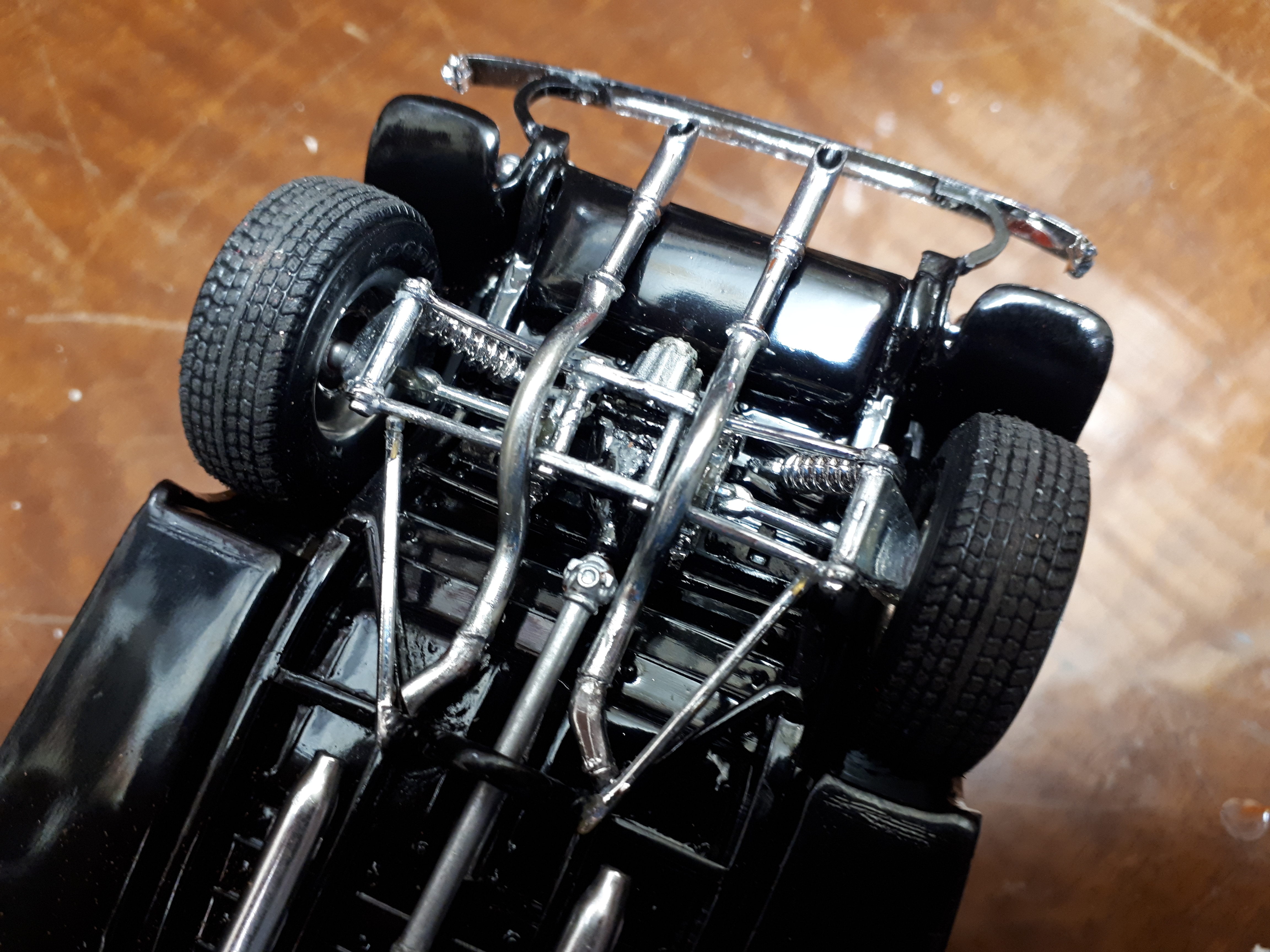

You could just stick the razor cover straight on but it is more accurate to shorten it about 3mm.  Being clear styrene it is quite easy to fix.  I also extended the frame horns to make the rear of the frame look more convincing.  I then began construction of a reasonably modern style centre crossmember to stiffen the frame to keep the independent underpinnings working as they should.
I used Evergreen styrene channel to accomplish this modification. I first removed the centre of the AMT crossmember but kept the front legs as a foundation. The photos also show where I relieved a big chunk out of the transverse rear crossmember in preparation for fitting the Buttera Jag crossmember. And it hasn't been done yet in these photos but if you want to get reasonable sized rubber under the back of the AMT kits you need to hog out most of the rear wheel inner fender panels. I see Misha had clearance issues on his stunning red tub but I had fortunately already crossed this bridge on my black Tudor from last year.

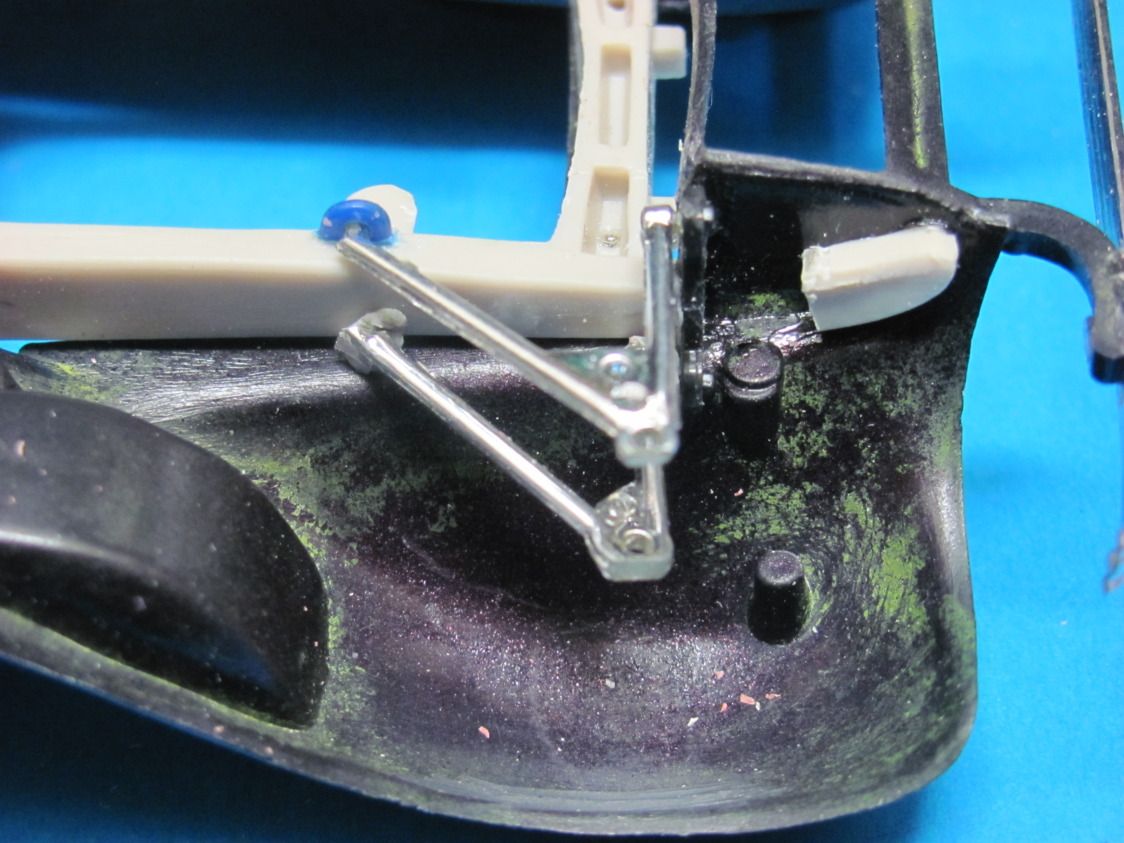

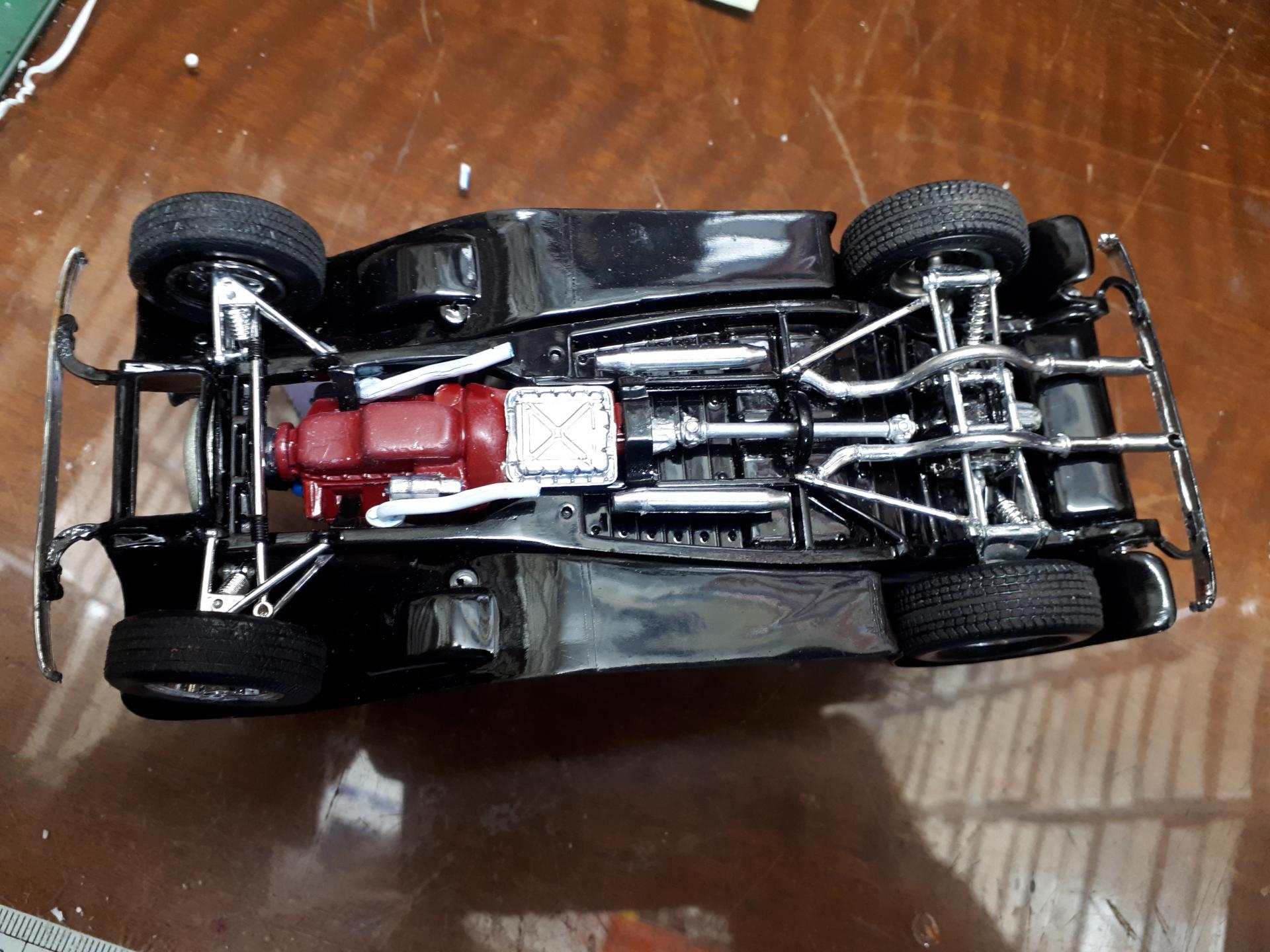

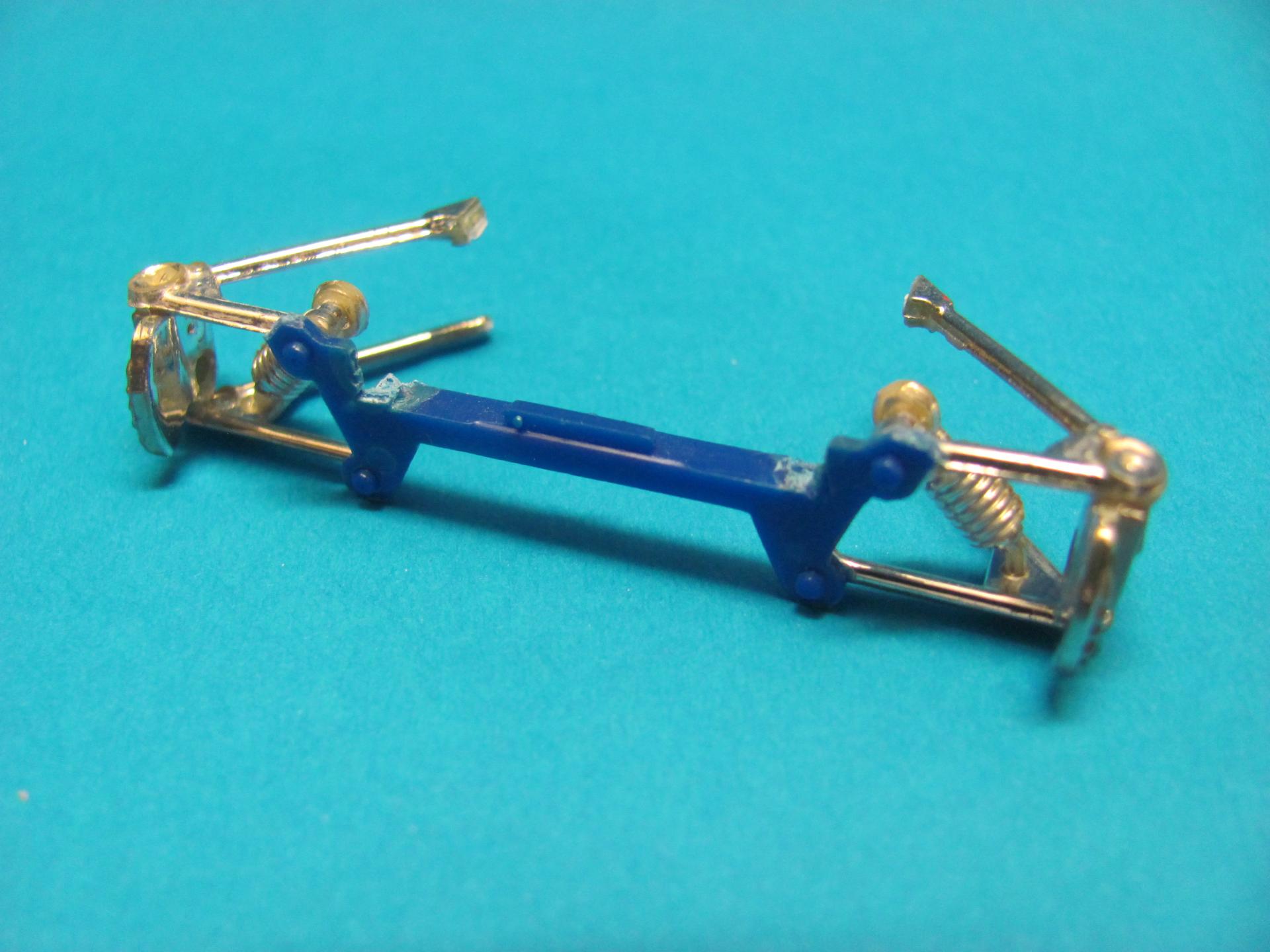

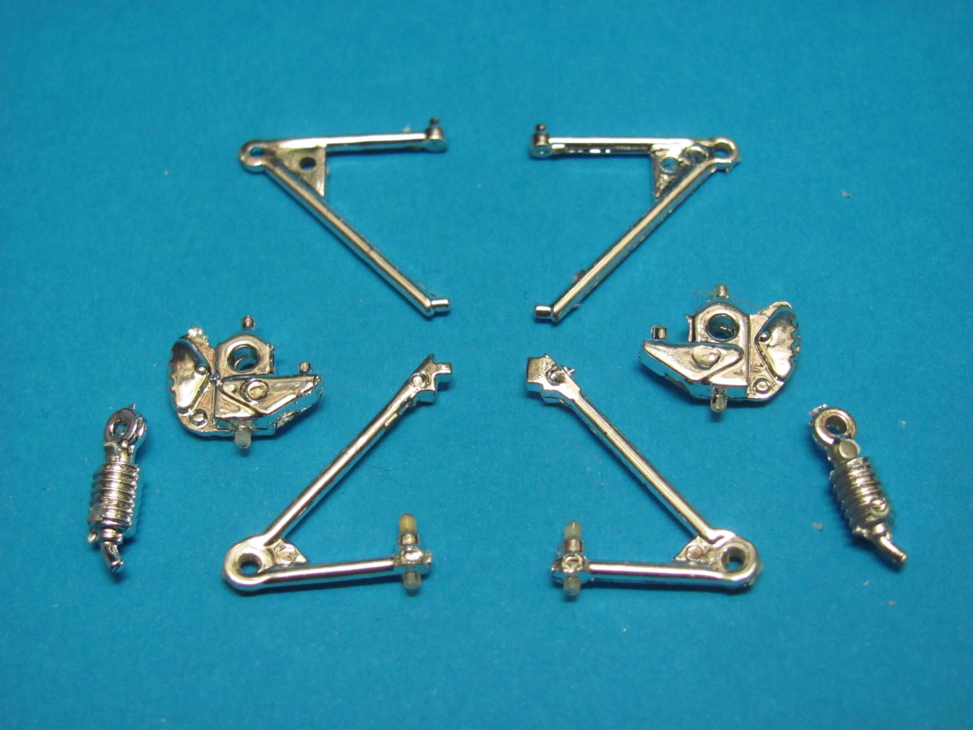

If the rear end install wasn't hard enough, the front end was a nightmare.  You need at least seven hands to balance all the bits to try and establish the very critical front wheel positioning.   I decided the only way I could be assured of getting this to happen was to glue the frame to the fender unit at this stage.  The car was always going to be two toned black and silver so this worked out as reliable way of keeping everything where it belonged.  I cut the too-short front frame horns off and then fabricated some new ones to match the fenders.  This left a gap that eased the pain of installing bits of the Buttera front end mounts.
I dug a gluebombed assembled front end from the parts box and this definitely aided with front end setup. When everything was locked in place I went back and filled in the gap in the frame horn that you see here.
Link to comment
This was easily the most complex suspension install I have ever tackled but I am glad I persevered as it it the right style for the era.  I did end up with one slightly wonky wheel that I am going to have to go back and manipulate.  Surprisingly the setup off the Model T was the right width to keep the tyres well under the crown of the fenders.  You can also see in these undercarriage shots that I used a small block from a Monogram 37 Tudor as well as the exhausts, albeit extensively modified!
You can also see that the early fender units don't have running board braces moulded in but I figured anything I glued on to imitate them would interrupt the flow of the running boards when viewed from alongside so I chose to ignore them.

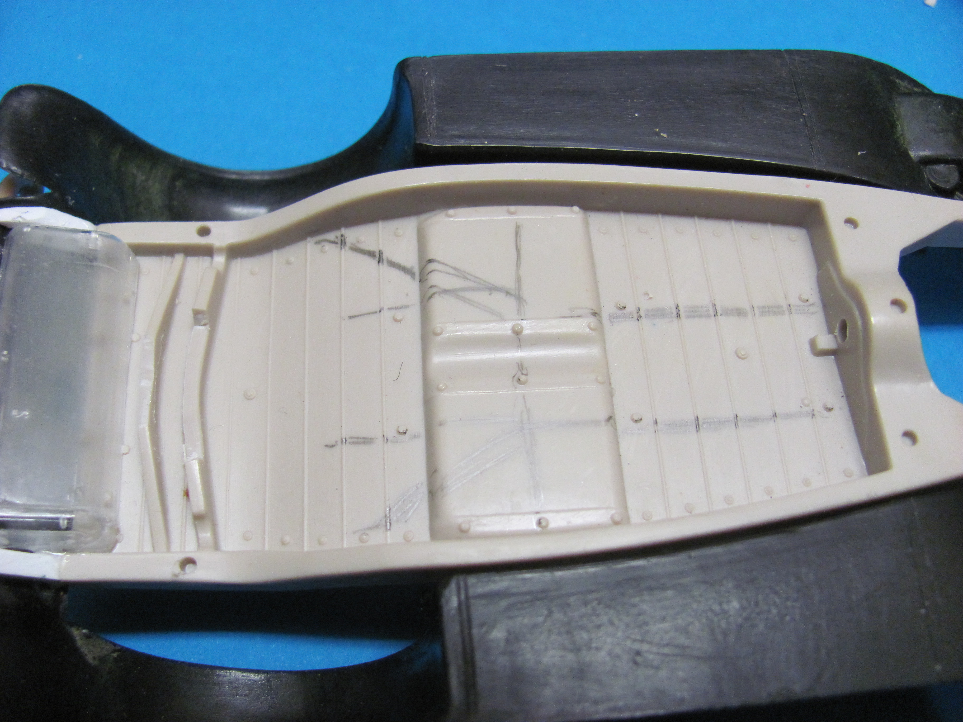

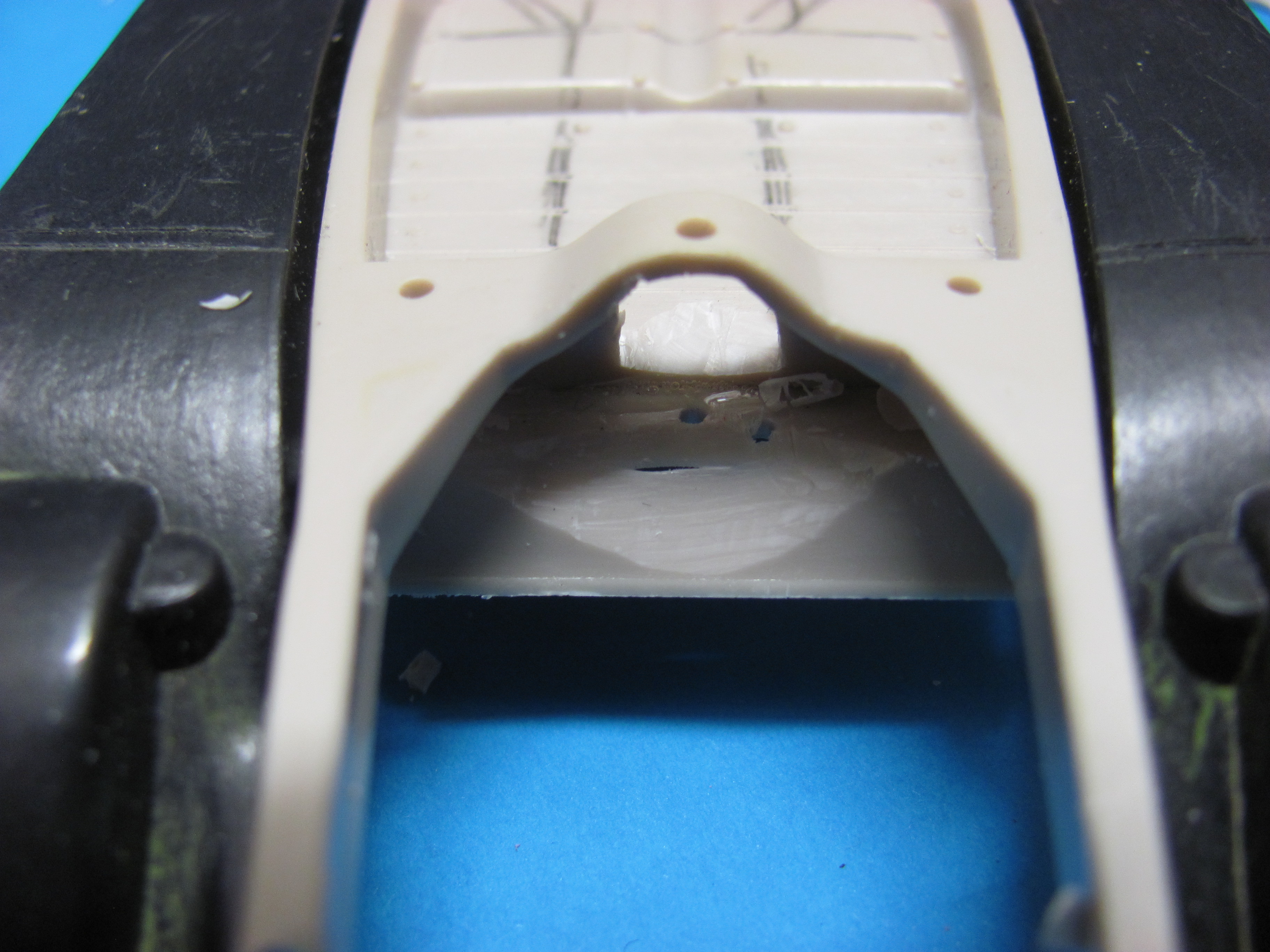

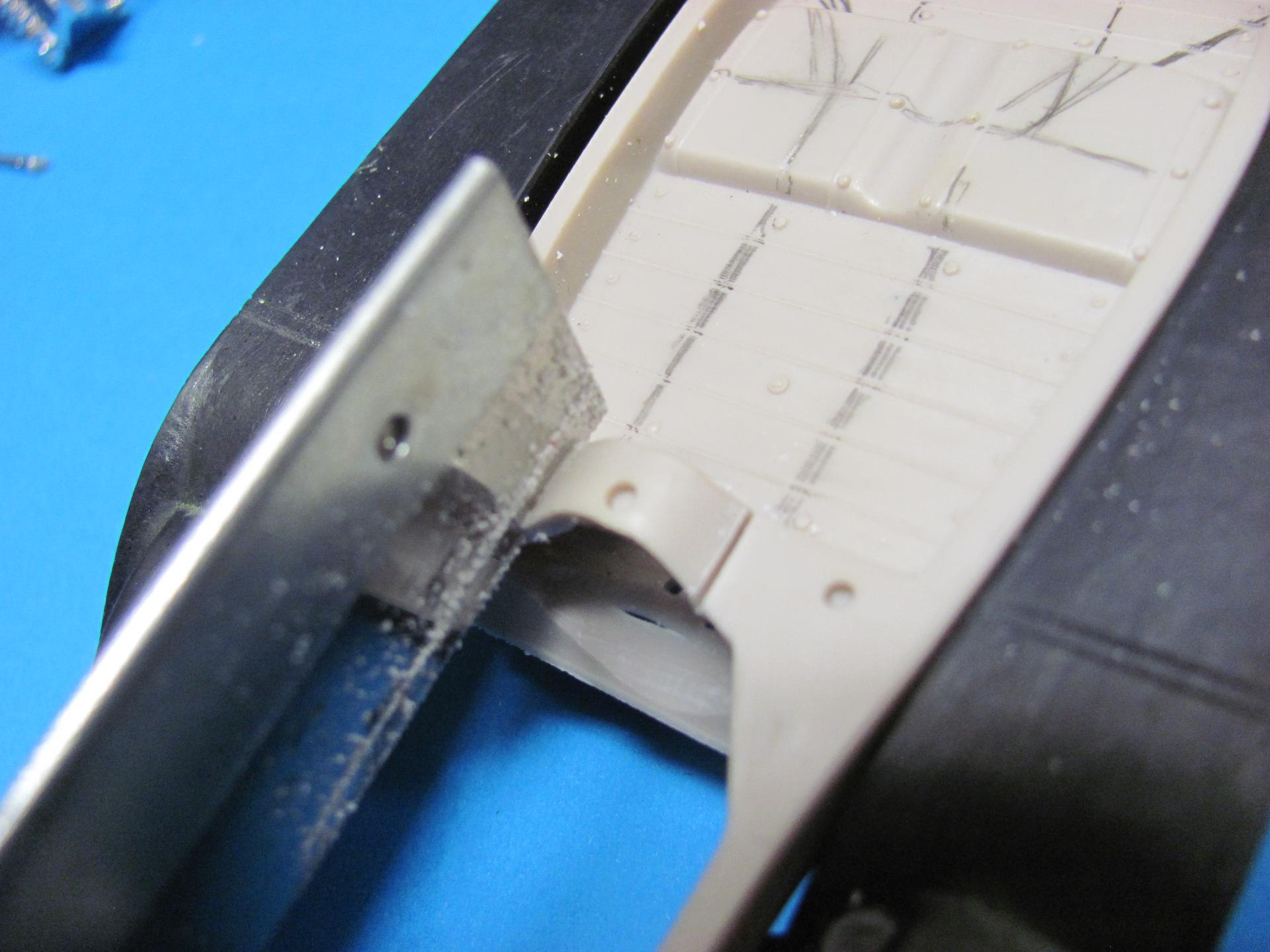

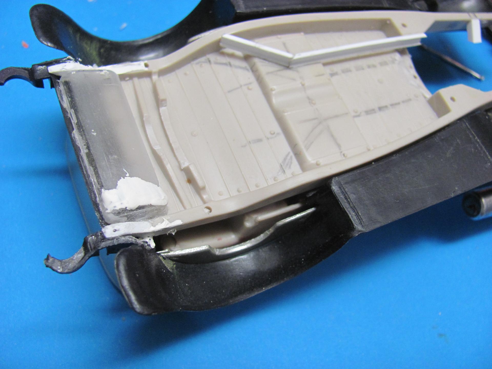

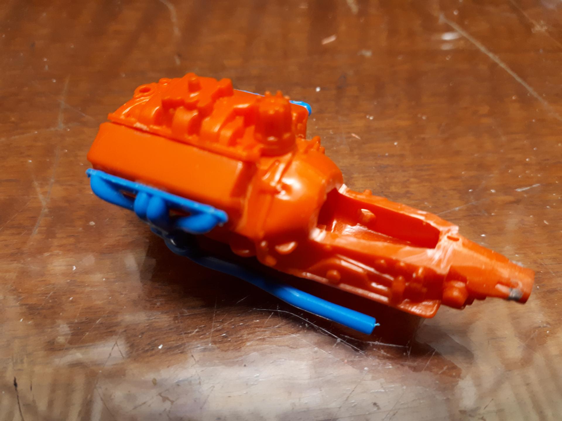

Just going backwards a bit here, you can see how I got the somewhat largish Monogram engine to fit.After gluing the floorboard in place I hogged out as much as I could for transmission clearance but it wasn't enough.  This car had already suffered from overcomplicationitis for way too long so I took the down and dirty way out and filed off the top of the transmission until it fitted.  Yeah, I know, I should have fabbed up a floor hump but I always intended to have the roof glued onto this one  so I didn't bother.  I also had to do some massaging on the block hugger headers from the 37 kit as the AMT frame was very tight in that region.

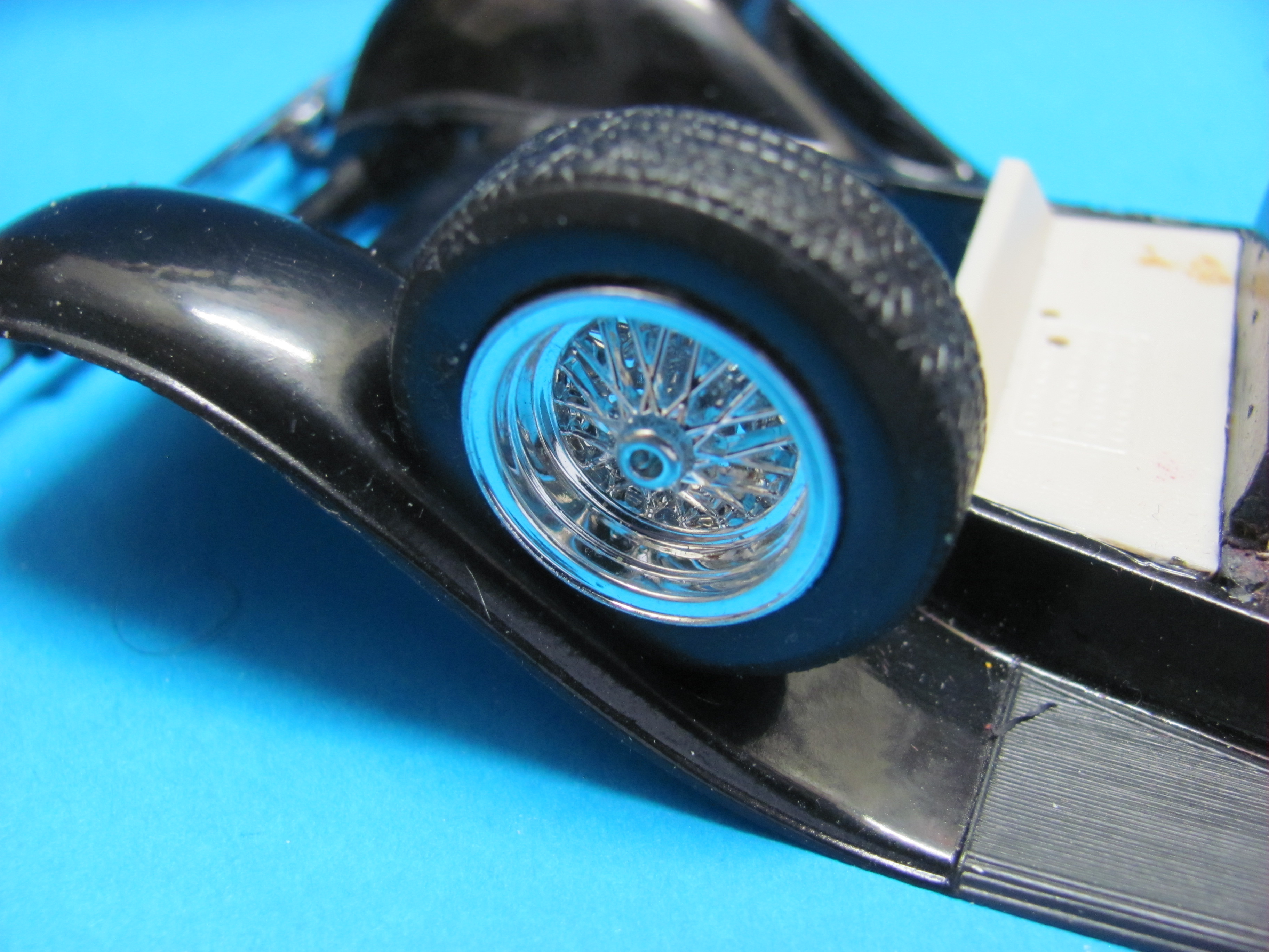

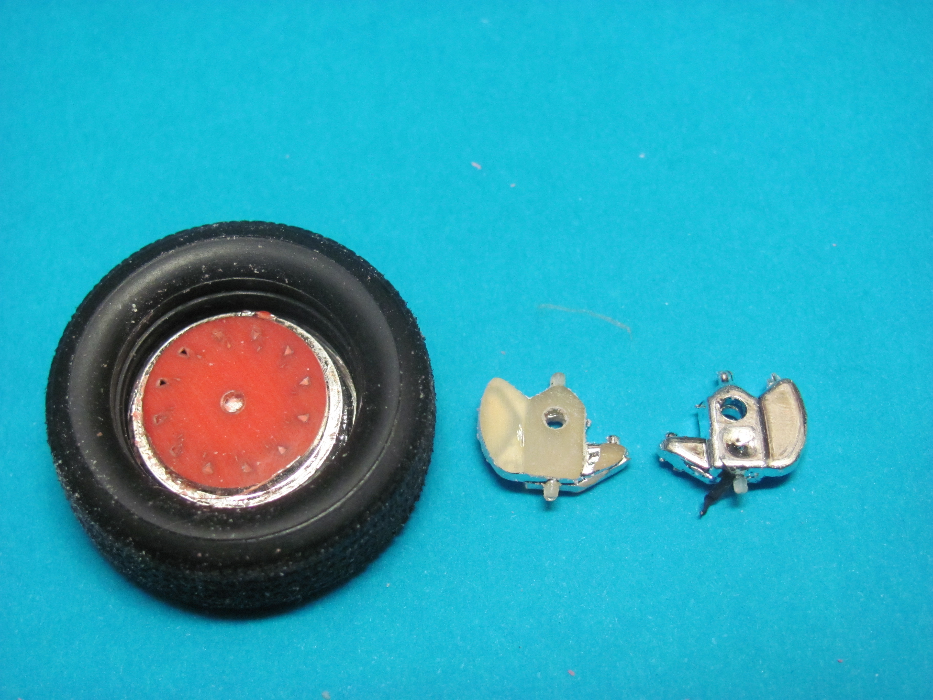

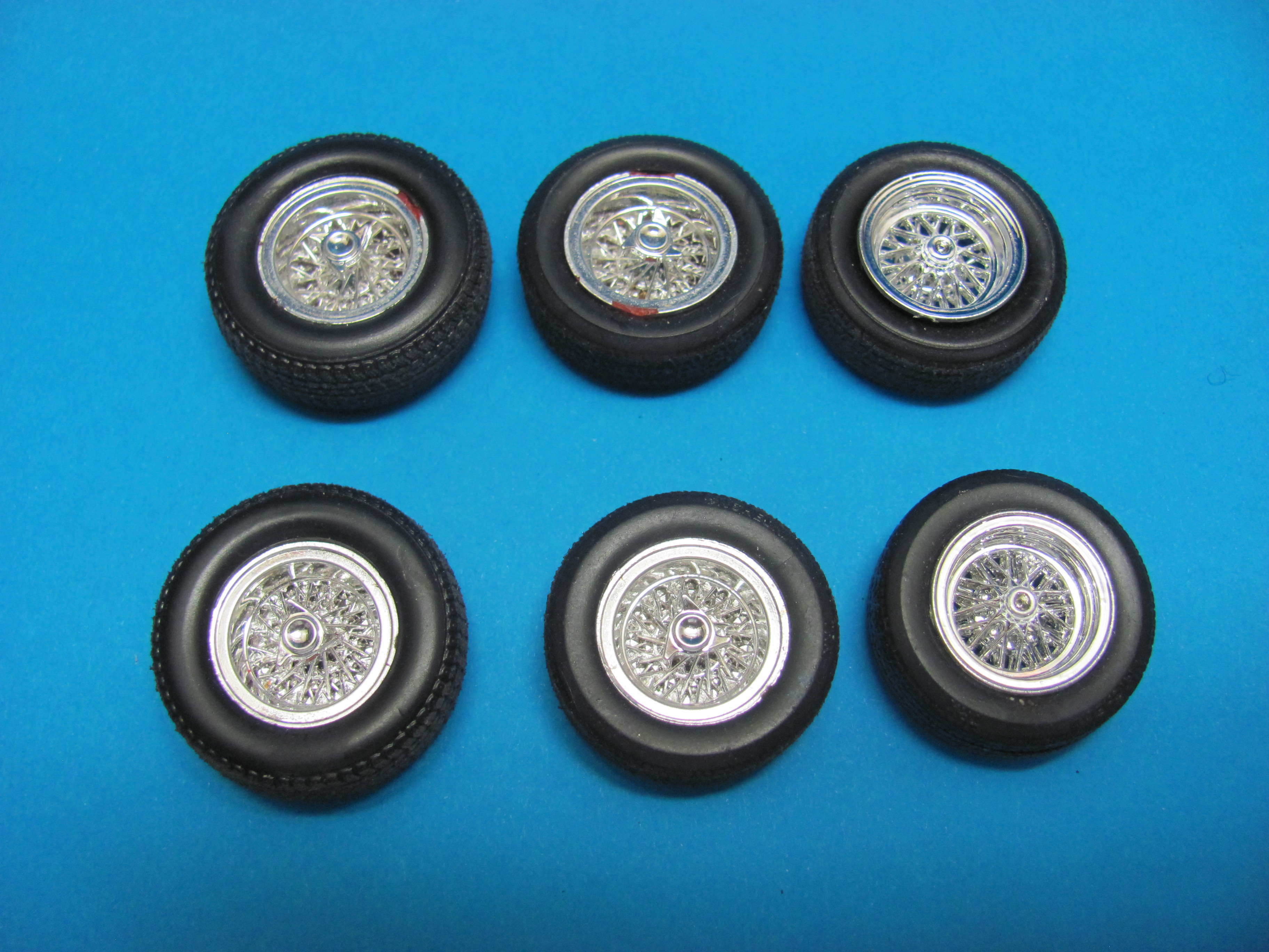

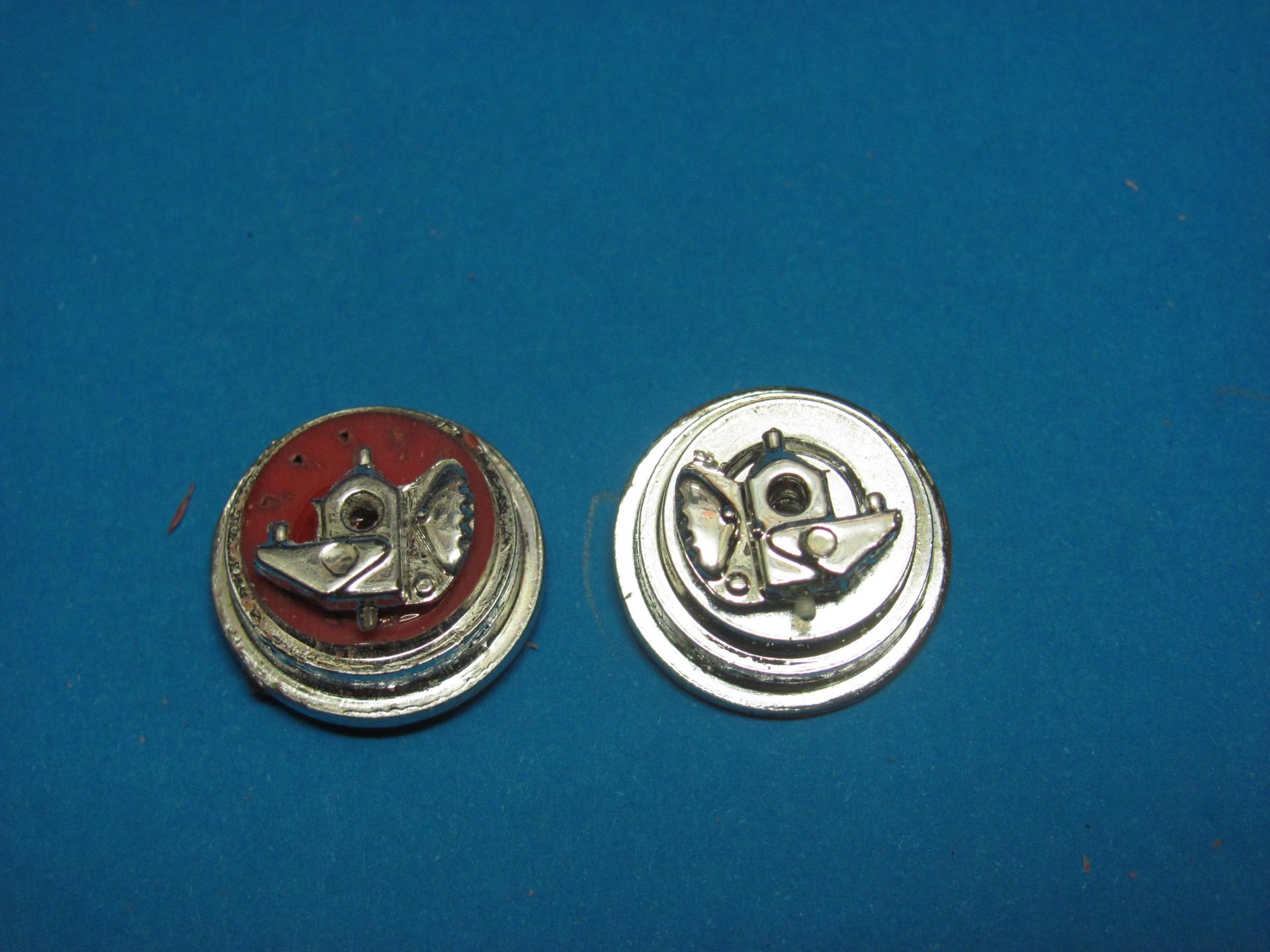

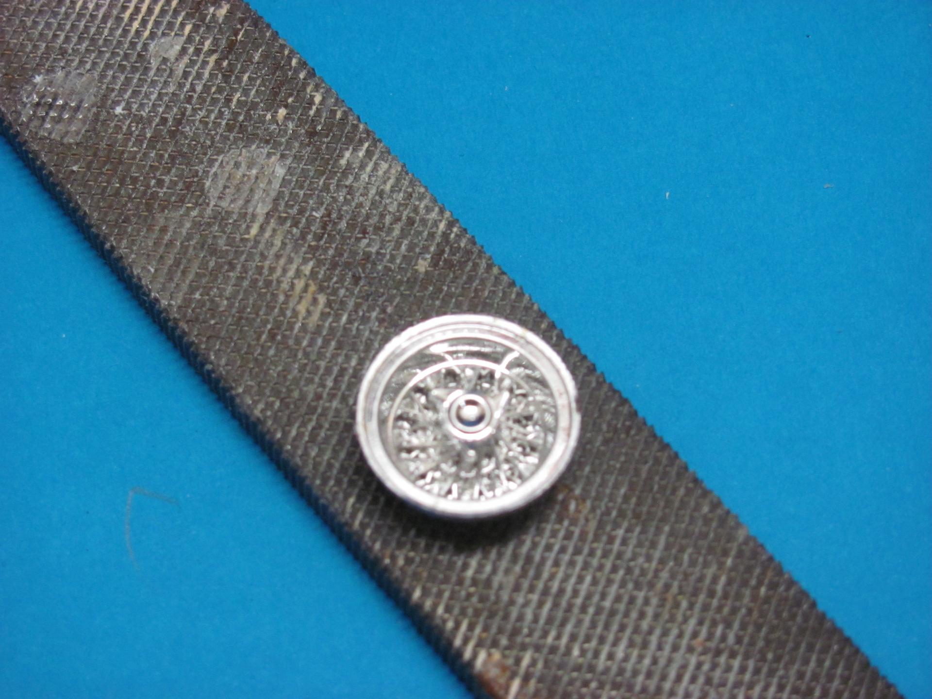

Back in the seventies, a resto rod just had to run a set of chromed wires.  This is the set I came up with to suit the phaeton.  The deep and deeper Borrani style wires came from a Monogram Street Stalker Camaro.  I picked this kit up many years ago at a clearance sale and I reckon it just might be the best parts kit I ever bought!  The front clip went onto a forty frame, as did the leaf spring rear end.  The nicely detailed SBC went into another forty coupe, which also got a very sliced and diced version of the Camaro interior.  The nose and hood went onto a dirt track late model and I cant really remember where the back half of the body and floor ended up but they are about the only parts I didn't use!
Unfortunately the wheels suffered some rim damage from my youthful exuberance decades ago but a bit of Molotow pen did a reasonable job of hiding that.  The wires for the spares came from the yellow version of the the Monogram 32 roadster.  It was the only way I could get a reasonable looking wire that would fit in those wells.
As you can see, I had to take a file to the back of the front Borranis as well as the spindles to try to get everything tucked under the front fenders.

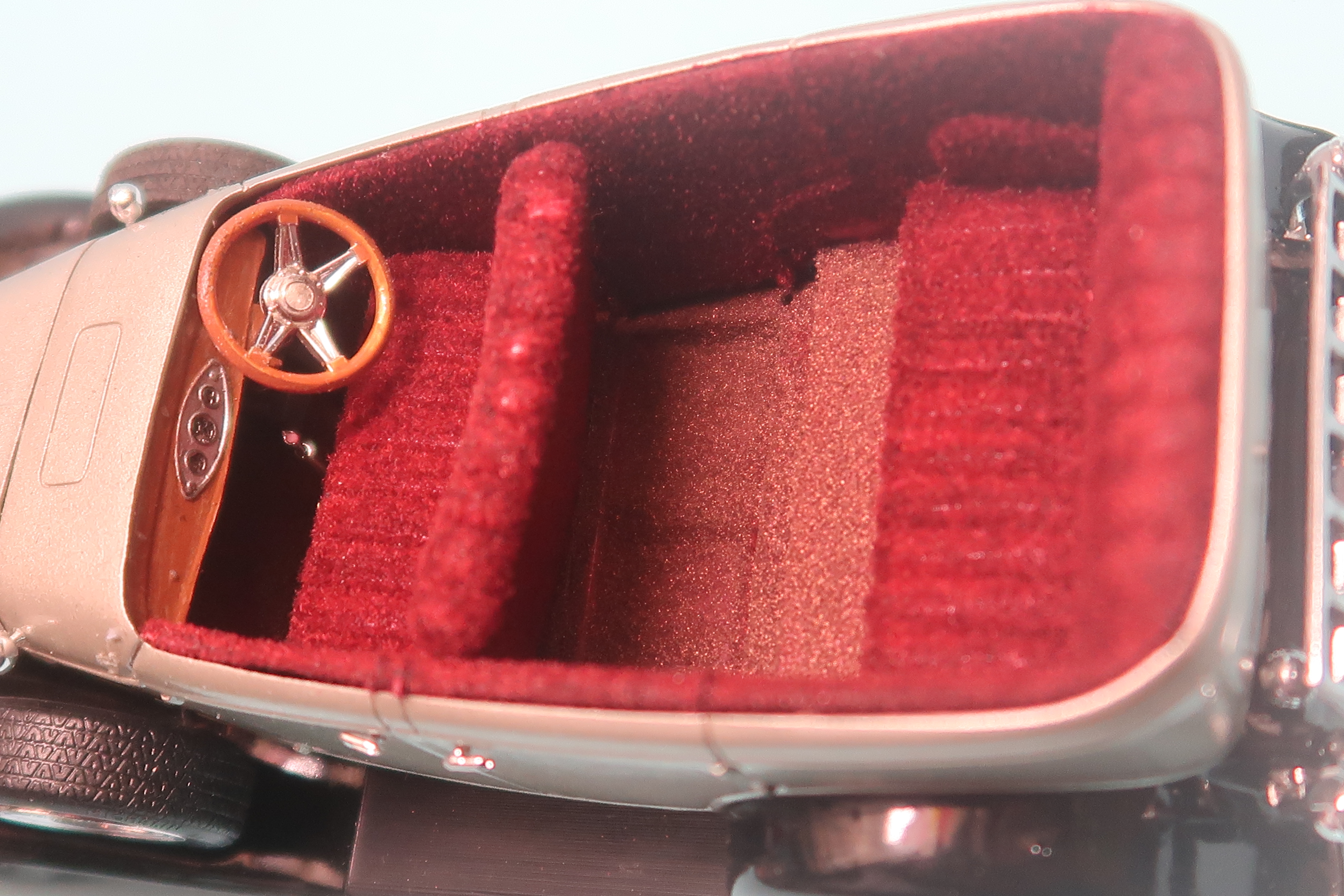

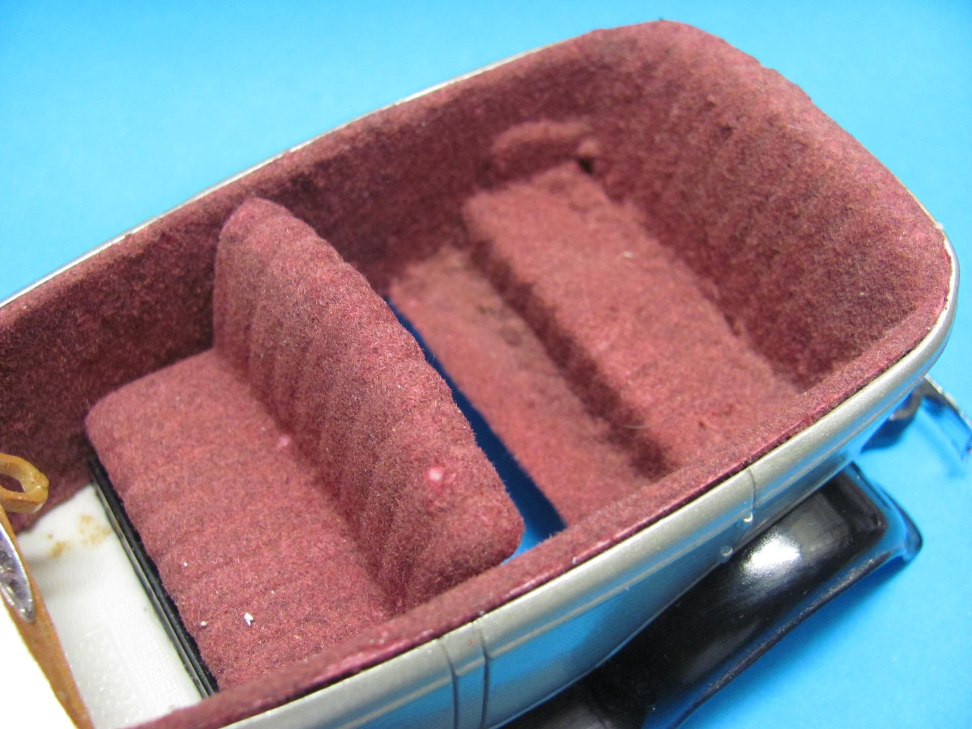

Speaking of errors, the horrible mess below was my first attempt at flocking this interior. I wanted a mohair look for this car but the attempt you see here was done using flock by a wellknown aftermarket detail supplier.  Now I'm sure his resin and photo-etch is great, I've got plenty of it, but there was something seriously wrong with his flock.  His instructions said do a section at a time, put a decent coat of flock on and tamp it down and then let everything dry  and dust off the excess next day. That gave me a bigger collection of furballs than I have ever seen under a bed.
I then brushed off as much of the ugliness as I could and tried my way, which is to cover everything with paint and then put the tub in a sealed container and do the old 'shake and bake" trick.  AS you can see below, it didn't do much better!
So recently realising I couldn't live with the attack of the fuzzy monsters I chucked the interior into a caustic soda solution and left it overnight.  The old Humbrol paint I had used came off easy peasy and I had a fresh interior to start again.

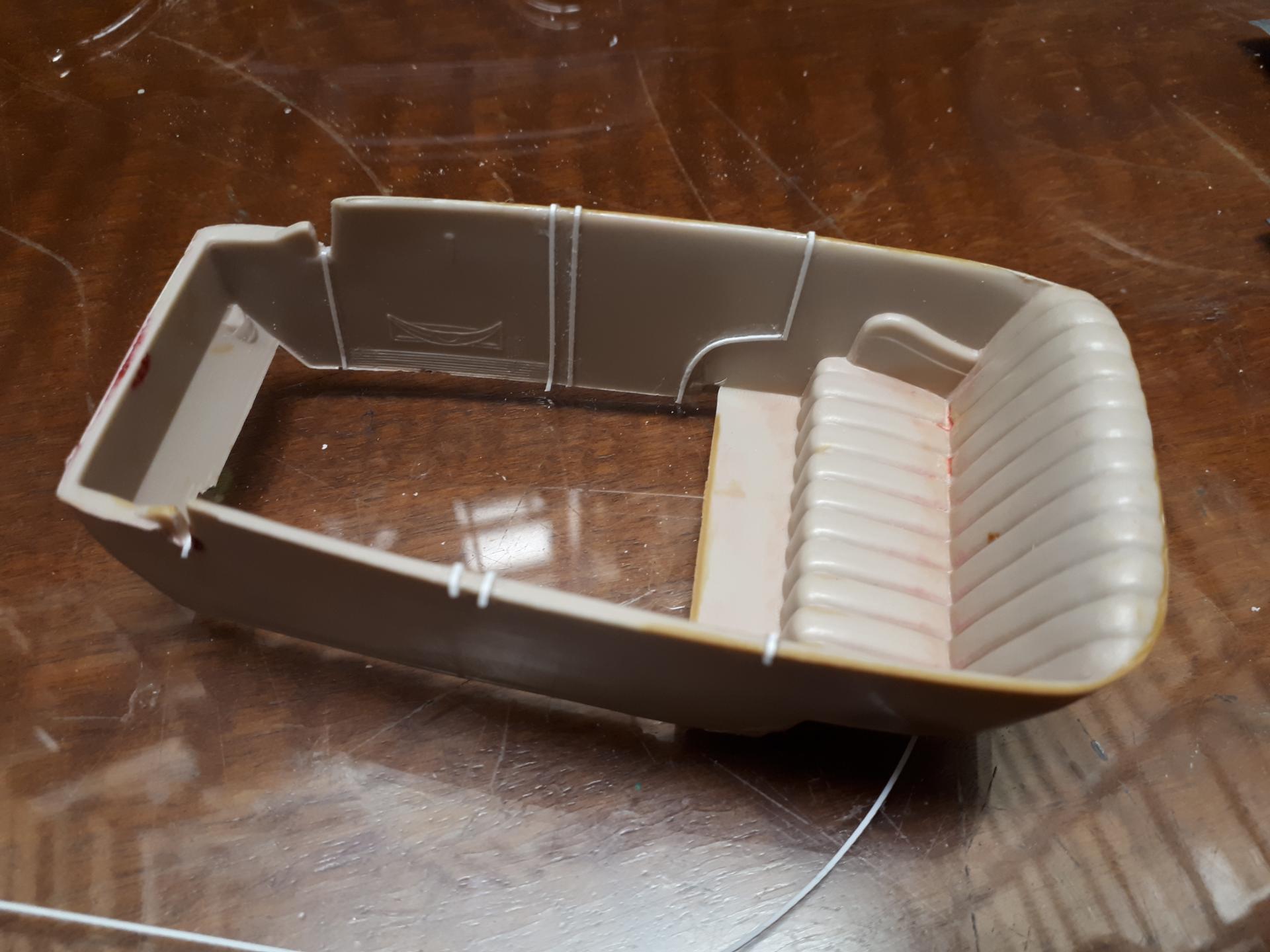

While I was at it, I added some Evergreen strips to give some indication of the door openings.

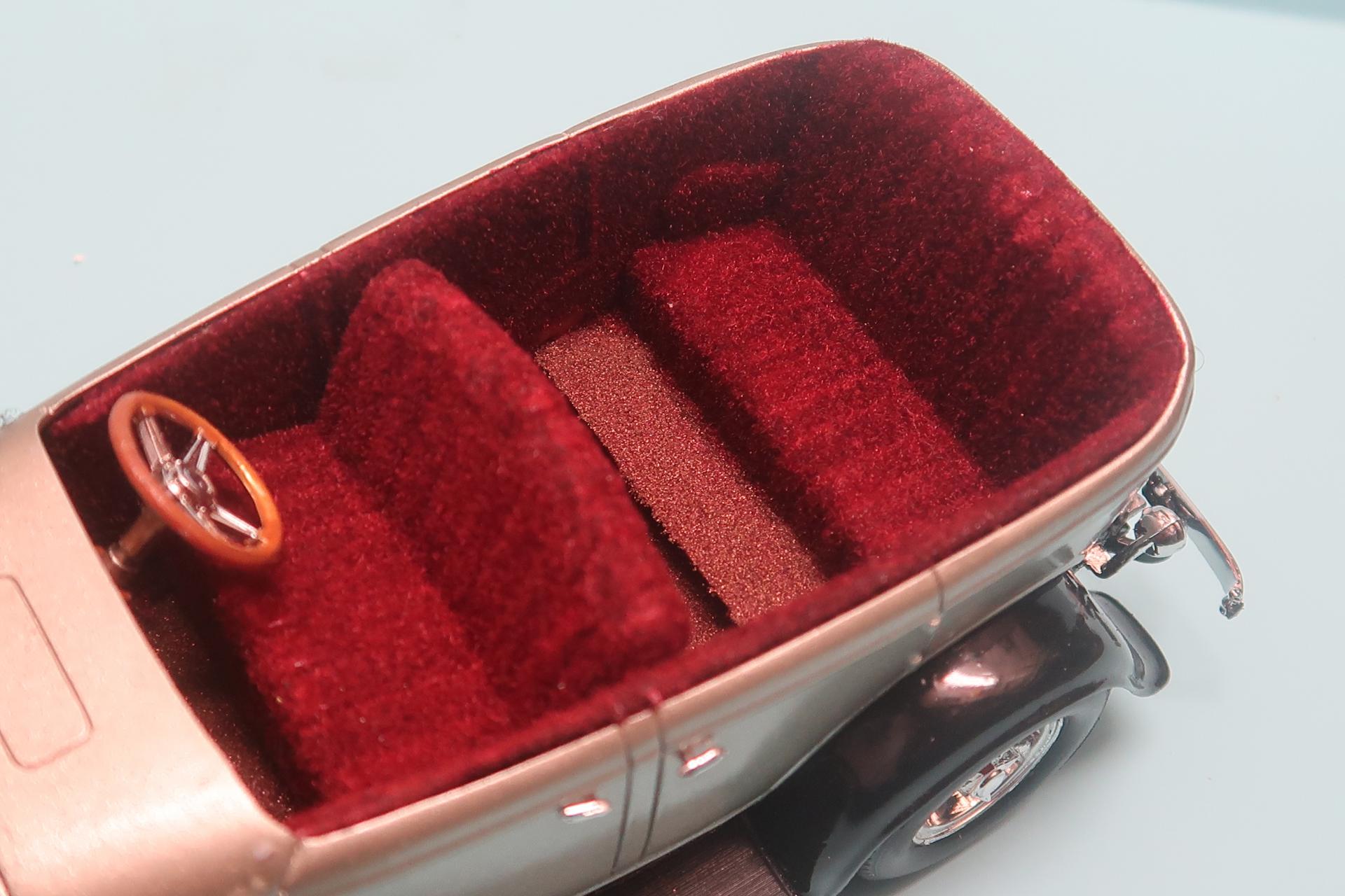

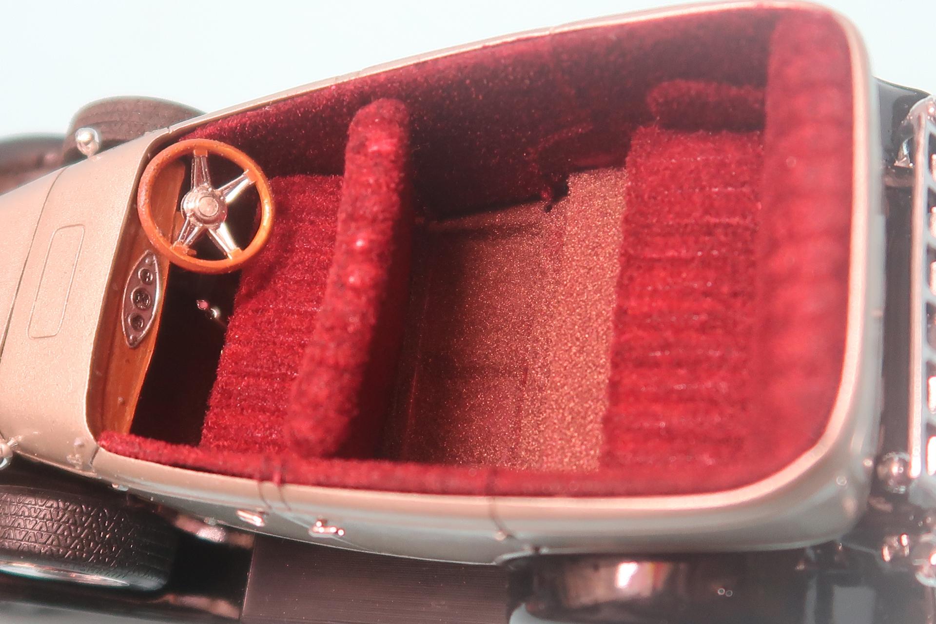

After my dramas with the U.S. sourced flocking material I obtained some here in Oz from Jason and Michelle at thepartsbox.com.  This worked a treat.  I simply slopped on a thick wet coat of Humbrol maroon paint and dropped the tub into a takeaway container with a lid.  I sprinkled some flock over the whole thing, did the shake and bake trick for a few minutes and then set the tub aside to dry.
The carpet is a bronze shade of embossing powder.  I'm not great at colour combos but it does the job and with the roof on all the time I doubt whether many people will even see it!
