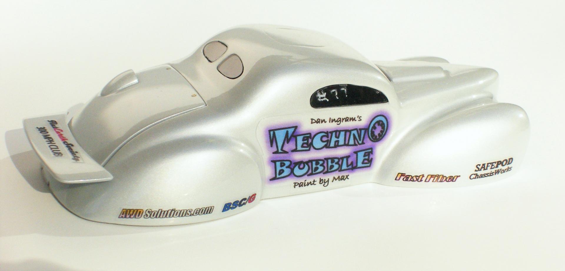

Since the Riviera is nearing completion, it is time to begin plans on the next cars to reach the workbench.  This time I want to build something completely different for me.  I am planning a couple Bonneville salt "What If's" fantasy builds.   First up is a body that I created many years ago for the Norman E. Timbs Special I built.  This is a body that I vacuum formed  which I intended to build his roadster from but after careful inspection rejected because the rear contours were not correct.  I corrected the buck and remolded the body, so this is a one off body that is slightly different from the final Timbs car.  Here is a link to that posting from a number of years ago............
uuGCHTyyelSqX3MJR1KVvK0yy6JXJhCj8z1OGxkJI always thought that this shape would make a great Bonneville race car so now I think it is time to get it built.0oRrHG5hWqy5bJKlYwIX-P_PXYqekQ-nzLB4rOQzJust from the "yellowing" of the plastic, you can see I have had this for some time now.BYRtorOx2fr95vuvY23z4dU8ITB0z7XgkuJSLCBHI am thinking maybe twin Hemi engines sitting side by side and a single seat way up front...... could work. right?   The second car is from a clay mold I sculpted many years ago with no particular plan for the final body.  It is kinda'' like a Group C race car and kinda' futuristic.  It sat around for years and the other day while molding some roofs (one for the Riviera) I figured I would knock one off of this car too.  After looking at it the idea of a Salt Flat car hit me.  Especially because of the body from the Timbs car I thought why not.  If building one salt flat car is good, two would be even better, right?  For this car I am thinking an Allison Engine since the car is bigger and beefier, so the engine should fit in there.  Here is the clay master.   hSCCEkcO-Ux5o5XTDx3xOudY3B_xBqr1iGwvK6MHAnd here is the body molded from the master    Rear view.NOKAL_qY-fkbMUOXSupe5NFep2qGjAyLWE1FX_udFront view  KsIh7F4TcGrO64IjtfPa_k3cG0h94TFzv6HFN-QgYou can get an idea of what I am thinking for the cockpit area and where the body will separate to open the engine bay.  Think scratch build tube chassis and full independent suspensions .  I want the wheel areas to be enclosed and louvered areas to allow air to escape.  Could work. right?
