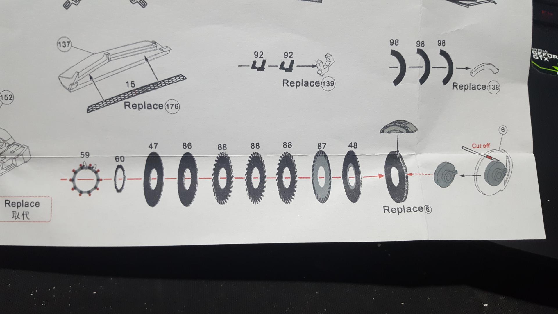

Has anyone  used this kit or one similar. Im not sure how they want you to build the rotors. Are you supposed to cut the hib out of the original kit ones and glue it in ? The instructions are pretty lacking.

I don't have the HD set for the LP700-4 "base" Aventador because Aoshima did a factory set for that kit. But these are the instructions for the Roadster one from HD
So yes you cut the center plastic hub off (or grind the brake rotor off from the outside) and the glue it into the center of the new brake system you build out of the P/E pieces.

Nice !thanks for that. Would you mind showing more of the directions?
