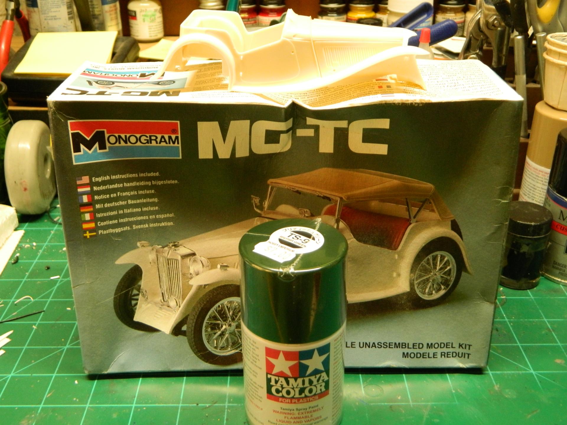

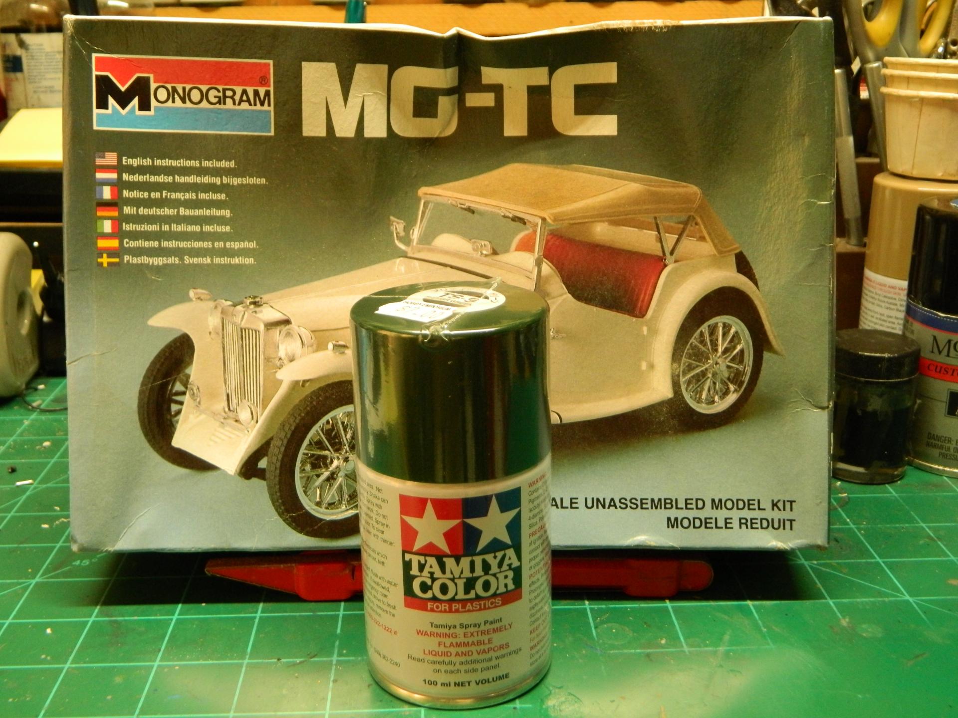

I am currently on a British motor vehicle kick and this kit was gifted to me by the Co-Treasurer of my Club since he knew of my fondness for British cars.  This is the Monogram MG-TC in 1/24 scale and the copyright on the kit is 1982, so it is an old kit.  I plan on building it box stock and in the same colors as the Tamiya Morgan 4/4 I built last year...Tamiya British Green with Model Master Dark Red seats.  I find this amazing especially since an MG-TC was restored on the TV series, For The Love Of Cars, hosted by Philip Glenister and Ant Anstead (pre-Wheeler Dealer days).
More to come...

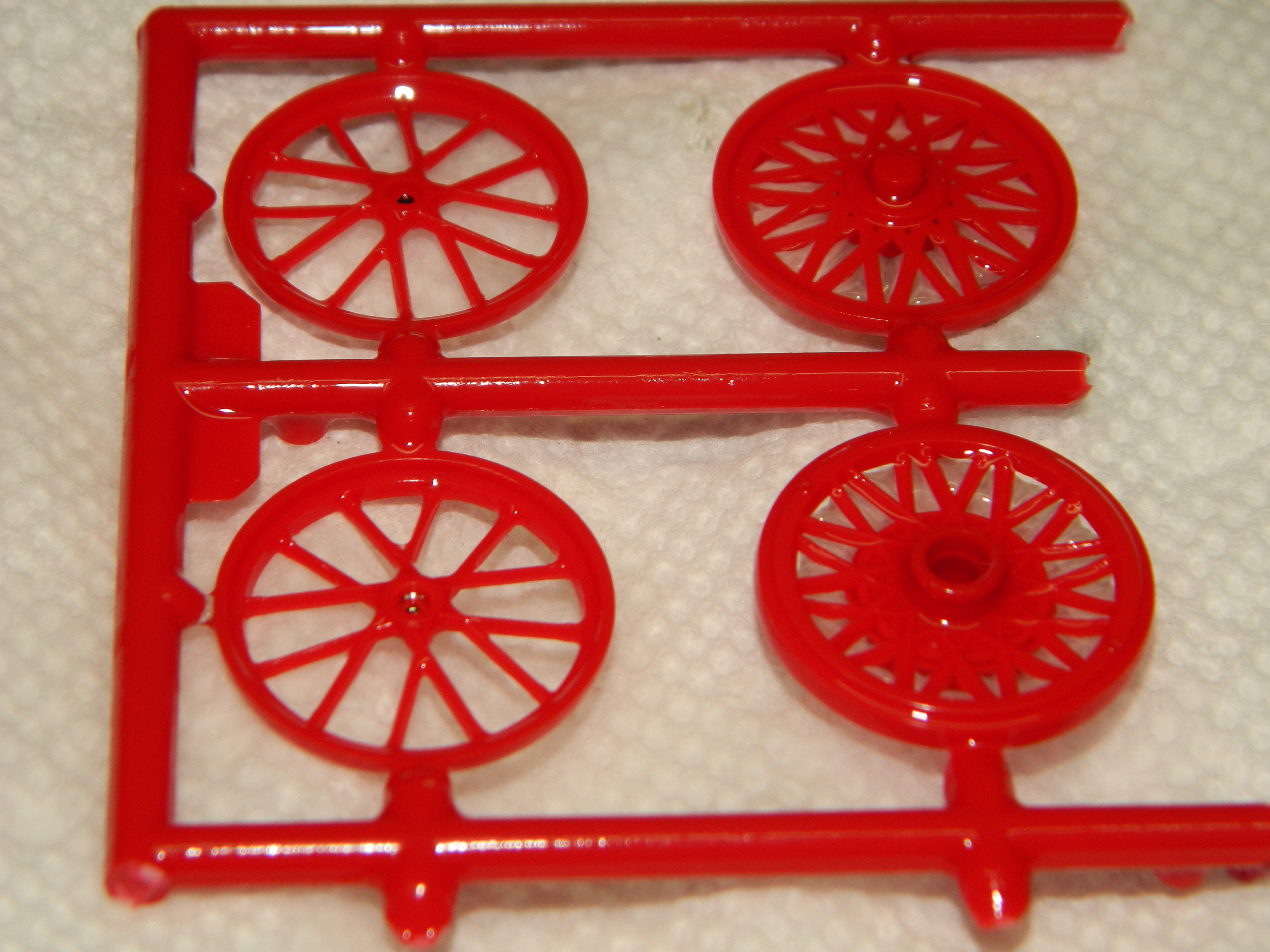

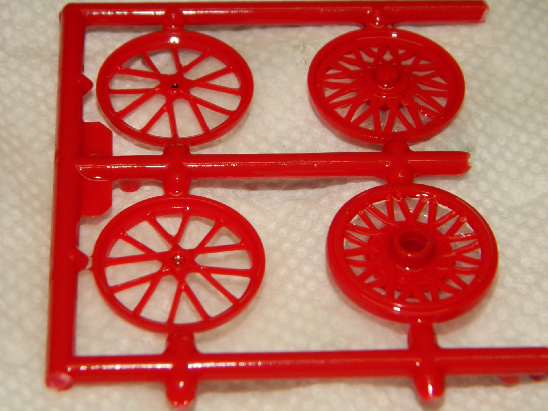

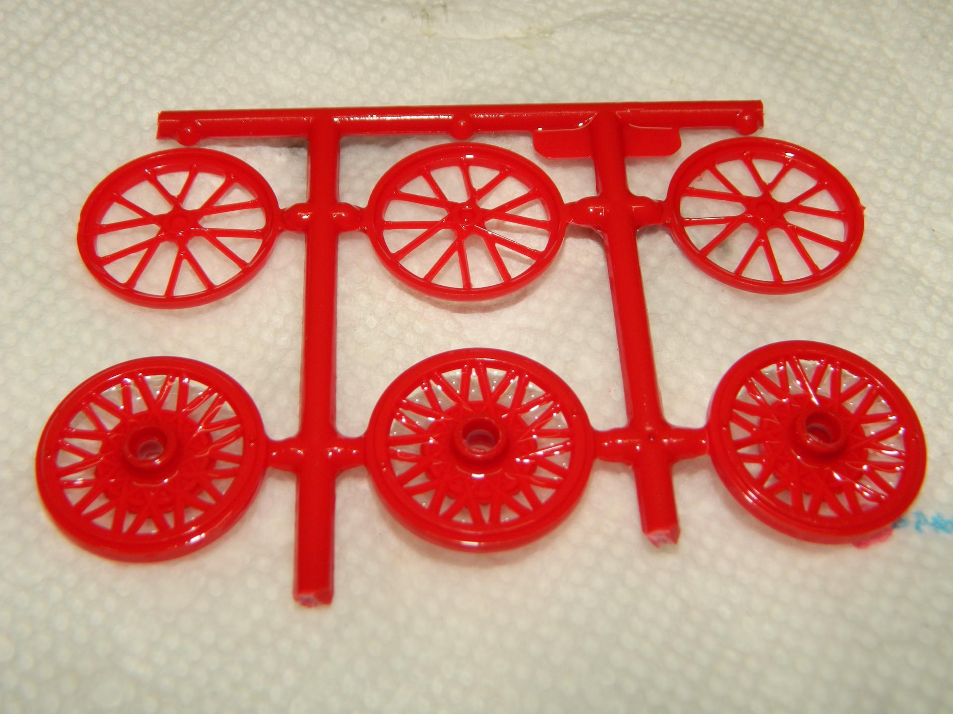

I determined which engine parts would need to be stripped and tossed them in a container with bleach.  The wheels were chrome plated and my research indicates the wheels were aluminium colored.  The wheels went into the bleach.
More to come...

The wheels would have been painted silver grey. Very rarely would they have been chromed due to hydrogen embrittlement.

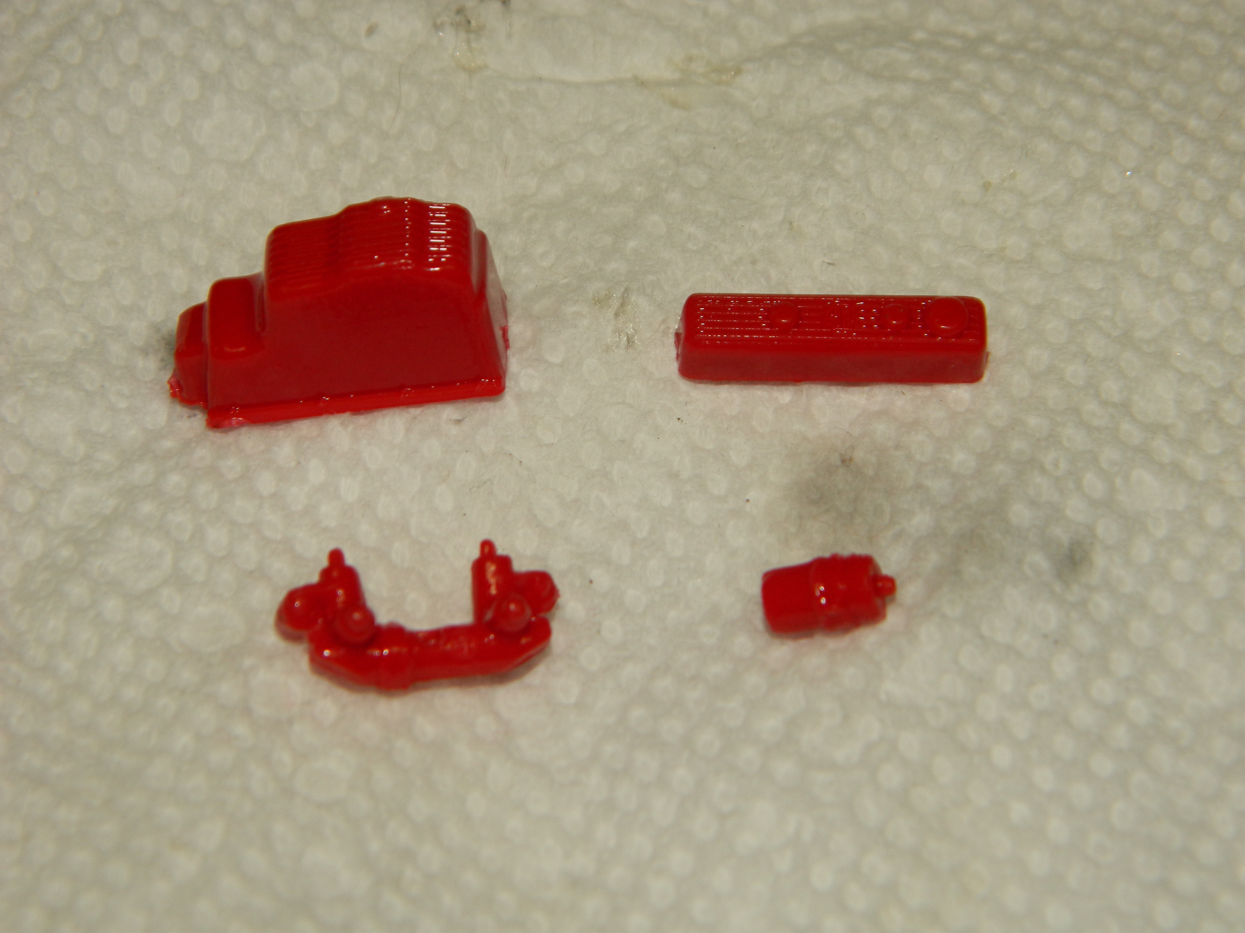

Dave, every picture I have seen of the MG-TC, the wheels were not chrome.  That is why I stripped them so I can repaint them the proper color or colour if you prefer.  The instructions say to paint the engine block olive green which isn't correct.  I have seen several shades of red from dark red to bright red.  I'll  research the engine color some more.  Thanks!

The all plastic kit was a reissue of the old die cast and plastic kit. As for the wheels being chrome plated or not, Dave is 100% correct. They were painted but never chrome plated from the factory.
The engine should be MG engine maroon, I'm sure you'll find something that side of the pond, but rustoleum do a shade that's pretty spot on, don't forget that the front grille inserts need to be painted the same colour as the interior.

It looks like either a Humbrol or Model Master dark red would be a close match for the engine.

Thanks Eric and Richard!  The wire wheels need to be a closer match to a real MG-TC and having them chrome plated doesn't match any of the pictures I have seen lately during my research.  At first, I wasn't going to strip the wheels, but upon further examination, the chrome had to go.  The engine block will be painted with Testors Dark Red or Fire Red in the spray can.

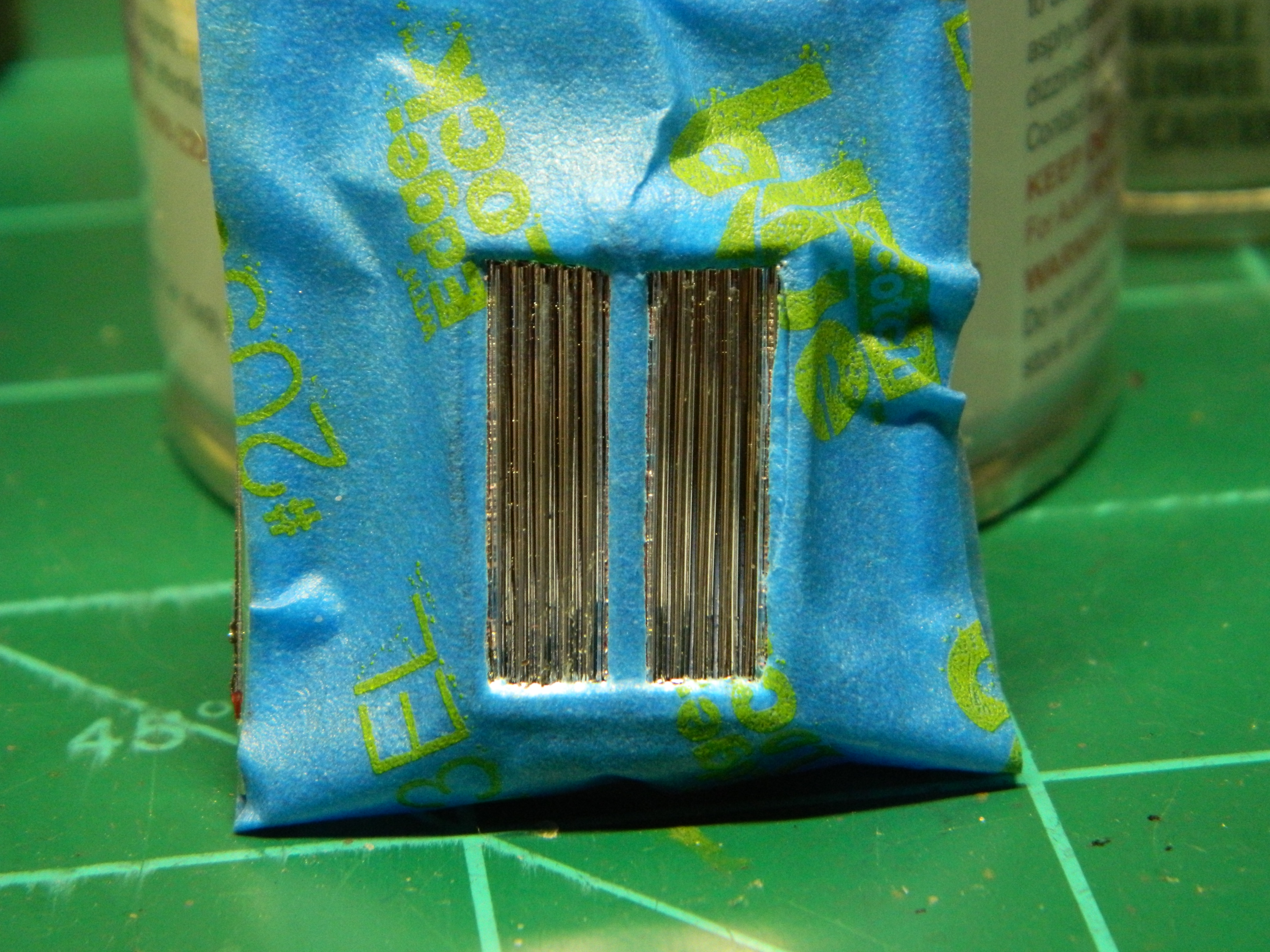

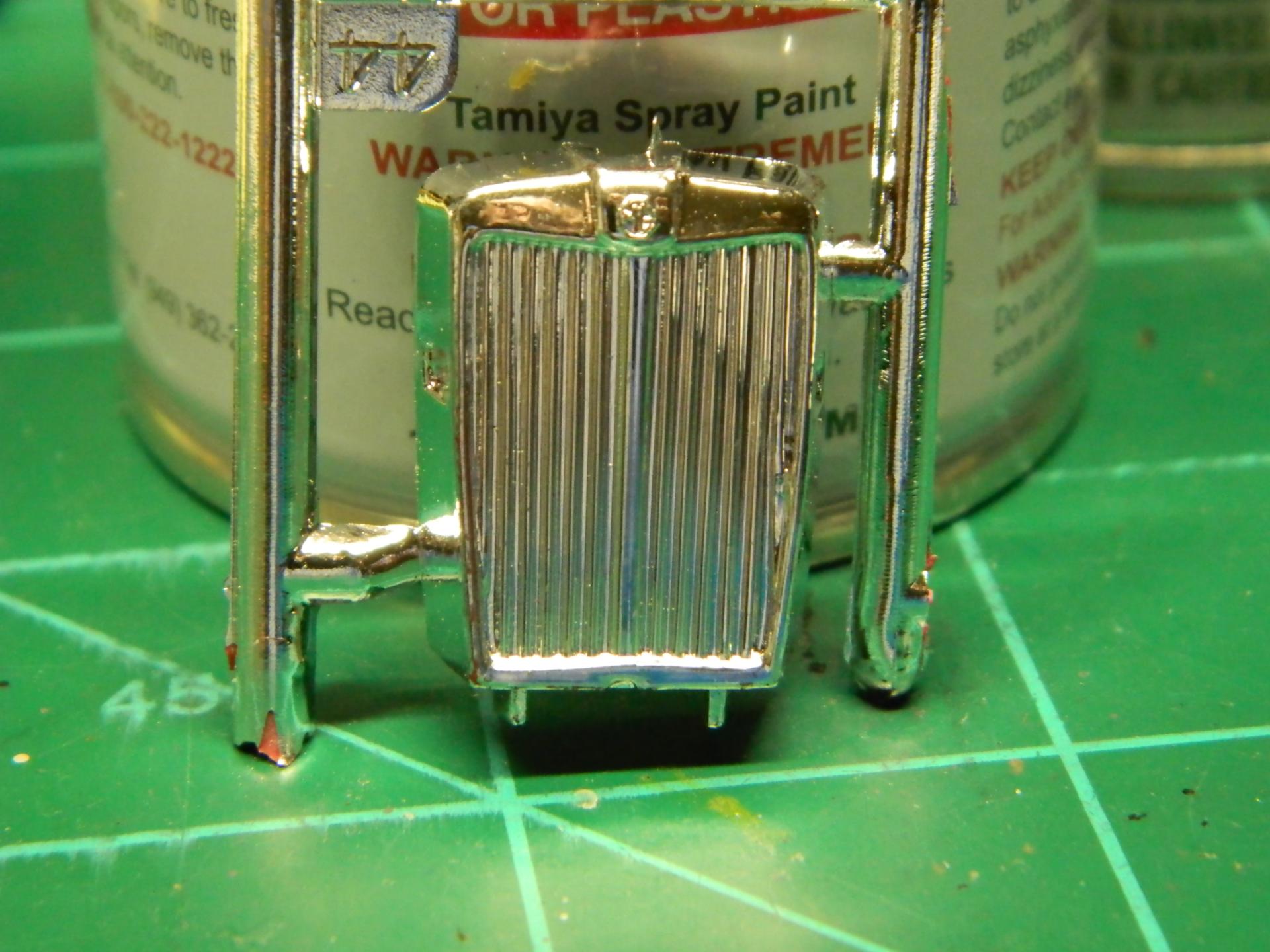

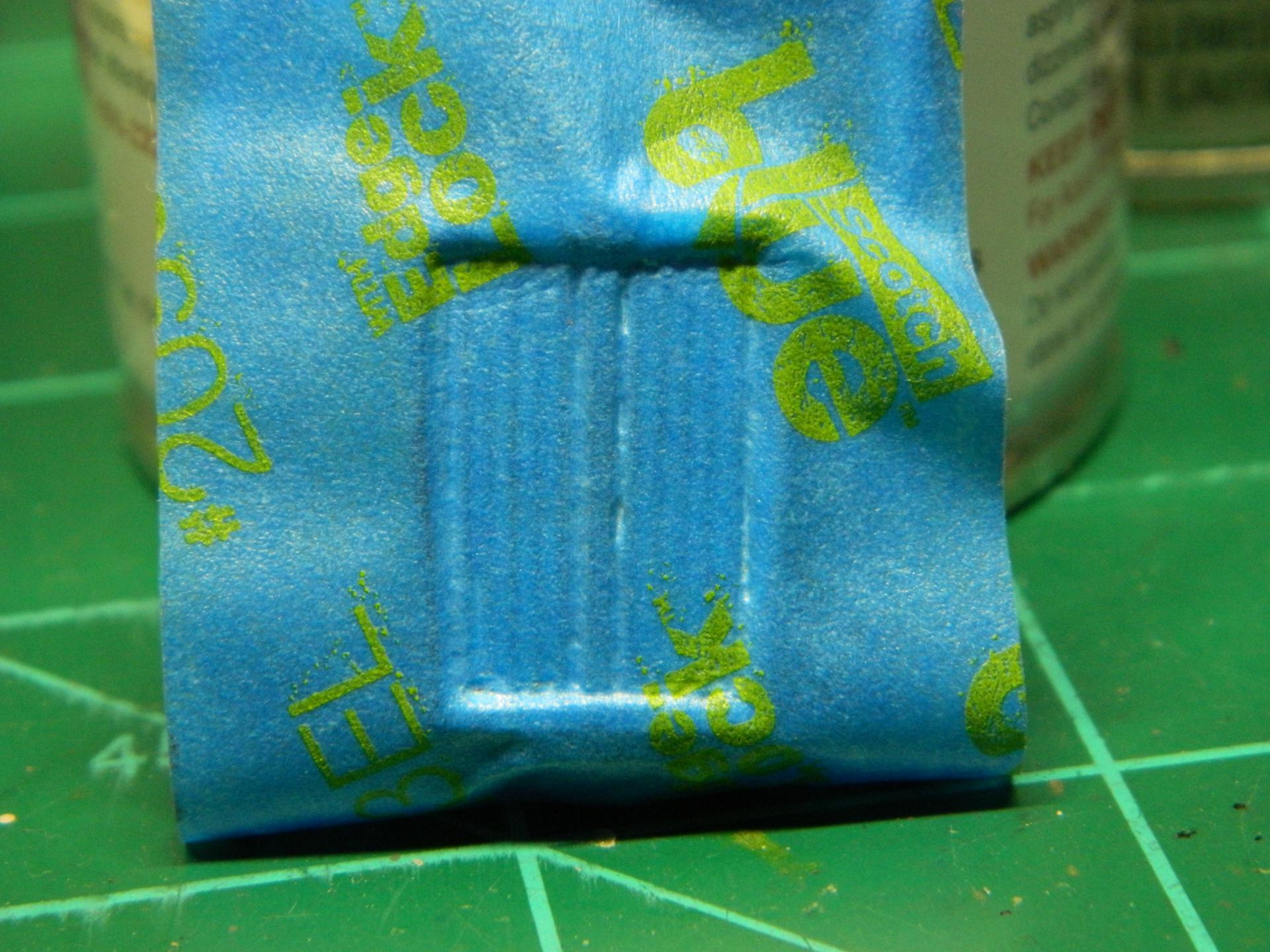

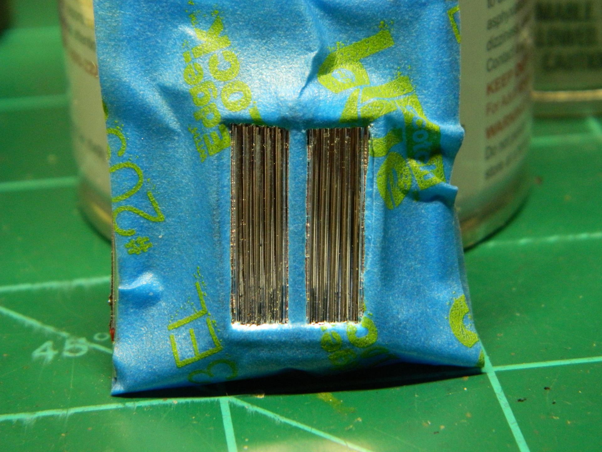

One of the things that stands out on the MG-TC is the slats color on the grille.  The slats are painted the interior color, but how do I paint the slats?  A brush is out of the question as it'll leave brush marks.  I choose to mask the grille and expose the slats.  I covered the entire grille with a piece of painters tape and I burnished it down.  Using a sharp hobby knife, I traced and then cut out the tape over the grille slats.  Now, all I have to do is decide on the color to paint the slats with.
More to come...
Never occurred to me that they are interior color. Looks a bit strange to be honest especially some color combinations.

Not sure what you will make of this idea, Michael..... but here goes.... I would paint the entire grille in matt black, and then before the black paint is dry you can wipe away the black from the parts of the grille that you want chrome, leaving the slats matt black underneath. I am only suggesting this method because I was advised to use this technique when painting the floor of a Revell London Bus, which basically leaves the black bits showing after you have wiped away the excess paint that you don't want.... before it dries.
David

With the green you're going with for the body, the three main interior colours were red,beige or green, so the grille will need to be painted to match.
David
Thanks for the idea David!  Over the years I have used The Detailer and now Tamiya Panel Line Accent Color to add definition to various parts.  The MG-TC grille will be painted with the interior color and right now I am leaning towards dark red seats as I had painted my British Green Tamiya Morgan 4/4 I built last year.  This means the grille will be painted flat or semi gloss red.  The dark red looks really nice with the British Green body.

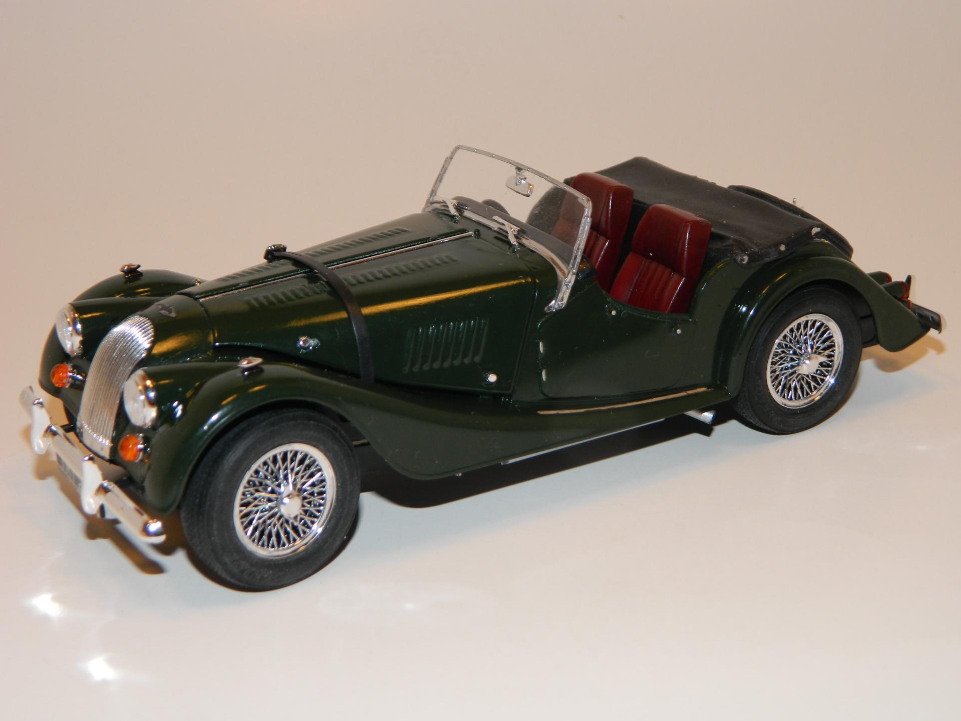

Thanks Mitchy!  I really appreciate the link you posted and I will look it over shortly.  I choose the green/red color combination since it appealed to me when I watched an episode of For The Love Of Cars with hosts Philip Glenister and Ant Anstead (pre-Wheeler Dealer days).  Ant bought a red '69 Aston Martin DBS and he restored it with an olive green body and a dark red interior.  Last year I built a Tamiya Morgan 4/4 abd used the color combo of British Green body with dark red seats and it looks spectacular!  I decide to repeat that color combo  on this MG-TC.  Here's a picture of the Morgan 4/4.
