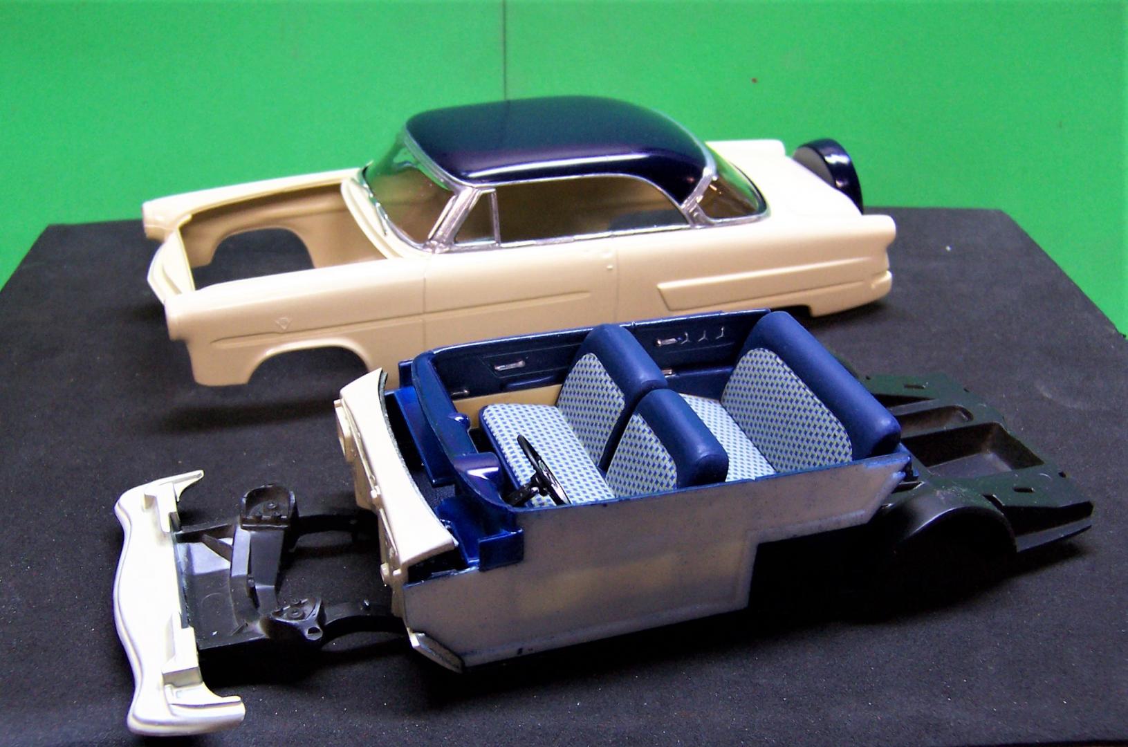

I did this one by making a pattern on a graphics program and then printing out decals.  Seats were painted dark blue first.001.thumb.JPG.2bfad91690b0601407b254ccdad36d75.JPG006.thumb.JPG.710a039a0117539d10378f250ea82119.JPG
Share this post
Link to post
