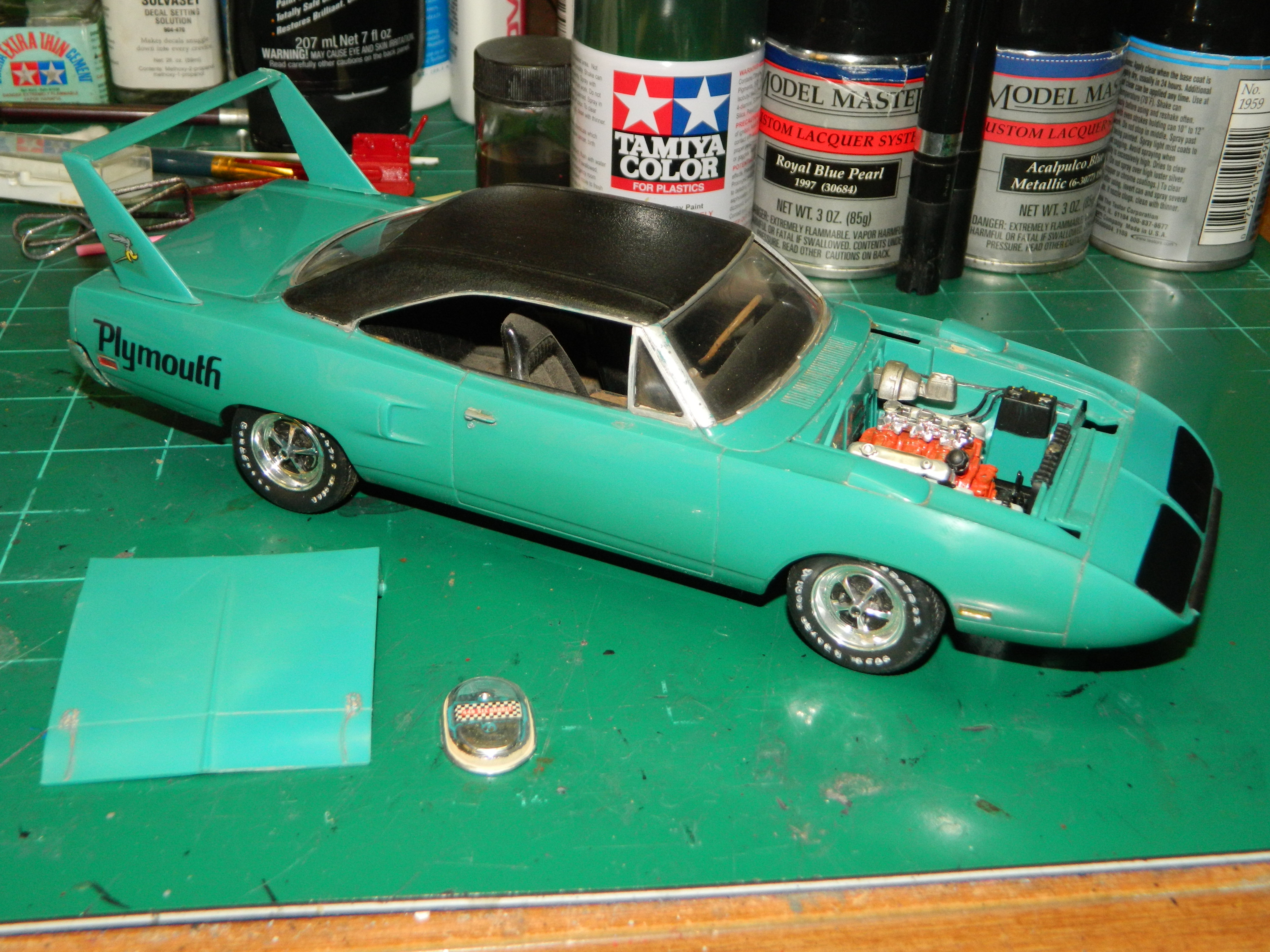

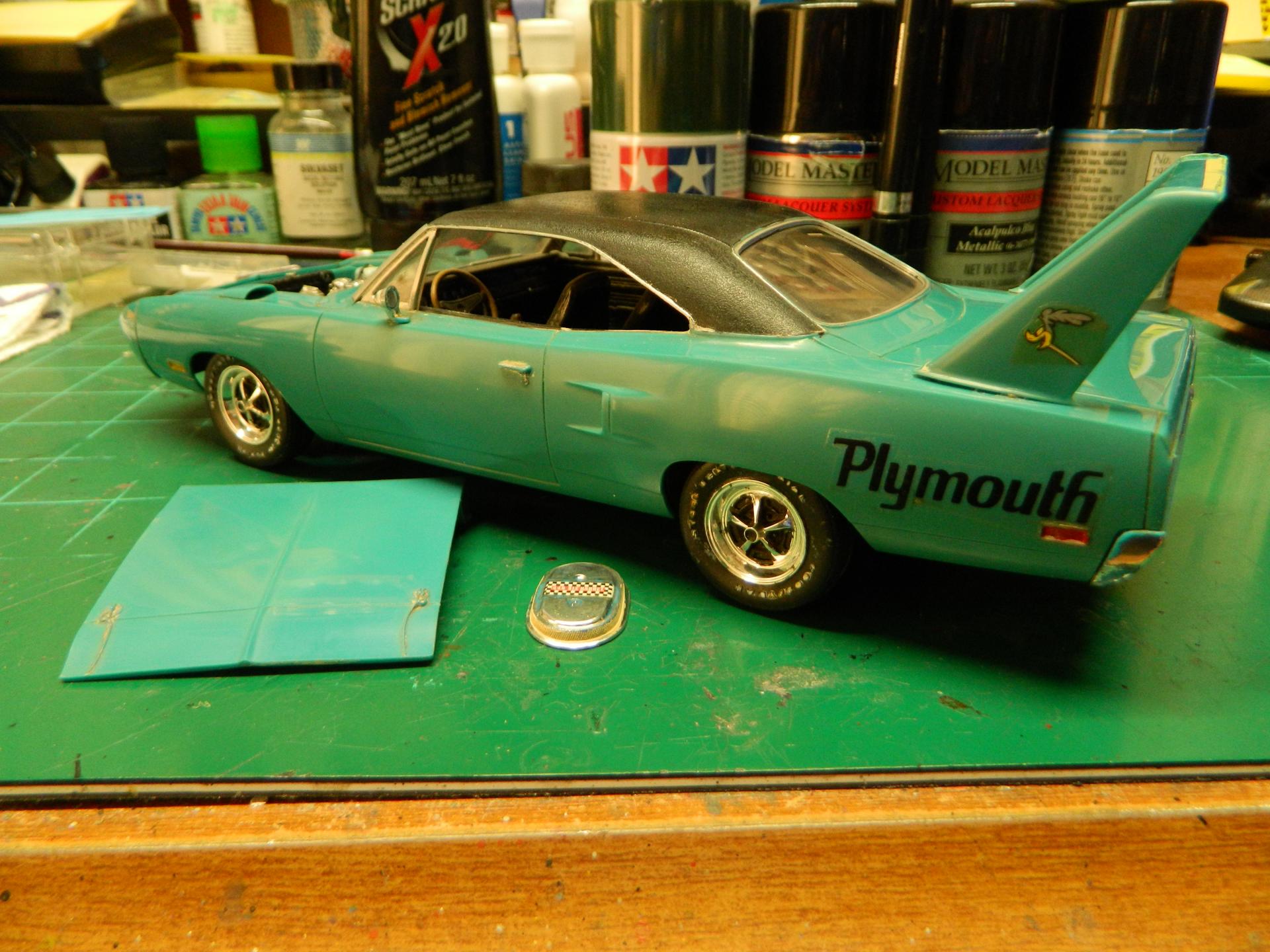

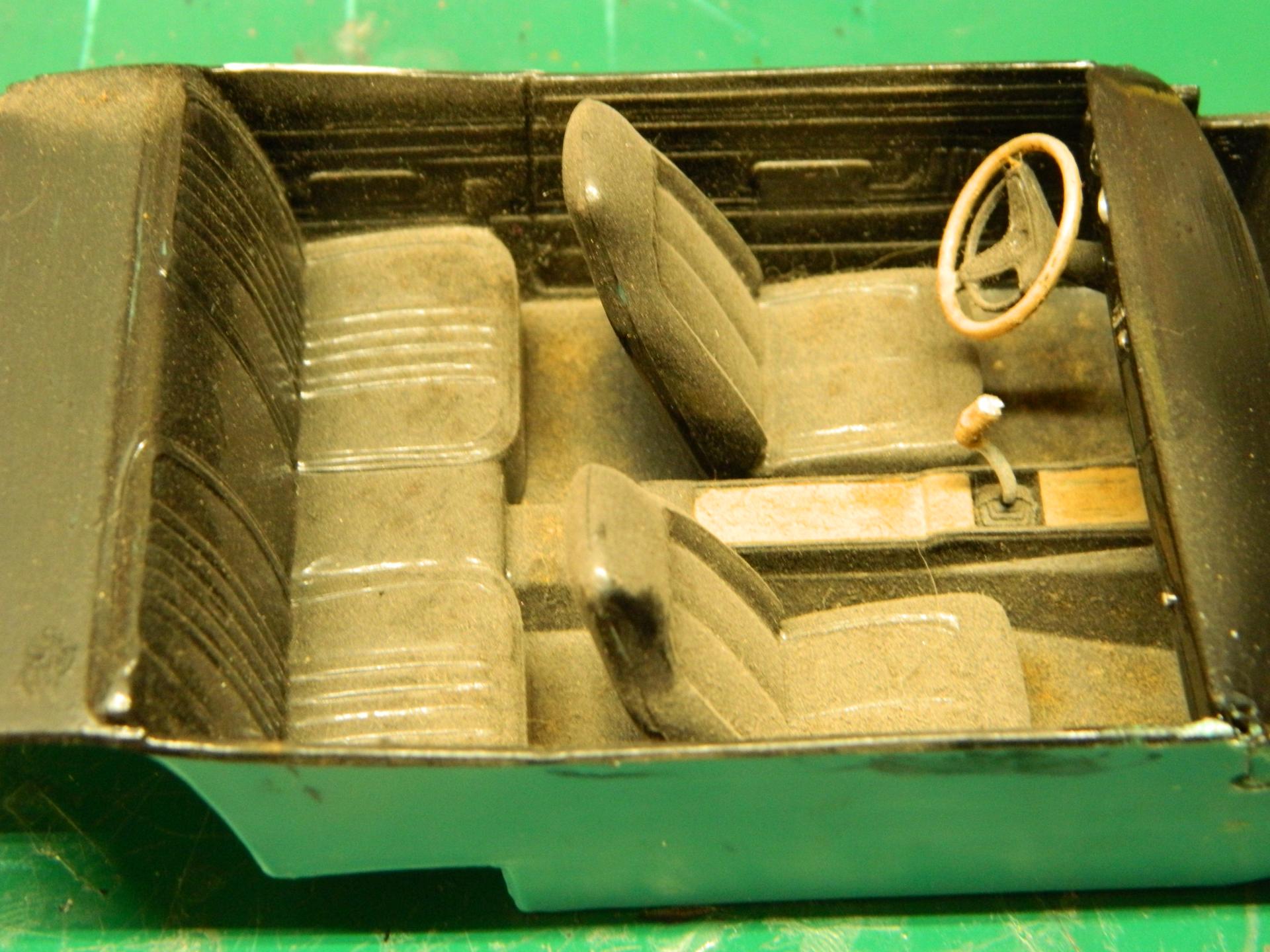

This Superbird has been languishing on the shelf.  Time for a rebuild!  I kept on looking over the Superbird and things started to fall off...with a little pushing and shoving!  The interior and glass are out.  I found a set of Rallye wheels and wider tires.  This is dust turning to dirt!  I'll break this down and wash everything!

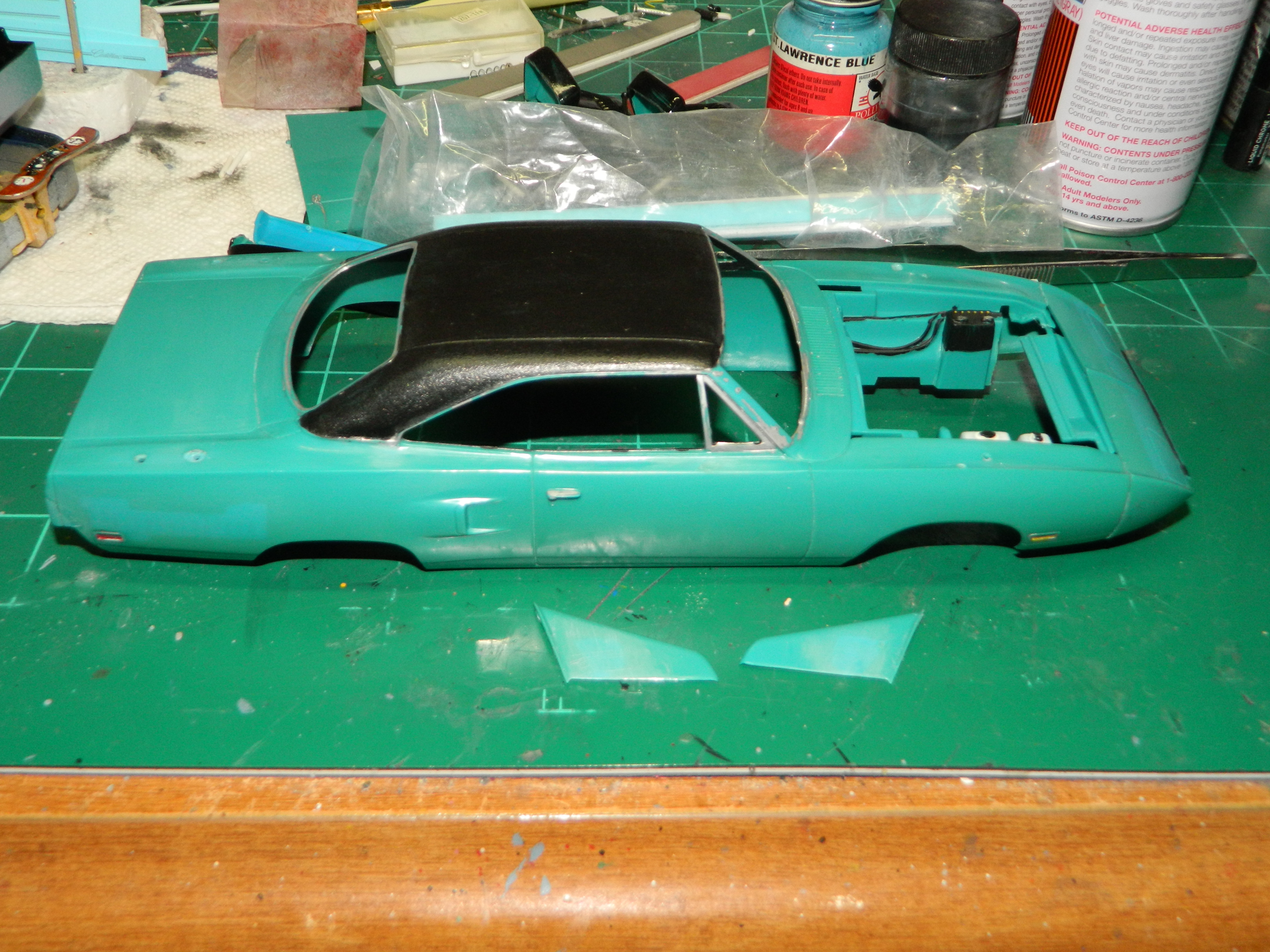

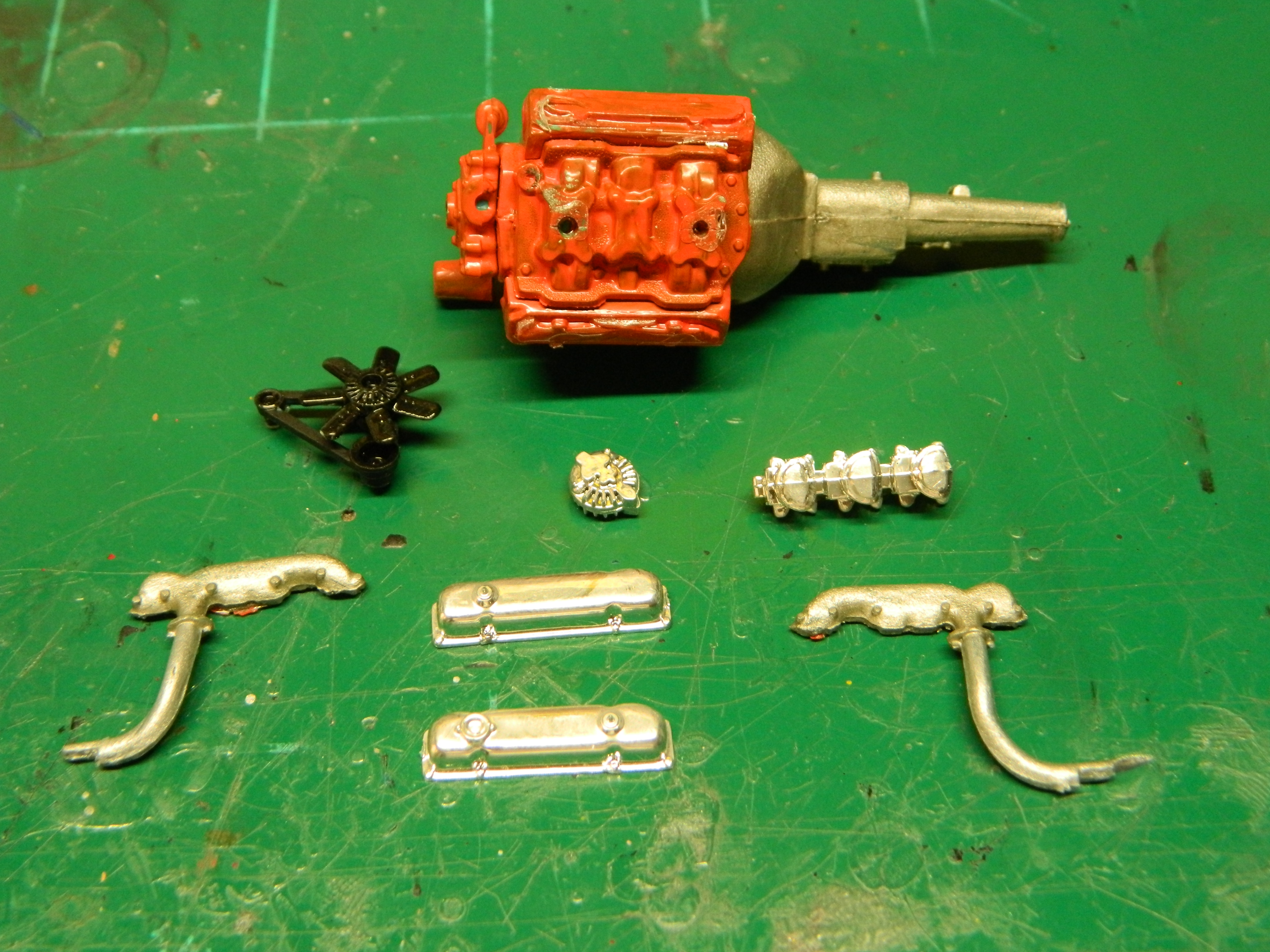

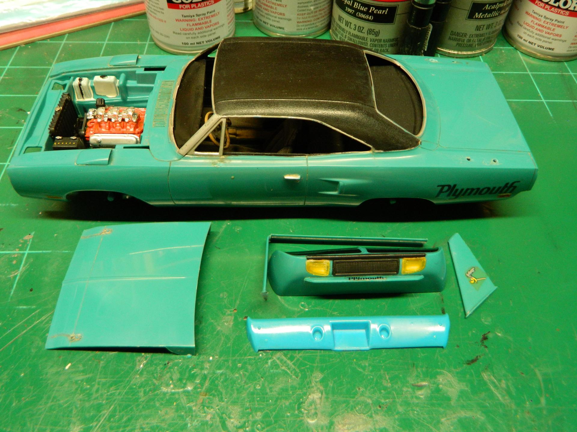

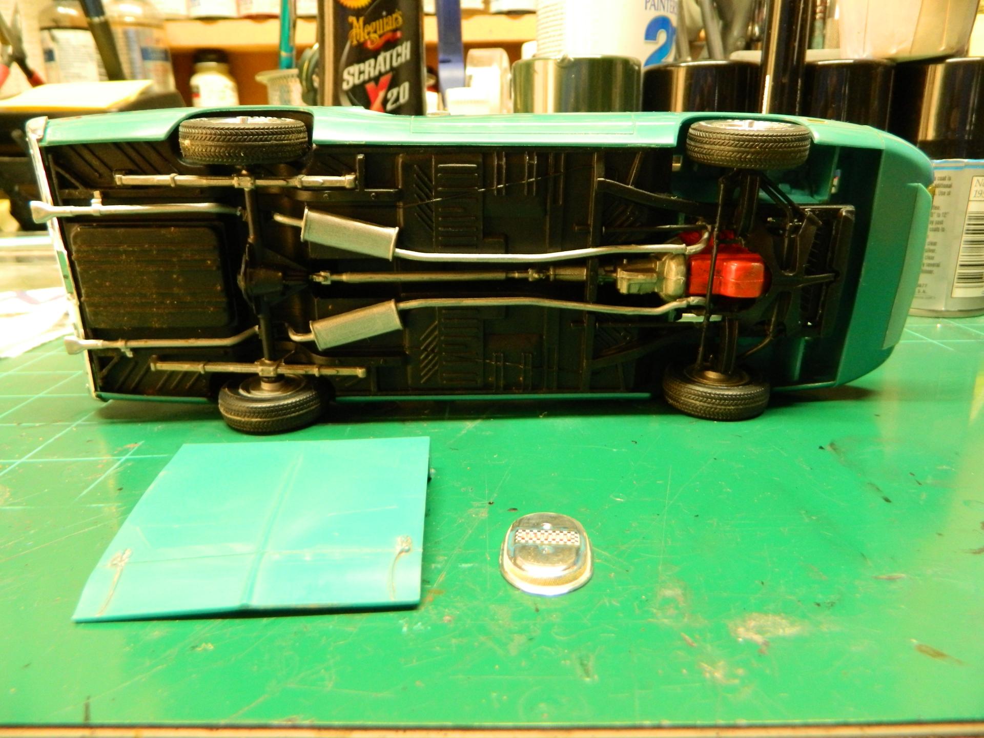

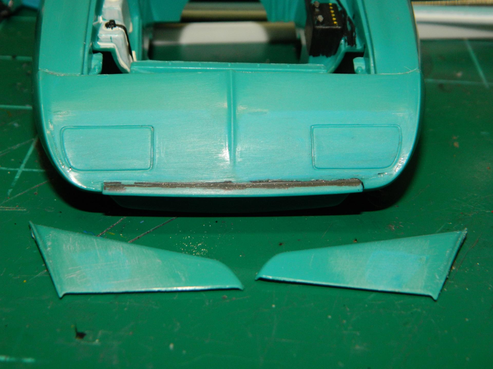

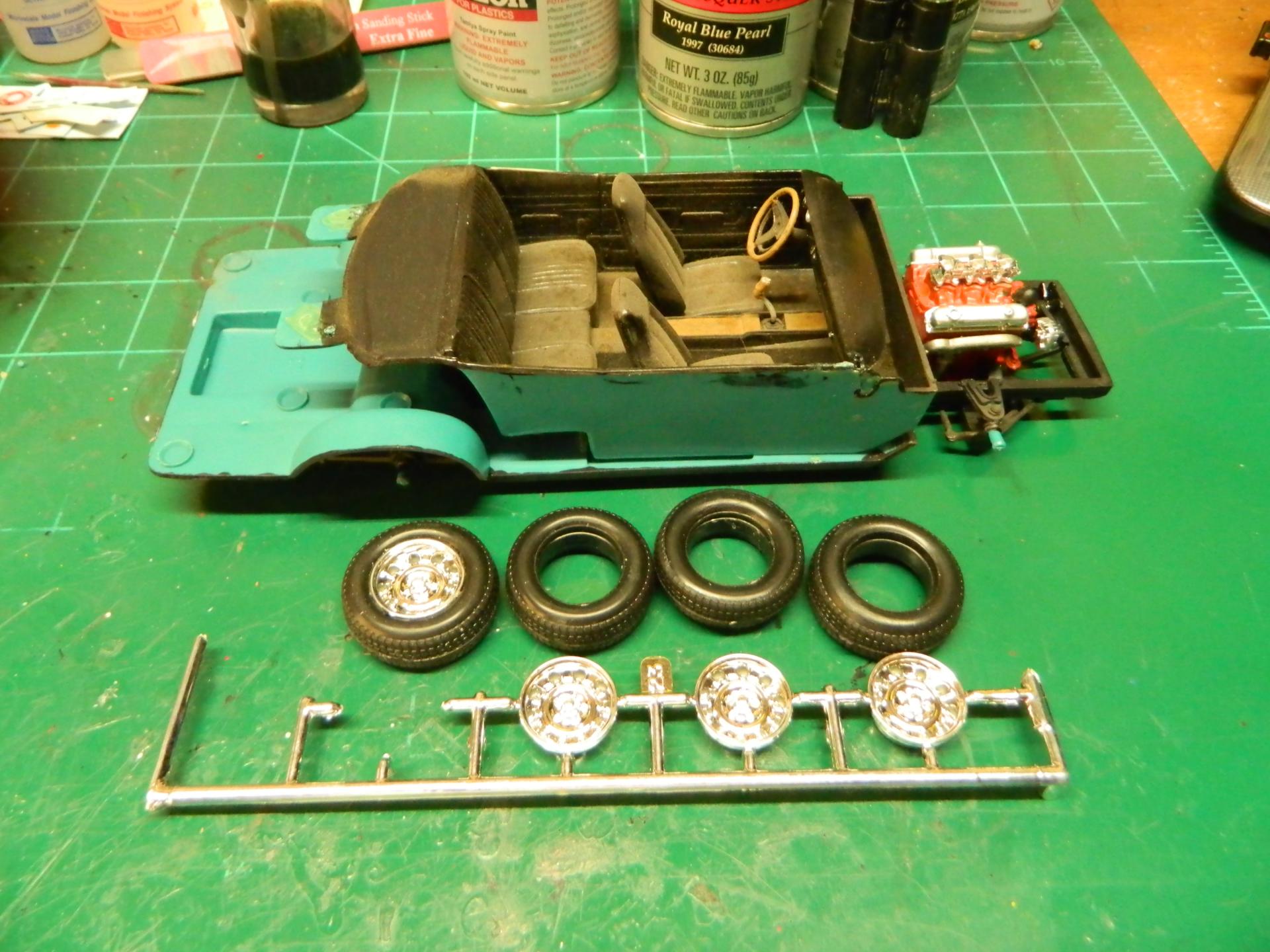

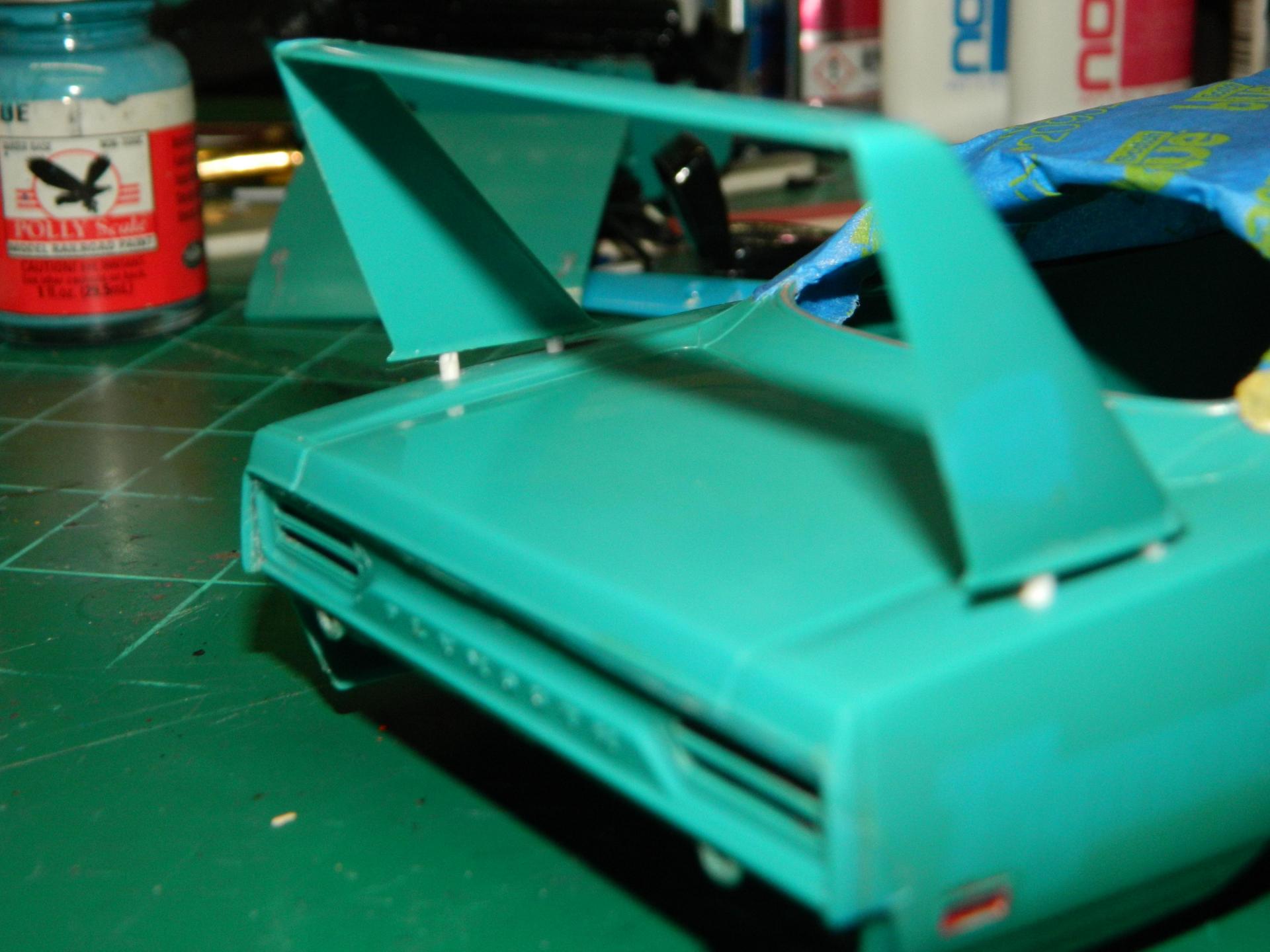

Since the chrome plating on the rear bumper was flaking off, I decided to strip the rest of the plating and I found Petty Blue plastic under the chrome.  I think this was the original plastic color on the body.  I have dismantled the engine and will strip the chrome from the carbs and alternator.  I may leave the valve covers plated.  The rear suspension came off rather easily, but the front suspension was much more difficult and I broke off a couple of braces for the suspension.  I used a couple pieces of styrene rod to replace them with.

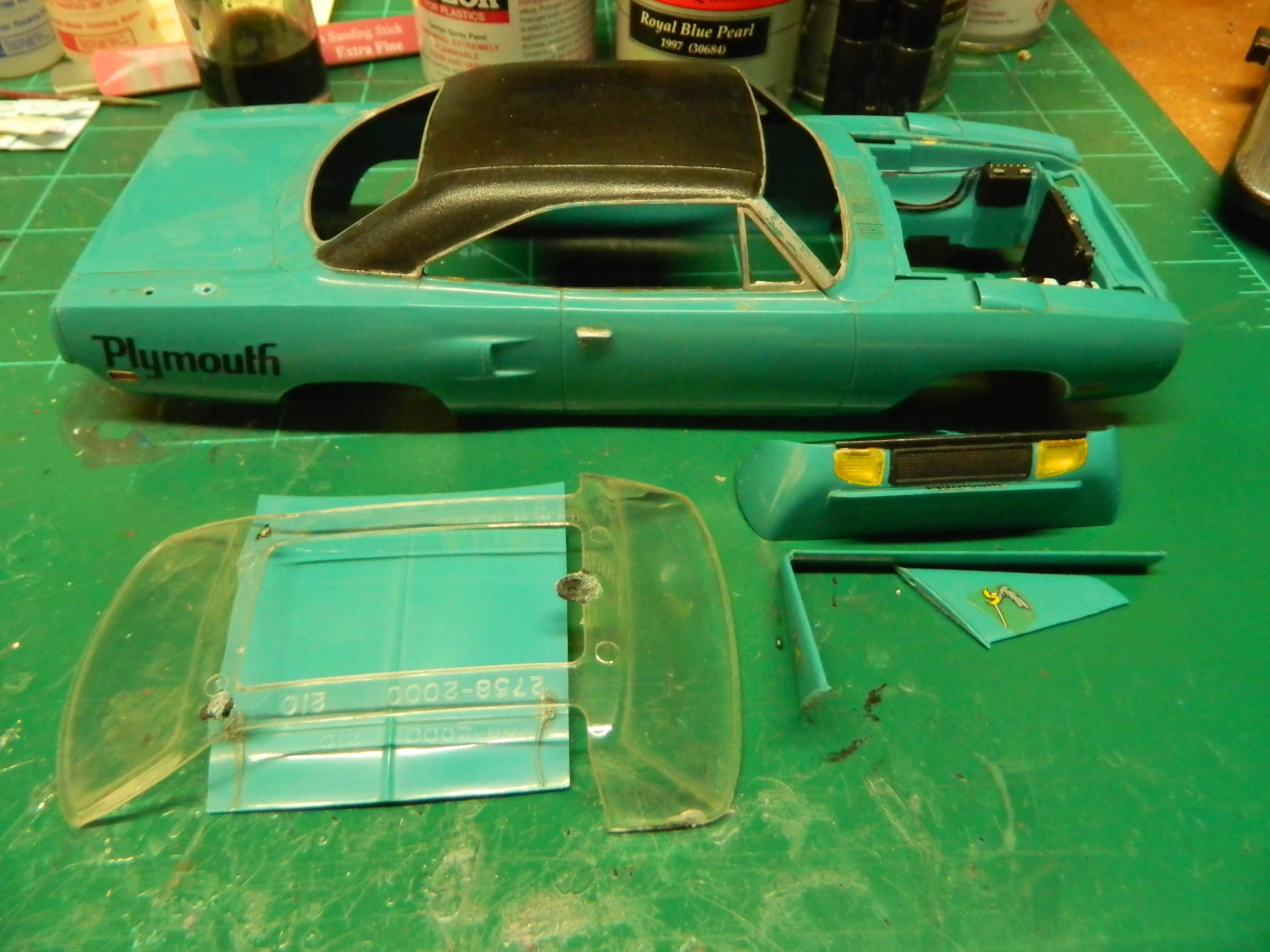

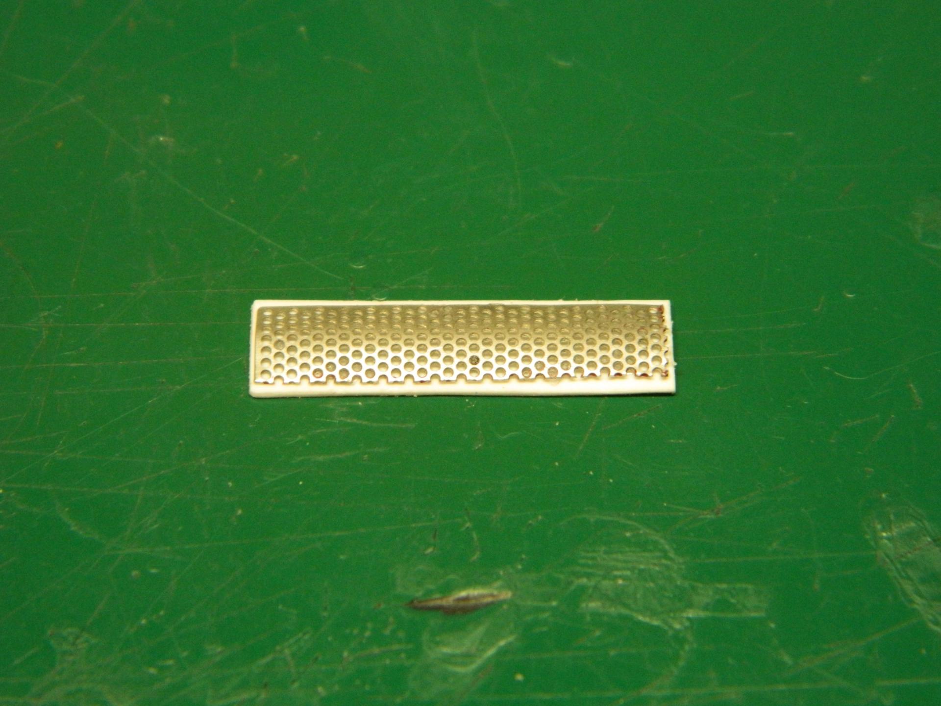

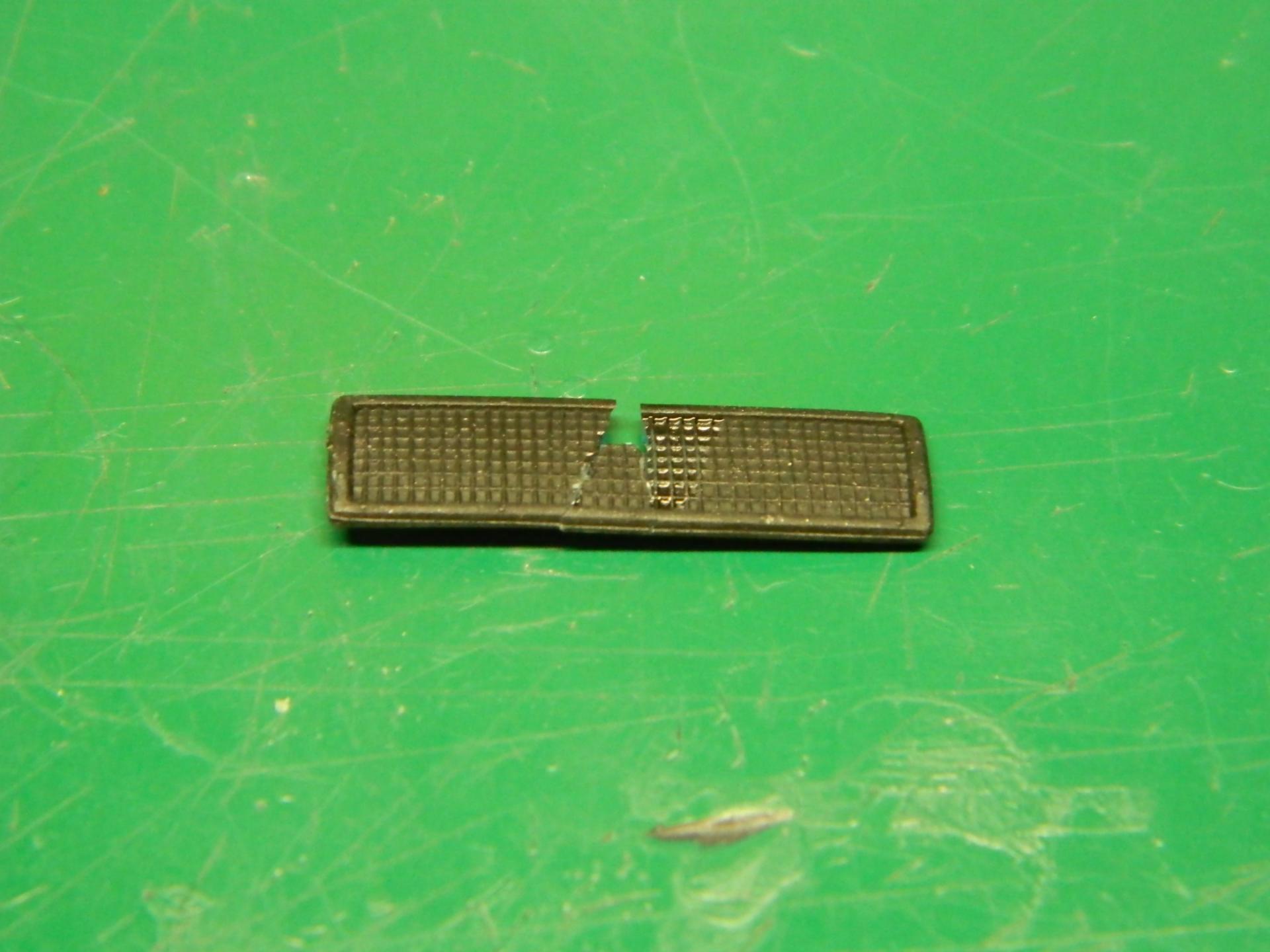

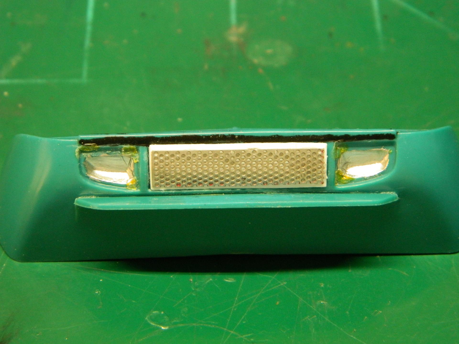

Well, it was bound to happen.  I broke the center screen.  I was in the process of gluing it all back together when I realized that I was missing a small piece.  I cut out a piece of photoetch screen and a piece of plain 0.020 styrene and superglued them together.  When all was dry, I bent the piece slightly around the handle of a hobby knife.    Fits pretty good!  A little more sanding and filing and it should be perfect.  Just need to paint it flat black.

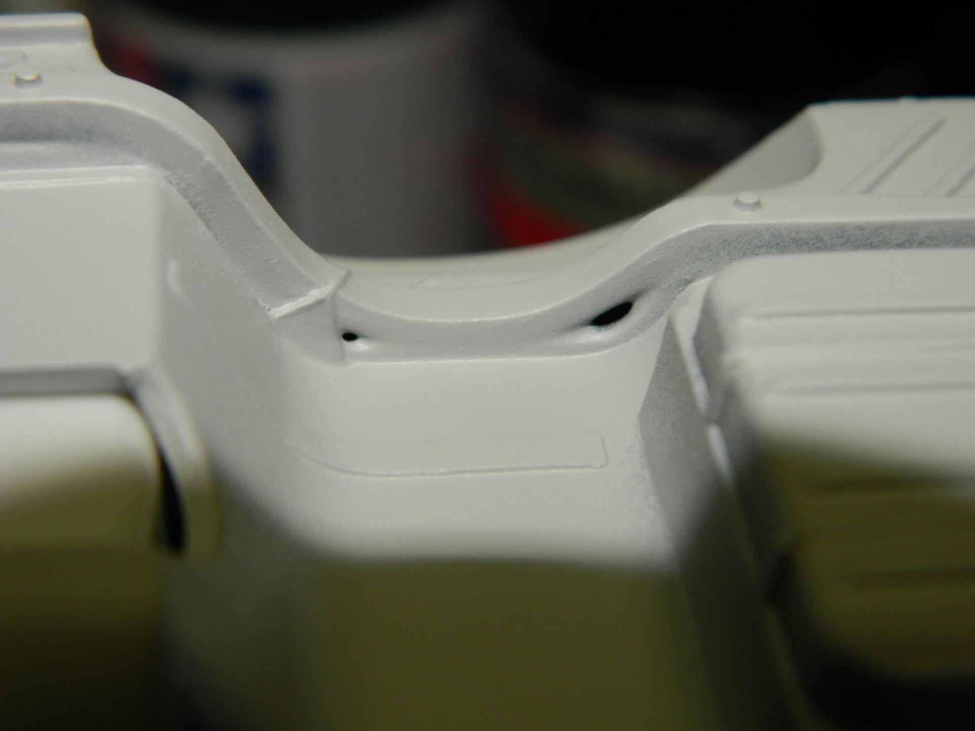

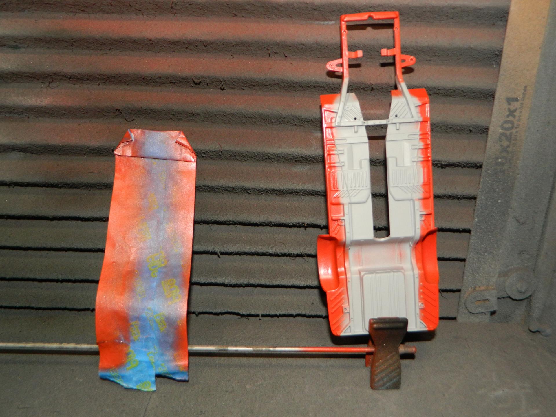

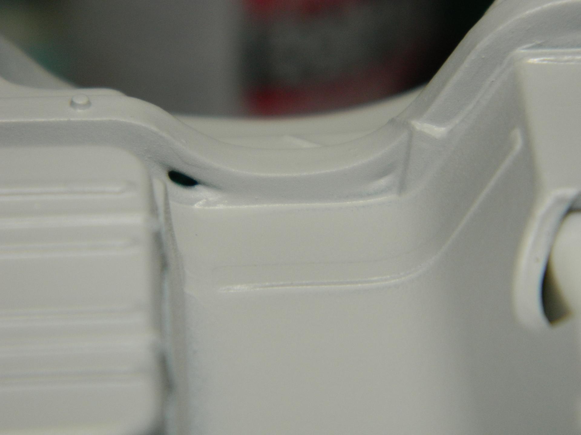

After priming the chassis, I looked it over and discovered many sinkholes in the plastic.  At this point, I don't care.  I am forging ahead with paint and assembly.
More Superbird to come...
Share this post
Link to post

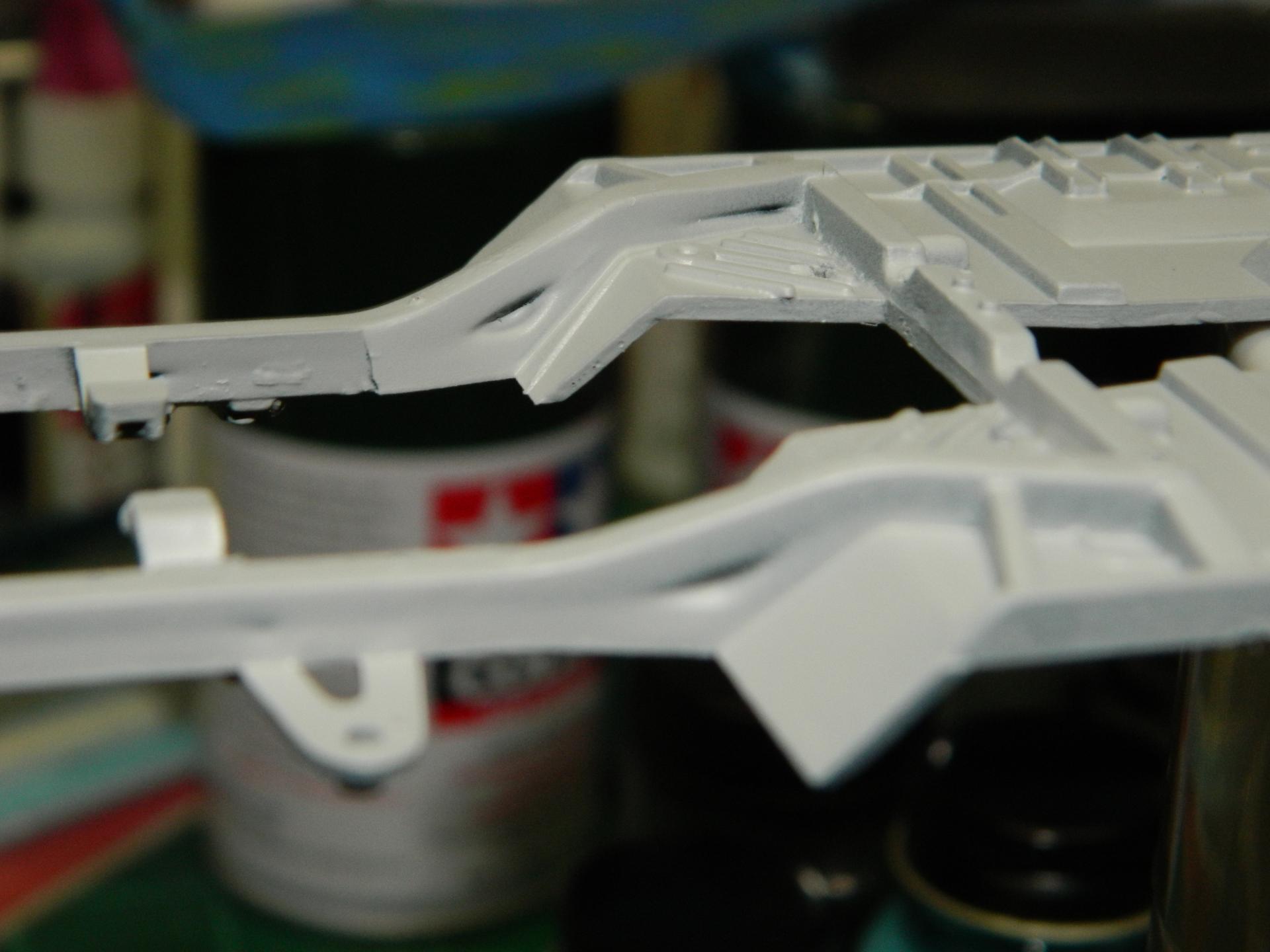

After priming the chassis, I gave it a quick look over and discovered many serious sinkholes in the frame.  At this point, I don't care.  I'm forging ahead with paint and assembly!  I loosely covered the center of the chassis without burnishing it down and made a couple of quick passes with Testors Hemi Orange Lacquer.  Not bad for a first time.

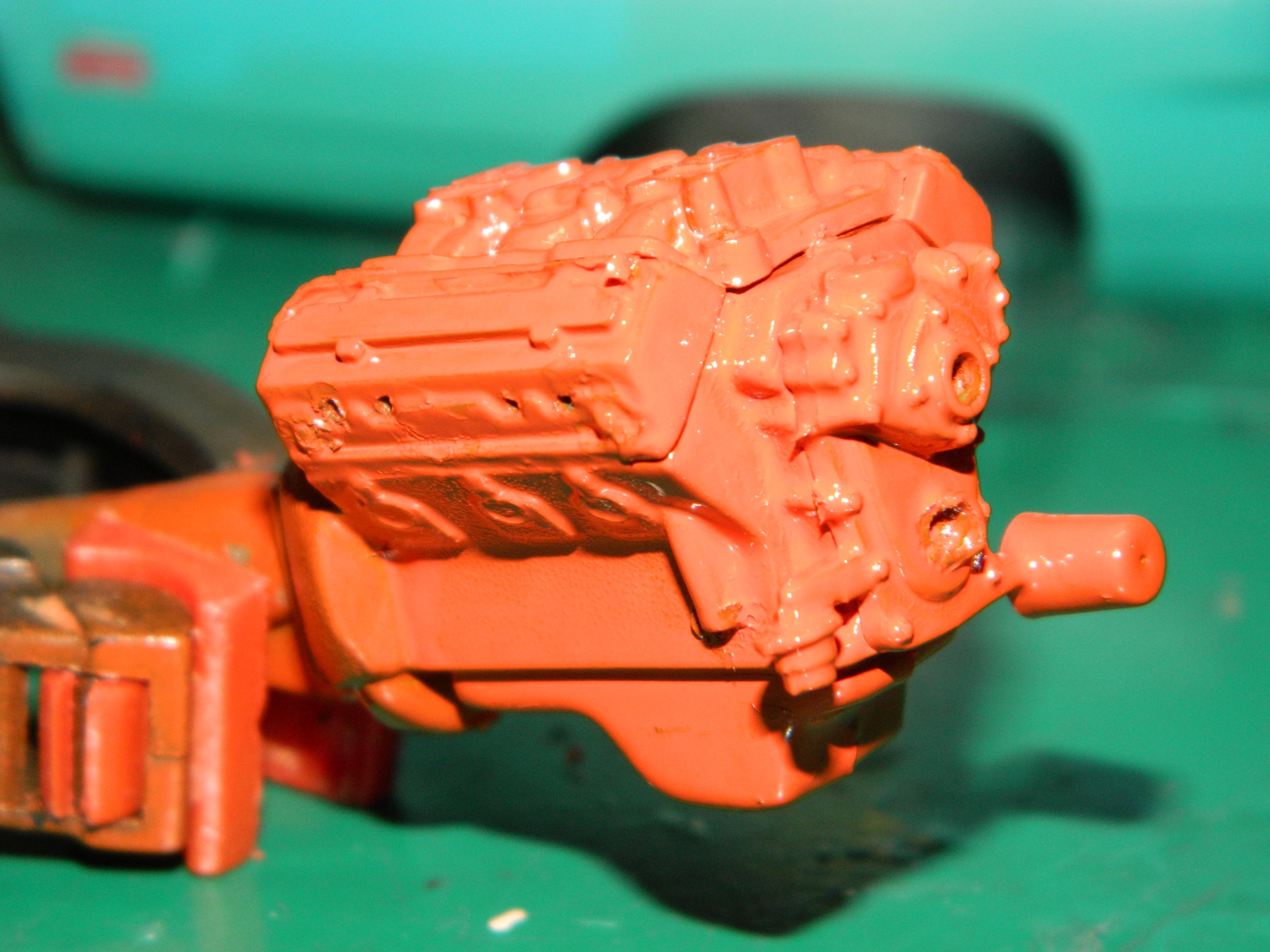

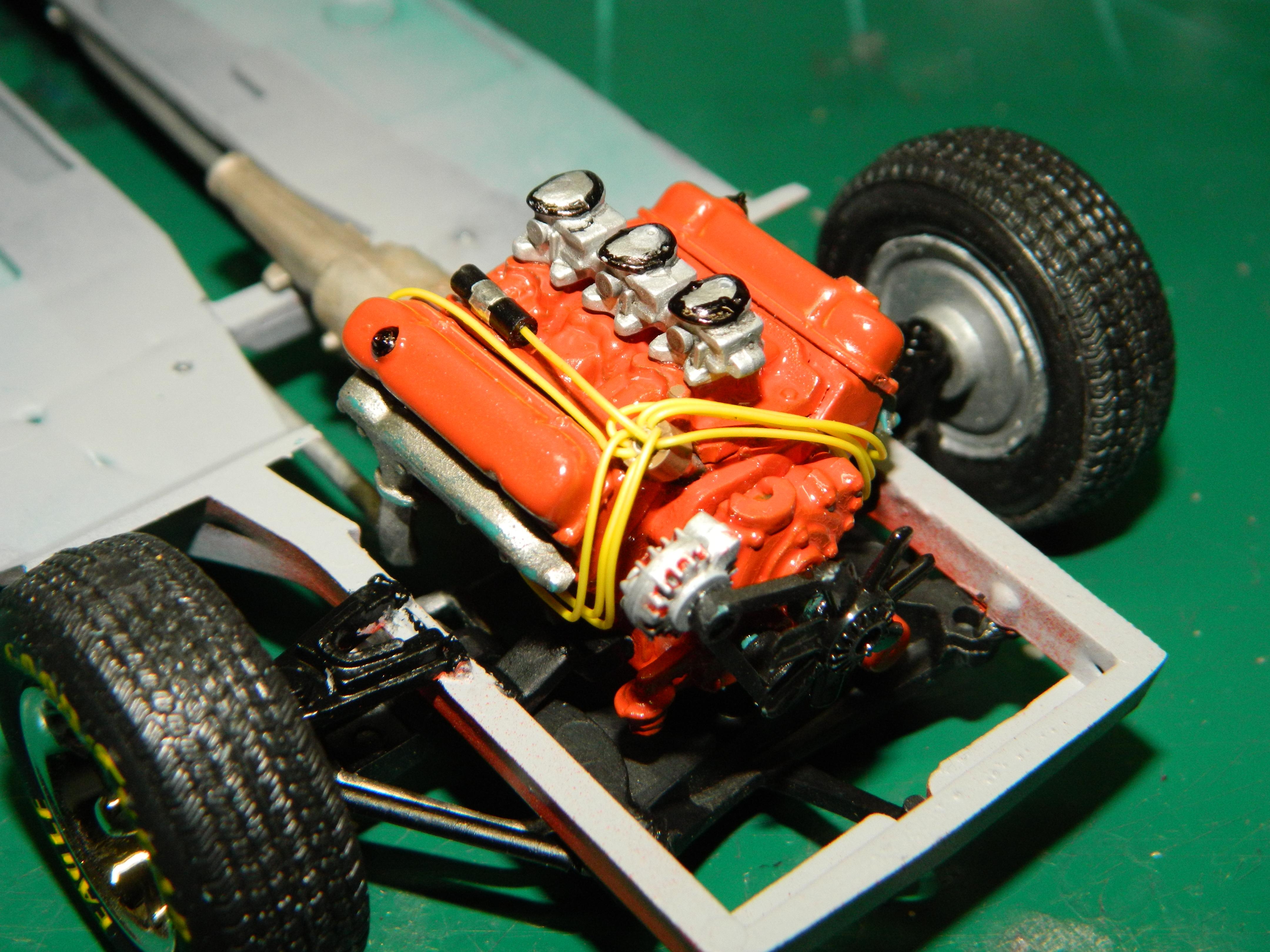

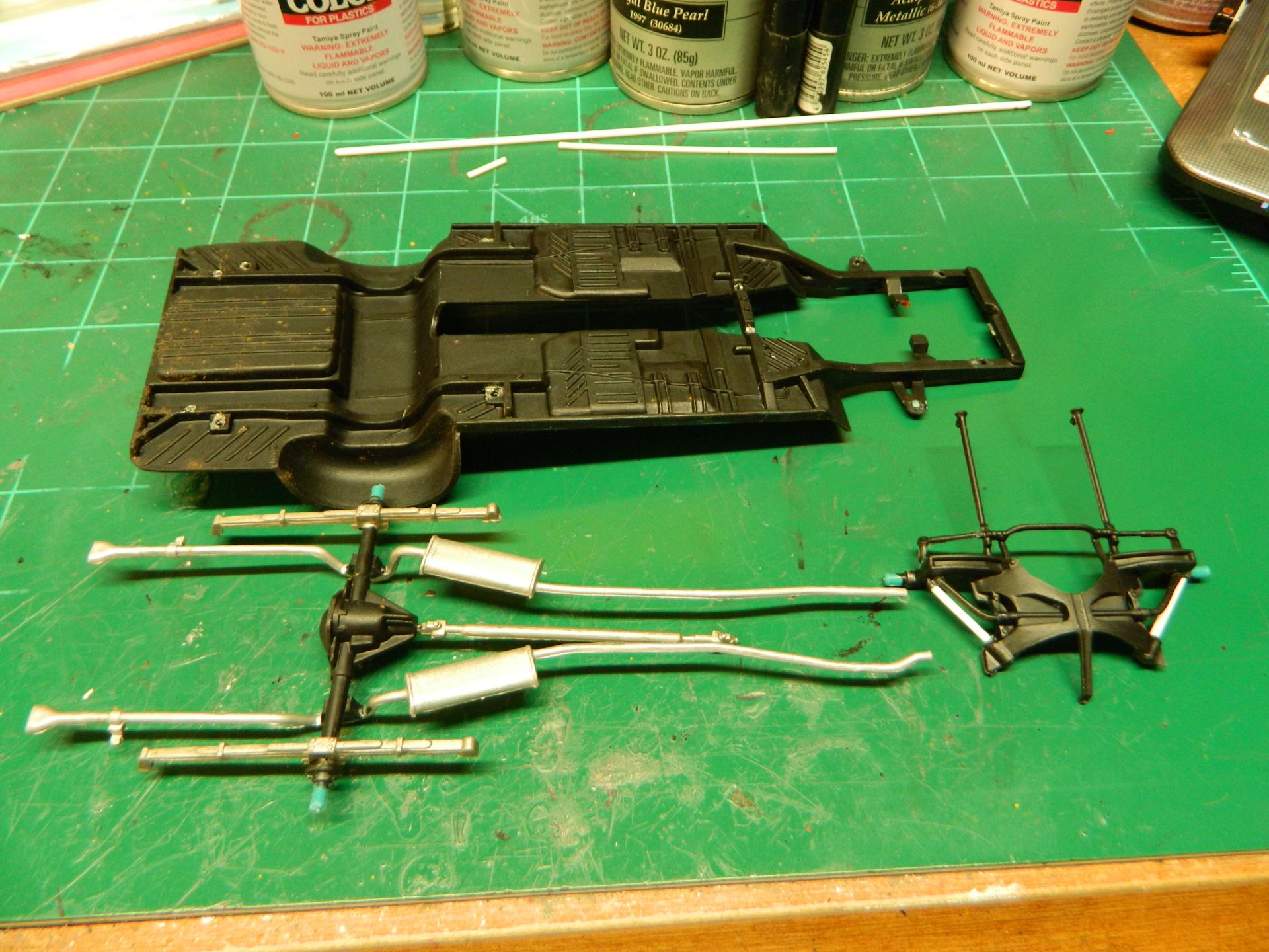

Maybe not the clearest picture, but you can see the round styrene I added under the rear wing supports.  When I removed them as part of deconstruction, I broke the pins.  This is to replace them.  I drilled the cylinder heads for plug wires and them I painted the engine with Mopar Street Hemi Orange Engine Paint.  I know, I usually do this procedure the other way around, so maybe there hope for me yet?

Hi Mike. Nice project. You mentioned the "Petty Blue" color when you stripped the chrome bumper. I built a Petty Superbird many years ago, and it was molded in blue, so I just clear coated it. I no longer have that model, but have a photo on my model site. It's near the bottom of the page.  http://www.shamblesmodels.com/race-cars.html

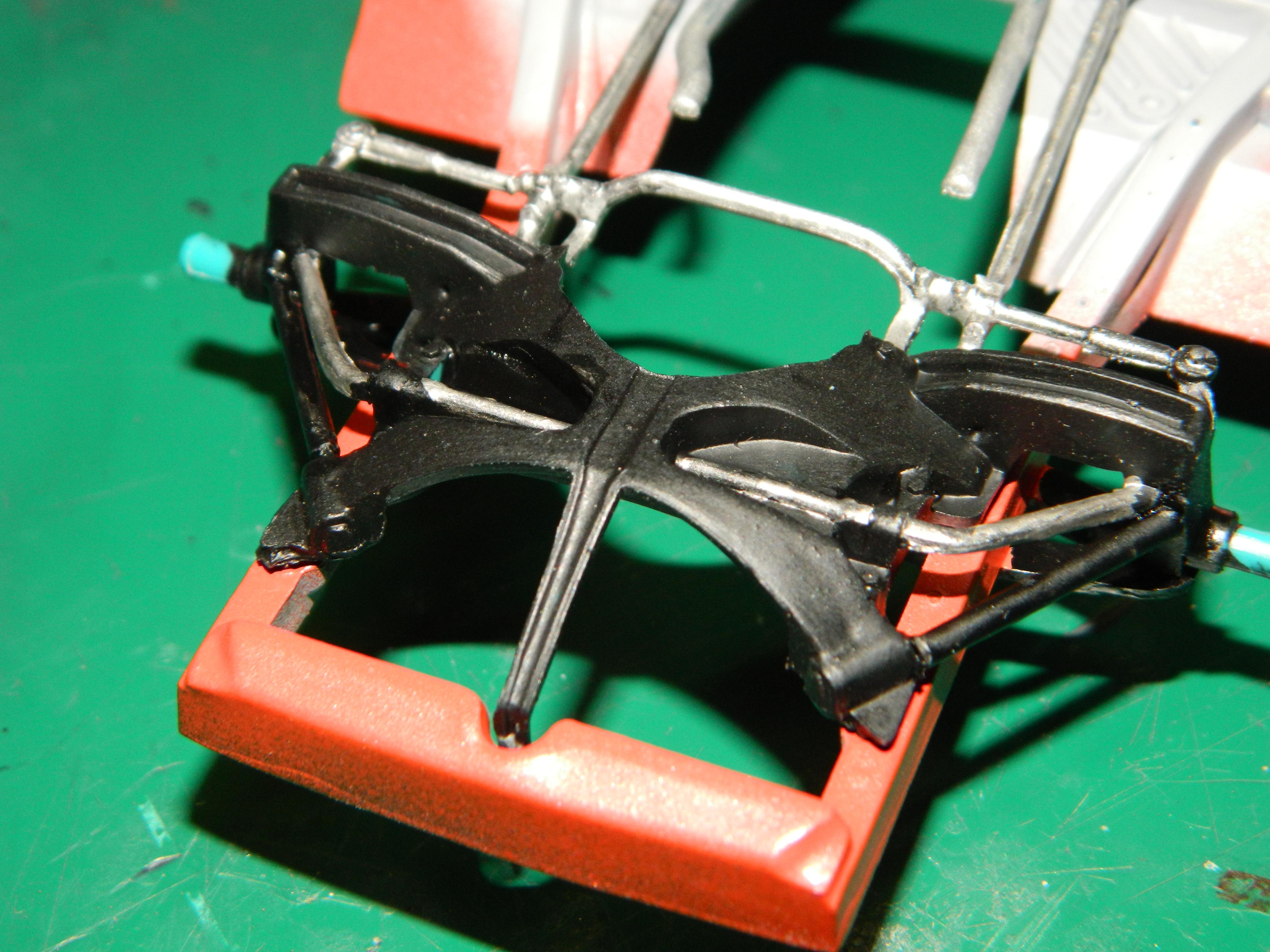

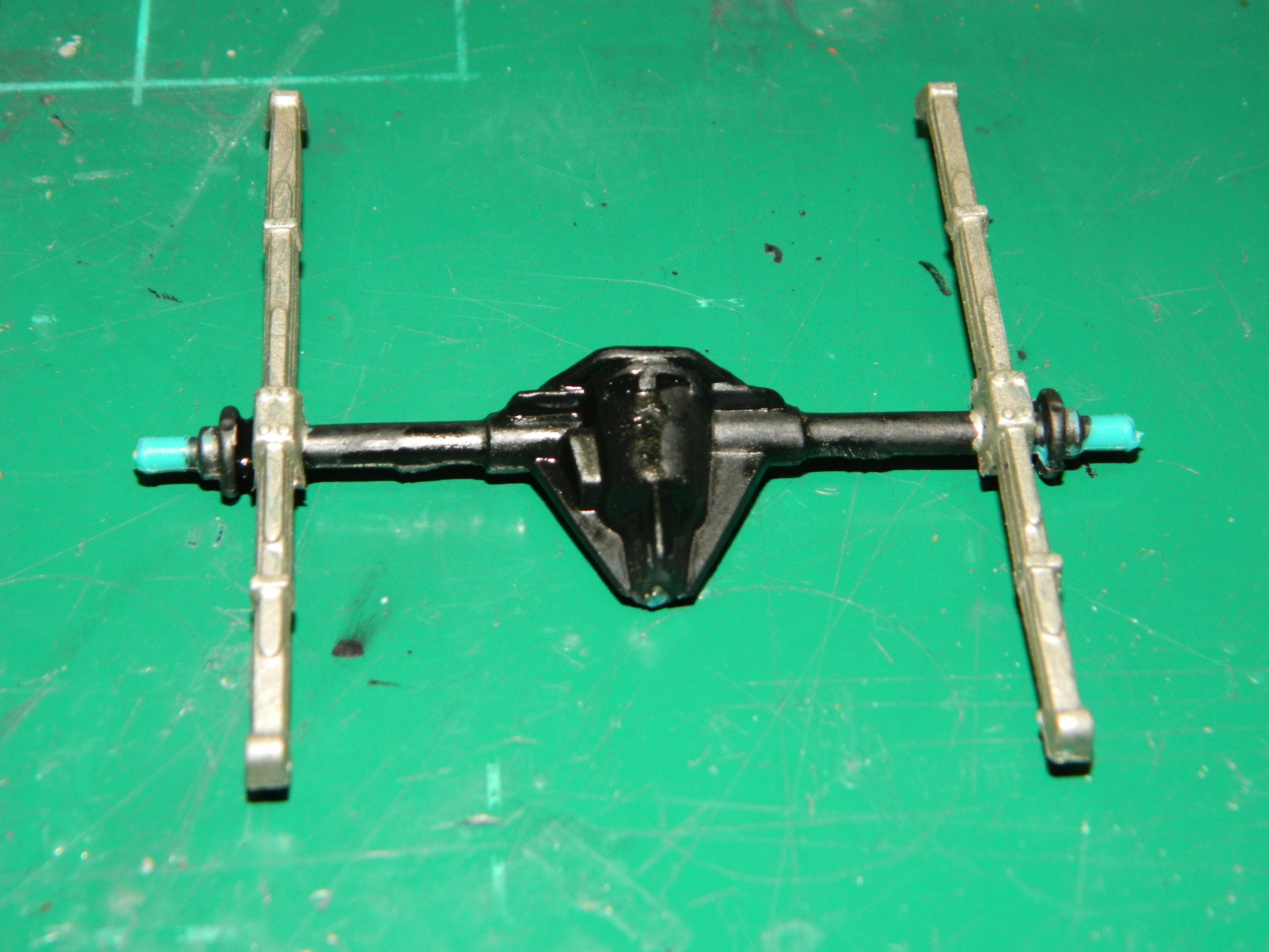

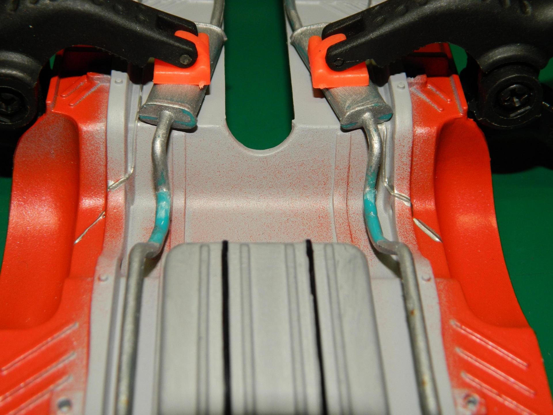

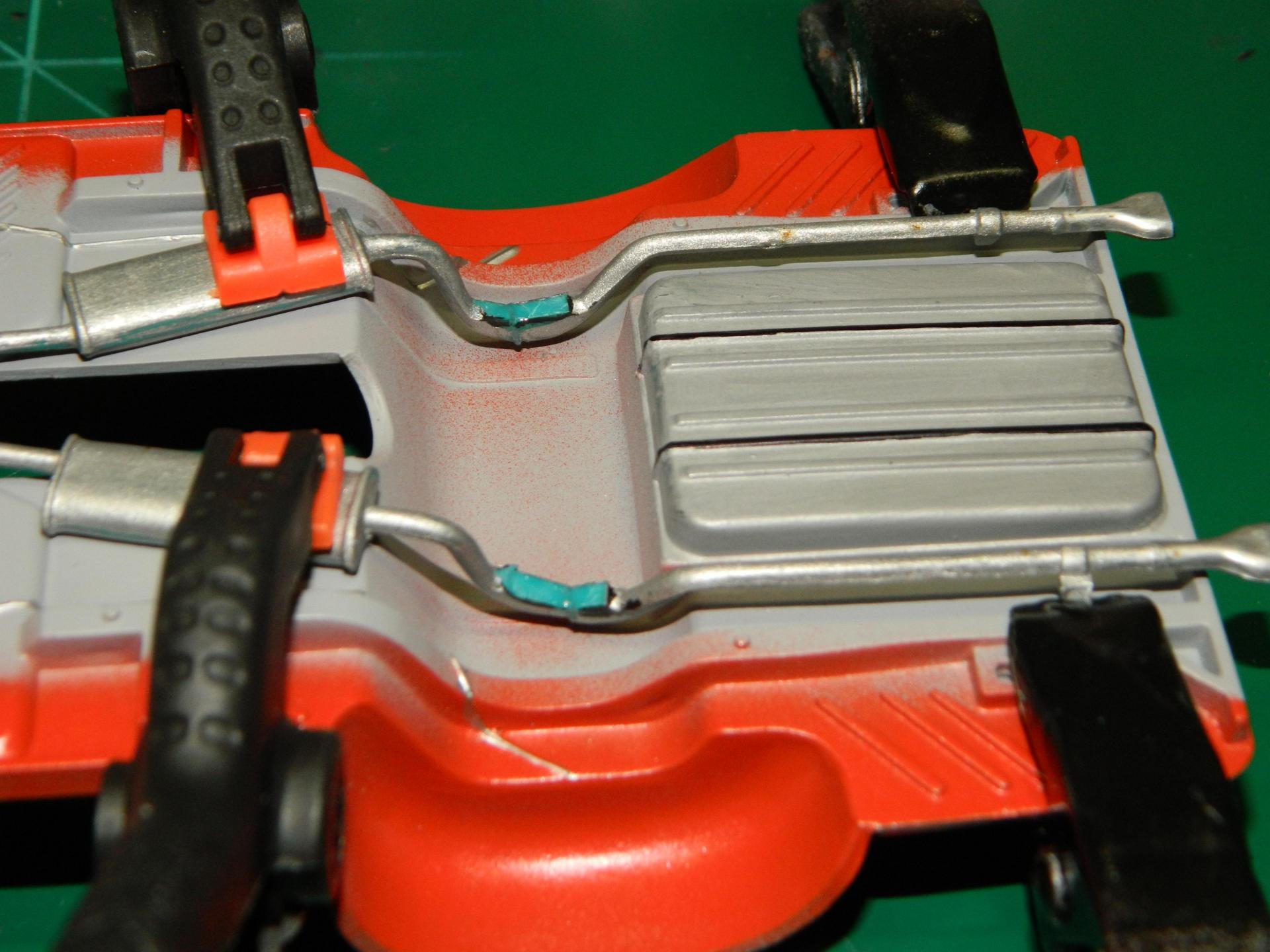

I removed the exhaust from the rear axle and of course, I broke them in two.  Using the chassis as a jig, I clamped the exhaust onto the chassis and glued the exhaust back together.  When they have dried, I'll remove them and clean up and paint the glue joint.  I repainted the front suspension and added it to the chassis.  I cleaned up the rear axle and repianted it.  I need to make a set of rear shocks and mounts since this kit doesn't include them.

I roughed up the surface with some sandpaper, washed and dried the body, primer and then paint.  What you are looking at is the colored plastic with an enamel clearcoat over it and the clearcoat yellowed over the years.

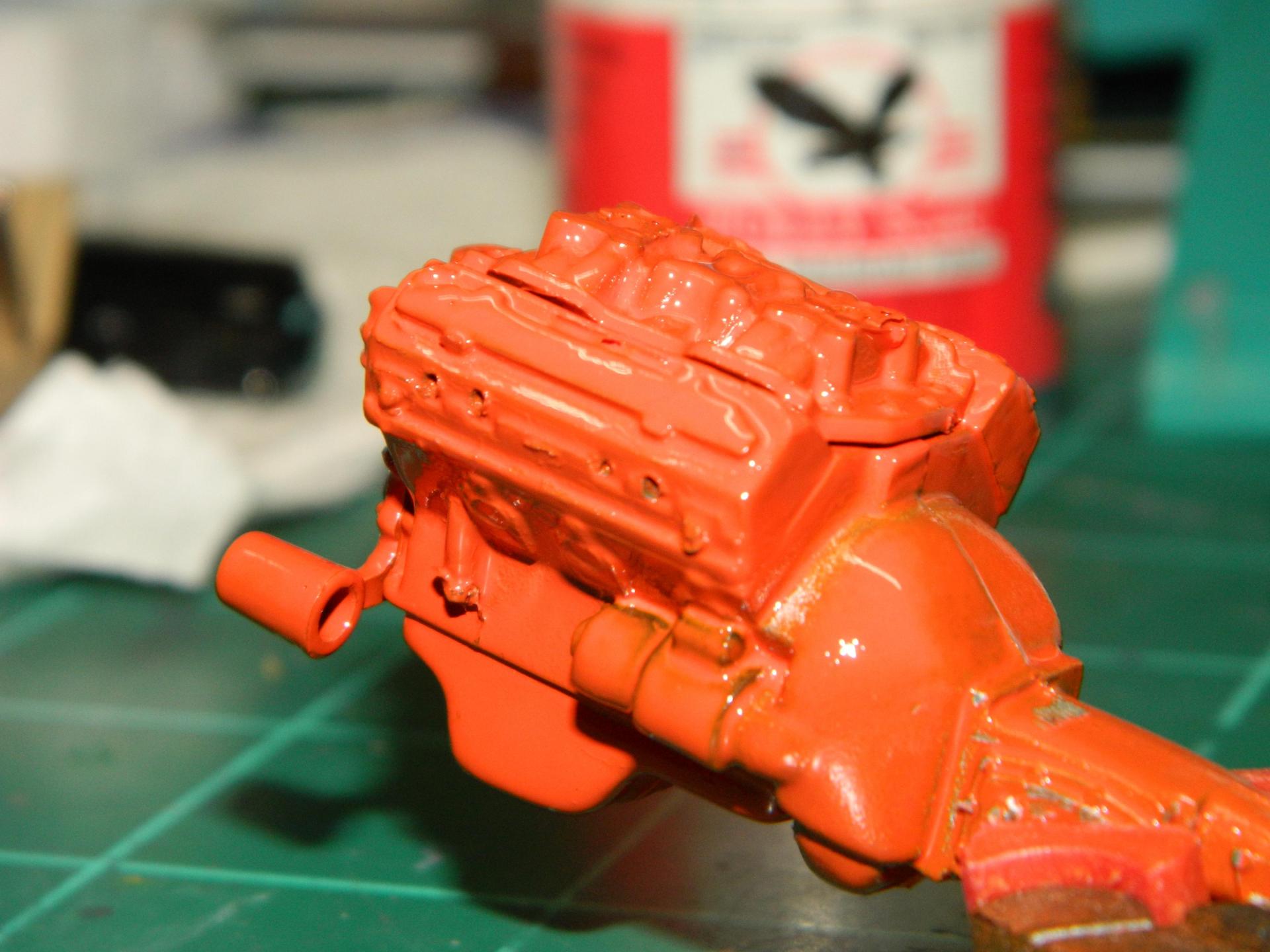

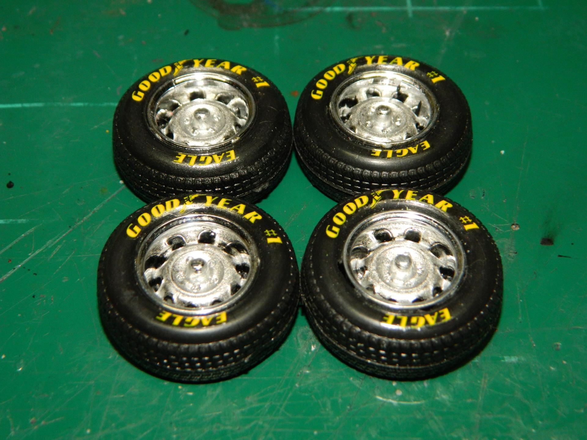

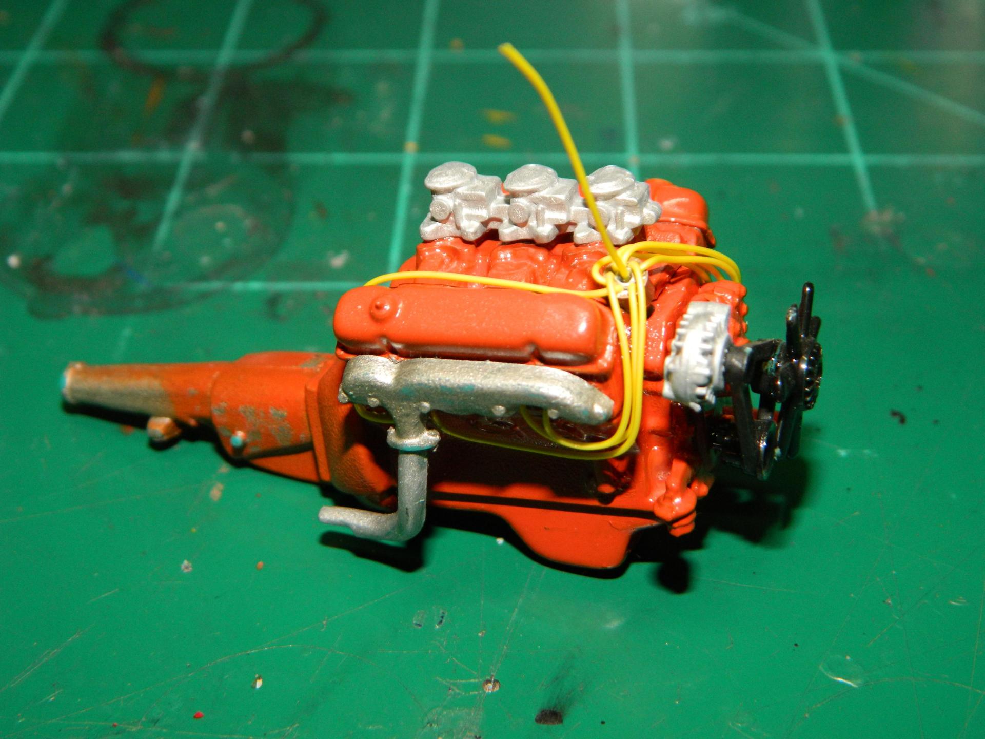

 I sat down this evening with my Dremel Motor Tool and started grinding the excess plastic from the exhaust pipes to get them round and generally the same size.  Then I mocked them up and applied a little more glue to help solidify the joints.  Tomorrow, I'll repaint the exhaust system.  The 440 6-Barrel has been painted and wired.  I'll detail the carbs and install the air filter when I have finished detailing that.  I wanted white letter tire markings, but I didn't have any.  I remembered these yellow tire letters from my trips to NNL East and I cut them out, dipped them in water and applied them to the tires.  Tomorrow, I'll coat them with flat clearcoat.

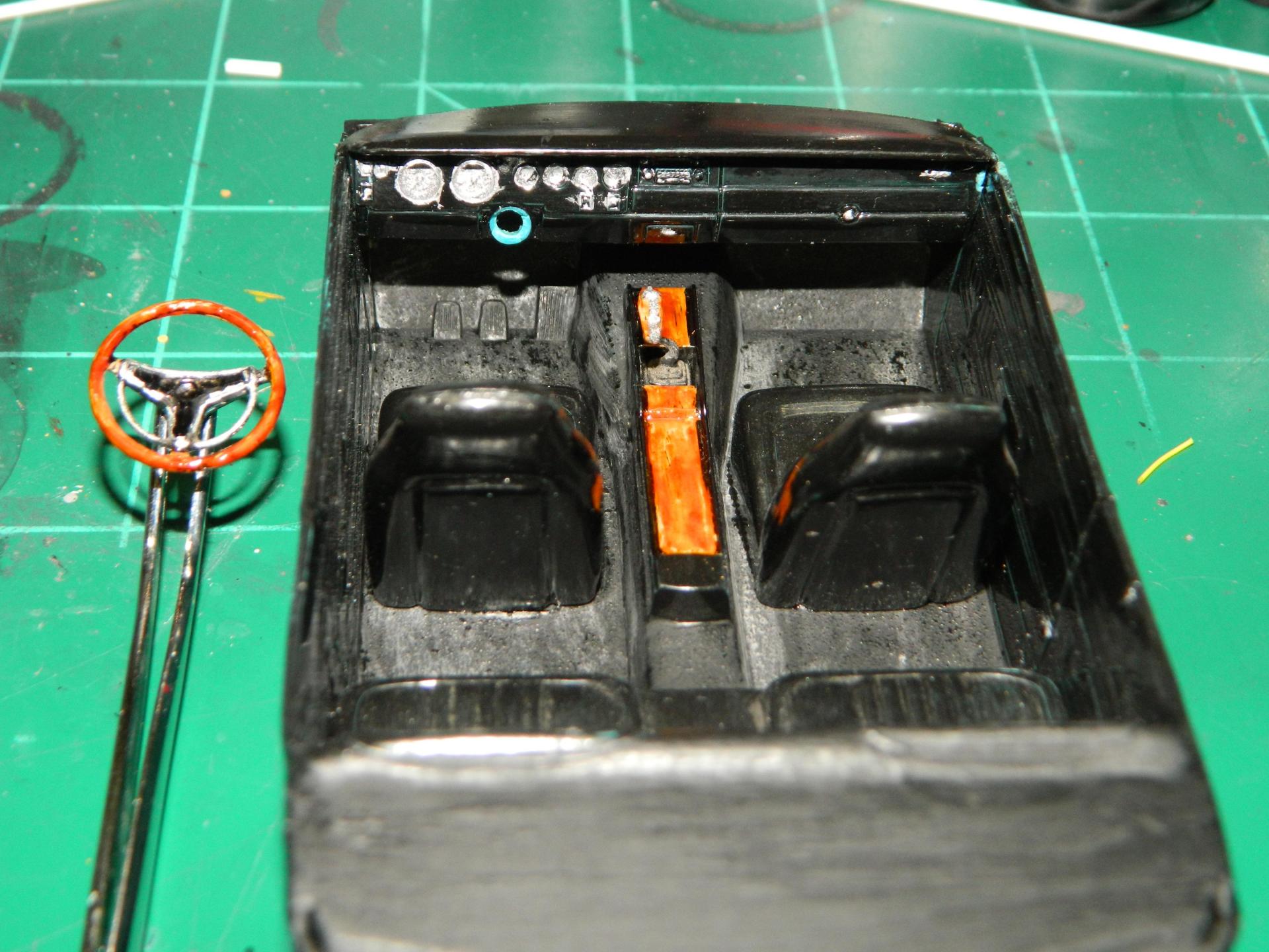

I finally got my decals today from KWT.  Thanks KWT!!!  I've been picking away at the interior.  Still more detail to add.  The 440 6-Barrel is nearly done.  I painted the air cleaner with Testors Competition Orange enamel paint and it is in the dehydrator until tomorrow.  It should be dry by then.

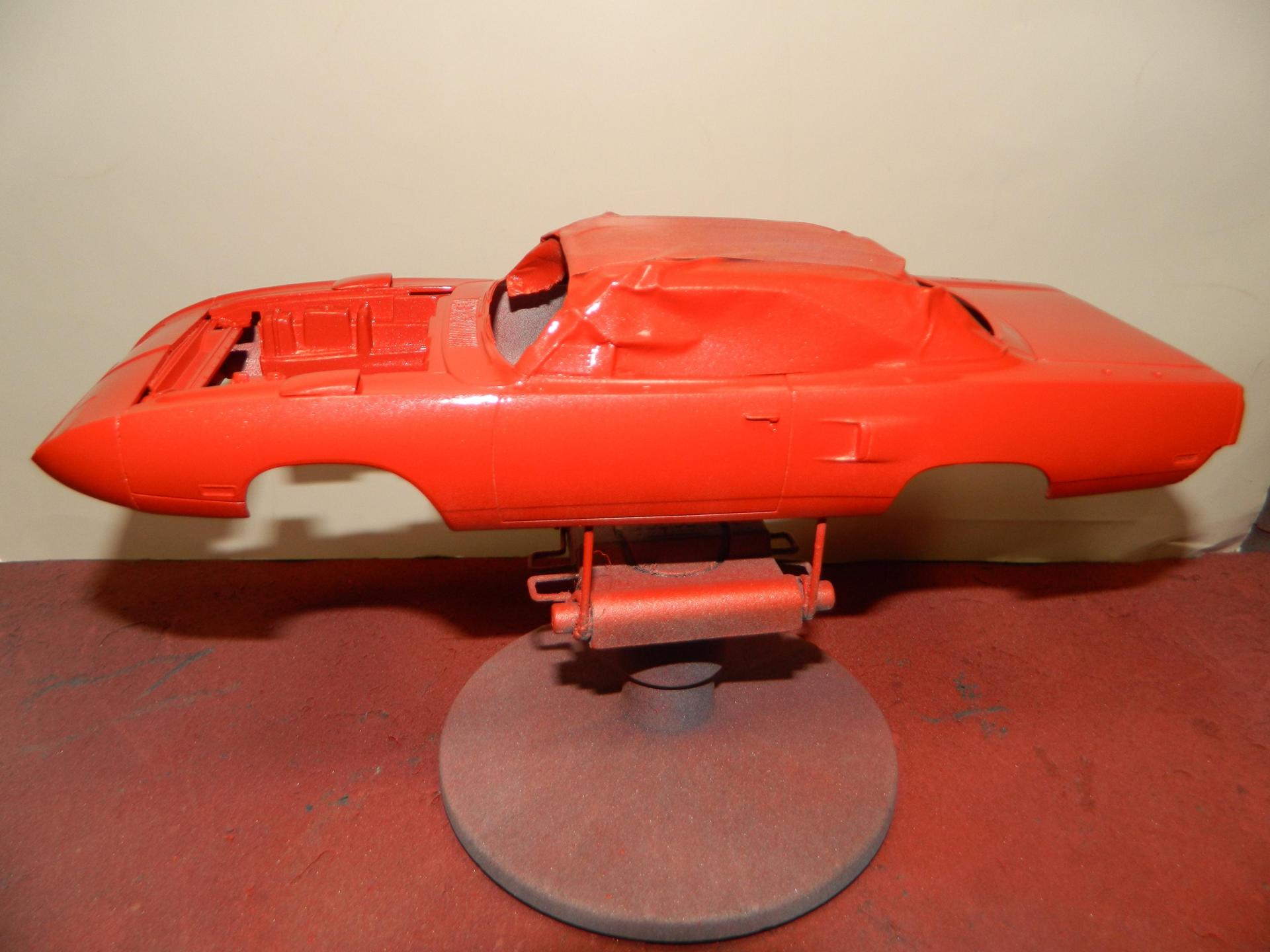

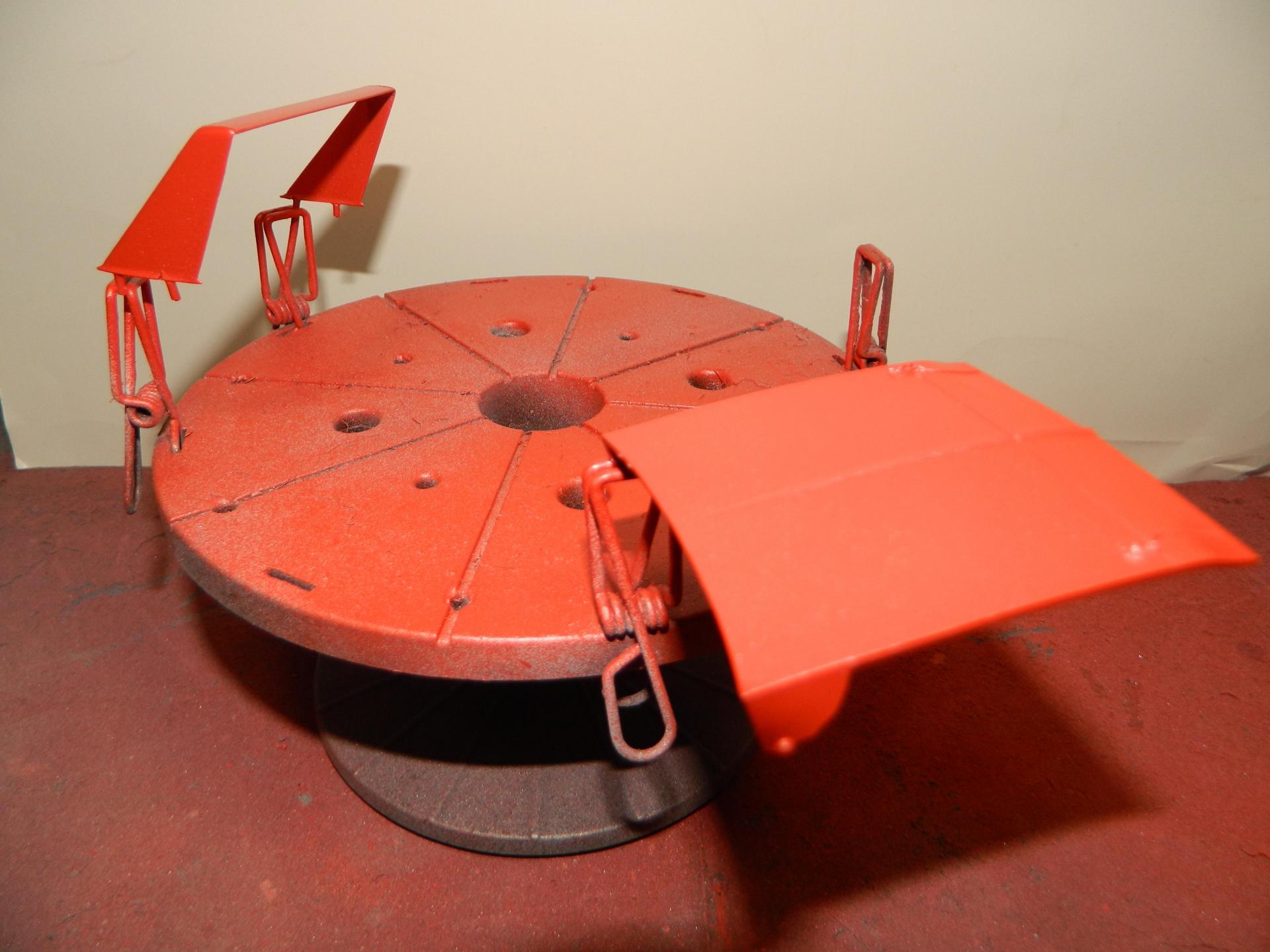

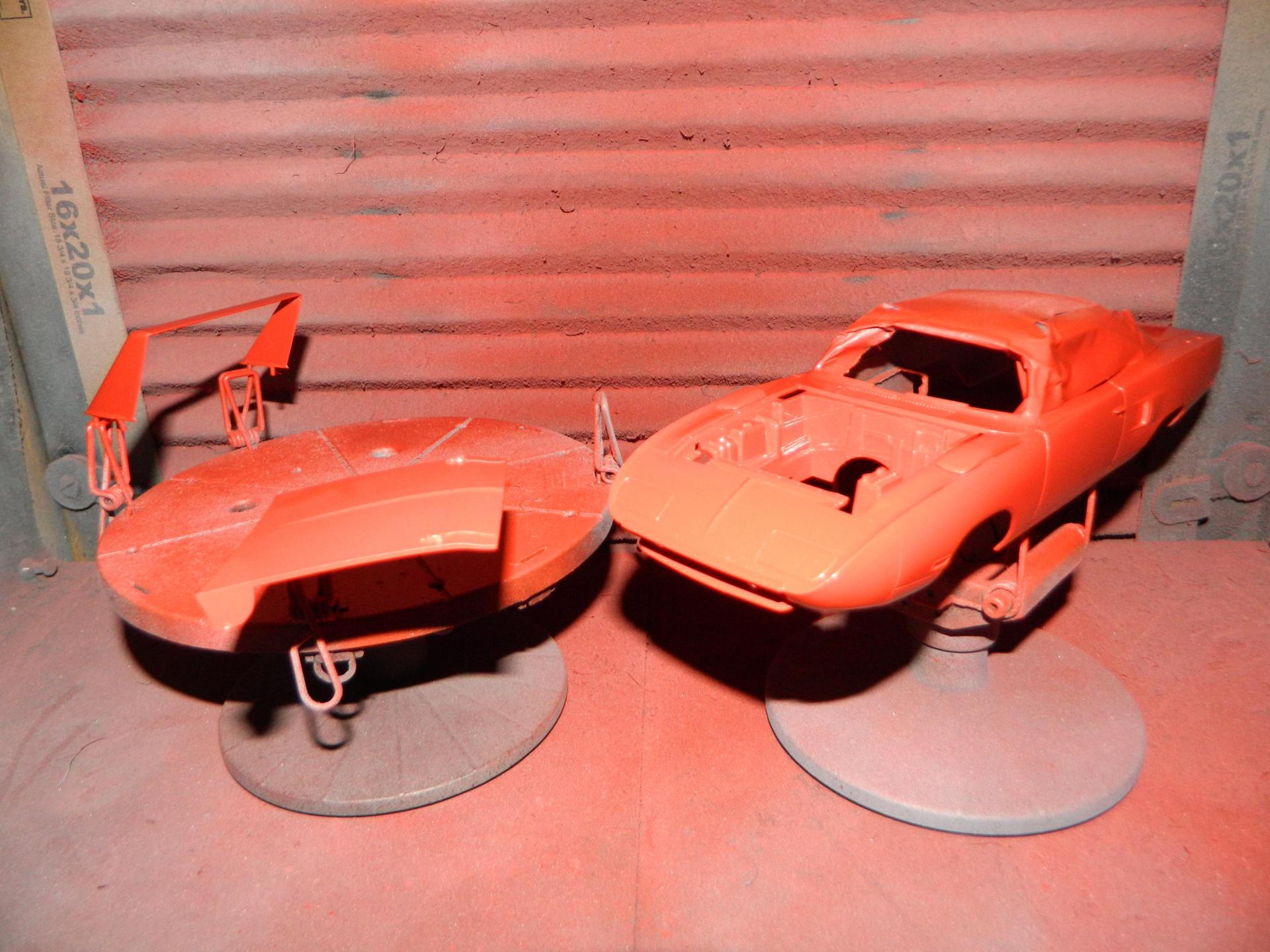

I painted the Superbird this afternoon.  Model Master Hemi Orange aka Mopar Tor-Red.
