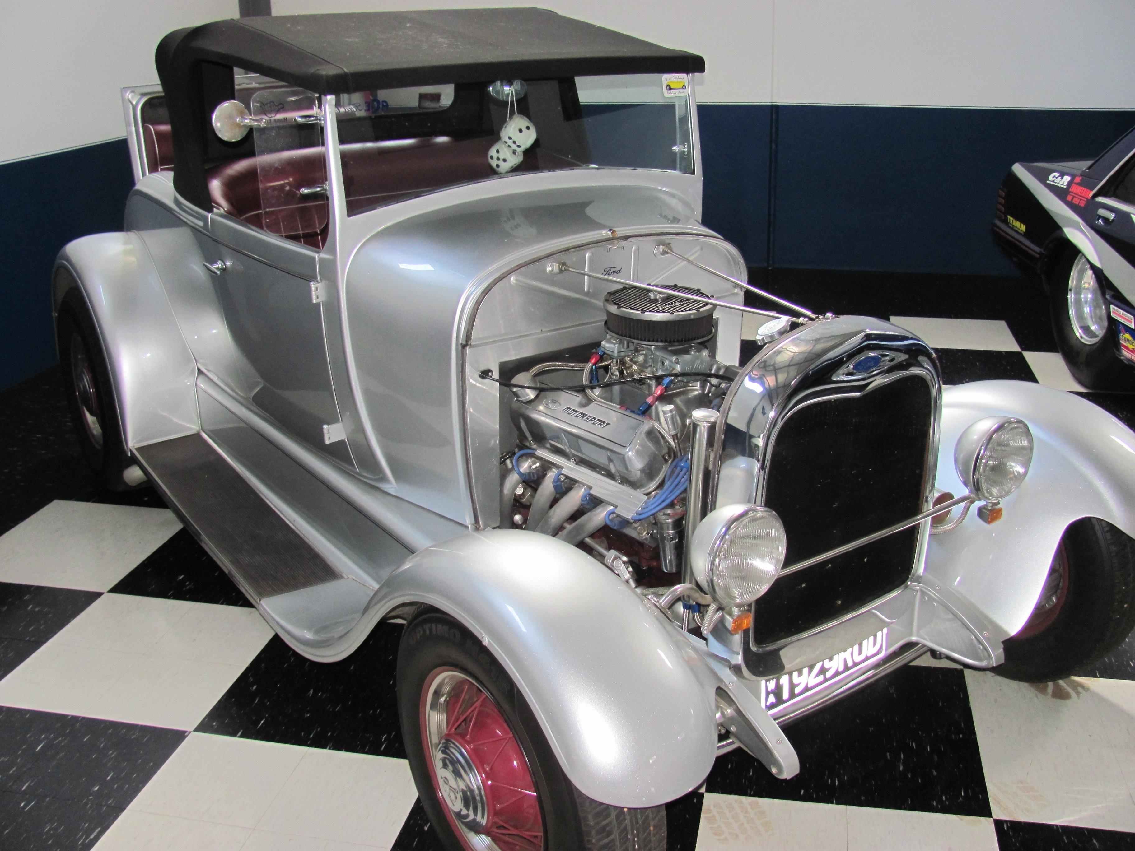

Really like where this is going but for what it's worth, I reckon she could really do with some rubber rake.  You don't sound convinced on your wheel choice but I think it is more likely the tyre selection that is giving you a bad vibe.  Fill those back fenders up, tilt her nose down and her bum up and I reckon this will pop!
  If it still needs some help, try gluing a 1/24th scale inner rim to the outside of your rears to give them a bit more depth and offset.
On the other hand, a fellow rod club member here in Western Australia built the Model A below about ten years ago. Silver with an oxblood interior and his wires are maroon with dress rings.  Maybe that would work?
Cant' wait to see this done!
