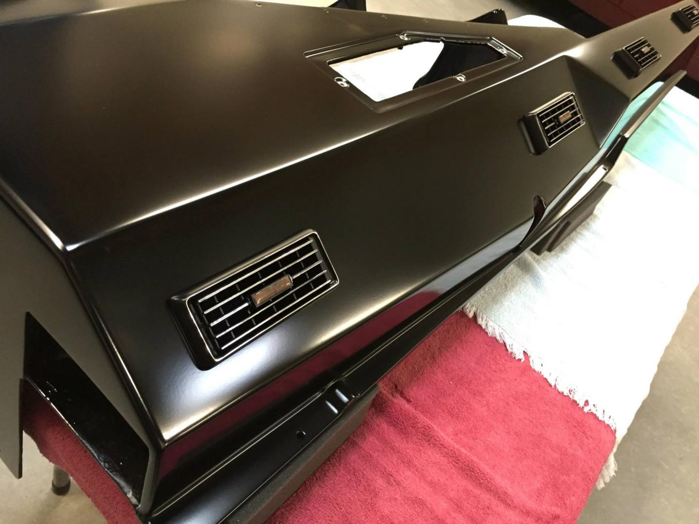

Yahshu Posted August 8, 2019 Share Posted August 8, 2019 As I've taken it upon myself to try to do a correct dash for the K100 Aerodyne, I'm stuck on the airvents, build one & cast from there seems to be the logical way to go but how to build a master so small, any & all ideas are greatly appreciated. Quote Link to comment Share on other sites More sharing options...
StevenGuthmiller Posted August 8, 2019 Share Posted August 8, 2019 You could try looking for a grill from another kit that has evenly spaced "slats" about the right size as pictured. From there just make a "frame" to place it in and the button in the middle. Once you have a master you can cast as many as you need. Steve Quote Link to comment Share on other sites More sharing options...

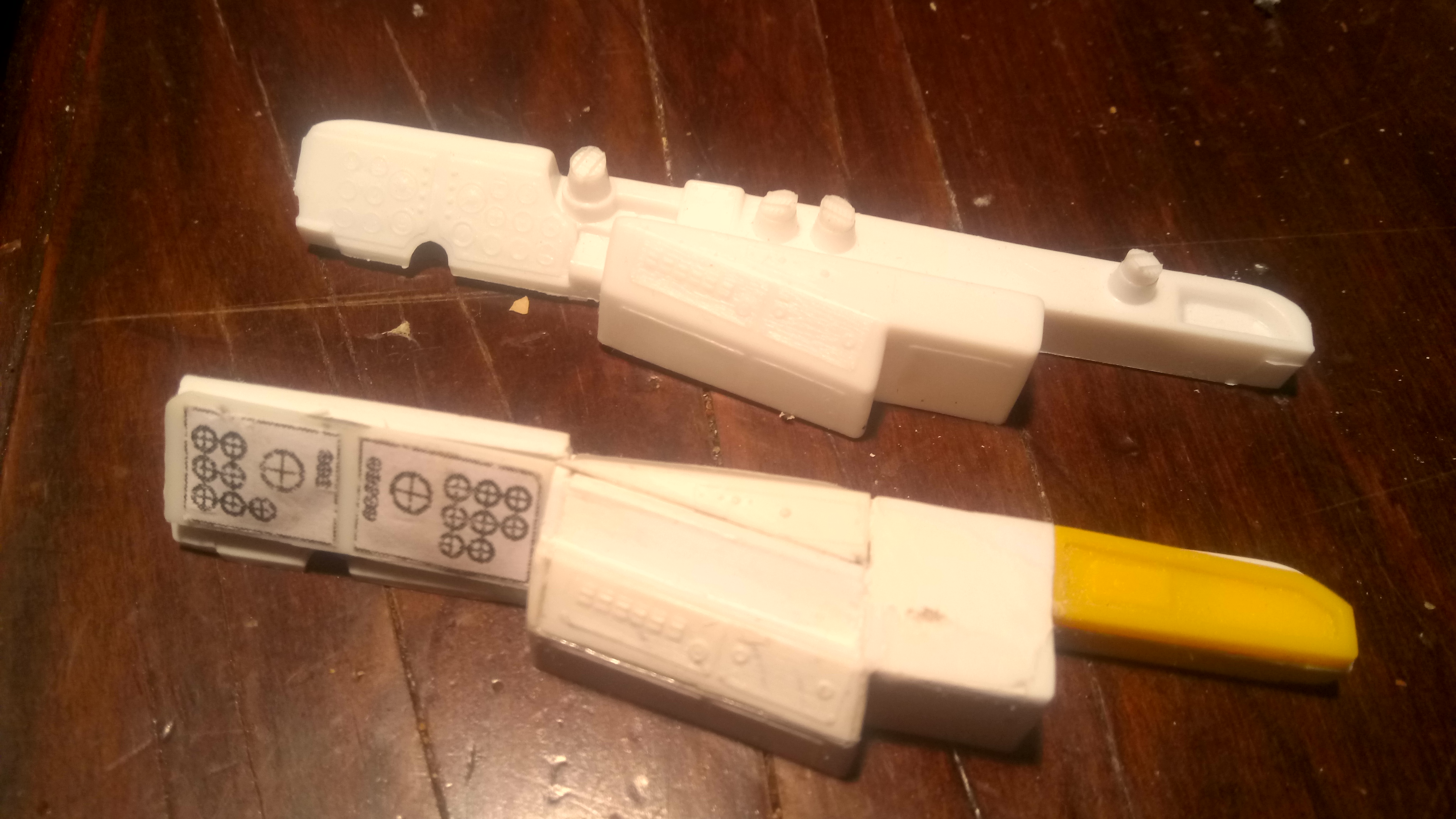

Yahshu Posted August 10, 2019 Author Share Posted August 10, 2019 (edited) So many excellent ideas. Thank you all very much. Unfortunately measurements are not available at present. 3D printing would certainly be easier if I had the patience & know how. Brass is the way I have thought of, photo etch top on a block would also work but alias, no photo etch making skills. I have a friend who is able to cad design the instrument panels which I was going to glue to aluminium plate & cut & drill, add wood grain decal & Scale Production "O's" for instrument bezels. Need to get the instruments reduced to scale also. I have sent a email to Jan @ CTM this evening to see if he may now be interested in doing the instrument panels now that someone is doing a dash, we'll what happens, he may be able to do photo etch airvent faces. This is where I'm up to at present. & this is my entire model collection these days so there's not much to savage parts from. Edited August 10, 2019 by Yahshu Quote Link to comment Share on other sites More sharing options...

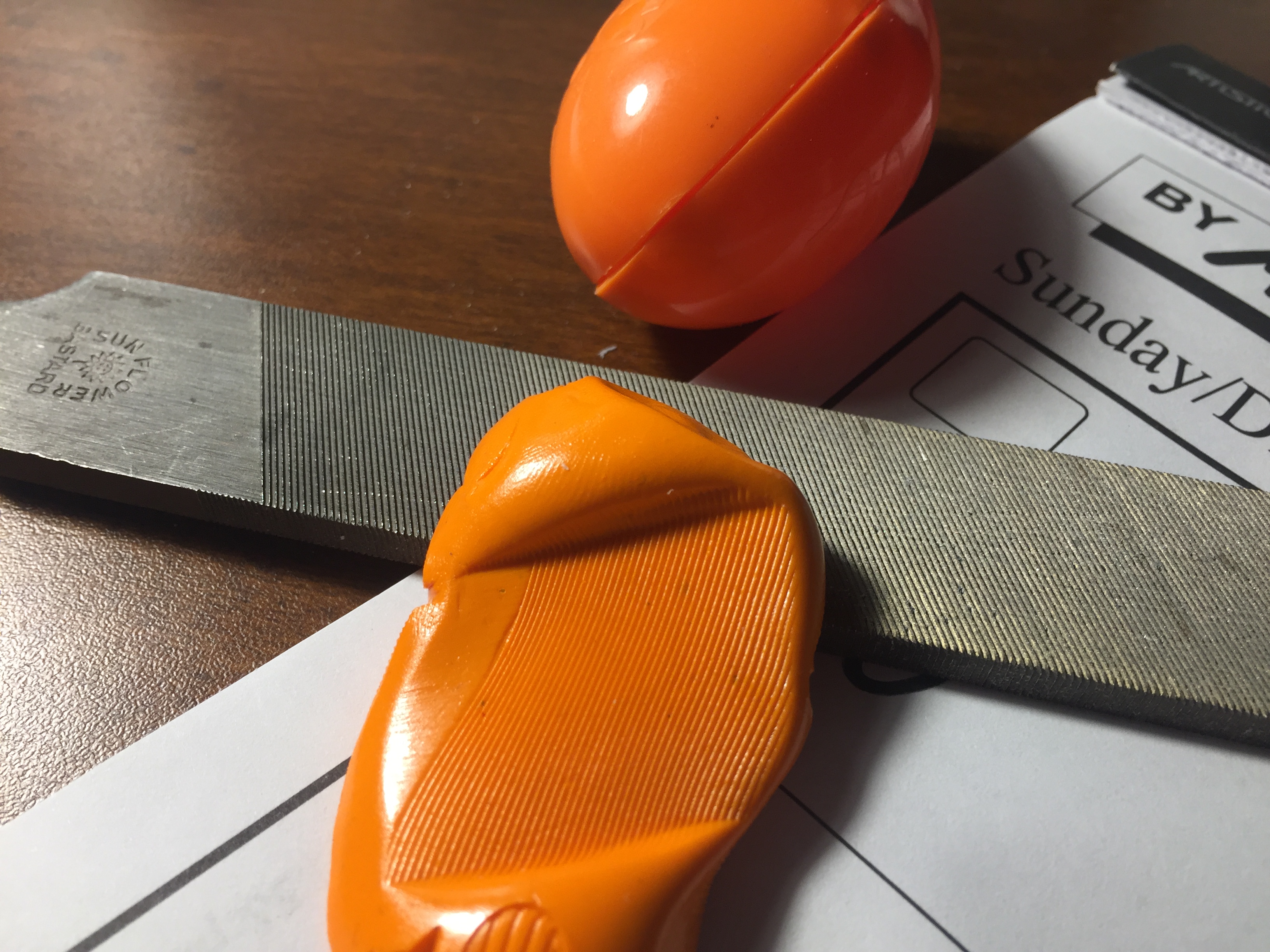

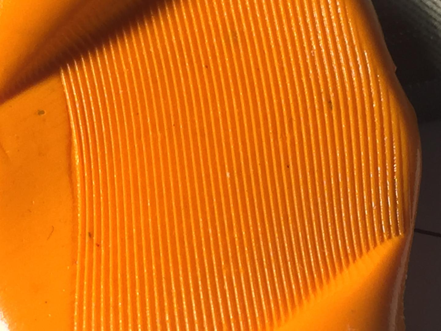

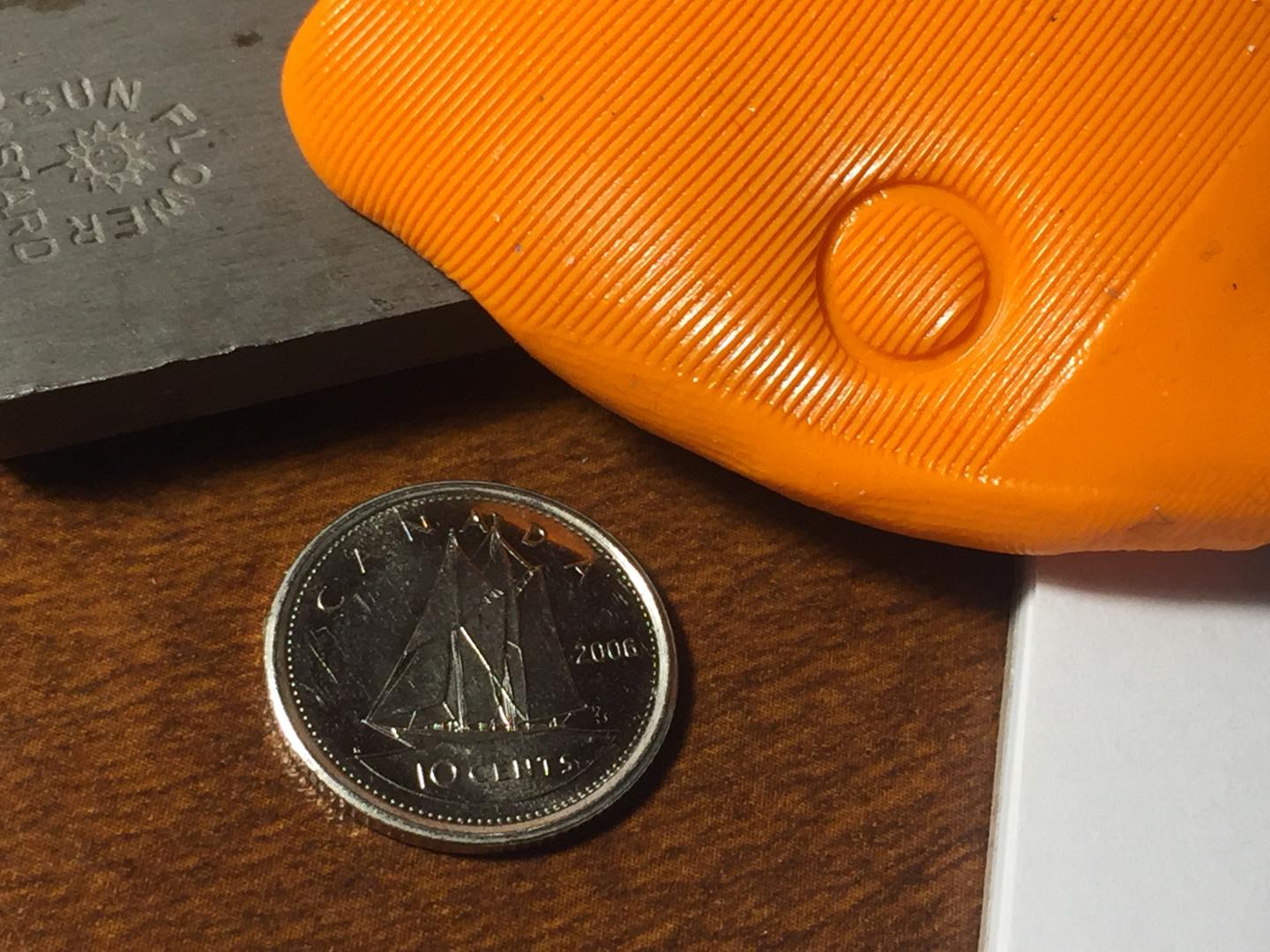

NOBLNG Posted August 10, 2019 Share Posted August 10, 2019 (edited) 16 hours ago, StevenGuthmiller said: Let's put on our thinking caps. Steve How about making a cast of a large metal file to get the basic louver pattern? This is just silly putty to get an idea of what the impression would look like. Edited August 10, 2019 by NOBLNG Quote Link to comment Share on other sites More sharing options...
Yahshu Posted August 10, 2019 Author Share Posted August 10, 2019 (edited) 1 hour ago, NOBLNG said: How about making a cast of a large metal file to get the basic louver pattern? This is just silly putty to get an idea of what the impression would look like. & we have a winner, awesome, so simple yet so effective, just sand 5 ribs at each end a little to knock the height off then put maybe a piece of brass on each end to cap it off. Thank you NOBLING. OK, next question please, can I pour Zap Z-poxy PT-41 casting resin directly onto silly putty & take a mold off the pattern? Edited August 10, 2019 by Yahshu Quote Link to comment Share on other sites More sharing options...
Snake45 Posted August 10, 2019 Share Posted August 10, 2019 5 hours ago, NOBLNG said: How about making a cast of a large metal file to get the basic louver pattern? This is just silly putty to get an idea of what the impression would look like. Fabulous! I'm gonna totally steal this trick to make some custom taillights. Only thing I'd add is, use a NEW file to make sure you haven't got any nicks. 4 hours ago, Yahshu said: OK, next question please, can I pour Zap Z-poxy PT-41 casting resin directly onto silly putty & take a mold off the pattern? Silly Putty will "melt" out at room temperature. Maybe put it in the fridge for a bit, or even let the casting cure right in the fridge. Quote Link to comment Share on other sites More sharing options...
