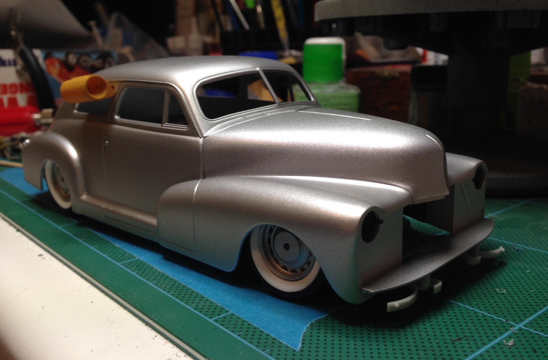

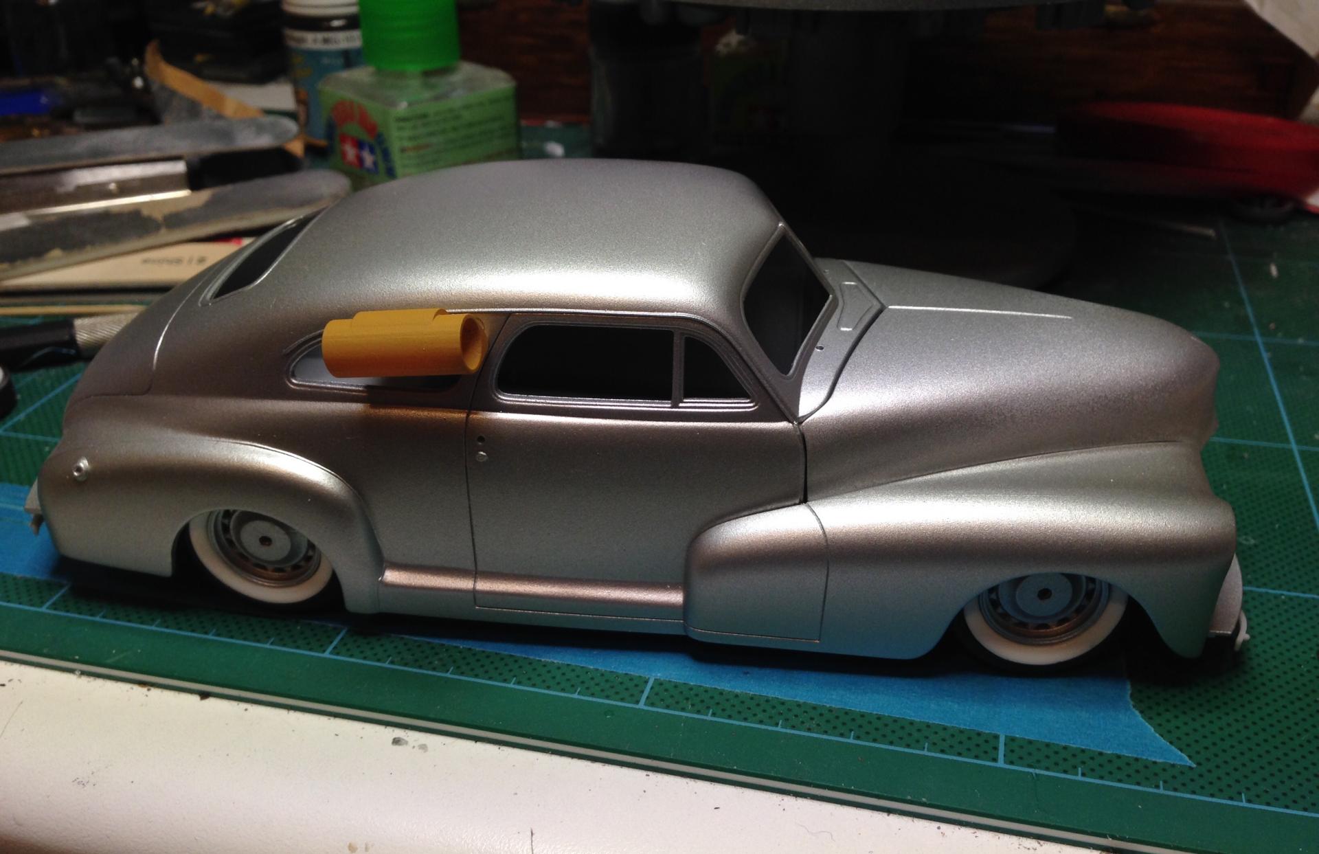

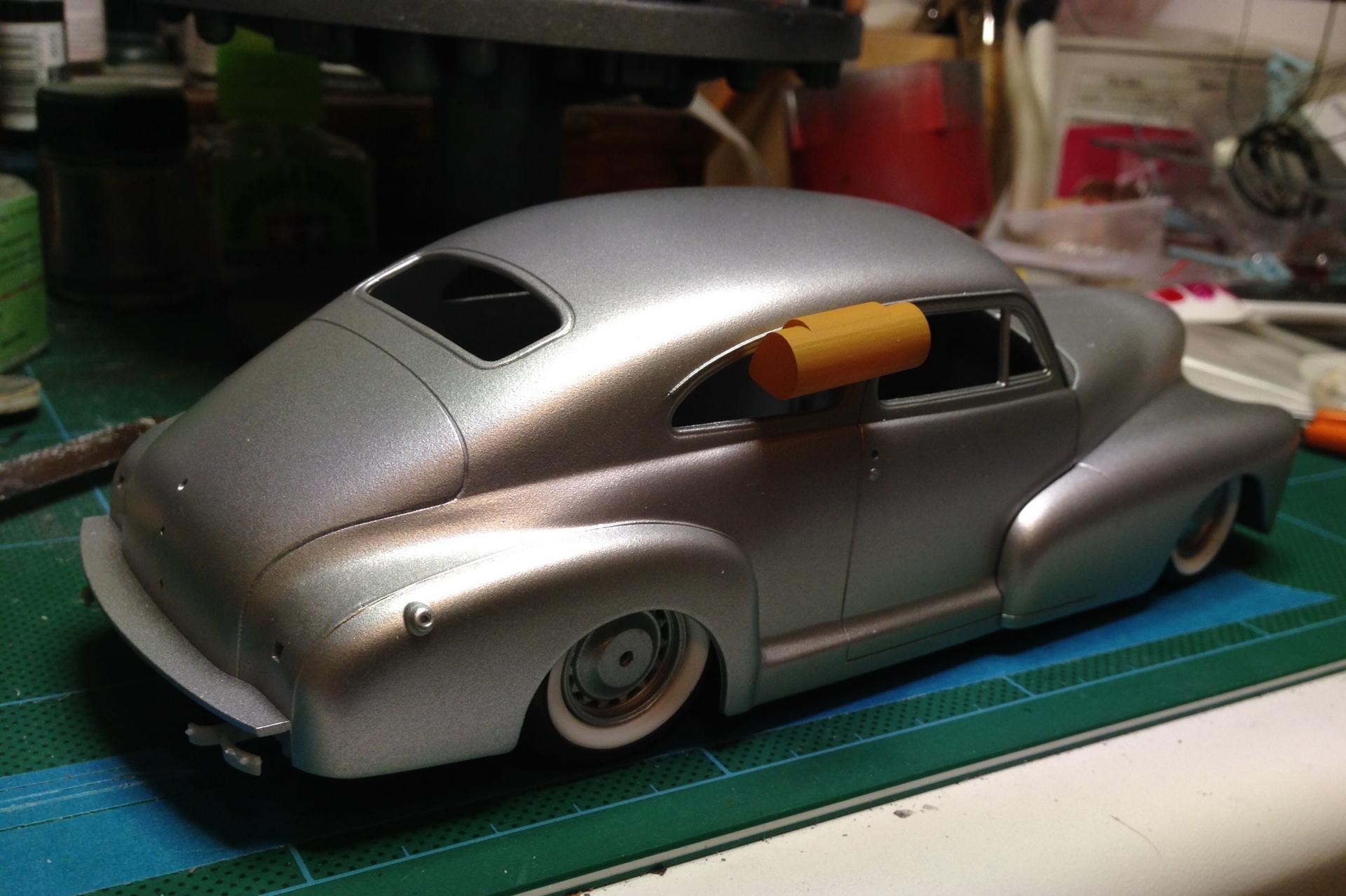

geetee66 Posted August 12, 2019 Share Posted August 12, 2019 I love the shape of these cars and this Galaxie Ltd. kit is lovely to work with. got a swamp cooler 3D printed by Shapeways in the Netherlands, artillery wheels from The Parts Box, in Australia. Roof n fenders will be candy red and the hood and sides will be white gold. Quote Link to comment Share on other sites More sharing options...

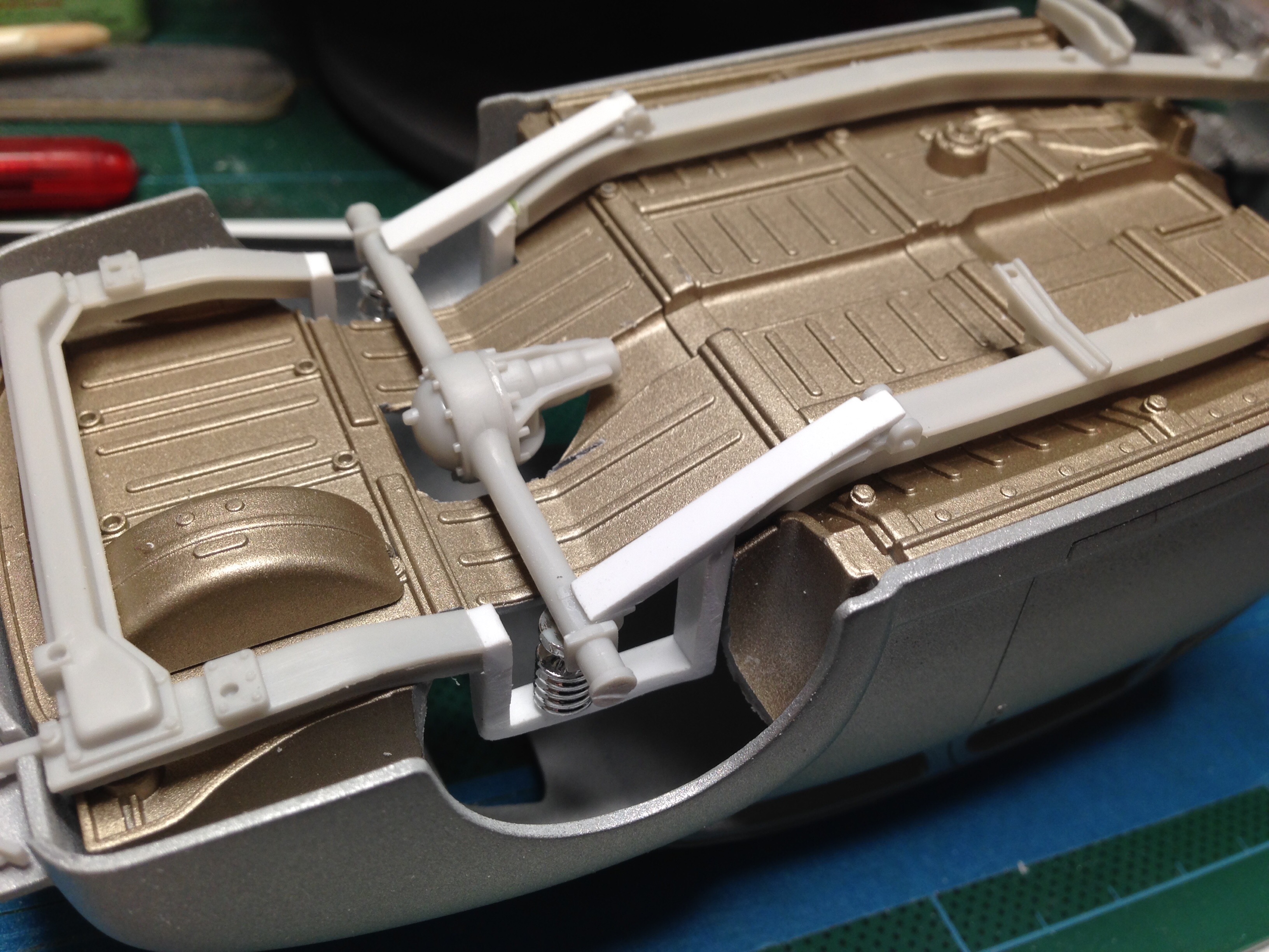

geetee66 Posted August 12, 2019 Author Share Posted August 12, 2019 The rear of the chassis needed some work to get the tail properly low. Some of the inner arches needed cutting away and clearance was required for the rear axle differential. more tweaking needed but this is it so far: Quote Link to comment Share on other sites More sharing options...

espo Posted August 12, 2019 Share Posted August 12, 2019 I agree on the shape of these early Chevrolets. A couple of thoughts on the chassis. I foresee that the drive shaft tunnel may have to be raised to clear the drive shaft with the rear suspension set so low. Not sure if this is the final rid height for the rear suspension but the lower control arms are resting on the frame and leave no suspension travel. Looking at the finished model up on all four tires this wouldn't show but if you are displaying the chassis at all it would be visible. I like the old water cooler on the side window, these worked better than you might think especially with some ice in the water. Quote Link to comment Share on other sites More sharing options...
dino246gt Posted August 12, 2019 Share Posted August 12, 2019 Here's the part to be removed, some styrene added then re-installed to clear the driveshaft and the diff. I also "mini-tubbed" it, sliced the inner fenders, added styrene then re-installed them: Quote Link to comment Share on other sites More sharing options...

geetee66 Posted August 12, 2019 Author Share Posted August 12, 2019 2 hours ago, espo said: I agree on the shape of these early Chevrolets. A couple of thoughts on the chassis. I foresee that the drive shaft tunnel may have to be raised to clear the drive shaft with the rear suspension set so low. Not sure if this is the final rid height for the rear suspension but the lower control arms are resting on the frame and leave no suspension travel. Looking at the finished model up on all four tires this wouldn't show but if you are displaying the chassis at all it would be visible. I like the old water cooler on the side window, these worked better than you might think especially with some ice in the water. Cheers Espo I've got a parts box driveshaft with extra universal joints that can get around the driveshaft issue. The ride height is going to be 'parked in the weeds', so suspension travel isn't an issue here. Quote Link to comment Share on other sites More sharing options...
geetee66 Posted August 12, 2019 Author Share Posted August 12, 2019 (edited) 2 hours ago, dino246gt said: Here's the part to be removed, some styrene added then re-installed to clear the driveshaft and the diff. I also "mini-tubbed" it, sliced the inner fenders, added styrene then re-installed them: Thanks for taking the time to show me how you did yours. I found that I needed to completely remove the tops of the arches or the tyres hit them. The wheels came with big n little tyres, but it would probably have been better to get all four in the smaller size. It would've made life easier, but fat rears look so much better, I reckon. The 3D printed cooler had more surface lines than I had hoped for, but the plastic is quite hard (much harder than styrene) and responds well to files and 1200 grit wet n dry. ps I like the tiny nuts n bolts on your front suspension. It looks like it operates ? Edited August 12, 2019 by geetee66 Quote Link to comment Share on other sites More sharing options...

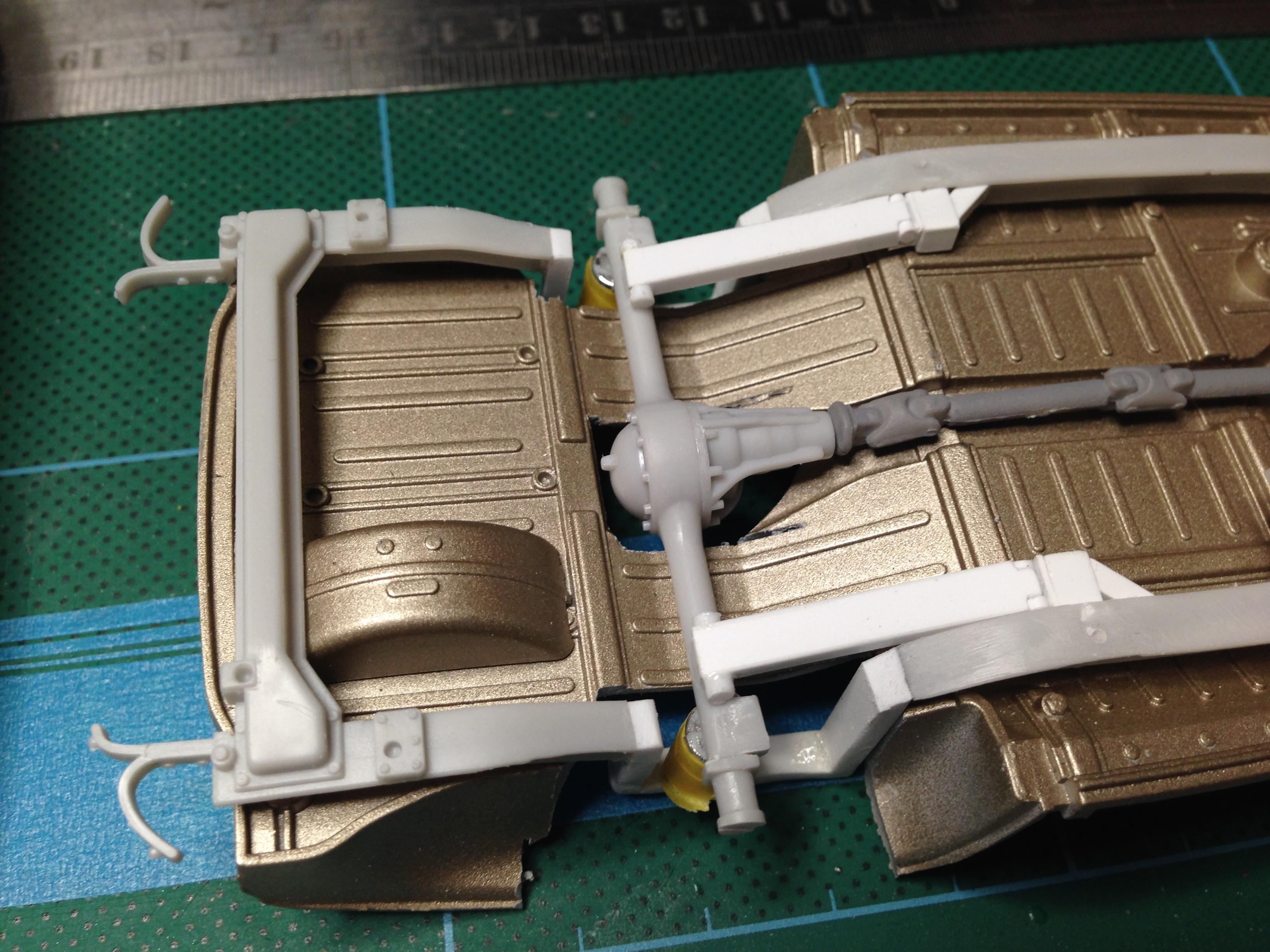

geetee66 Posted August 18, 2019 Author Share Posted August 18, 2019 On 8/16/2019 at 1:53 AM, espo said: I kind of thought you already had this figured out but was not sure. Your chassis looks great, very nice work here. Ok, so after a bit of thought, I decided the control arms I made were pony. So I relocated them and made them a bit better. Now it looks more workable: Quote Link to comment Share on other sites More sharing options...

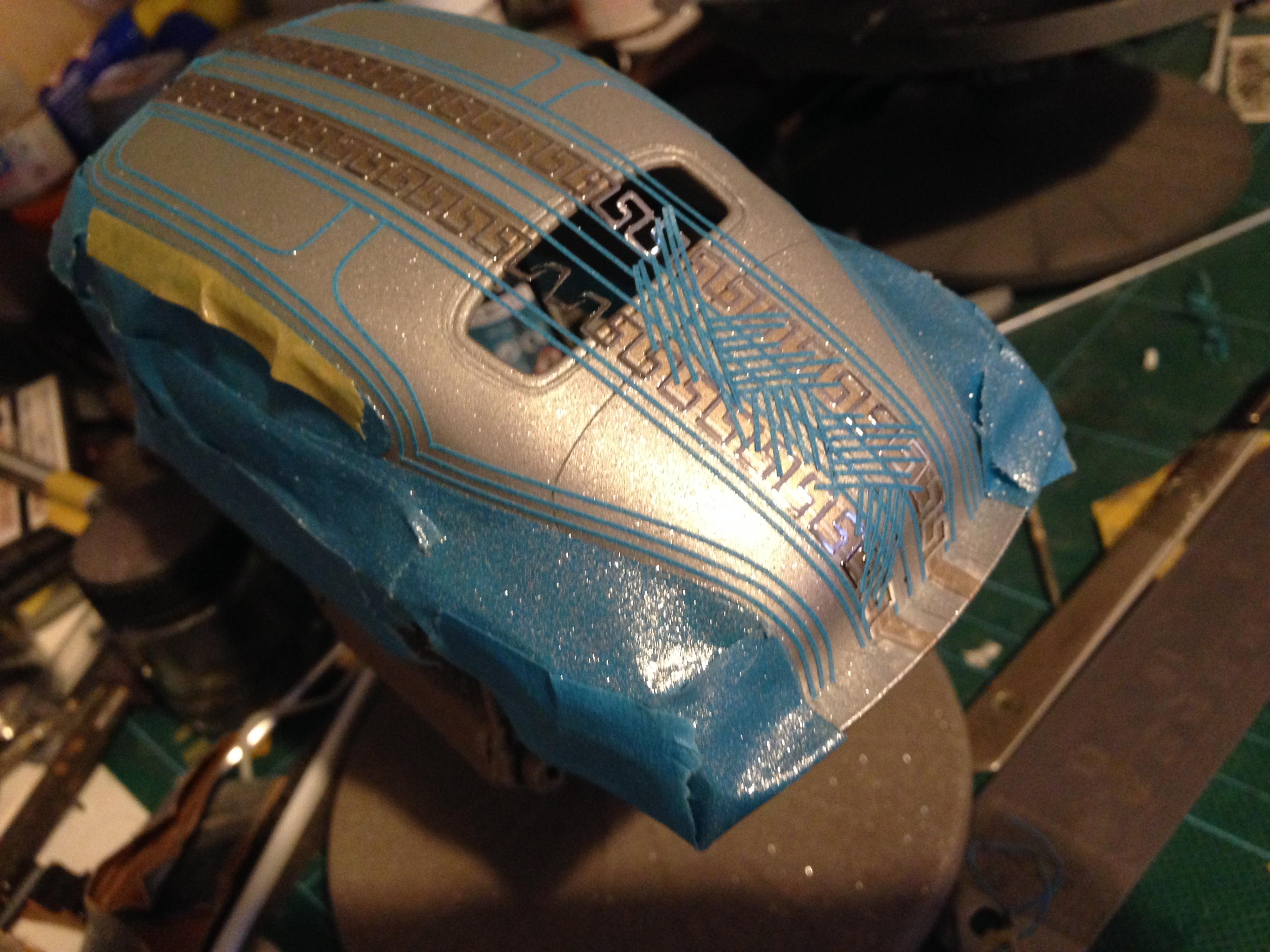

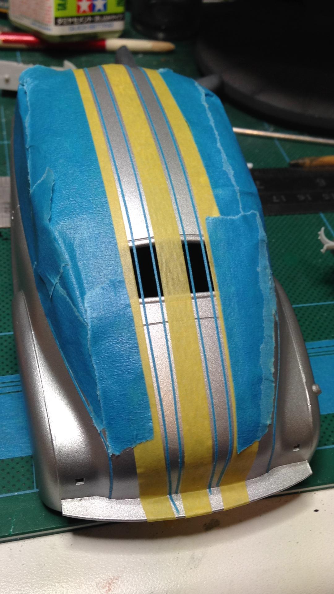

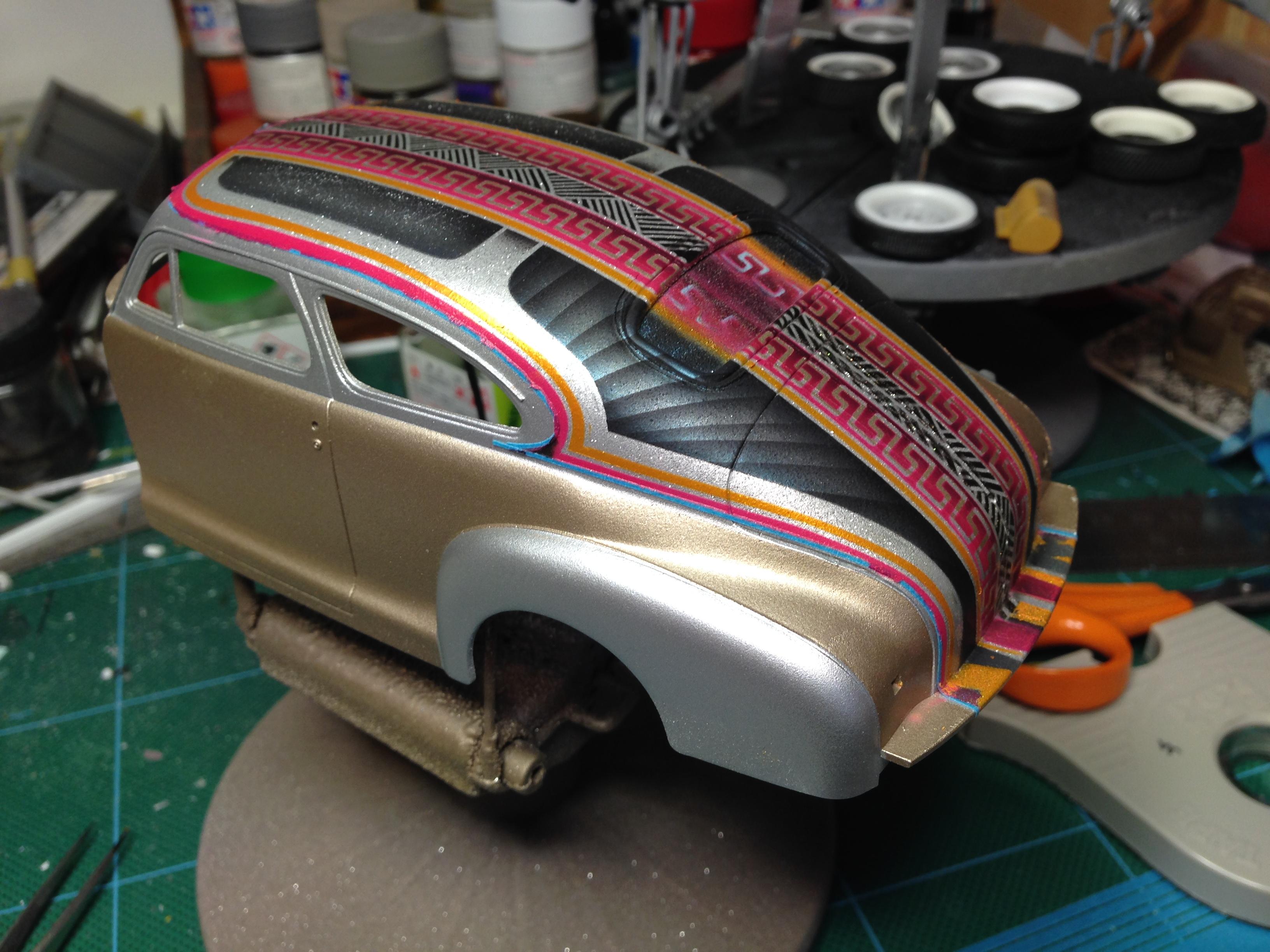

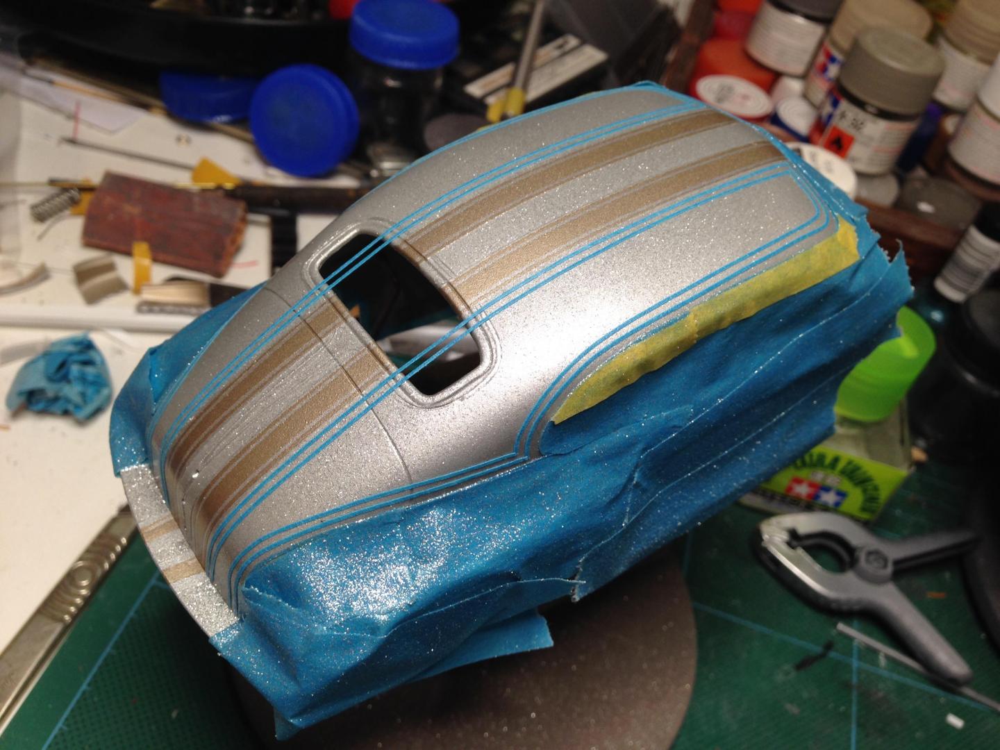

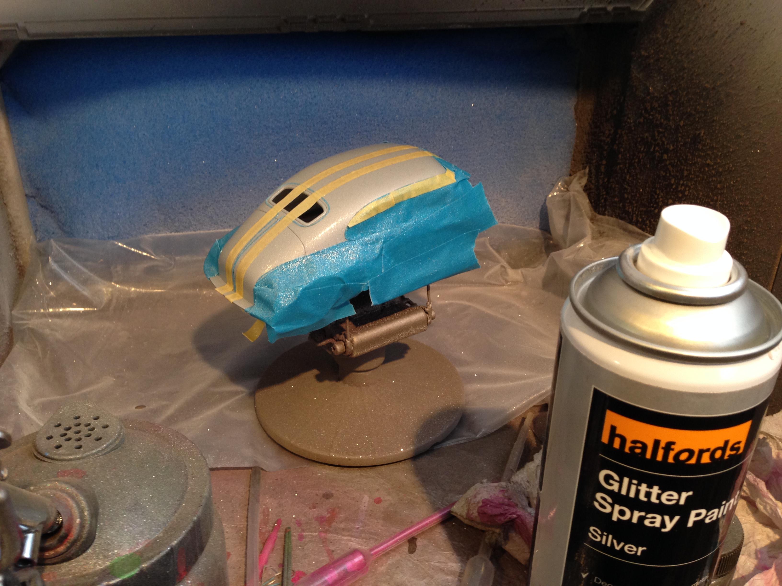

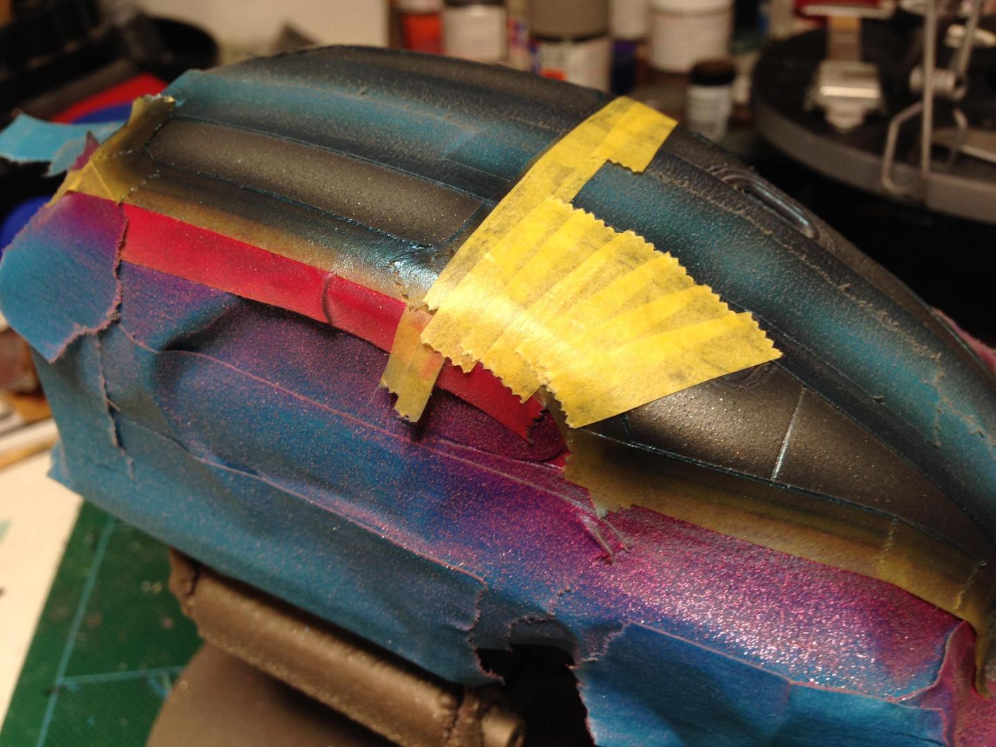

geetee66 Posted August 18, 2019 Author Share Posted August 18, 2019 I also masked and painted the sides with white gold and did a couple of stripes on the roof. These look a bit obvious now, but there's going to be lace panels and fingerprint sections covering some of it and under red candy, it should give a nice effect. Quote Link to comment Share on other sites More sharing options...

espo Posted August 19, 2019 Share Posted August 19, 2019 Interesting looking drive shaft with multiple universal joints. I like the start of your paint design. Always interesting how these paint treatments evolve. Quote Link to comment Share on other sites More sharing options...

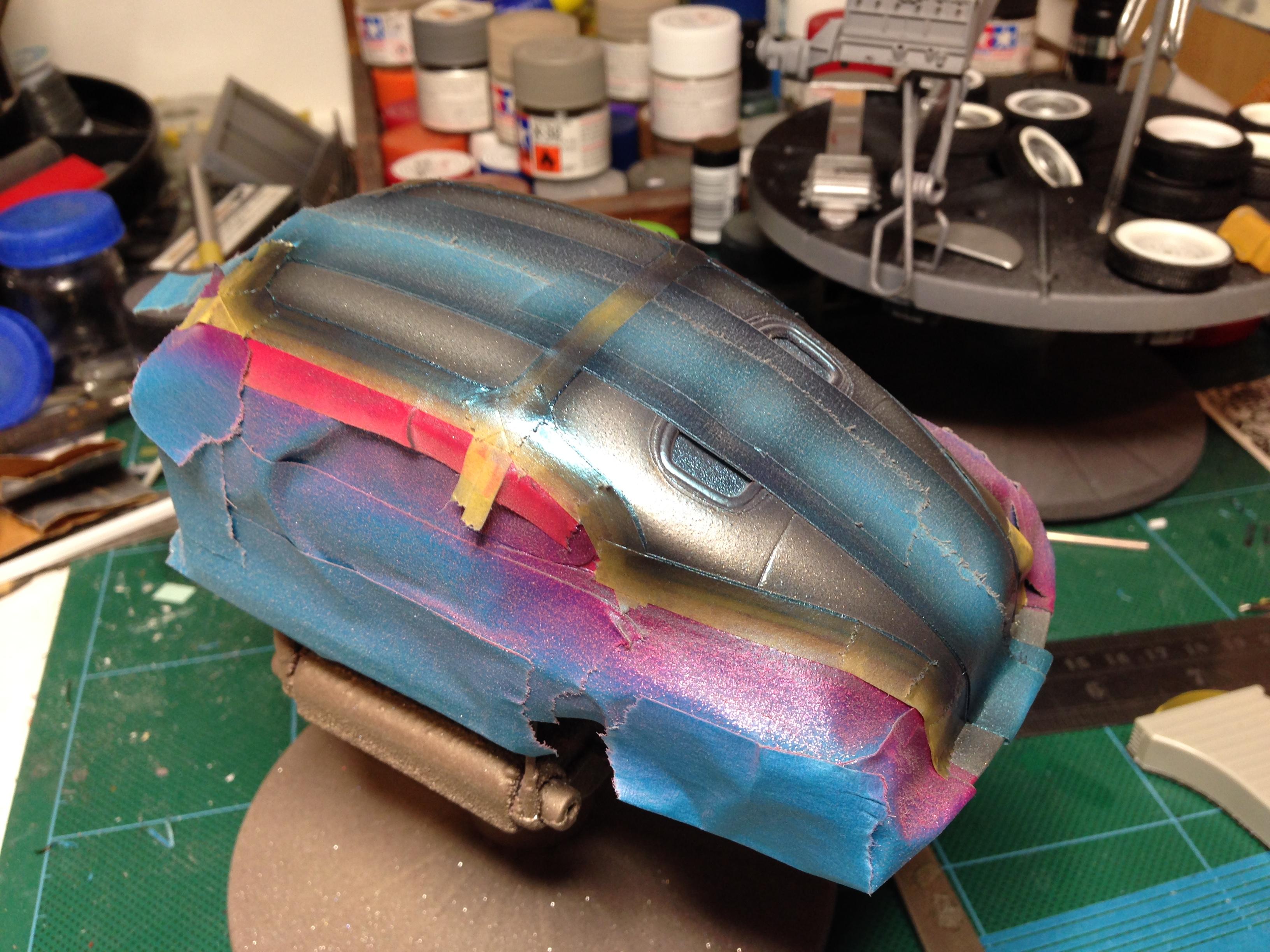

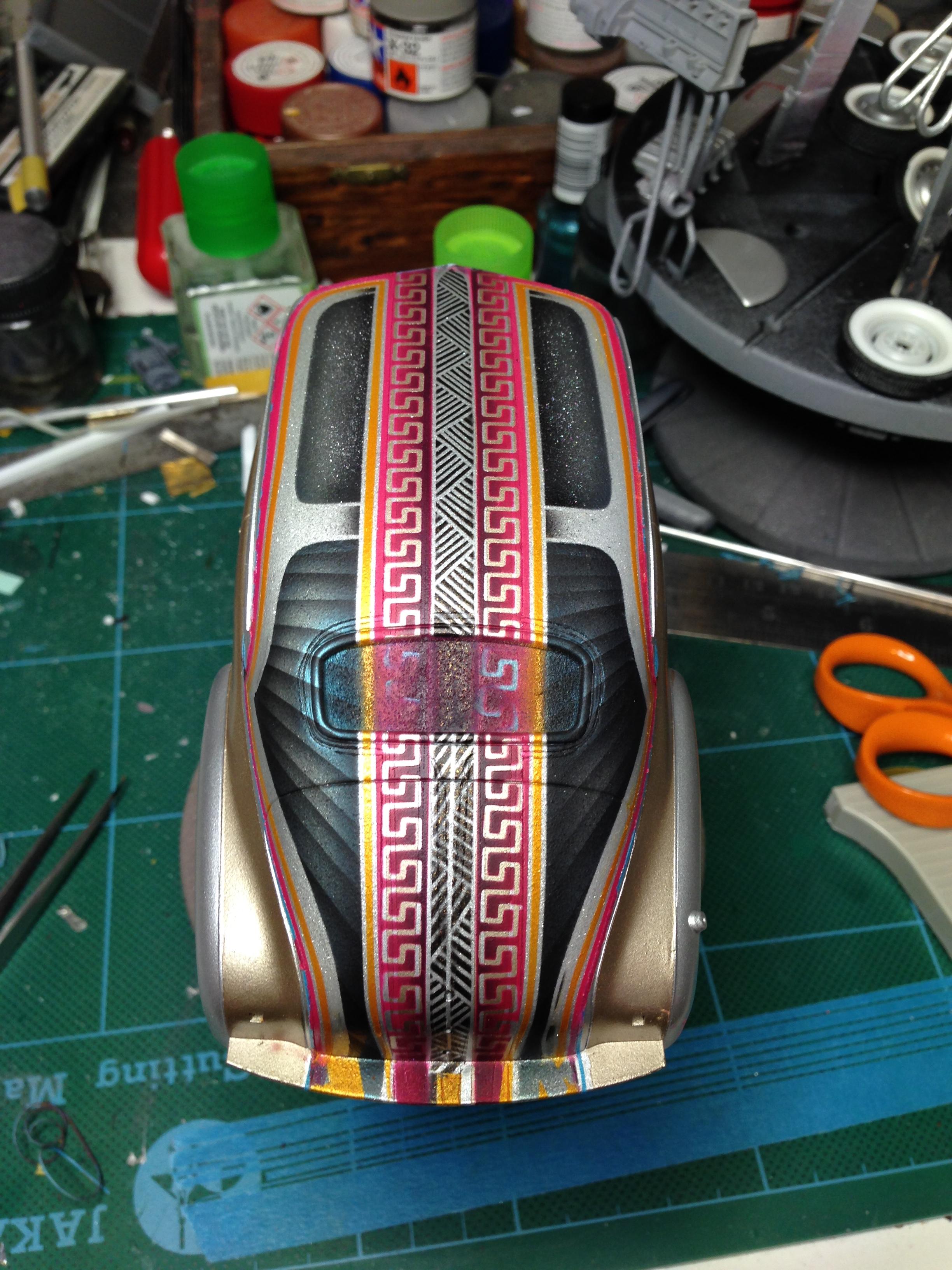

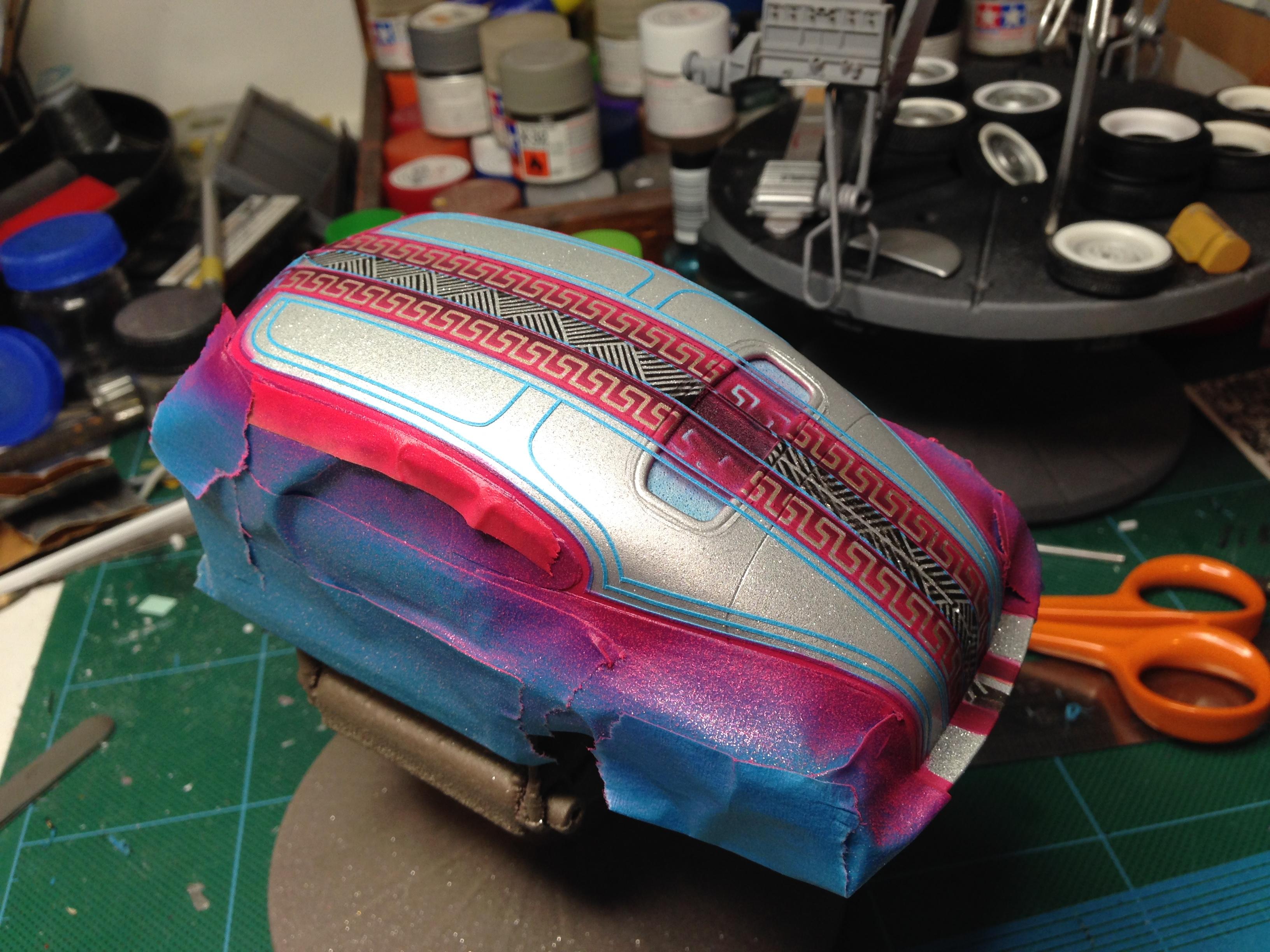

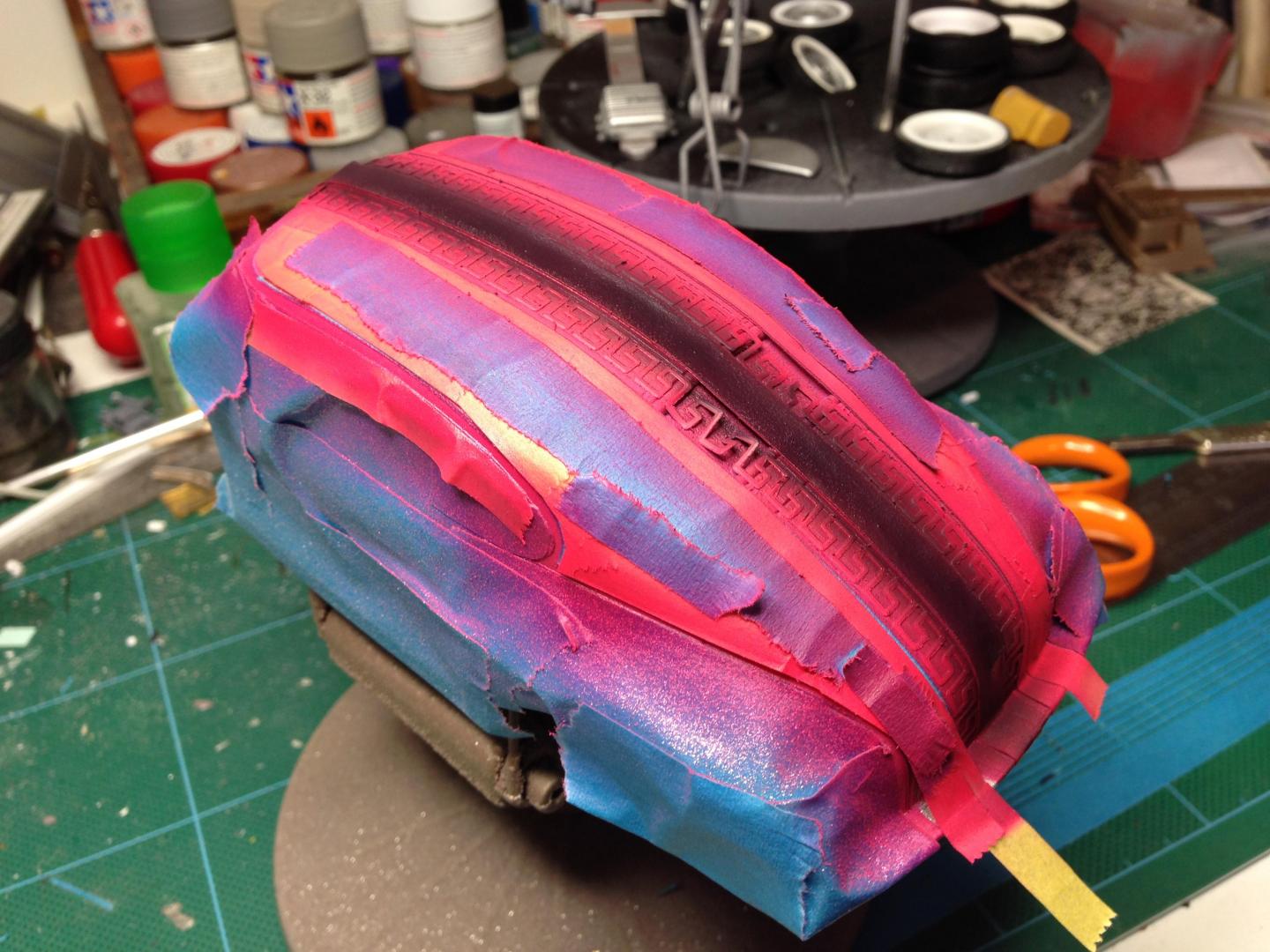

geetee66 Posted August 24, 2019 Author Share Posted August 24, 2019 Got some paint on it today. The herringbone pattern took about 160 pieces of tape. Quote Link to comment Share on other sites More sharing options...
stitchdup Posted August 24, 2019 Share Posted August 24, 2019 (edited) Stunning paint! If you want to save some time on cutting tape there are nail art stencils on amazon that could work for your paint jobs. They come in packs of 50 varied for about 3 or 4 quid a pack Edited August 24, 2019 by stitchdup Quote Link to comment Share on other sites More sharing options...
Shambles Posted August 24, 2019 Share Posted August 24, 2019 (edited) Dang! That's some VERY impressive work! Edited August 24, 2019 by Shambles Quote Link to comment Share on other sites More sharing options...

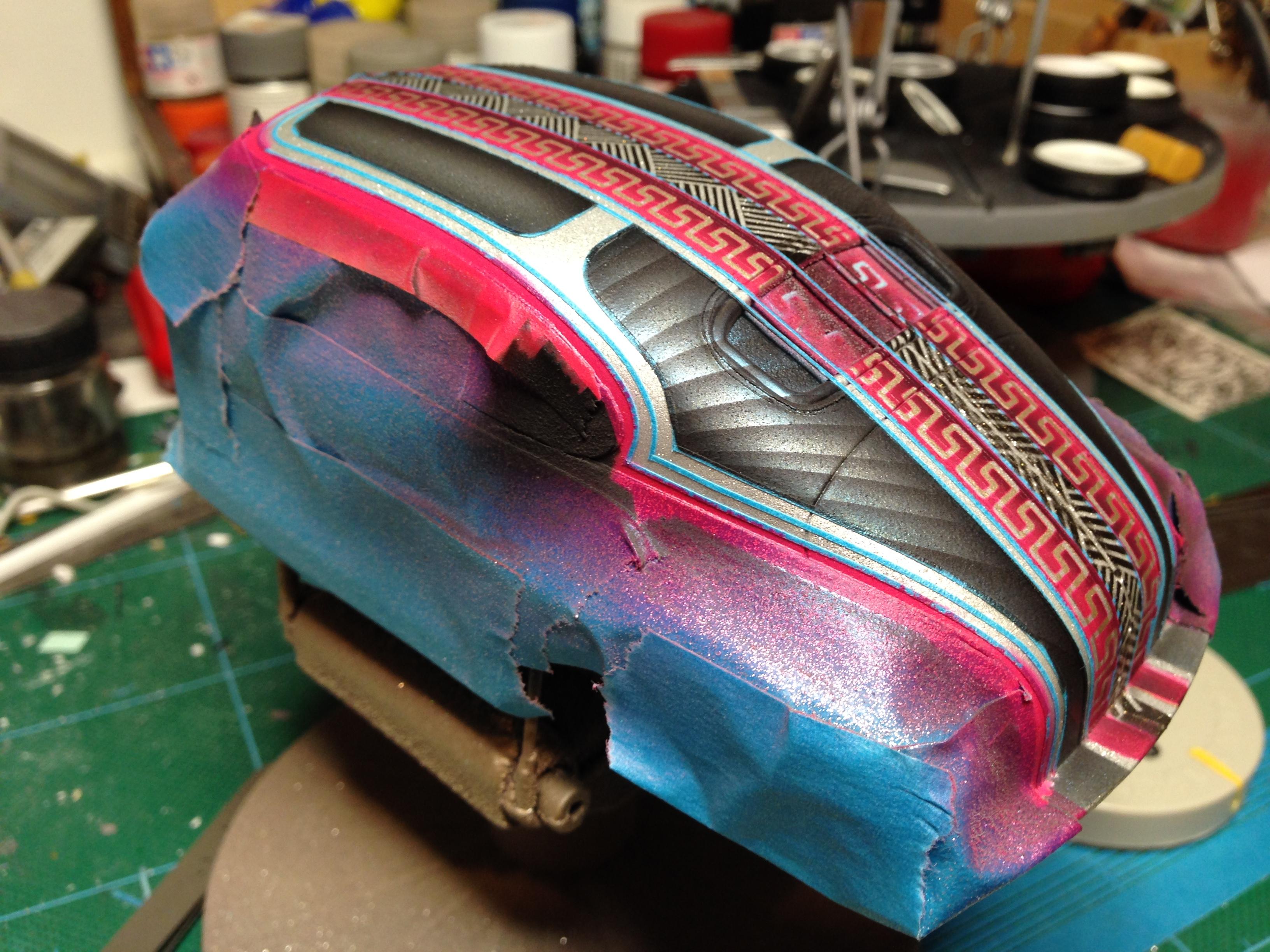

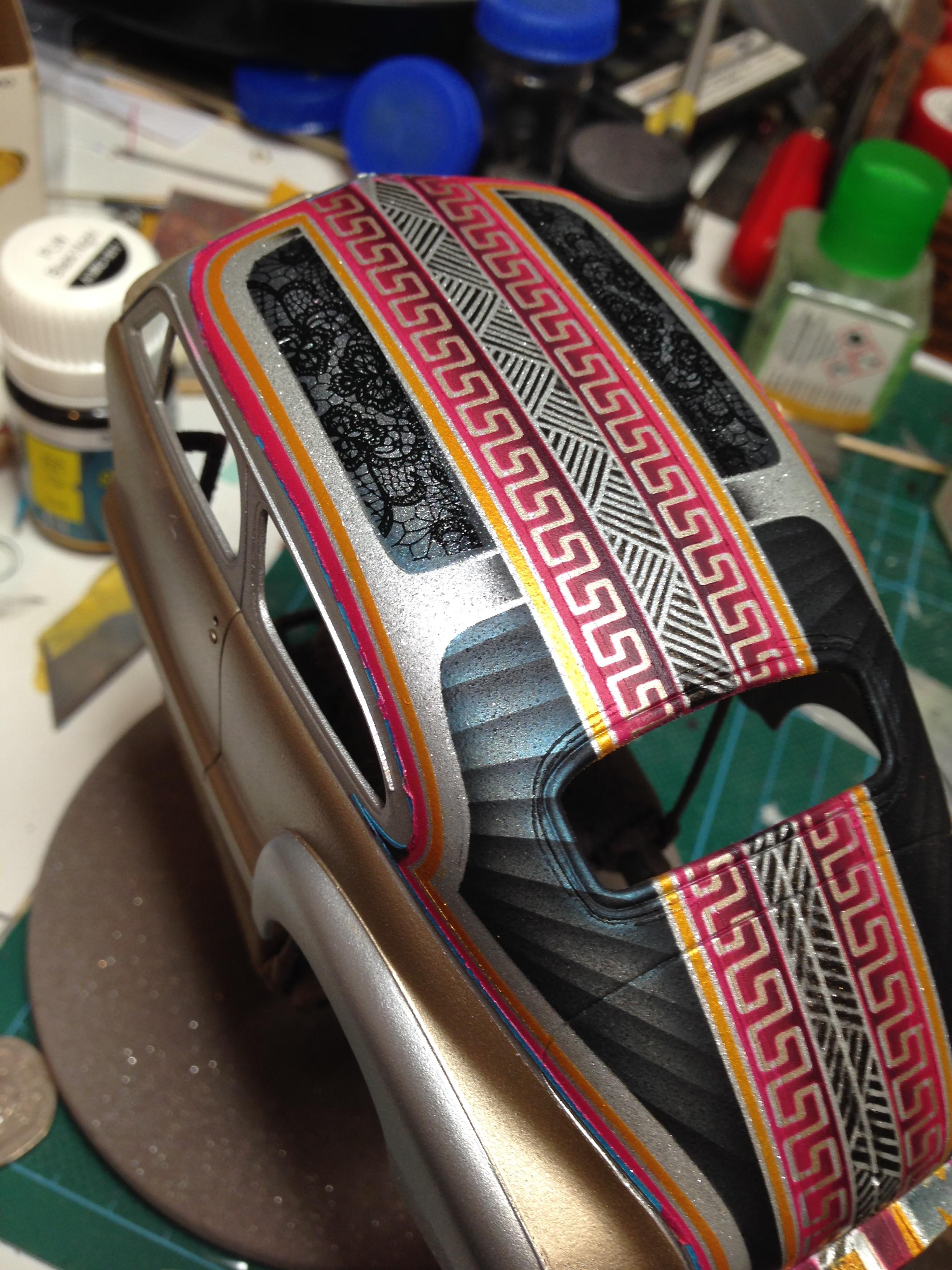

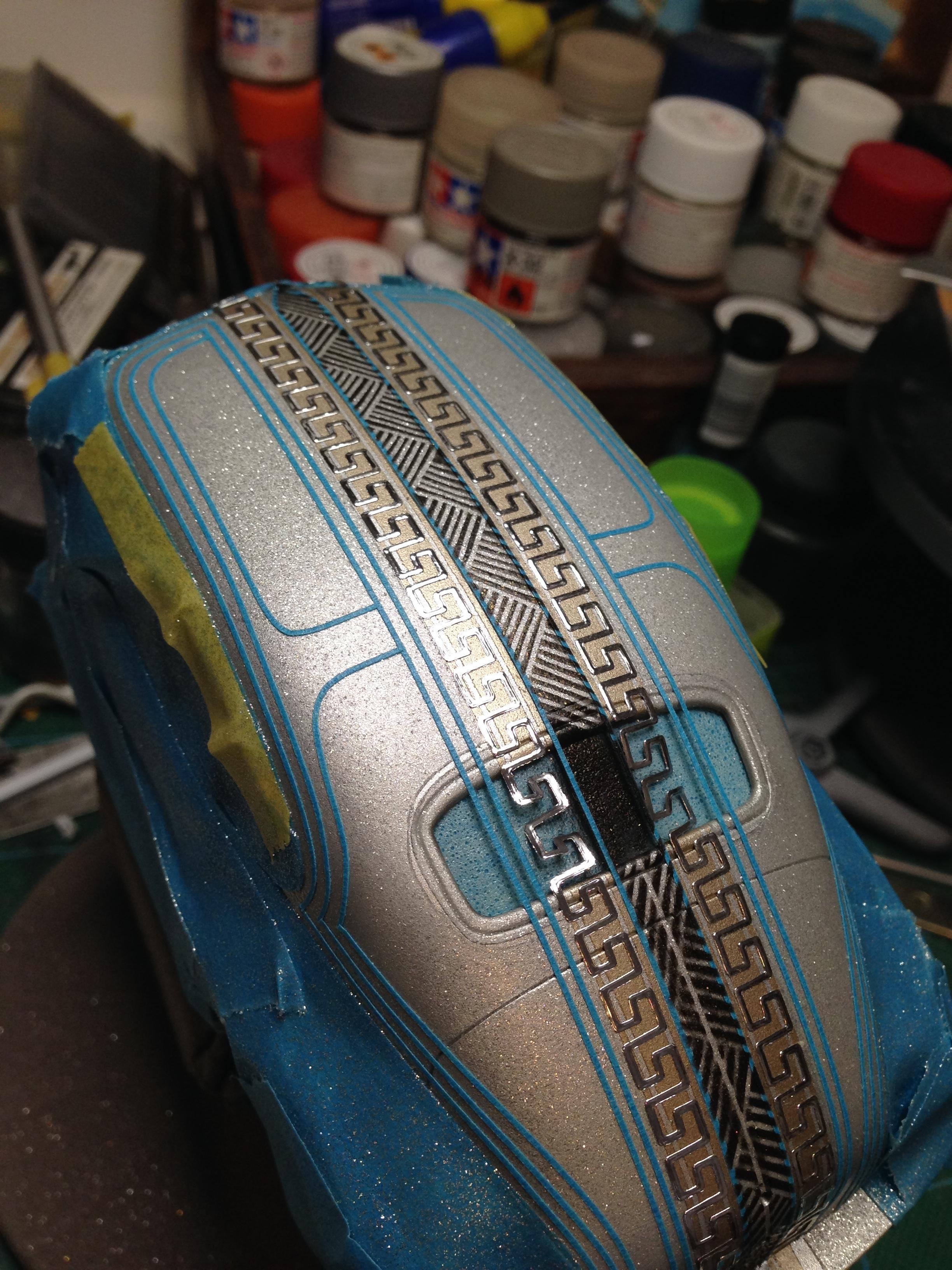

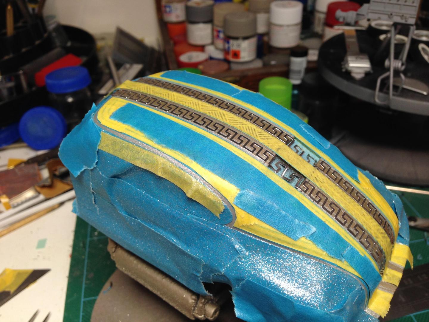

geetee66 Posted August 25, 2019 Author Share Posted August 25, 2019 One more colour went on today. Next is a clear sealer coat before I go candy red. Got a little bit of tidying up to do, but overall, not too shabby. Quote Link to comment Share on other sites More sharing options...
crazyjim Posted August 25, 2019 Share Posted August 25, 2019 Fantastic masking. Quote Link to comment Share on other sites More sharing options...

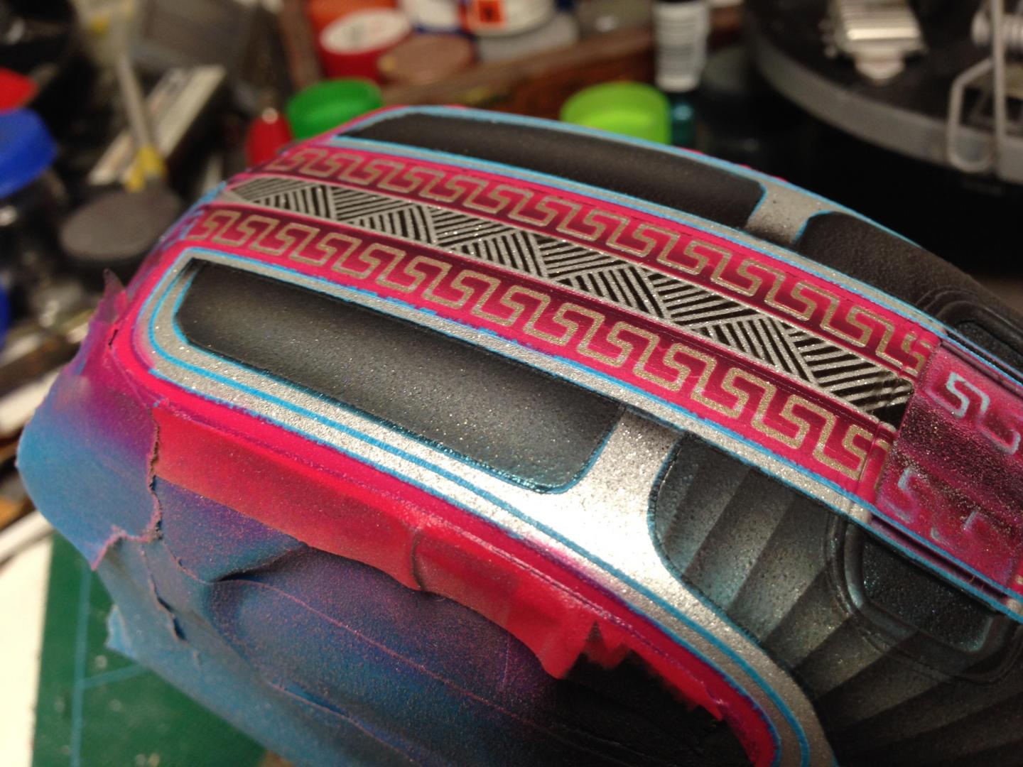

geetee66 Posted August 25, 2019 Author Share Posted August 25, 2019 1 hour ago, crazyjim said: Fantastic masking. Cheers Jim i got the lace on. Should be dry enough to clearcoat tomorrow. Quote Link to comment Share on other sites More sharing options...

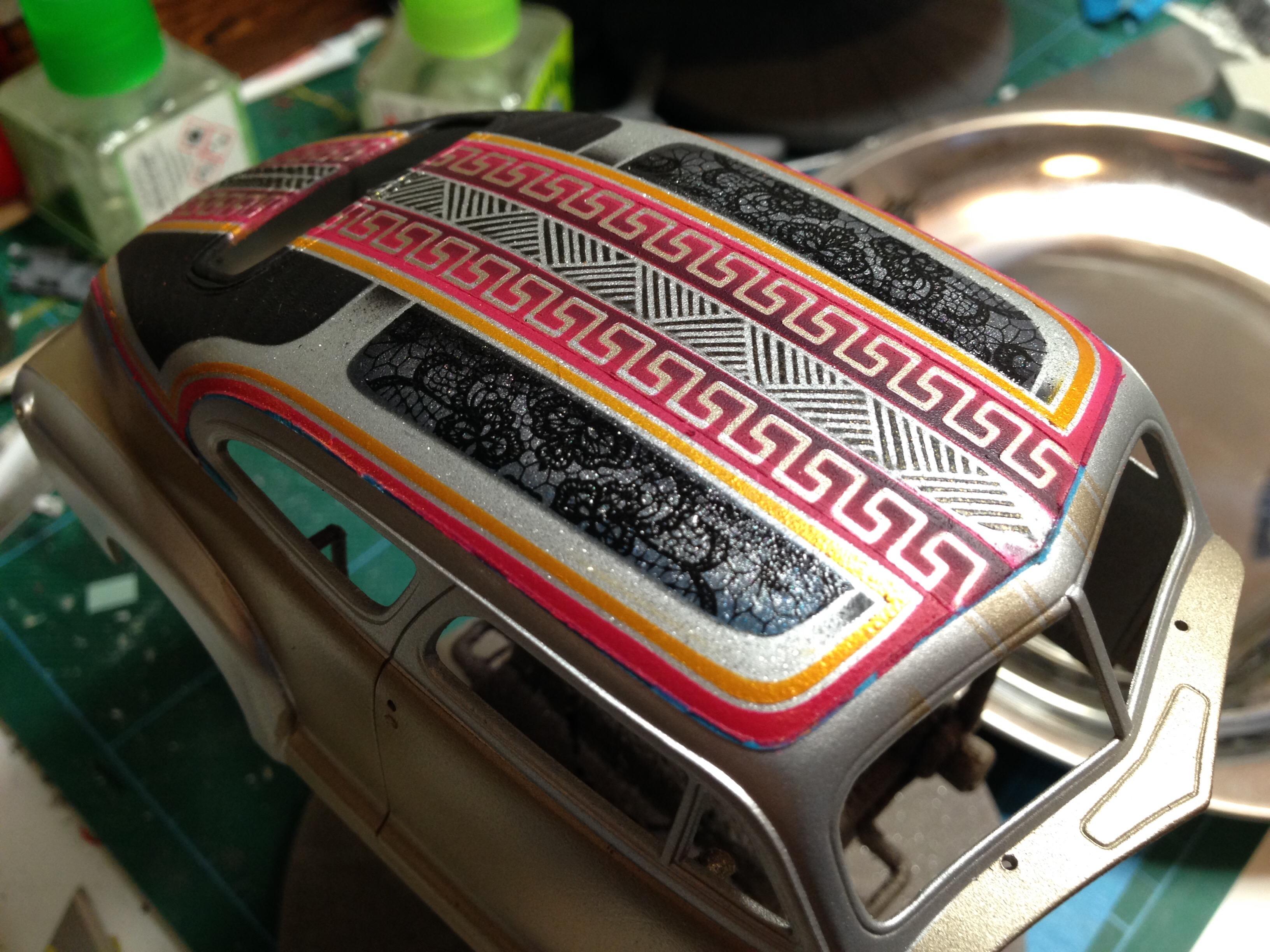

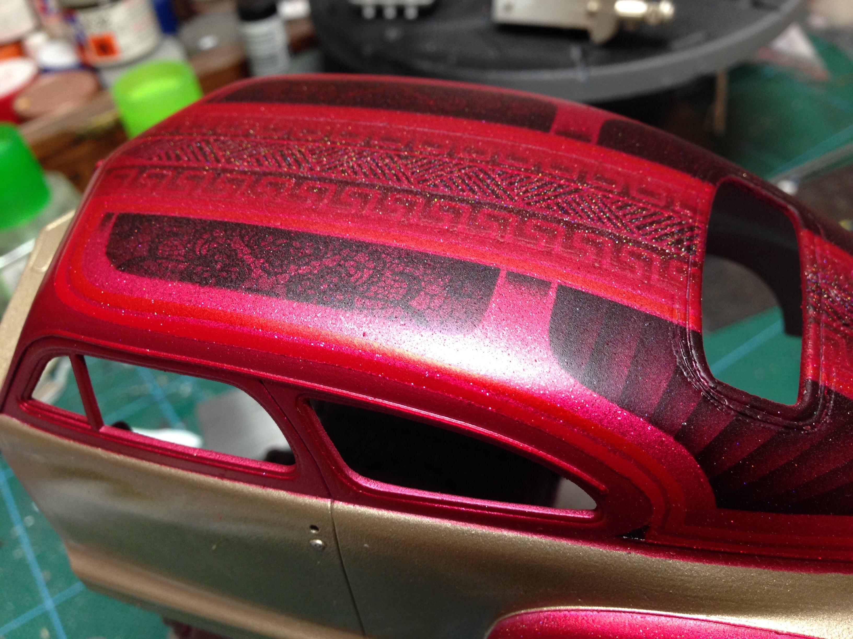

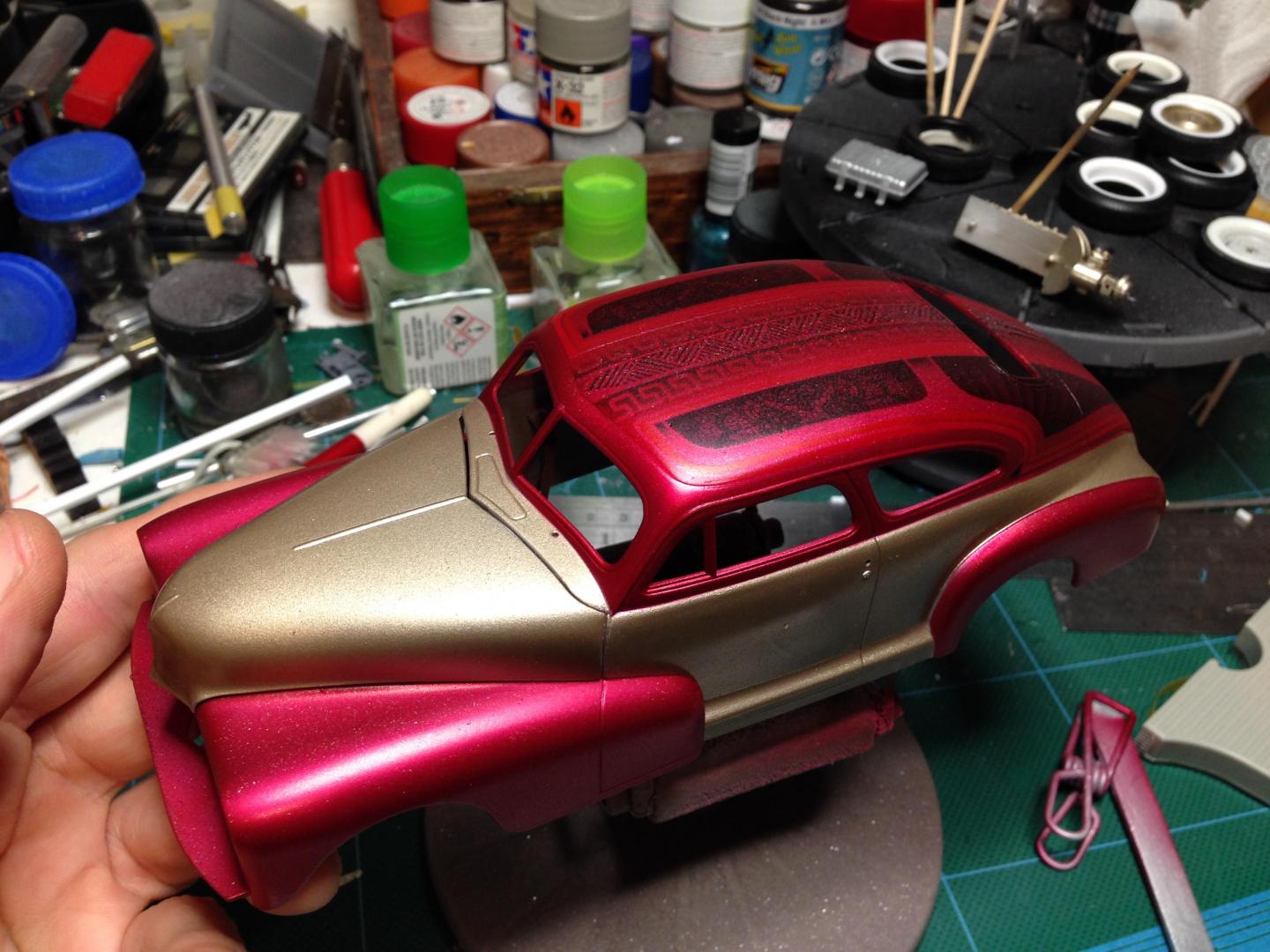

geetee66 Posted August 31, 2019 Author Share Posted August 31, 2019 Got the red candy on today. The sparkle will return after clearcoat Quote Link to comment Share on other sites More sharing options...
