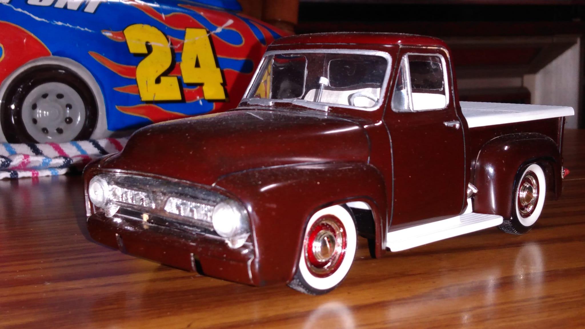

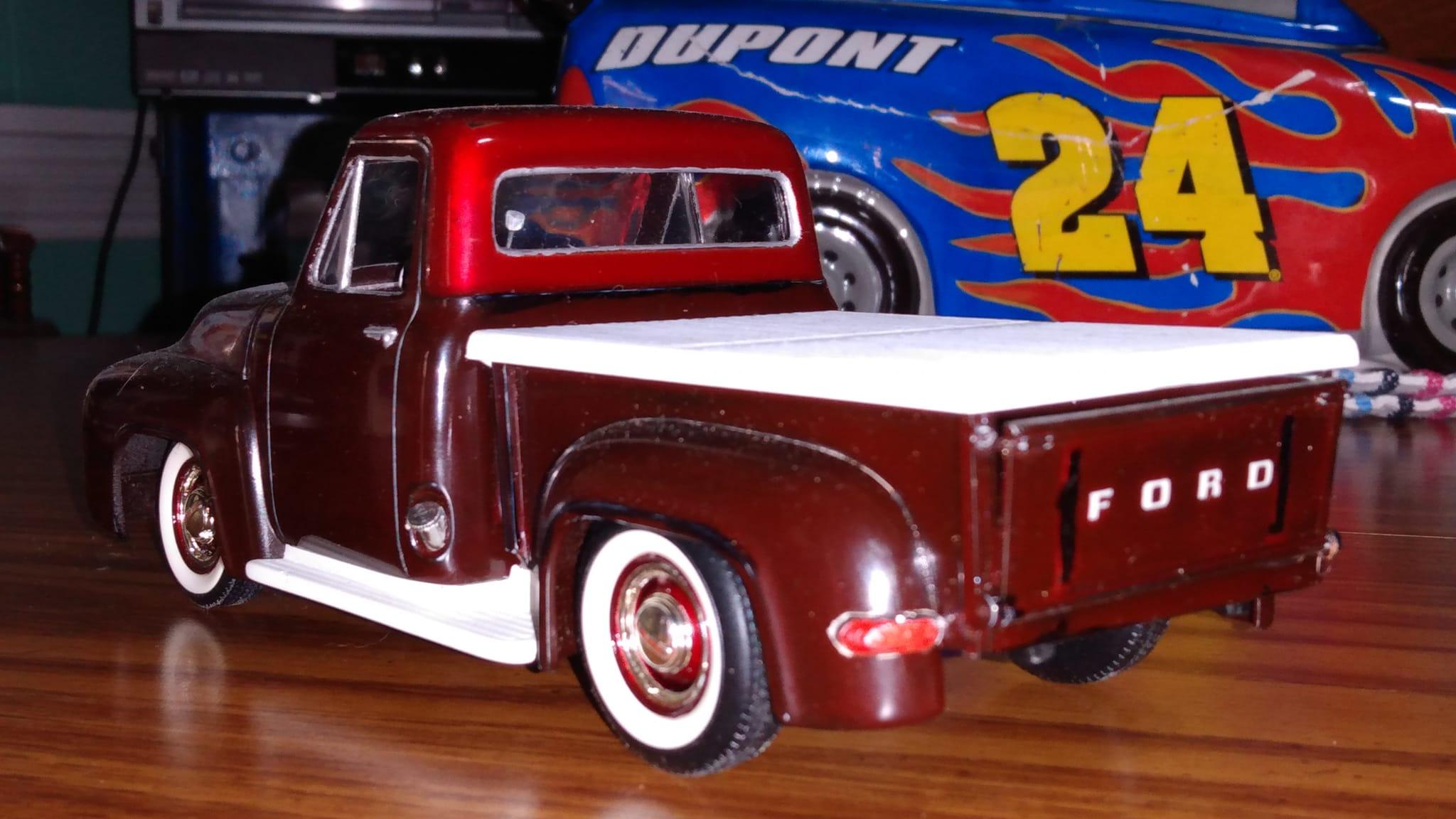

Last little bit of fab work involved pinning all of the handles and arm rests that come with the Drag City Casting interior kit. Since the handles are too small to drill deep enough to insert pins in from the back i went ahead and drilled all the way through and made the pin heads part of the handles. I looked up pictures of full scale trucks for placement.
I finally made a hobby shop trip to get the paint supplies needed to break this project out of primer jail. Main color is Testors one-coat Root Beer with Tamiya clear and Tamiya Racing White for the accent color. I'll wait a week and then polish it out and wax it for a deep shine. Here's a real loose mock up in terrible lighting  just to show the color scheme.
Also, I love this caricature decal from AMT's recently released '34 Pickup retro-deluxe where the decal sheet was restored to the original 1960's release. Problem is that it's pretty big and hard to fit on smaller 30's vehicles but then I got to thinking that in the 50's and 60's a lot of guys named their rods and customs, especially for car shows,  and there was plenty of room on the big bed cover.

I screwed up when I painted the running boards/floor piece in that I should have continued the white up the sides into the cab. Had a total brain fart there and did it black. Didn't like it as soon as I saw it mocked up so into the stripper. With the paint removed I realized this would be a good opportunity to address the exhaust. I wanted chrome side pipes and found a set I like in AMT's most recent '36 Ford Coupe/Roadster retro-deluxe issue. I installed pins that fit into holes on the under sides of the boards where the 4 tabs are and drilled out the ends then painted flat black up in there. I also added some exhaust pipes that disappear up into the frame since that area where they hook up to the side pipes will be partly visible.
On to some finish work.
I assembled the wheels, sanded the tire treads and gave the wheels a thin black wash.
I assembled the headlight rings and lenses to the grill. I'm so happy with how this turned out by doing the separate chrome rings!
And I did some detail painting of the dashboard and steering column along with some decals to go with the bed cover.
All for now.

Yesterday I got the Drag City Casting seat and interior panels finish painted. Tamiya sprays: Maroon, Racing White and Flat Clear.
And last night I had some time to myself so i polished all of the body pieces using Adam's Paint Correcting Polish and a micro fiber cloth. I still need to wax everything.
