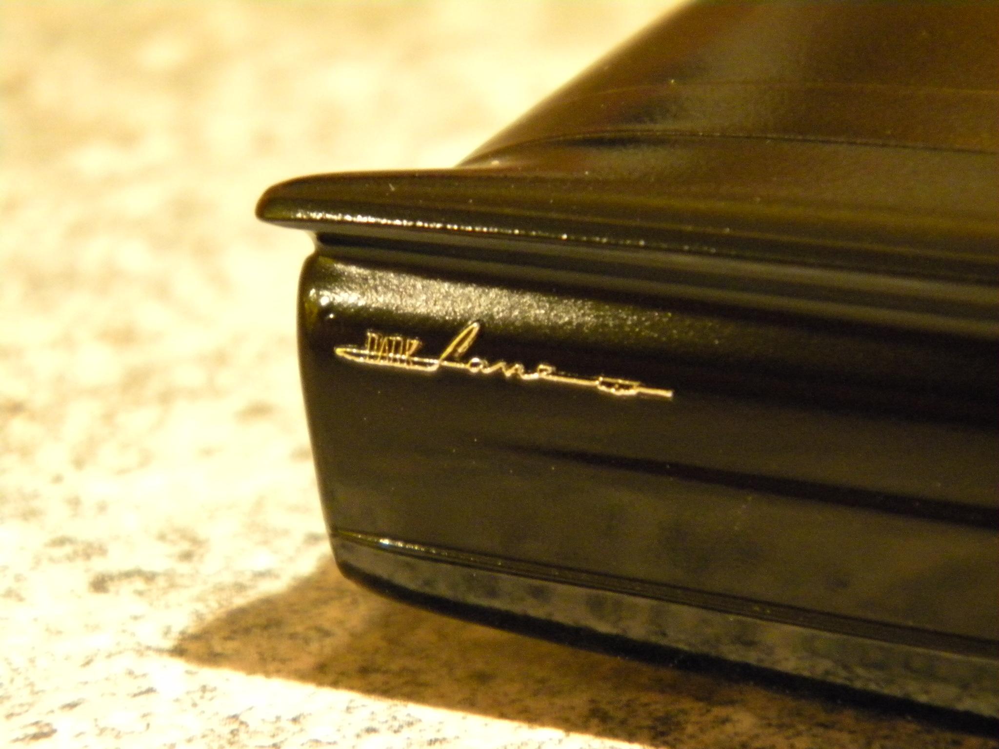

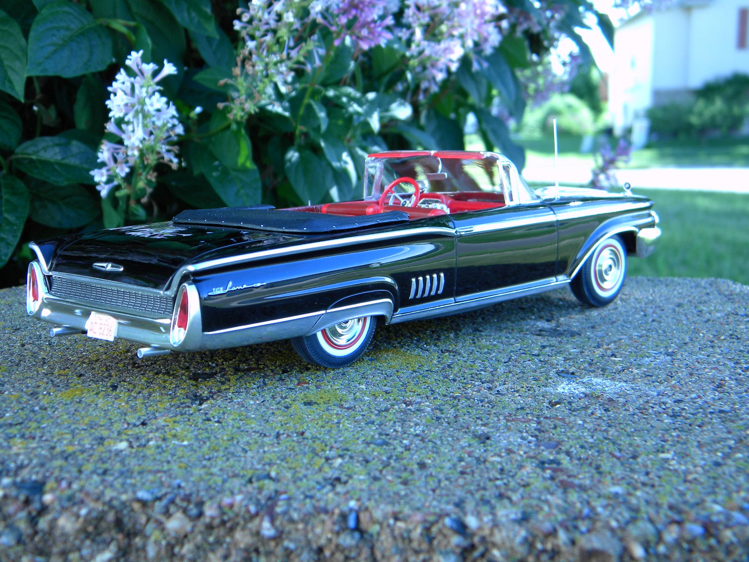

StevenGuthmiller Posted August 25, 2019 (edited) Skip the Molotow get some "Bare Metal Foil" and use the "foil under paint" technique. You will get much better results than with the Molotow pens, and you don't even have to have a steady hand! Steve Edited August 25, 2019 by StevenGuthmiller Quote Share this post Link to post Share on other sites
Bucky Posted August 25, 2019 1 hour ago, StevenGuthmiller said: Skip the Molotow get some "Bare Metal Foil" and use the "foil under paint" technique. You will get much better results than with the Molotow pens, and you don't even have to have a steady hand! Steve Steve, what do you use to clean the paint off the BMF, and at what point do you do that after painting the car body? All your "chrome" trim looks fantastic. I'd like to give your methods a try. Quote Share this post Link to post Share on other sites
StevenGuthmiller Posted August 25, 2019 34 minutes ago, Bucky said: Steve, what do you use to clean the paint off the BMF, and at what point do you do that after painting the car body? All your "chrome" trim looks fantastic. I'd like to give your methods a try. I use a combination of the conical Tamiya swabs and sharpened tooth picks dipped in a little bit of lacquer thinner. Some will sand or polish the paint off of the script, but I find I get a cleaner look with the thinner, plus there is the danger that you might sand all the way through the foil. I have had that happen. Personally, I find that I get the best results if I wait until right before my final color coat before applying the foil to the script. Then I shoot the final color coat over the entire body, let it dry until it can safely be handled, and then clean the paint off of the script. Of course you are using lacquer thinner so you need to be careful of the rest of the finish. Once the scripts are exposed to my satisfaction, I commence with the clear coats over the top of everything. I apply the rest of the foil after clear coats and polishing. A good tip is to still try to trim the foil as close as possible to the script. Edges of the foil can be visible under the paint. Steve Quote Share this post Link to post Share on other sites

StevenGuthmiller Posted August 25, 2019 6 hours ago, ratherbefishin said: Questions though. Why not do all foil work before the final wet color coat? I'm sorry Curt. Maybe I wasn't clear enough, but that's exactly when I do the scripts. If you're asking "why not do the rest of the body trim before color as well", my answer would be, it's easy to clean paint from a small detail like a script, badge or door lock, but I sure as heck wouldn't want to try it with an entire model. In other words, it would be way too much work! 6 hours ago, ratherbefishin said: Also, in past build my paint build up diminished the detail on some insignia/lettering. Is there a method you recommend to restore this detail if it is obscured? I really can't help you much there Curt. I use automotive lacquers and even though I use as many as 4-5 primer coats, 3 or 4 color coats, and up to 5 clear coats, I never have problems with detail hide. Of course the scripts are done only over the 5 primer coats and 4 color coats and not the clear. The '61 Buick photos above show a detailed badge on the trunk lid that was so faint that it was nearly non-existent, yet I managed to still do it with this technique. I suppose that if you are worried about detail hide, you can always put your foil on earlier in the process. I like to apply it as close to the end of the painting process as possible just because it means less paint to remove from the script. It's just a little more difficult to cleanly remove more coats from the script. Steve Quote Share this post Link to post Share on other sites
StevenGuthmiller Posted August 25, 2019 Let me just say, to anyone who is thinking that somehow Molotow ink is in itself going to help you get better scripts than any other paint.....you're wrong. It might look closer to chrome when finished, but applying it is no different than applying any other paint. If you're not the type of person who is steady enough to lay down a perfectly straight line with a paint brush, it's going to do you no good. This is not a knock on Molotow, it just seems that more and more people are getting it in their head the Molotow ink is some sort of magic bullet, but in the end it's just paint. If you couldn't do it with Testors "Chrome Silver" in the little jars, you're not going to do any better with Molotow ink. Steve Quote Share this post Link to post Share on other sites

StevenGuthmiller Posted August 25, 2019 (edited) 10 minutes ago, BigTallDad said: Instead of a tooth pick, I use a small strip of balsa...it absorbs more lacquer thinner, and any paint accumulation can be easily cut off. I'm sure that would work as well. I don't particularly want a lot of thinner an the "tool" anyway. Too much thinner can run onto the surface of the body if you are not careful. Plus I like something sharp so that I'm not just taking the paint off of the surface of the script, but can actually remove as much of the paint as possible from the sides of the script. If possible, I prefer to eliminate the paint that is "crawling" up the sides of the scripts and badges so they appear to be resting on top of the surface of the body, and not down in the paint. I sharpen the tooth picks at an angle. Any accumulation of paint can also be easily trimmed off. Steve Edited August 25, 2019 by StevenGuthmiller Quote Share this post Link to post Share on other sites
Bucky Posted August 25, 2019 Great step-by-step, Steve!! Thanks, bunches for that! Another question for ya...how does the lacquer thinner work on enamel color coats? This is one of those threads I'll follow! Quote Share this post Link to post Share on other sites
StevenGuthmiller Posted August 25, 2019 1 hour ago, Bucky said: Great step-by-step, Steve!! Thanks, bunches for that! Another question for ya...how does the lacquer thinner work on enamel color coats? This is one of those threads I'll follow! Lacquer thinner will work regardless if you're using lacquer, enamel or acrylic. It will pretty much remove anything. Steve Quote Share this post Link to post Share on other sites

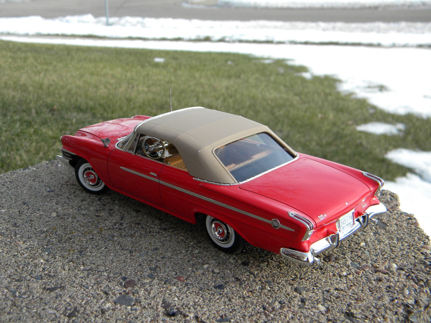

StevenGuthmiller Posted August 25, 2019 Just a couple more examples of results achieved with this technique. Steve Quote Share this post Link to post Share on other sites
SCRWDRVR Posted August 26, 2019 (edited) That's incredible, your ability far exceeds mine that's probably why I still use paint lol.... Edited August 26, 2019 by SCRWDRVR Quote Share this post Link to post Share on other sites
ratherbefishin Posted August 26, 2019 Steve, sorry to be a pest but how did you achieve that fabric top finish on the Chrysler. It’s outstanding. Quote Share this post Link to post Share on other sites
StevenGuthmiller Posted August 26, 2019 40 minutes ago, ratherbefishin said: Steve, sorry to be a pest but how did you achieve that fabric top finish on the Chrysler. It’s outstanding. Flat paint. Steve Quote Share this post Link to post Share on other sites
