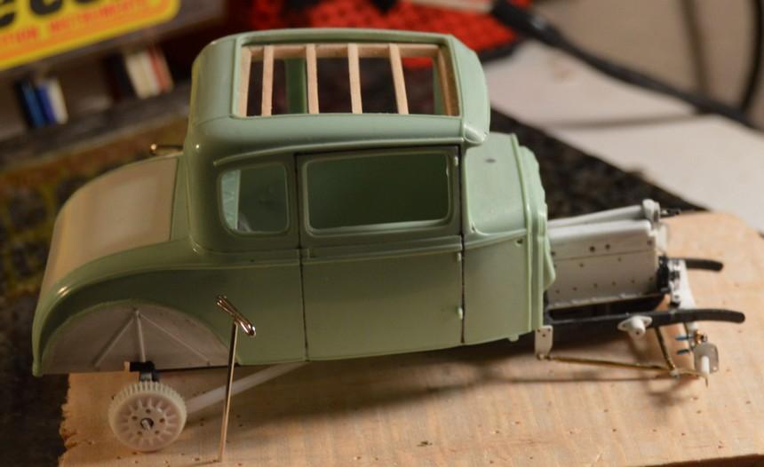

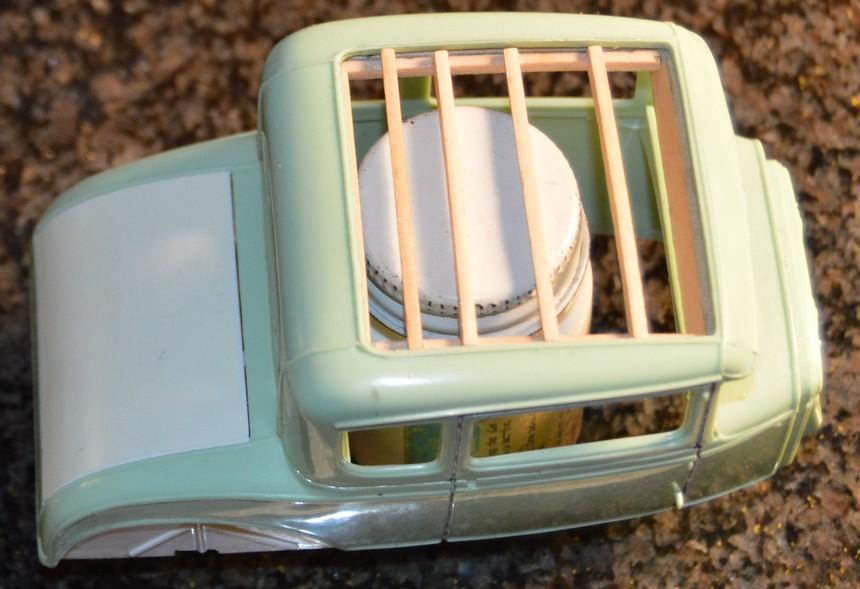

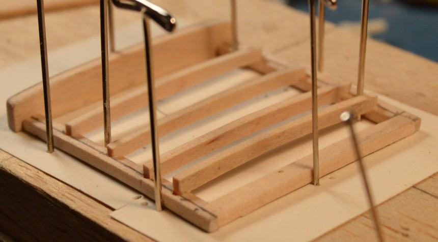

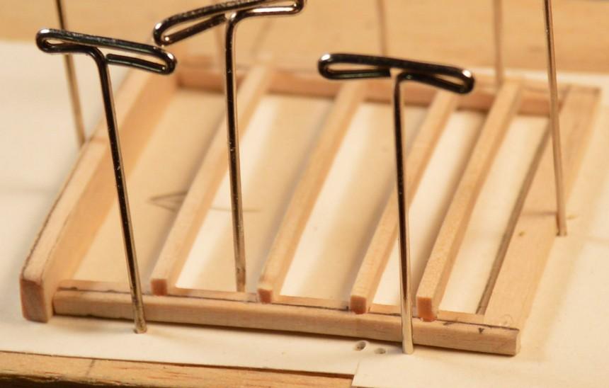

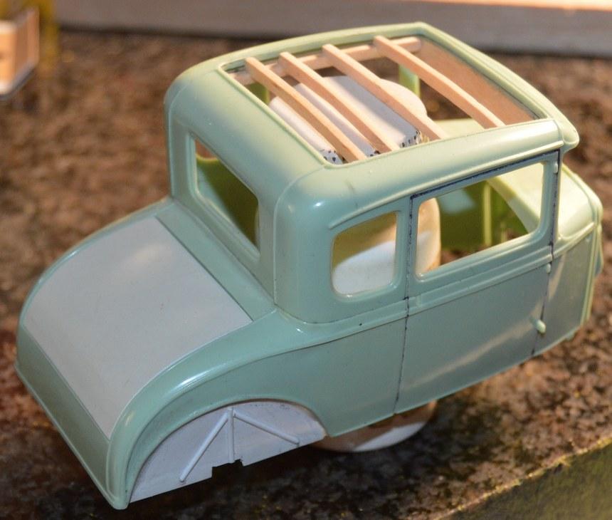

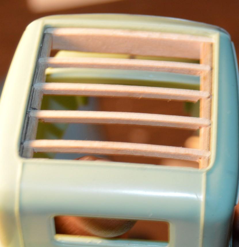

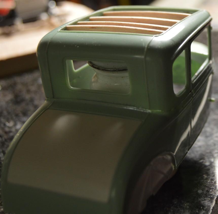

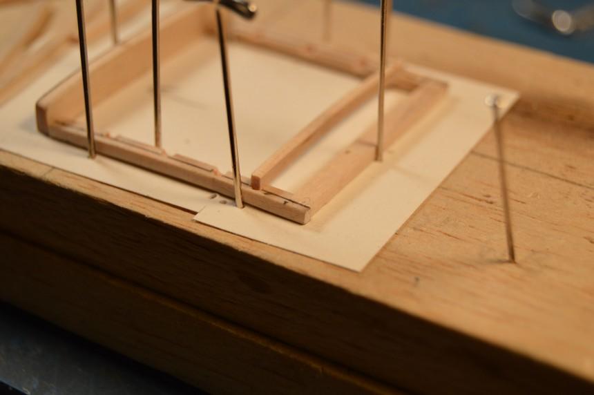

Straightliner59 Posted February 17, 2020 Author Share Posted February 17, 2020 I got some work done on the wood for the roof, tonight. I cut some little pockets for the ribs to sit in. It all fits together, pretty nicely! I'm stymied, trying to figure out how to temporarily assemble it, to check its fit in the roof of the real world, not just as numbers. Thanks for looking! Questions, comments, critiques always welcome! Quote Link to comment Share on other sites More sharing options...

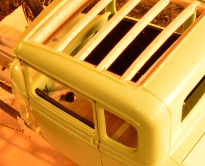

Straightliner59 Posted February 17, 2020 Author Share Posted February 17, 2020 I got it a bit further along. Still need to do some straightening-up. It's not prototypically correct, at this point, but, it's almost "fudgeable". Quote Link to comment Share on other sites More sharing options...
oldnslow Posted February 17, 2020 Share Posted February 17, 2020 (edited) Nice job on the insert , but the photo I saw , the framing is all on one level , not stacked , and the frame should fit inside the opening almost flush with the roof . Edited February 17, 2020 by oldnslow Quote Link to comment Share on other sites More sharing options...
Straightliner59 Posted February 17, 2020 Author Share Posted February 17, 2020 (edited) 8 hours ago, oldnslow said: Nice job on the insert , but the photo I saw , the framing is all on one level , not stacked ,and the frame should fit inside the opening almost flush with the roof . Exactly why I said it isn't prototypically correct. The framing here is flush, because the sheet metal is thinner than the the plastic. I'll eliminate some of that thickness. I wanted to get it put together, because it was impossible to check the fit, without it assembled. Now, I can get to the fine-tuning! Thanks for your comments and observation, sir! ? Edited February 17, 2020 by Straightliner59 Quote Link to comment Share on other sites More sharing options...
David G. Posted February 18, 2020 Share Posted February 18, 2020 Nice work on the roof. Do you plan to leave it open or cover it? David G. Quote Link to comment Share on other sites More sharing options...
Straightliner59 Posted February 18, 2020 Author Share Posted February 18, 2020 6 hours ago, David G. said: Nice work on the roof. Do you plan to leave it open or cover it? David G. I want to leave it open. I have been considering a roll-back canvas tonneau thingie for it. I also still need to notch the cross-pieces, so they will fit flush with the side rails. I need to thin the roof plastic, too. I needed to get it assembled, to see how it fit the body, though. Thank you, David! I appreciate your comment! Quote Link to comment Share on other sites More sharing options...

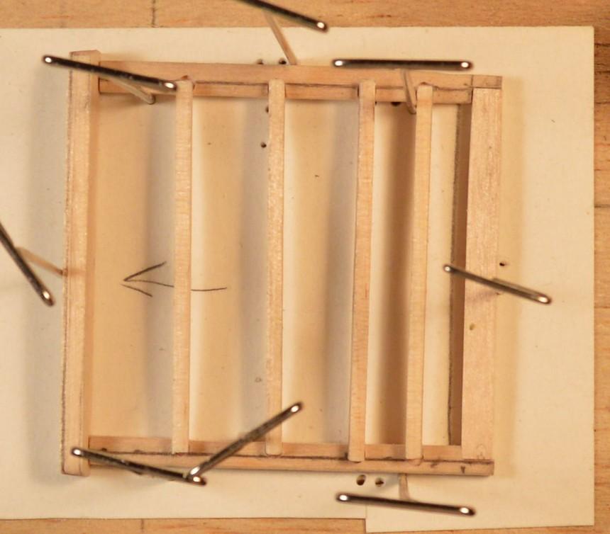

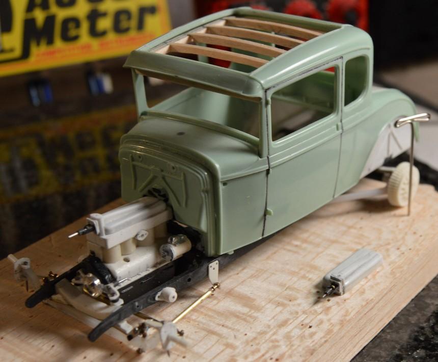

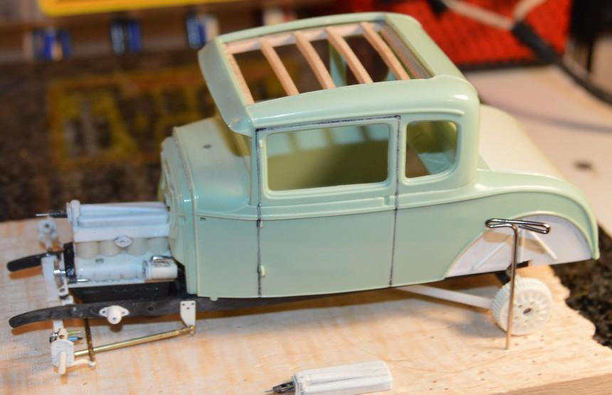

Straightliner59 Posted February 21, 2020 Author Share Posted February 21, 2020 Here's the new wooden roof framing. I evened out the spacing on the front three cross braces. Also notched them, and flushed them up with the frame. Next, I need to set up the Dremel to grind the roof thinner. Could be a little tricky! Wish me luck! Quote Link to comment Share on other sites More sharing options...
oldnslow Posted February 21, 2020 Share Posted February 21, 2020 Changes look great . Quote Link to comment Share on other sites More sharing options...
Straightliner59 Posted February 21, 2020 Author Share Posted February 21, 2020 42 minutes ago, oldnslow said: Changes look great . Thank you, Robert! I am working on the roof, itself, now. I don't expect to get it down to scale thinness, but, it already looks tons better, with what I have already removed (not begun, in these photos). Quote Link to comment Share on other sites More sharing options...

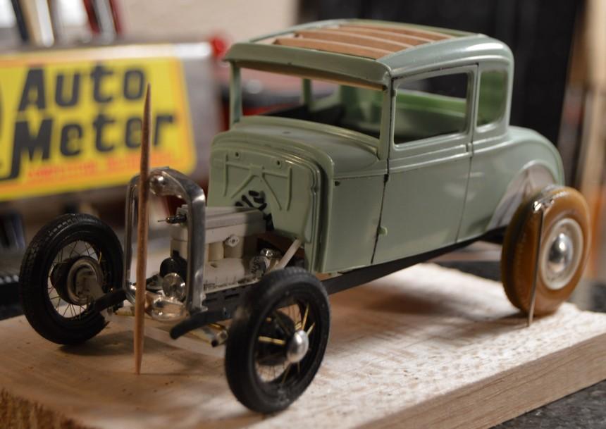

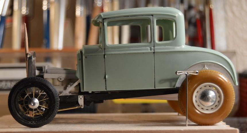

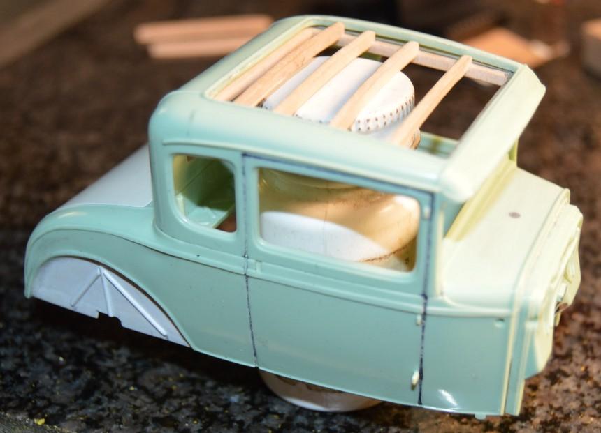

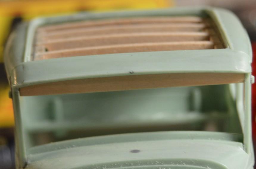

Straightliner59 Posted February 23, 2020 Author Share Posted February 23, 2020 (edited) I got the fine-tuning on the roof a bit farther along. I thinned the plastic around the opening quite a fair amount. I will keep working at the interface between the body and the framework until the wood pretty much just snuggles into place (it doesn't, yet). I spent some time with a steel plate, some magnets and a blow dryer, and flattened the floor "plate". It was fairly humped, in the middle. Once that was done, I replaced the wood floorboards, inserted the interior door panels and dash, and set the assemblies together, and placed them on the chassis, to get a look at what I have, so far. I also tacky-glued the pressed aluminum grille shell to the chassis. I like where it's heading! Questions, comments and critiques always welcome! Thanks for checking it out! Edited February 23, 2020 by Straightliner59 Quote Link to comment Share on other sites More sharing options...
mchook Posted February 23, 2020 Share Posted February 23, 2020 The top looks great & the I love that radiator shell. It wont be long & the primer & paint should be flying. Quote Link to comment Share on other sites More sharing options...
Straightliner59 Posted February 23, 2020 Author Share Posted February 23, 2020 4 hours ago, mchook said: The top looks great & the I love that radiator shell. It wont be long & the primer & paint should be flying. Thank you, Mark. Your kind words are appreciated! I like the metal, for the radiator shell, too. The aluminum looks more like nickel plating than kit chrome does, I think. I have an idea that might help to clean up its form a bit. It's still going to be a squeeze, between the fan and the radiator. Thanks for your comments. Quote Link to comment Share on other sites More sharing options...

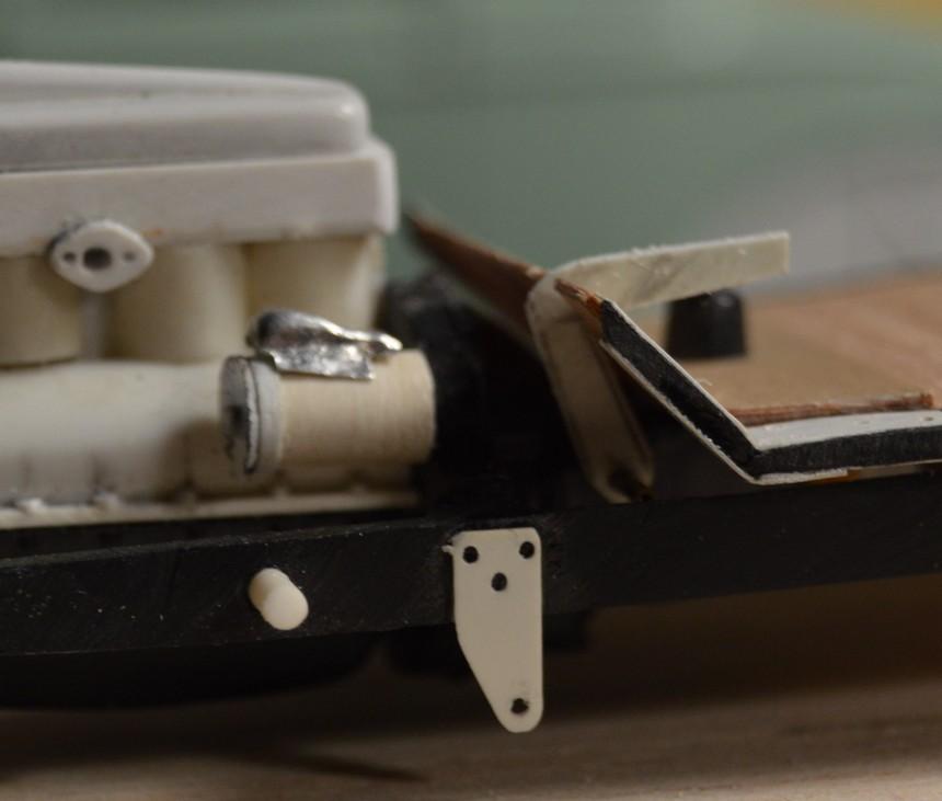

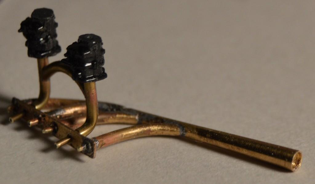

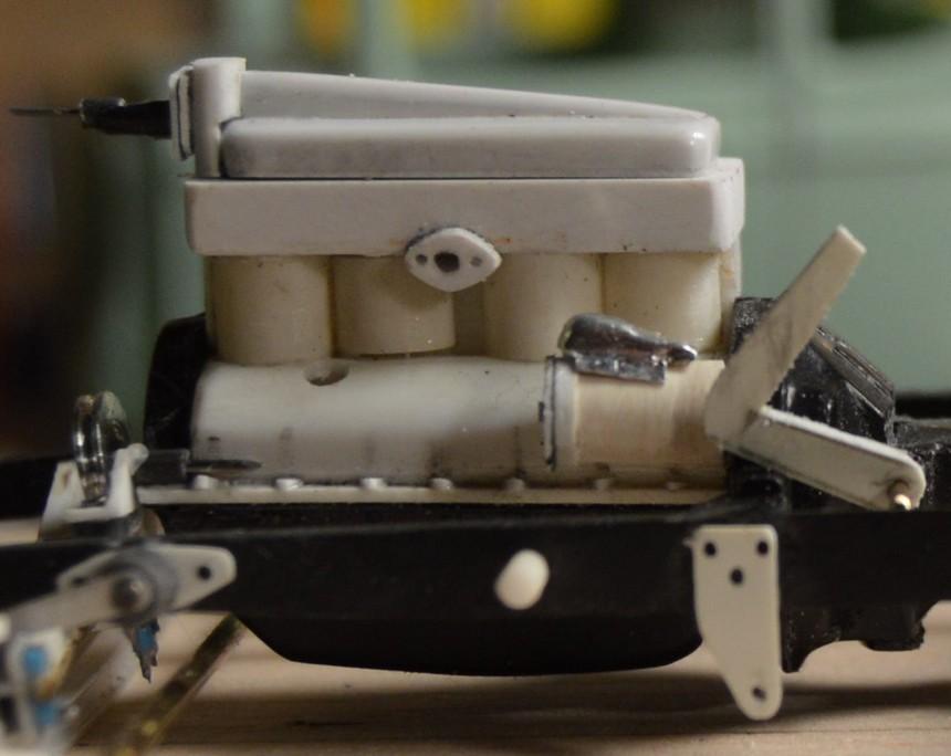

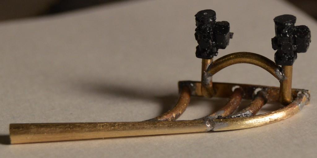

Straightliner59 Posted March 2, 2020 Author Share Posted March 2, 2020 I took this apart to rectify some issues I hadn't yet addressed, and thought I'd post a photo of some of the sub-assemblies. I soldered the flange to the header, and inserted pegs into the intake manifold. Now, the manifold and header fit together! As always, questions critiques and comments are welcome! Thanks for looking! Quote Link to comment Share on other sites More sharing options...
afx Posted March 2, 2020 Share Posted March 2, 2020 I like the header and intake. Quote Link to comment Share on other sites More sharing options...
Straightliner59 Posted March 2, 2020 Author Share Posted March 2, 2020 11 minutes ago, afx said: I like the header and intake. Thanks, JC! It's a pretty cool looking setup, I think. Assembled, like that, it should make for a pretty foolproof mount, too! Quote Link to comment Share on other sites More sharing options...

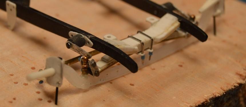

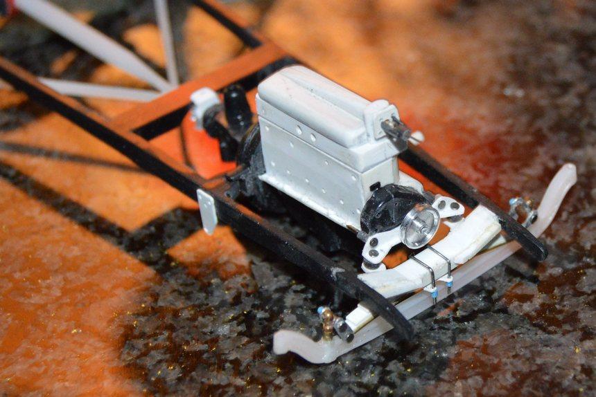

Straightliner59 Posted March 6, 2020 Author Share Posted March 6, 2020 I did further work to the front suspension. I made the u-bolts and the retainer plate. I have a start on the steering box, as well. Quote Link to comment Share on other sites More sharing options...
Straightliner59 Posted March 6, 2020 Author Share Posted March 6, 2020 I got the front suspension back together. The shocks are new, not yet "bolted" to the eyes on the springs. Next up will be putting the rear suspension all back together, with shocks, this time. After that, I will probably move to the clutch/brake pedal assembly... Quote Link to comment Share on other sites More sharing options...
David G. Posted March 6, 2020 Share Posted March 6, 2020 Excellent progress! I'm still amazed at the level of detail you[re putting into this. David G. Quote Link to comment Share on other sites More sharing options...
Straightliner59 Posted March 7, 2020 Author Share Posted March 7, 2020 13 hours ago, David G. said: Excellent progress! I'm still amazed at the level of detail you[re putting into this. David G. Thanks so much, David! Scratching those little details is one of my favorite aspects of modeling. Thanks for looking, and for your comment! Quote Link to comment Share on other sites More sharing options...

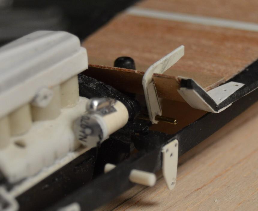

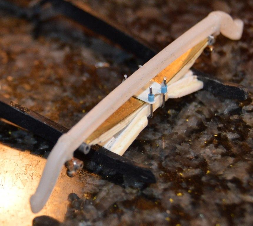

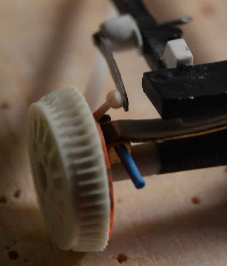

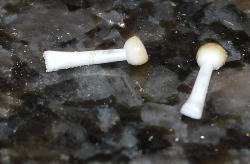

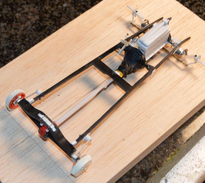

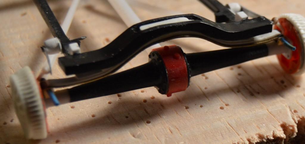

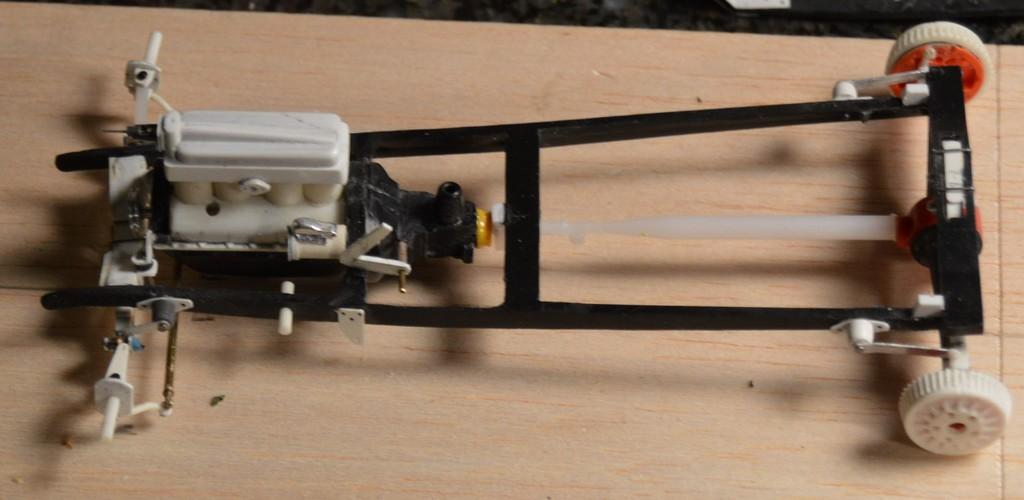

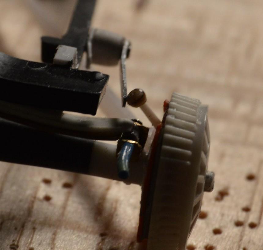

Straightliner59 Posted March 9, 2020 Author Share Posted March 9, 2020 I needed to make the little brackets that mount to the axle ends of the rear shocks. They have a little ball on the end that the shock arm attaches to. It's a tiny piece of plastic, and oddly-shaped. I ended up making it by stretching some .060" plastic rod, holding the ends at similar angles, as I pulled, since the needed to bend in. Once i had those cut apart (leaving some of the long, thin end attached), I fitted them with the shocks in place, to get them close to where they belong. Next, I used a lighter to melt the thin end, carefully, to create the balled end. I still need to clean up the balls, a little, but, I am happy with them! It's kind of cool that they will be readily visible, on the finished model. Here are a couple of photos of the brackets, themselves, and with them, and the shocks, sitting in place. I've also included an overhead shot of the chassis, as it edges toward completion. As always, comments, critiques and questions are welcome! Thanks for stopping by! Quote Link to comment Share on other sites More sharing options...

Straightliner59 Posted March 11, 2020 Author Share Posted March 11, 2020 On 3/10/2020 at 5:37 AM, David G. said: Cool! David G. Thanks, David. I still need to sand the ball ends down, but, those should work! I remembered doing something similar, when I built The Bug, almost years ago. Quote Link to comment Share on other sites More sharing options...
