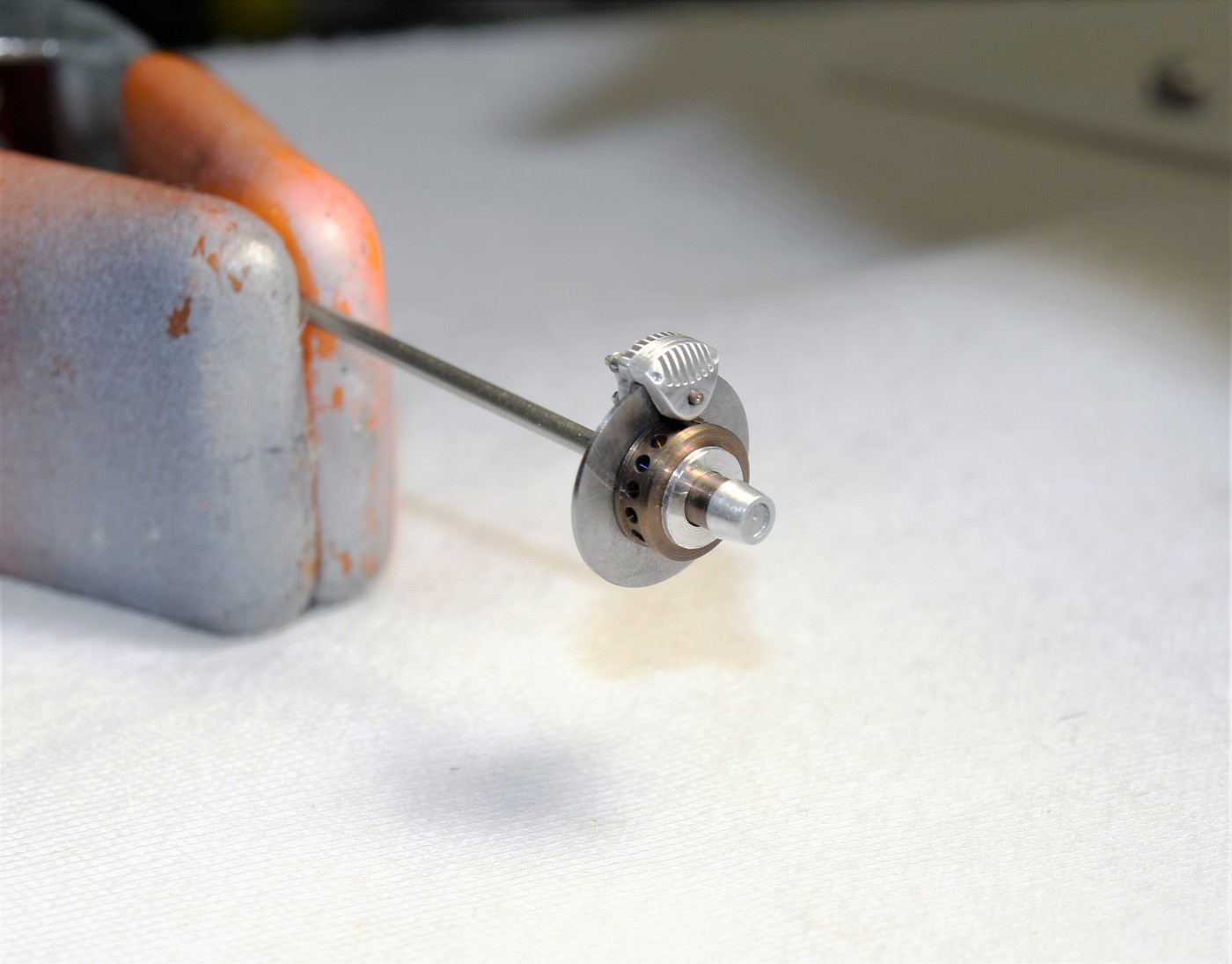

After fussing around I got one side of one of the front disc brake calipers done.  Outboard side and one more to match then onto the 2 inboard sides which are a bit different and more challenging than this little bugger.  Didn't snap off one end mill either. YEAH.  the fins are cut in using a .010" (.27mm) end mill.  The dimensions are 4.0 x 3.0 x 1.4mm    Some days on the mill are better than others.....to mill this the machine was REALLY dialed in today.  Not always the case I assure you.....cheers, tim

Fantastic precision work (as usual) Tim, the brake calipers will be nothing less than jewels!  I have a couple of these 0.010" end mill and it's always very intimidating to work with them, as you say so well, they can last a very long time or break on the first cut.  Yours did quite a job...! 👍

I am curious regarding depth of cut, with these end mills. As I recall,  Sherline suggests half the diameter of the mill. I have been using my mill, more frequently than before. Thanks to you and Tim, I am slowly spreading my wings, on it.

Good morning Francis, you sure are right about that.......I don't mind losing one from time to time, I've had 2 in a row go "poof"......adjusted speed & feed and then good to go.   The "fins" themselves are .15mm in thickness...........
Daniel, this will surprise you perhaps but the length of cut on this particular end mill is only .85mm overall.  I came in on the piece from the end of course after dropping it down to the max length of .85.  Ran the speed to 10,000 rpm (the max my machine will spin) and then s-l-o-w-l-y worked it in to the piece.  Each cut was 1.5mm in length.  I would back out  (SLOWLY ) the end mill when I got about half way into each cut, cleaned off the end mill and the slot (I use a soft, narrow bristle brush) and then finished the cut.  It's important to back the end mill out slowly as it can easily snap on the way out if there are cuttings in the slot. I DO use an air vacum to pull shavings away from the piece as I'm milling too.  Helps to clean it out of the way of the end mill and keeps the workplace a bit cleaner.  I learned that little tip from Dave (comp1839)   Hope this helps you in some way.    cheers, tim

Thank you, so much! It will prove to be very helpful,  at some point. It will get some work in with the. 032" mills I have, first, them, I will graduate myself to the smaller ones. Your work (as is Francis') is ultra-inspirational.

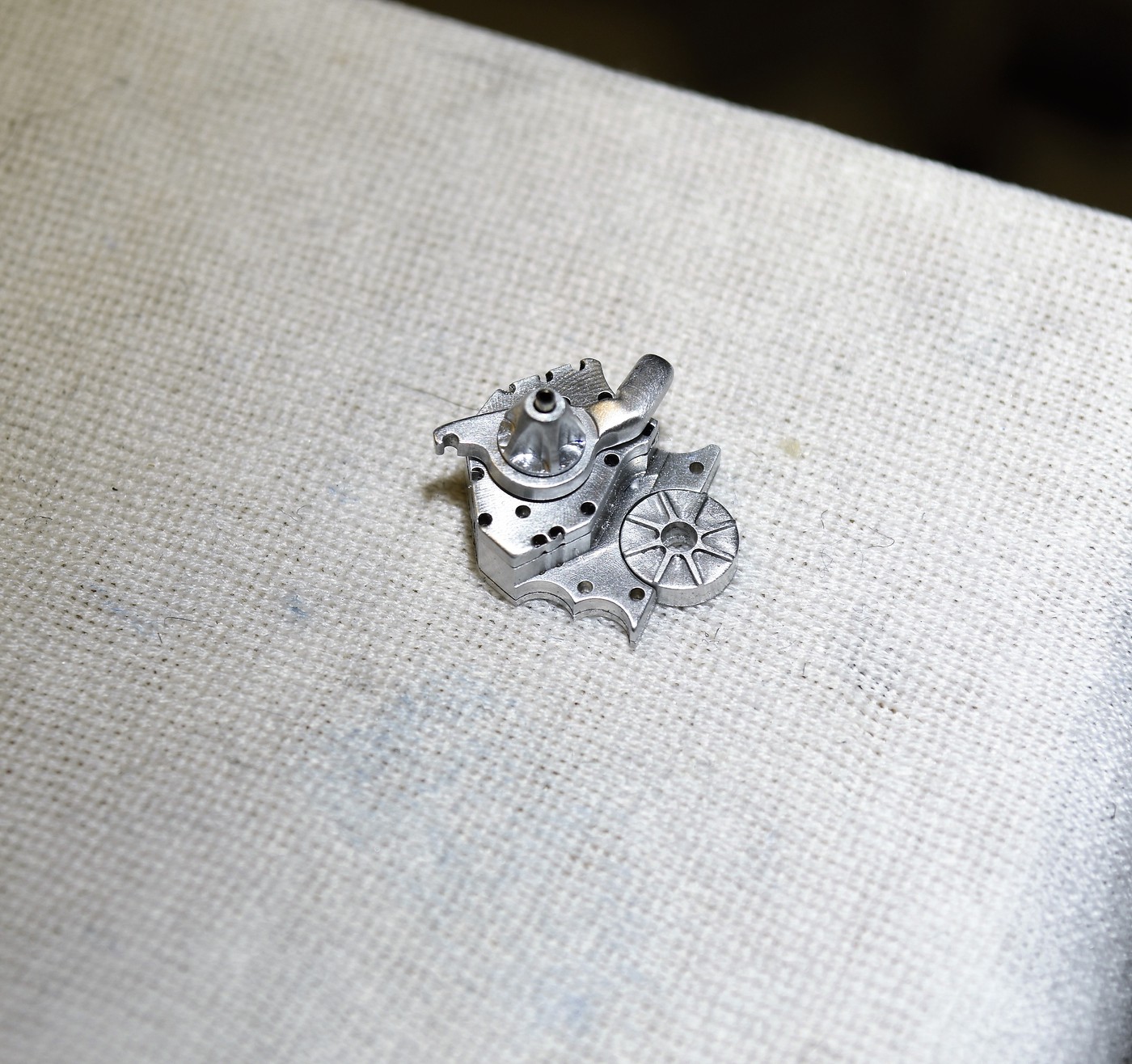

As mentioned above, I started the rear calipers.  They are larger with a bit more detail in them (more tiny "fins" too).  Got thru the first one and when backing out the end mill on the last cut it snapped the tool.  I got 5 caliper sides done before snapping one, I consider that a win.   These pics are of the outer side of the calipers.  After cutting them off I'll get on to the more complicated inside half.  It takes about 2 1/2 hours to machine 1 as an fyi.  Requires a bunch of patience for an older guy like myself.   Cheers, Tim

Andy, thanks for stopping by too and for the sentiments.  Regarding fluid on this tiny piece, the endmill is a Kyocera 4 flute.  I couldn't get a 2 flute like I wanted in the extended length in this small diameter. I always use oil when drilling with tiny bits or machining harder metals (steel or Ti).    Liquid/fluid of any sort that causes any particles to be trapped or adhere in the flutes would be an issue. This thing is so small you can't even see the flutes.  The life expectancy of a tiny mill like this IS limited.  It cost me $20. btw. Considering I got 5 hours running it before snapping, I'm okay with it.  I did make one adjustment however that I should share, that being instead of backing it out half way during each cut of the fin, I started backing it out twice (third of the way).  I should be good from here on.   Thanks again for the comment & suggestion.    Cheers to everyone,  tim
